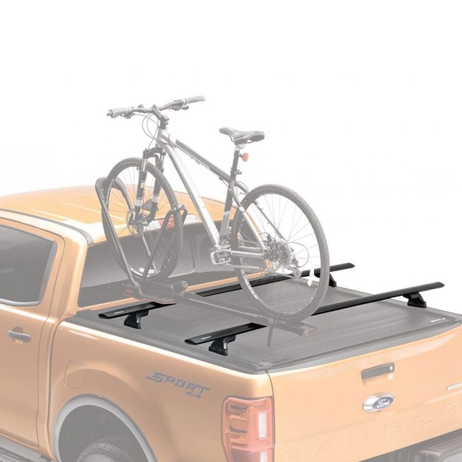

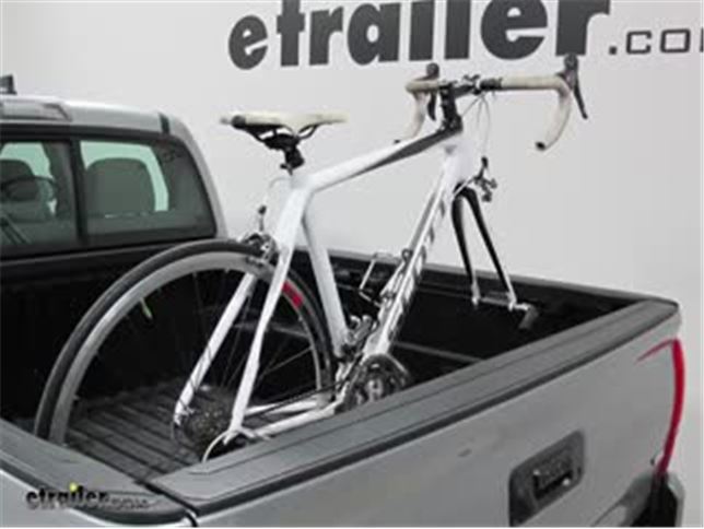

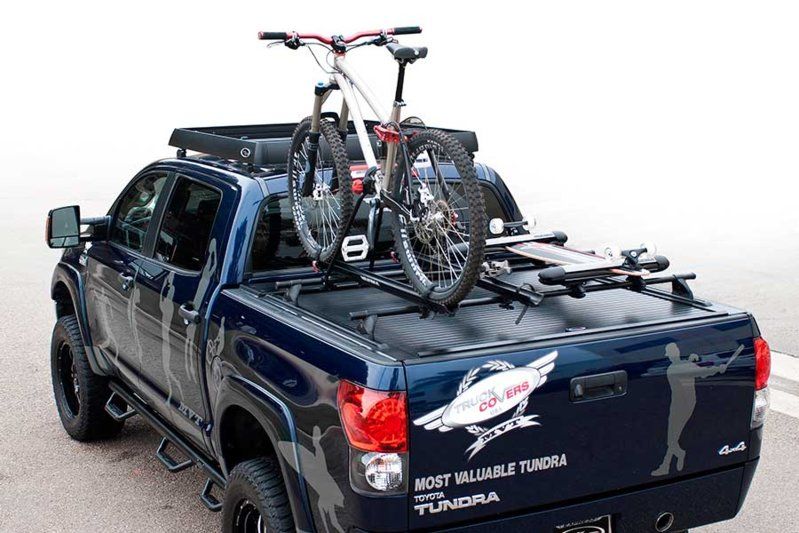

I've seen several trucks with deck rail systems that use crossbars to mount roof and fork type bike racks similar to these:
ONECOL (1).jpg download (9).jpg e67c19475b2a641f7f25a7a51423cdf3.jpg images (8).jpg install-rockymounts-lowball-bike-rack-2018-toyota-tacoma-rky1097_644.jpg
Most however require lifting a heavy e-bike up to chest height to load. Due to the overall height, Some can also be a clearance problem in some situations.
View attachment 79636 View attachment 79641 View attachment 79642 View attachment 79643 View attachment 79644
I have been searching for a solution like this for over a year. Specifically, look at the blue tundra with the bike over the crossbars - he has a tonneau cover, with the bike on the crossbars - I want something exactly like this. I don't want to have to remove the front wheel to get the bike onto the truck on the crossbars.
The problem for me is that all of these roof bike racks in these pictures you shared are rated for a max of 45 pounds. My bike is about 50 pounds with the battery off. So again, I am concerned about the liability in an accident.
The rack in the second picture looked interesting. It looks like it could pivot outward making it easier to load. The extra bike weight can be handled by tying it off to the truck rails but the liability issue is a different story. Sharp lawyers can make a big deal out of nothing if there is a big payoff to be had.
