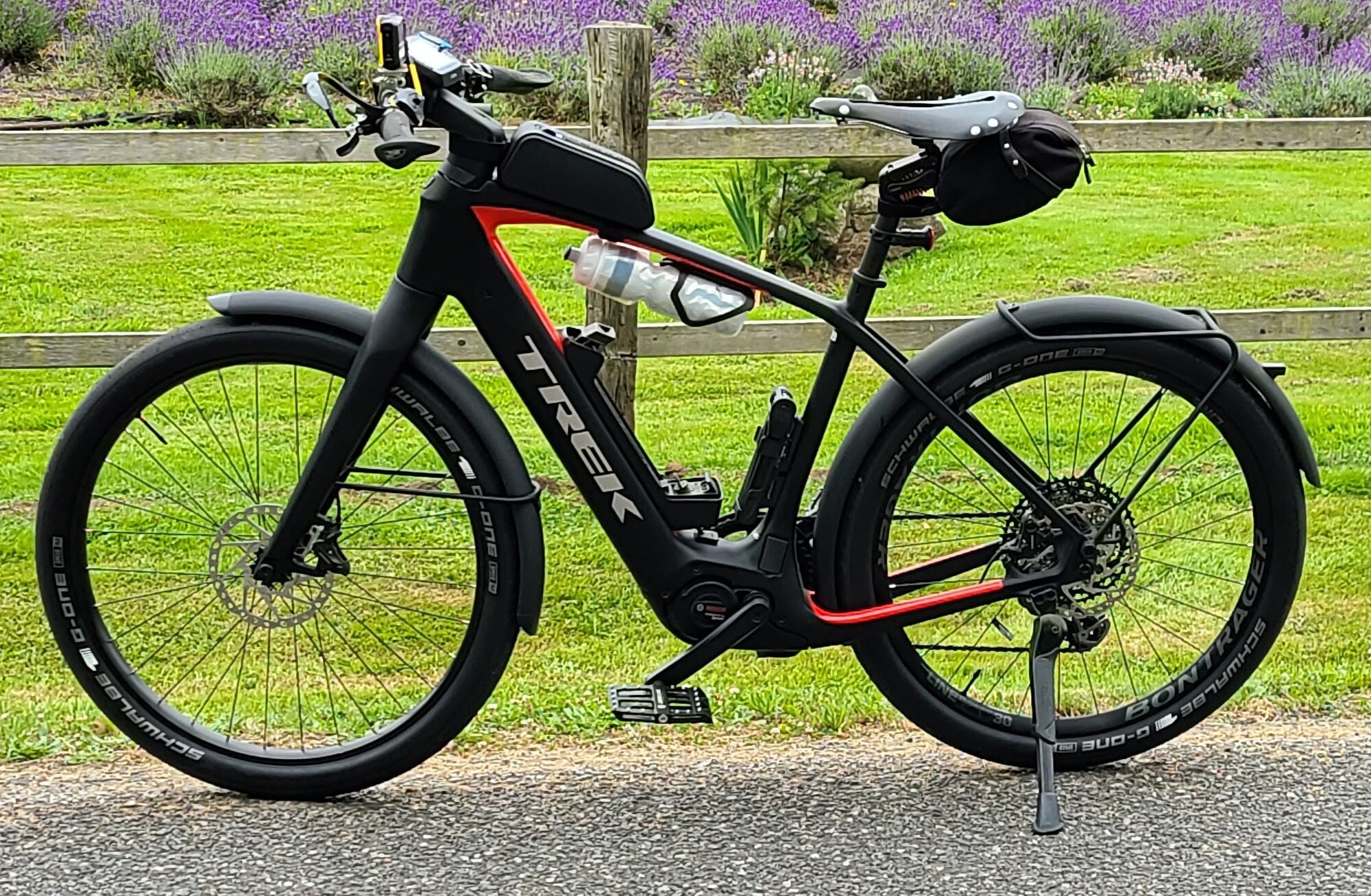

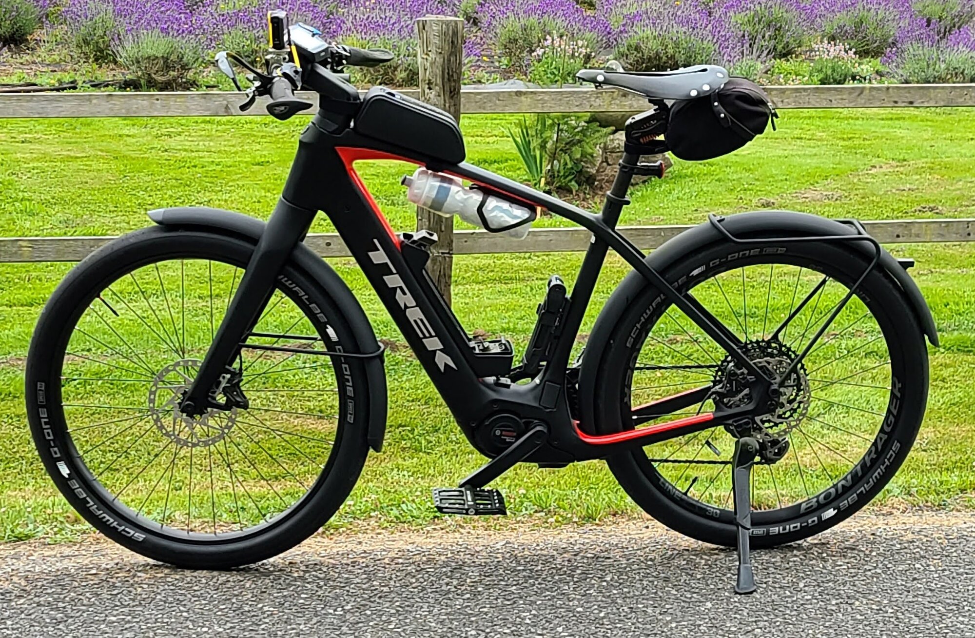

The Allant is a great commuter designed ebike. It has a semi-upright ride position which makes it easier to look around and behind, helping you maintain good situational awareness, important when riding any bike but even more so when commuting on roads with so many distracted, impatient drivers on the road.
If you can afford it, the Allant 9.9S is the bomb! The bike is quick, well speced with four piston brakes, 12 speed Shimano drive train,624 wh internal battery with very comfortable geometry, very stable at speed with full, solid, alloy fenders. With its carbon fiber frame, it is quieter and transmits fewer fine vibrations to your bum and hands. It does lack a suspension so I installed a Kinekt tunable, weight adjustable seatpost https://cirruscycles.com/pages/why-kinekt
For handlebar comfort I swapped out the OEM handlebar for a Baramind that has elastomers built in that allow controlled downward flex when hitting bump, sticks, rocks, etc. Their Bam City model is perfect on an Allant https://www.baramind-bike.com/en/ they are made in France and can be ordered directly off their website.
Trek offers a second, range extending 500 wh battery option, which I did go for an have never regretted.
As I live in a very hilly area, I did swap out the standard 10-45 cassette for a 10-51 to get better hill climbing gear ratios.
I really dislike the idea of using my phone as the bike display and much prefer a dedicated display unit. So I changed out the smart phone hub for the Nyon, a far superior option )the one new in 2021 is even better. The smart phone hub has met with mostly user dissatisfaction with phones flying off the mount on heavy bumps and frequent connectivity issues.
For tires I am now riding Schwalbe Hurricane 27.5 x 2.4. They have low rolling resistance a smooth center strip for near silent running on pavement and knobby shoulders for decent performance on trails, as well as good flat protection.
These two further mods I put on the bike are certainly not necessary but kick the drive train refinement up several notches and are very nice to have. I changed out the manual derailleur for a Sram AXS wireless unit as well as an Onyx rear hub with instant engagement and silent coasting. Their classic unit, designed for mountain bikes and ebike rated is a better choice than their Vesper which has been paired down to lower the weight. https://onyxrp.com/tech/
