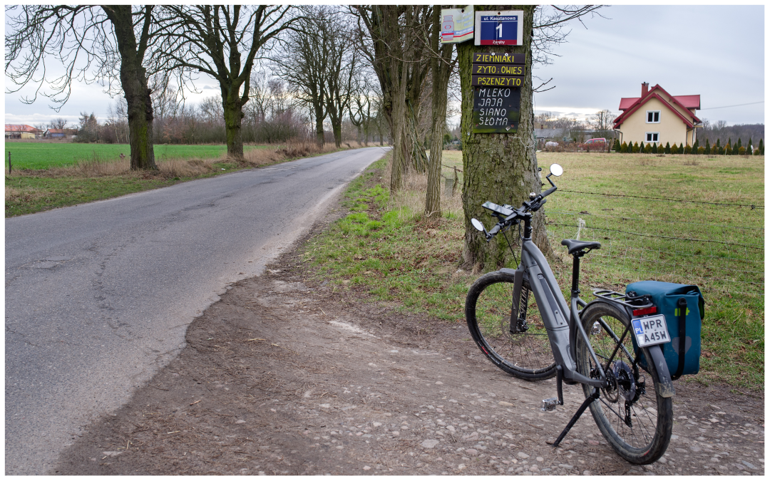

First of all, the Ortlieb E-Mate pannier is almost ideal for the spare Vado battery. It includes a reinforced pocket inside that fits the battery. The Vado battery is a tad too long and the pannier's flap can still be closed with the magnetic lock but with some care. The E-Mate is very popular among the Forum enthusiasts.
Ortlieb Bike-Packer pannier is larger than the E-Mate. The (optional) Ortlieb Commuter Inserts (it is a single piece even if the name suggests otherwise) allows to carry even larger batteries. The "Inserts" is a reinforced nylon organiser to be put at the bottom of the Bike-Packer pannier. There is a plenty of space there. I typically carry the spare battery, two large water bottles, snacks, some clothes such as a windbreaker, a wallet, door/bike keys, an Allen key set, a chain tool and there even is some space for an MTB tyre pump...

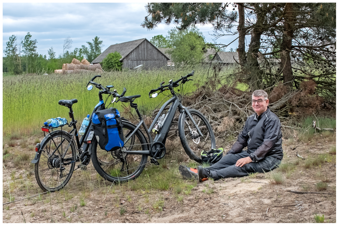

I need to add to what Tim has just said that carrying a spare battery is painless as long as:
  1. You use an appropriate pannier that wouldn't tear up due to the battery weight (examples above);
  2. You never forget taking the battery lock key with you (it's never happened to me but it happens to many e-riders).
A good pannier feels like it were glued to the rack, creates minimal aerodynamic drag and does not affect the bike balance. The Vado motor is so strong it is virtually unaffected by rather heavy pannier.
My Vado with the Ortlieb Bike-Packer pannier/Ortlieb Commuter Inserts, loaded to the max on a long trip (including a spare battery).
My Vado with the Ortlieb E-Mate pannier (holding the spare battery).

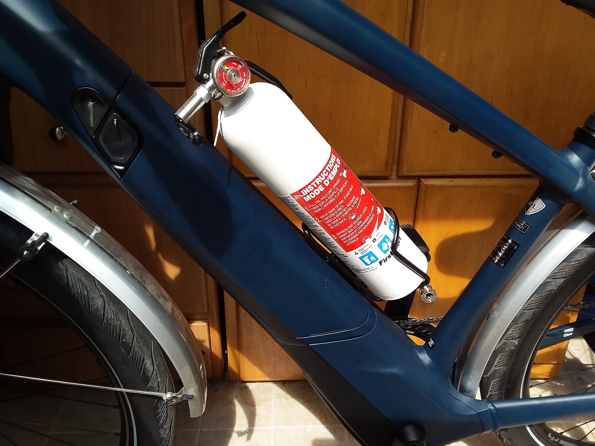

Thinking about this whole electric system ... motor default failure = overheat , lithium ion default failure = explode , both between my legs. Maybe a better use of the
water battle cage is a fire extinguisher...

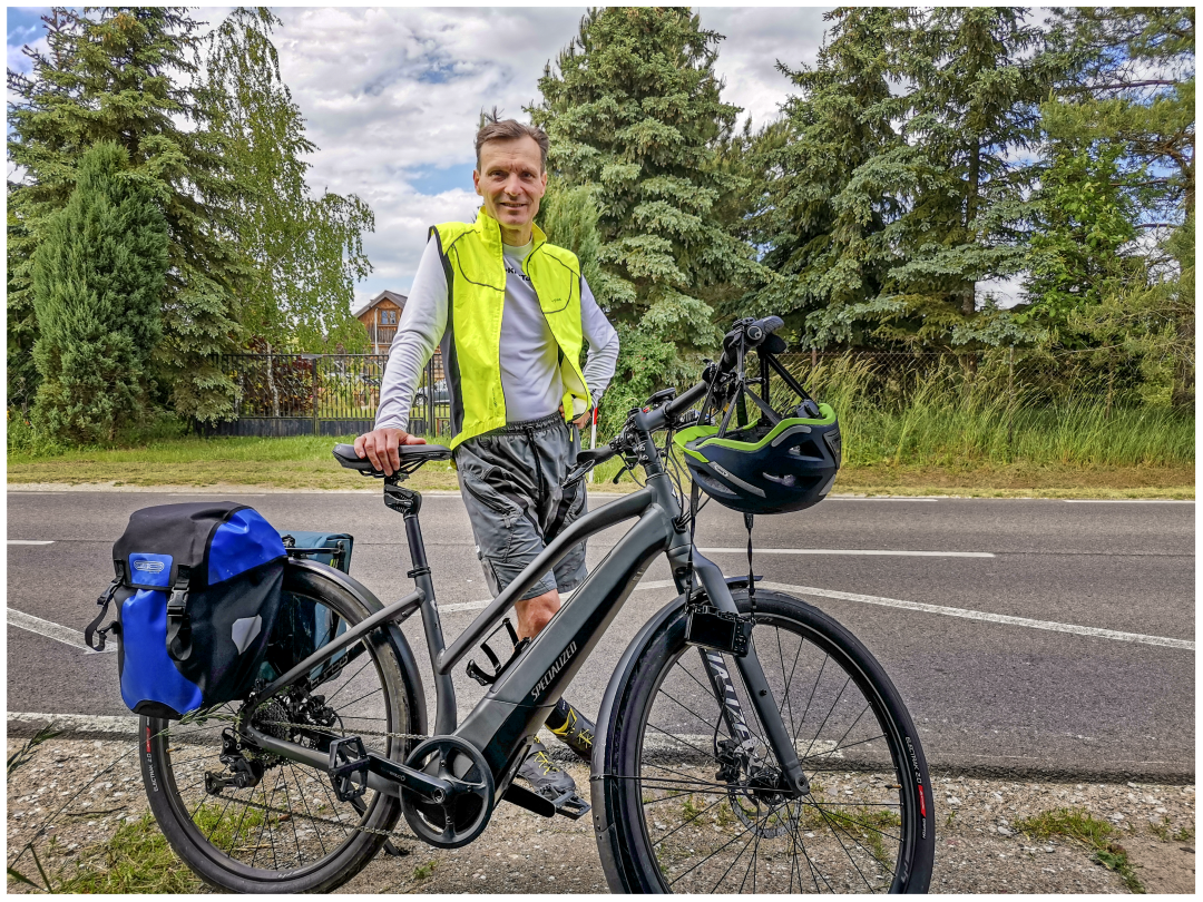

Guys. Why do you need to make life complicated? Yes, Riese & Mueller e-bikes come with (optional) dual battery and it is 1000 Wh total but the bike is extremely heavy. I own two 600 Wh batteries making my range superior to the R&M (1200 Wh) while the Vado with a single battery and no cargo weighs 23 kg (50.7 lb); we weighted it. Just a ride? Ride a relatively lightweight e-bike. Need to transport your Vado? Remove the battery and it weighs 19 kg (42 lb) or so. Now, fancy the monster with the dual battery...
Need a long ride? Put your spare battery into a pannier and just hang the pannier on the bike's rack, then off you ride. If I -- a lazy person -- can do it, anyone can. Never forget taking the battery key with you though ;)
More power to your smartphone? Put the smartphone into your cycling jersey pocket together with a powerbank.
There are some ideas that my first manager in the scientific institute used to call: "It's a triumph of technology against the common sense" :D Don't follow that way!
My relatively lightweight, sleek Vado fully loaded on a 70 mile ride. The drive side pannier holds the spare battery, two water bottles, tools, wallet, keys. The pannier on the opposite side is for food, more water and more clothes. My brother pictured here uses an iPhone (a battery hungry device), so he keeps the phone in the pocket of his shorts together with a powerbank.
