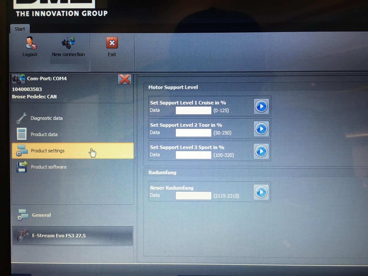

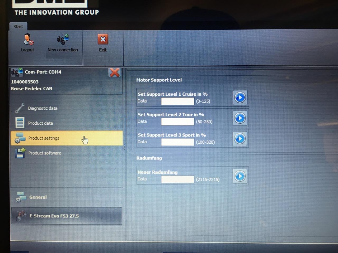

I've been looking at a Bulls E-Stream EVO FS 27.5 Plus with a 650Wh battery. There is no tuning option
Actually, there is some sort of tuning. It's very straight forward.
We have tuned few Brose motors to suit the riders' preference but it doesn't increase the top end speed.
If you are looking for speed tuning, it's possible to swap out the motor for a 350W S-pedelec motor or You can get a EVO 45 bike and put 2.8" tires.
Now, Specialized uses their own firmware matched the Brose motor and I am not certain if this can be done on Specialized bikes but it's not too hard of a problem at all.
