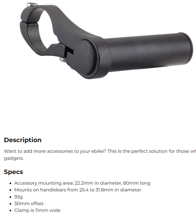

All you need to do is to fit the remote is this:
Or easy enough to make one also if you just cut a short section of 22.2mm bar flat as opposed to radiused as above it will zip tie nicely to the side of a brake hood and be easily accessible.
that’s a nice compact one. many ways to do this, but the real question is how appropriate the geometry of the frame is to drop bars. every drop to flat conversion i’ve ridden has been way off, for me at least, and i’d imagine the opposite to be true also.

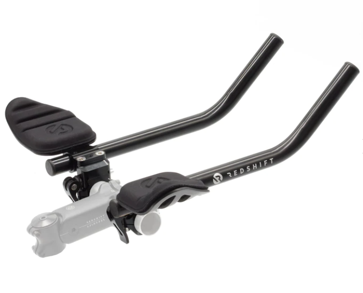

I've got a new idea.
Why do you need drop bars in the first place? To reduce the aerodynamic drag and keep your arms closer apart.

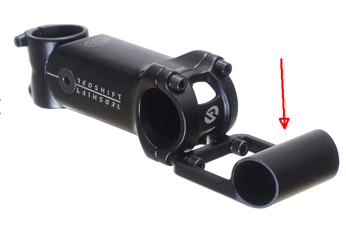

Redshift Aerobars (Model L) are the answer. Fitting the 31.8 mm central part of flat handlebars around the stem. (I asked Redshift Sports and they confirmed the aerobars will fit my handlebars).
I just need to buy Redshift Accessory Mount first, to move my GoPro mount off the bars:
With the "LeMond bars" (as we call them in Poland: "lemondki"), the rider can assume an aerodynamic position, relieve the bum, and pedal more efficiently. Who in the earth needs drop bars?!

anyone who wants to control their bike while going moderately fast!
aerobars are not suitable or safe for riding on the uncontrolled road except in a straight line. the contact point with the bar is too close together, hands too far forward, too hard to see, etc. and then there is the small matter of your hands being nowhere near the brakes. they’re not even allowed by most organized rides here, simply too dangerous.
great for going super fast on a straight flat surface though!!! or a triathlon with a closed, well-practiced course.
be careful, @Stefan Mikes
Haven't you seen the Tour Divide Ultra video? Big number of gravel cyclists ride on aerobars!

doesn’t mean it’s safe for general use. seriously. the last time a cyclist killed a pedestrian in new york, they were riding with aerobars. not a coincidence.
Unfortunately, riders often insist on using aerobars during group rides, despite of the mounds of evidence proving the dangers involved in doing so. While there is no “cycling law” against the use of aerobars during group rides, any cyclist with common sense knows that it is a bad idea.
Aerobars can be considered less safe for a few reasons: mostly because your hands are not on the brakes while riding in the aerobars. It also takes more practice and skill to maintain a straight line in the aerobars (especially in cross winds) due to how close your arms are together. And so during the traditional road bike races the riders are only allowed to use tradition road bikes.
Yes, a cyclist killing a pedestrian on any type of bicycle is an aberration, but the last person who managed to do so in New York City was riding in Central Park on a bike equipped with aerobars.
Steering control is severely compromised when using aero bars. They're not considered safe when riders may be racing in close proximity - a slight wobble could cause a major takedown. They're not great for cornering either. Hence the reason they're illegal in most events, except triathlon and time trials, where riders are mostly spread apart and riding fairly straight courses.
seriously stefan, if you’re going to do this, only use them when you’re nowhere near other riders, cars, or pedestrians. there is a reason drop bars are the way they are - so you can still control the bike and the brakes while in the drops.
Mark,
My buddy Staszek made a 553 km gravel ultramarathon using aerobars anywhere on the pavement outside cities. I myself saw a guy riding aerobars on a flat handlebar gravel e-bike on a 10 km straight stretch of a forest gravel road on one of my group rides. Staszek tells me aerobars are very good outside cities and it is where I mostly ride. He only instantly grabs his handlebar hoods when he can see a pothole, a pedestrian etc.
I understand the dangers, and thank you for telling me about them! There are so frequent situations where I ride long stretches of no-traffic paved roads here, and I hate the wind drag... And I would love to straighten my back! :)

just resist the urge to use them when you’re not all alone in the woods!
i’ve done the “aerobar” position on my drop bar bikes on straight stretches of road or the local cycle track when it’s empty. it does indeed make a big difference. you can test it out without the bars, just lean forward and rest your arm just below the elbow on the handlebars 😳😳
