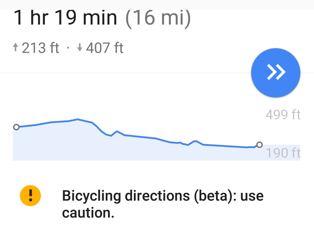

This is the commute i'd like to do, there and back without charging:
https://www.google.co.uk/maps/dir/L...d2a6fb49cb8!2m2!1d-1.1397592!2d52.6368778!3e1
So it is quite hilly.

A 250 watt drive at 15 mph and less, with 13 to 15 amp hour battery pack, you should be able to get 40 miles with some decent effort on your part. Looking at your route, you have 16 miles one way and it's really not all that hilly.
If you could charge during the day before your return trip, it would be a breeze.

So you think a 13ah battery would easily take me that route and back on one charge?
J.R.
It can. You're a young guy (26?) and the route isn't that challenging. I would charge midway if you can. Not only would charging assure you get there, it would prolong the pack's life span. 32 miles, the 13 ah would allow 14.6 watt hour per mile. Very doable.
