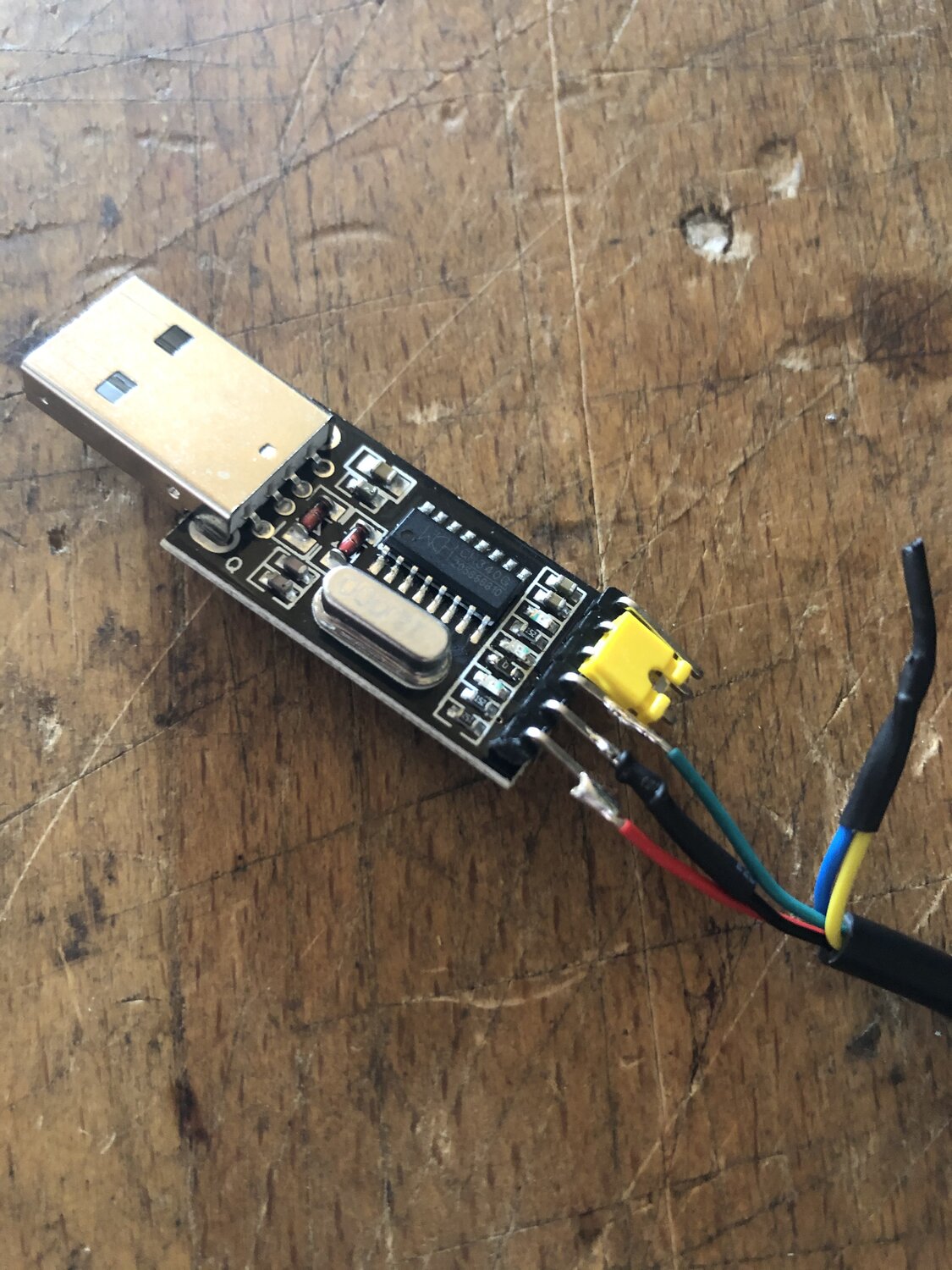

I purchased an Ultra motor and frame from WW and want to adjust some of the throttle settings but are not having much luck. I got the upgraded controller but the throttle response is vey weak its almost like having no throttle at all. PAS is great and seems to be adjusted ok so I'm just looking to raise the throttle output. What I want to do is access the throttle settings from my other bike with the BBSHD and change the ultra programing to match up with that. I think the current setting I have is to save a bit of battery life but with the larger battery (34.5ahr) I am using I have power to spare.
I purchased a programing cable from Cal E-Bikes and are using a PC with windows 10 installed. I downloaded the ( what I think is the right program ) from the web and the program won't let me connect up to my USB. You have to manually input your Com Port and it keeps saying "failure" All com ports are good I swapped around the keyboard and mouse plugs to different ports and they all work fine. I even downloaded the "basic ultra programing program" from the Biktrix site and still can't connect up. I also brought the bike inside the house to try and connect up to another PC with Windows 7 and got the same results. I took the shrink tubing off the USB end of my adadpter to see if I could see anything obvious but it looked ok.
Any ideas I'm all ears thanks for listening.

You installed the driver for the cable? There should be one if windows does not pull it.
Here is an example:
https://edrivenet.com/bafang-programming/
Something should show up in Device Manager is it's not recognized try another USB port or try another cable.
