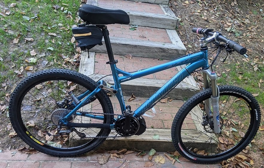

I have built several off road e-mountain bikes over the years but the one thing they have in common is they still look like DIY kits. The new e-mountain bikes are fully integrated they just look awesome and IMO just next level compared to a DIY's type bike. Sure my BBSHD DIY kit performs well and the cost savings are there compared to a store bought "real e-mountain bike" but it's like buying / building a kit car. You can always tell a kit car from a manufacture built car. The idea is to buy directly from the manufacture that makes the ebikes for other big manufactures like a Specialized, Trek, Giant, SantaCruz, etc. The question is does anyone know of a manufacture in China or Taiwan that builds ebikes for Trek or any of the other big brands? Secondly does anyone know if they sell to the public direct from the manufacture? I'd like to buy direct.
Note: I dont want to spec a bike from scratch but wouldn't be opposed to assembling one if all the CORRECT matching components are part of the kit.
I've looked at Alibaba and only see lower end bikes. I did find Frey which carry nice e-bikes with better components like sram / rockshock / fox BUT they look like a startup and look like a new e-bike company. Not what I'm looking for. Want to take advantage of a proven build and manufacture that's been doing this for other companies.
Bike Directs is the closest I've seen so far, they have two integrated e-bikes that look good and I've been looking at their site for six months now and they always seem to be sold out. http://www.bikesdirect.com/products/ebikes-electric-bikes-at-near-wholesale.html the Bikes are name brand MotoBecane apparently there an online only sales. I dont think you can find this brand in a LBS. From the reviews on the older bikes they seem quite positive. I have NOT been able to find any reviews on the 2021 models though.
Any other sites I should look at or does anyone know of a link to a manufacture site if so please list. First is this a thing? Second if it is a thing how would I go about doing this?
i
Thoughts comments and suggestions. Pic of my current e-bike. Early Specialized Epic Cross Country model with BBSHD and 17ah 52v battery.

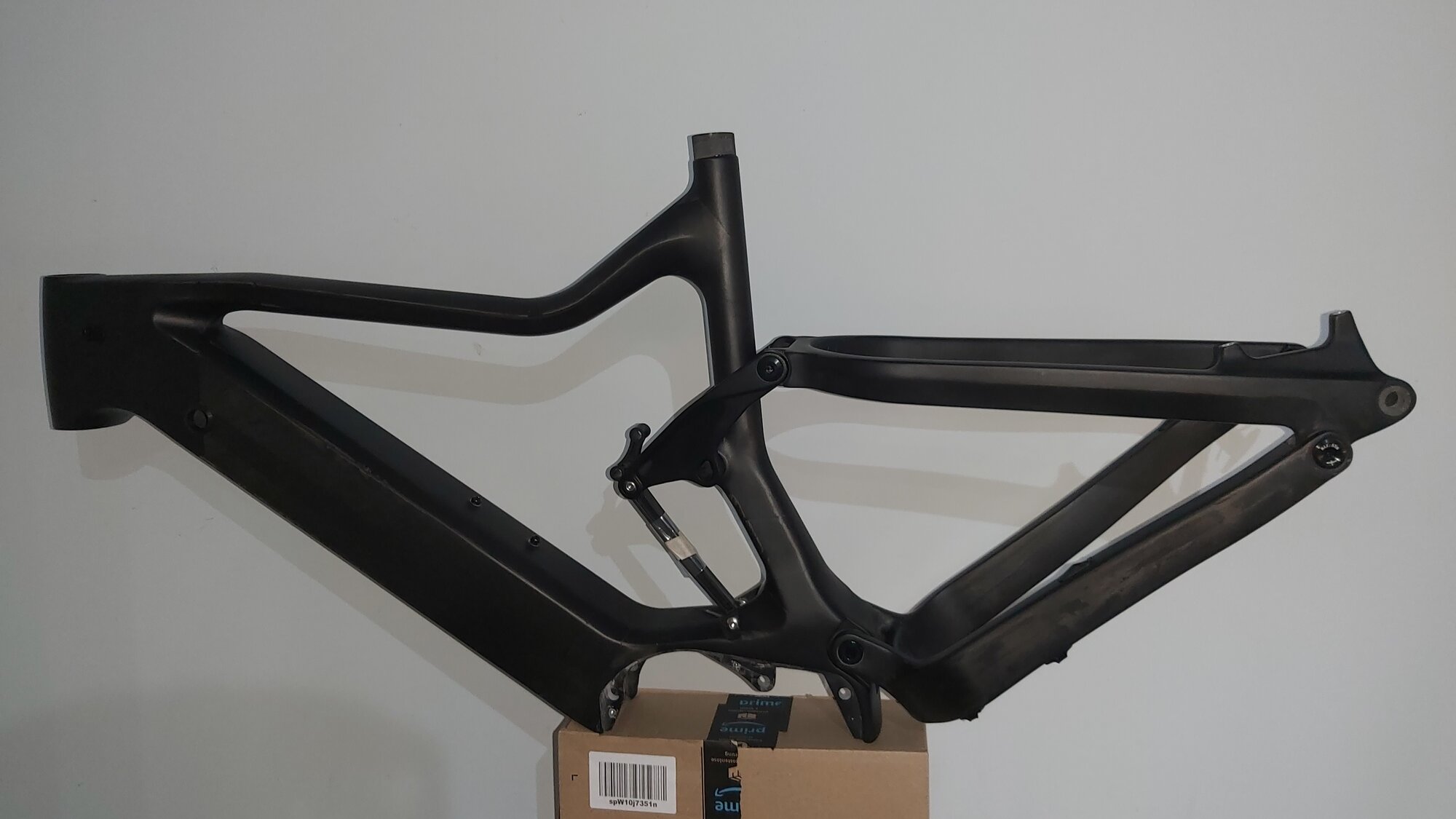

Dengfu are an OEM and ODM carbon manufacturer http://www.dengfubikes.com/Products/index.html
I'm currently waiting for my order to turn up and have felt no reticence ordering from them, you will see threads on here using dengfu frames and the numbers will proliferate as they assemble them and ship them.
Yeah I reached out to Dengfu and they basically sent me a list of some of their available parts but not a complete bike. For example they qouted me on a frame and battery tray but not on the battery. The frame did not come with any suspension etc... Shipping was like $400 also I think shipping cost have really gone up with in the last six months. I dont recall shipping ever being this expensive from China.

Have you looked at older model year eBikes? I ride 2016 models and the resale price for them is surely getting really low. Pretty soon there has to be some real Emtb that can be bought for $500 because the owner doesn't want to put money in parts.
Mike_V
F.G.,
IMNSHO
You won't find another eBike as, strong, powerful, good looking, capable as the one you've built.
'The Brain' rear suspension, is too expensive to replicate now.
Today you find some soft and saggy multi link wobbly rocker suspension.
Excellent build, FS yet a big 52V battery, nice Specialized paint, fork of your choice.
Near perfect, except for climbing the Rockies, I think.
M.V.
Thanks for the complements. For me my 17ah 52v pack is way to big for my style of riding. A hard expensive lesson to learn the battery was $500+ If I keep it I will order an 8ah 52v which I will be able to fit in a saddle bag and clean up the look. The most I ever ride is about 1.5 hrs and that should be plenty. The other issue is the lack of travel I only have about 100mm and I frequently bottom out the suspension. A big beefy DIY setup requires more of a trail or all mountain bike setup. The current setup is a bit too heavy for a light XC bike.
Doing a diy like mine especially if your building a trail riding bike with durability in mind requires a lot of planning and careful choice of components. The blekkie chainring is a must have and having a good quality battery is a must I went with Em3ev. The BBSHD is not with out issues though. There is a major issue with throttle sensitivity which can be overcome with a FW update but requires a special programming cable and bla bla bla and I mentioned the chainring. This issue becomes very apparent if all you do is trail ride. Also you can tweak the settings in a manager which you can get used to it and it's not that big an issue but took over a month to figure out. I will give credit where credit is do and it's pretty much bullet proof and way overpowered. I would challenge any ebike up a hill this thing climbs like a goat on PCP. It's sick. The other huge advantage is the throttle. Having the ability to bump the throttle to get you over the stump or what ever is just awesome. The last glitch I have to address and there have been many is, I will get the occasional chain pop off. I need to get a chain guide or something to address that.
My options are sell and start over with a 29er Trail /All Mountain, BBSHD, 10ah 52v similar to a Stumpjumper or bite the bullet and buy an ebike that's worth as much or more than my car lol or play the waiting game and see if I can find a bike gently used or see if I can find a good ebike at a reasonable price. Hence this thread. The only bike I've seen that I would consider in my price range but is virtually non existent is the 2021 Motobecane with the M600 bafang kit found on bikes direct.
I totally forgot about this thread; The Ultra motor turned up a few days later and the frame the week after, so from order to delivery was 3 weeks for the motor and 4 for the frame.
Frame quality is very good.
It is currently disassembled and prepped ready to begin the painting process tomorrow, starting with carbon adhesion primer and a good 2k primer, i can't make my mind up what colour scheme im going for yet though its either a red to black fade, matt black or a high gloss black, maybe a gloss matt mix.
I'm also undecided on battery composition too, 21700s or pouches, choices, choices, choices o_O

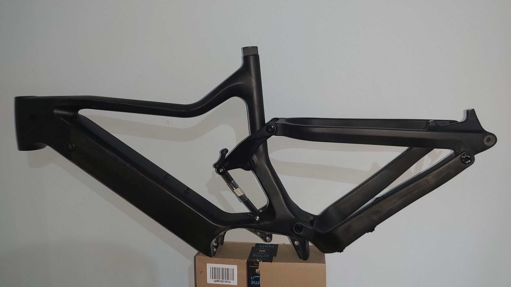

I've heard only positive things about Dengfu frames.
Beautiful frame Style, my opinion one of the best looking out there. Definitely good luck with that. It would be great if you can post photos throughout your build.
Haystacks
Dengfu for certain make high quality products, even if i didn't know they produce top branded frames i would have assumed so just from the carbon lay up and the finish.
Yes this frame is for a Bafang G510 which is the ultra, looking forward to testing this combo.
I'm considering doing a build thread here or maybe on emtb - emtb has lots of 'cheeb' builds going on at the moment (Dengfu E10) and this place has none, could be an interesting juxtaposition with the hydra though too; DIY vs Pre built (hydra is dengfu) Whatever happens i'll post some pics so folks can see the progress.

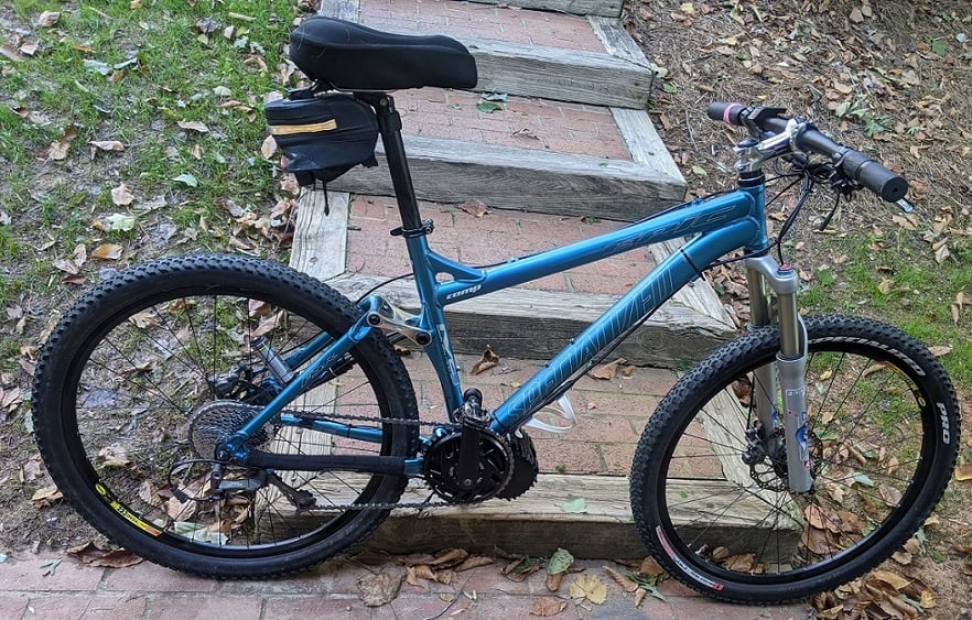

I went and took a different approach. Started this with the intent of going back door to a manufacture of a good bike in the hopes of buying a new "generic" emtb. To be honest I did not want to spend 4-8k on a new emtb. I spend the next couple of months carefully selecting a better donar bike compared to the super light cross country bike. I found an XT spec All Trail Mountain bike and I was able to adapt my exisitng BBSHD. I also replaced my huge 17ah batterh with one suited for about 20 miles or 2hrs of trail riding off road which weighs considerably less. Since early June I've clocked 300+ miles 3-4 days a week and been avg about 1.5 -2hrs per ride so far been rock solid. I have ripped off the throttle cable by a tree but that's been the only casualty.
Granted it's certainly not as integrated as I would have liked. So buying used bike and retrofitting a DIY kit is the option I went with. I did learn some lessons along the way and if your trail riding and install 30lbs of extra weight on a frame your better off going with an Enduro / Trail or All Mountain type bike as opposed to a cross country bike and make sure you have a STRAIGHT down tube. You dont really feel the extra weight as you have a motor to propel you. I looked for a long time and found a great deal on a very well specked Trail bike 160mm/160mm XT spec well with in my budget and installed a BBSHD kit with an 8ah 52v battery 27.5" wheels. I can easily hang with my emtb buddies and on the straights I can blow by them with throttle. There are some compromises thought. The cabling although ok on this bike it's certainly a detractor and an eye sore in my view, the motor does hang a bit two low and on certain stumps I have clearance issues, and the most important issue for me is the PAS is linear not dynamic like it is on my buddies Turbo Levo. That is so smooth. It really feels like you just have more power when you pedal it seems like the harder you pedal the more assistance you get. My BBSHD although assisted it's different, just spins based on the fact that your pedaling. The one HUGE positive I have over the retail type emtb's is the throttle assist. I use this all the time and works great if approaching a steep section where you just need a bump to get you over the tough sections. Anyway I'll probably wait till everyone just dumps there really expensive emtb's and just buy one of those at a fraction of the cost. until then I'll just enjoy and ride what I got.
Before and After pics.
