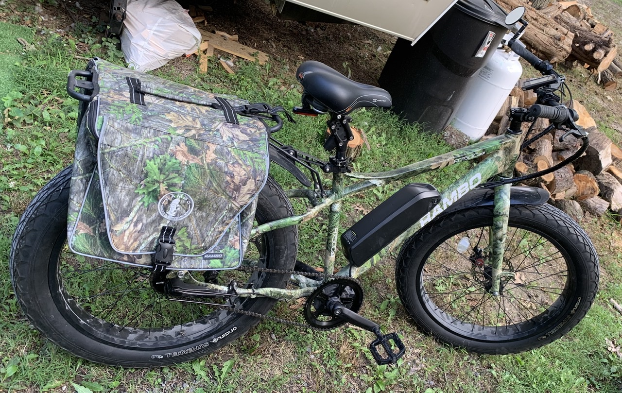

Hi folks,
I have a BBS02 based fat tire hunting bike that was originally geared “low and slow” for off-road riding and hauling game out of the woods. I made it more roadworthy by swapping out the 34t front sprocket first with a 46t then with a 52t sprocket. That worked to decrease the pedal cadence to one I could comfortably keep up with at road speeds, but with the 52t, it occasionally causes the BBS02 to overheat and temporarily cut out when riding up long hills. I’m worried about eventually burning it out.
I decided to upgrade the bike to a BBSHD motor, something I had planned to do eventually anyway. Luna says it’s direct swap - just remove the BBS02 motor, insert the BBSHD motor and an appropriate BBSHD front sprocket, and you’re set.
My BBSHD motor is coming next week. Based on an online gear calculator, I’ll be using the 46t front sprocket and replacing the 26t rear cog on the Sturmey Archer 3 speed IGH with a 20t cog.
Any input or recommendations from anyone who has ever made a similar swap? Or on assembling the BBSHD motor in place of the BBS02 in general? Things to watch out for, or to avoid?

Cant tell by your pic but you might need a chain tensioner if you don't already have one.
Thanks, but I think a chain tensioner is only needed with an IGH when the bike frame has vertical dropouts for the rear axle, and no way to adjust chain tension. Mine had an IGH from the factory so it has horizontal dropouts, and the chain is tensioned by moving the rear axle forward or backwards in the horizontal dropouts.

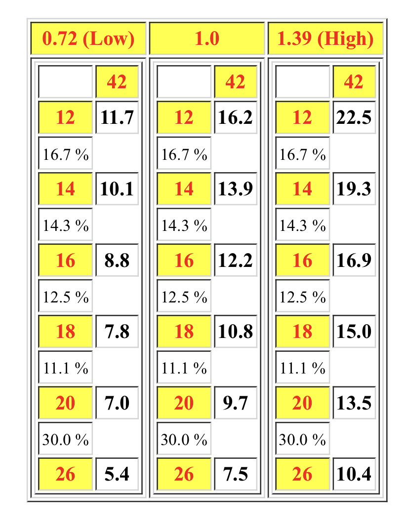

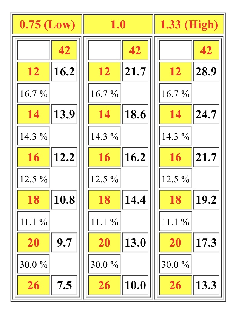

I re ran the numbers at the online gear calculator, and it seems the 20t won’t be quite small enough now for my needs. (I can’t keep up higher pedal rpms due to prior strokes and residual left leg weakness. I can do short spurts at higher pedal cadence but I can’t maintain it for long.) I’m considering 18t or 16t rear cogs so I can ride at round speeds of 14-16mph comfortably but at lower pedal rpms (60?)
Any thoughts on rear cog size with 42t front sprocket?
This is the rear cog options at 60rpm:
This is the rear cog options at 80rpm:

What was your old chainring size? Were you always using the 20t rear cog? Do you use throttle? What would you want your max top speed to be if using throttle?
I only use the throttle to get the bike rolling (due to my weak left leg.). I normally ride in PAS 1 & 2, with PAS 3 very rarely for big hills, and prefer to ride around 13-16mph.
Original rear cog was 26t and front sprocket was 34t. I couldn’t possibly keep up with the pedal cadence at road speeds, so I replaced the front sprocket with a 46t, then a 52t. Even with that, I’m pedaling too fast at 16-18mph to keep it up for long.
If I am using unlimited throttle, top speed could be as high as it’s safe, but its not a big concern as I’m not going to use it much. But I’m coming off multiple Honda Sport Touring and Adventure type motorcycles so no matter how fast it goes, it’s not much in comparison.
