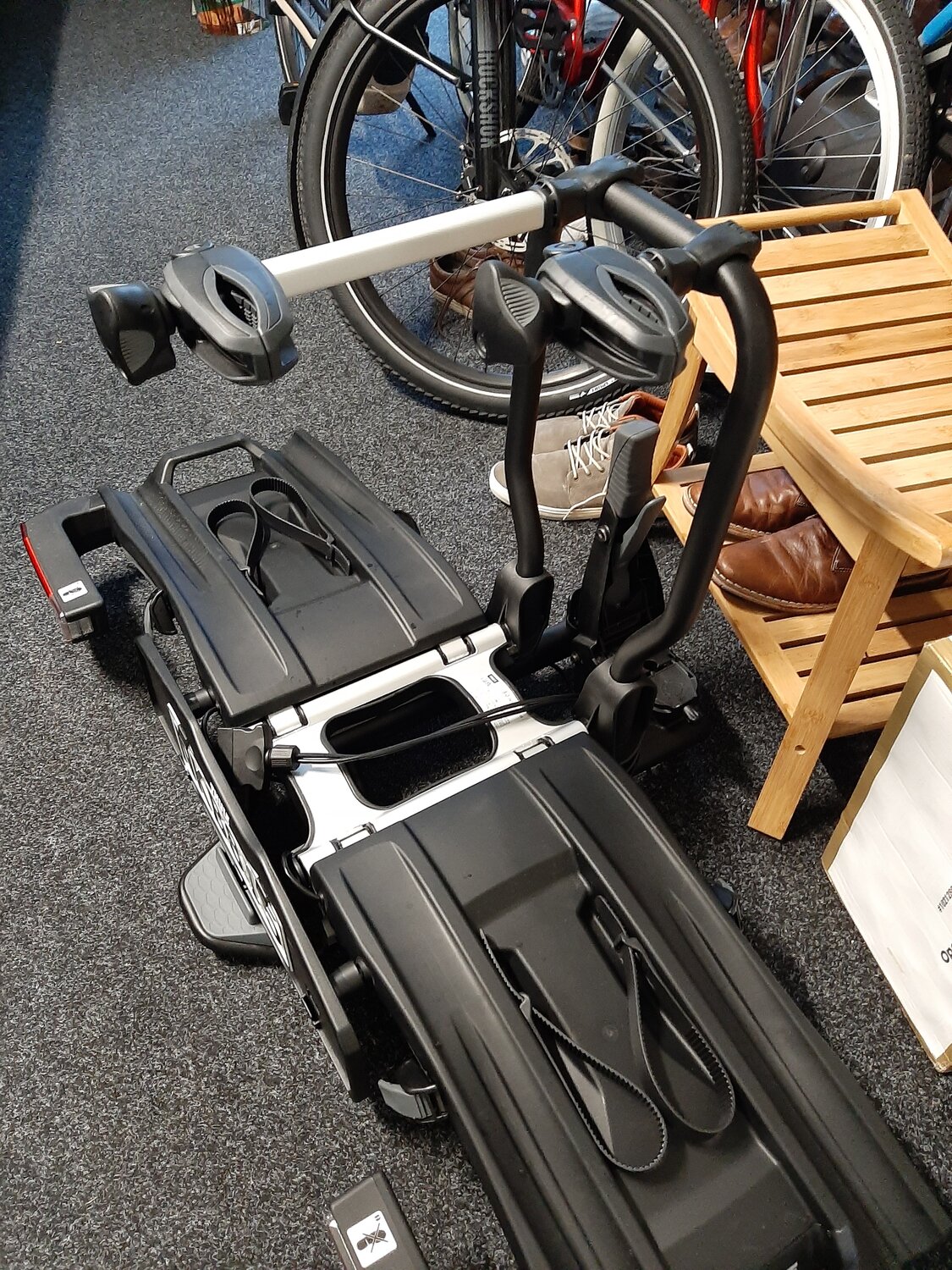

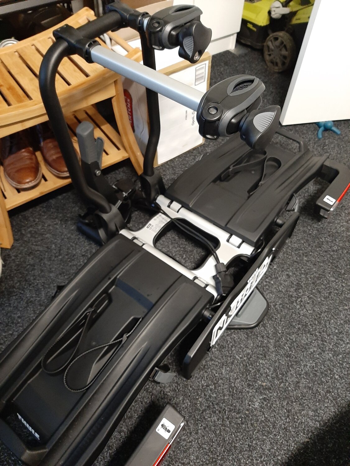

I have the Thurle Easy Fold and the support bar can be moved into any position to suit your bike - I have a Como 5 and the support bar locks very easily on the seat tube.

Very good info, thanks Tim. Do you know if carrying 2 bikes on the Easy Fold, the geometry will allow both to attach to the seat tube?

Hi John - I haven't put 2 bikes on my Easy Fold tray, but as it has two separate support bars and both can be set in different positions on the rail independently then I don't see why you shouldn't be able to support both bikes attached to their seat posts. You probably have to go nose to tail so that the two support bars are separate from each other. I have unfolded my Easyfold and took some photos for you. The support bars can be moved anywhere along the back rail to suit your bikes. I have tried to position the support bars in the photos to give you an idea of what i think would work. The longer bar is set up for my Como on the outer position and attaches to the seat seat tube. Hope this helps. The Thule EasyFold is very well made and a clever design, and easy to pick up and store.

Hi John - Extra info - the two grips that hold the bike seat tube can be swung around 360 degrees into any position, and the end knobs are keyed so they can be locked once the bikes are in position and grips are tight.

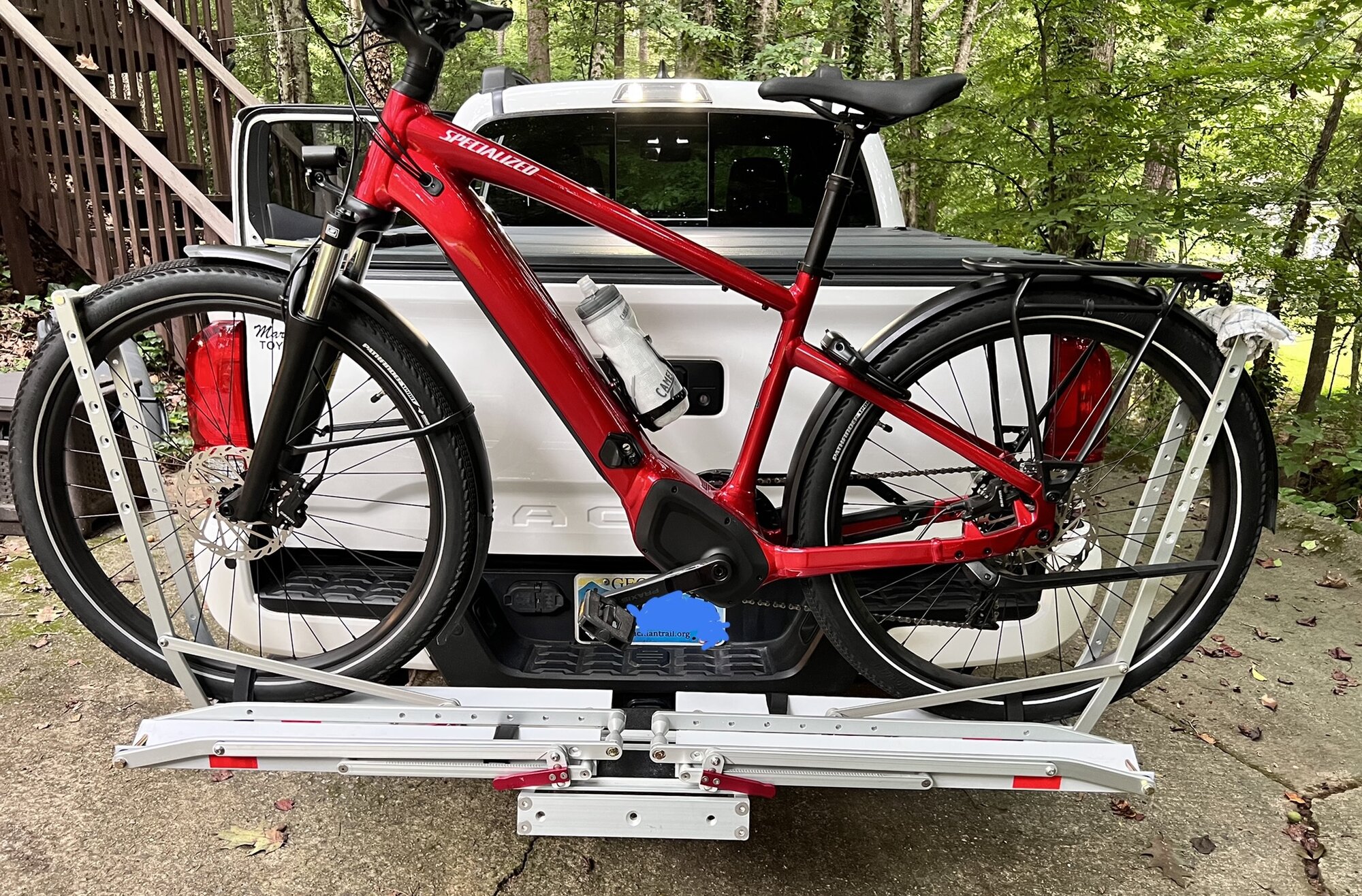

Okay, back home today so I had a chance to try out the wheel stop that's on my wife's 1UP rack. It works decently well with her Verve+ 2 though we still set up a spool to meet the rear tire - rear fender doesn't come down as far as on the Vado.
My 2022 Vado 4.0 in Medium with 1186mm (46.7") wheel base and stock 650Bx2.3 tires hangs off the end a good bit if using the wheel stop.
I wouldn't buy it unless you were to want it for another bike with smaller wheelbase.

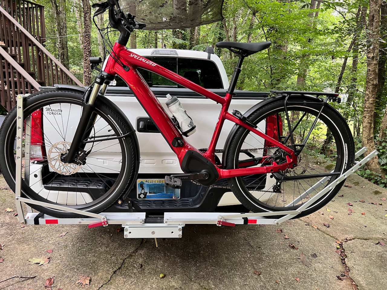

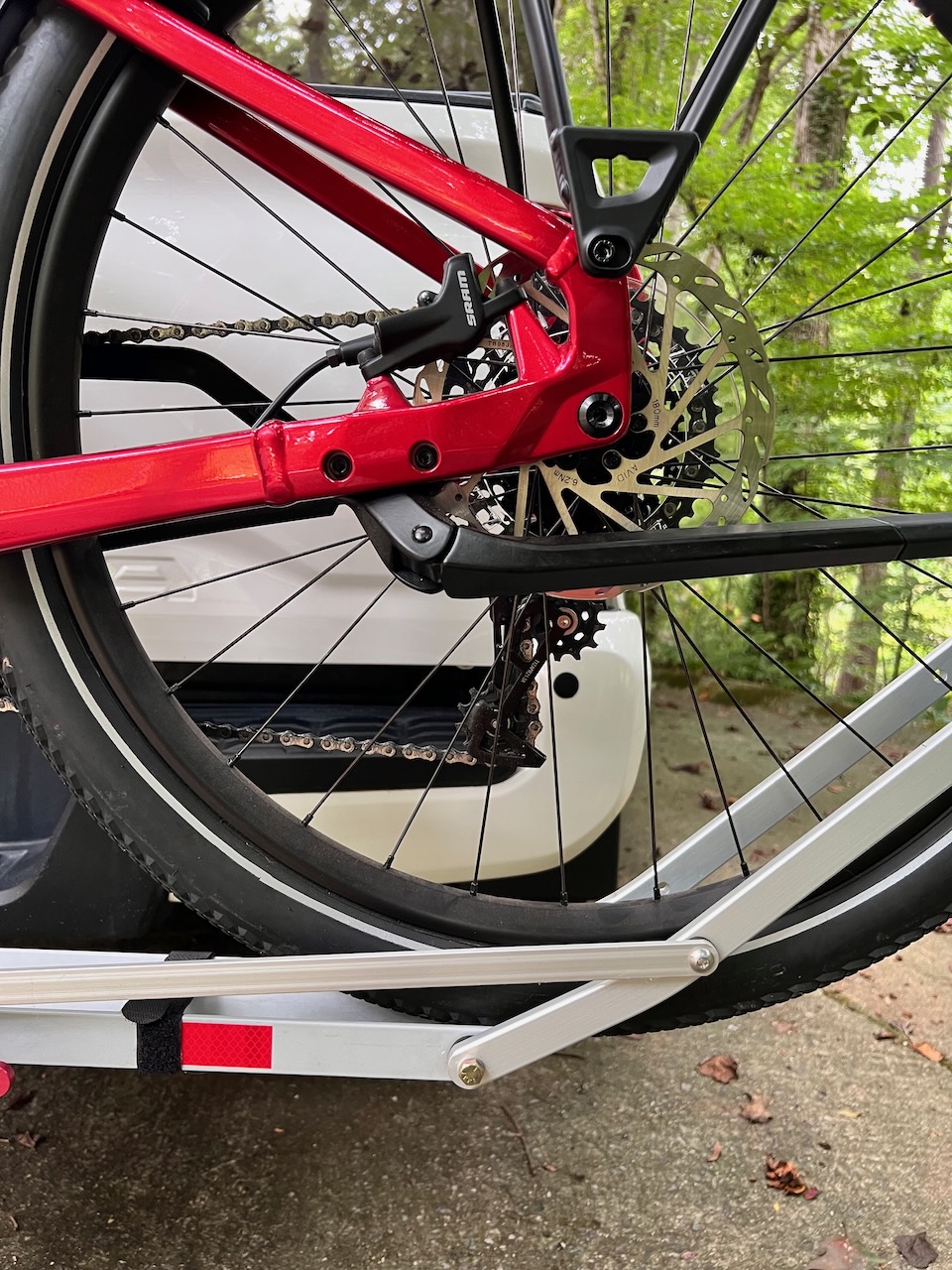

@Nubnub yeah, the wheelstop sits fairly low.
Here’s my rack without wheel stop and both spools at the end spot. I wrapped a towel around the rear spool and there’s minimal pressure on the fender. Bit of pipe insulation would work well, or a piece of a pool noodle. Both wheels are cinch strapped to the trays. (Note I have an AddOn installed.)
So you should be more than fine with your Tero. 😎
Honestly I dislike the long rubber extension on the Vado front fender and may remove it or it and the fender. I’m also planning to bob the rear fender - I’d co sided removing the whole thing if I had a good plan for a rack stay and routing the tail light wiring.
