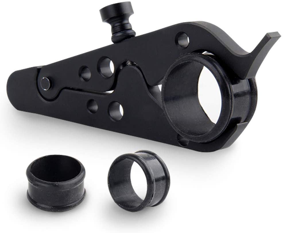

This device:
It isn't true cruise control since it doesn't compensate for changes in slope, wind, riding surface etc. It works well on most rail trails though.

This device:
Do you think it will fit most ebikes that have a lever throttle?
