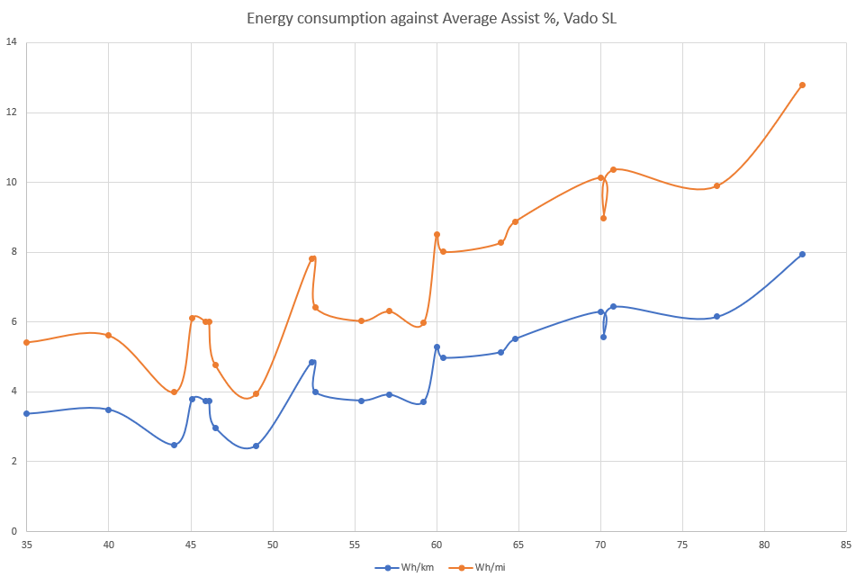

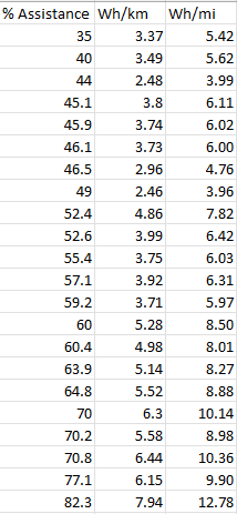

Very interesting subject! And very hard to quantitatize. It is because riding a lightweight mid-drive motor e-bike is non-linear, and it depends on factors of your own power input or winds on a given day. Also, even if my area is pretty flat, I cannot tell you anything about the effect of elevation gain: as very small hills tend to accumulate on long rides even in the plains. Here's my data collection for Vado SL:
Note that the only dependent parameter that makes sense is the energy consumption per distance unit.
Non-linear, and hard to get a consistent data set. No data for very high assistance level.
Now, let us assume you could get the energy consumption at 10 Wh/mi for 70% assistance (I mean, 70/70% as it is how I set up my Vado SL: the same Max Motor Power as Support %). With the 320 Wh battery that would make 32 miles, with one extra extender that would be 48 miles, and it would be 64 miles with two range extenders. All with the assumption there are no significant hills on your way.
Now, I could make 72 miles on the main battery + a single RE. Yes but that was at 55% of average assistance, and the average speed was only 12.7 mph for that ride!

Could you say a few words about your axis? I don't know what WH/KM and Wh/mi means. That would better help me to understand your graph.
It is watt-hours per kilometre or per mile. It is how much of energy is consumed on average from your batteries on the ride. If you ride on the main battery only, your battery capacity is 320 Wh, and each Range Extender adds 160 watt-hours. When you know how much of energy you have for your Vado SL, just divide the total capacity of the batteries by the consumption factor Wh/mi and you can estimate for how many miles you could ride.
Generally, assistance levels below and up to 50% give you long range at the cost of low average speed. Increase the assistance to 70% and you will see the range dramatically drop. Go for 100% Turbo, and you will notice the range has become ridiculous. It is because the faster you ride, the more energy is used but it is not linear! It is the third power (cube)! Meaning: need long range, ride slowly :)
