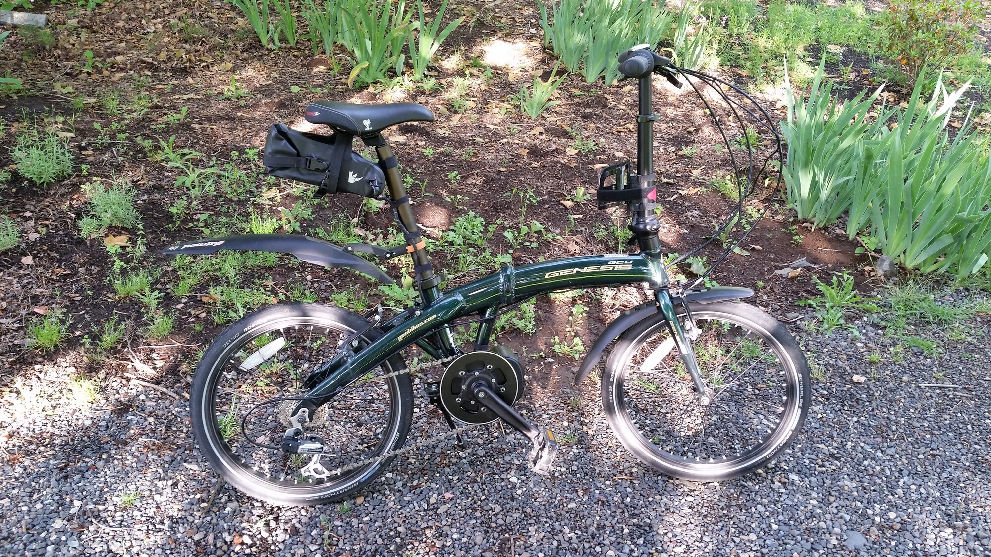

This is the 4th bike this TSDZ2 has been installed on. 1st was a Dahon Jack 26" folder for testing purposes only, 2nd on my wife's Dahon Briza 24" folder which she doesn't ride anymore, 3rd was on a Cadillac Fleetwood beach cruiser type bike with a Nuvinci N360 hub - taken off that bike because the rear roller brake along with a front side pull brake were totally inadequate for where I ride. I've had this Walmart Genesis 20" folder for several years, bought it to leave in my car and ride after work but before getting home. For a $200 bike it is as good looking as a Dahon and rides nice despite the obviously cheap components. Used to ride it in pitch dark wearing a headlamp with coyotes and deer keeping me company on the trail. It's been sitting unused for a few years and since the motor was coming off of the Cadillac anyway I figured might as well give it a try, it's easy so why not. Took only ~10 minutes to take the motor off of the Cadillac. I had to do a little work on the Genesis for the motor to fit. Removed a standoff on the bottom bracket with an angle grinder and cutting disc where a folding stand was attached and there was a catch in the bottom bracket that needed a little trimming with a rotary file, then it slipped right in. Bike needed some general cleaning up and the rear axle bearings were a little loose so I cleaned re-lubed and adjusted the bearings - they had been very well lubricated from the factory. Weather permitting I'll take it for a spin tomorrow on my usual 22-25 mile hilly loop. I'm thinking with small 20" wheels it should do well on long steep grades. Will see if this is the Tongsheng's final landing spot, I'm running out of bikes to try it on.

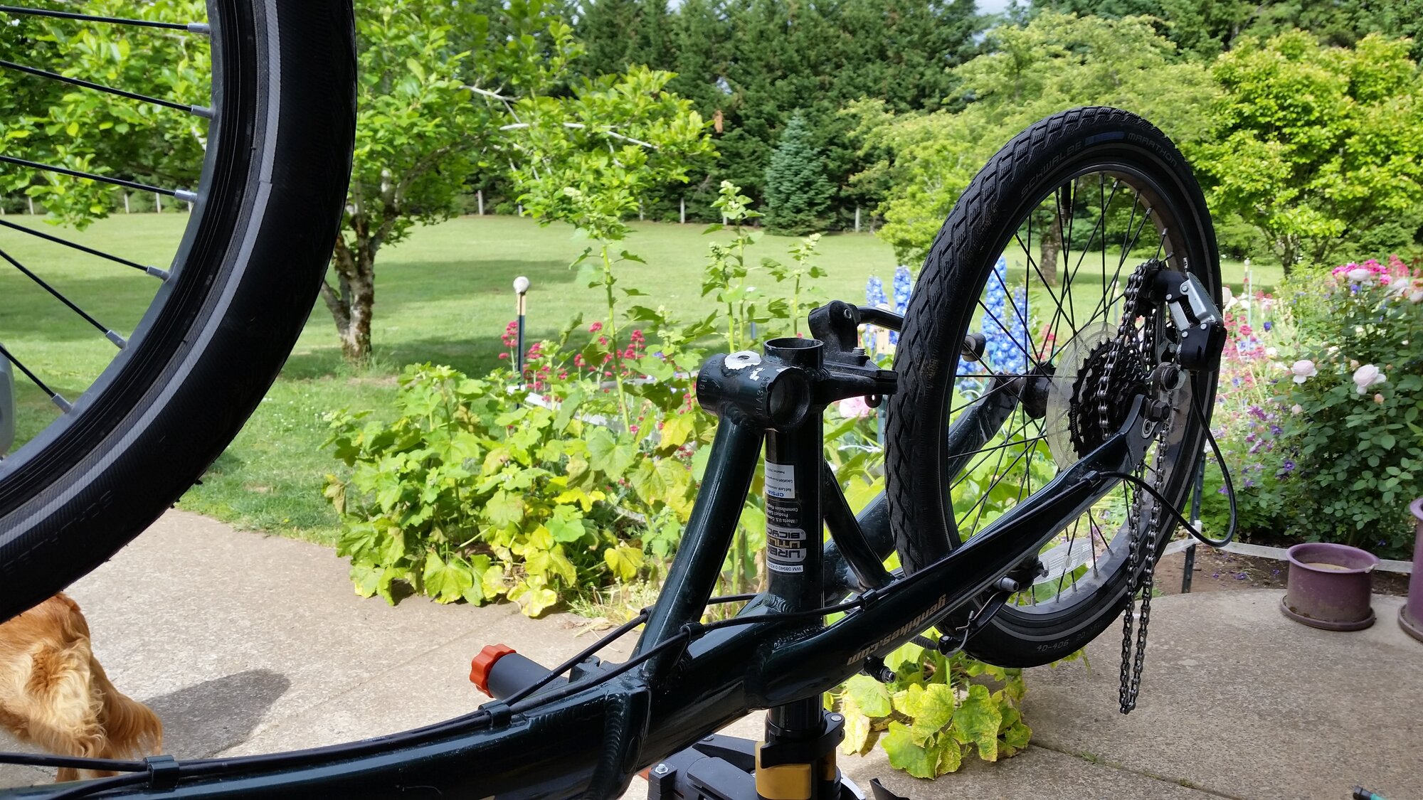

Here it is on the stand this morning, weighs ~26 pounds before the crank assembly was removed.

I've finished doing what I am going to do with this bike. Changed from 6 speed 14-28 freewheel to 7 speed 11-28 DNP along with 7 speed shifter to match. 36v 10ah battery in seat post bag. I'll reserve judgement until after doing some longer rides but it is much more comfortable with the original handlebars and the WTB seat that I found in a parts bin.

Very interesting. Do you know what the Genesis weighs with motor and battery? The battery is in the seat pack. Correct?
EMGX
Correct, the battery is in the seat post/seat pack bag. I put it on a hanging scale and it weighed a disappointing 40 pounds. It could drop a few pounds without the fenders (which are fairly heavy although I didn't weigh them), the water bottle holder and with lighter pedals (these pedals are from my Cadillac bike and are heavy), but this is the way I'm going to ride it - plus carrying a pump/spare tube/bike multitool in a handlebar bag that will add additional weight.

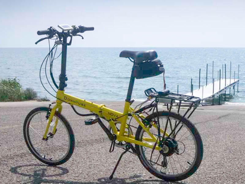

Here's my favorite little 20" folder. I believe it comes in around 36 pounds. Using a 250W AKM100 motor in the rear and a 25A KT controller, reprogrammed for 20A. Using a 36V4AH hoverboard pack in this pic. Wore out my DNP 11-34 at 3100 miles. My wife's folder wore out her DNP a half year later when her bike crossed 3100 miles. It's like a time bomb.
