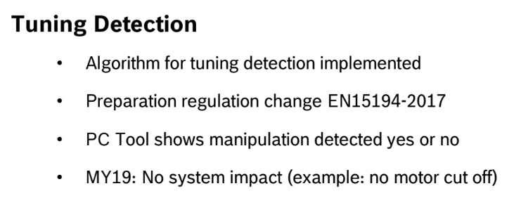

So apparently Bosch is going to detect speed tuning soon... no action so far, just detection.

Seems this would be a software change so if current owners never had their software updated it wouldn't impact them, imho.
Dmitri
Yeah. That's good to know. Then again I've got my Nyon self-updating.
I mean, you can see where it's heading, right? The system will detect manipulation and kill the motor.
Velome
Yes, I certainly could, but I don't see how they could detect my badass device unless they changed the sensor somehow.
Dmitri
Umm, your Badass device is the easiest device to detect because it only works from 17kph upwards. So if the software sees an abrupt jump from 17kph to, say, 9kph, they know that you're manipulating things.
Of course, BadassBox will be updated to just 'divide by two' in all cases. But don't forget that the other part of the change that's coming is a secondary speed sensor (instead of cadence sensor). This speed sensor is required for the ABS module, and I suspect it's housed inside the brake rotor. For now, this entire setup is very Magura-specific, but I wouldn't put it past Bosch to just have 2 speed sensors for consistency. And then no BadassBox will help you.
Velome
Yes, you are exactly correct about the detection of the speed change. I thought about that after I posted. Thanks for the correction and elaboration on 2 speed sensors!

I'm guessing that Bosch will leave it up to the dealer and regional service provider to sort out any issues that they believe were caused by tuning.

And the thing I wonder about is, will this detection still work if its just impacting the sensors like the badassbox?
