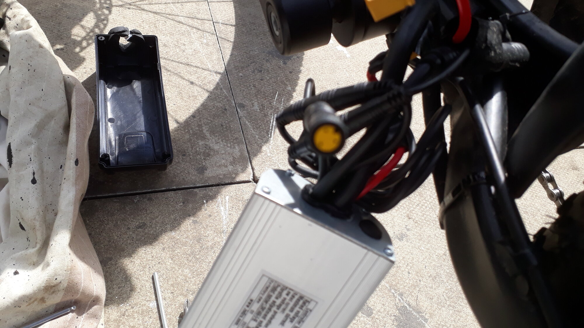

Hi all, i would if someone could tell me what is this yellow connector for, sorry about the blurry pic?.

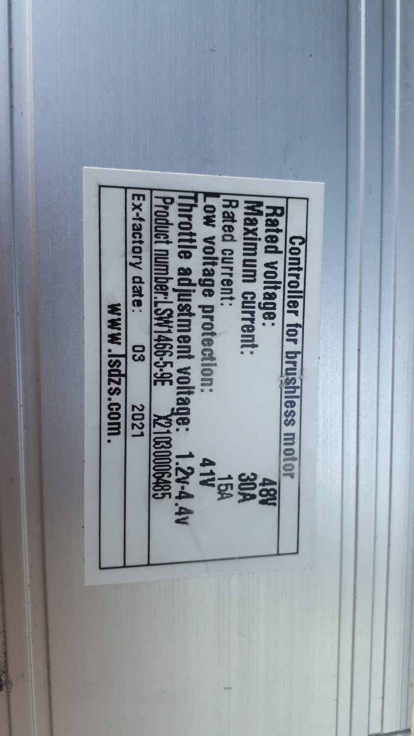

Have also sent a pic of the controller.

It's a Julet or Higo 3 pin connector sometimes used to connect PAS, throttle or other 2 / 3 wire accessory. If your bike already has both, try contacting the bike maker.
Clyde
Hi thanks for your reply. Could i run lights of this connector?
No. It's a throttle or brake cut-off. You're better off running a buck converter off of the battery, anyway, as the 5v provided by most controllers won't power much of a light.
Thanks Clyde
