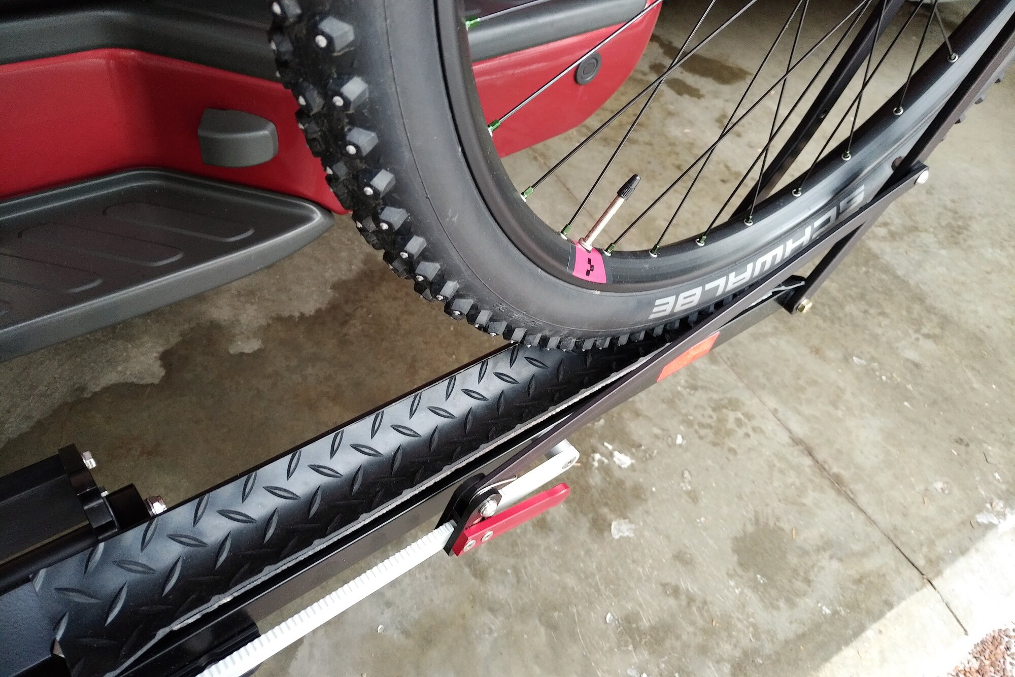

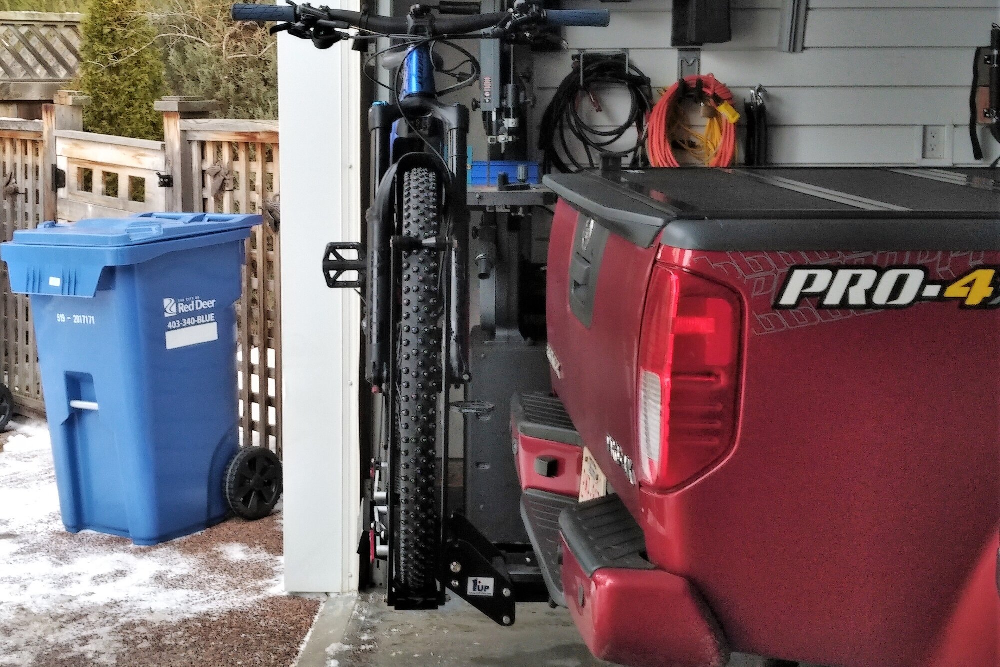

The keyed wheel locks are just one of the features I like about 1Up. I find about half the time I only need one tray for my emtb so having the lighter SD single is easier when it comes to installing and removing the rack. If I’m hauling two bikes, attaching the add-on only takes a couple of minutes. I also acquired the fat tire spacer kit.
For winter transport, I fabricated tray inserts made from heat molded acrylic and glued strips of HD rubber mat to protect the powder coat from being scraped up by the studded tires.
