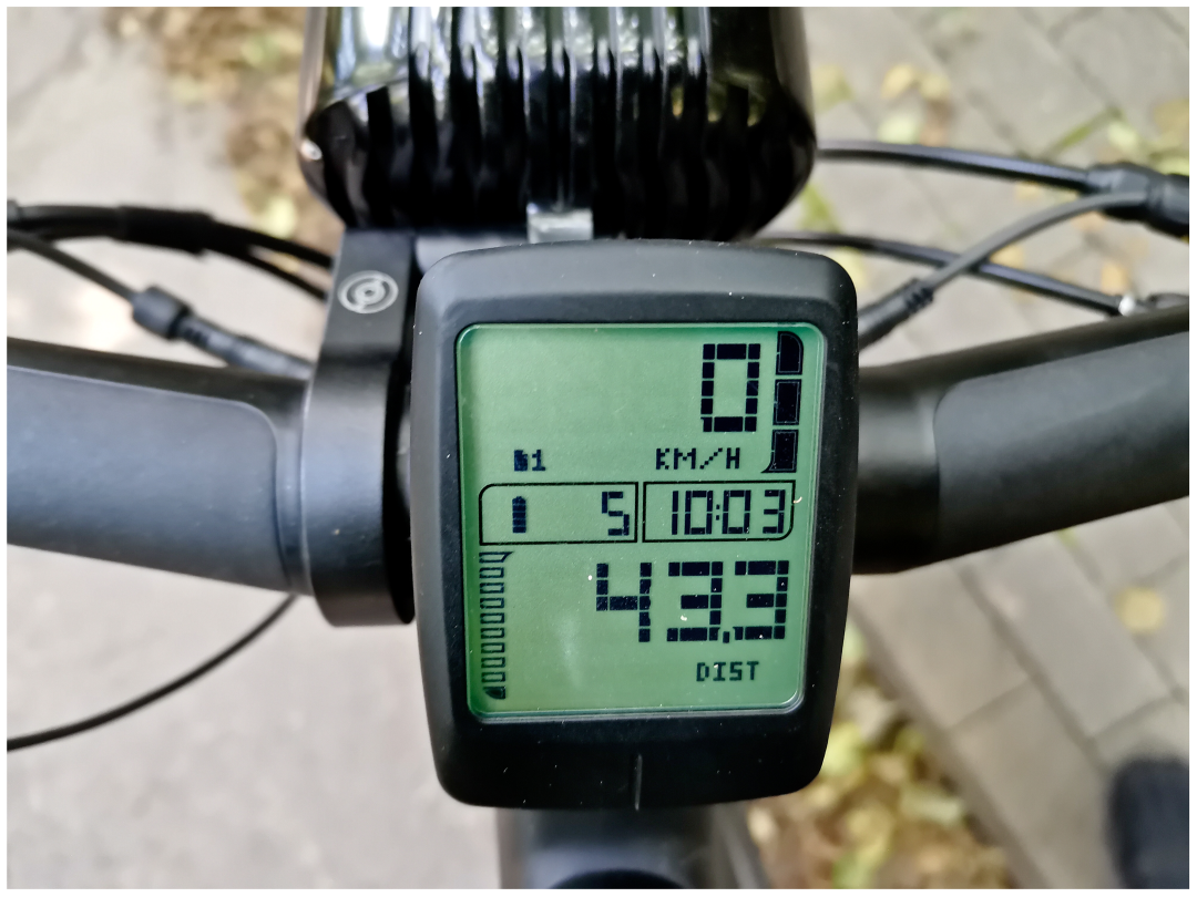

Here is the outcome (the distance is in kilometres):
So, the range of Vado 5.0 (Class 3) ridden in Turbo Mode only, with the UI-600 battery, in the flatland, tarmac, with a 200 lb rider, almost no stops, moderate wind (cancelled by riding a loop), summertime, is 43.3 km or 27 mi. Any deviation from these parameters such as heavier rider, any significant hills, strong headwind, cold temperature, frequent city stops, harder terrain, etc., will adversely affect the range.
Note: The test was conducted between 100% and 5% of battery charge. Below 5%, the bike goes into a standard Eco Mode until 3% is reached and no more pedal assistance is provided.

It is the 1.2s, the 72 Nm torque, 520 W max power (Brose TF) motor optimized for fast riding. The Turbo mode ride was too pleasant! No effort at all. I rode the first 20 km without even stopping (except of the junctions) and against cold headwind. I guess if I were commuting to work, I would be fresh after the ride. It was as if I rode a motorcycle!

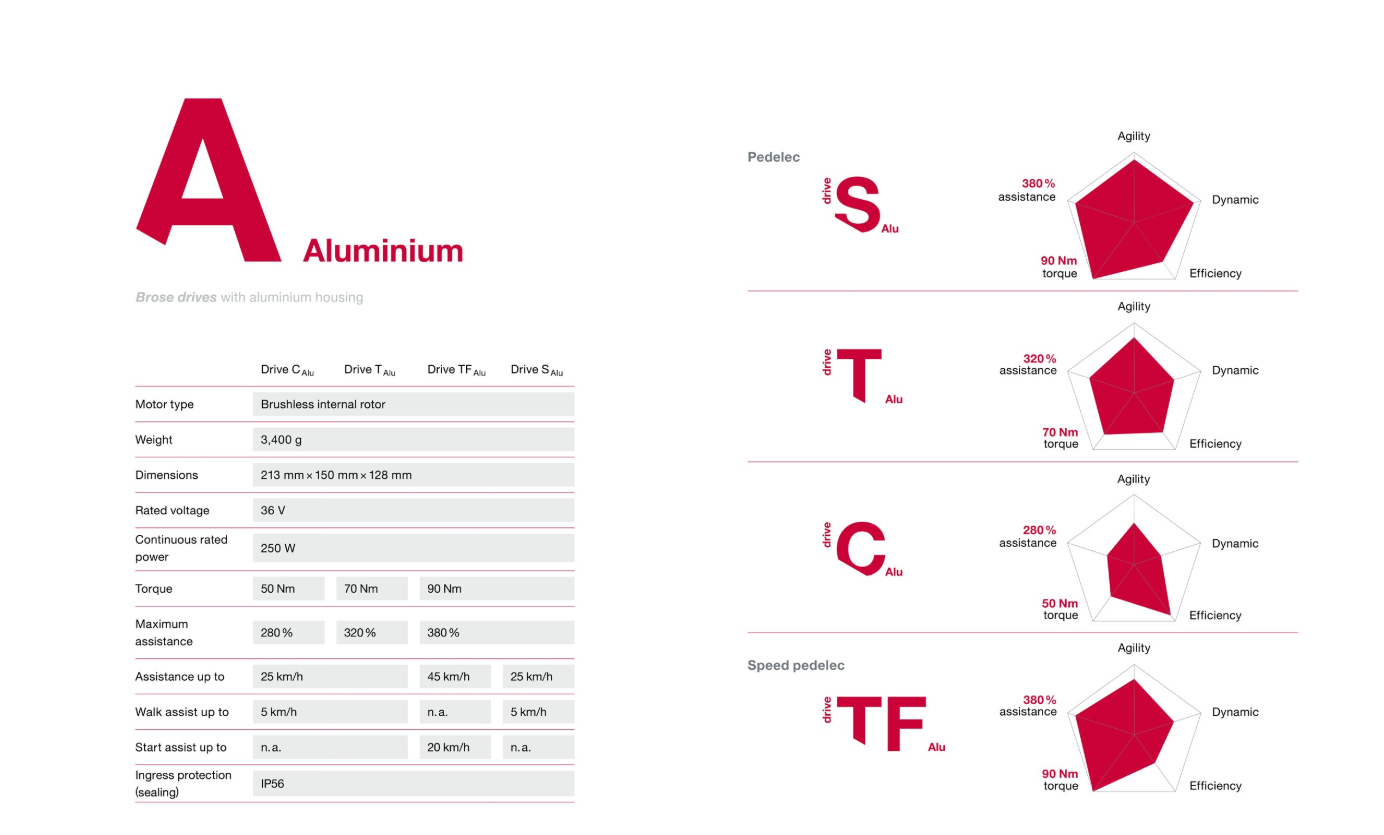

It is exactly the 1.2, or Brose T motor. Here is the listing of all Brose e-bike motors with Specialized code-names:
Brose Motor NameSpecialized motor code-nameFound in Turbo e-bike modelPurpose (as declared by Brose)Max Power [W]Assist %Torque [Nm]
C (alu)1.2eVado 3.0Low-speed city bikes, efficiency-priority, Walk assist.41528050
T (alu)1.2Vado 4.0Trekking bikes, less efficient than the C model. Walk Assist52032070 (or 72 or 85 depending on the data source)
TF (alu)1.2sVado 6.0 (EU only)Speed commuter e-bikes, low efficiency. Extra start assist up to 20 km/h. No Walk assist.52032085
S (alu)
(There is a confusion as it presumably is both MTB and Speed motor, depending on tuning)
1.3Vado 5.0MTB & Speed e-bikes, better efficiency than TF. Walk Assist.55038090
S (mag)2.1Levo (since 2019)MTB, lightweight56038090
The information found in different sources differs very much. I suspect the 1.2 motor has more torque than 70 or 72 Nm, with the 85 Nm figure which I saw in some Brose chart presented once by @PaD.
Note: Actual power drawn from the battery differs from the delivered motor power. Once, my Vado with the 1.2s motor must have produced the 520 W power when I was mashing uphill in Turbo mode. Mission Control -> Diagnostics -> Battery reported 18 A current at 37 V (666 W). Efficiency = 520 / 666 = 0.78 or 78%.
C (alu)1.2eVado 3.0Low-speed city bikes, efficiency-priority, Walk assist.no guess28050
TF (alu)1.2sVado 6.0 (EU only)Speed commuter e-bikes, low efficiency. Extra start assist up to 20 km/h. No Walk assist.52038090
S (alu)
Happy birthday Stefan and enjoy your year before being invited to the club of old sacks (by me).
The Brose T (1.2) in the Vado 4.0 came out originally with 85 Nm. After complaints about reach the range the torque was reduced by software to gain more efficiency.
Guess why I didn't have firmware-updates made since spring 19.

max. power for the 1.2e ist 415W, according to the source I had linked here:
Stefan Mikes
Europe
Brwinów (PL)
@TS25,
This table gives even more confusing data, especially for the TF motor. Source:
Papa G
@TS25,
Thanks Stephan and TS25: A lot to digest here. Glad to confirm the 2020 Vado 4.0 has the Stronger 1.2 motor, not the 1.2e. If the motor hardware is the same, wonder if my 1.2 motor could be reprogrammed to the higher 85nm of the 1.2S? I’d consider getting a 604 watt battery if the torque could be increased, and keep the 504 watt battery as a reserve for longer rides.
