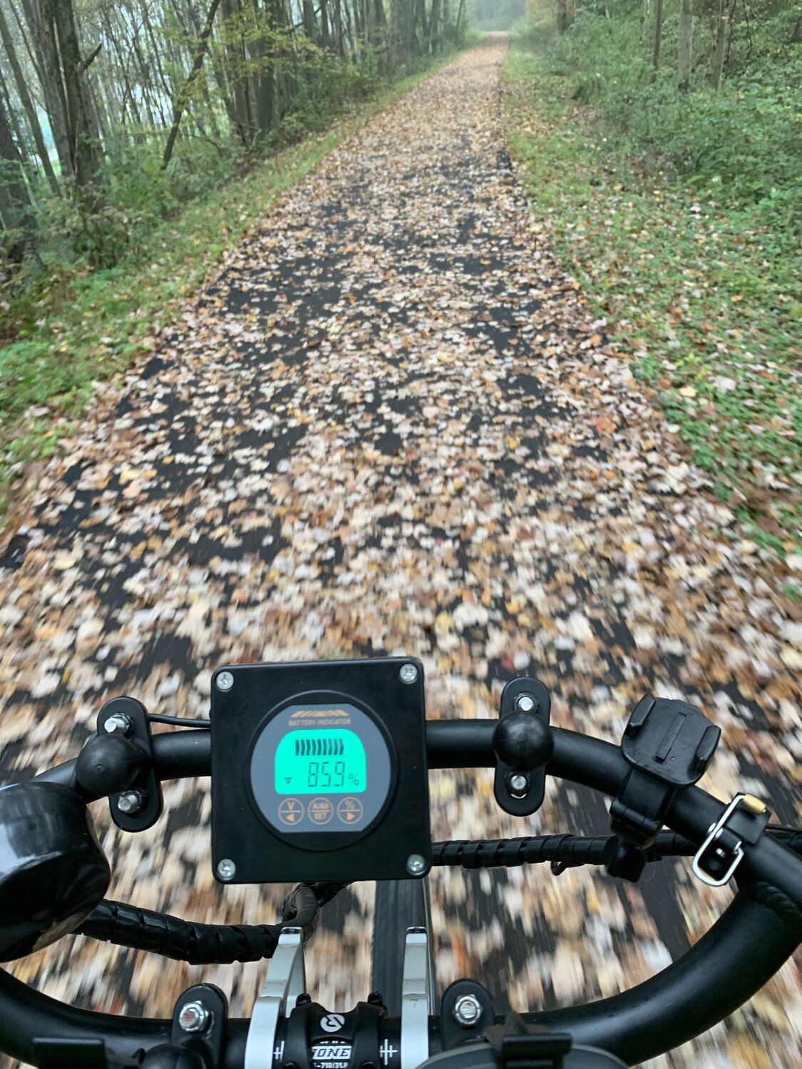

I want to burn off some Holiday calories and I have a question. As an older rider, I worry about riding on bike trails that go through forests as wet leaves are pretty slippery. I used to do this all the time when I was in my twenties and thirties, and took several nasty spills, but as I approach seventy, I don't want to go down hard (or go down at all) on wet leaves or black ice. Two of my favorite trails, The Susquehanna River Trail (Columbia, PA to Bainbridge, PA) and the C&D Canal route (between Chesapeake City, Maryland and Delaware City, Delaware) both run through forests for part of the way. (especially The Susquehanna River Trail) Does anybody know if the crews that maintain these fine trails remove the leaves from trail surfaces? If not, do any of you have any tips for negotiating leave covered surfaces (possibly frozen leaves) in winter time?

I rode the paved & leaf covered Rail 66 trail in western PA last month. It was like ice in spots
In addition to being slick, it was hard to see the edge of the pavement. There is a considerable lip which can cause a spill if you drop off. I passed a woman who did just that. Luckily, she wasn't hurt and there was no serious bike damage. I talked with her a bit until she calmed down and was able to continue.
At one point, I passed an ATV towing a small trailer with a gas powered blower mounted on it. He told me he cleans the leaves off the 30 mile long trail several times each fall.
Maintenance crews do the same thing on the paved Western Maryland Rail Trail. They have a blower mounted on the back of a large tractor to do the job.
I have never seen any leaf removal done on the C&O Canal Trail though and it can be treacherous in places.
