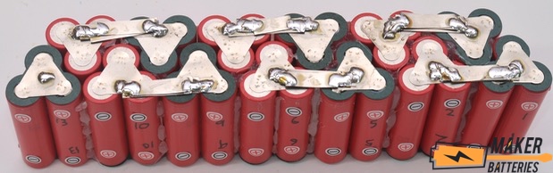

The parallel slab (6p) version of these batteries would be very easy to assemble. The idea is to eliminate the need for a spot welder. The big power pack is 1 kWh, and that is a lot of power for 7 pounds or so.

Soldering balance leads should be done prior to spot welding if DIY. It can be done well but with power leads in particular the heat can be damaging, even if the defect doesn't appear until months later I've found the cells exposed to increased heat to be most likely to fail. I wouldn't expect novices with a soldering iron to build a battery I'd trust but nickel does solder quite well-- I still prefer to avoid even balance wires unless pre-tapped. Many cell suppliers will pre-weld groups in nearly any config you like for a few pennies per cell.

Oh and it's perfectly fine to solder on the nickel strips attached to the cells, provided you do it correctly and don't hang out on the cells for long periods of time. Every professionally built 18650 pack has the wires soldered to the nickel strip. Here are instructions I've written to show people the proper way to build these packs: http://www.diybatteries.com/2016/10/22/how-to-build-a-48v-10ah-battery-with-maker-batteries/
as well as video instructions that show the proper way to solder them here:

Hi Micah. Good to hear from you. I'm sorry if you felt anything I said was "misinformation". I did say that you took the planning and guesswork out of it but I think your target audience might be folks who don't really have the knowledge to properly build a pack and for these people a professionally built pack is a much safer option at a marginal markup in price. Comparing price/quality with the em3ev in that video the results should speak for themselves as you get what you pay for:
Your advice is well given and presented in the video but correct me if I'm wrong that every cell manufacturer says not to solder their cells. To quote: "Don’t solder the battery directly. Excessive heating may cause deformation of the battery components such as the gasket, which may lead to the battery swelling, leakage, explosion, or ignition." I counted 5-8 seconds of heat for each series connection and I assume you're more adept and experienced than your likely buyers who may take a little longer to construct. Excluding pre-tinning that is 20-30 seconds of heat applied in ~40-60 seconds time. Particularly the positive terminals are prone to heat-induced damage as the 400-600°F heat can easily boil the electrolyte and damage the cells (again, even if the defect isn't apparent until later). Solder has poor electrical conductivity as well though I don't fault this too much. If you believe a 3P GA cell to be well suited to 30A continuous I wish you luck, but you won't be winning me or anyone who knows this stuff over with assertions that novices soldering their own lithium batteries is perfectly fine. There are other issues with your "idea" but I wish you well all the same.

There are recommendations and then there's real world use. Believe me, there are all kinds of builds where solder has been used and used successfully. This will never be a main stream product but for those of us who have experimented, there has been much success.

I understand how a BMS works, and how to build a battery. I don't see an issue with my soldering onto a nickel strip. The above is 350 watt-hrs if their 7AH rating is true. Micah has a comparable package at 360 watt-hrs, 36 Volt 10AH 10S-3P, at about the same price. I would need a better price on the kit to consider making one.
