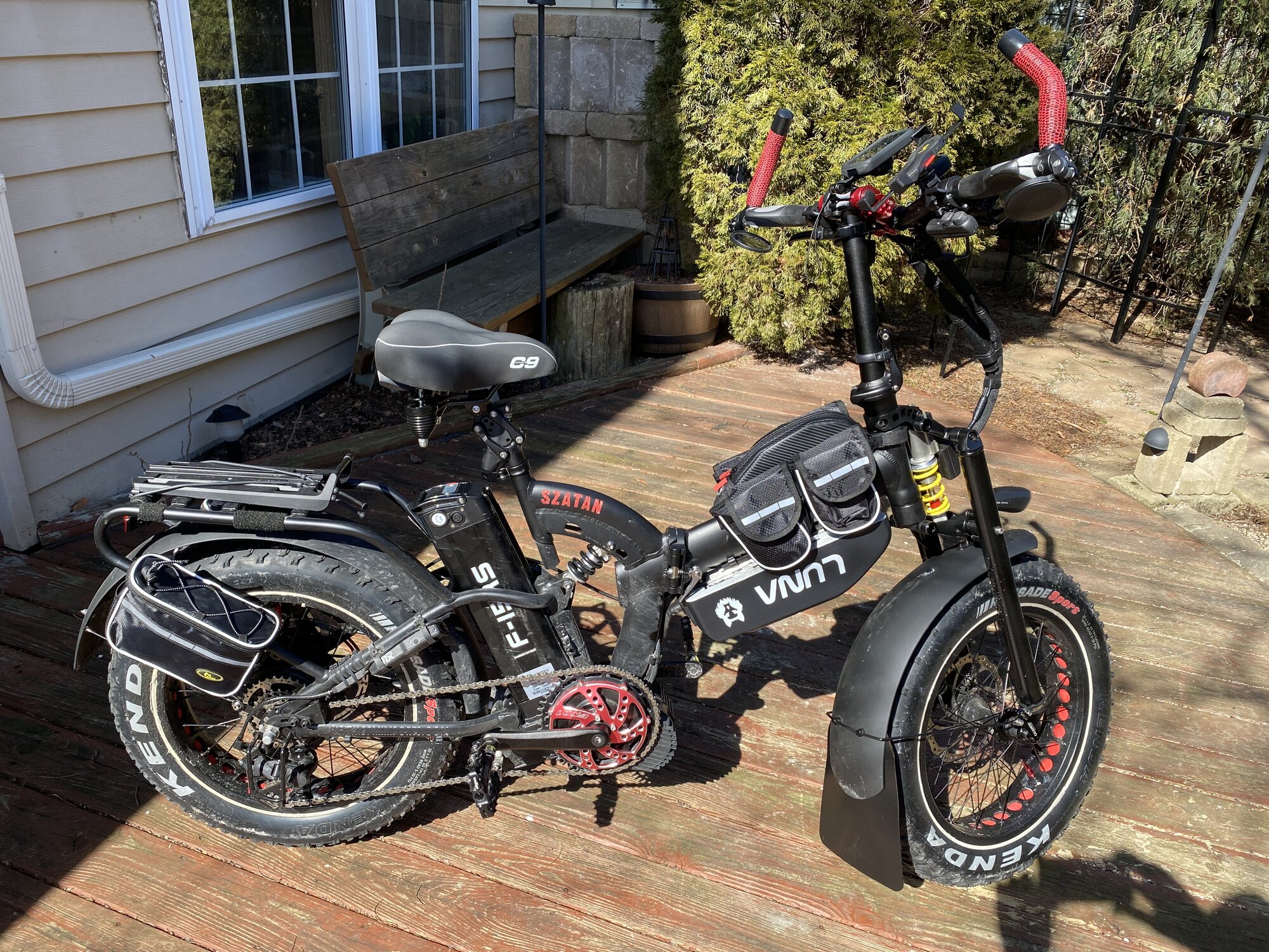

Well, you right but good you asked why. I like to tinker with things and modify it even if it is not necessary just because it is fun. My second bike has 2 motors, rear hub 1000 W and BBSHD mid motor with Luna ridiculous controller and it is blast. Although I still want to change cheap Chinese 15 A controller to Phaserunner just to push hub motor little further
Ebiker33
Well, you right but good you asked why. I like to tinker with things and modify it even if it is not necessary just because it is fun. My second bike has 2 motors, rear hub 1000 W and BBSHD mid motor with Luna ridiculous controller and it is blast. Although I still want to change cheap Chinese 15 A controller to Phaserunner just to push hub motor little further View attachment 62401
That Ebike looks very comfortable to ride; dual suspension, fatty wheels, with a suspension seat post and a spring loaded large gel seat, very little road vibration must be reaching your body with that set up.
