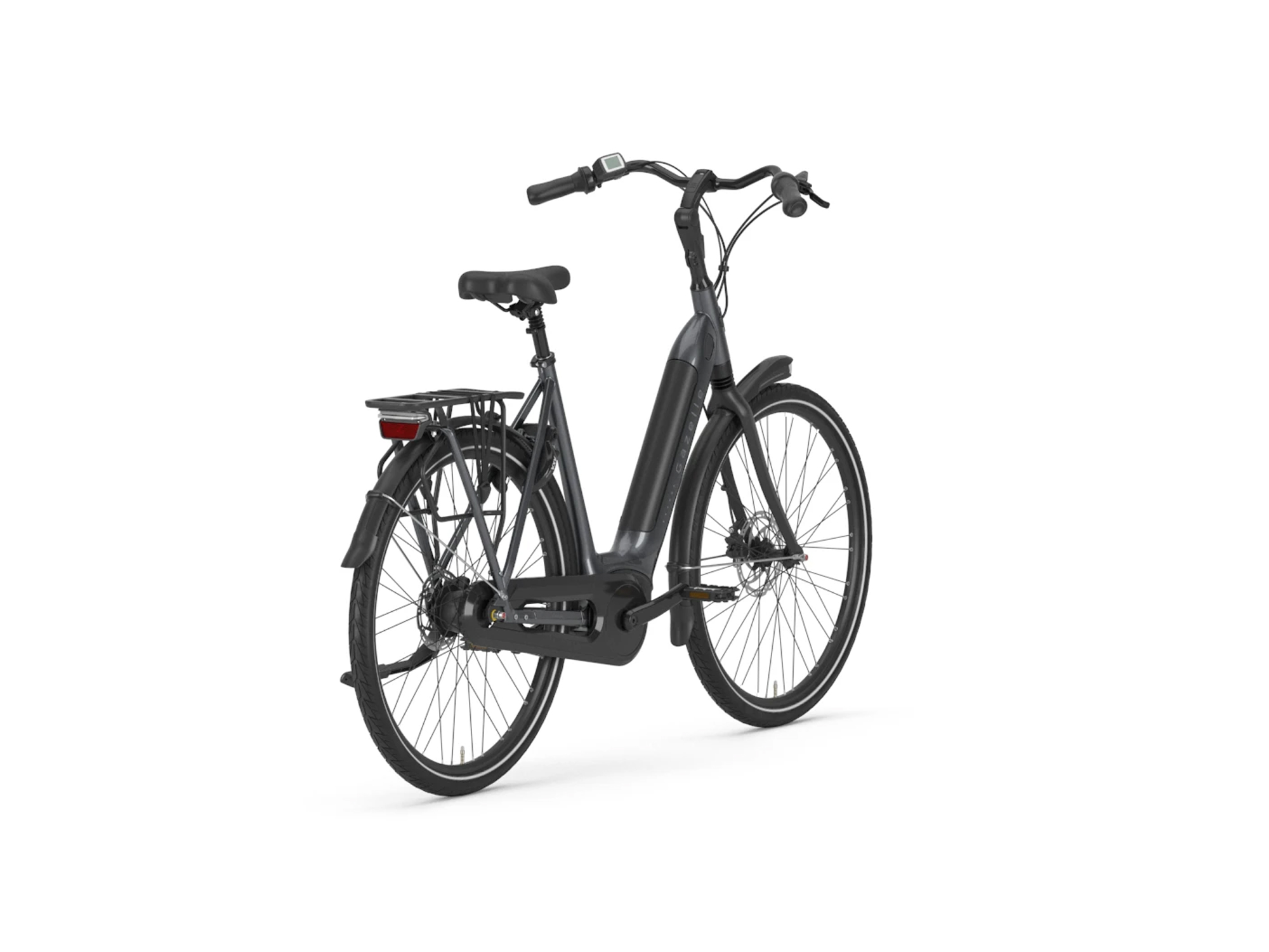

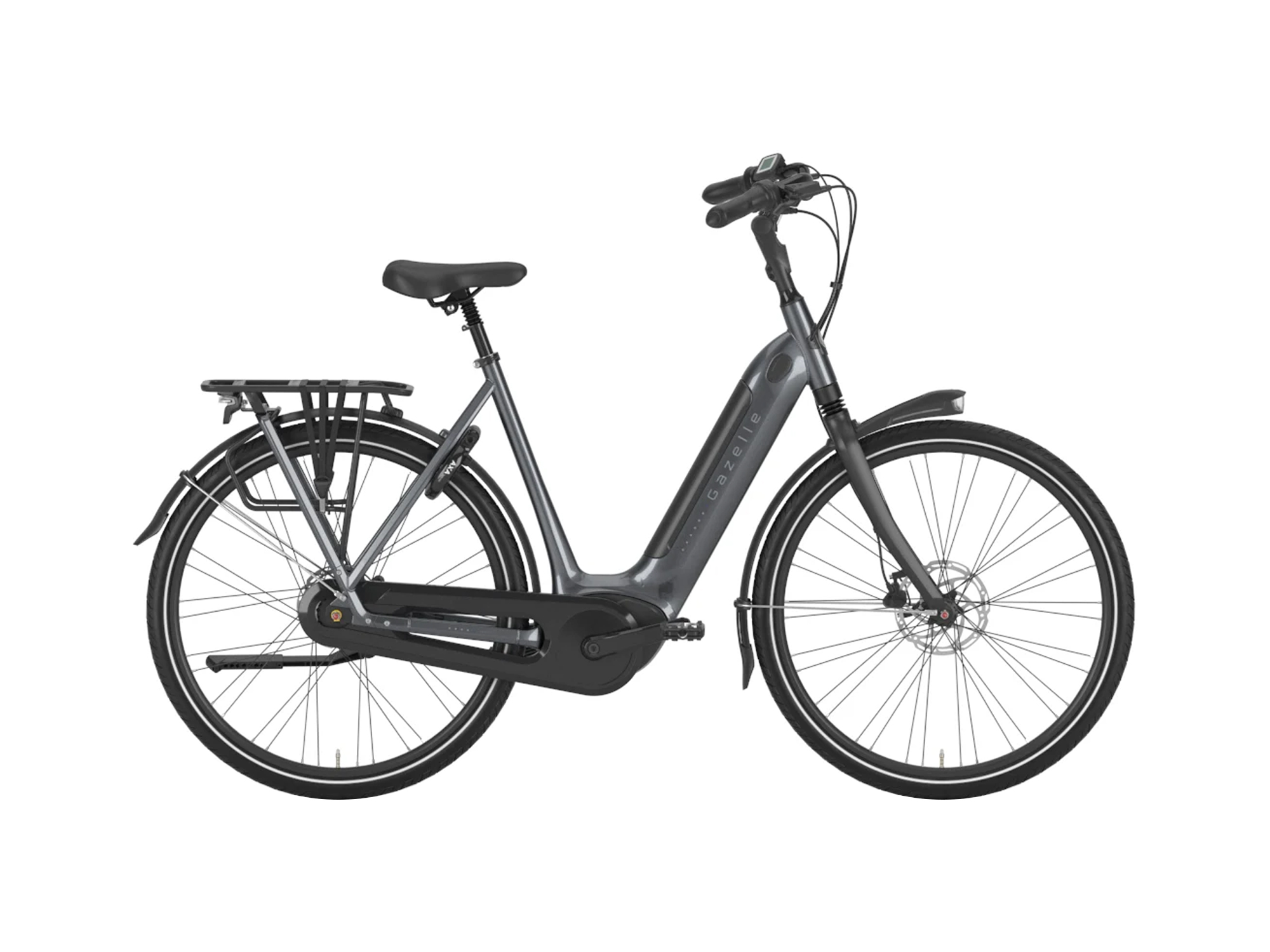

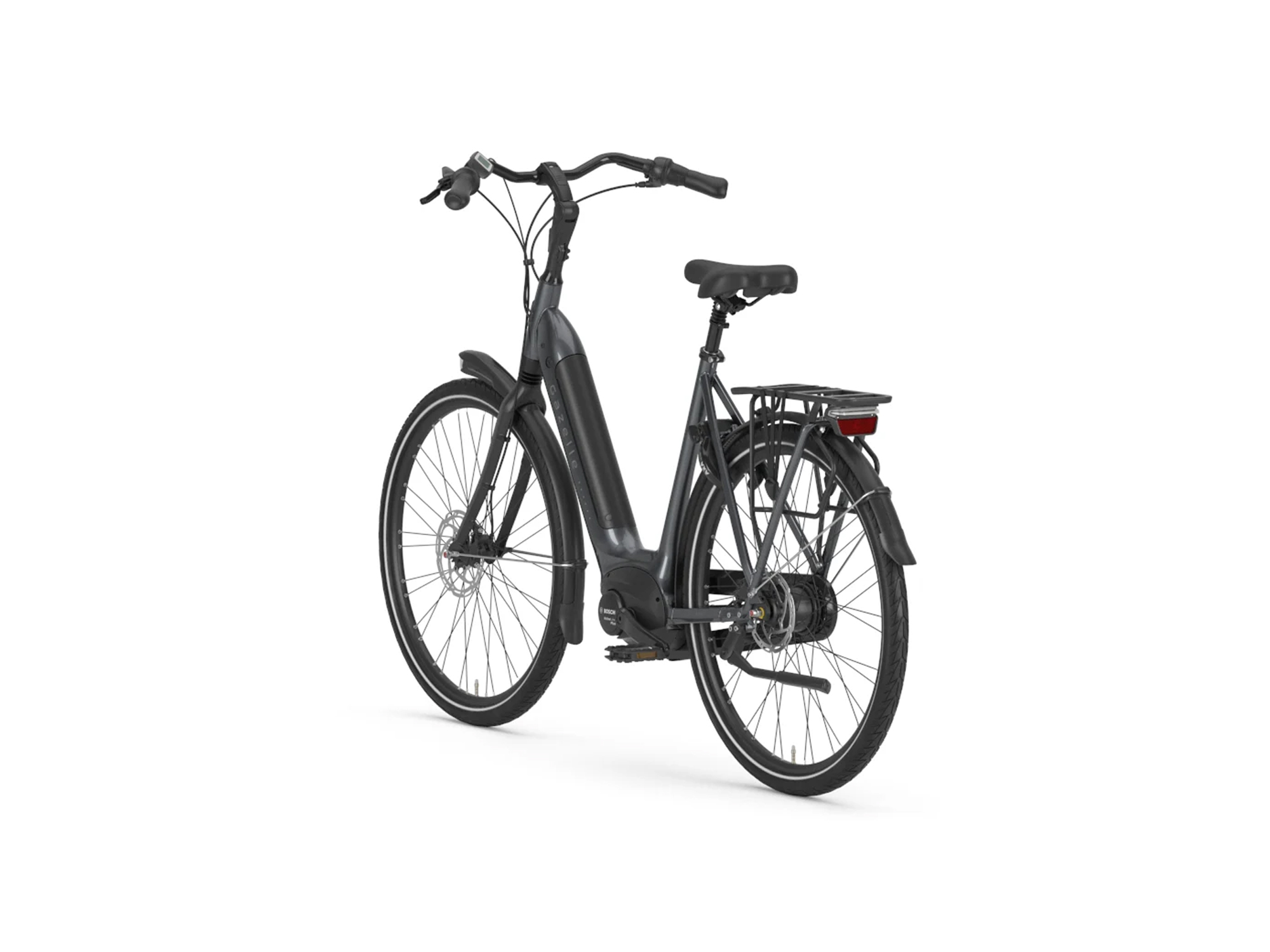

  • This is a feature complete electric bike, meaning that it comes with fenders, integrated lights, and a rear rack for cargo. Whether you’re riding day or night, rain or shine, casually or commuting, this ebike is ready to go. Gazelle is an above-average bicycle brand in my opinion, because they take extra steps to prevent rust, keep paint from fading, they sell through dealers on a global scale. Gazelle is owned by a very large long-running company called Pon Holdings. Gazelle itself is over 100 years old, having been founded in 1892, and is based in Dieren, Netherlands.
  • I (Court Rye) was test riding the Medium 53cm sized frame for this review. My weight is roughly 135lbs (61kg), and I am roughly 5’9″ (175cm) tall. I’m sharing this information to help you gauge fit based on the video review above :)

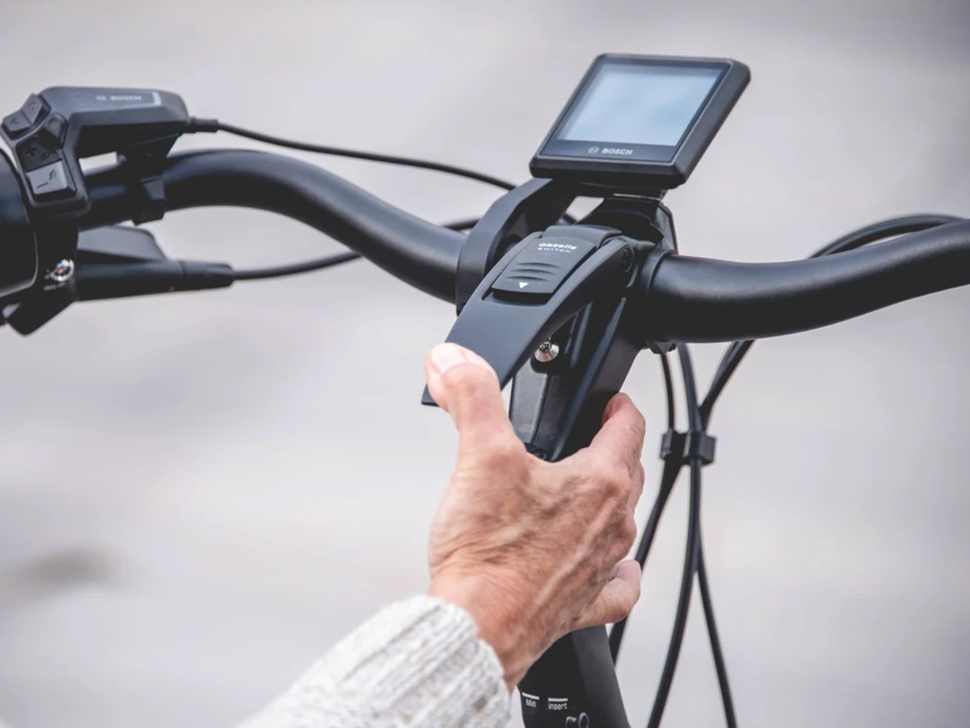

  • The cockpit is very clean, and feels less overwhelming to me than the setup on some competing electric bikes. I think this is due to the half-grip twist shifter vs. triggers, and the twist bell on the left verses something that’s mounted on top of the bar and positioned further in. The display panel is very compact and matches nicely, but is still reachable and the readout is very clear and readable.
  • The tool-free adjustable angle stem allows for a more upright body position if you have a sensitive back, neck, and shoulders like me. Or, you can angle it forward and drop the handlebar a bit for a more efficient and aerodynamic body position. I love that the bike comes in three frame sizes, so you can really dial it in based on your body features… and the frame is super approachable with the deep wave style step-thru frame.

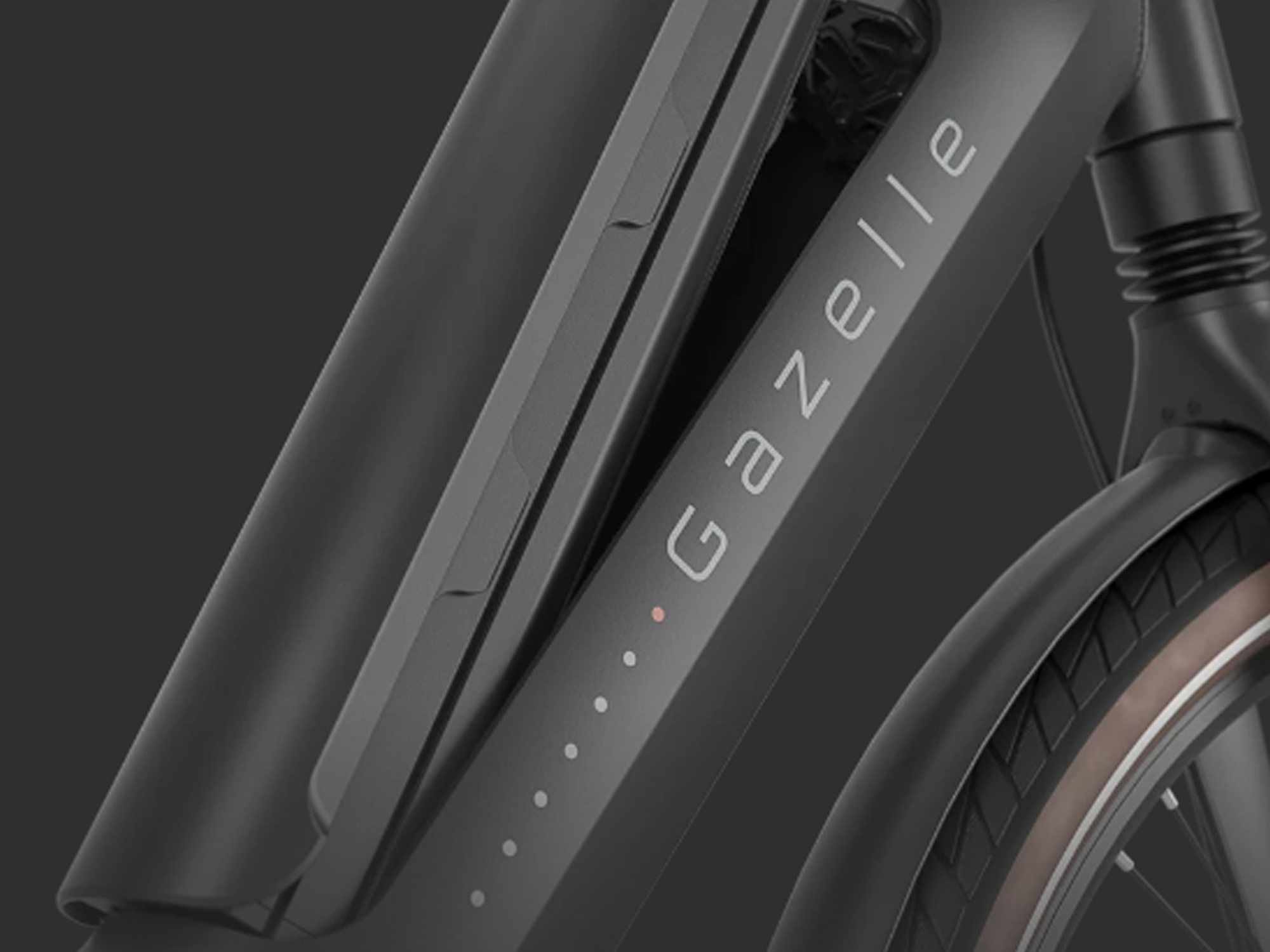

  • Excellent weight distribution. The battery pack fits inside the downtube and is about as low and centered as you can get. The mid-drive motor blends seamlessly into the frame and is almost completely obscured by the full-surround chain cover.

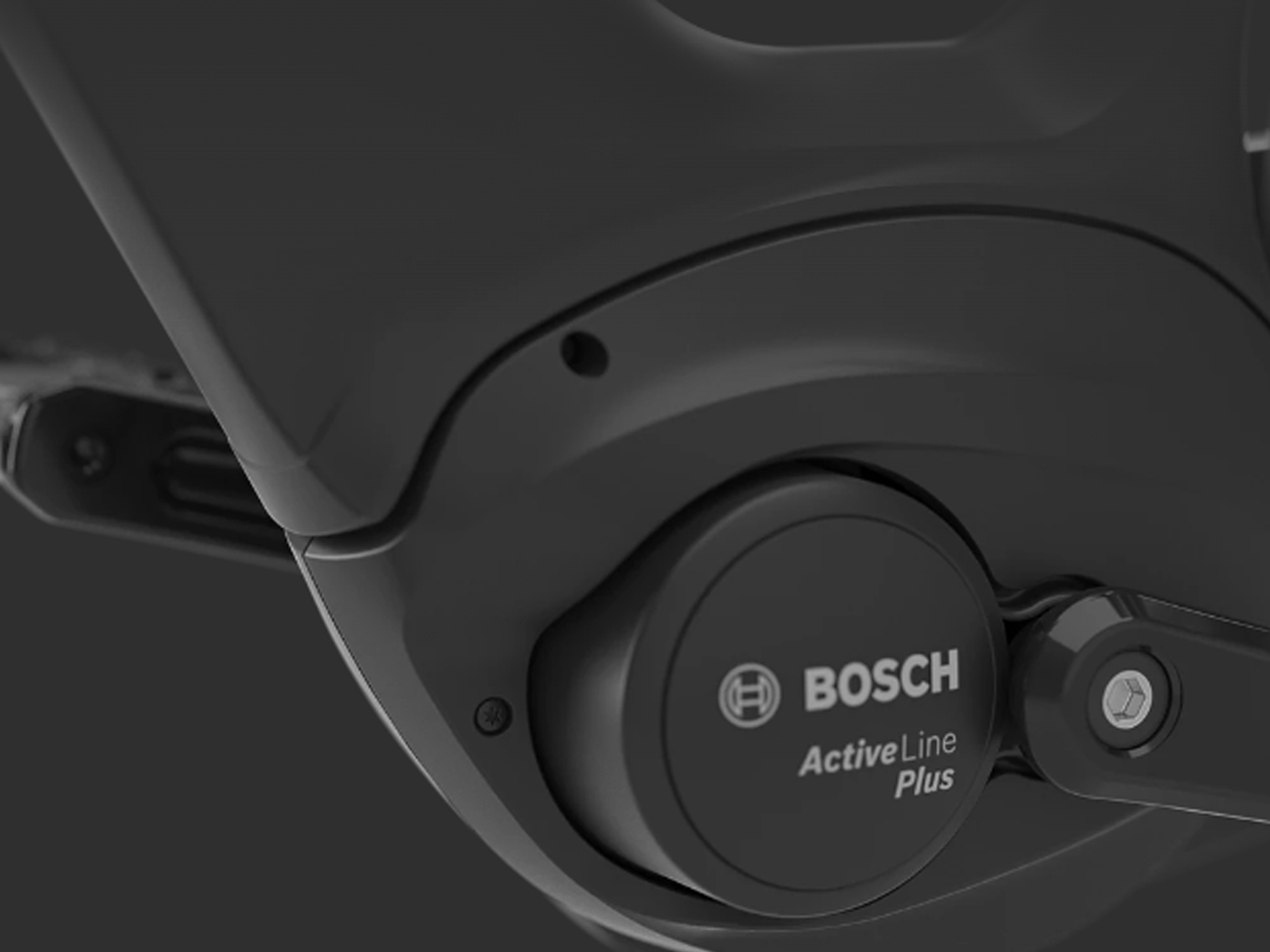

  • The Bosch motor controller is incredibly fast and smart, it makes riding with assist feel very natural and controlled. It measures rear wheel speed, pedal cadence, and pedal torque over 1,000 times per second and can even back off when it senses shifting, which protects the chain and geared hub from stress and damage.

  • The rear rack is amazing! It’s positioned far enough back that the saddle can be lowered all the way down without colliding with a trunk bag. The side support arms are extra strong, made from custom tubing and painted to match the frame color! You get 29kg (59lbs) of cargo capacity here, which is above average and great if you’re using it to mount a child seat. It uses standard gauge tubing to work with most clip-on panniers, has pannier blockers on the sides to keep bags from touching the tires, and even comes with a triple bungee strap for quickly securing lightweight loose items. I also appreciate that some of the support structure is hidden below the fender creating a really sleek refined look.

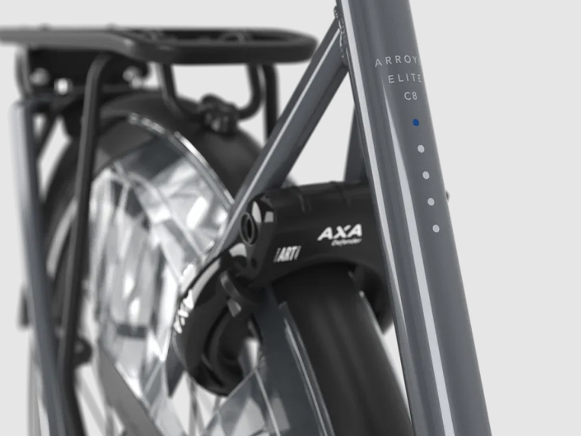

  • Another cool accessory that Gazelle includes right out the gate is an AXA Defender frame lock to secure the rear wheel for quick stops. It’s keyed alike to match the battery pack, which reduces clutter and the need to carry and fiddle with multiple keys. It’s convenient and works well… but does add some weight.

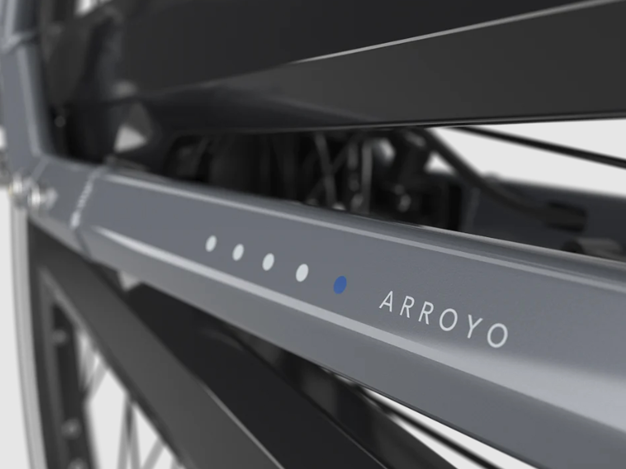

  • The battery pack is removable to help reduce weight when lifting, servicing, and transporting the bike. It’s also nice that the same charging interface is used for the pack and the bike frame plug so you don’t need a dongle. I’ve read that it’s best to store Lithium-ion batteries in cool dry environments and avoid a full discharge to 0%. Optimal use is between 20% and 80% full, and store at 50% full for long periods of disuse. It’s cool that this battery pack and cover are cross compatible with some of the other Gazelle models too, in case your family or friends buy more than one and wish to share.
  • The Bosch Active Line Plus motor offers more torque and higher cadence support than the lowest level Bosch Active line. For me, it’s a worthwhile upgrade, but still delivers the benefits of efficient power use and decreased noise vs. the Performance Line products. It’s also less expensive, contributing to a more affordable ebike.

  • Weighing in at roughly 59lbs for the medium sized frame, this is a moderately heavy electric bike… but still less than the Arroyo C7 HMB that has a larger double crown suspension fork. The weight of both models has to do with the spring suspension fork and seat post, internally geared hub, fenders, integrated rack, lights, cafe lock, adjustable stem, swept back handlebar, and reinforced step-thru frame with cutaway point. The bike looks very smooth and beautiful, but extra metal was used to increase strength and stiffness while keeping this wave design, and it appears to be the same frame used for their belt driven products with that cutaway on the right chain stay… which requires more metal and structure for strength.
  • The Bosch Purion display panel is fairly easy to read, effective to use, and easy to reach to press on the buttons without compromising your grip too much, but the display itself isn’t removable and some menus and readouts that fancier displays include just aren’t present here. It doesn’t have a dedicated light button, so remember to hold plus to activate or de-activate the lights and hold minus to cycle through menus, and hold minus and tap power to change units from miles to kilometers and back. The Micro-USB port on the right side of this display is only for diagnostics and not charging portable electronics. Consider paying a local shop to help upgrade the Purion to Kiox if you want USB charging and Bluetooth for their smartphone apps.
  • As nice as the controller is on this ebike, Gazelle is using the older rear wheel speed sensor with a spoke-attached magnet that can get bumped out of position more easily than the new one that mounts on the disc brake rotor mount. It’s a small thing, but this is one of their nicer ebikes, so it would be cool to see the cleaner integration.
  • I love that the battery lock core and AXA frame lock use the same key, but discovered that the key gets locked into place when the cafe lock is disengaged. Perhaps they meant this as a feature, but it means that you basically have to lock the bike every time you stop or someone could mess with the cafe lock and steal the key and or battery. Furthermore, since you have to leave the key in the cafe lock when riding, if you’ve got the key attached to a keychain, it will rattle as you ride. If you do not have it attached to a keychain, it could get lost more easily when you take it off and drop it into your backpack or purse. I just wish they let you remove the key from the AXA Defender frame lock when unlocked as well as locked so this wouldn’t be an issue.
  • In order to lock the battery into place, you have to insert the key and unlock the core before seating it into the downtube. Some competing designs I’ve seen from BULLS just allow you to push hard and the battery will click into place without the key. I appreciate that ramped latch design because I feel it makes dropping the battery pack less likely, as you don’t have to simultaneously fumble with a key.

  • The Bosch PowerTube 500 battery pack weighs more than the older PowerPack 500, is longer and sharper (making it awkward to fit into backpacks and pannier bags if you wish to transport additional batteries for long range use), and has a custom plastic shield mounted to match the downtube. The shield does not appear to be easily swappable between batteries without using tools, but at least the shield is generic black (less expensive to produce, more standardized and easier to find as a replacement). The black shield matches the black frame really well here.
  • There’s plenty of room for bottle cage bosses on the downtube (on top of the battery pack) and seat tube, but Gazelle didn’t include any. You could always get an SKS Anywhere adapter for mounting a bottle cage to the seat tube with straps, or get a trunk bag and panniers for cargo and accessories to mount on the rear rack, but it’s nice to have a bottle within reach. Perhaps their decision has to do with frame strength and cost savings on the plastic battery shield vs. something fancier like Cannondale has done with a mounting point on their battery shield.
  • The Bosch Active Line Plus motors have a bit of “clunk” feeling when you stop pedaling. I think this relates to the gearing inside, because there’s also some friction when pedaling backwards as it seems to cycle the gearing inside the motor itself. Both of these characteristics may smooth out and reduce with continued use, but I didn’t notice this same behavior when testing the more powerful Bosch Performance Line motors.
