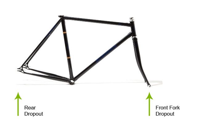

Hub motors for bicycles are usually positioned at the middle of a wheel and when the bike is powered off they function much like a traditional hub (connecting the tire, rim and spokes to the axle. Spokes are flexible and light weight, they absorb some shock when riding but can come out of true over time. Regular bicycle maintenance is still required with an electric bike and one downside to hub motor designs is that they add additional weight to the wheel and require extra wires to deliver electricity and communications about operation. This means that truing wheels and repairing flats requires more effort.
So hub motors take the place of regular light weight hubs, connecting the wheel to the bicycle axle. As they receive electricity and spin, the bike is propelled forward and some of this energy is exerted into the frame at the dropouts. Usually the sturdiest place to mount a hub motor is in the rear wheel because these dropouts are reinforced and have four legs connecting them to the rest of the frame instead of just two on the front fork. These four arms consist of two seat stays and two chain stays.
In some cases a front mounted hub motor is preferred because it allows an internally geared hub or continuously variable transmission CVT hub such as the NuVinci to be used in the rear. Some of the newest electric bikes like the Smart ebike combine an internally geared hub (that the cyclist pedals) with a hub motor and are able to put both in the rear wheel.
