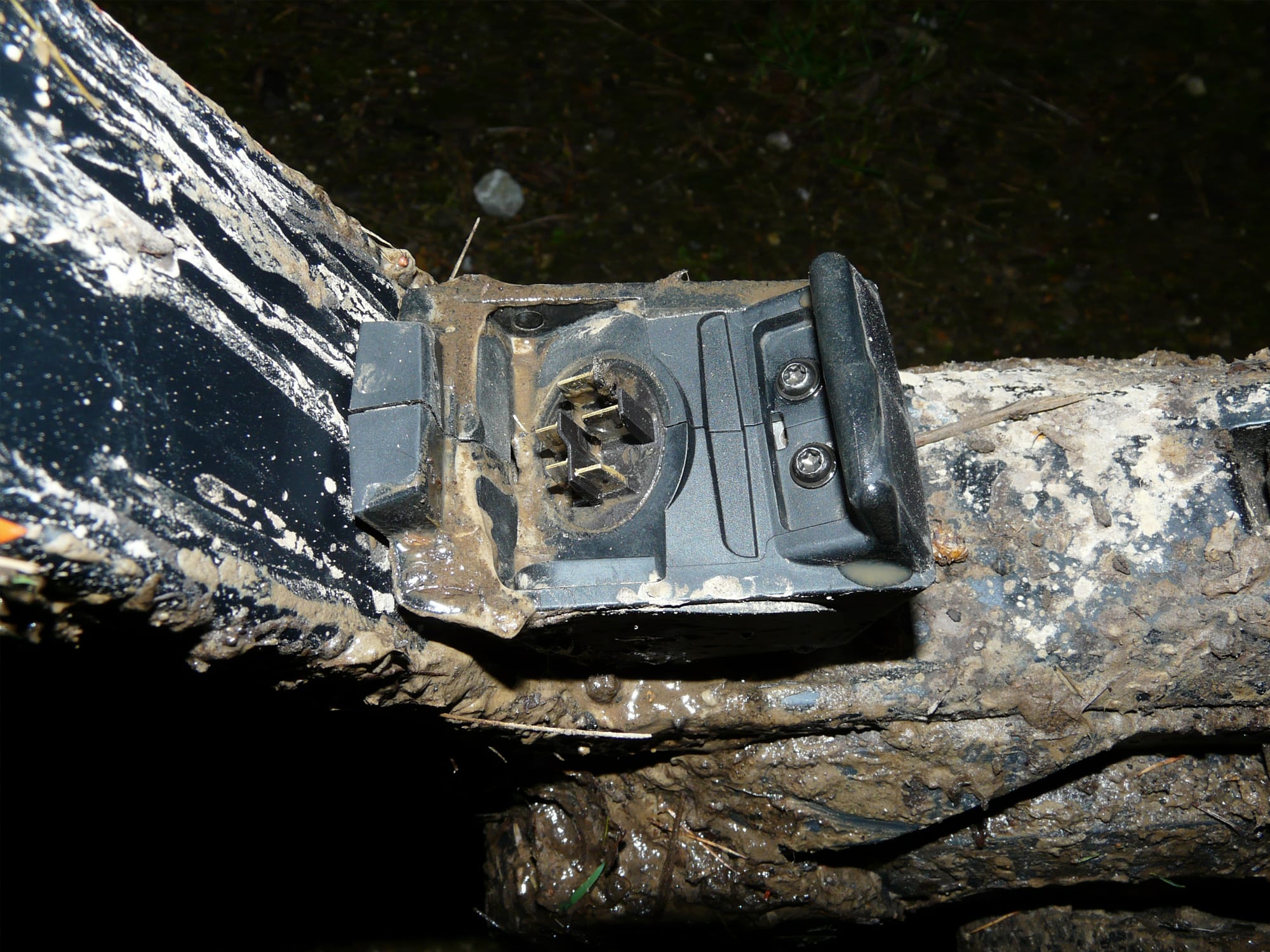

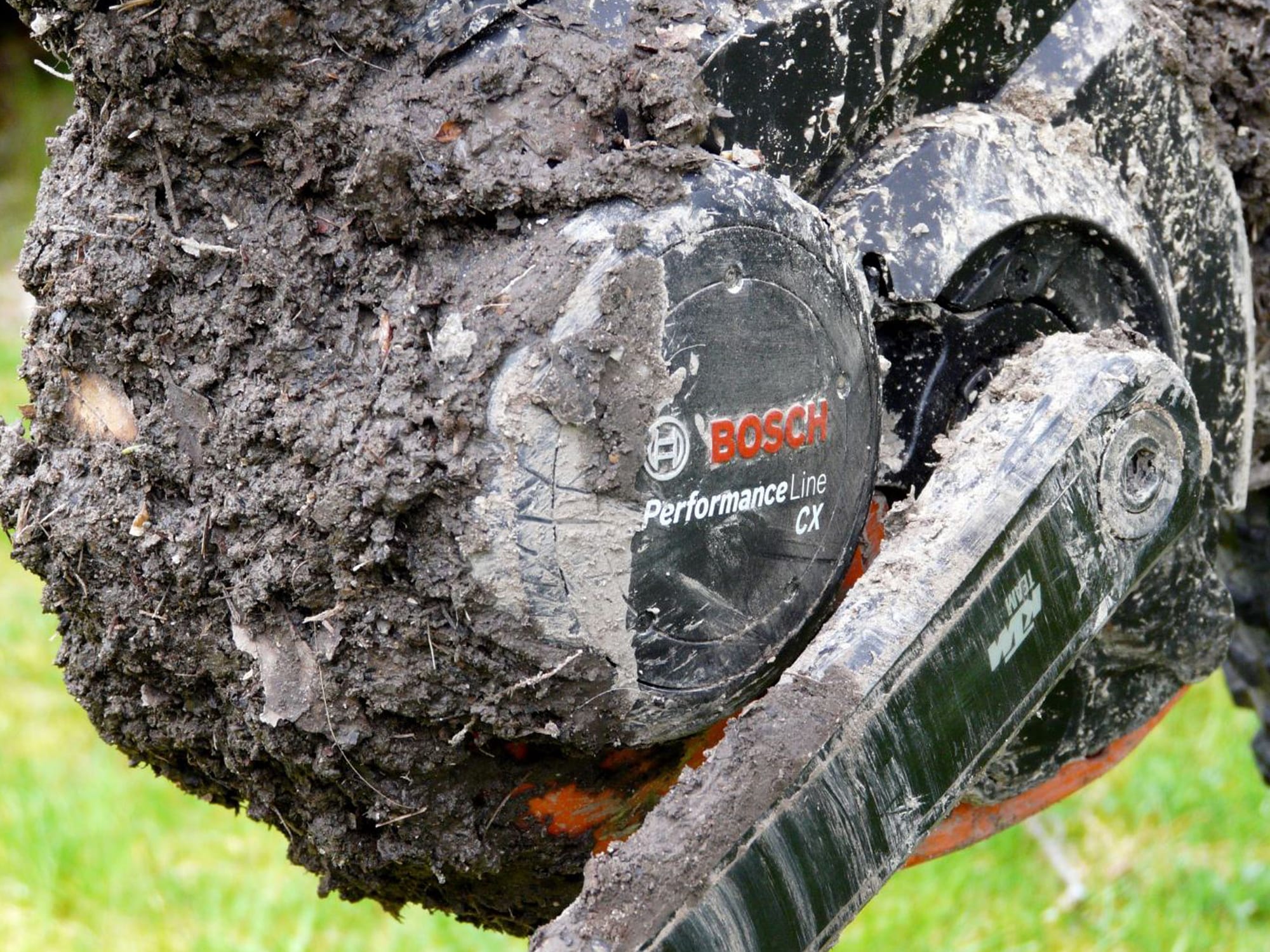

In recent years some of the fancier electric bikes have designed motors, batteries and display units that specify an IP rating or “IP Code“. This stands for Ingress Protection which rates the degree of protection provided against intrusion (body parts such as hands and fingers), dust, accidental contact, and water by mechanical casings and electrical enclosures according to Wikipedia. Just the sort of rating you’d want for a product that’s being used in wet, dirty and abrasive conditions. The Specialized Turbo Levo is a good example of this, its battery pack is rated IP67 which would mean it is dust tight and may be submerged in water up to 1 meter. Crazy right? Not sure I’d actually try that… I got this interpretation by looking up the first and second digits of the IP Code independently in their little table. Again from Wikipedia: the first digit indicates the level of protection that the enclosure provides against access to hazardous parts (e.g., electrical conductors, moving parts) and the ingress of solid foreign objects. The second digit indicates the level of protection that the enclosure provides against harmful ingress of water.
So IP ratings are awesome but still fairly uncommon and in the case of the Turbo, only relate to specific components of the bike… the battery box itself, not the motor or display. So what about these other pieces and also the majority of less expensive electric bikes which don’t come with any sort of IP ratings? this is where we get subjective and where I’m going to reference what I have heard and seen from shops. Don’t blame me if you wash too vigorously or ride through a super deep puddle and the bike breaks, that’s up to you and the warranty provider and frankly, sometimes these products break due to wear and tear having nothing to do with cleaning. The best you can do is be somewhat educated and thoughtful in your approach :D

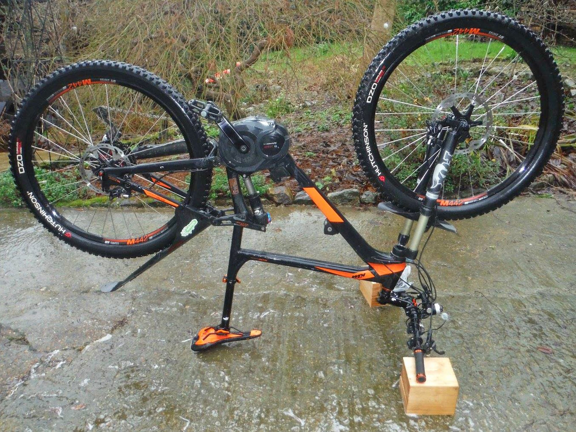

Ideally you’d have a bike stand to lift your bike which make cleaning the wheels easier. This one is semi-affordable but has a 55 lb suggested limit. Before lifting or moving the bike make sure you take off the battery to lighten your bike. If you don’t want or can’t afford a stand you can usually just flip the bike over onto its handlebars. WARNING! be careful not to break your shifters or LCD display panel when doing this. Some ebikes have removable displays which helps but given the extra wires and other sensitive parts that can be damaged when turned upside down it’s still a bit risky. Take care not to hurt yourself or your bike and consider using wooden blocks to elevate the mid-section of the bar as shown below. In the second picture you can see how the bike is suspended by straps in a garage so that the wheels are off the table for easy access and drivetrain movement. For people who can’t drill holes in their walls and don’t have a garage the stand or flip technique are probably the best bet.
So once the bike is either lifted, flipped or leaning agains the kickstand or wall, you can spray the wheels and run a rag through the spokes. For those who want to get super deep into it and really clean parts like sprockets there’s a brush set available that will work better… And of course, there are also fancy rags to help you with those tight spots! In recent years micro-fiber rags have become less expensive and they work very well. They’re are designed to not leave scratches but if you get them very dirty and rub the dirt and grit around in you could still end up with some damage so be careful. Check out these ones which cost less than $10 for a pack then just rotate through and wash them all at the end to avoid the dirt scratching issue.

Never ever use a air line any where near any bike electric or not to remove water you will force water into the tight spaces. Don’t wash an Ebike up side down, you will get water ingress and water pools where it’s not designed to be, the bike elements and parts are designed to use gravity to help gutter away water like a weather board on the bottom of you front door or a peak of a cap you wear on your head ;) Just to re assure you, motor bikes have more electrical systems than an Ebike but are usually not IP rated, they have more ingress because you ride faster and things are not sealed. They rely on gravity to gutter away water so water does not pool. I was a motor cycle dispatch rider for years and all my bikes were fine ;) Last thing, don’t put your bike away wet dry it down as much as you can ;)
