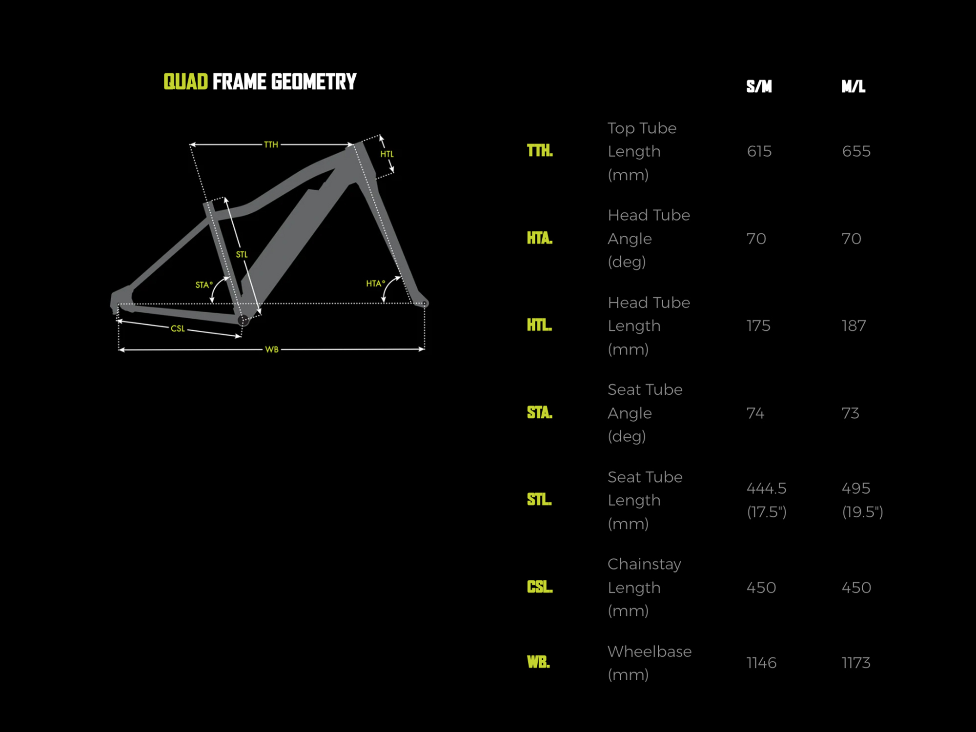

17.5 in (44.45 cm), 19 in (48.26 cm)
Medium/ Large 19" Frame: 23.75" Reach, 28" Minimum Saddle Height, 34.5" Minimum Saddle Height, 27.5" Width, 76" Length, 45.5" Wheelbase

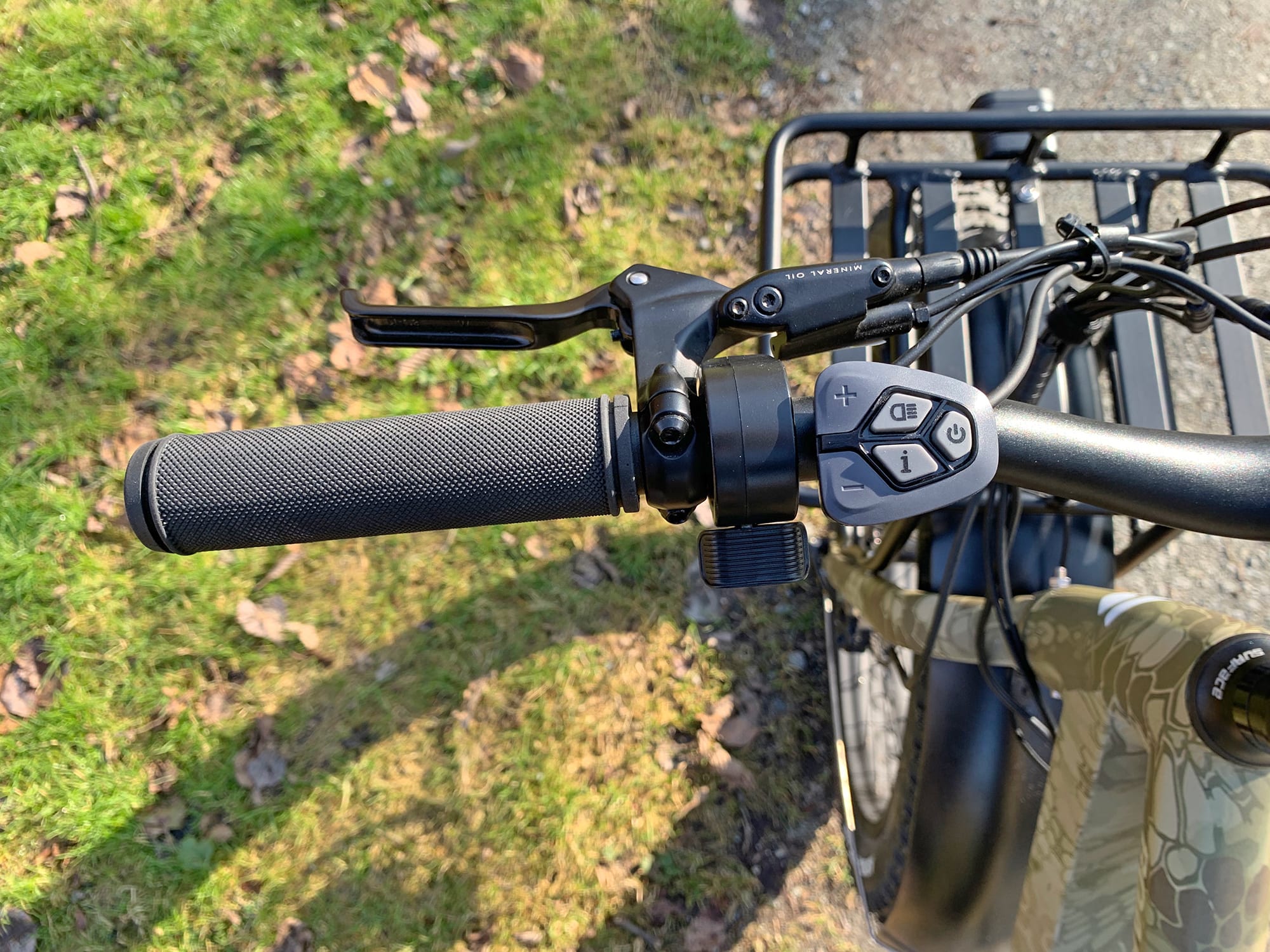

Independent Button Pad near Left Grip (+, -, Light, Information, On/Off), Hold - for Walk Mode, Hold + and - for Settings Menu
Battery Percentage, Current Speed (With Infographic), Power Meter, Trip Distance, Odometer, Max Speed, Avg Speed, Trip Time, Assist Level (0-5)

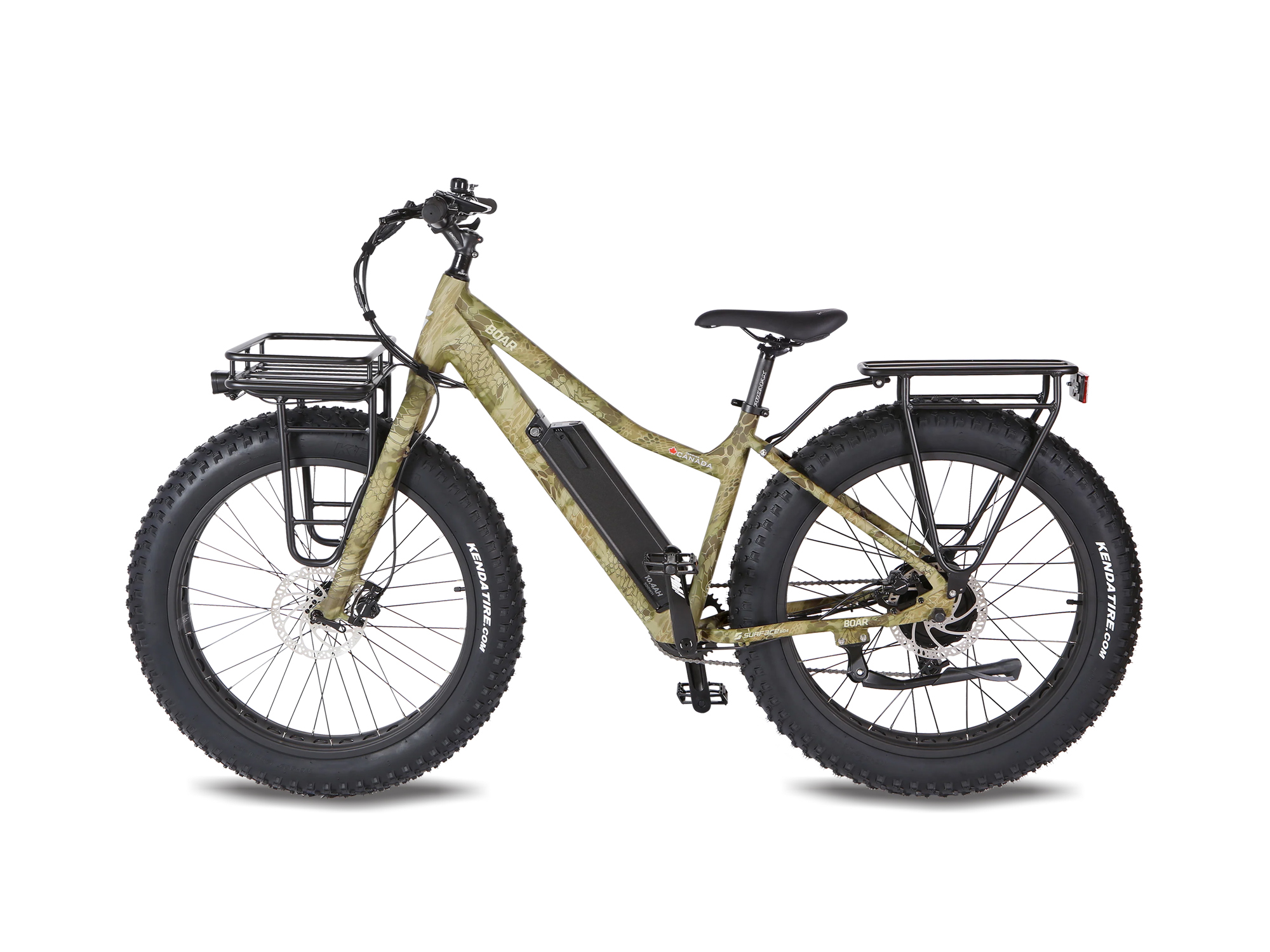

  • Official Kryptek brand camouflage paint on the frame and fork, heavy duty custom-made racks, extra large 4.5″ fat tires, and unlockable high-speeds make this a very unique platform… especially when you consider that it’s available in two frame sizes. Very few other ebikes are so perfectly designed to fill a niche, and I feel that this would be an excellent platform for hunting, bikepacking, and camping

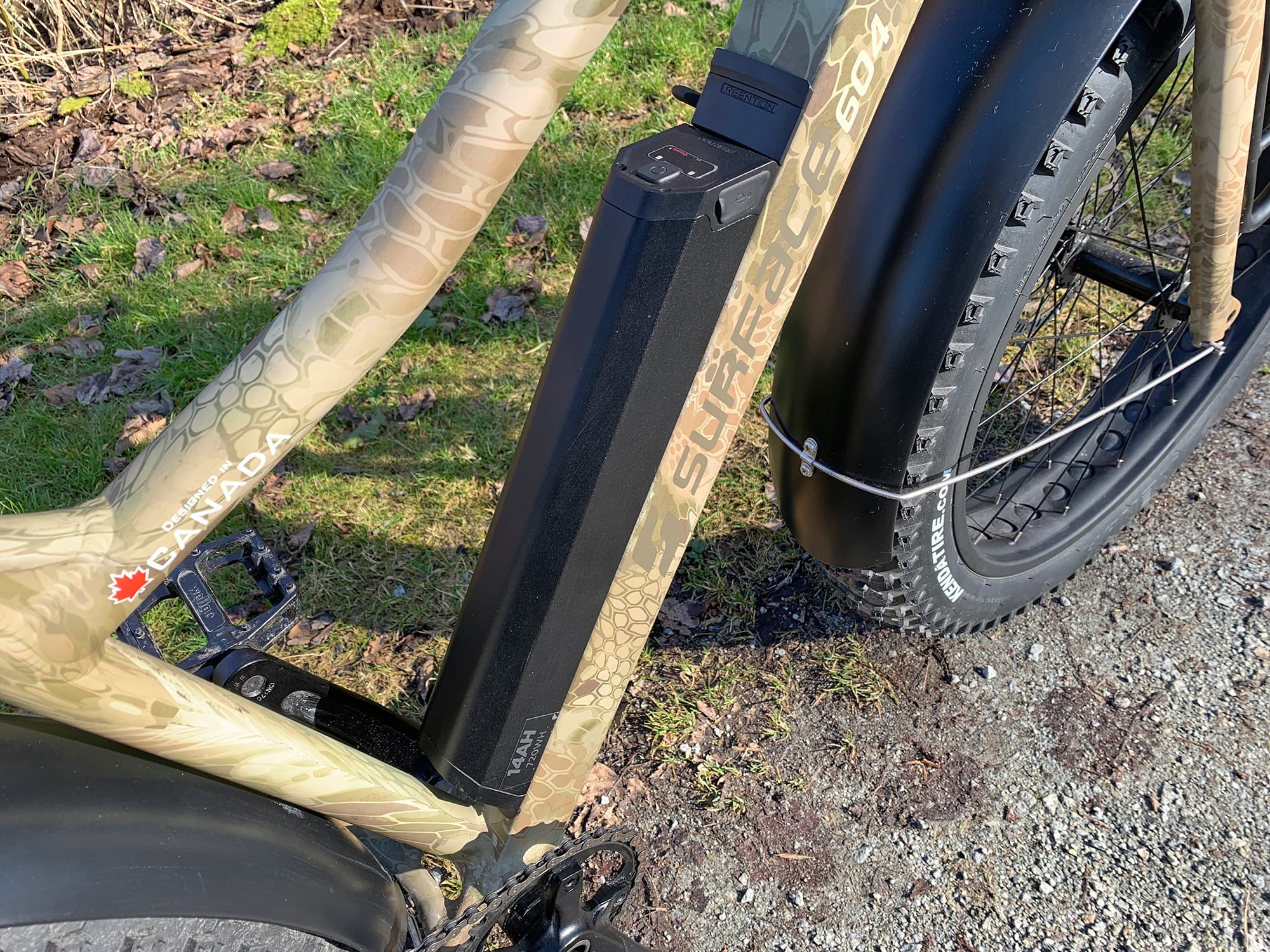

  • Two USB charging ports (one on the display and one on the battery pack) let you run portable electronics on the go or separate from the bike at your camp. Since this bike comes with two battery size options, and the upgrade is only $300, I’d definitely recommend the higher watt hour! The heavier weight, throttle, and unlockable higher speed will drain the battery faster than most competing products
  • All of the 2023 Surface 604 products utilize the same Reention battery pack design, and the batteries are interchangeable. This is a nice feature if you are exploring a his and her setup or want a city and trail bike… being able to take a second pack with you on the rear rack of the Boar Hunter would significantly extend the range

  • The frame and fork are custom painted with Kryptek camouflage matte paint to help the Boar Hunter blend in to its surroundings, there are very few shiny parts and many of the black accessories are also matte

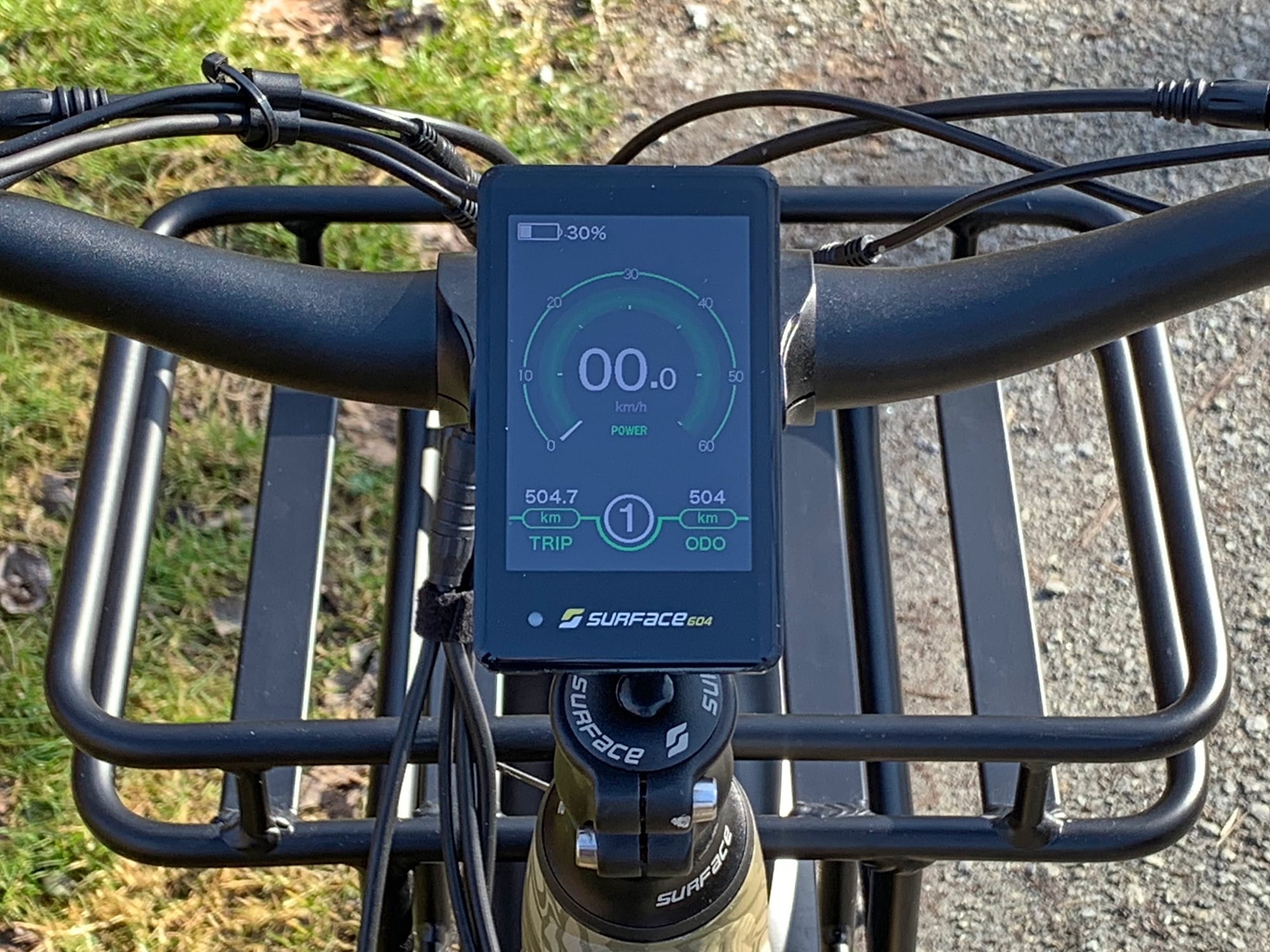

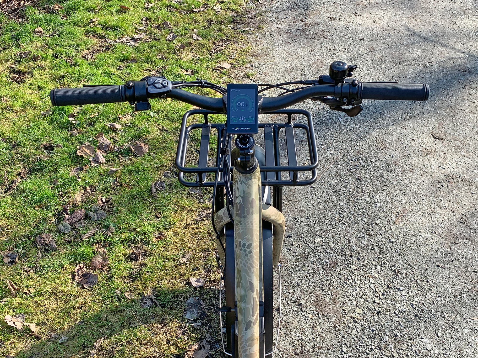

  • The display panel has been upgraded to be even larger, now 3.5" diagonal. It's easier to read, still swivels to reduce glare, and has a USB charging port built in to power portable electronics such as an additional light, smartphone, or GPS

  • The display has a password option where you can set a four digit pin to deter tampering and theft. This is great if you’re leaving the bike at a public bike rack and don’t want people messing with the throttle while you’re away (especially since the throttle is active at all times with the bike on), and it might also help to secure the bike if you leave it at a campsite and continue on by foot

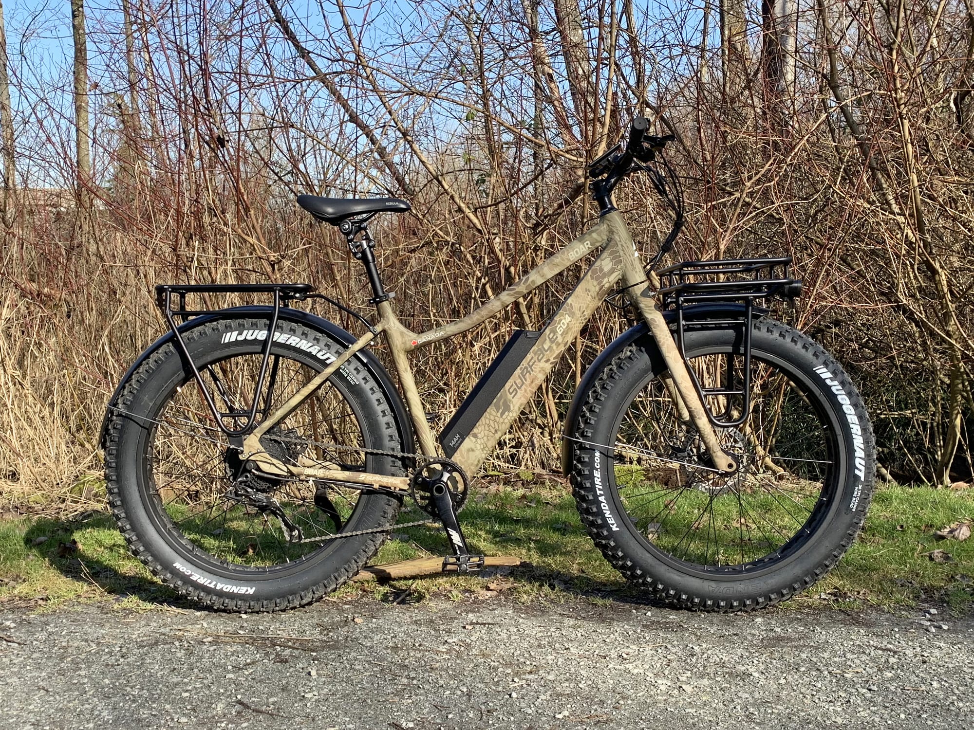

  • Between the Selle Royale gel saddle, riser stem, and high volume extra-large 4.5″ wide fat tires, the Boar Hunter is comfortable to ride, even on rough terrain and without a suspension fork (as long as the tire PSI is lowered a bit). For me personally, the suspension seat post is a great upgrade and worth the money if you plan to go far or fast
  • Considering how custom this thing is, I was surprised and delighted to see that it comes in two frame sizes!
    That means more people can fit or ride comfortably and still get the custom camo design and racks seen here… most competing fat bikes don’t even have the option to buy racks like these that will fit correctly
  • The curb weight of ~67lbs may sound like a lot, but I actually think it’s pretty good given the extra-large tires and dual-rack setup, note the hollow spindle, punched out rims, and narrow rigid fork that all save weight

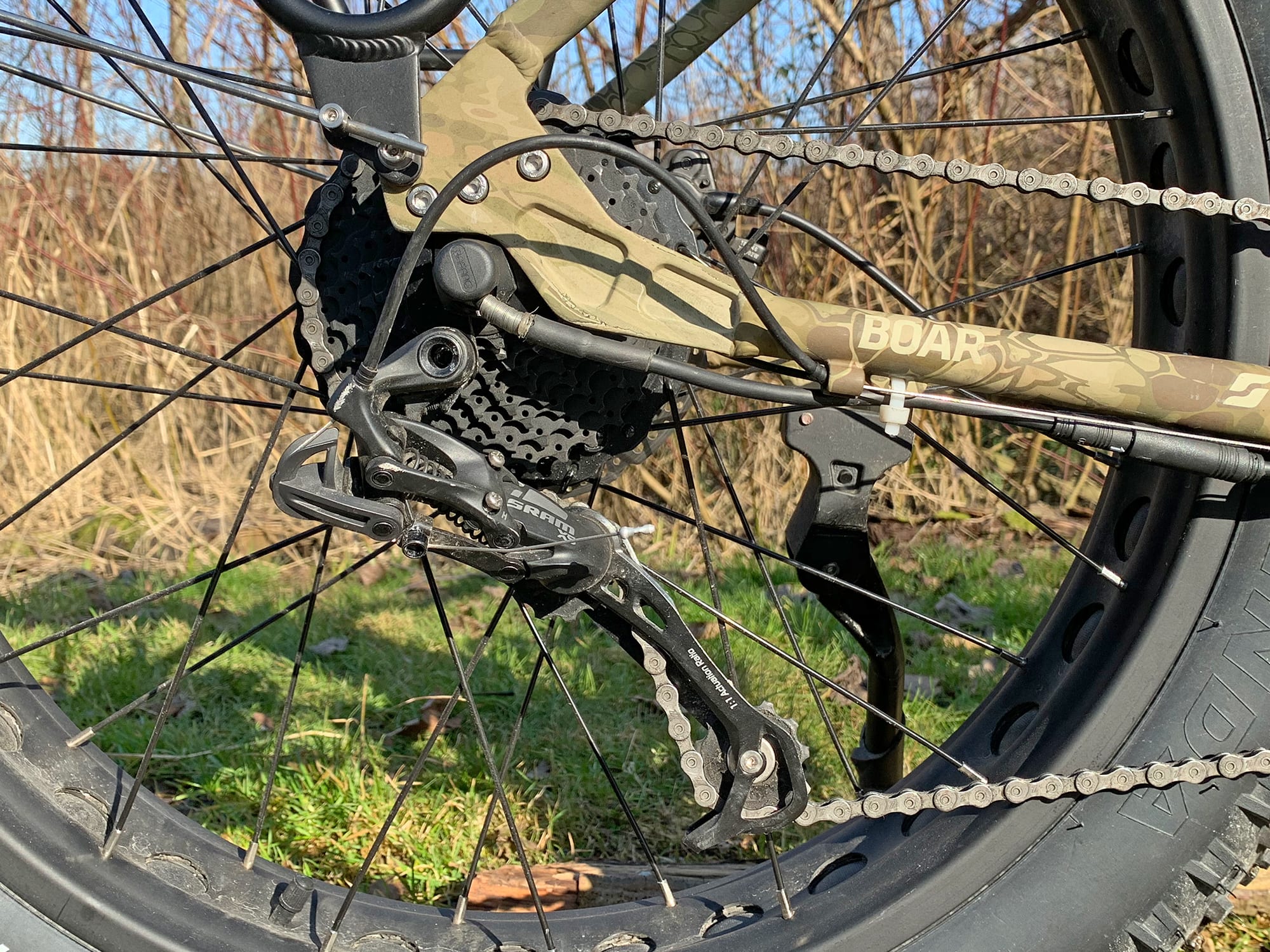

  • SRAM X5 is a pretty good component level, so the derailleur feels tight and shifts quickly and reliably. It’s equivalent to Shimano Alivio or Deore, which is five steps up from the bottom (X5, get it?) so it’s a great choice for an off-road rugged bike like the Boar Hunter

  • Surface 604 offers a battery upgrade path for just $200 which increases capacity from ~500 watt hours to ~672 watt hours. This is definitely worth it for people who want to go further, navigate through more rigorous terrain, or ride at high speed. Both batteries use the same case that is cross compatible with all other 2020 Surface 604 models and the larger pack only adds one pound of additional weight because it uses the same number of cells with a higher energy density
  • The display panel has a full sized USB charging port built into the right side which is very convenient for powering a smartphone with GPS. Additionally, the removable battery pack has a full sized USB Type A charging port built into the top right corner, so you can charge and run portable electronics separate from the bike itself. This could be useful in a camp setting or even inside your car or home when the bike is mounted to a rack or parked in a shed or garage
  • The new color display looks great and has an intuitive button pad interface. I love the dedicated light button, the fact that the display has an ambient light sensor, that the brightness auto-dims when you activate the lights (so it won’t ruin your night vision), and that it swivels to reduce glare

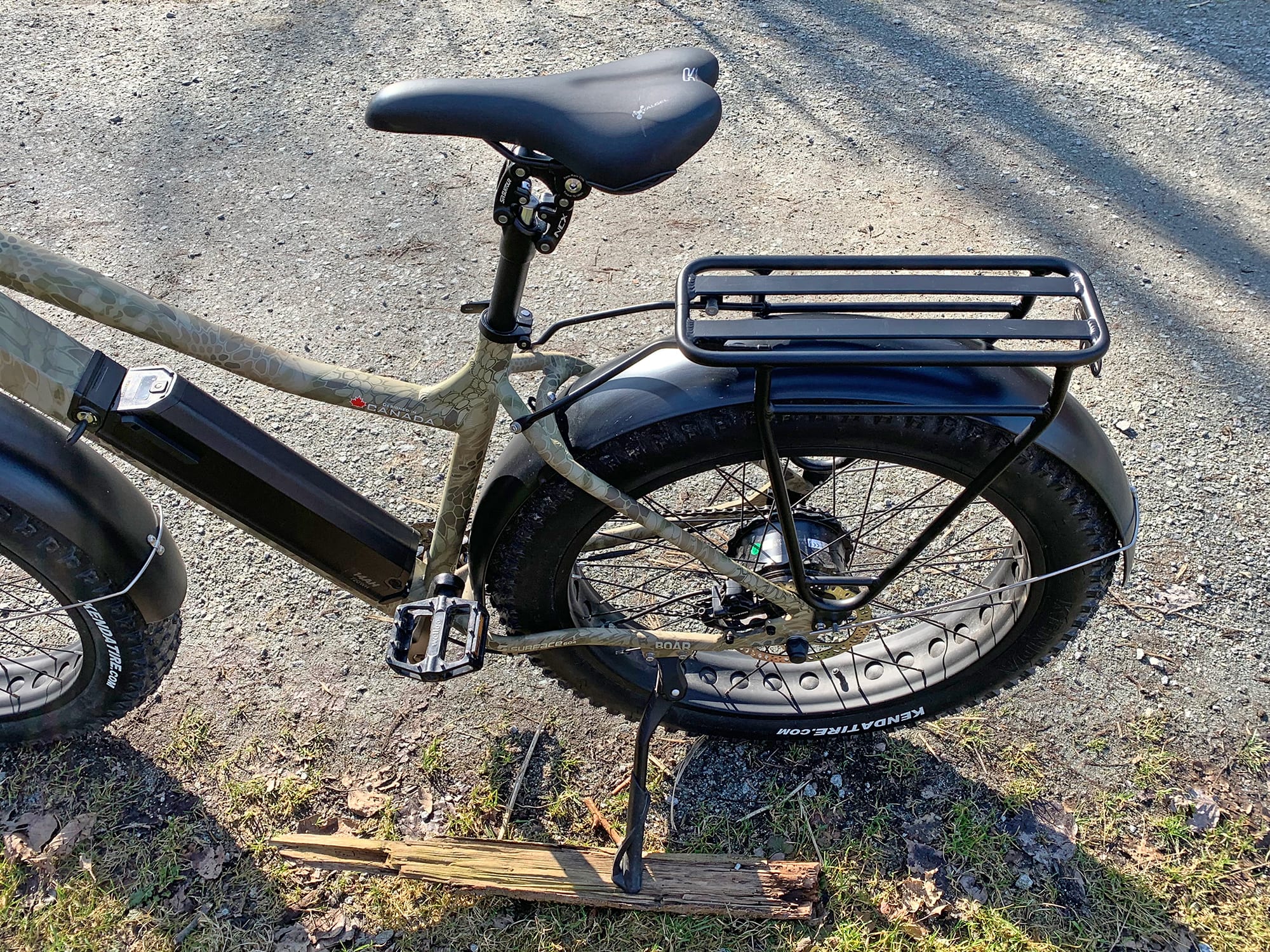

  • I spoke with the bikes designer and he showed me how they designed the rear rack with fender support mounting points so they wouldn’t have to add additional holes on the bike frame itself… very smart! And if the rear rack is removed, I think you can use the mounting points for the fenders only

  • Surface 604 designed the frame with an aggressively sloped top tube to lower stand over height, this could really save your crotch if you had to hop forward unexpectedly and stand in soft terrain where your feet sink in. In order to make the frame strong enough to handle that sloped top tube, they added a tall gusset where it meets the seat tube

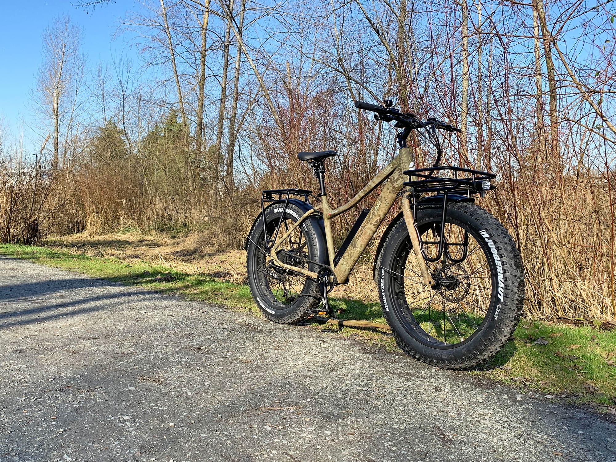

  • The headlight is positioned fairly well, on the front of the rack so it won't get blocked, and it does point where you steer because this rack is mounted to the front fork.

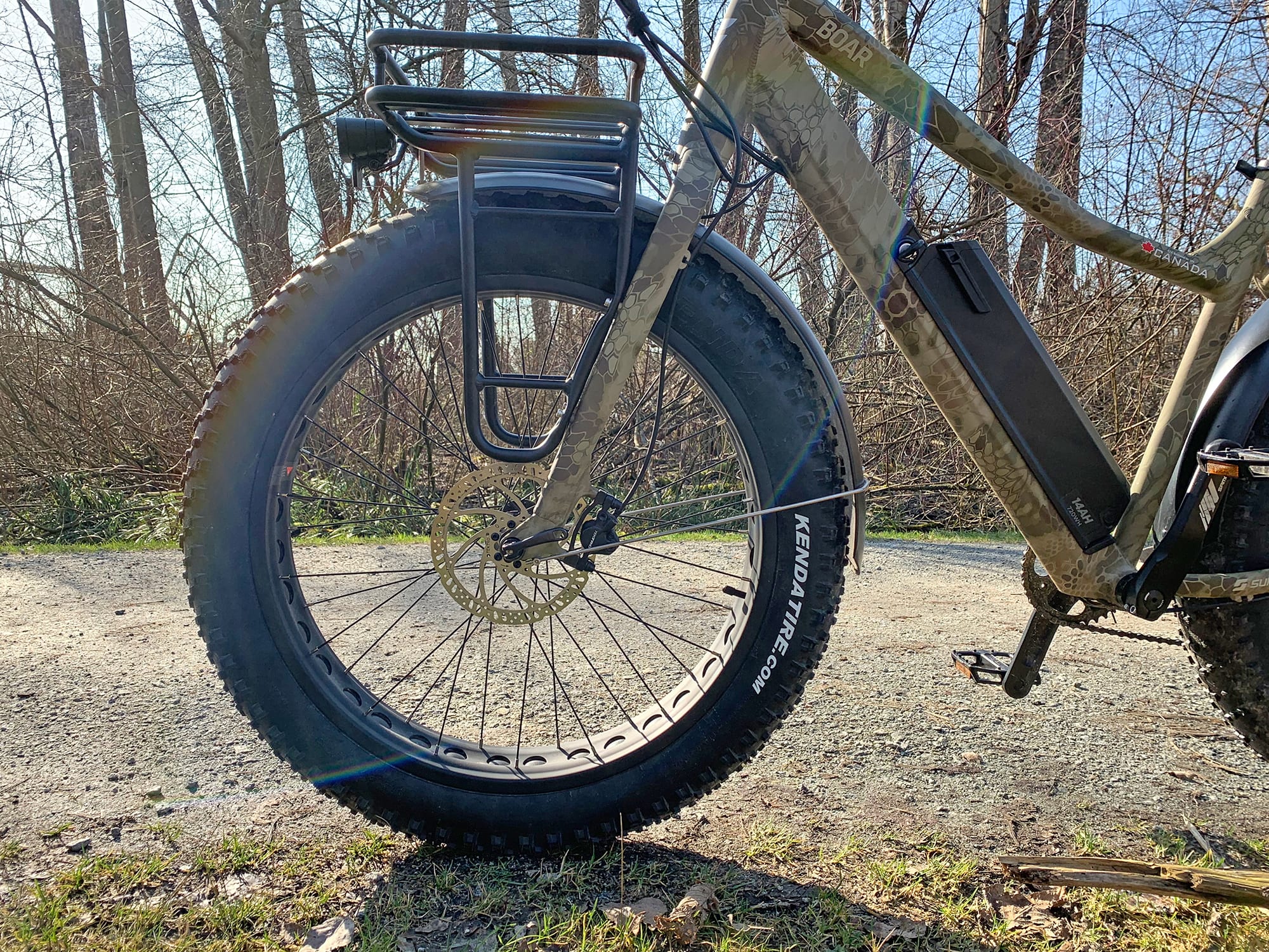

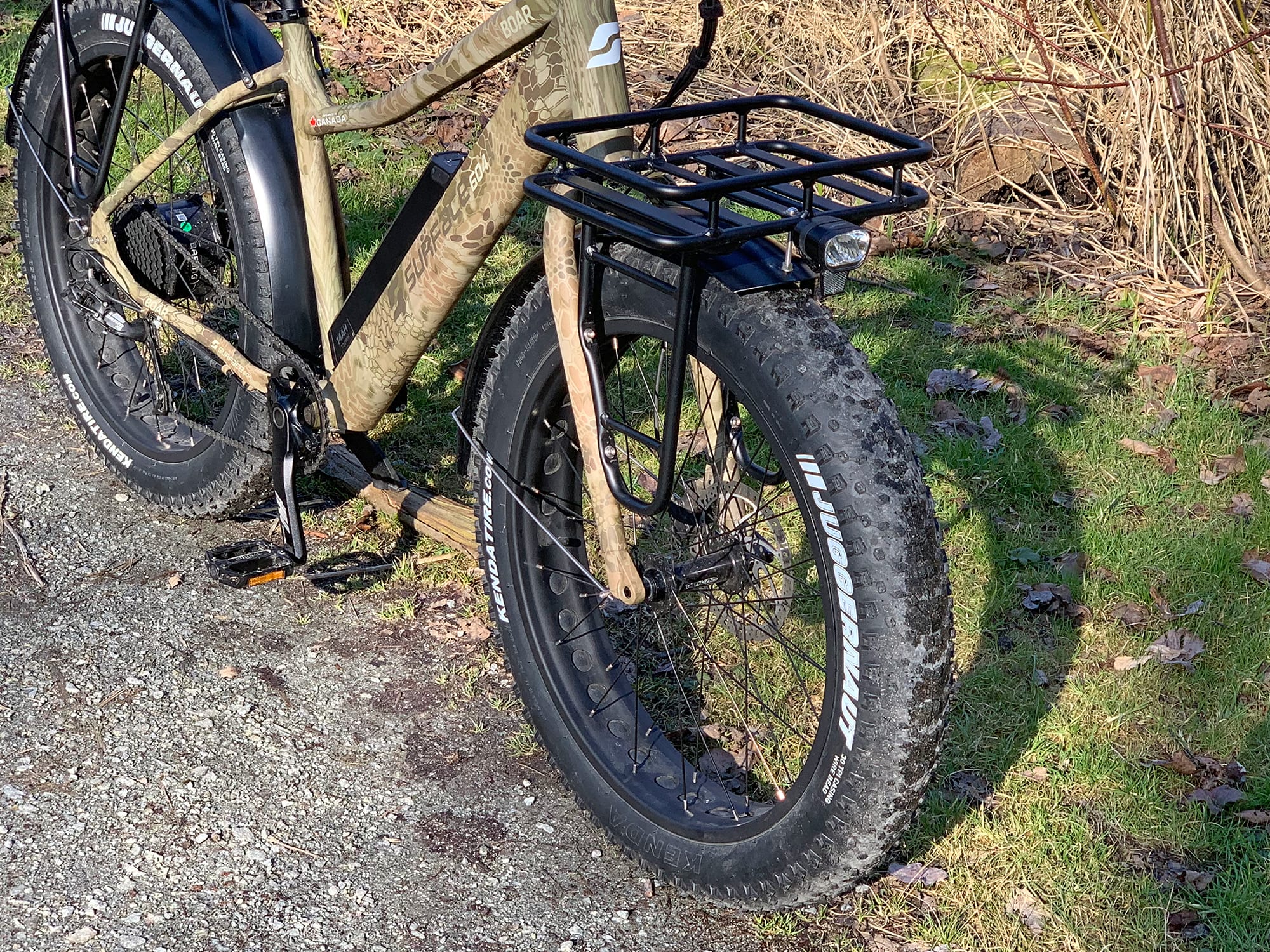

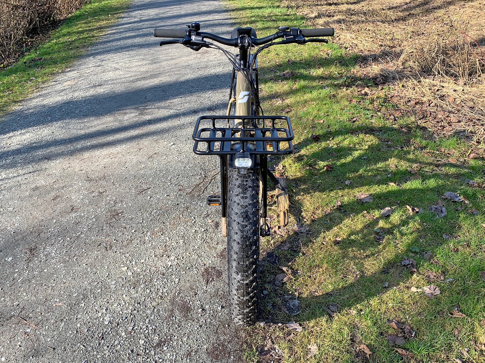

  • Since the front rack is mounted to the fork instead of the frame (such as the head tube), it may impact steering when loaded. The upside is that it feels more natural to see the rack turning as you steer the bike. It can be removed.

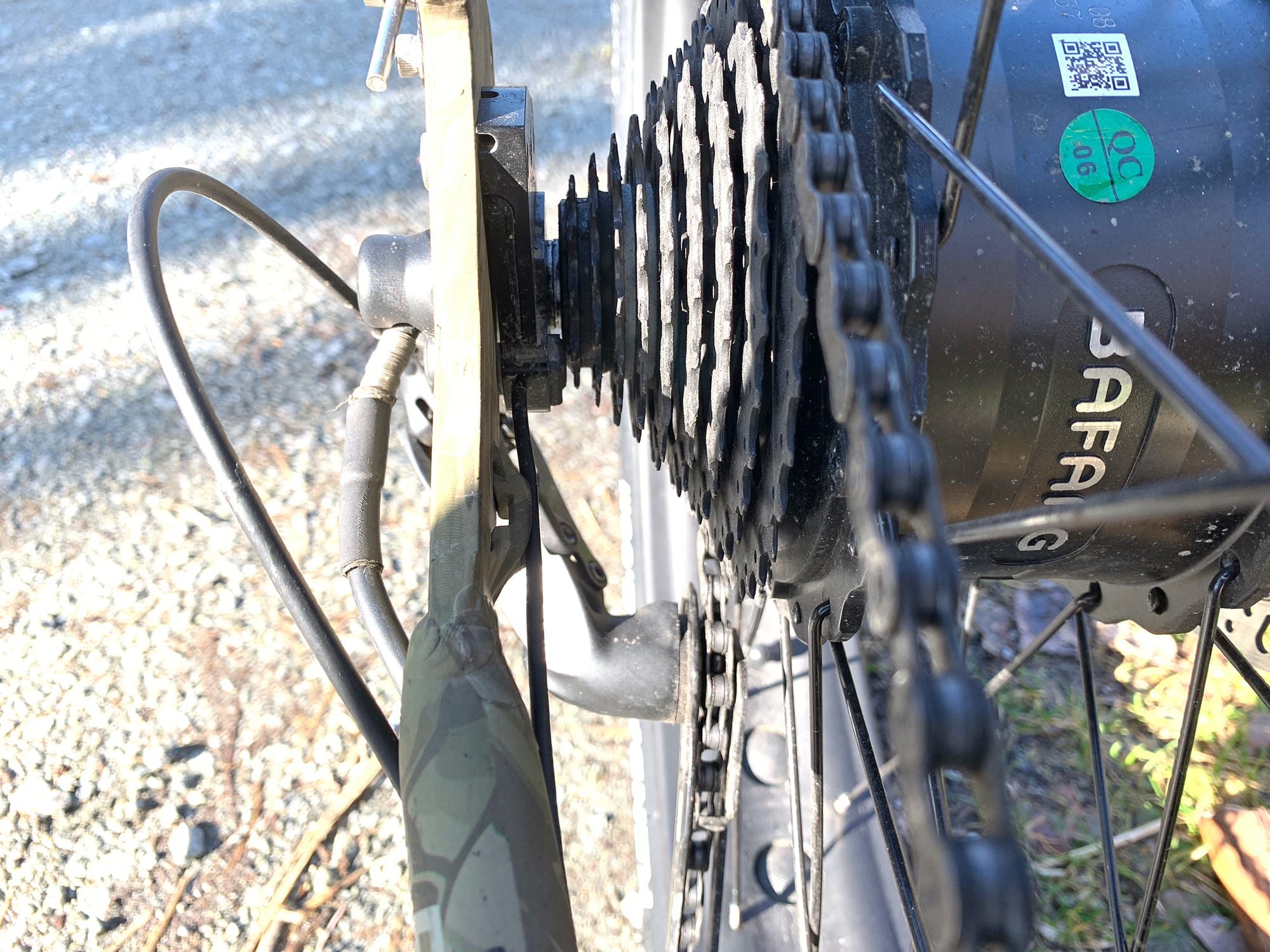

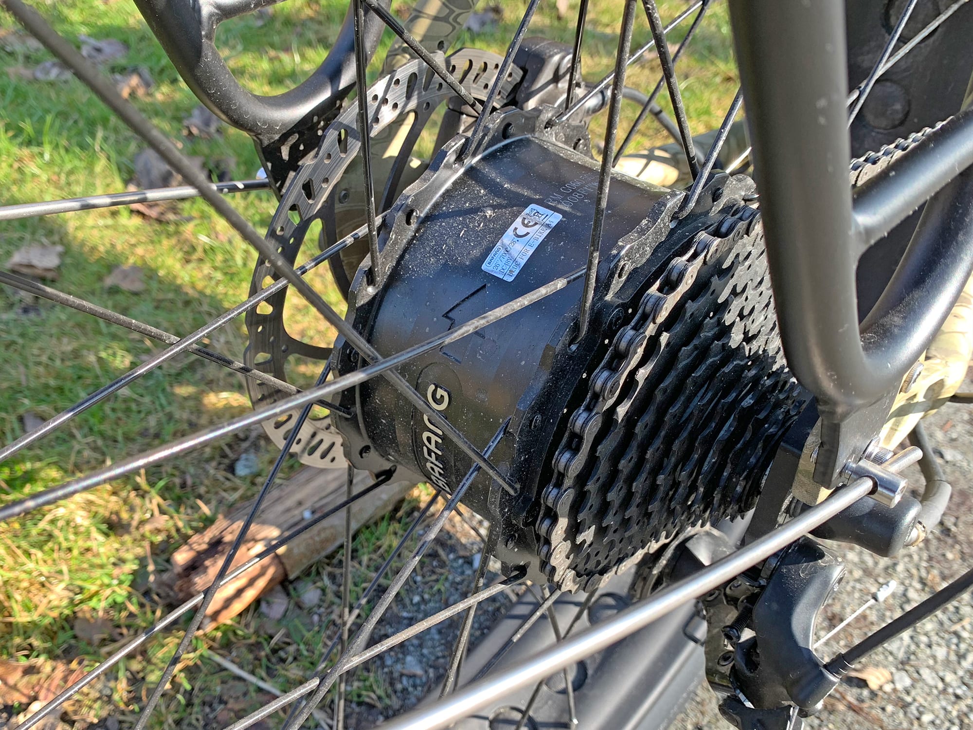

  • The motor mounts to the rear dropout using a keyed axle and slotted washer. It seemed reliable while riding, but I didn’t see any additional torque arms to spread axle pressure out into the frame. This is an area where durability and reliability could be improved, given the power of the motor and weight of the rear wheel. If the rear axle isn’t kept tight, it could rock back and forth and chew into the aluminum alloy frame over time

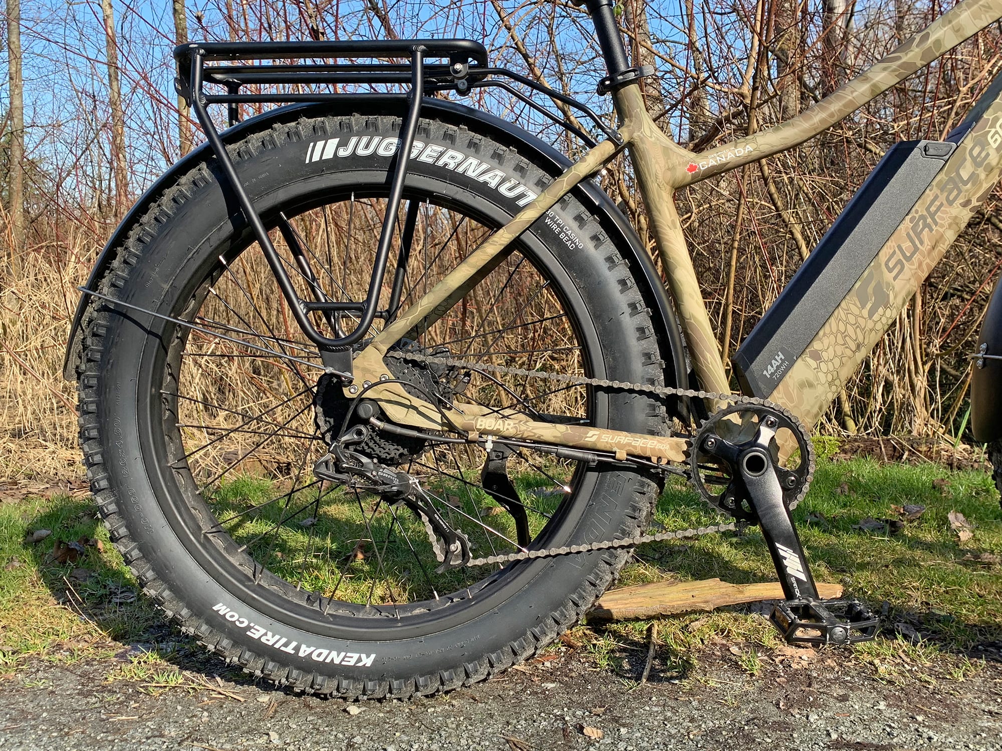

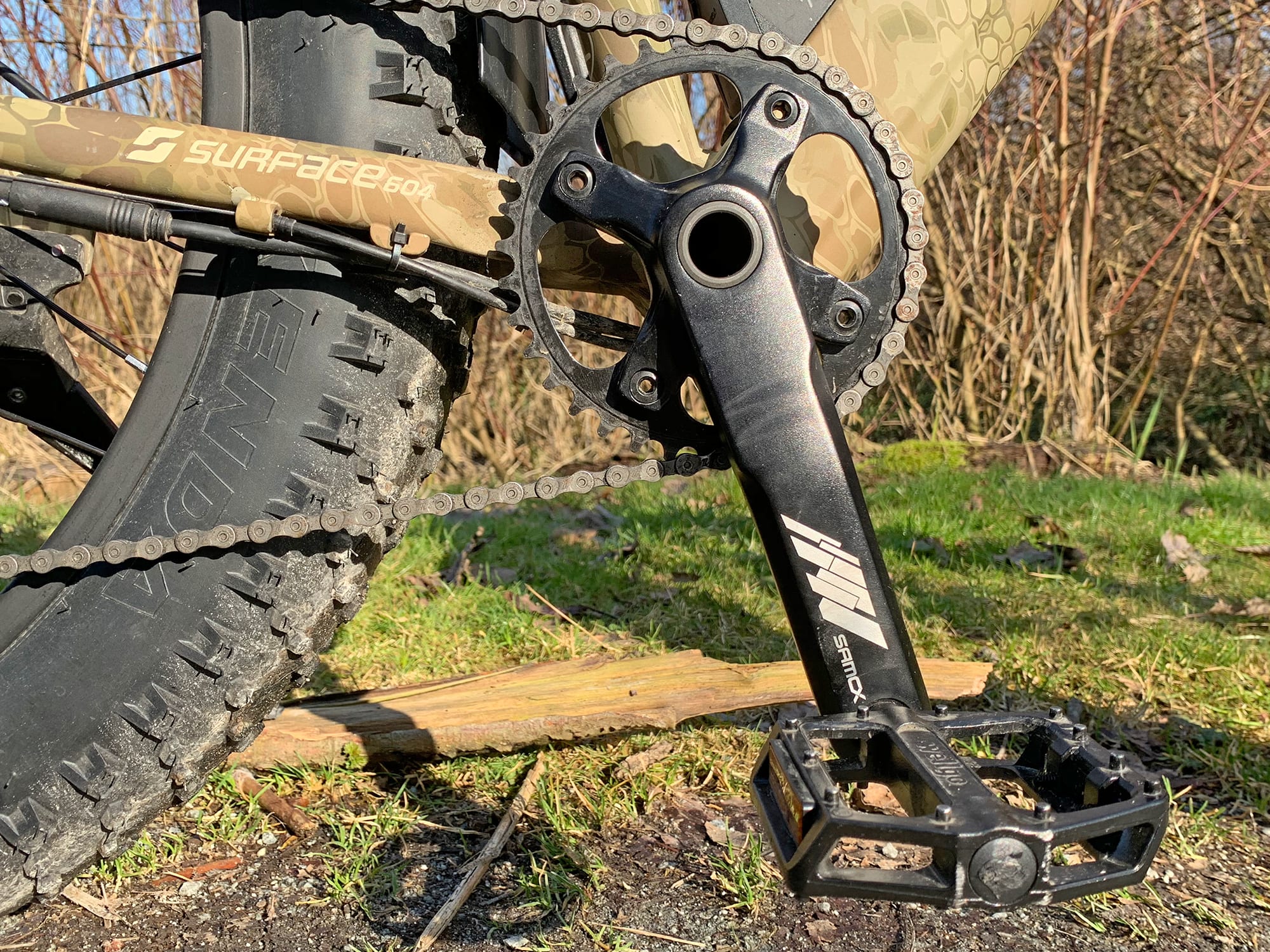

  • The chainring doesn’t use a narrow-wide tooth pattern (which would lock the chain on more reliably), and there’s no chain guide system (plates or a plastic guide), so I feel that the chain could bounce off more easily on this bike… and I’d consider finding an aftermarket 34 tooth narrow wide chainring as an upgrade or a cheap plastic guide like this
  • There’s no chain protector, so your pants could get dirty or snag on the chain and chainring. I also didn’t see a slap guard for the chain stay. This means that the paint could get chipped up over time, but the alternative (a shiny clear sticker) could reduce your camouflage. Consider a neoprene wrap slap guard if you want… but know that nicks on the chainstay won’t cause rust and shouldn’t impact the structural integrity of the bike

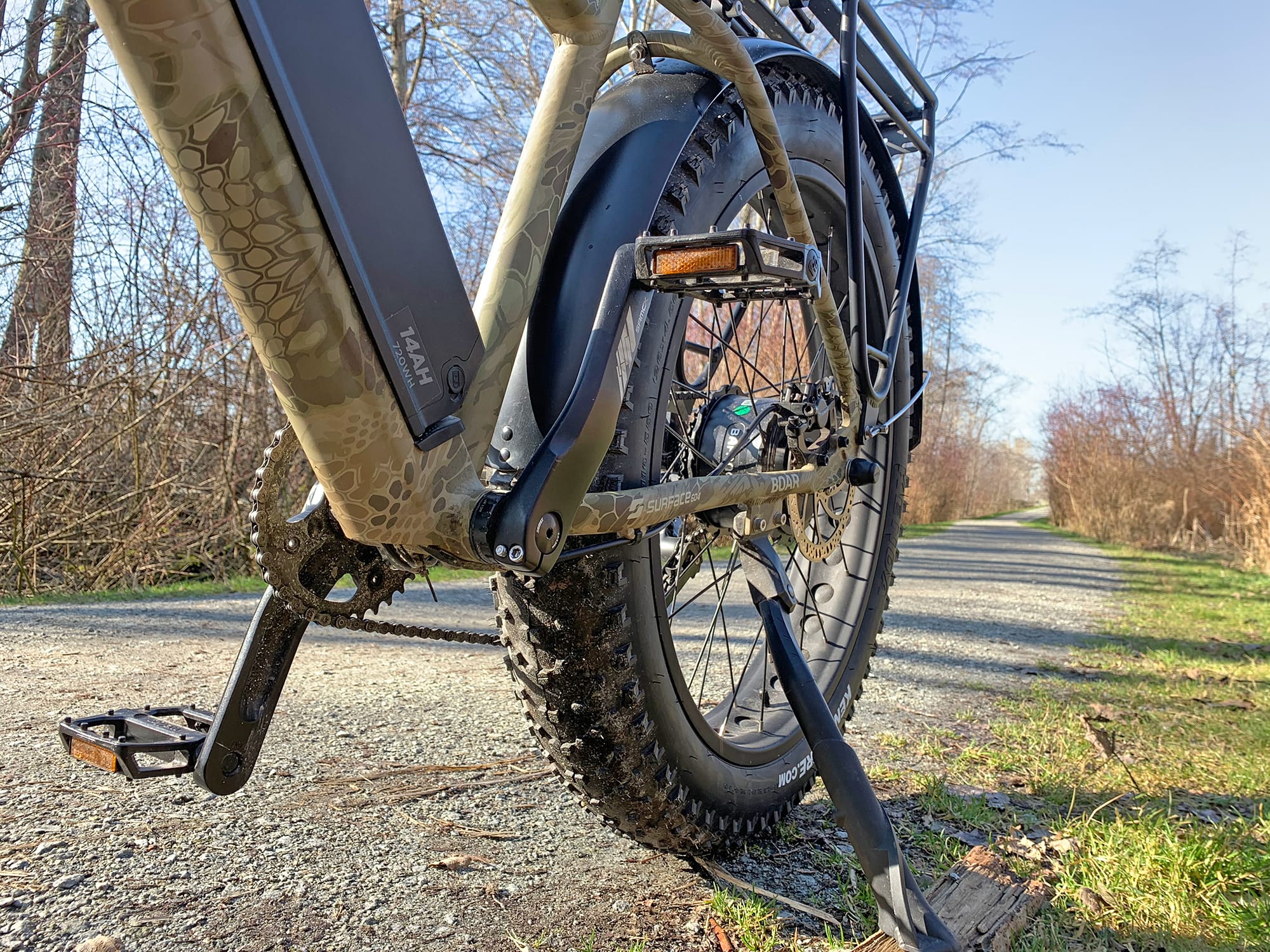

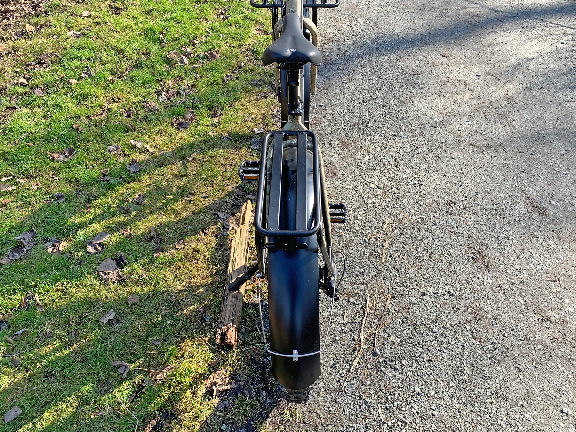

  • The optional steel fenders are pretty nice, but they do produce a bit of noice when riding over bumpy terrain. The rear fender doesn’t mount to the rack near the middle, and seemed especially bouncy there. Steel is sturdy, but if it gets scratched, it can rust vs. aluminum or plastic
  • The front rack design is pretty cool, especially with the standard gauge tubing on the sides for panniers, but it is fork attached vs. frame attached. This means that it adds weight and momentum when steering, and the cargo could tip out as the fork swivels to the side while making sharp turns or parking the bike. It’s probably best used for lightweight gear like clothing or sleeping bags

  • It’s a minor thing, but I appreciate the two-way high lever shifter design that Shimano offers on their products while SRAM seems to only have a one-way high trigger. On the plus side, the low lever offers four-shift action to really dump the gears, and you won’t mash gears on this bike very easily because it uses a hub motor vs. mid-drive

  • The rear derailleur and power cable (that feeds into the axle) are a bit vulnerable on all bikes, but that really comes to mind here because of the off-road use case. I would like to see a derailleur guard at the back to help protect these delicate parts
  • The included ebike battery charger leaves something to be desired because it only puts out 2 Amps (vs. 4 Amps on some competing chargers) and the plug-in spot on the battery is very close to the left crank arm which means you could snag the wire or bend the end piece if you trip over it. You’ll have to go to the non-drivetrain side of the bike and bend over to reach the charging port… minor complaint, but worth highlighting
