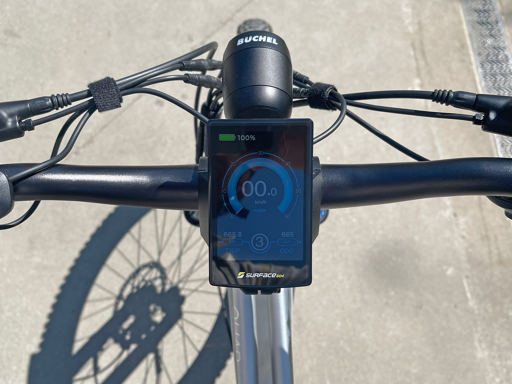

Independent Button Pad near Left Grip, Buttons: +, -, Information, Lights, On/Off, (Hold - for Walk Mode, Hold + and - for Settings Menu, Settings Password 1212, Speed Limit Password 0510)
Battery Percentage, Current Speed (With Infographic), Power Meter, Trip Distance, Odometer, Max Speed, Avg Speed, Trip Time, Assist Level (0-5)

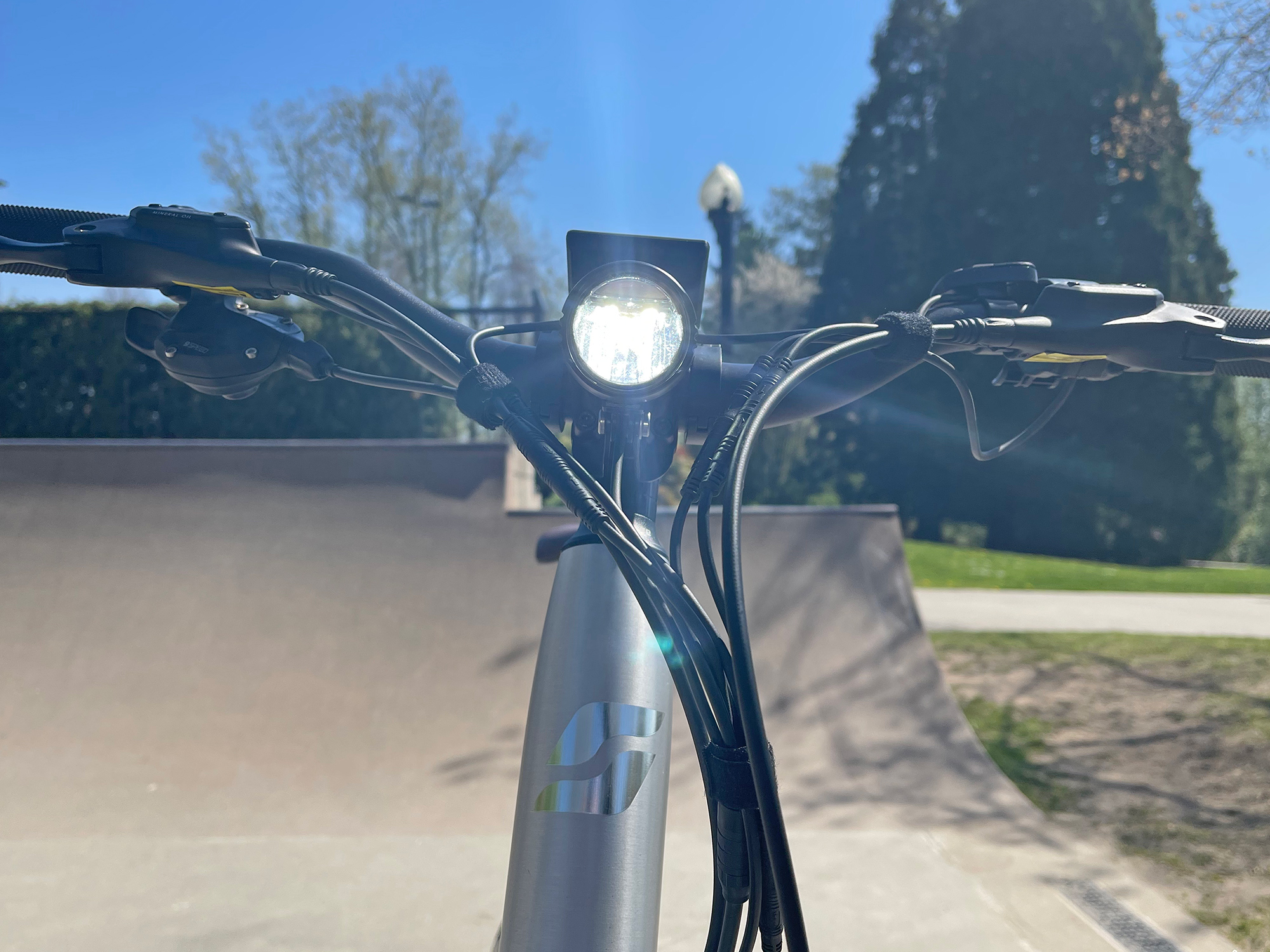

  • The headlight they chose is quite bright, and has side windows to improve your visual footprint. Normally, headlights are mounted lower down on the suspension arch which isn’t as safe and may vibrate more because that position is not suspended. S604 made a custom light bracket that mounts to the stem and it works great… points where you steer and the beam won’t get cut off by the fender or front tire.

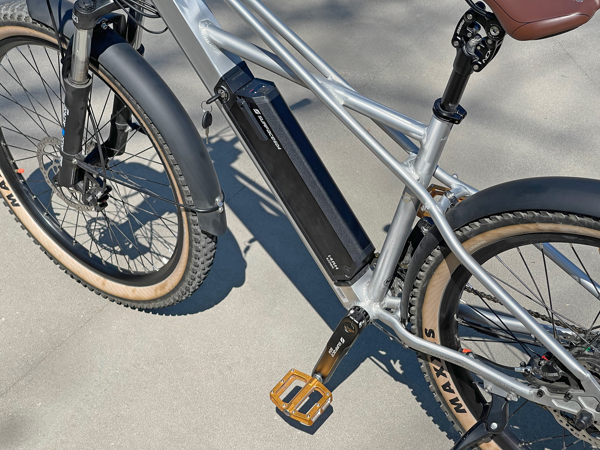

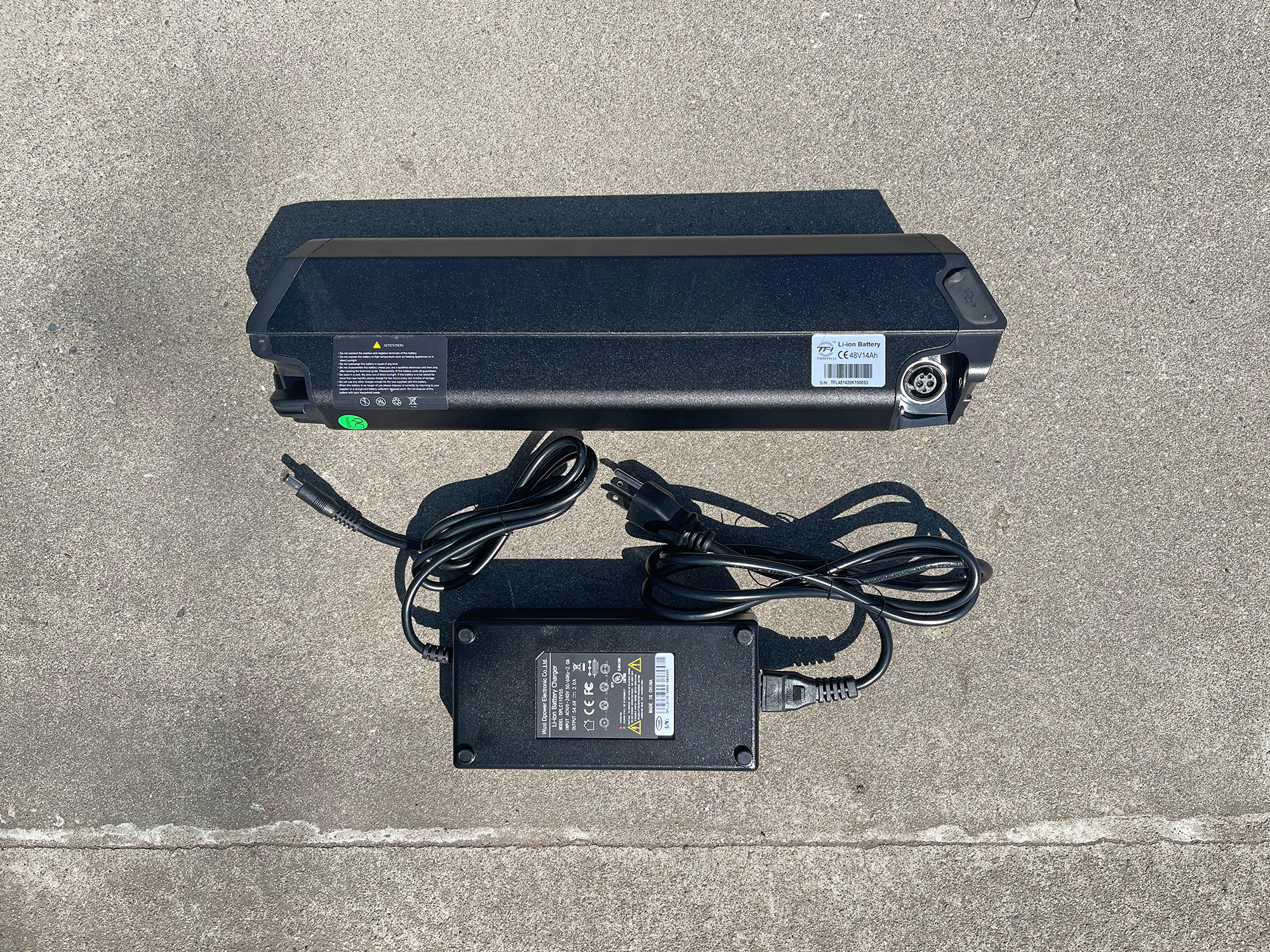

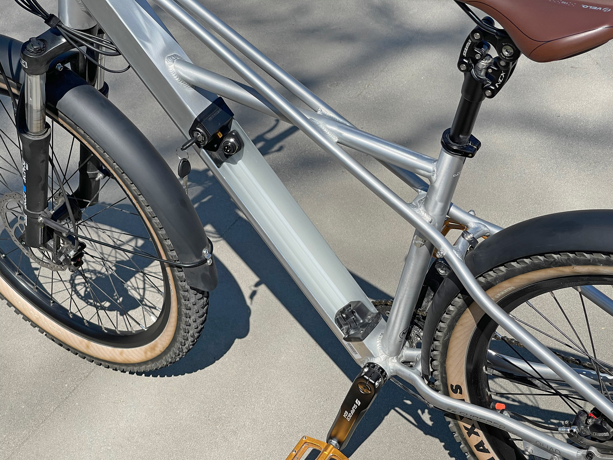

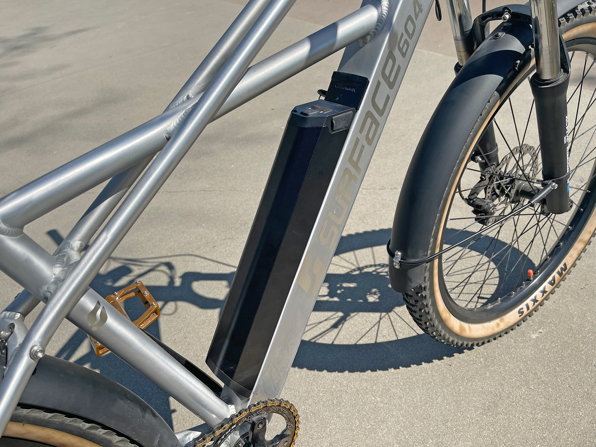

  • There are two battery options with this ebike, and the default 672 is above average! For a bit more money, you can upgrade to 960 watt hours to extend range (great if you plan to use the throttle frequently). I love that both battery packs have a built-in USB port for charging accessories, even if the battery is not on the bike. There is a second USB Type A port built into the base of the display, so you don’t have to run wires all over the bike if you add more lights or want to charge your phone… this is all great considering the extra energy the bike batteries both have.
  • My understanding is that many of the Surface 604 bikes now use the same Reention Dorado battery interface, so the battery pack can be shared! This is a more open battery standard, which means you can have the batteries repacked or purchase them from generic suppliers someday if S604 changes their design or goes out of business.

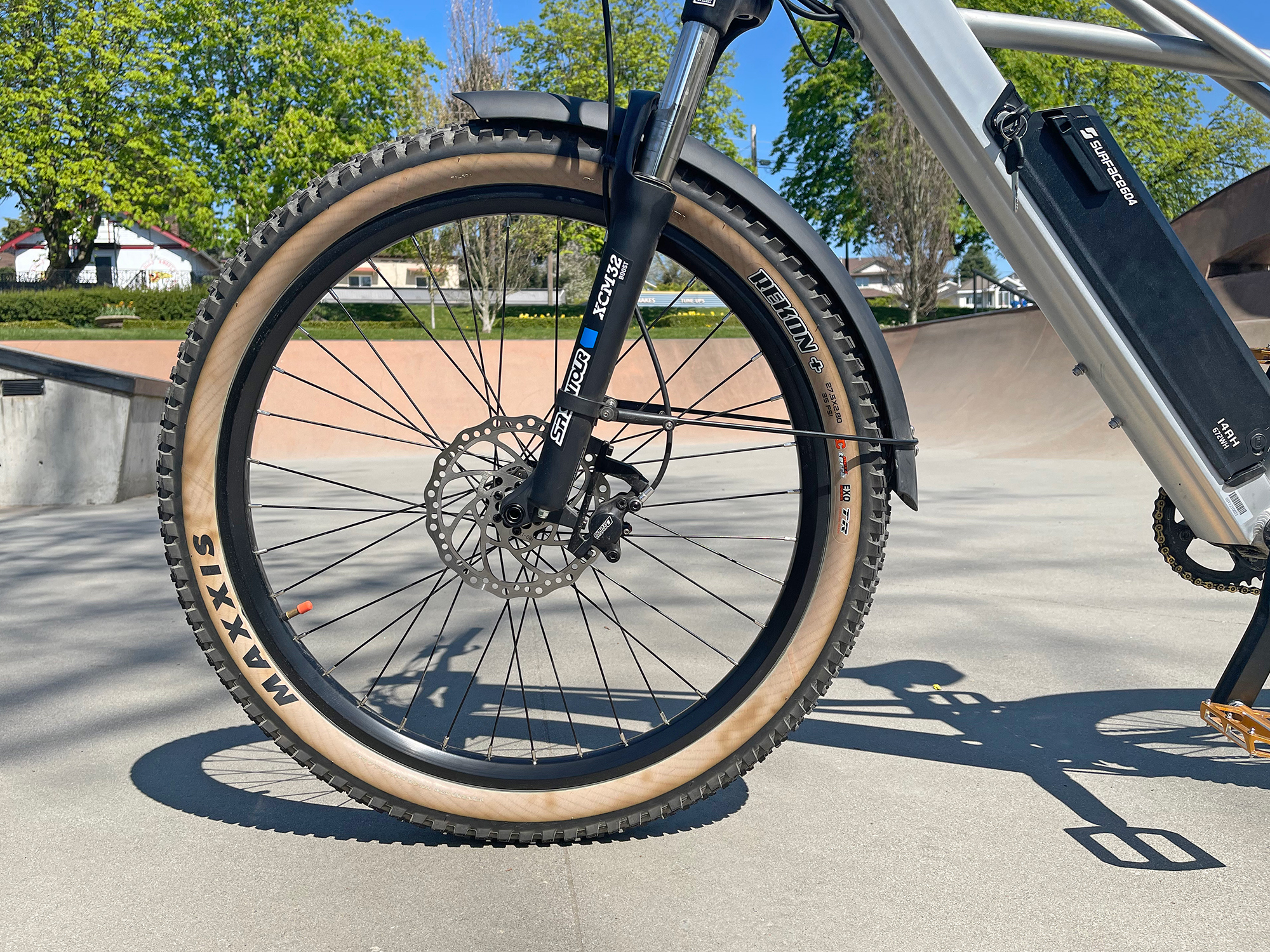

  • Pretty good suspension fork here, I love that it offers lockout and preload adjust to “pre load” the spring for heaver riders. The sturdy 15mm thru-axle is a big upgrade from 9mm axles that use quick release, and the wider 110mm Boost hub spacing improves spoke bracing angle and strength. The front wheel has 13mm spokes and the rear appears to be 12mm which is even thicker. The wheels are super sturdy and use 36 spokes, so they should be capable of handling heavier riders and heavier trails.

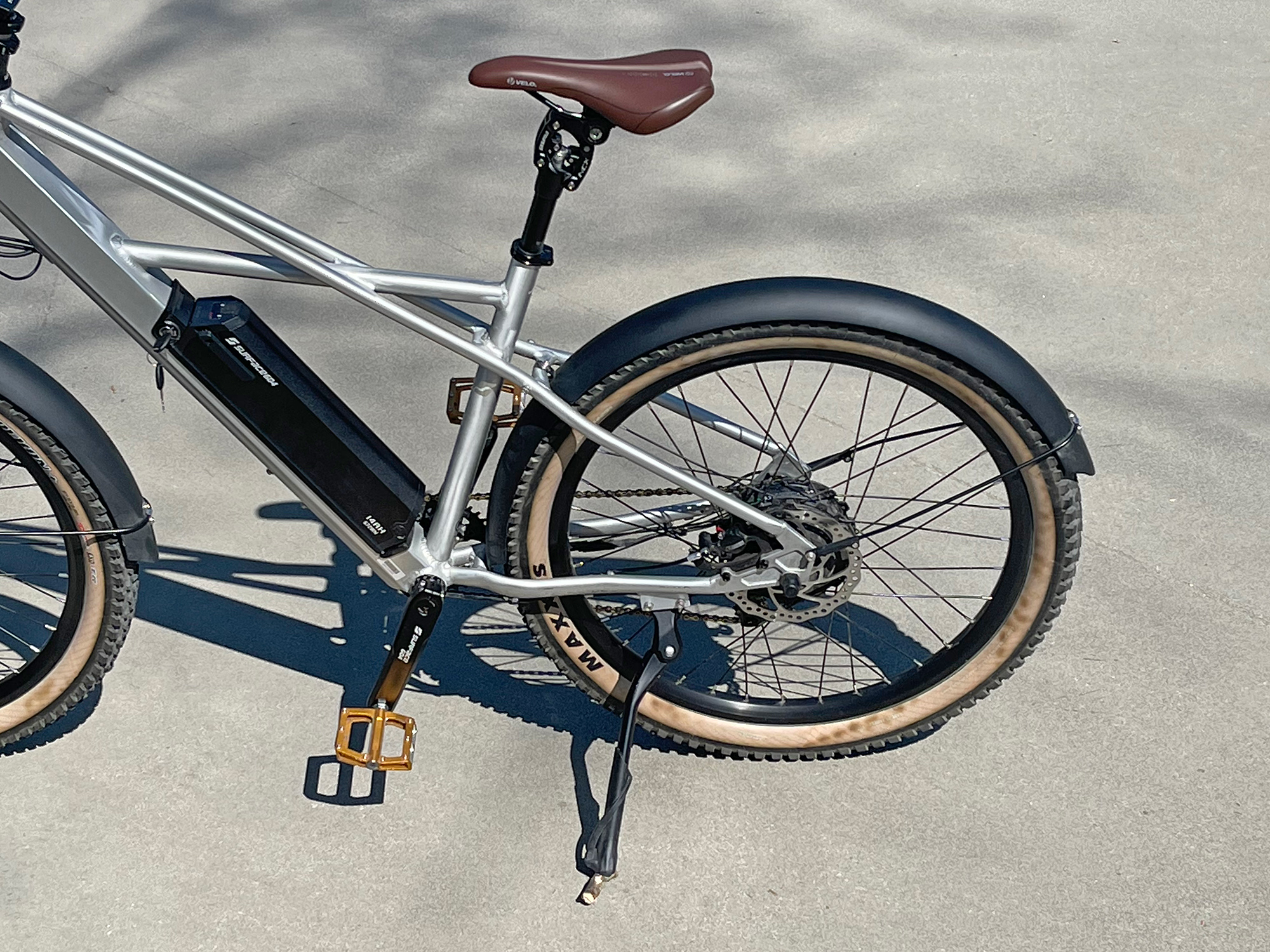

  • Good weight distribution with the battery pack low and center. The spring fork weighs a bit and balances out the rear hub motor. High-step diamond frames tend to be sturdier and stiffer than mixte mid-step or step-thru, so the bike should perform without flex or failure with 300lbs of total weight onboard.

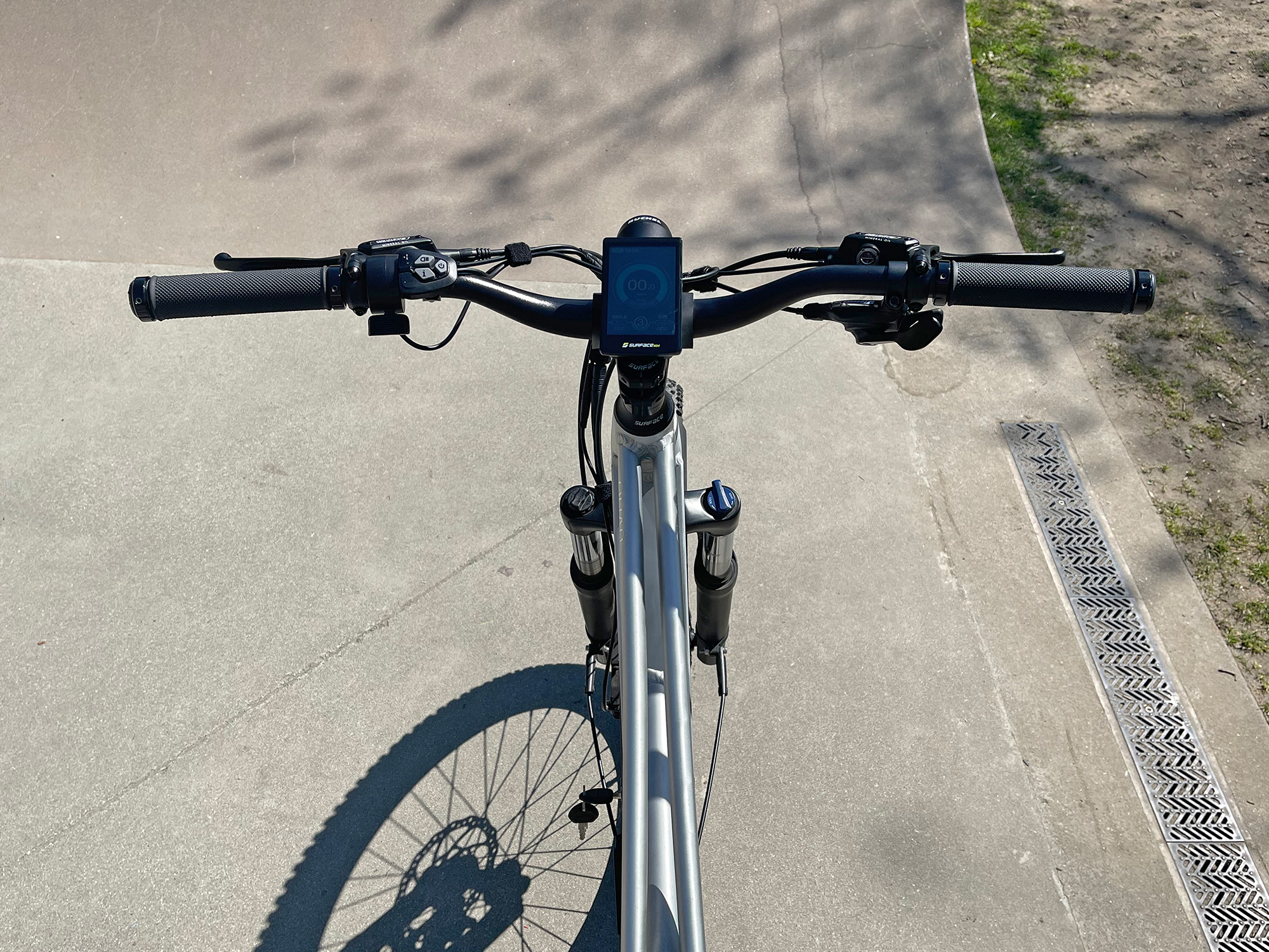

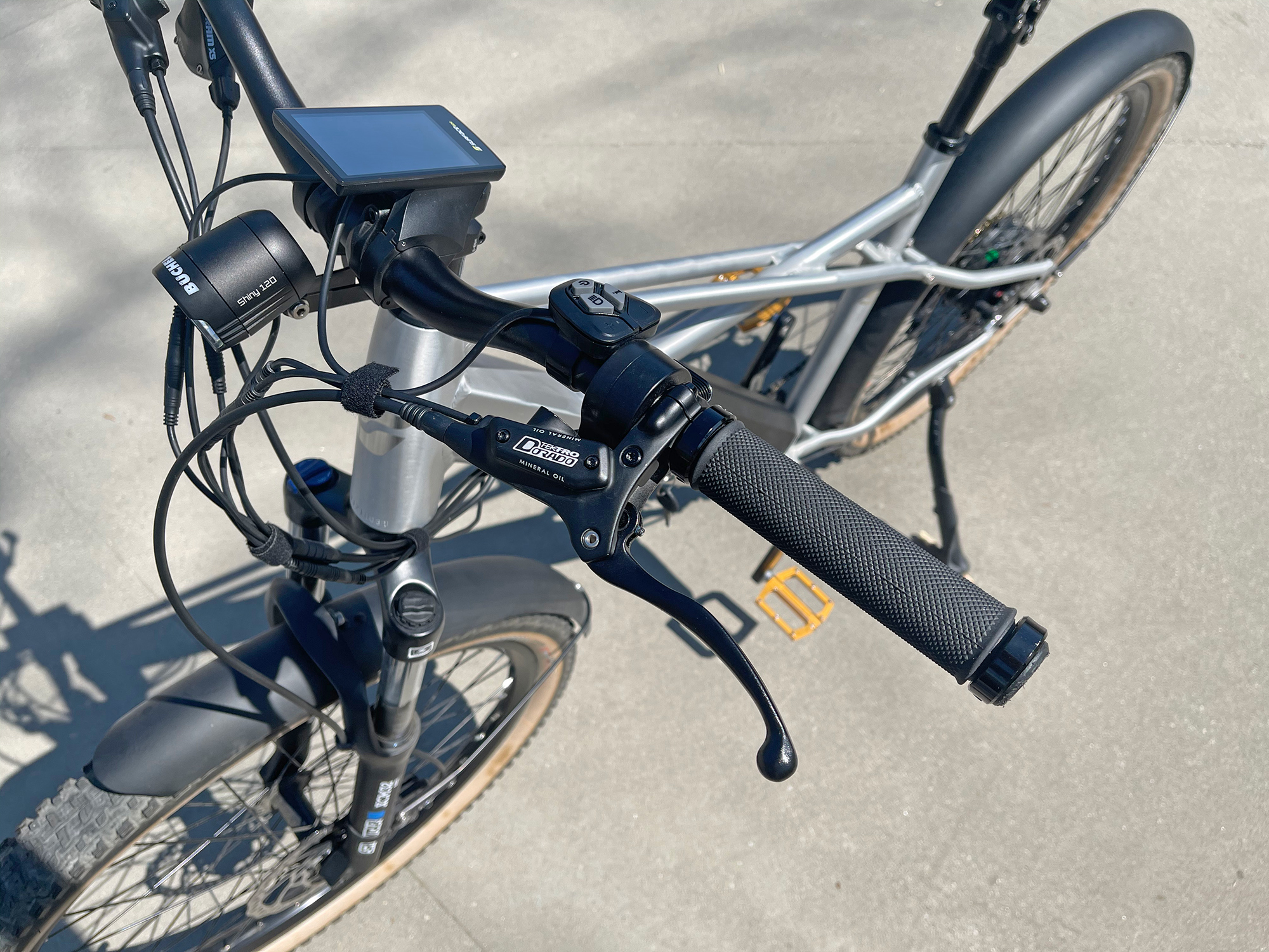

  • The LCD display is large and fairly easy to read, it offers adjustable angle to reduce glare and has the USB port in the bottom. I appreciate that the button pad for it has a dedicated lights on/off button and info button. You can get into the settings fairly easily by holding + and – simultaneously and S604 has codes that let you unlock higher speeds if you wish. Both the button pad and trigger throttle are fairly easy to reach and intuitive to operate.

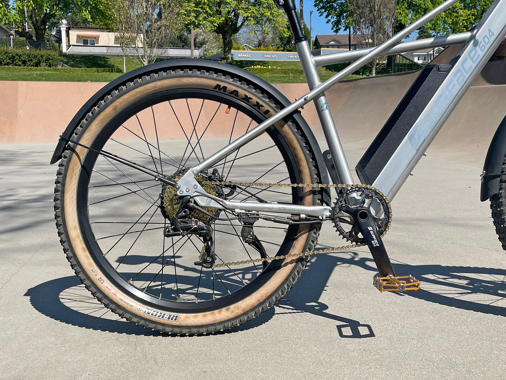

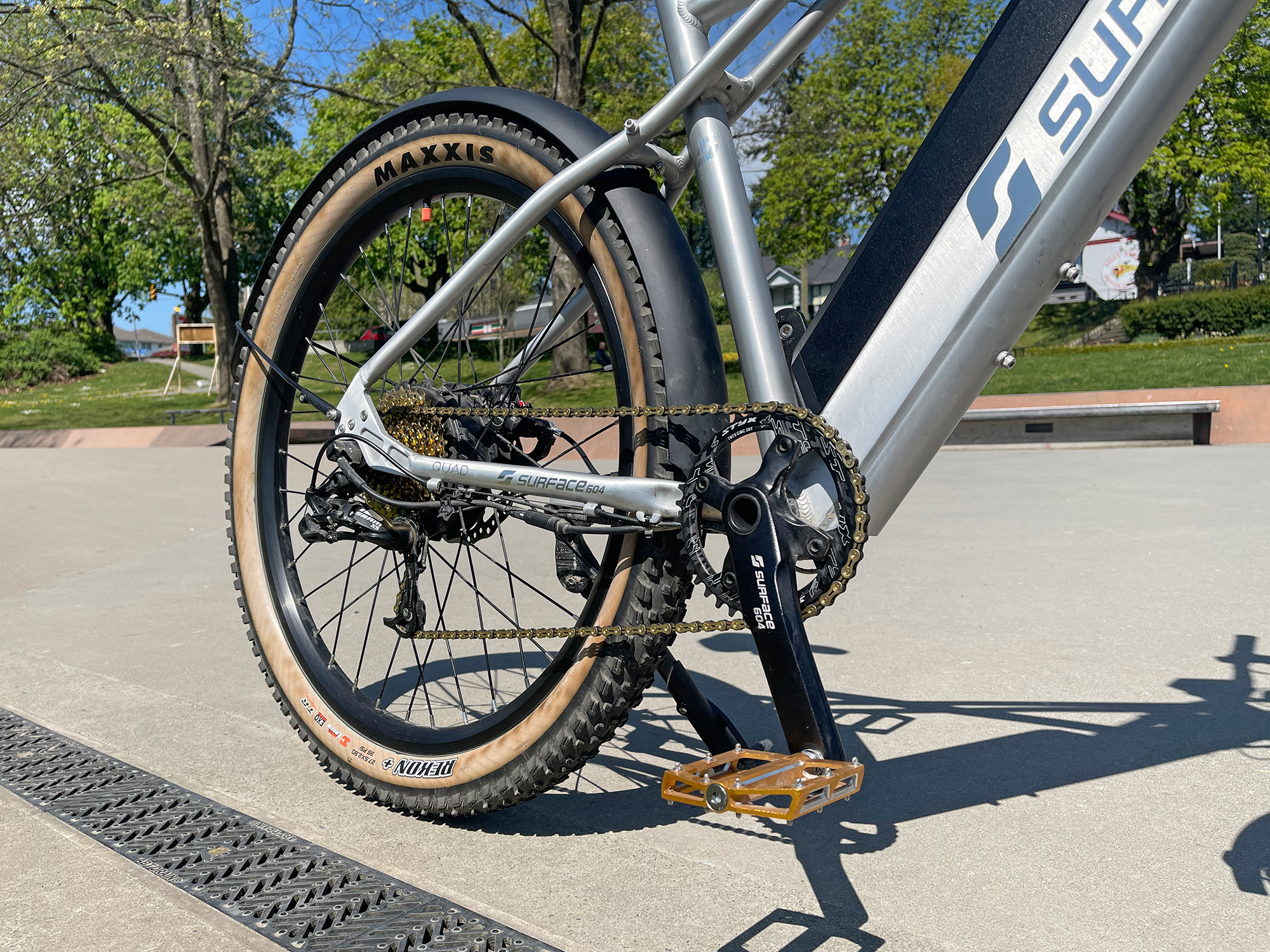

  • Speaking of off-road, not only are the chain and cassette upgraded (with a wide 11 to 36 tooth cassette painted gold) but the chainring uses a narrow-wide tooth pattern that grabs the chain more securely so you don’t drop it when riding on bumpy sections of trail. It’s a clean lightweight way to improve the drivetrain vs. a full guide.

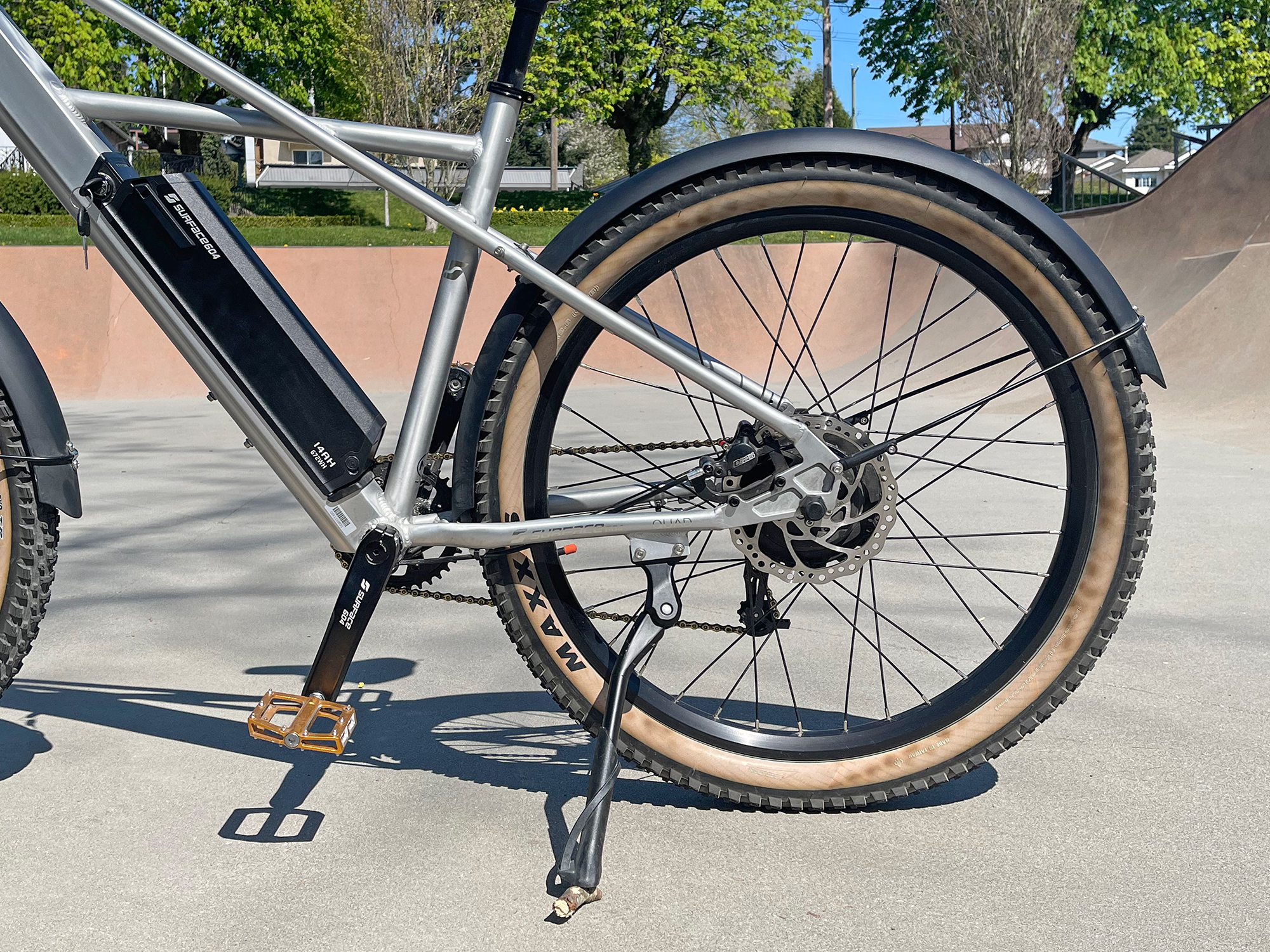

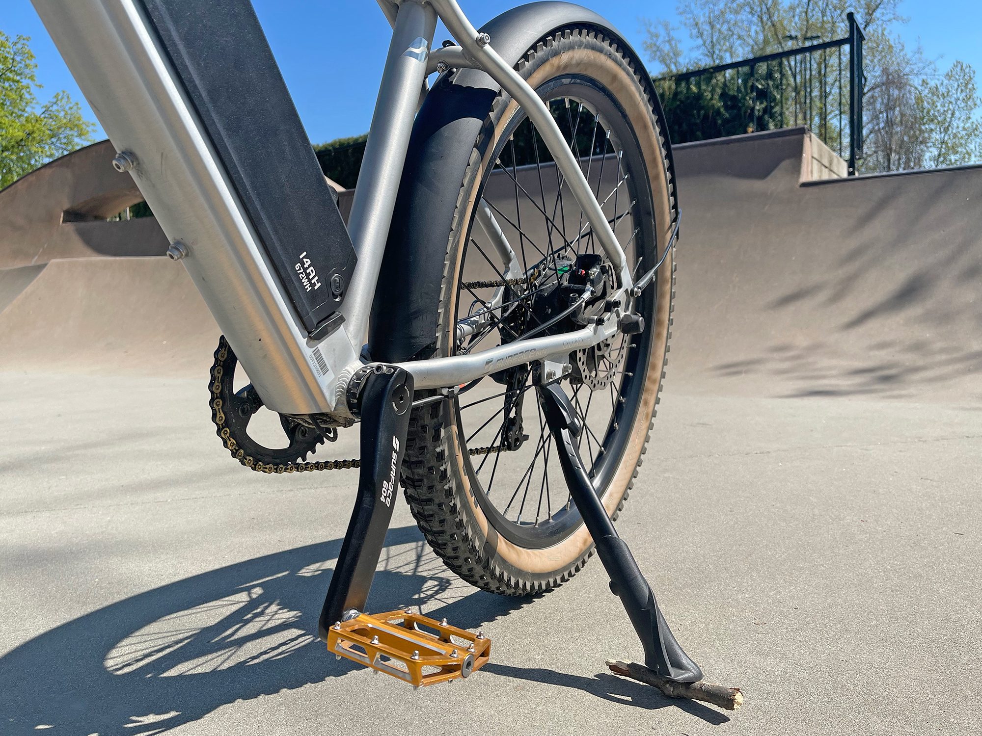

  • I appreciate the kickstand choice here, because it offers adjustable length. It’s mounted using a standard 40mm bolt spacing, which makes it easy to replace. They positioned it far enough back that it won’t cause pedal lock when backing the bike up, and it should support a loaded rear rack well.
  • The large 27.5″ x 2.8″ plus sized tires offer a larger contact patch that improves grip, float, and stability. It’s a popular size for ebikes because the additional weight and drag are more than offset by the motor. These tires come tubeless ready if you wish to set the rims up, they are puncture resistant, and have the stylish brown sidewall. The larger overall diameter is close to 29″ which offers a lower attack angle for easier rides over rough terrain.

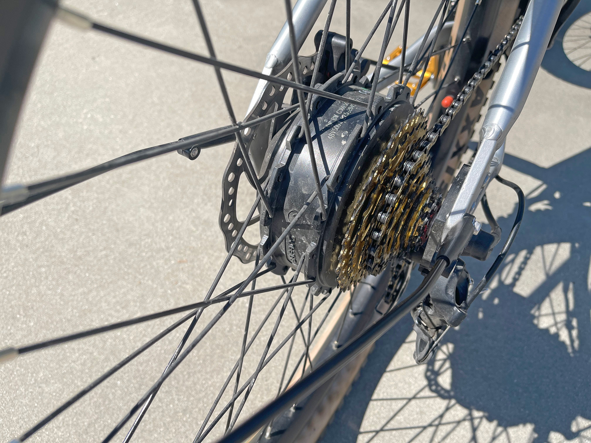

  • The hub motor is fairly quiet considering the higher 65 newton meters of peak torque output. It’s rated at 500 watts nominal, but probably peaks out around 750 peak. The torque sensor design is very responsive to start, and more natural for mountain biking than a cadence sensor in my opinion, they say it is rated at 65nm of torque.
  • This is a minor thing, but the brake levers both offer adjustable reach for improved fit, and I suspect that they activate the rear light if you get that as an option with the rack (at least this is the case for their city models like the Surface 604 Rook and Colt).

  • The battery locking cylinder and charge port are both on the non-drivetrain side of the bike, which is more vulnerable since it leans that way when on kickstand. The charge port is low, and exposes the charging cable to the left crank arm. You have to bend down to plug it in, and the bike leans towards you. I’d prefer both of these to be high on the right side of the bike for easy access and reduced snag potential.

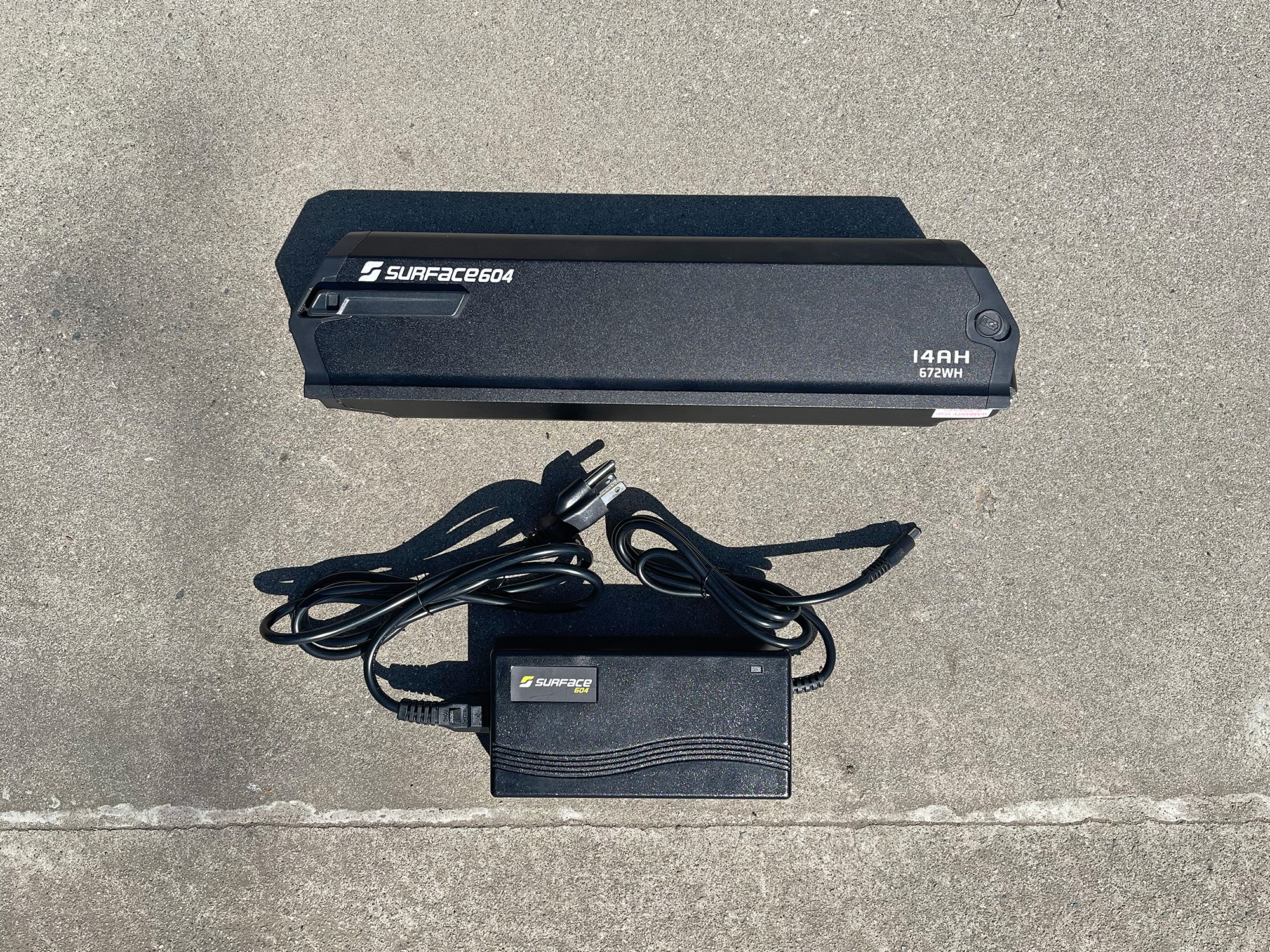

  • The charger for this ebike is pretty basic, though I do appreciate the branding they did. It’s fairly compact, has a removable wall-side cord to reduce length, and it only weighs ~1.4lbs, but it only puts out 2 amps. This makes it slower than some of the 3 and 4 amp chargers I’ve seen from other companies, which is especially relevant if you get the upgraded 20 amp hour battery (960 watt hour) because it could take 7+ hours for a full charge. I’ve also heard that the barrel style charger plugs can ark easier or crack the plug socket if bumped.

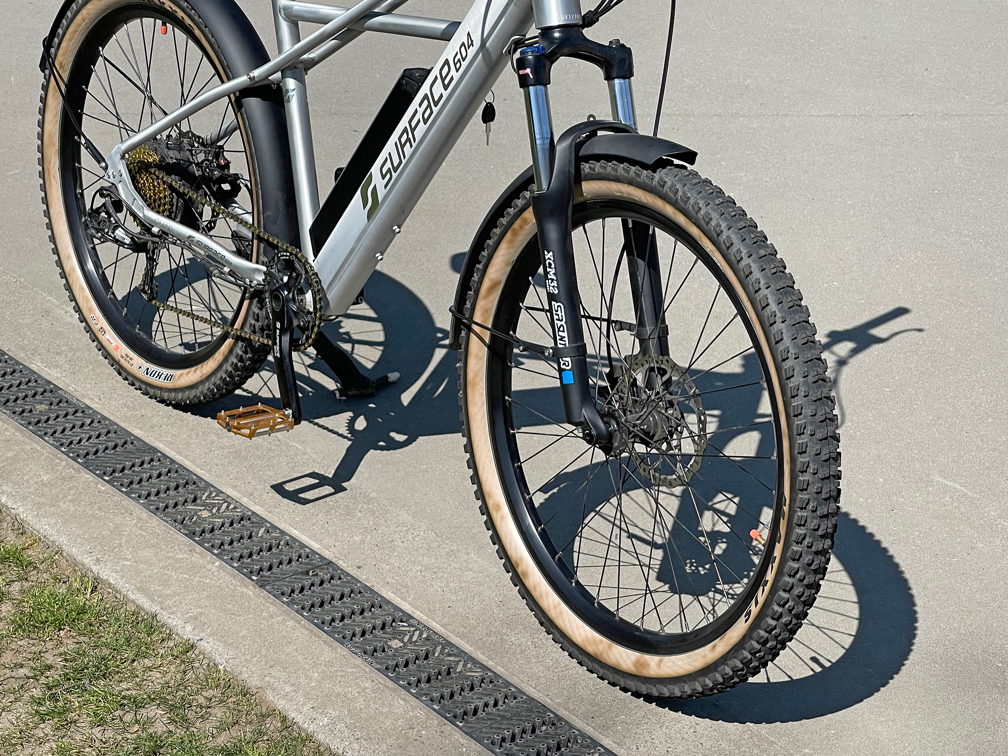

  • The fork they chose is pretty decent and kind of unique, because it’s a 15mm thru-axle with boost but because it’s using a straight 1-1/8″ steer tube vs. tapered 1-1/8″ to 1-1/2″ you may struggle to replace or upgrade it with an air fork to reduce weight and add tuning options like rebound, you might have limited options.
  • If you opt for the upgraded 48 volt 20 amp hour 960 watt hour battery pack, you will notice that it spills out to the left side a bit and is not perfectly centered on the frame. This bugs me a bit aesthetically and may slightly impact the balance of the frame.

  • The control pad is mounted behind the trigger throttle on the left, and I found that it took a bit more flexibility and effort to reach in this configuration, you could always change the order, but then the throttle would be tricky to reach, you could also try to put the throttle on the right portion of the handlebar but then it will interfere with the trigger shifters, maybe a future throttle mount will be narrower so the buttons can move closer…
