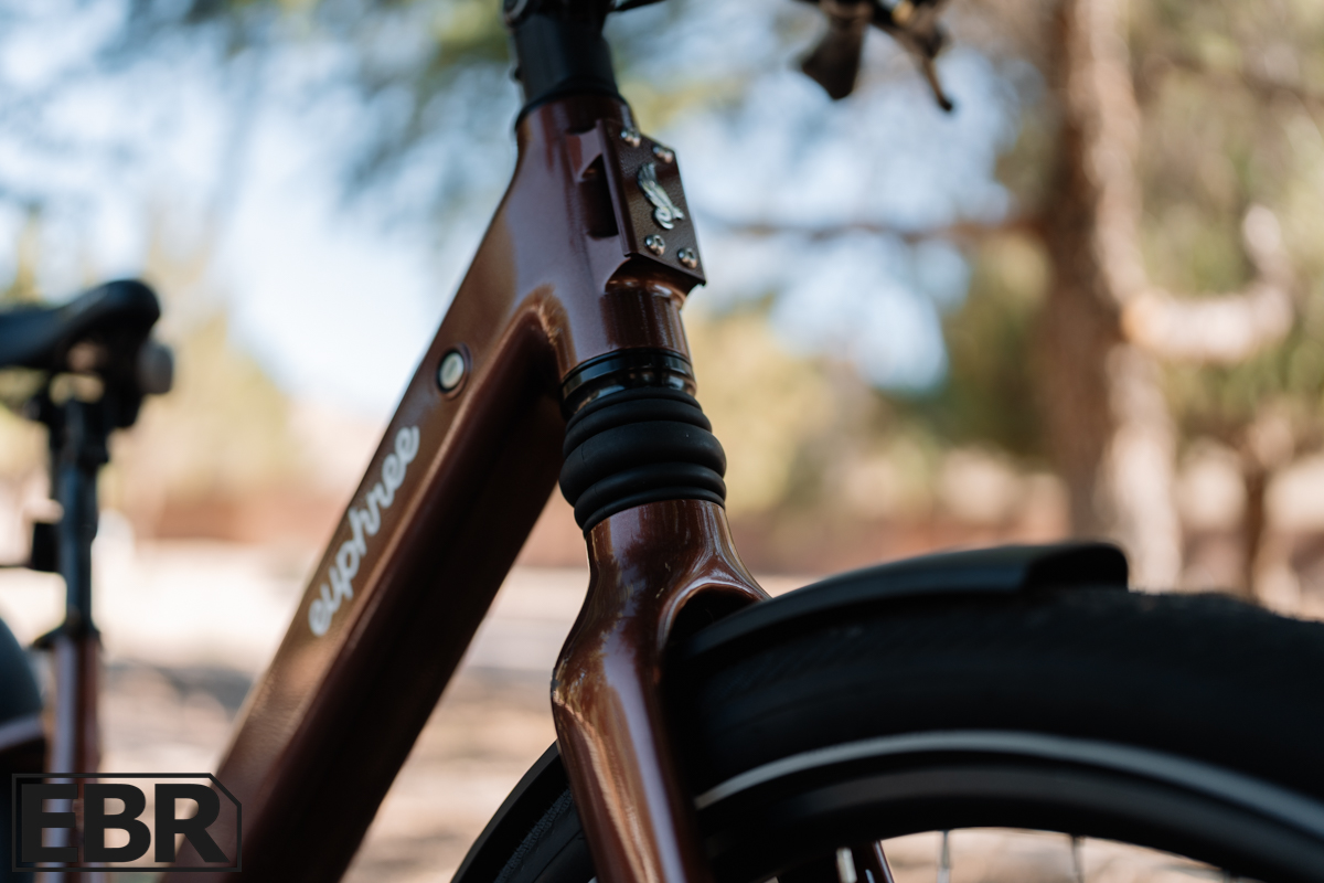

Right off the bat, the Solar Sparrow sets itself apart with its unique Uni-Fork suspension built into the headtube, delivering 30mm of travel. Unlike the heavier, more common suspension forks you see on other commuters, this keeps the bike’s weight down to just under 60 lbs fully loaded, pretty light for an ebike with a rear rack, fenders, and lights. The step-through frame, with a 16-inch standover height, makes hopping on and off a breeze, especially for riders worried about stability or coming back to biking after a long break.

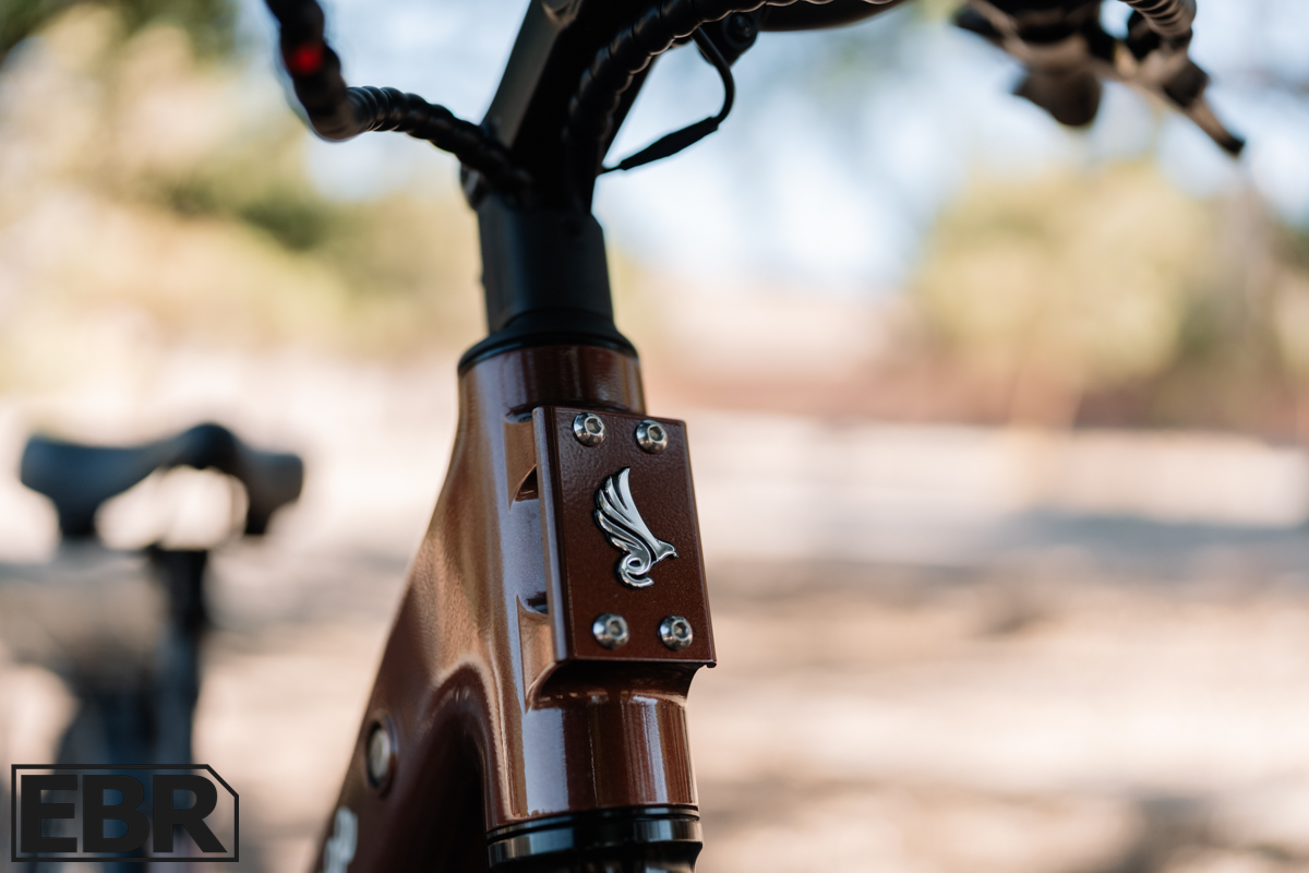

The ride is upright and relaxed, with swept-back handlebars and a 90° adjustable stem that lets you dial in the reach for your comfort. Euphree says the one-size frame fits riders from 4’11” to 5’10”, but at 5’11”, I felt it was just a touch small. It was still rideable, mind you, but taller folks might want to test it first. The combo of the Uni-Fork, SR Suntour NCX suspension seatpost, and a wide, cushy Velo saddle makes comfort the star of the show. Whether you’re cruising over cracked city pavement or dodging potholes, this bike soaks up the bumps without feeling sluggish.

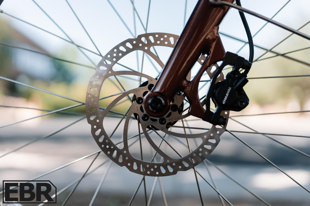

The 26” x 2.4” Kenda Kwik Six tires roll fast and quiet, with enough grip to handle wet or rainy commutes confidently. Reflective sidewalls add a nice safety touch for dawn or dusk rides. Braking is handled by Tektro E350 hydraulic disc brakes with 180mm rotors, which deliver strong, reliable stopping power for a bike this light. No complaints there, they get the job done with confidence.

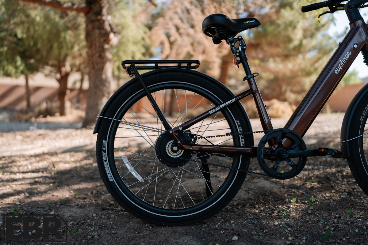

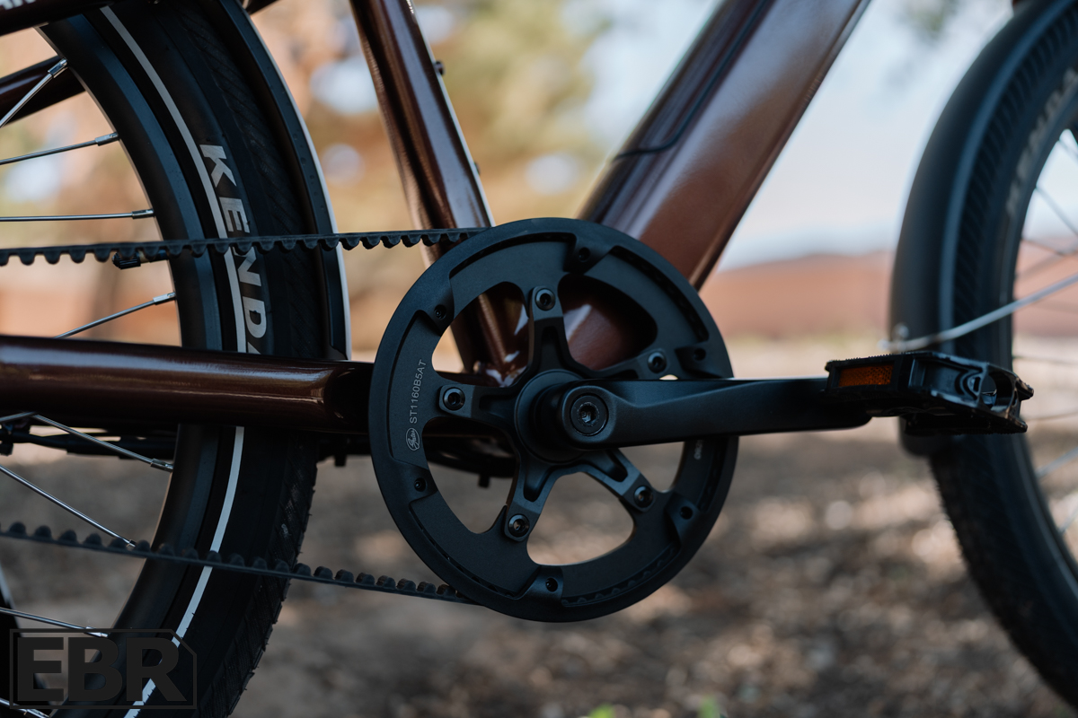

The Gates Carbon Belt Drive is a highlight. It’s whisper-quiet, grease-free, and practically maintenance-free, which is a godsend for anyone who dreads cleaning chains or tweaking derailleurs. The single-speed setup is geared well for flats, letting you pedal easily without assistance, and it holds its own on moderate hills with the motor’s help.

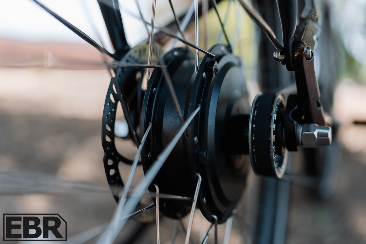

Speaking of power, the 500W Bafang rear hub motor pumps out 75Nm of torque, giving you a smooth, punchy ride up to 28 mph. What’s cool here is the dual sensors, cadence and torque, that you can toggle between. For folks stuck in ebike analysis paralysis, this is a win, letting you experiment to find what feels best. I leaned toward the torque sensor for a more natural, responsive ride.

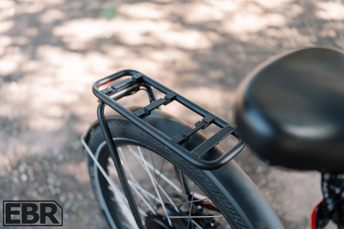

On top of that, the Solar Sparrow comes loaded with practical extras: a 200-lux dual-beam LED headlight, a rear light that brightens when braking, a sturdy rear rack (up to 50 lbs), and full fenders. The color LCD display is clear, and there’s even a USB-C port for charging your phone. It’s smooth, quiet, and comfy, a triple threat for city commuting that feels ready to roll right out of the box.

The Solar Sparrow’s heart is a 500W Bafang rear hub motor kicking out 75Nm of torque, a solid setup for a lightweight ebike like this. That torque gives it plenty of pep for quick acceleration and tackling moderate hills, making it feel lively without being overkill. It’s not going to outrun performance-oriented bikes with beefier motors, but for everyday riders hitting city streets or bike paths, it’s more than enough to get you where you’re going with confidence.
The motor pairs with four pedal-assist levels (Eco, Tour, Sport, Turbo) plus a Walk mode, and there’s a thumb throttle that caps at 24 mph by default. If you want the full Class 3 experience, you can tweak the advanced settings on the color LCD display to unlock pedal-assist speeds up to 28 mph, which is a nice touch for those who want a bit more zip.

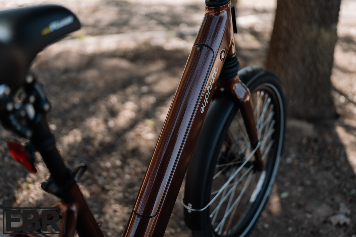

The battery is a 48V, 10.5Ah unit with 504Wh of capacity, SGS-certified to UL 2271 safety standards, so you can trust it’s built to avoid any fiery mishaps. It’s housed in the downtube and removable with provided keys, which is handy for off-bike charging, storage, or added security when locking up in public. At about 6 lbs, it’s light enough to carry without much hassle, though you’ll need to fiddle with a two-step unlock-and-slide process to pop it out. Charging takes around 5 hours with the included 2A charger, which is standard for a battery this size. For a commuter-focused bike, this power setup strikes a good balance between performance and practicality, keeping the Sparrow light and agile without sacrificing too much juice.

The star here is the Gates Carbon Belt Drive, paired with a single-speed setup that’s a breath of fresh air for anyone tired of greasy chains and finicky derailleurs. It’s got a 60T chainring up front and a 20T cog in the rear, giving a gear ratio that’s well-suited for city flats. You can pedal comfortably up to about 20 mph without assistance before it feels like you’re spinning out. The belt is silent, doesn’t need lube, and is rated to last over 10,000 miles, so you’re basically set for years. On moderate hills, the motor and torque sensor pick up the slack, but don’t expect to hammer up steep climbs without leaning on the assist, it’s a single-speed, after all.
Tektro E350 hydraulic disc brakes with 180mm rotors front and rear handle stopping duties. They’re responsive and powerful for a bike this light, with adjustable levers that let you fine-tune the reach. The motor cut-off kicks in as soon as you grab the levers, adding a layer of safety. These brakes don’t fade, even on longer descents, and they’re more than capable for city commutes where quick stops are common.

Comfort is king here. The Velo saddle is wide and well-padded, ideal for longer rides or casual cruises without leaving you sore. The swept-back handlebars encourage an upright posture, and the 90° adjustable stem lets you tweak the reach to avoid hunching. Polypropylene pedals are nothing fancy but get the job done, with enough grip to keep your feet planted. The grips are ergonomic and comfy, though I wouldn’t mind a bit more cushion for sweaty summer rides.
The Solar Sparrow’s standout feature is its Uni-Fork suspension, integrated into the headtube with 30mm of travel. It’s lighter than a traditional suspension fork and does a solid job smoothing out small bumps and vibrations on city streets. Pair that with the SR Suntour NCX suspension seatpost, and you’ve got a setup that takes the edge off potholes and cracked pavement without adding much weight. It’s not built for aggressive off-road trails, but for rides around town, it’s a smart, lightweight solution that keeps the ride plush.

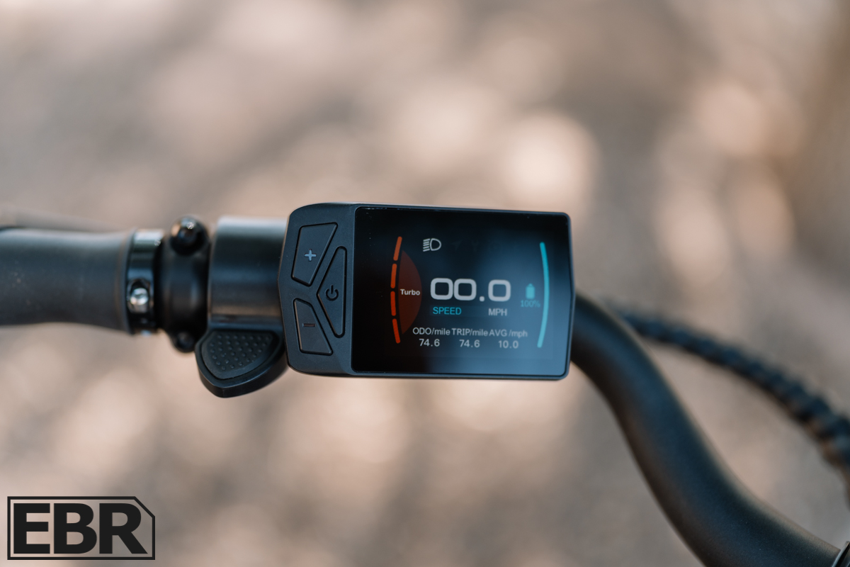

The Solar Sparrow’s color LCD display, mounted on the left side of the handlebars, is straightforward and functional, giving you what you need without overwhelming you with tech. It shows the essentials: speed, battery level, assist level (Eco, Tour, Sport, Turbo, or Walk mode), trip distance, total odometer, and power output in watts.
The screen is clear even in bright sunlight, and the buttons are intuitive for switching between assist levels or toggling settings like the cadence and torque sensors. You can also dive into advanced settings to unlock the full 28 mph pedal-assist speed (the throttle stays capped at 24 mph) along with many other aspects.
One neat feature is the Type-C USB charging port built into the display, letting you juice up your phone or GPS on the go, super handy for longer commutes or if you’re using your phone for navigation.
There’s no dedicated app for the Solar Sparrow, which is both a pro and a con. On one hand, it keeps things simple, you don’t need to mess with Bluetooth pairings or app updates, and Euphree emphasizes no user tracking for privacy, which is a nice nod to keeping your data your own.

You also get full metal fenders to fend off splashes, a sturdy rear rack rated for up to 50 lbs, and a 200-lux dual-beam LED headlight paired with a rear light. A 2A charger is included for the 48V battery, getting you back on the road in about 5 hours. These extras make the Solar Sparrow feel like a complete package, ready for daily commutes without needing to buy much else.
