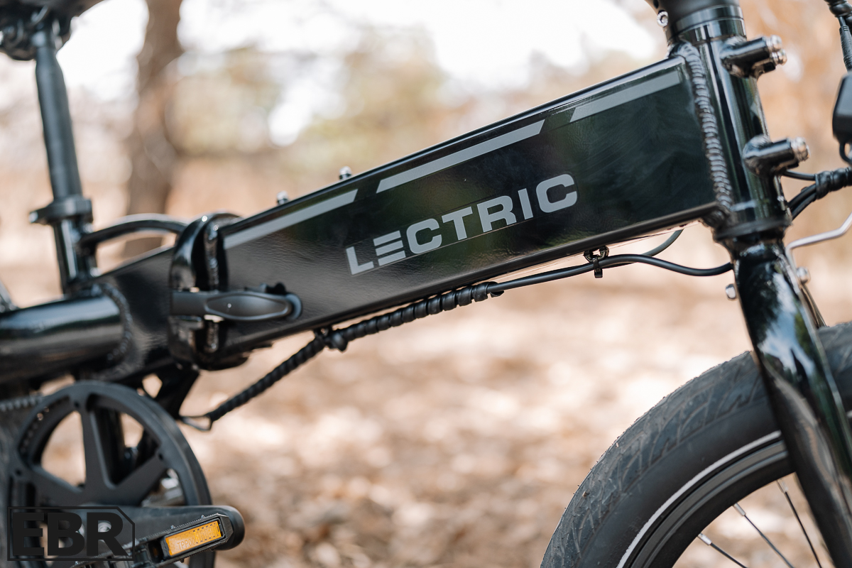

There are a lot of folding e-bikes that don’t feel particularly confidence-inspiring because the frame simply isn’t stiff enough. The Lectric XP Lite 2.0 doesn’t suffer from that; it has a very solid feel. There’s nothing on this e-bike that feels “cheap.” When people ask what’s the least-expensive e-bike that is good, this one is going to be way up there.

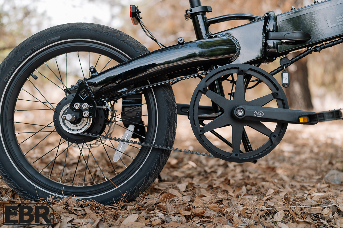

With a single-speed drivetrain, riders won’t have to worry about shifting, but with only one gear, that means that you’re pedaling slowly on the hills and spinning your legs like a windmill to hit 20 mph. The 52t x 16t gear has a sweet spot between 11 and 16 mph where it is easiest to pedal, but that means starting will require a bit more effort and reaching top speed means a certain amount of ghost pedaling.

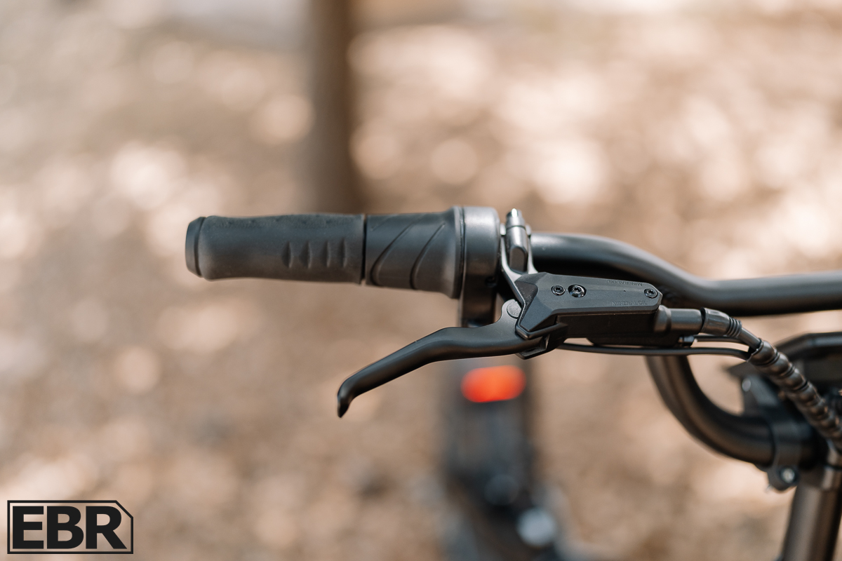

One of the big changes from the previous Lectric XP Lite to the XP Lite 2.0 was a brake upgrade, from mechanical disc brakes to hydraulic disc brakes, as well as changing from 160mm rotors to 180mm rotors. Our colleagues at Electric Bike Report found that the stopping distance for the XP Lite 2 was two feet shorter than with the original XP Lite.

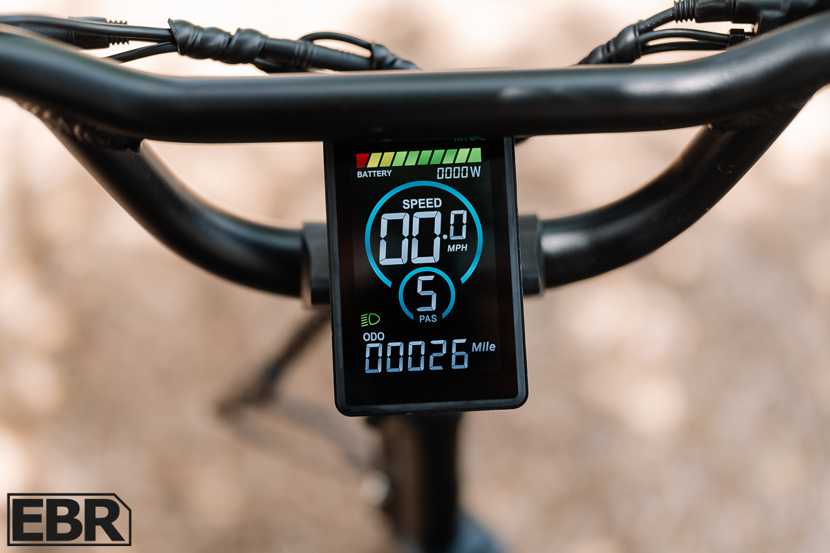

Lectric has introduced a new display for the XP Lite 2.0. This new display is color and is large enough to be easy to read. Riders can see current speed, PAS level, voltage, range, elapsed time, trip distance and odometer in a glance and riders can scroll through other data points, including average speed. Another interesting data point it offers is the real time power output of the motor in watts. This is a bit small and is likely to be hard to read for anyone who needs reading glasses, but it’s an interesting tidbit to check out.
We aren’t fans of displaying battery capacity as a series of bars; we would prefer to see battery life expressed as a percentage of total capacity. Granted, you’ll see that number go up or down in response to riding easier or more difficult terrain, which may be confusing to some riders, but we find it to be preferable to a less-detailed readout. That minor complaint aside, we have to say that we definitely prefer this display’s ten bars to some that only have four.

Because this is a single-speed e-bike—eliminating the shifter, derailleur and multi-geared freewheel saves both weight and money—Lectric offers riders the opportunity to order the XP Lite 2 with a Gates belt, rather than a chain. What this does is eliminate the need for chain lube—ever—as well as preventing black marks on clothing caused by a dirty chain. This option runs an additional $100. We think the upgrade is worth it, but we recognize that most buyers of the XP Lite 2.0 will be doing all they can to save money, not go for fancy extras, even if they are worth the money.
