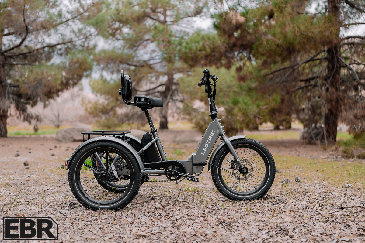

Hopping on the XP Trike reminded me why three-wheelers fill an important niche in the cycling world. Let’s be straight—this is primarily designed for riders with specific needs: folks dealing with balance issues, those rehabbing injuries, or riders who simply prefer the stability of three wheels on the ground.
True to Lectric’s approach, they’ve kept things streamlined with just one color and size option. It’s part of their formula for keeping costs reasonable, and while it limits personalization, it’s a fair trade-off for the price point.
Getting on and off is refreshingly simple thanks to the 13-inch standover height. The parking brake feature—those little flip switches that hold the brake levers in place—is genuinely useful. Without them, a trike can roll away while you’re still getting situated, which is not a scenario I wanted to experience.
The throttle maxes out at 14 mph, which initially might seem conservative if you’re used to zippier e-bikes. After taking my first corner with a bit too much confidence, though, I appreciated that limit. Physics doesn’t play favorites with three-wheelers, and cornering at speed is fundamentally different than on a traditional bike.
Regarding the fit range, I’m skeptical about the 4’11” to 6’4″ claim. At 5’11”, my knees had about two inches of clearance before hitting the handlebars when pedaling. Riders pushing the upper height limit might find themselves more cramped than comfortable.
The ride quality impressed me, particularly how the suspension seatpost absorbs impacts that would otherwise travel straight to your lower back. The braking system—with its single centrally mounted rotor sending stopping power to both rear wheels—provides confident control. That same axle setup efficiently distributes motor power to both rear wheels, delivering consistent traction.

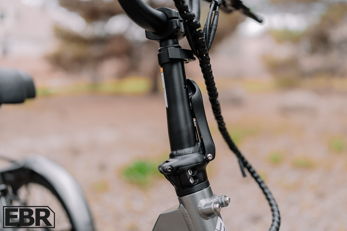

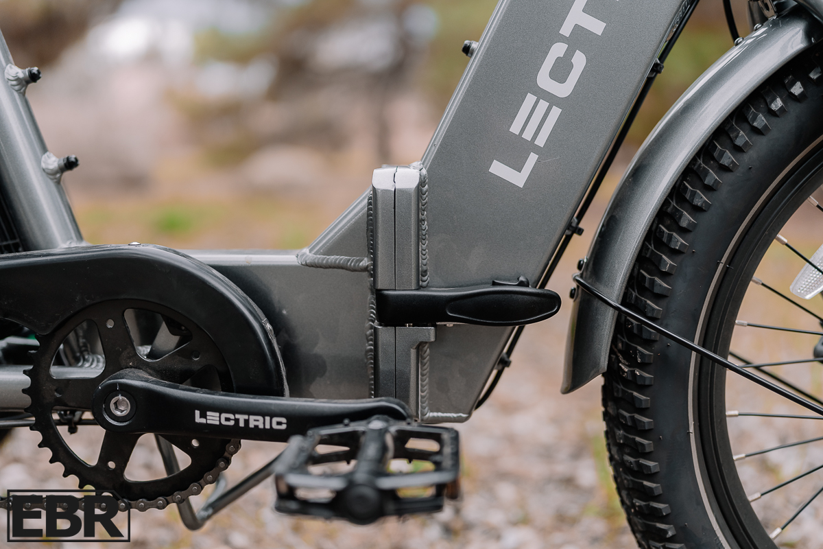

Folding the trike does meaningfully reduce its footprint for storage, but reality check: it still weighs about 80 pounds. This isn’t something you’ll casually toss in your trunk solo—grab a helper for lifting situations.
Ultimately, what matters most is how it rides, and the XP Trike delivers a stable, confidence-inspiring experience that could genuinely help people rediscover cycling who might otherwise stay sidelined.

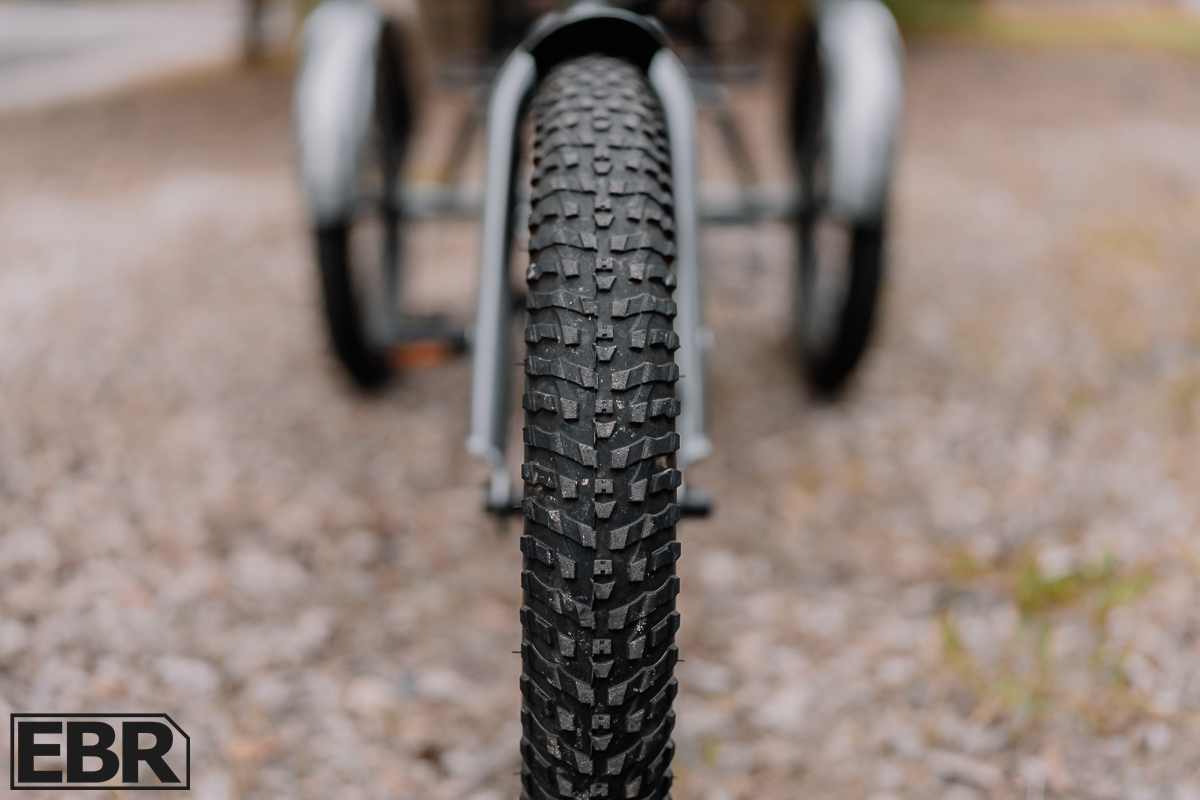

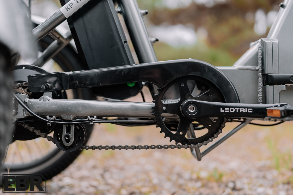

Let’s start with what keeps you rolling: 20-inch alloy wheels wrapped in 2.6″ tires, striking a nice balance between stability and maneuverability for a trike. The single-speed drivetrain (36T chainring paired with a 16T cog) keeps things simple and low-maintenance – a smart choice for a trike where frequent gear changes aren’t really part of the equation.
One of the more interesting engineering bits is the braking setup. Lectric’s gone with hydraulic disc brakes sporting 180mm rotors, but here’s where it gets clever: both rear wheels are controlled through a centrally mounted caliper system that applies equal braking force to both sides. Same goes for the motor power delivery – it’s balanced between the rear wheels for consistent acceleration.

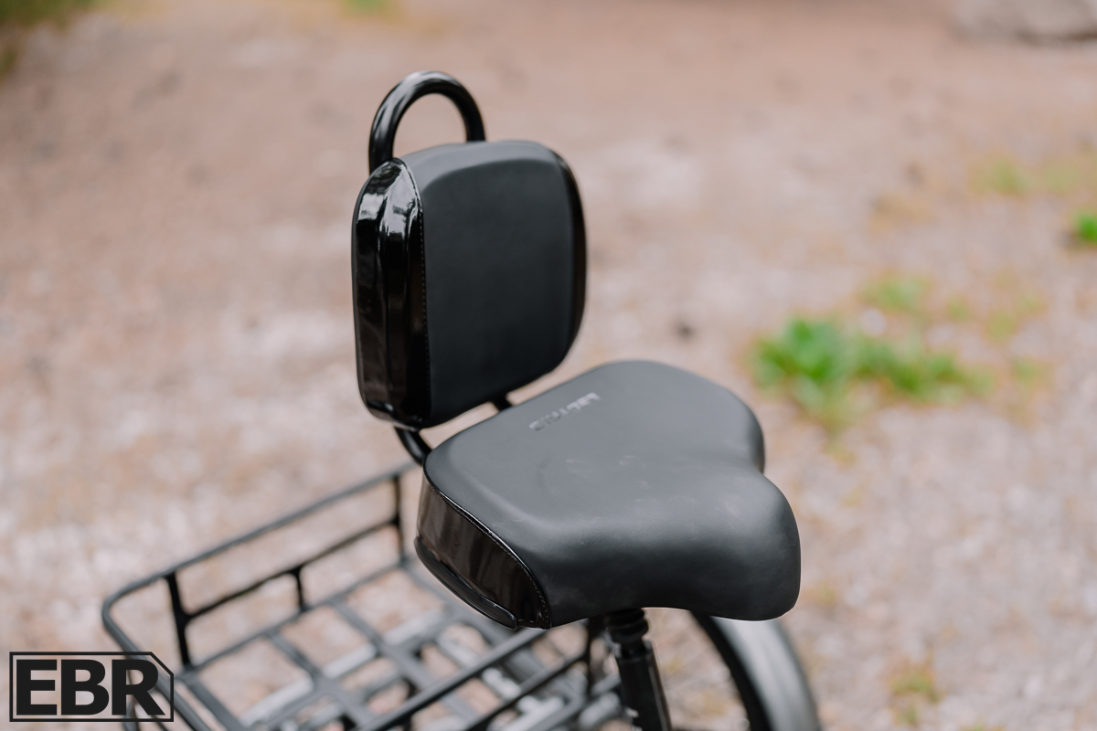

On the comfort front, you’re getting a wide saddle with back support, ergonomic grips, and BMX-style handlebars spanning 25 inches. No suspension here, but the fat tires help soak up some road buzz. The cockpit’s straightforward with a right-side twist throttle, and the folding stem adds some practicality for storage.

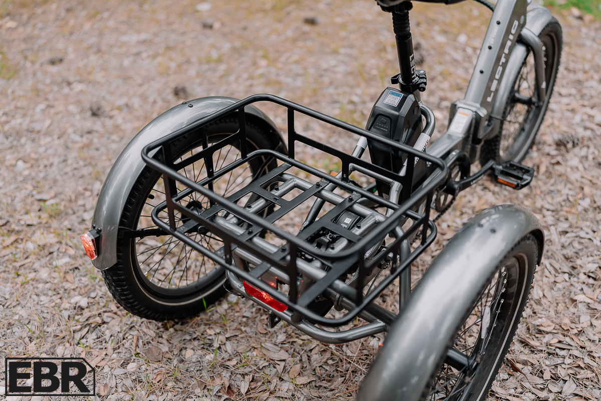

Speaking of practicality, Lectric’s included alloy fenders and an integrated rear cargo area rated for 75 pounds. There are mounting points for a front basket and additional accessories (3 bosses on the downtube, 2 on the seat tube), plus front and rear lights rated at 850 lux with turn signals – a nice safety touch for a bike that’s likely to see a lot of neighborhood use.
