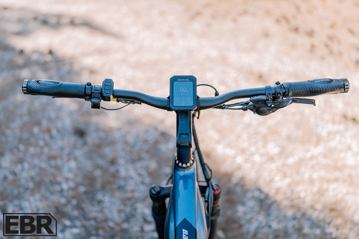

On the geometry side, the bike provides an upright riding position with a slight forward lean, which shifts a small amount of weight onto the grips. The lock-on grips with thick gel padding are a welcome feature, providing extra comfort on longer rides. I found the adjustable stem to be a nice touch, giving riders the ability to customize their handlebar angle, whether they prefer a more upright, relaxed position or something a little more aggressive for harder efforts.

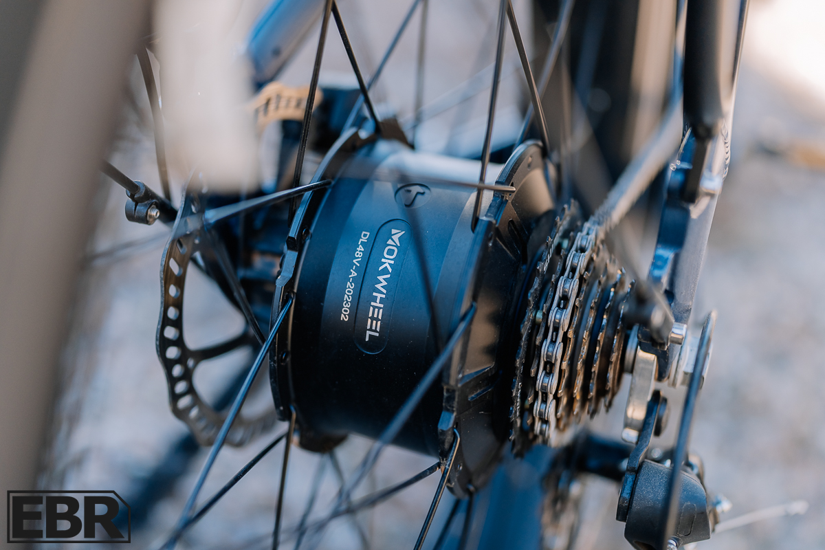

The 750W motor, combined with 85Nm of torque, delivers plenty of power, especially with the torque sensor. While the motor can feel a bit punchy at first, the ability to adjust the motor sensitivity from 1 to 5 in the display settings helps dial that in. It ships at level 3, which feels balanced, but being able to tone it down or ramp it up is a nice feature, particularly if you’re still getting used to the power or have different riders using the bike. The torque sensor isn’t the most refined, but it does its job of matching power to effort better than a cadence sensor would.

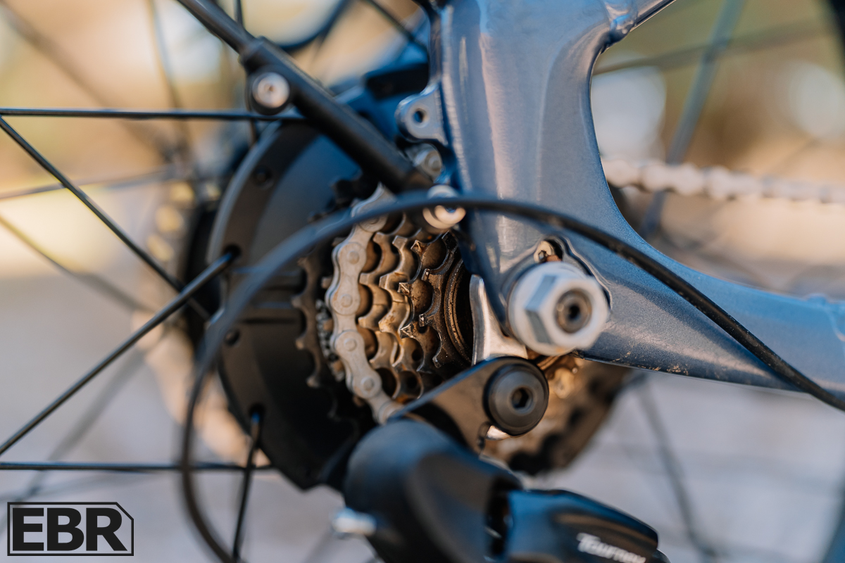

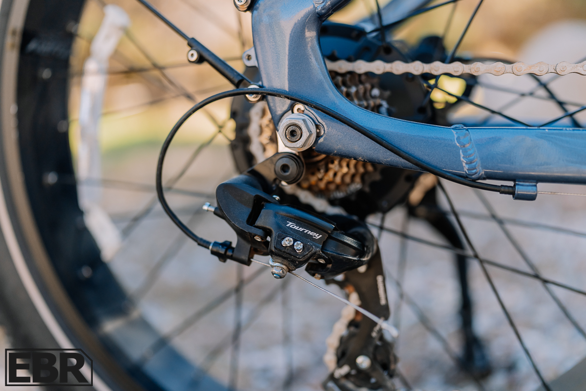

The drivetrain is a Shimano 7-speed system with Tourney components, a 44t chainring, and a 14-28t cassette. It’s adequate for an e-bike, where motor assistance is the primary factor, but I did find myself ghost pedaling once I hit around 25 mph. For most riders, this setup will be just fine, but having a bit more range in the gearing would be helpful, especially if you need to pedal without motor assistance or on longer rides.”

The Mokwheel Basalt rolls in as a Class 3 e-bike, powered by a 750W rear hub motor with 85 Nm of torque. It’s got plenty of kick to tackle steep climbs and off-road paths without ever feeling underpowered. Paired with a torque sensor, the pedal assist feels more natural, making it a smooth ride whether you’re cruising around town or taking on more challenging terrain.

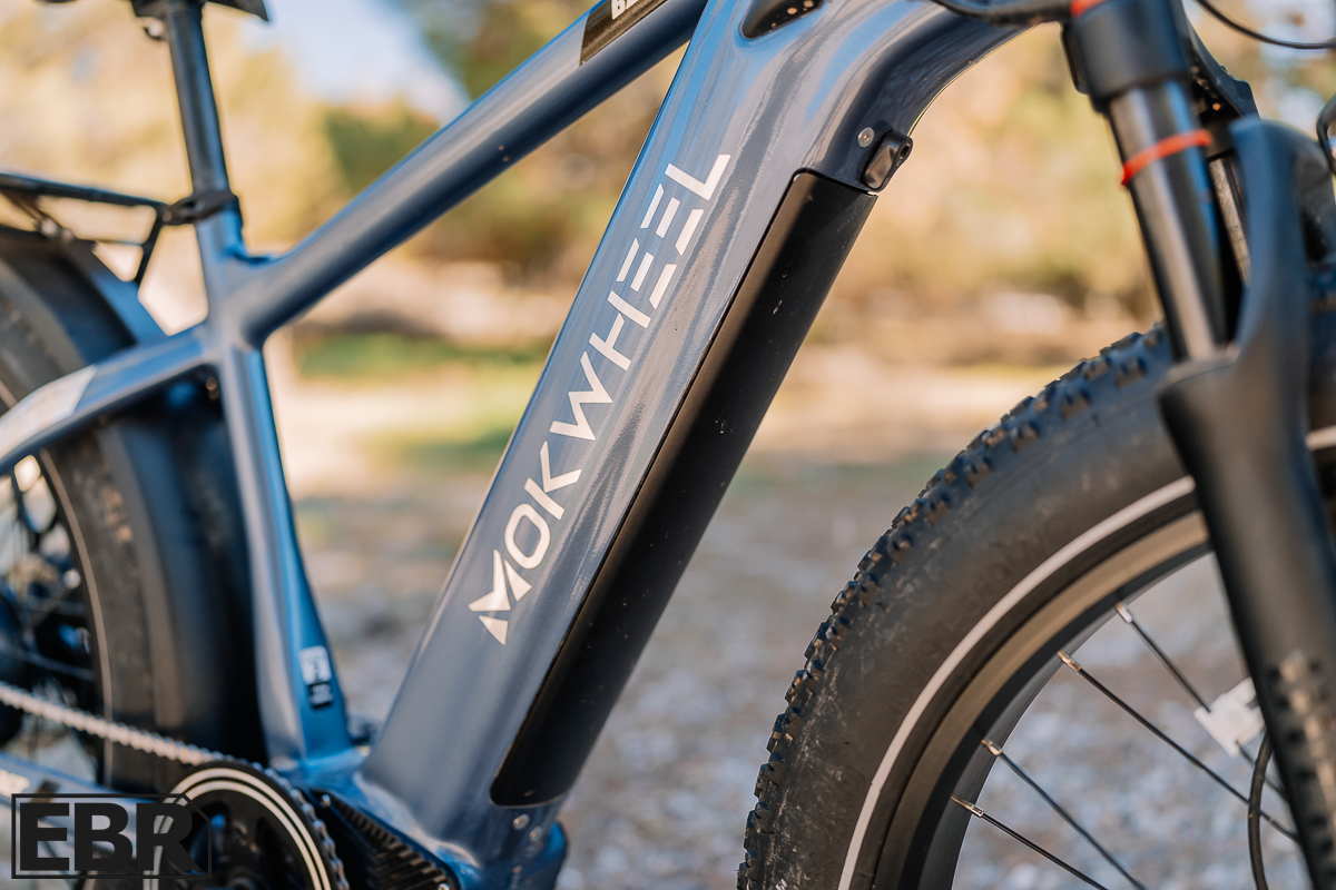

On the battery front, the Basalt comes equipped with a 941Wh battery that’s both integrated and removable, which is a nice touch for easy charging and convenience. At 48V and 14.4 amp hours, it’s got more than enough juice to handle long rides, and it’s UL 2271 certified for added safety. With the combination of the high-capacity battery and the motor’s solid torque output, the Basalt is well-suited for extended rides and tougher routes without sacrificing power or range.

The Mokwheel Basalt is built with components that can take on a variety of riding conditions, starting with its solid 6061 aluminum alloy step-over frame. It’s designed with a clean, integrated battery look and has a load capacity of up to 400 lbs, so it’s plenty durable. Up front, the bike features a 110mm Overlord coil suspension fork with a lockout switch, giving you the flexibility to handle anything from paved streets to rougher terrain.

On the drivetrain side, the Basalt keeps it simple with a Shimano Tourney 7-speed system and Shimano trigger shifters. The 44T alloy crankset and 14-28 cassette give you a practical gear range for most riding situations, focusing more on durability than high-end performance, but it’s plenty for the average rider.
Comfort-wise, the bike features an adjustable stem, 720mm alloy handlebars, and Mokwheel’s leather ergonomic grips that lock on for added security. The alloy seatpost has a quick-release adjuster, so you can easily find your preferred saddle height, and the cushioned leather saddle offers decent comfort for longer rides.

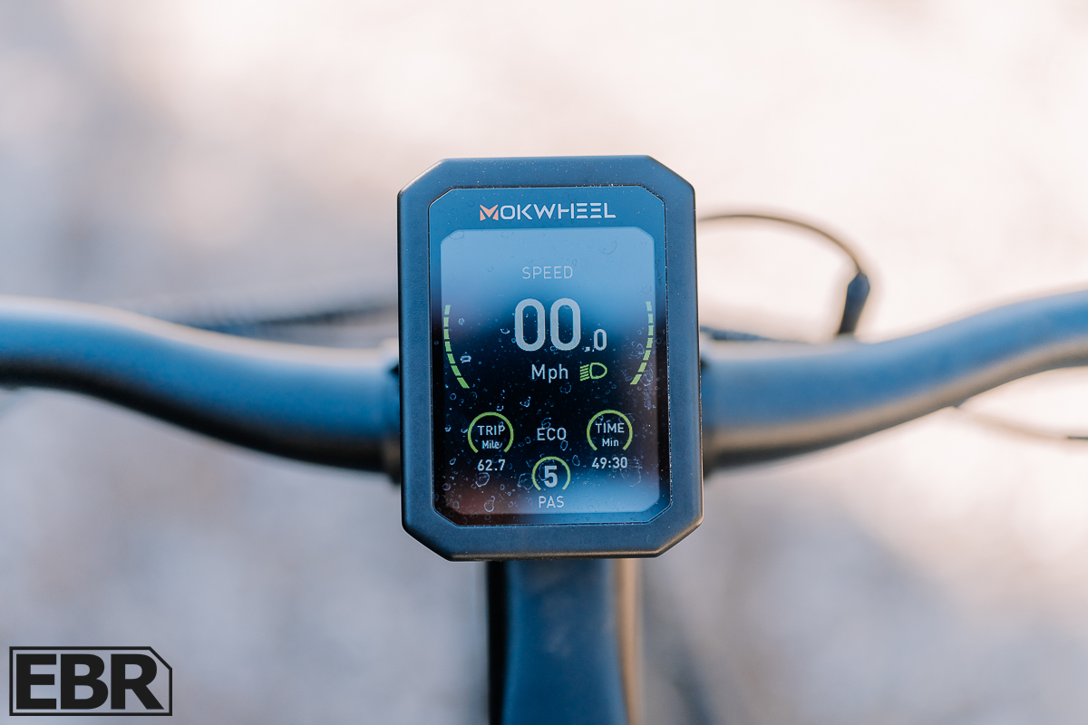

The Mokwheel Basalt comes with a color display that’s impressively easy to read, even in bright sunlight. The contrasting colors make all your key ride data clear, so you’re not struggling to check your stats while on the move. The main screen shows all the essentials—odometer, speed, battery level, ride time, headlight status, and current pedal-assist level—laid out in a clean and uncluttered way.
Navigating through the settings is simple and intuitive. For basic tweaks, like changing units of measurement or adjusting screen brightness, just long-press the up and down arrows on the control pad. It’s a user-friendly setup that allows you to quickly fine-tune the basics. For those who like to dive a bit deeper, pressing the up, down, and light button simultaneously gets you into the advanced performance settings.
This is where you can really customize your ride. You can switch between 3 or 5 pedal-assist levels, depending on how much control you want over speed variations. You also have options to adjust the wheel size and set the max speed, which tops out at 28 mph.
One of the more useful features is the ability to adjust the motor’s responsiveness. In the settings, you can dial in the sensitivity from 1 to 5, with 5 giving you the most punchy, immediate response. This flexibility lets you choose whether you want a more relaxed power delivery or a stronger torque kick right from the start.

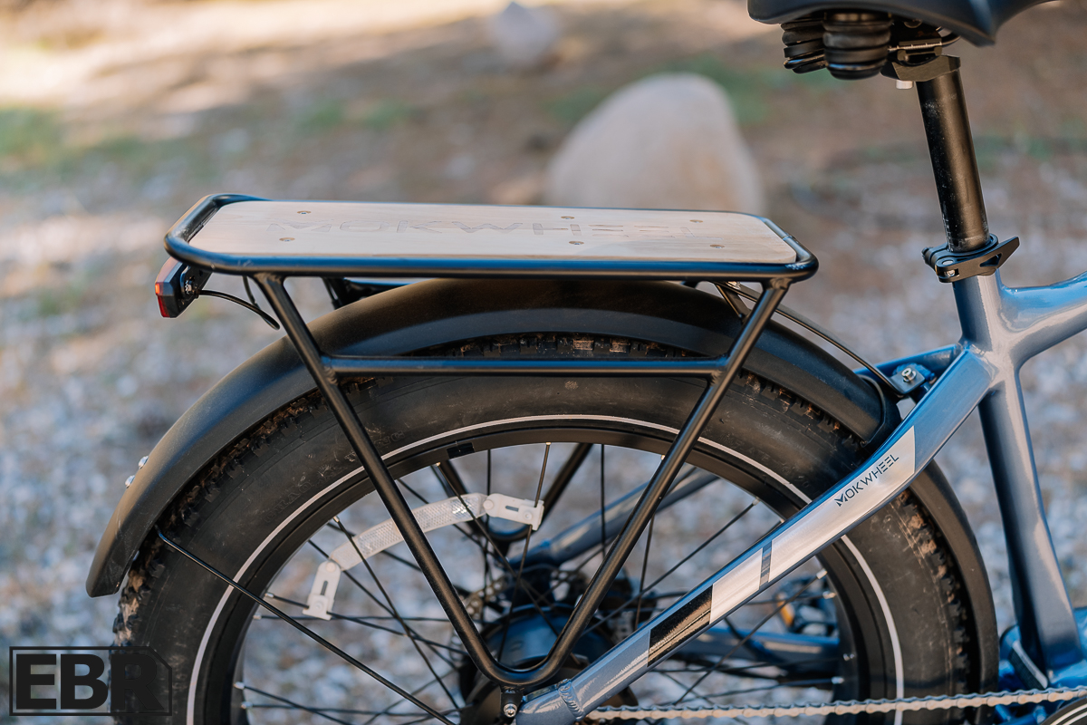

Out of the box, the Basalt comes with some practical accessories that add value, especially if you’re planning to commute or carry cargo. It includes a rear rack and full fenders at no extra cost, which is a nice touch. For those who want to take things further, Mokwheel offers optional accessories like a 1000W power inverter and foldable solar panels, making it a great option for those longer, off-grid adventures. You can also pick up extras like a front basket, rearview mirror, water bottle cage, bike bag, or even a pet or cargo trailer if you’ve got more ambitious trips in mind.

- A clutched derailleur would reduce chain slap and prevent chain slip-offs, especially on a bike marketed for off-road use.
