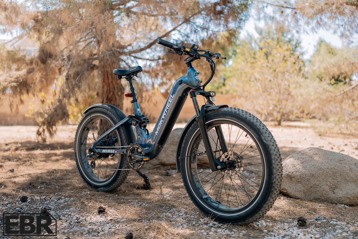

The 19” low step-over height made getting on and off this bike a breeze, especially given its tested weight of 82 lbs. If you’re worried about managing a heavier e-bike, this design definitely helps with stability. The riding position is a nice hybrid of upright comfort, thanks to the flat bars and the bike’s geometry, making it easy to settle in for longer rides without feeling cramped or stretched out.

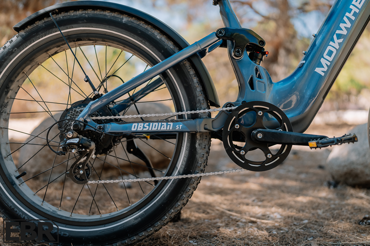

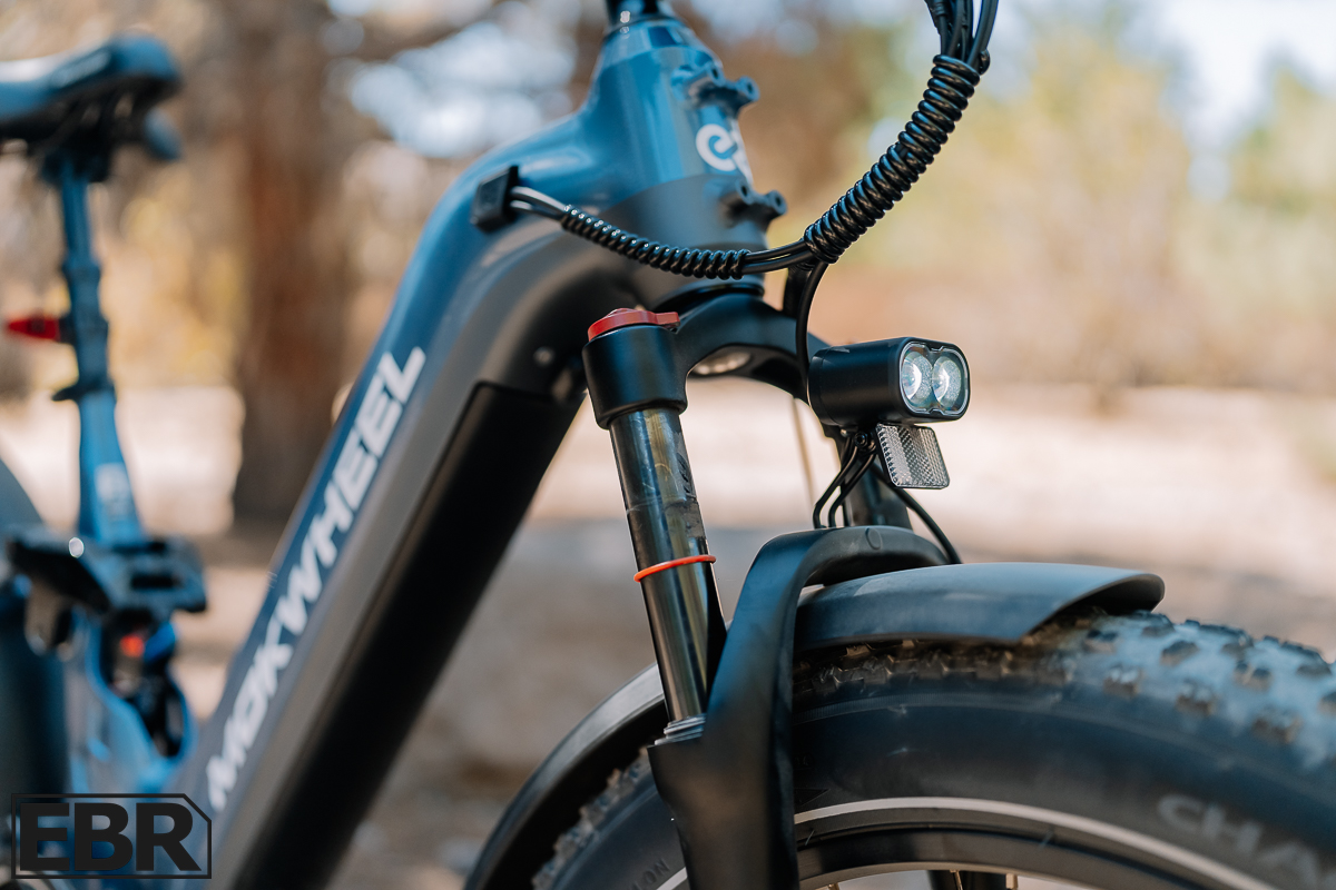

The saddle was surprisingly comfortable, and when paired with the bike’s full suspension—featuring a 130mm coil fork and an RC38 rear air shock—it soaked up the bumps and rough terrain like a champ. I was especially impressed by the stiffness of the step-through frame. Usually, these types of frames have a bit of flex, but Mokwheel seems to have nailed this one. My guess is that the extra frame material supporting the rear shock plays a big role in that added stiffness, giving the bike a more confident, solid feel when riding.

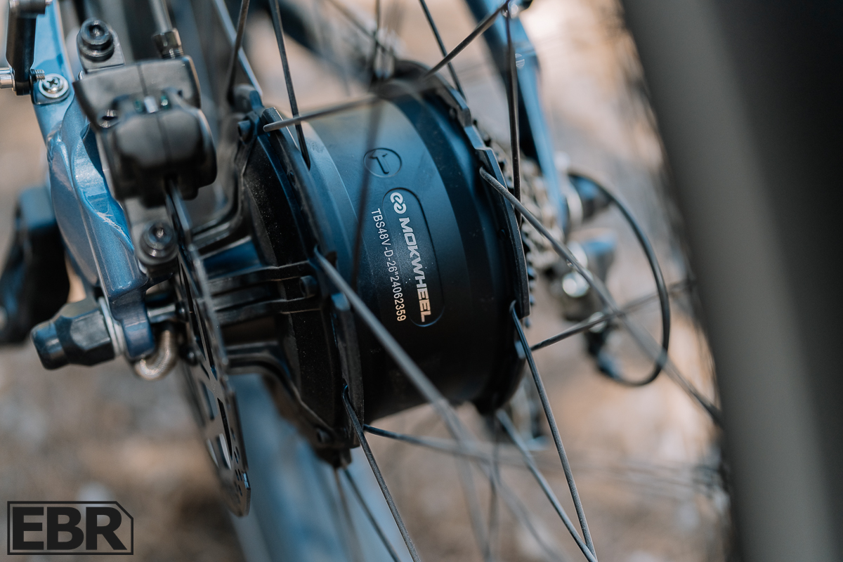

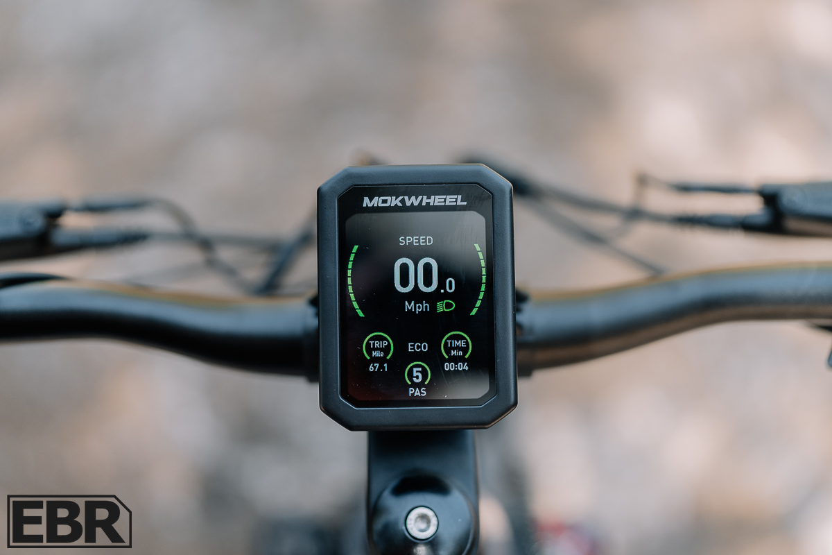

The display is user-friendly and lets you limit your speed to 20 mph or unlock the full 28 mph if you want that extra kick. The 1000W rear hub motor with 105 Nm of torque packs a serious punch. You can adjust the motor’s sensitivity from 1 to 5 on the display, where 1 is more reserved and 5 gives you full power. It came set to 3 out of the box, but I played around with the settings. On 1, the power delivery is nice and mild, which I think new riders will appreciate. Crank it up to 5, though, and you’re in for a wild ride—it’s got enough power to lift the front wheel off the ground from a standstill with my 180 lbs in the saddle! It’s the kind of torque that might catch you off guard at first, but soon has you grinning ear to ear as you blast down the road.

The Obsidian ST packs a 1000W rear hub motor that delivers a solid 105 Nm of torque. That’s plenty of power for an all-terrain e-bike and translates into strong acceleration and solid hill-climbing capabilities. During my rides, the motor had no trouble handling steep climbs or providing a quick start, even with the bike’s 82-pound heft. With 5 pedal-assist levels, you can dial in the power to match your ride—whether you want to take it slow and steady or go all out for a bit of fun.

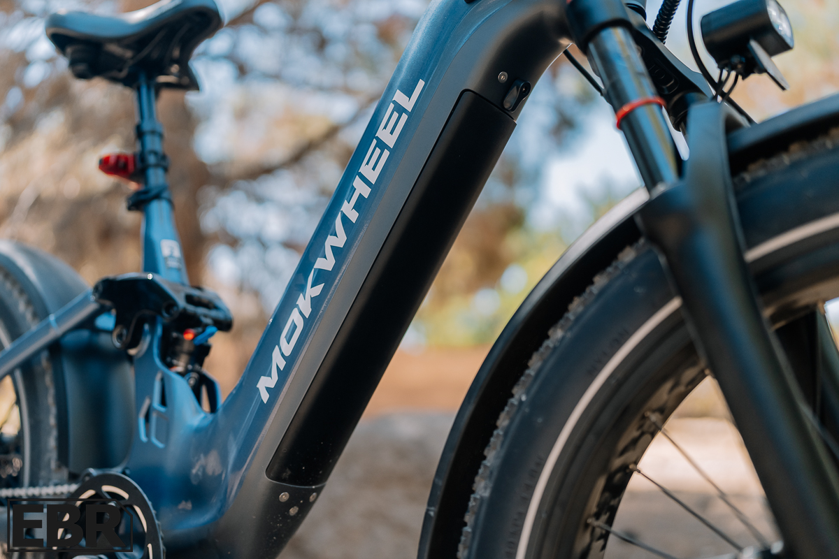

Powering all of this is a hefty 940Wh battery (48V, 19.6Ah). Mokwheel advertises a range of 60-80 miles, which seems reasonable for a motor of this size. Of course, real-world range will depend on factors like terrain, rider weight, and how aggressively you use the pedal assist or throttle. In my rides, mixing throttle use with higher pedal-assist levels drained the battery faster, but it still provided enough juice for a solid day of riding.
As for the battery itself, it’s not yet UL certified, but Mokwheel mentioned they’re in the process of getting UL 2271 certification. They reassured that it’s the same battery used in the Mokwheel Basalt, which is already UL certified.

The Obsidian ST comes equipped with an 8-speed Shimano Altus drivetrain, which is a fairly standard setup for an all-terrain e-bike. The trigger shifters provide smooth and precise shifting, and the 12-32T cassette paired with a 44T alloy chainring gives you a decent gear range for both flat cruising and moderate climbs. It’s not a high-end drivetrain by any means, but it gets the job done for the type of riding this bike is meant for. One thing to keep in mind is that the Altus derailleur doesn’t have a clutch, so you might experience some chain slap on rougher terrain.

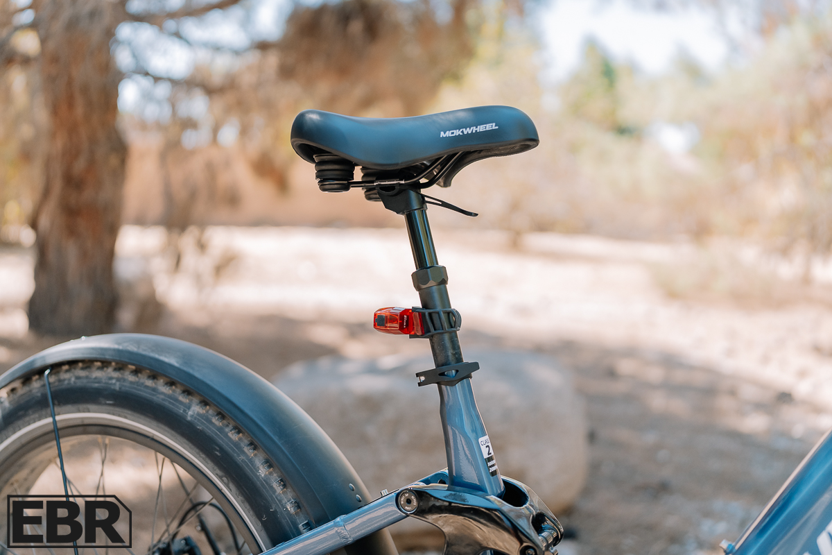

One interesting choice here is the dropper post. Usually, dropper posts are reserved for more aggressive riding, like mountain biking, where you need to get the seat out of the way for descents or technical terrain. That’s not really what this bike is built for. Instead, Mokwheel opted for a dropper because the frame’s linkage design doesn’t allow for a full-length seat tube, so this was a practical middle ground. The dropper offers 50mm of travel plus another 4 inches of seat tube adjustment, which gives you enough range to find a comfortable position. The saddle itself is Mokwheel-branded, spring-supported, and cushioned, which pairs well with the bike’s full suspension to smooth out the ride.

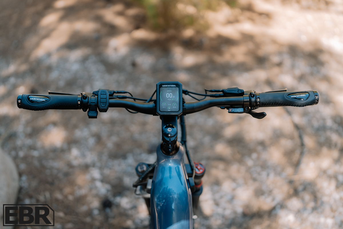

The Obsidian ST comes with a color display that’s surprisingly easy to read, even in direct sunlight. The contrasting colors make all the information pop, so you’re not squinting to see your stats while you’re riding. The home screen shows all the essentials: odometer, speed, battery level, ride time, headlight indicator, and your current pedal-assist level. It’s a clean layout that gives you what you need at a glance, without feeling cluttered or overwhelming.
Navigating the settings is pretty intuitive. If you want to tweak some basics, like changing units of measurement or adjusting the screen brightness, just long-press the up and down arrows on the PAS control pad. It’s a straightforward setup that makes it easy to dial things in. But if you’re someone who likes to customize your ride experience further, pressing the up, down, and light button all at once takes you into the more advanced performance settings.
This is where you can really tailor the bike to your preferences. You can adjust the pedal-assist levels between 3 or 5, depending on how many speed variations you want while riding. There’s also an option to change the wheel size and set the max speed, which can go up to 28 mph.
One feature I found useful is the ability to control the motor’s sensitivity. In the settings, you can adjust it from 1 to 5, with 5 being the most punchy and responsive. This gives you a lot of flexibility, whether you prefer a more laid-back, gradual power delivery or you want the motor to kick in with some serious torque right from the start.
