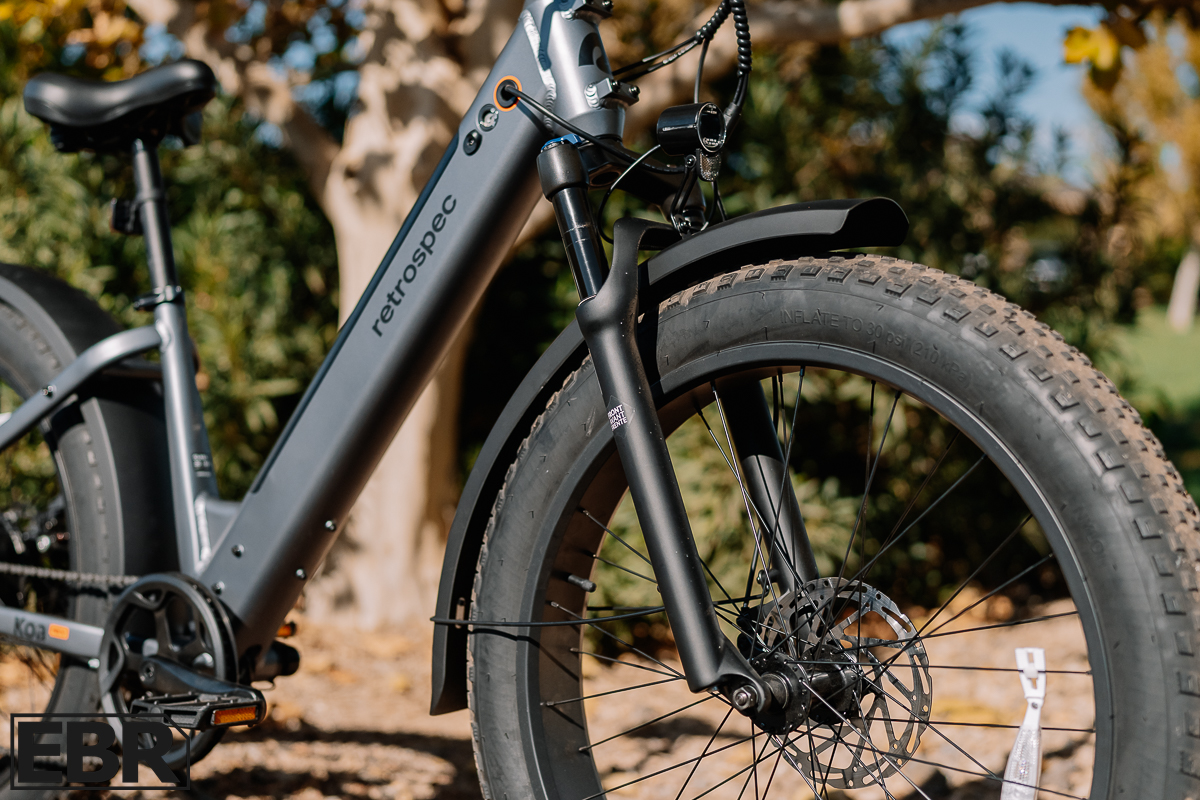

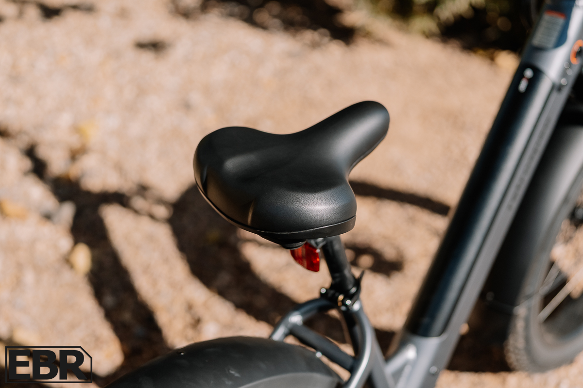

Comfort is a major strength of the Koa Rev 2. The wide, plush saddle—supported by dual underside springs and 1.5 inches of padding—fits my sit bones well with room to spare for broader riders. Paired with 4-inch tires at 15 PSI and an 80mm coil spring front fork, the bike soaks up road chatter and trail bumps effortlessly, delivering a smooth, forgiving ride.

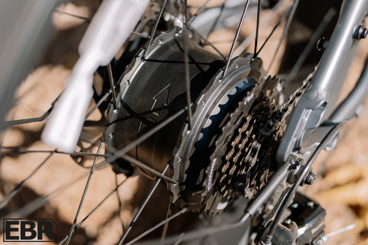

The 500W rear hub motor is a no-nonsense setup that performs admirably. It’s quiet enough to avoid annoyance and uses a cadence sensor that engages power after a half to three-quarter crank rotation, cutting off when pedaling stops. While many fat-tire e-bikes opt for 750W motors for heavier builds, the Koa Rev 2’s 500W motor, paired with smart programming, holds its own. Acceleration is steady rather than explosive, building confidently as the tires gain speed. Flats are effortless, and hills are manageable with pedal assist, though relying solely on the throttle can feel underpowered on steeper climbs—a quick pedal input solves this easily.

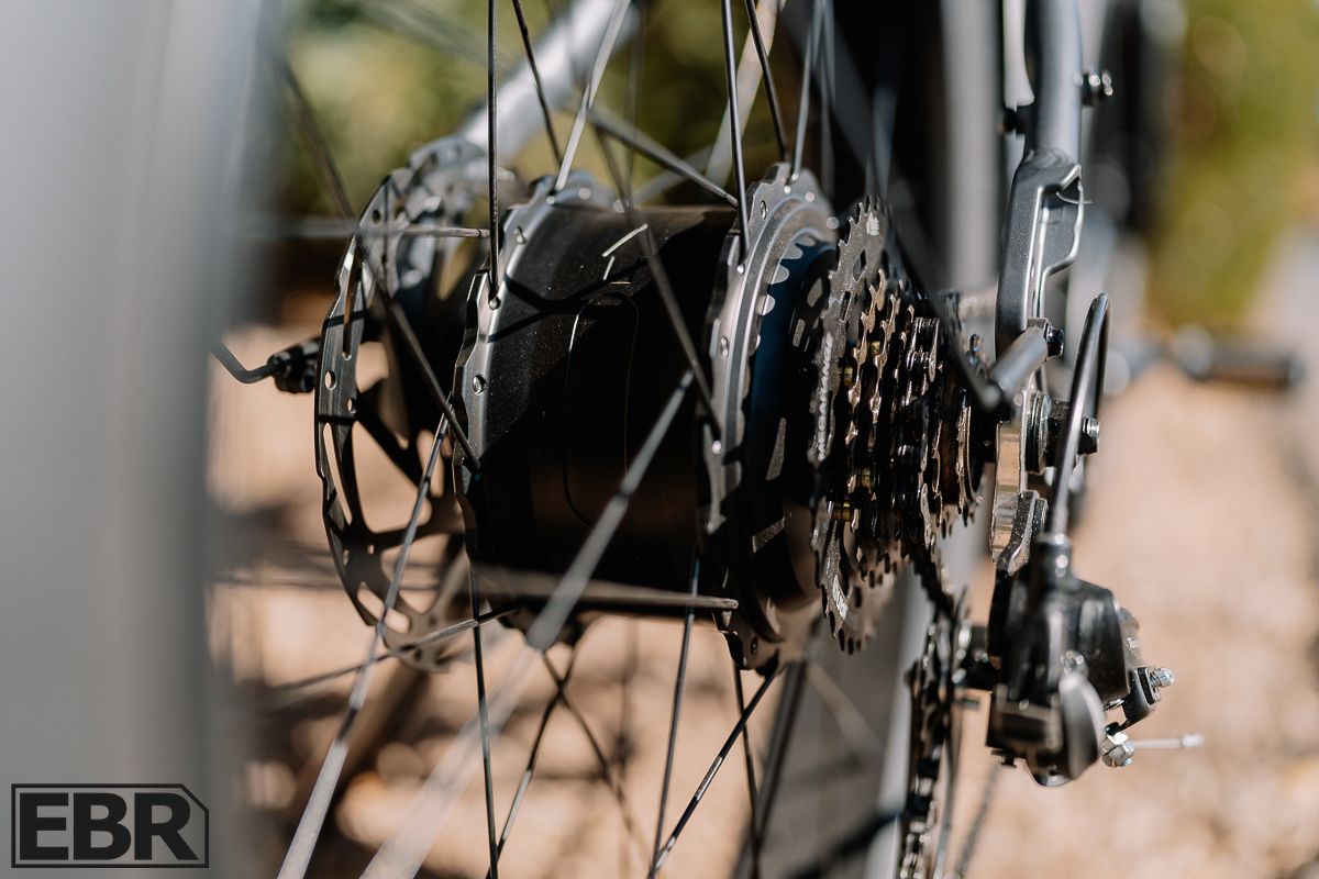

The Tektro mechanical disc brakes, equipped with two-piston calipers and 180mm rotors, are a less common choice in an era dominated by hydraulics but perform reliably. They deliver confident stopping power, though they require periodic cable tension checks—about once a year—to maintain performance, unlike low-maintenance hydraulic systems. While hydraulics might edge them out slightly, these brakes get the job done and help keep the bike’s price down.

Powering the Retrospec Koa Rev 2 is a 500W rear hub motor. This rear hub motor is activated via a cadence sensor and it has 6 levels of PAS, PAS levels 1 through 6.
The cadence sensor gives its power delivery based on the pedal cranks ‘cadence so when you start moving the cranks, it will pick that up and when you stop, the cadence sensor will then do the opposite and have the motor cutoff.
While retrospect does not disclose the peaking wattage or the torque rating of this motor, it has enough to tackle hills in my area without any issues., Although as mentioned earlier in my rides, steeper inclines need the help of your legs and pedal assist, using throttle alone it can get bogged down.

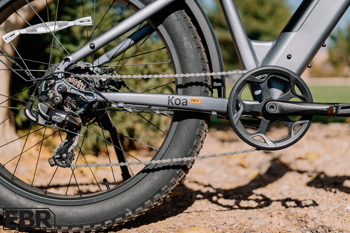

The drivetrain features a Shimano 7-speed groupset paired with a 46T three-piece chainring, 170mm cranks, and a 14-34T rear cassette. This setup delivers smooth pedaling on flats and enough range to push past the Class 3 speed limit of 28 mph when needed.
Braking comes from Tektro mechanical disc brakes with dual-piston calipers and 180mm rotors. They performed well in testing, though unlike hydraulic disc brakes, they require periodic maintenance to ensure cable tension remains tight. Similar to a rear derailleur, expect to check and adjust the brake cables about once a year.

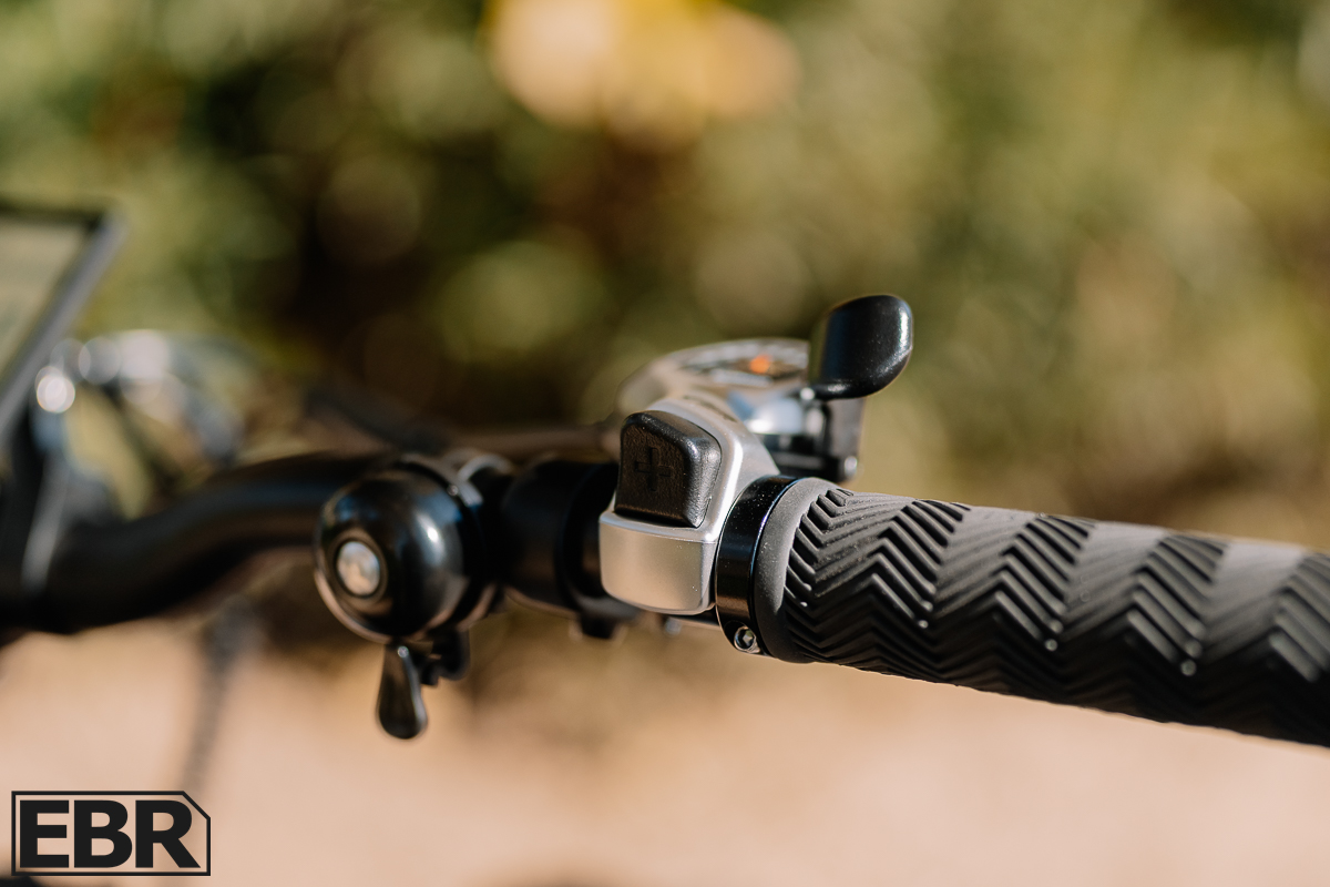

The cockpit centers around a 700mm flat alloy handlebar with a 31.8mm diameter at its thickest point. It’s equipped with lock-on rubber grips, retro-style mechanical brake levers, a bell, and over-the-bar index shifters. On the left side, a three-button control pad operates the display, with the black-and-white LCD screen neatly tucked nearby.

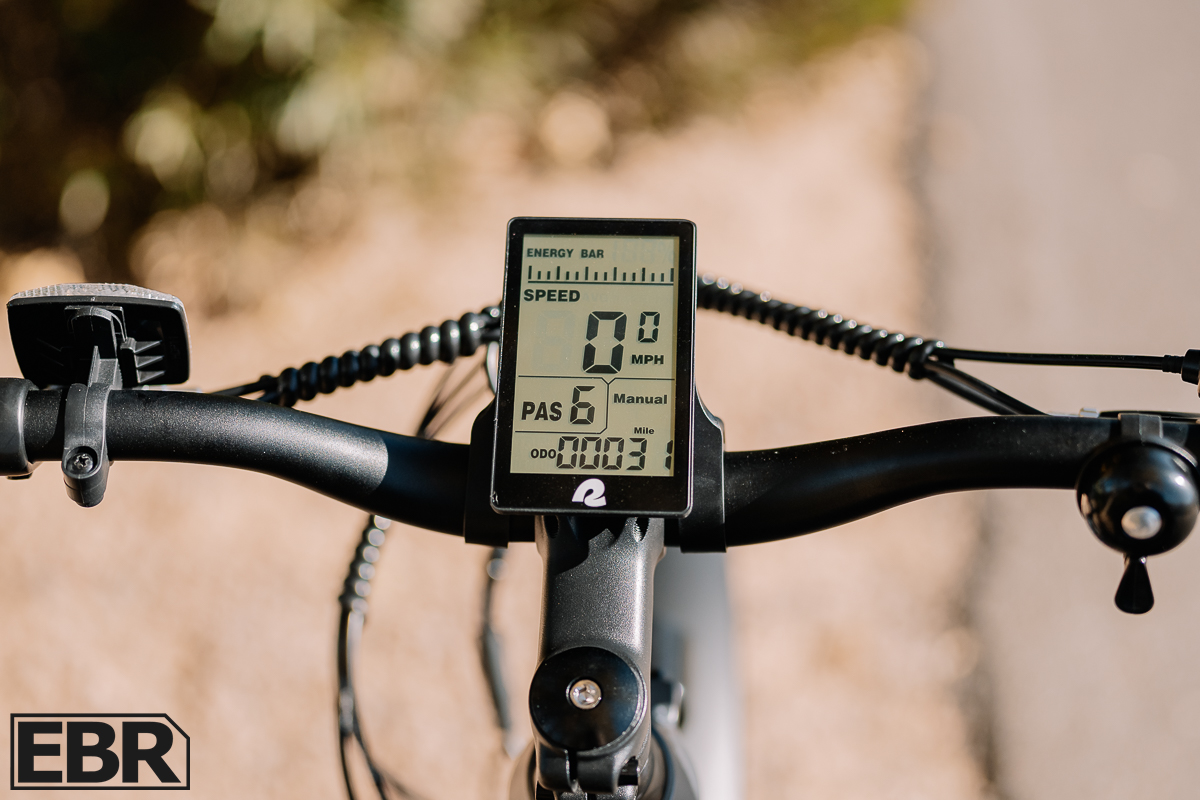

The Koa Rev 2 features a straightforward black-and-white LCD display that shows all the essential ride data: battery level, speed, pedal assist (PAS) level, and odometer. Pressing the ‘M’ button on the control pad cycles through additional screens, including average speed, max speed, and more.
The display is user-friendly and remains clearly visible even in direct sunlight, making it reliable for all conditions.
Retrospec doesn’t offer a companion app, which suits this bike’s no-frills approach. Without complex tech like motor tuning, an app isn’t necessary. The setup prioritizes simplicity, delivering what you need while keeping costs down and the riding experience uncluttered.
