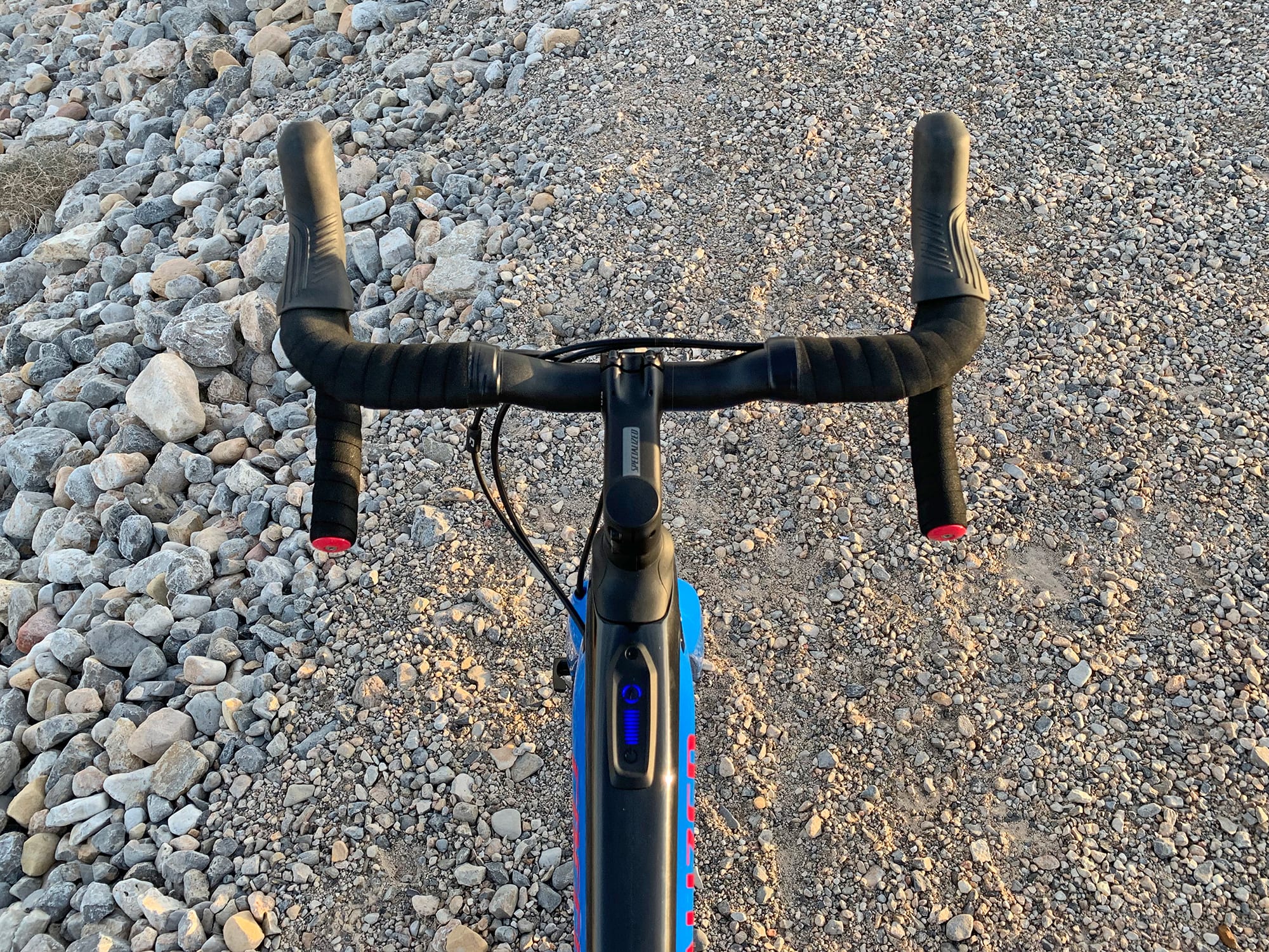

- The Comp Carbon and Comp Carbon EVO both come in multiple colors and six frame sizes, the main differences for the EVO gravel grinder setup are flared handlebars, wider treaded tires, and a seat post dropper… which crates a weight difference of roughly 1.9lbs (31.6lbs for the Comp Carbon EVO vs. 29.7 for the Comp Carbon)

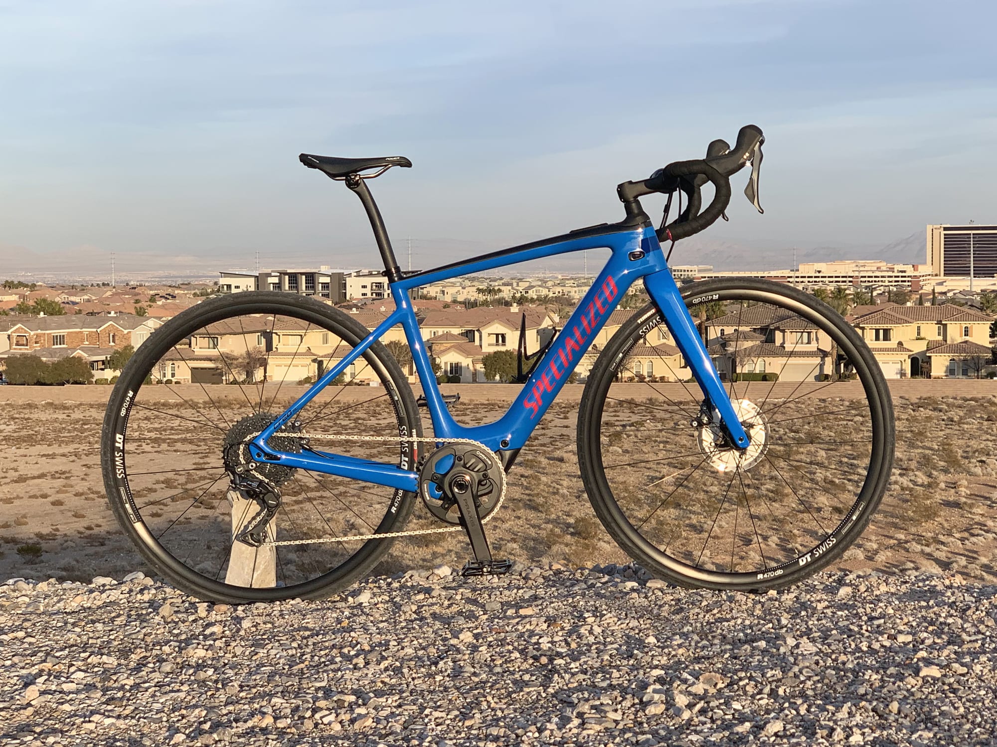

- No compromises here, I love that the frame has provisions for bottle cages on the downtube and seat tube, and that there are mounting points for fenders and a rear rack

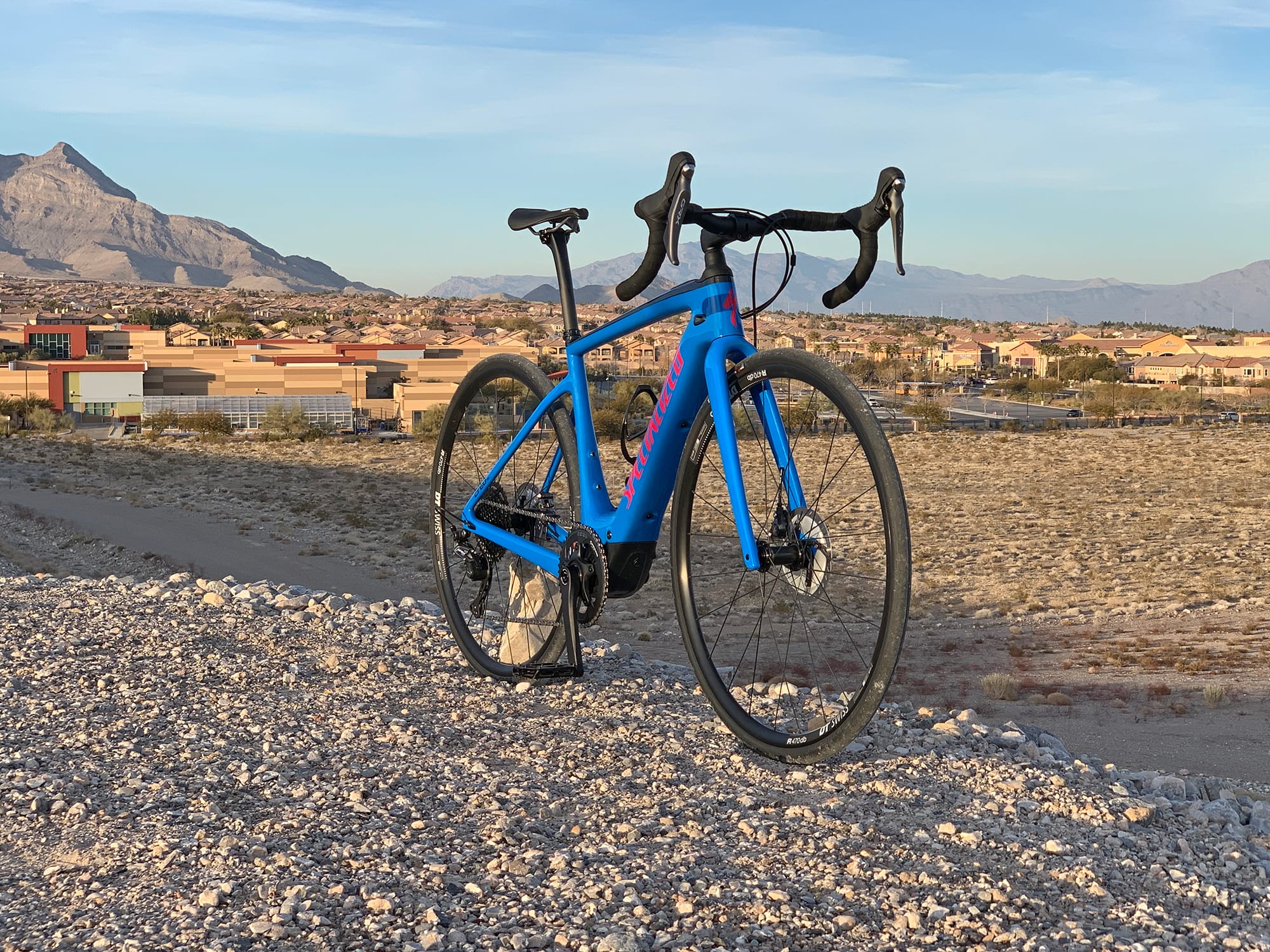

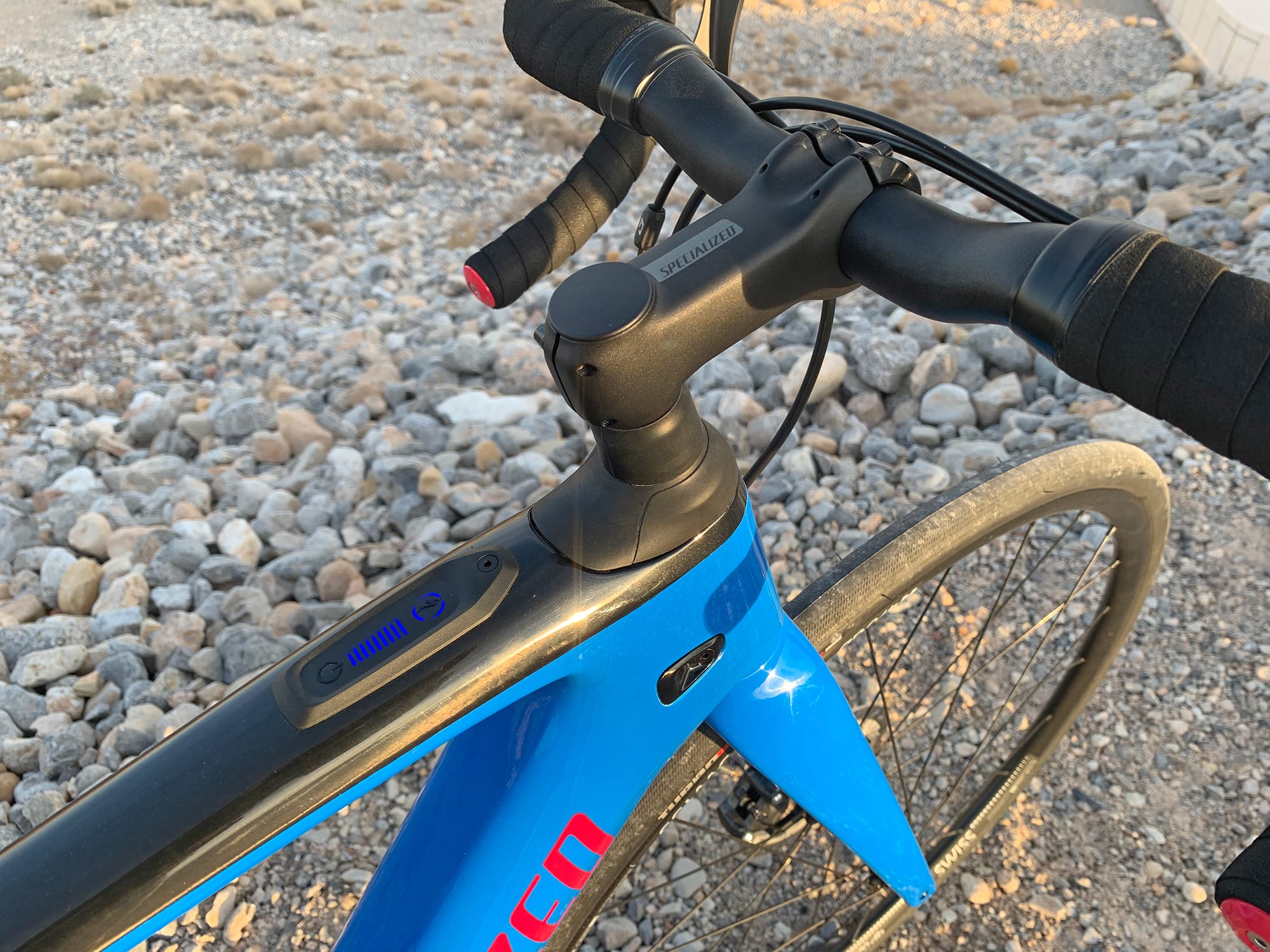

- Incredibly stealthy design… this thing genuinely looks like an analog bicycle because the motor casing is so compact and the battery is completely internalized, there are no big LCD displays to distract or cause glare, and the LED readouts on the TCU interface can be disabled using the Mission Control app
- Excellent weight distribution, it’s all kept low and centered on the frame and the bike balanced well when lifting from the center (as I weighed it)

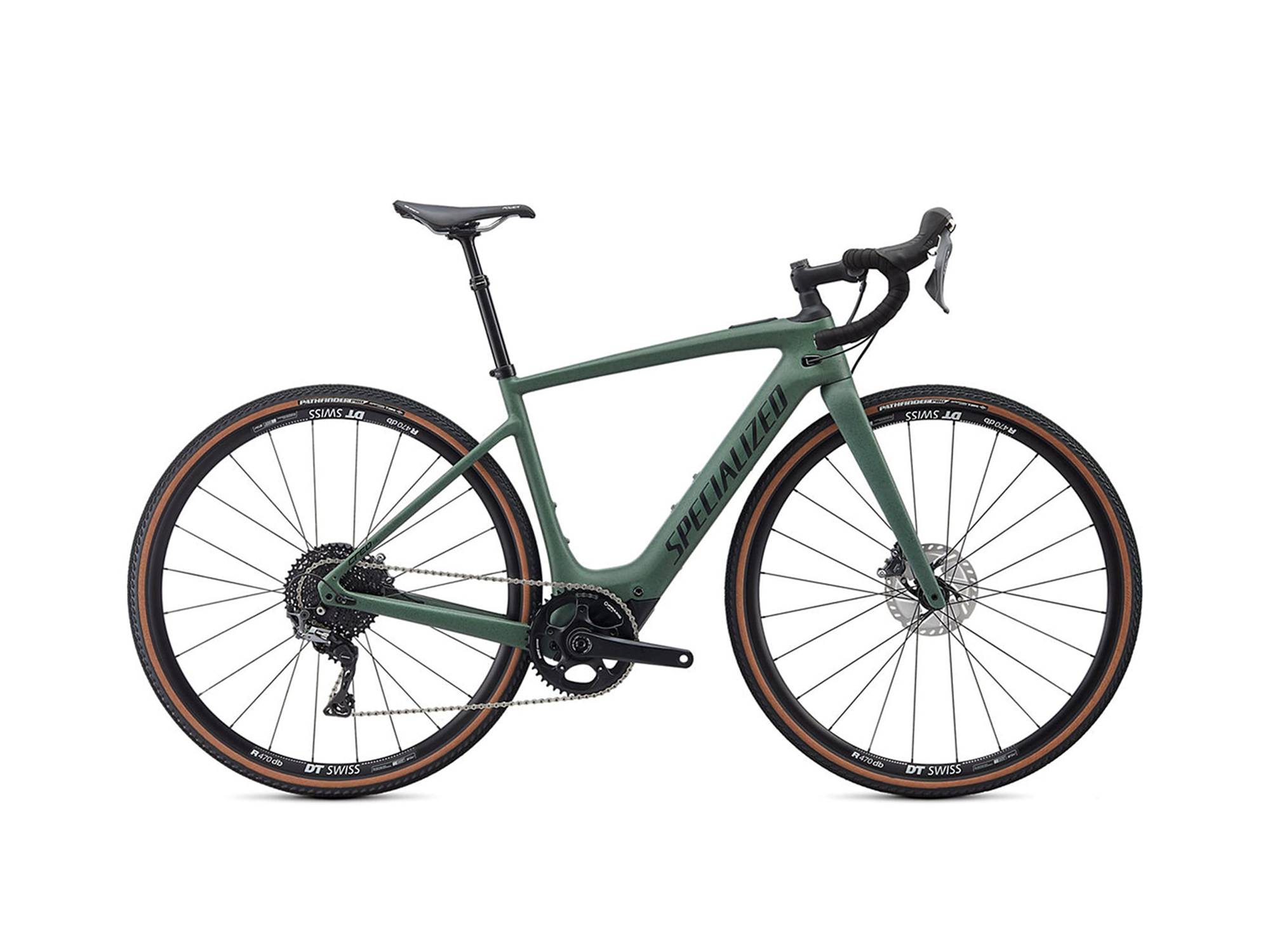

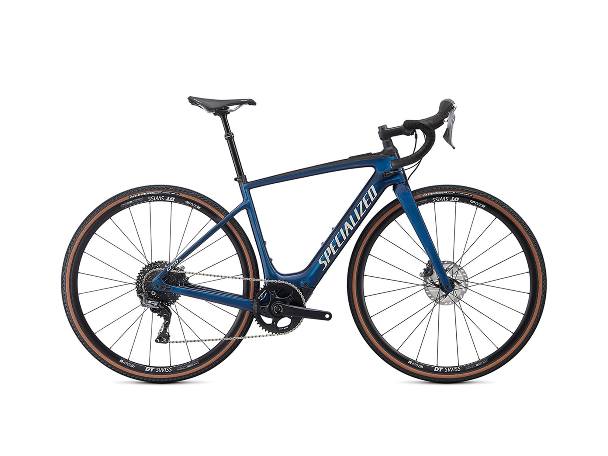

- The Creo SL Comp Carbon EVO (gravel grinder trail model) comes in two awesome frame colors… I was testing the satin green with black splatter accents, but they also sell a gloss navy with white that has carbon accents (you can see the carbon layers). Note that the carbon can look uneven and reflect up, it’s a more organic style and some people have made comments about it on the Specialized website saying they wish the whole thing was Navy

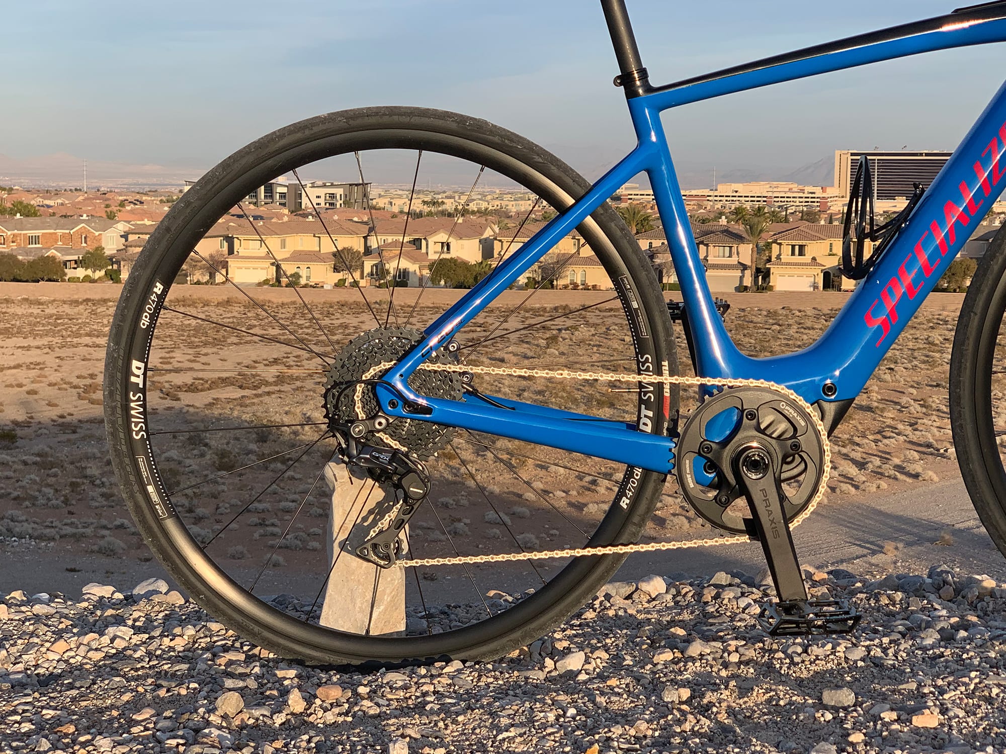

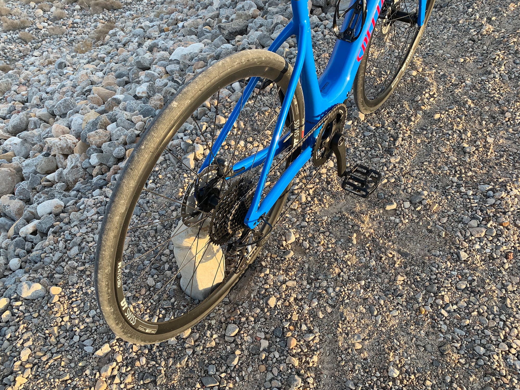

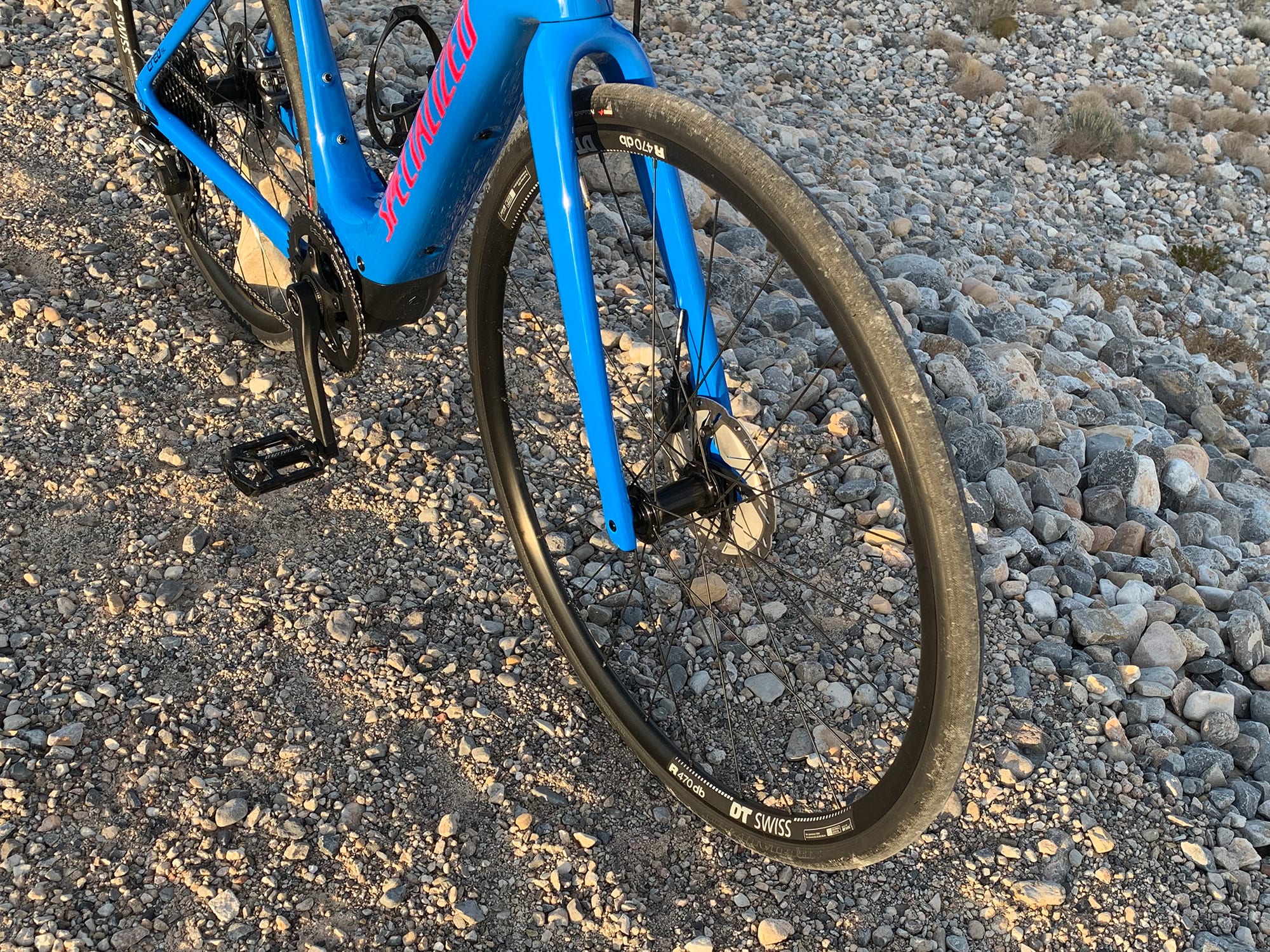

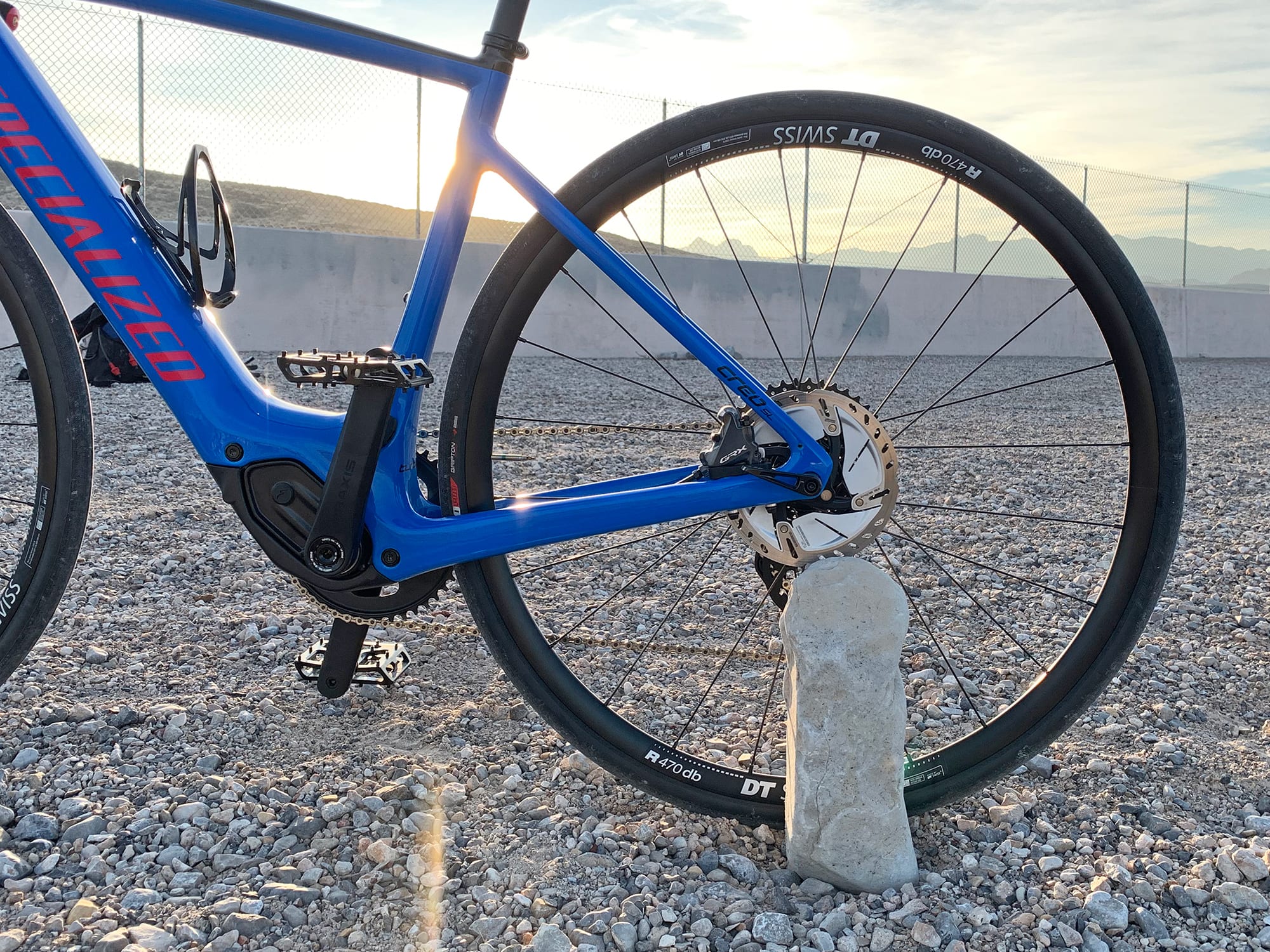

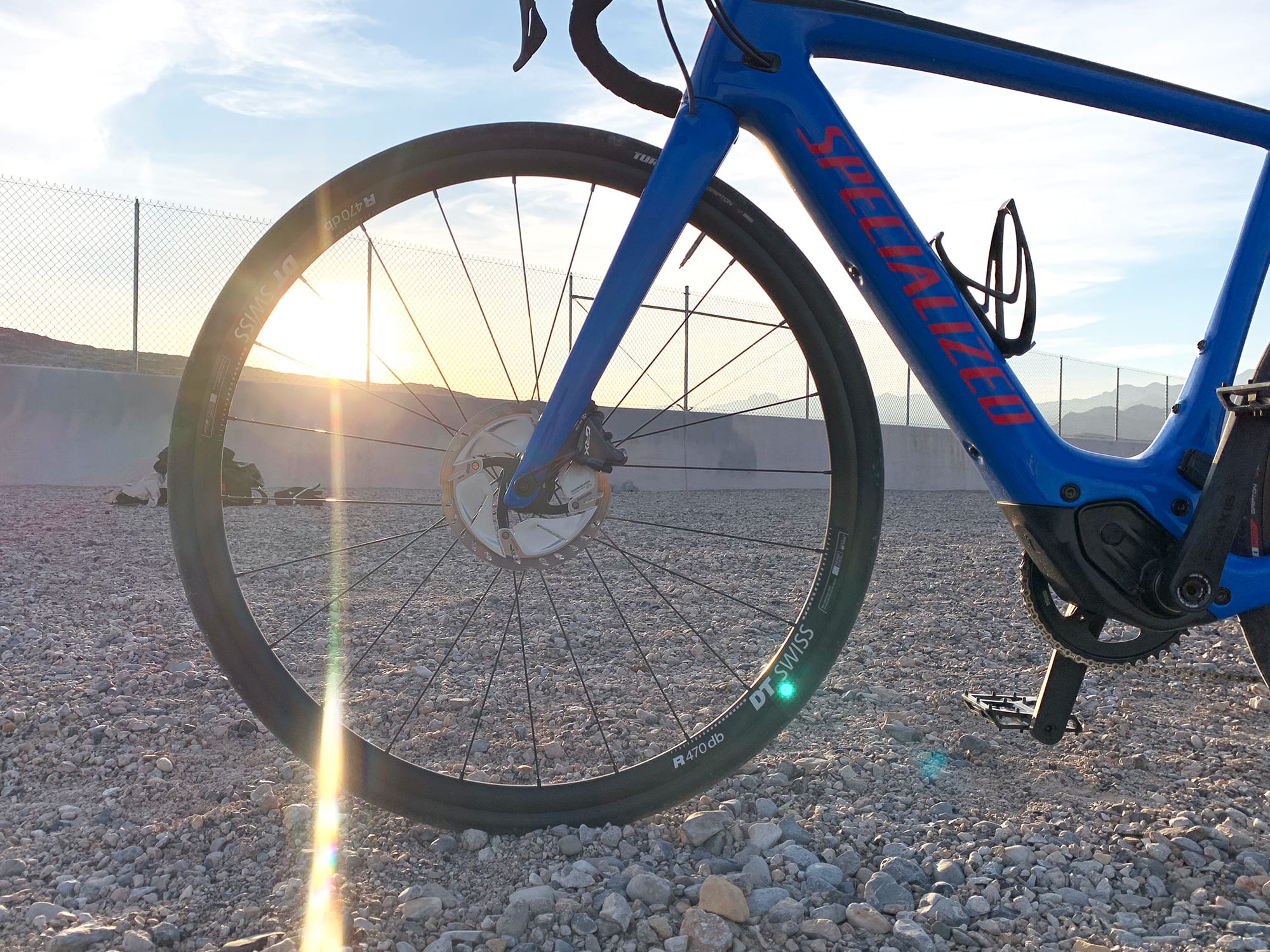

- Wider Boost hub spacing provides a sturdier spoke bracing angle for strength and stability at high speeds, both axles are thicker 12mm with threaded quick release for easy trail maintenance and fixes

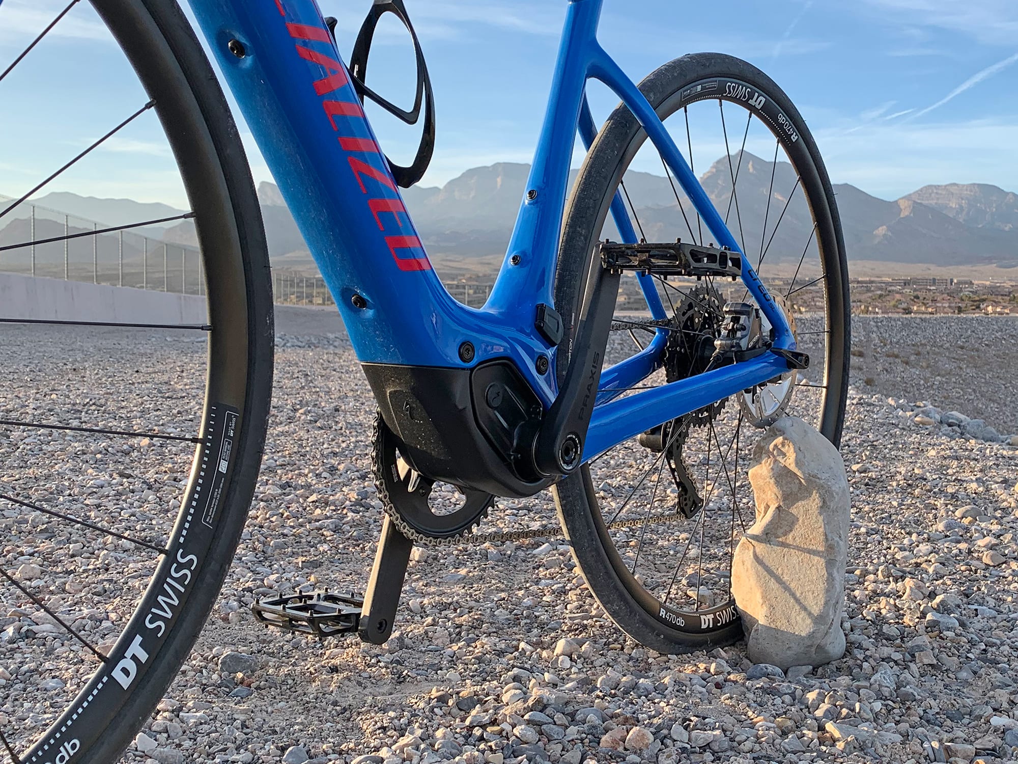

- Extra-long rubber slap guard protects the carbon frame from chain strikes when riding on bumpy terrain, it’s a clean lightweight design that’s effective
- Narrow-wide tooth pattern on the lightweight aluminum alloy chainring reduces drops and provides a tighter connection, so you and the motor achieve maximum power transfer when pedaling
- The Shimano GX derailleur is tucked close to the frame and offers a one-way clutch that reduces chain bounce at higher speeds and on off-road gravel sections, click it up to engage or click it down to perform drivetrain maintenance or remove the rear wheel more easily

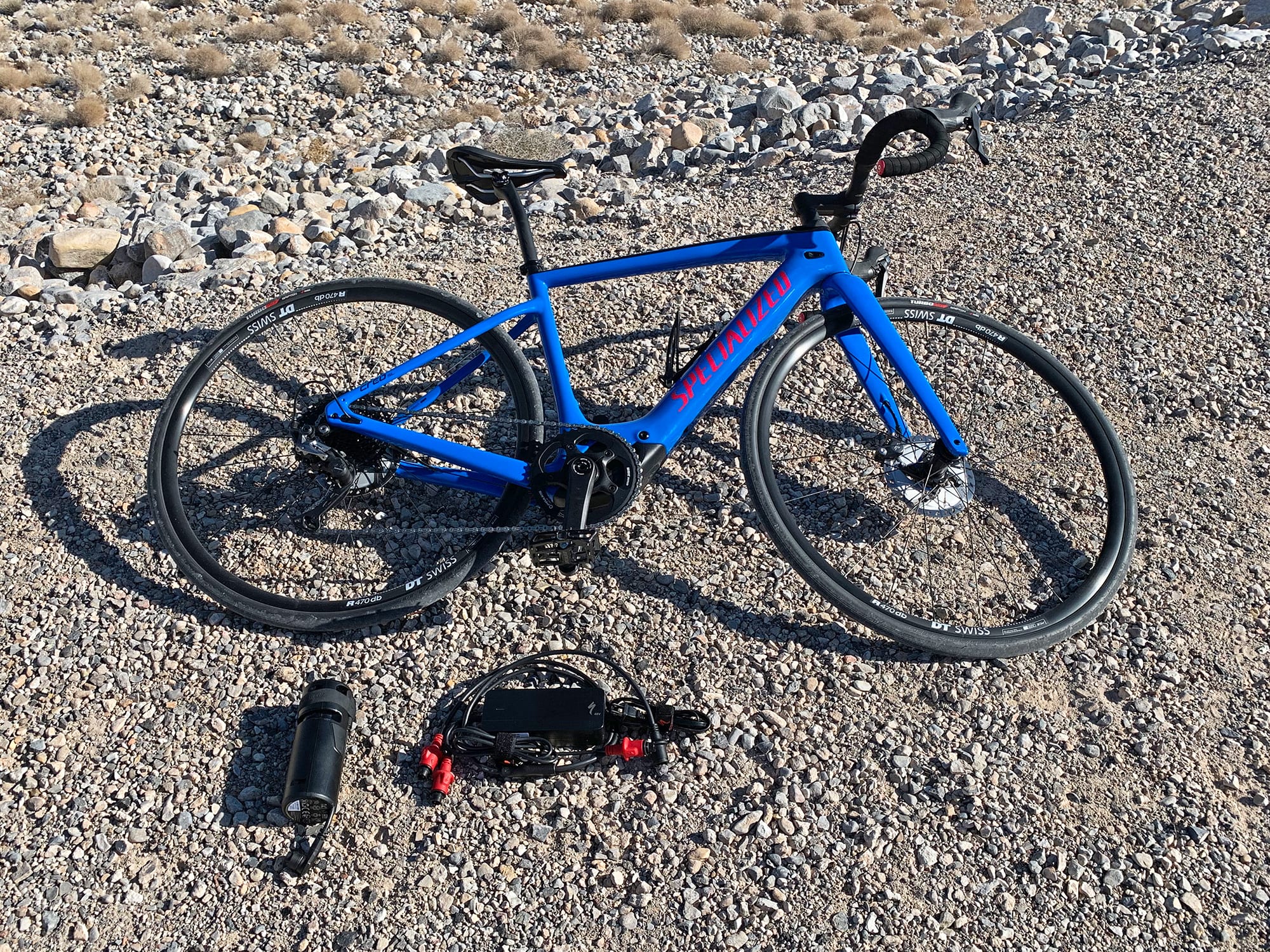

- Be sure that you purchase a left-entry Specialized Z-Cage bottle holder if you buy the Range Extender battery because the cable comes out of the left side of the battery and the security notch will then be aligned with the front… we had a right-entry Z-Cage and the battery didn’t seat quite right as a result
- The Y charging cable (to fill the main battery and an optional Range Extender battery costs extra, and the little cable going from the Range Extender to the bike costs extra
- Unlike the Turbo Levo models, the Creos do not include a remote button pad with the S, +, -, and Walk Mode… so you have to take your hands off the handlebar to switch modes, and I don’t think there’s a walk mode here

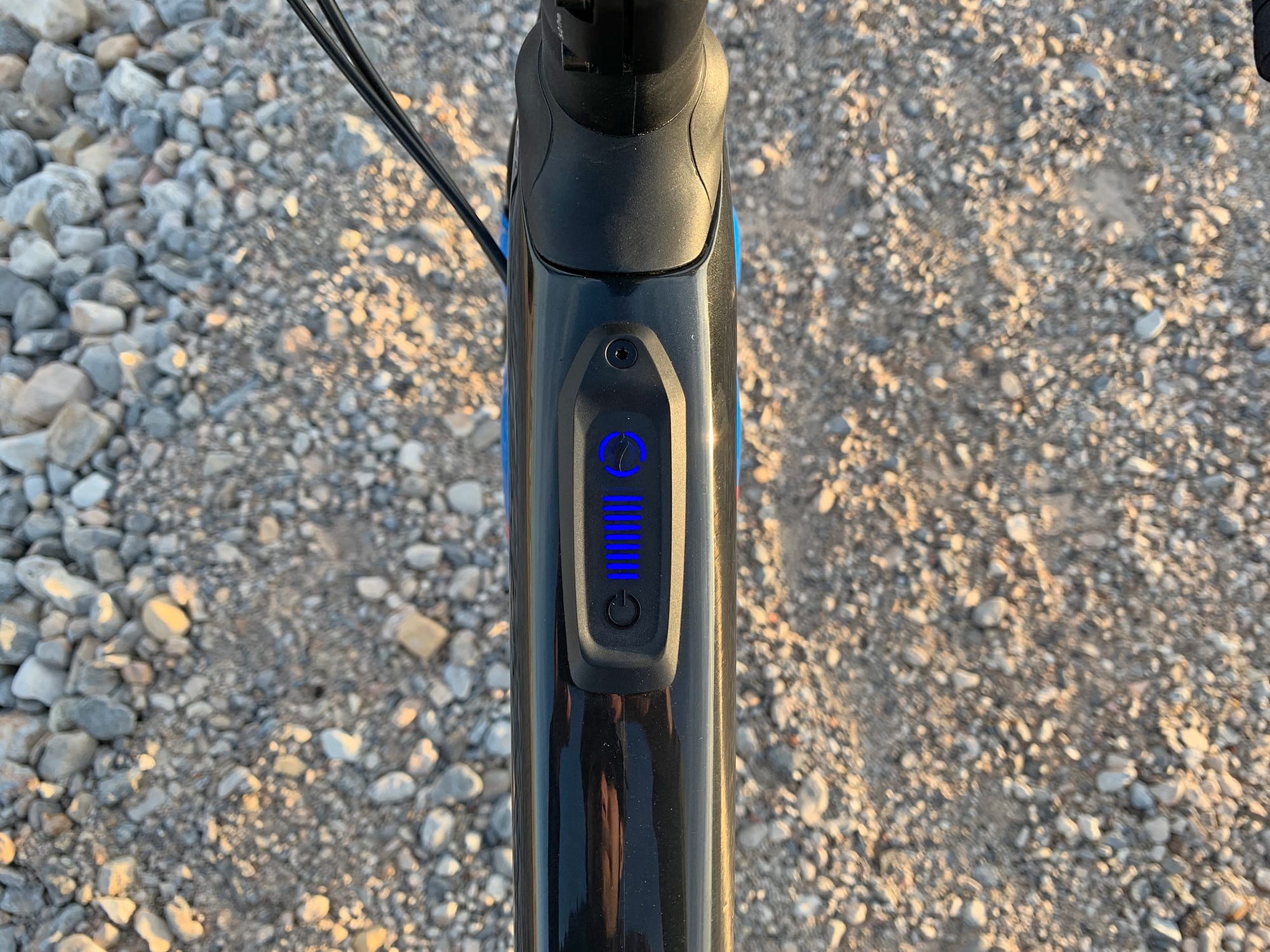

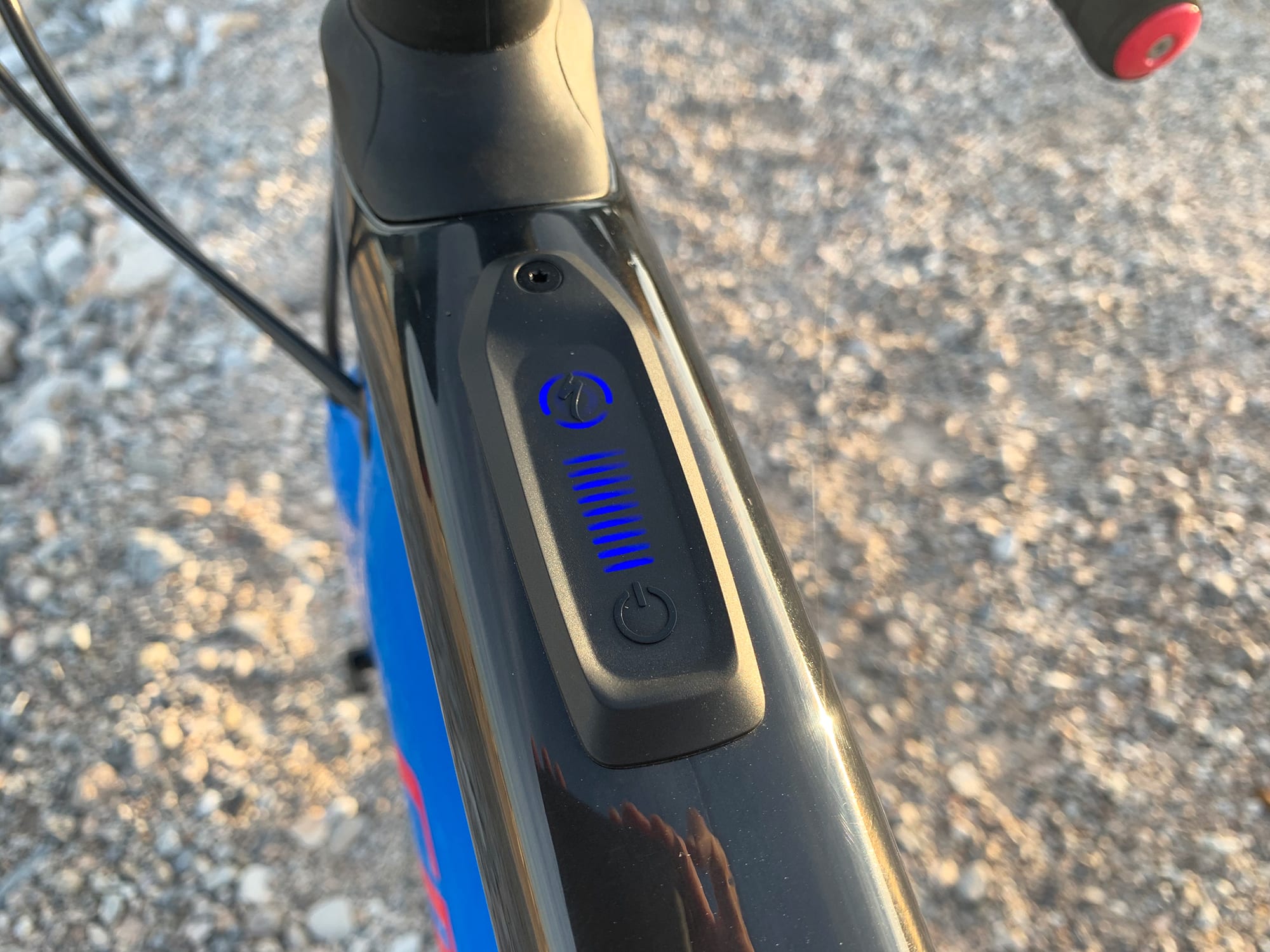

- The TCU LED console is pretty decent, but it doesn’t show your current speed, max speed, trip distance, range, or any other interesting stats. So, it’s nice that Specialized has a smartphone app offering more feedback, but it would be useful to somehow charge your phone off of the main ebike battery, a USB charging port or wireless charging mount would be awesome to see in the future

- The charge port on the bike frame is very low, so you have to bend way over, and it’s positioned in the path of the left crank arm which could snag and pop the plug out… ideally it would be on the drivetrain side of the bike vs. the brake side because the proper way to lay a bike down (that doesn’t have a kickstand) is to do so on the non-driveside
