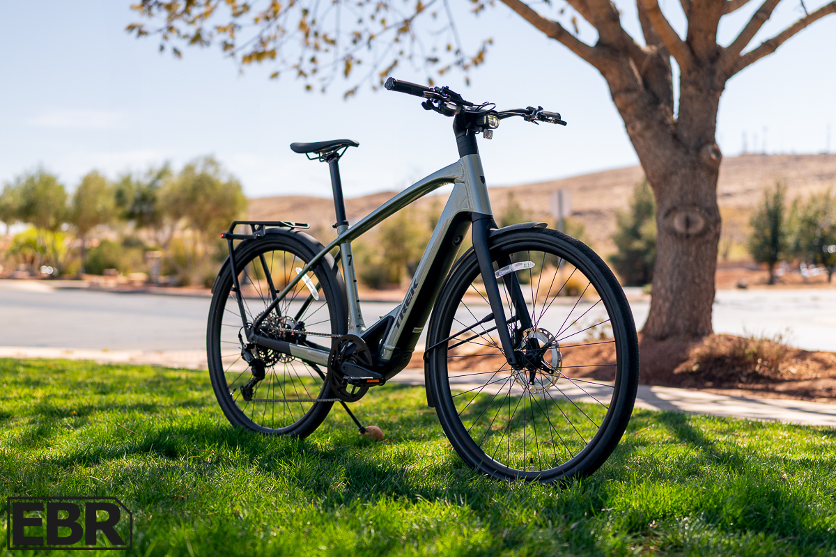

Last year, I rode Trek’s Allant+ 8S, a Bosch-powered commuter that wowed me with its smooth ride in a growing e-bike scene. Now, in 2025, I’m on the FX+ 7S in Lichen Green Moss—a matte mint green with black accents that oozes understated style. With its compact cockpit, Quad Lock phone mount, 700x40mm Bontrager H2 tires, fenders, integrated lights, and near-silent TQ HPR50 mid-drive, this bike blends modern looks with commuter-ready practicality.
Climbing on, the hybrid geometry hits a sweet spot—sporty yet comfy, with my hands resting naturally on the ergo grips. The fixed stem worked for me, but it might not fit every rider’s preference. Pedaling off, the FX+ 7S barely feels like an e-bike. No throttle, just a seamless TQ motor so quiet I wondered if I’d secretly gotten fitter. It boosts your effort without taking over, like choosing a smooth espresso over a sugary energy drink—both get you going, but this one’s refined and keeps you in control.

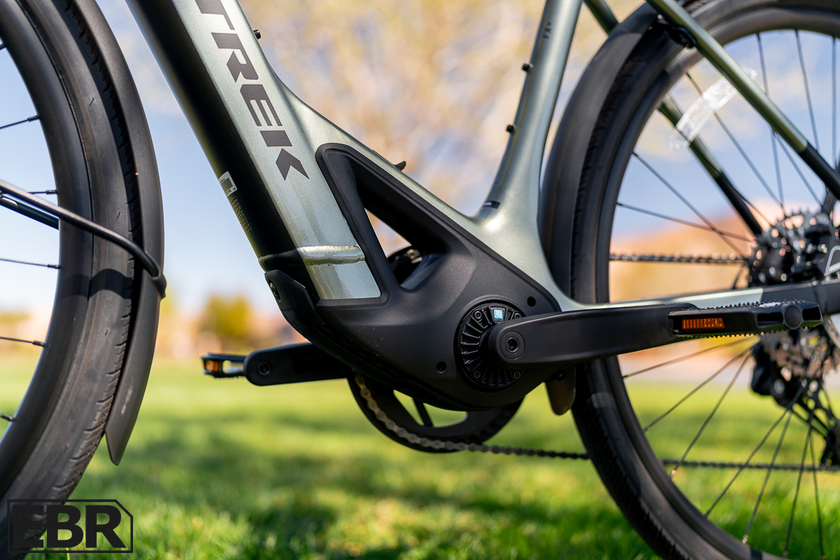

The muscle behind the Trek FX+ 7S is the TQ-HRP50, a 250W mid-drive motor that peaks at 300W’s and pumps 50Nm of torque. This setup feels right on the FX+ 7S, and sticks to its pedal-first theme, supported by the lack of a throttle.
Commuters who like to pedal get that genuine pedal feel, with the added assistance when the legs want a break. The TQ-HRP50 mid-drive is basically silent and has a natural pedal assistance that feels very premium when riding.
Once you pair the FX+ 7S with the Trek Central app, you can tweak the pedal assistance at each level (Eco, Mid and High) in aspects like the wattage, assist percentage and pedal response. However, I found the factory settings to be sufficient and aside from playing with the feature for this review, I kept the stock settings as they fit the best balance for my rides.
Powering the TQ-HRP50 is the 36V, 360Wh battery (at 10 Amp-hours) that sits fully integrated into the down tube. Being fully integrated, that means the charging the battery must remain on the bike with no off the bike battery storage or charging.

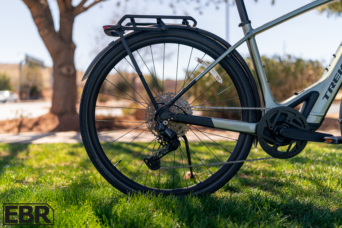

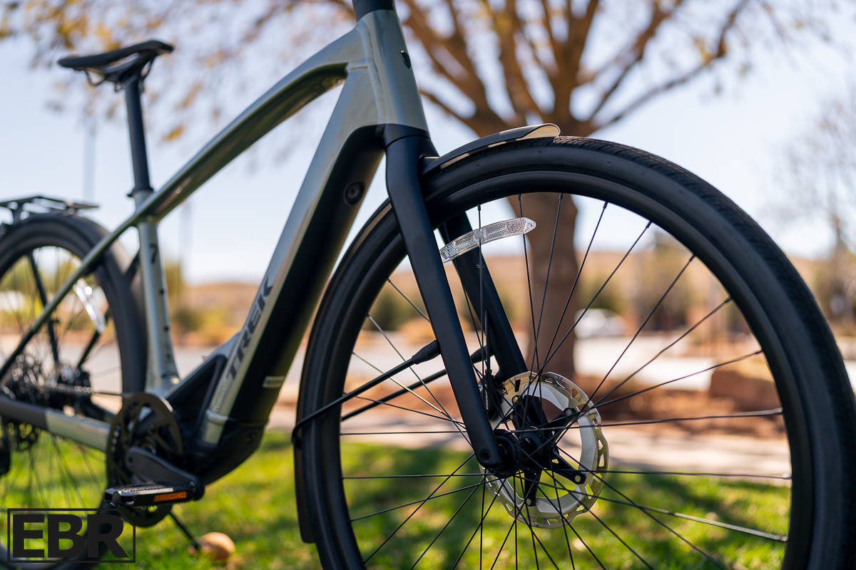

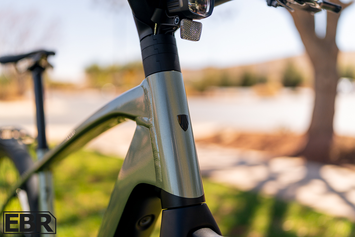

Kicking off with the frame, its Treks Alpha Platinum aluminum paired to a carbon fork. This combo keeps the bike light and the carbon fork helps with vibration dampening as well as a 12x100mm thru-axle.
The Bontrager Paradigm rims are Tubeless Ready, 32-hole, 21mm wide, with Presta valves, and roll on 14g stainless steel black spokes. Tires are Bontrager H2 Hard Case Lite, wire bead, 30 tpi, 700x40mm, with a max tire size of 700x42mm.
The drivetrain sports a Shimano U6000 10-speed shifter and a Shimano CUES U6000 GS rear derailleur. It’s equipped with a ProWheel Alloy crank (46T narrow-wide chainring, 170mm arm length, ISIS spline) and a Shimano CUES LG400 LINKGLIDE cassette (11-48T, 10-speed), connected by a Shimano LG500 9/10/11-speed chain. The max chainring size is 46T for 1x setups.

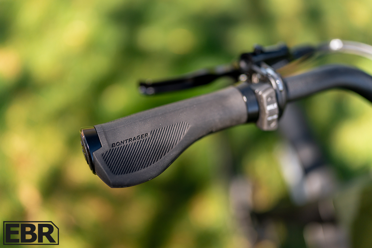

Bontrager Satellite Elite alloy lock-on grips provide comfort, while Shimano hydraulic disc brakes (RS600 lever, RS405 2-Piston caliper) with Shimano SM-RT64 (180mm up front) and RT-EM600 (160mm in the back) centerlock rotors cover the braking power.

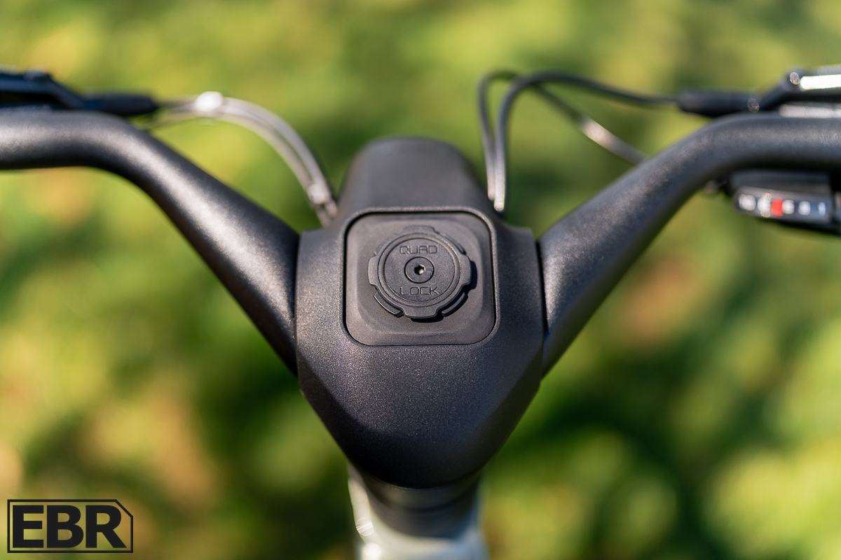

The Trek FX+ 7S swaps a traditional display for a Quad Lock integrated phone mount, a one-piece stem design that uses your phone (with a Quad Lock case) as the front-and-center display. This setup lets you view ride data, calls, or music on a device you already carry, and it’s practical—when you park, your “display” goes with you. It’s also future-proof: no hunting for outdated display hardware if the bike’s discontinued, as software updates roll out via the Trek Central app.
So, what’s the catch? The mount’s proprietary, so you’re locked into this specific stem setup with no aftermarket alternatives outside of what’s available from Quad-Lock.

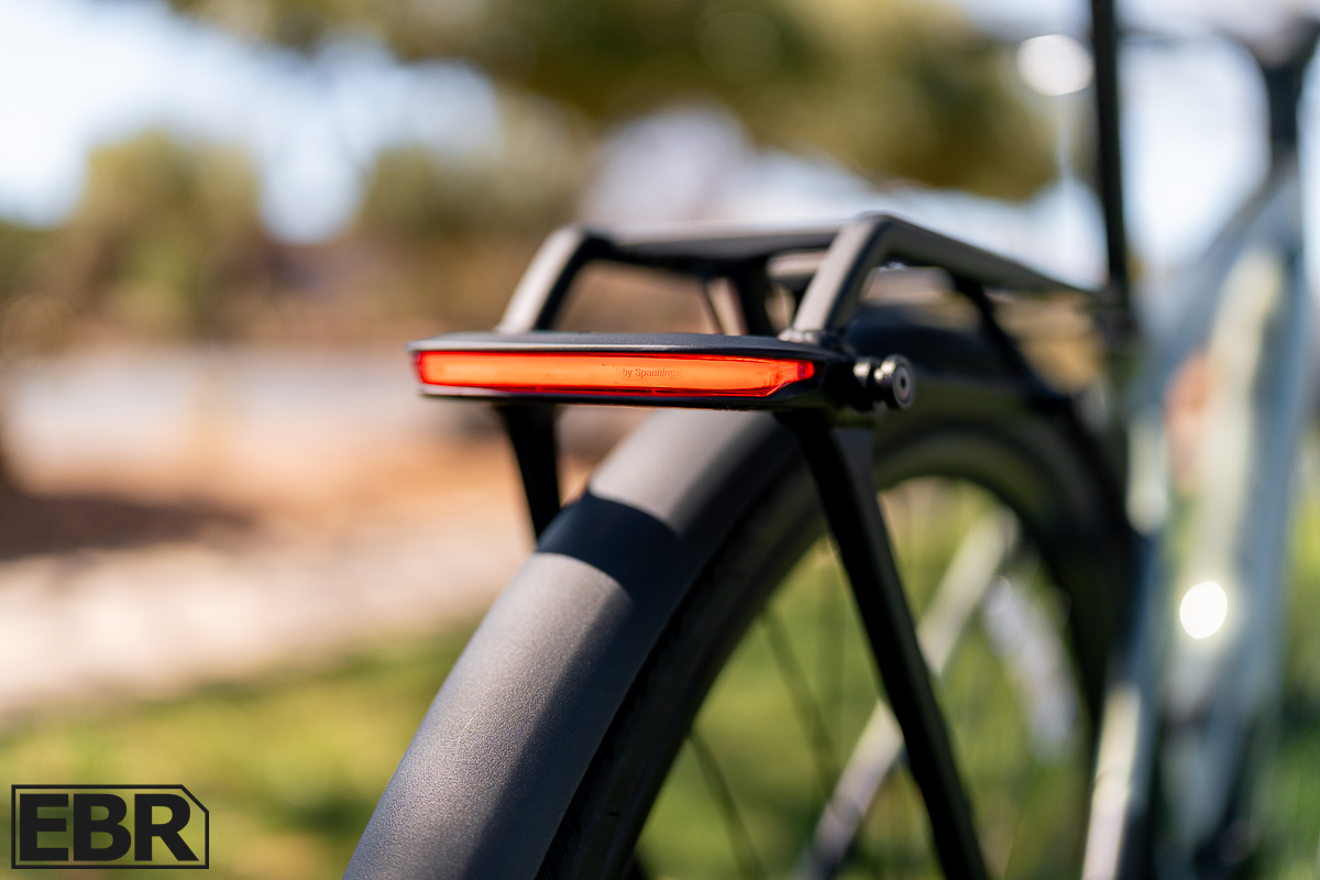

Included accessories are fenders for weather protection, an MIK-compatible rear rack for cargo, a stem-integrated Quad Lock phone mount for using your phone as a display, and front and rear lights for visibility. Optional accessories include a 160Wh range extender for extra battery life, pedals, bottle cages, and MIK bags for additional storage.
