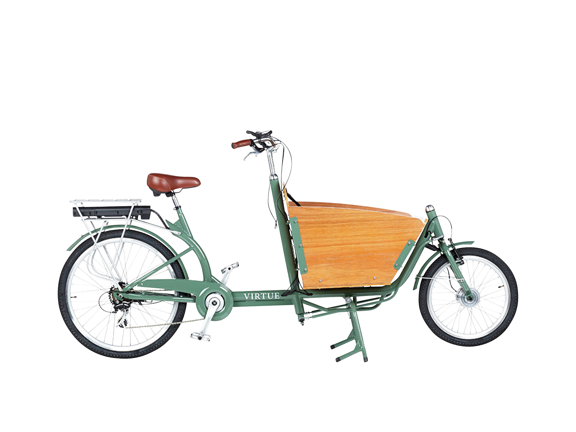

The Gondoliere+ is one of the sportier electric-assist cargo bikes from Virtue Cycles, a company that offers unique family friendly products at surprisingly low price points. The excitement around the more affordable price faded for me a bit when I got close up and realize that the battery, motor, shifter, brakes and other accessories were more generic or low-end. The ride quality is still good and the aesthetic is very impressive with the solid wood box, brown faux-leather grips and saddle and silver accents throughout. The Atlantis Green frame color was a great choice, I’d feel proud riding it around as a guy vs. a pastel peach or yellow that I’ve seen on some of the small cruisers geared more towards women from brands like Pedego and Electra.

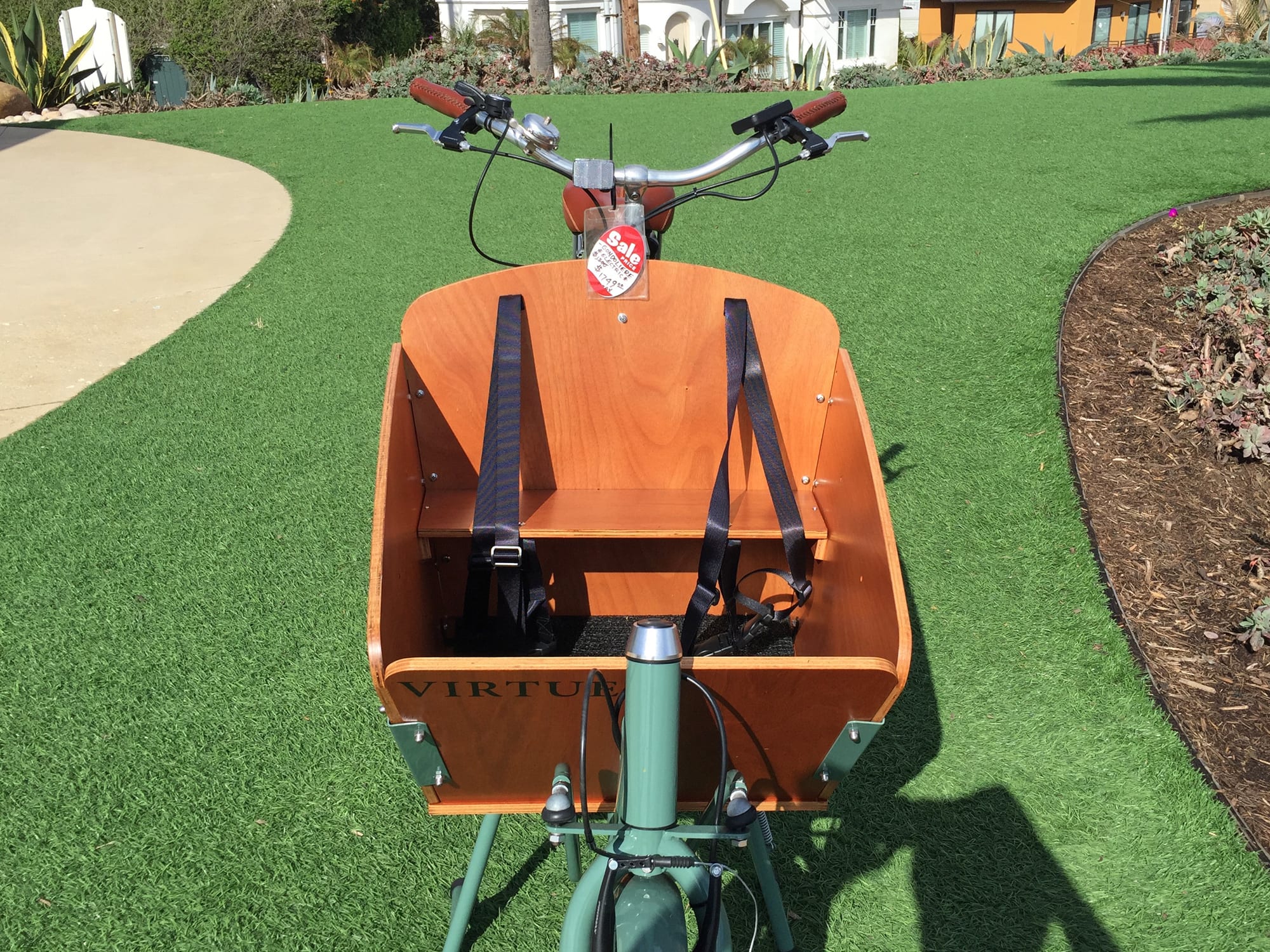

The value of this bike is that it lets you keep an eye on your precious cargo, be it groceries, pets or kids. You can look down from the relatively upright seating position and even communicate all without having to twist back as you do with most trailers and child seats. The wooden bin has a little bench seat and two seat belts designed to keep kids seated and comfortable. It would be a blast taking your kid along with their friend to the beach or park :D

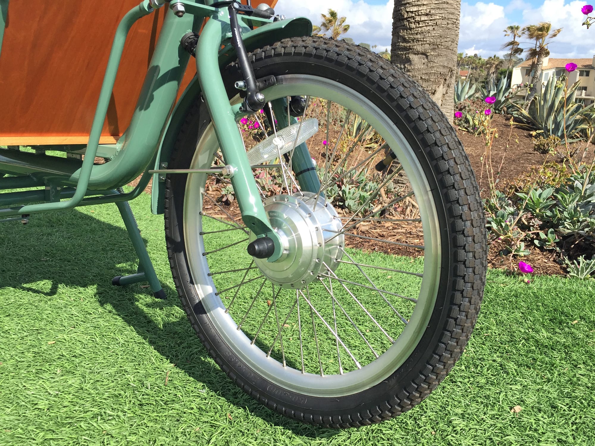

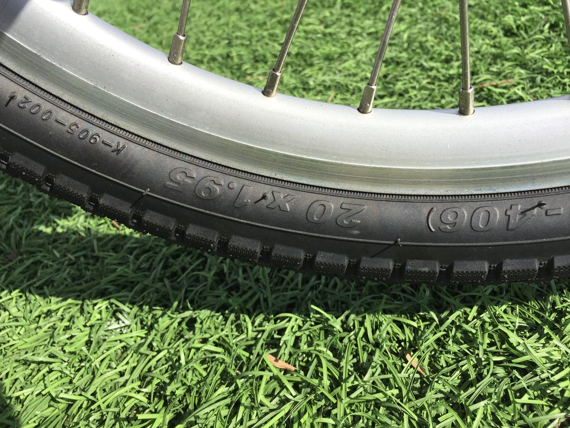

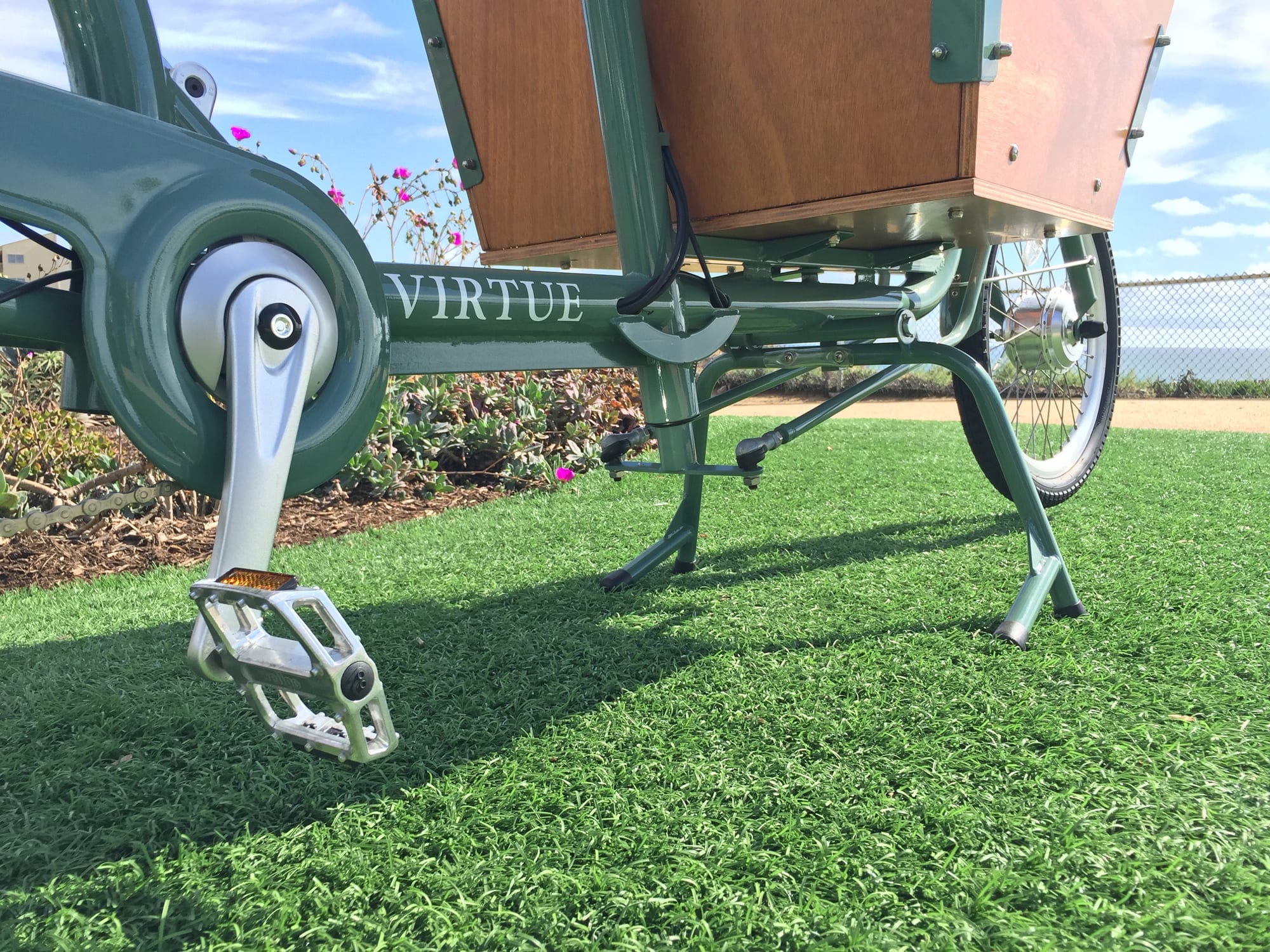

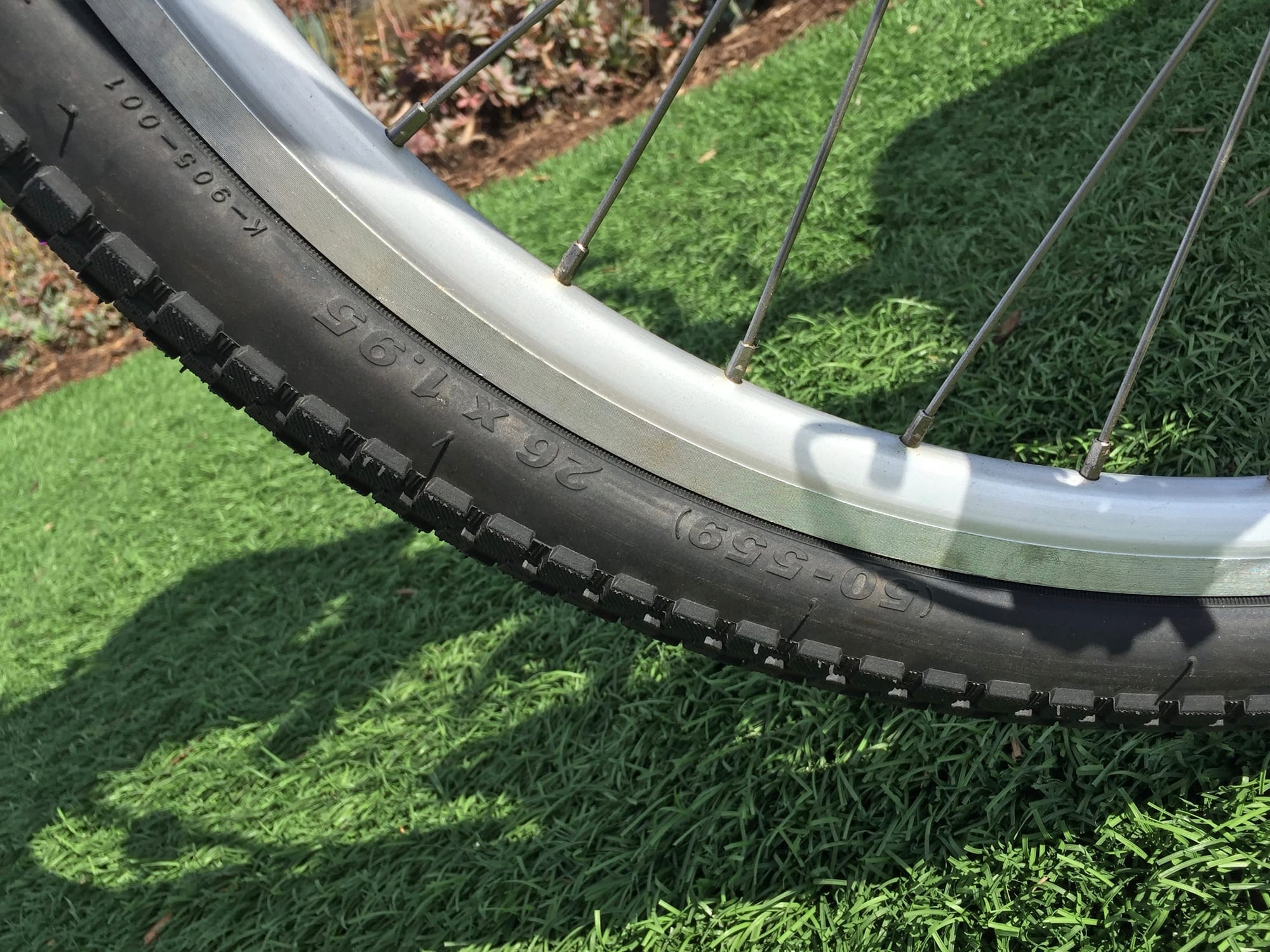

The downsides of this design, other than a few basic components, are the size and weight… The tires and tubes aren’t especially tough and getting a flat tire would be no fun as there’s no quick release and you’ll have to deal with the motor cable on the front wheel. I love the oversized super-stable kickstand and was impressed with how easily it was to activate. You can step down on one of the little pegs and roll the bike backwards to have it pop up into position. The metal fenders and chain guard add utility keeping you and the cargo bin dry and with seven gears (and a super large climbing gear) the bike was easier to move than I was expecting.
I mentioned “sporty” handling earlier in the review and was referring to the two-wheel design of the Gondolier vs. the three wheel School Bus also made by Virtue Cycles. While it takes a bit more balance getting up to speed, turning is a lot easier on the Gondoliere as you can lean side to side. Note that the clearance of this bike isn’t great, the small 20” front wheel brings the tubing close to the ground and two steering rods extend even lower. I realize this isn’t a bike you’d probably take off road but even going over curbs or tall speed bumps could be a little precarious.

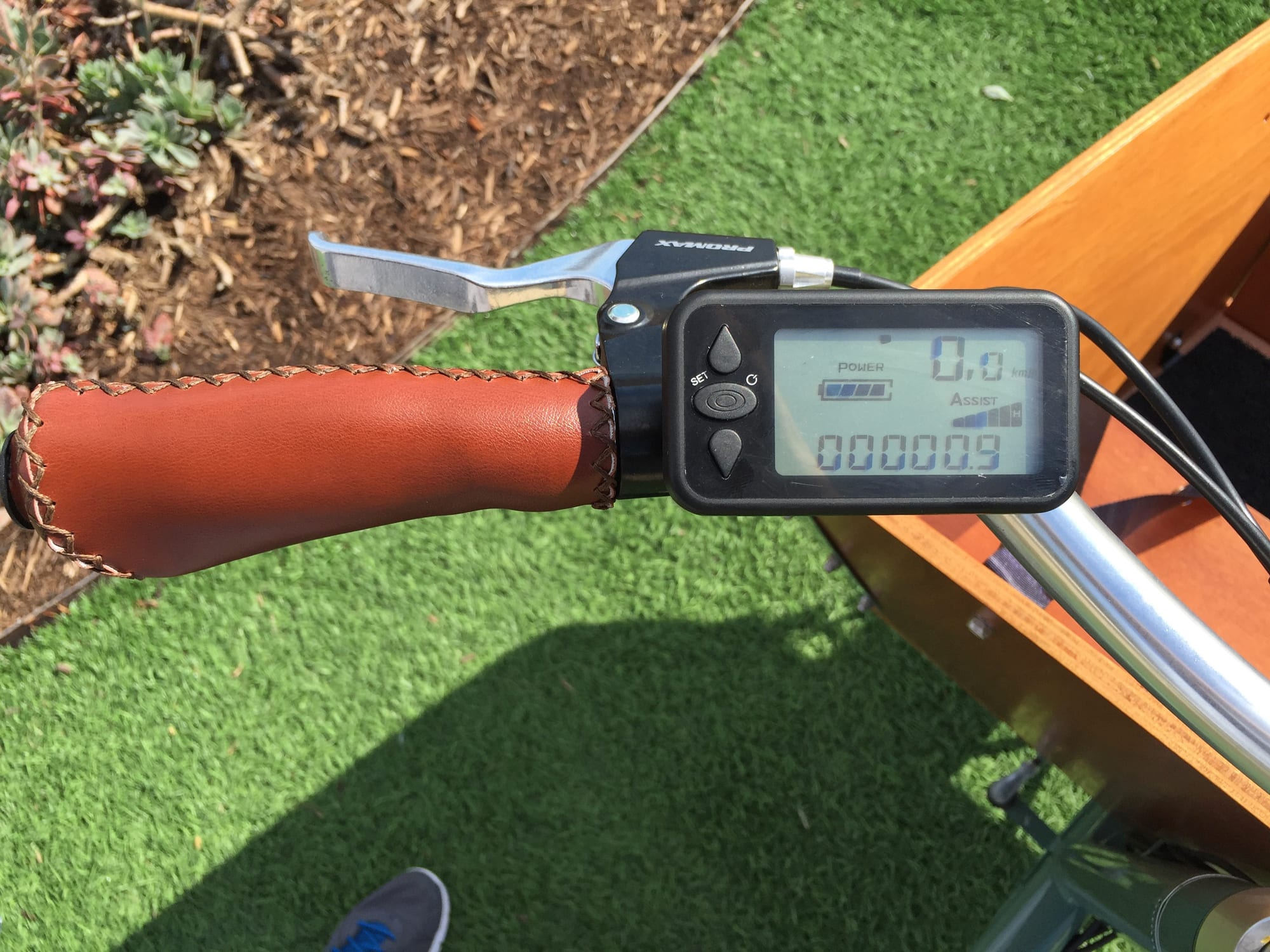

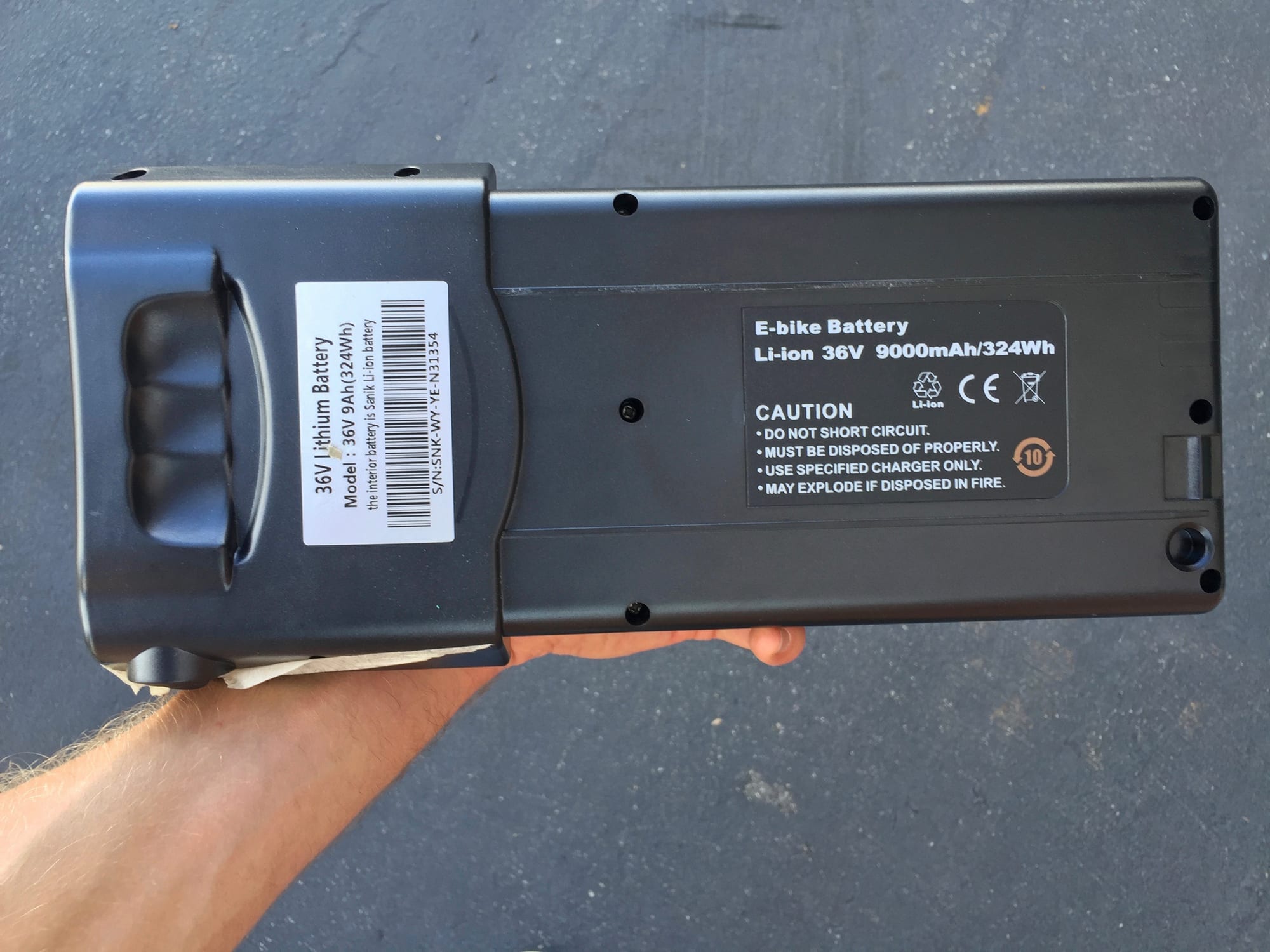

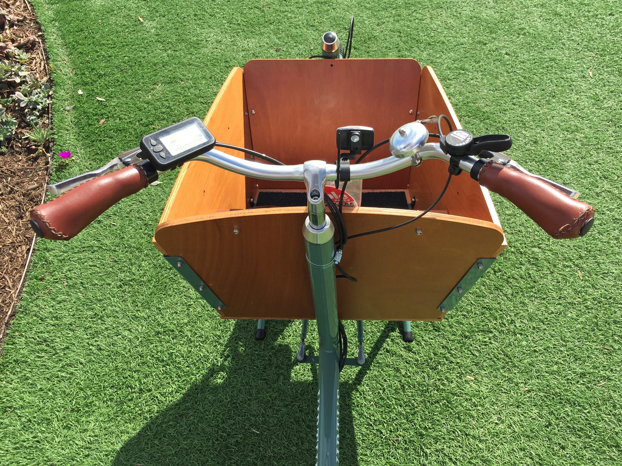

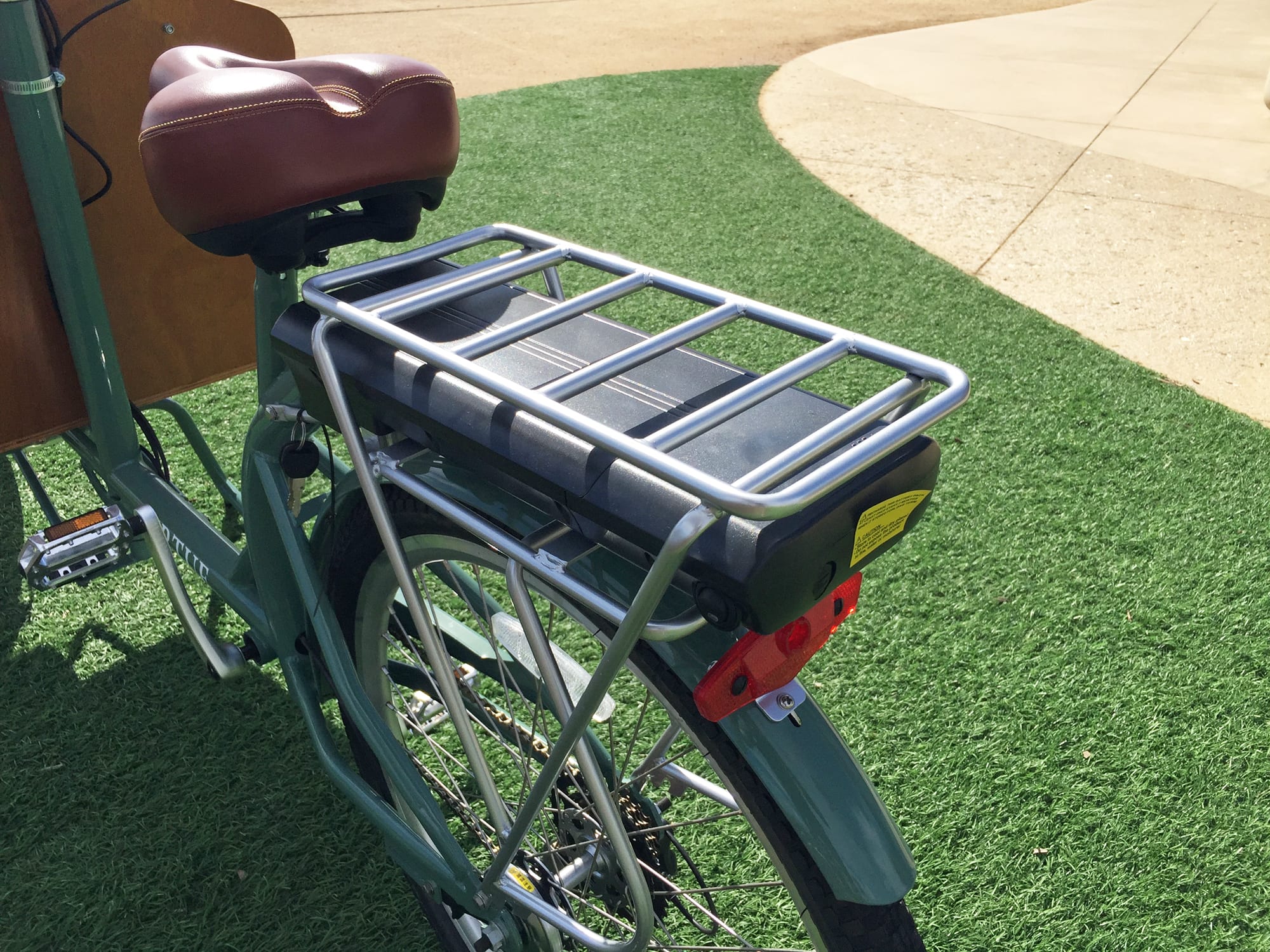

Activating the bike is a two step process with an on/off switch on the battery and another on/off button on the display. I like that the battery is easily removable and protected well inside the rear rack (which also doubles as a cargo spot, keeping sensitive gear out of the way of animals or kids feet and curious fingers). The display panel is very basic and I wasn’t able to switch from KPH to MPH, you get six levels of assist and at the highest level the bike felt very zippy. This was a surprise because a 250 watt motor is at the low-end of power in the US where legally you can get up to 750. What made it work so well is the smaller wheel it’s mounted in, and I love that the weight of the hub motor is up front and sort of pulling you along vs. in the back. I feel that it improves stability and of course the weight balances out the battery in the rear. All things considered it performed very well and even activated quickly, at first I was bummed that there was no throttle because having to pedal with a full load or up a hill with this thing could be daunting. you still do have to get it started on your own and hopefully you’ve switched down to a low gear before you stopped! But it doesn’t take long for the motor to activate and when it does you’re golden.

- Plenty of storage space inside the wooden cargo bin (which has seatbelts for two small children) and the traditional rear rack which could support a trunk bag or panniers like this grocery-bag style one – they shouldn’t rub on the wheel thanks to side blocker bars
- The kickstand offers great stability for loading the bike and is surprisingly easy to use, you step down on it and back the bike up as shown in the video

- Comfort saddle with rubber bumpers, ergonomic grips and a swept-back handlebar provide good comfort along with 1.95″ wide tires
- Whether you’re transporting kids or pets in the cargo bin you can see them the whole time without having to turn around and worry about a seat or trailer, it offers peace of mind and lets you communicate more easily as well

- Changing a flat tire on this bike could be difficult… there are no quick release systems, the tubes are different sizes (which means more fix-it gear to carry around) and the bike itself is heavy

- Activating the electric systems is a two step process (a switch on the battery and a button on the display) which takes a bit of extra effort and time and could create confusion if you hadn’t ridden for a while, I noticed that the display only shows Kilometers vs. Miles and wasn’t able to switch it

DC says
To switch from KPH to MPH, hold down Up and Down for 5 seconds. More settings can be found at this page. Not the same bike, but the controller commands seem to be the same.
Court Rye says
Awesome, thanks for the tip and link DC!
