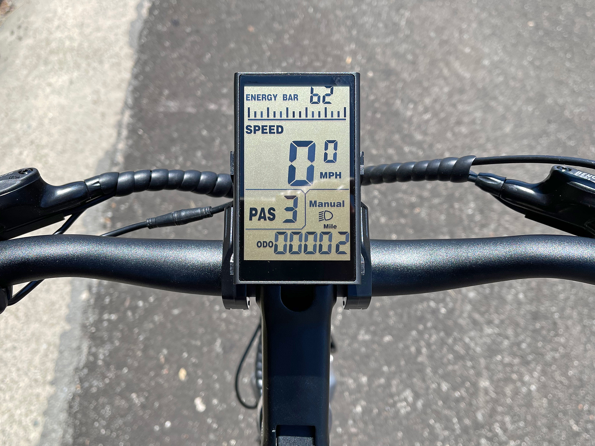

Independent Button Pad on Left, Buttons: Up, Down, Mode/Power, Lights: Hold Up Arrow, Cycle Display: Press Mode Button, Walk Mode: Hold Down Arrow, Settings Menu: Hold Up and Down, Charge Level Indicator on Battery Pack (4 LEDs), On Off Button on Battery Pack, Second USB Charging Port on Downtube Battery (5 Volt 1 Amp)
Battery Level (5 Bars), Assist Level (0-5), Speed, Average Speed, Max Speed, Assist Level (0-5), Trip A, Trip B, Odometer

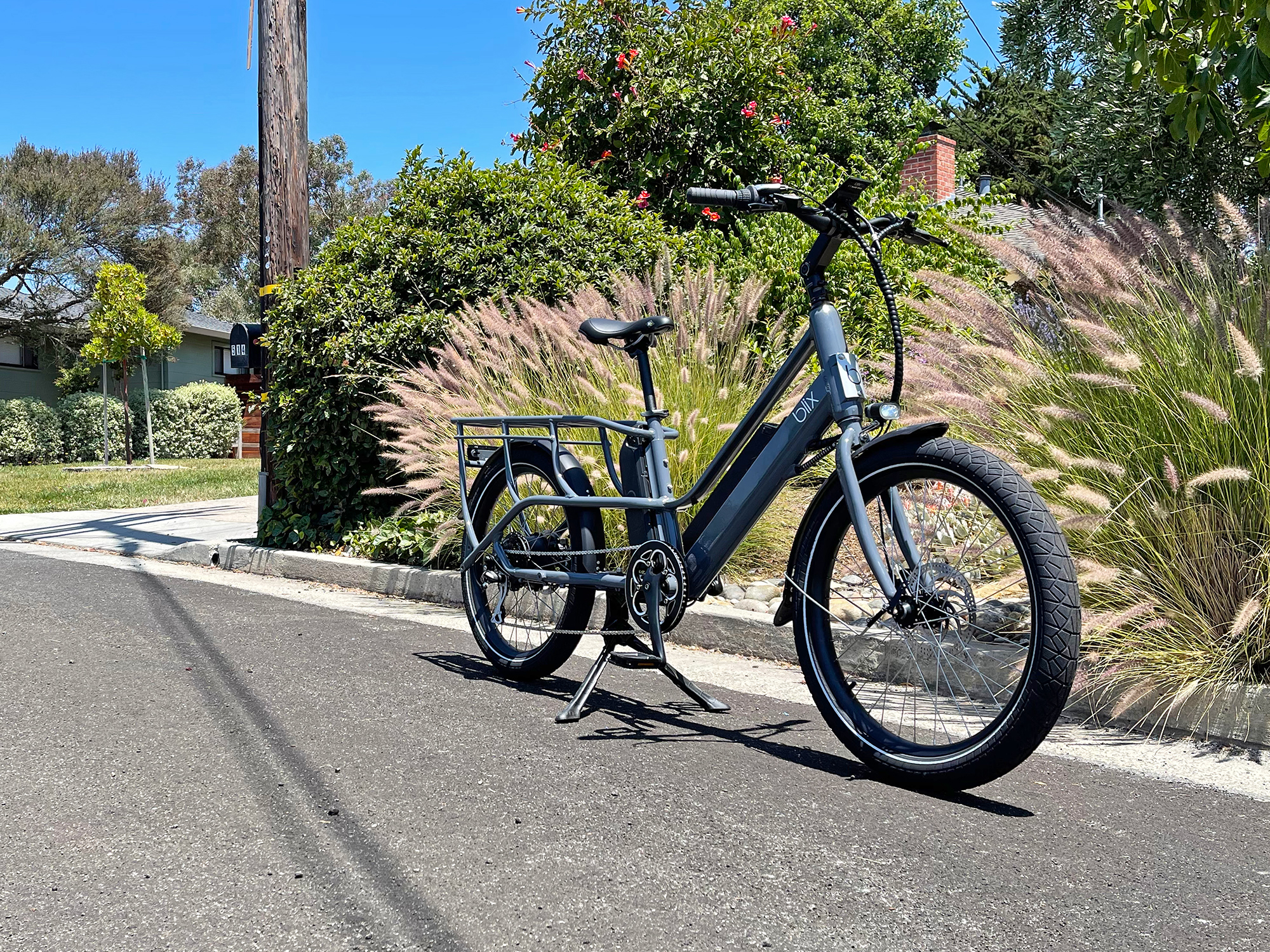

  • Amazing value here… I practically couldn’t believe that they priced the updated Packa at $1,699 with so many improvements. It still comes with extra wide fenders, integrated lights, and a high quality rear rack with lots of cargo options. I do expect that the company will raise prices as time goes on, due to supply chain constraints that everyone is facing… but wow, they are really committed to value here.
  • Beautiful custom frame design, it was redone since the last generation to improve stiffness and add functionality without adding weight. I love that it’s now available in three frame colors vs. just two, and that the fork and battery cover are paint-matched!

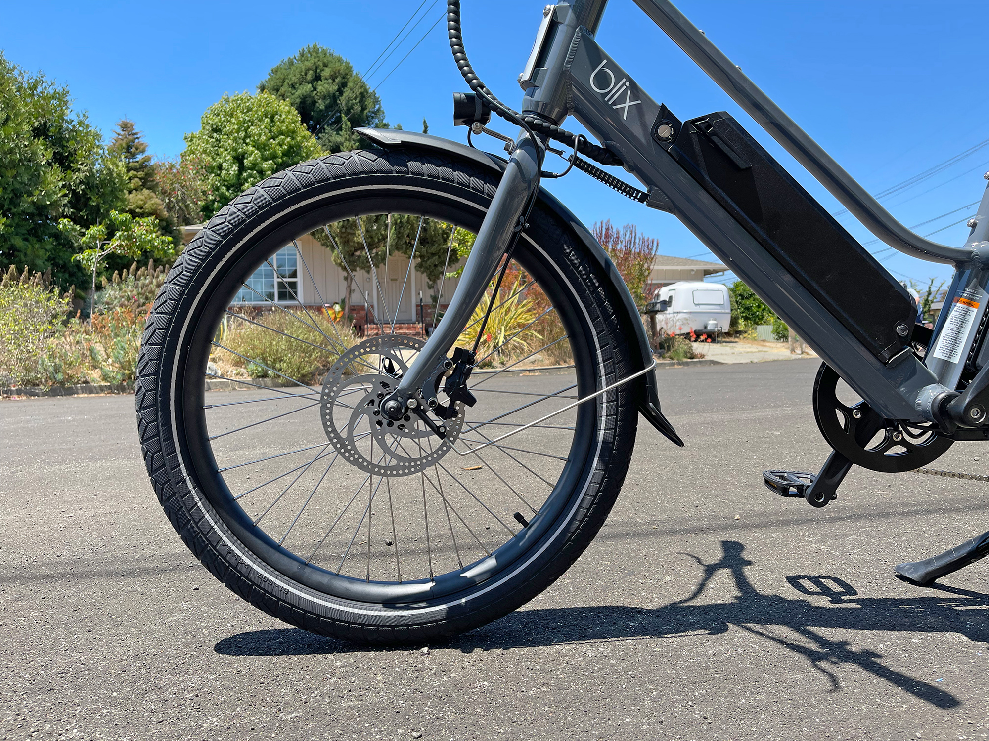

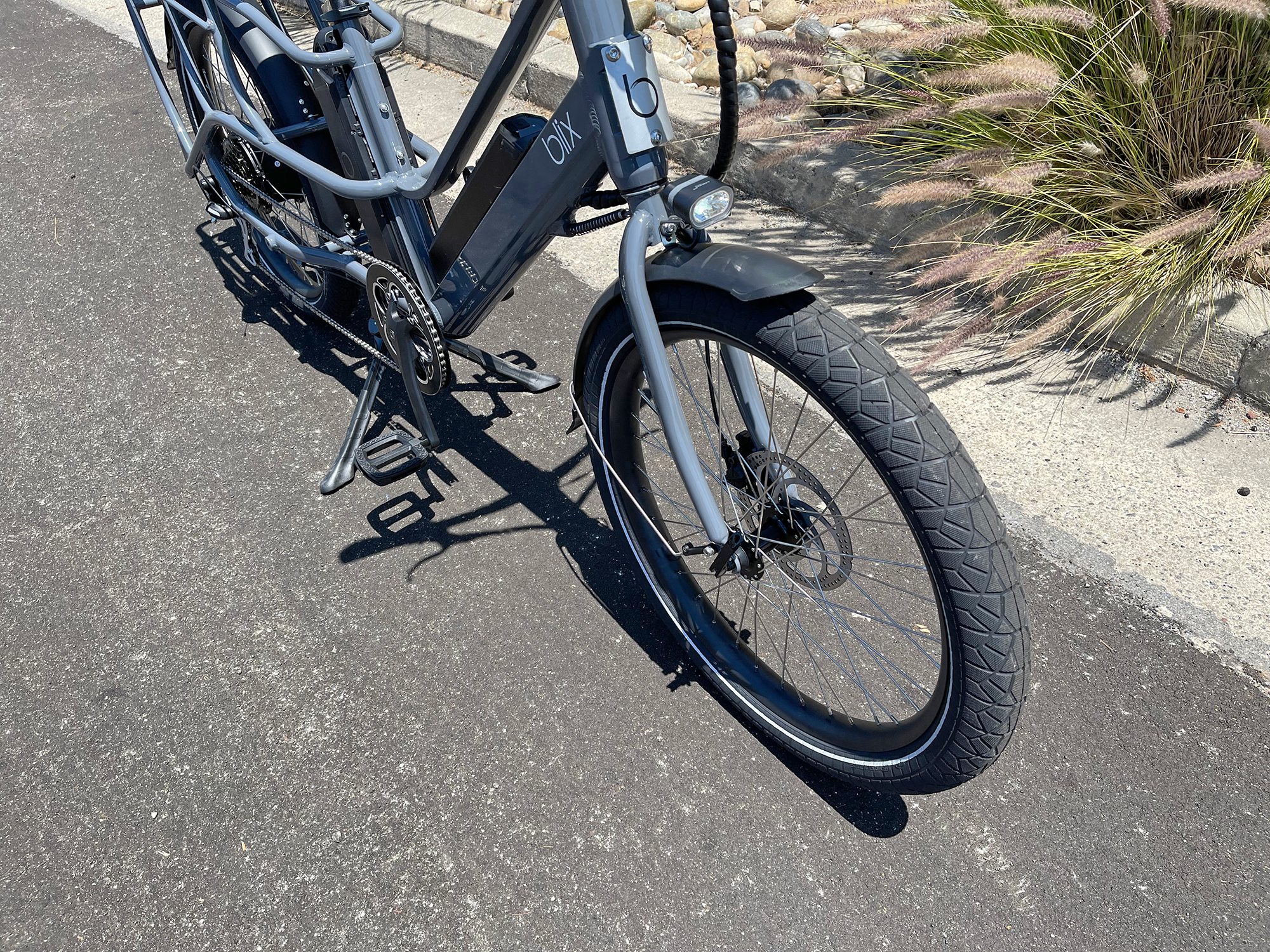

  • Blix decided to use matching 24″ tires on the Packa, so you don’t need as many different sized replacement parts. By choosing 24″ vs. 26″ they gave the motor a greater mechanical advantage, added wheel strength, and kept the rack lower to the ground for easier to load, but didn’t sacrifice as much comfort as 20″ wheel size.
  • I love that they chose puncture resistant tires that have reflective stripes for safety, and made the front wheel quick release for easier maintenance.

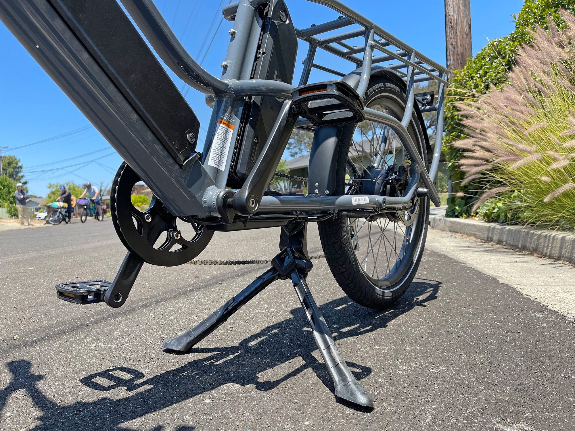

  • Mounting and loading the bike is very easy thanks to the giant double-leg kickstand and stabilizing “deflopilator” spring at the front fork. I like that the kickstand offers some adjustment too, so you can make it fit your environment and fine tune things over time.

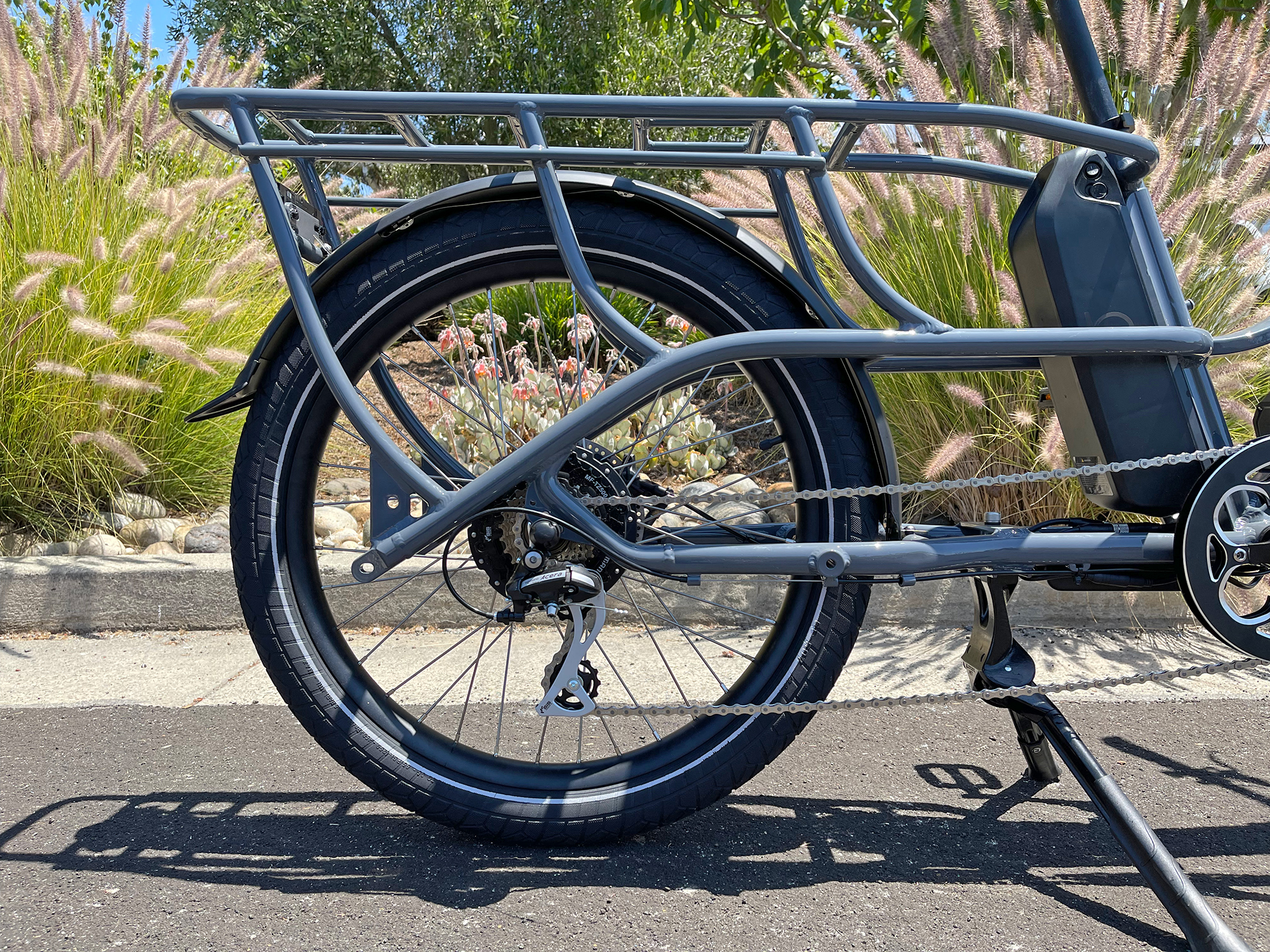

  • The drivetrain is pretty good for around town riding with a wider 14 to 34 tooth cassette (vs. 14-28 on most of their other models) and an alloy chainring guide to reduce chain drops. The chain is also rust-resistant, and should last longer than average.

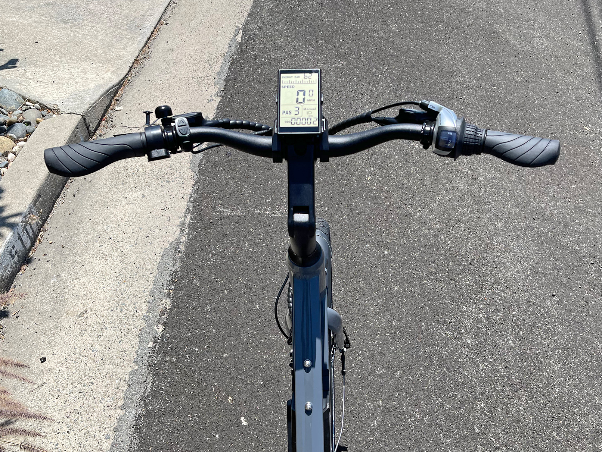

  • The LCD display panel is center mounted and fairly large, making it easy to read. Most of the controls on this ebike are intuitive, including the half-grip twist shifter that switches gears. It has an optical window on top that displays the gear you’re riding in.
  • It’s neat that both the LCD display and battery pack have 5 volt 1 amp USB charging ports built-in! This could be useful for charging portable electronics, additional lights, or even for picnic situations where you remove the main battery and bring it with you. I like that the main battery has a USB port built into the side, so you can run portable electronics in a tent or at a picnic separate from the bike itself (if you remove the battery).
  • Blix has left the display panel open, so you can adjust the settings… including top speed. You can lower the top speed to improve range and add some safety, or raise it a bit and operate the bike more like a Class 3 speed pedelec if you’d like. They ship it at 20mph 32kmh to comply with legal framework for Class 2 ebikes. You could unplug and remove the throttle easily and ride this as Class 1 if you wanted.
  • Blix is using a high resolution cadence sensor with 12 magnets, so pedal assist feels very responsive. The sensor is compact and appears to be well sealed against water and dust, good choices.

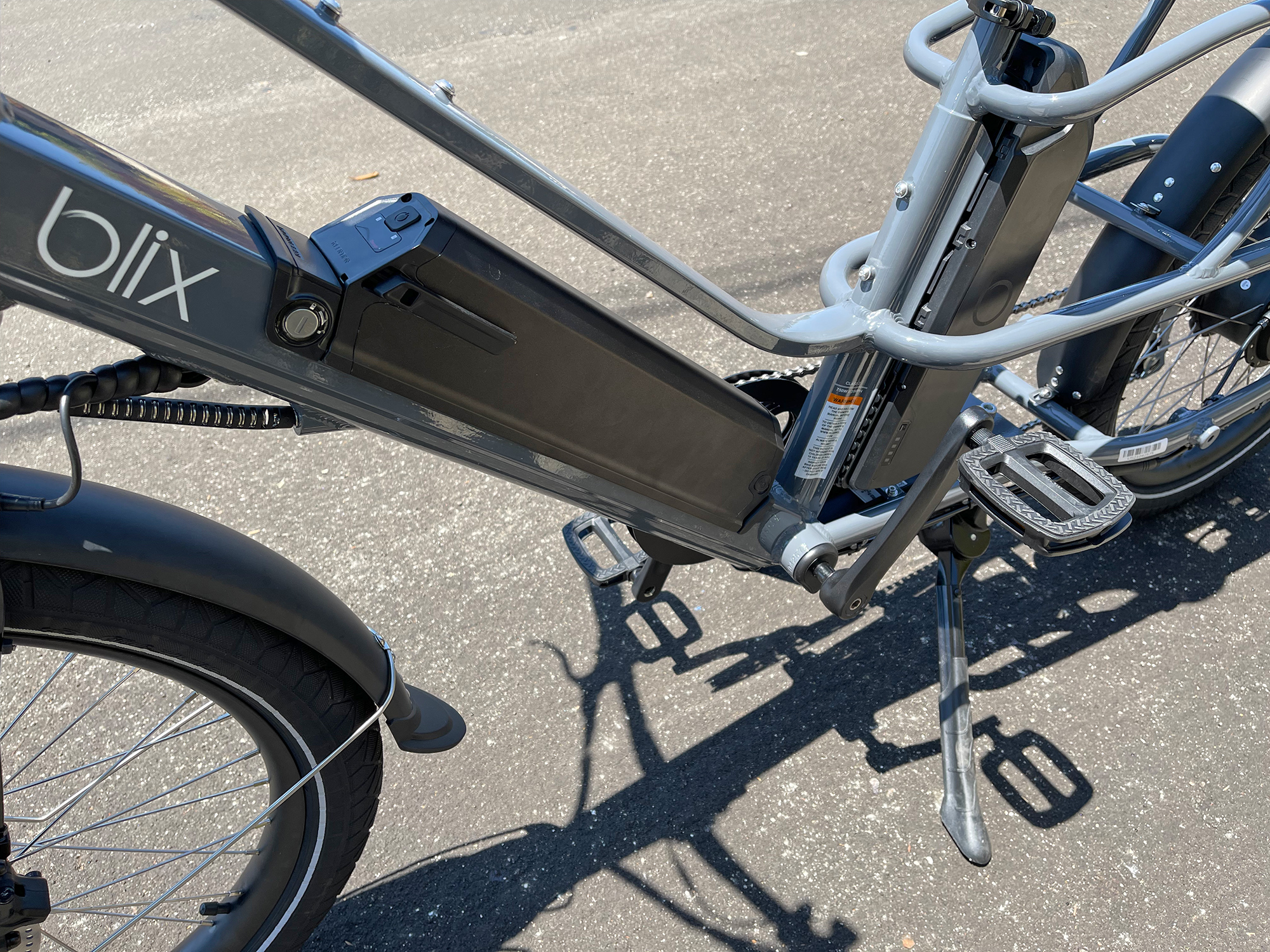

  • Updated battery pack design (only for the optional second pack). They are using very high quality Panasonic cells and spacing them apart in the casing for improved air flow and durability. The 48 volt system provides efficiency for sending energy and also increases the potential power output. This enabled them to increase motor power to 700 watts and get that high 90 newton meter torque rating.

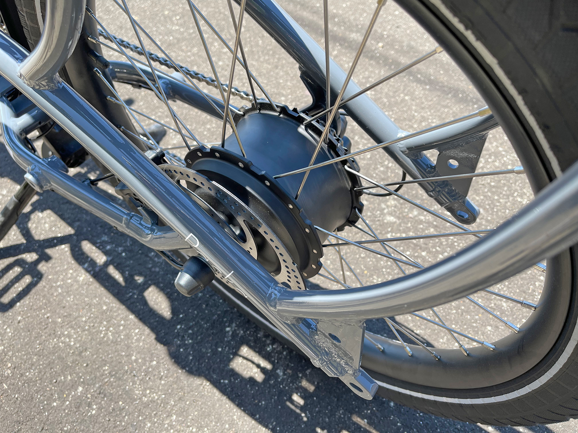

  • Notice the wide rear hub spacing (175mm like you’d see on a fat tire bike), which provides more space for the powerful motor. Blix also increased the motor controller amp output to 15 amps continuous and 25 amps peak, so the motor can operate efficiently. And, they moved the motor power cable to the non-drivetrain side of the bike to reduce clutter and add physical protection if the bike tips.

  • The optional second battery pack is much easier to mount, remove, and interact with. It’s mounted to the seat tube vs. rear section of the frame, so weight distribution is better and there’s more space around it. There’s an on/off toggle switch on this pack, so you could disable it and only drain the main battery if you wish. When both packs are mounted and switched on, the Packa Genie controller alternates between them automatically, to drain them evenly as you ride.
  • Geared hub motors are known for being compact, lightweight, and efficient. I’m familiar with the Shengyi brand. This bike felt very powerful, and I was able to test it out by climbing a steep hill on throttle only (no pedaling). It seems like a solid choice, based on what I’ve observed from competing hub motor powered e-cargo models.

  • I saved one of my favorite upgrades for last, and that’s the hydraulic disc brakes! They are still using large 180mm rotors that offer improved mechanical advantage and cooling, and I love that the levers have motor inhibitors, brake light activation, adjustable reach, and there’s a bell attached to the left lever!

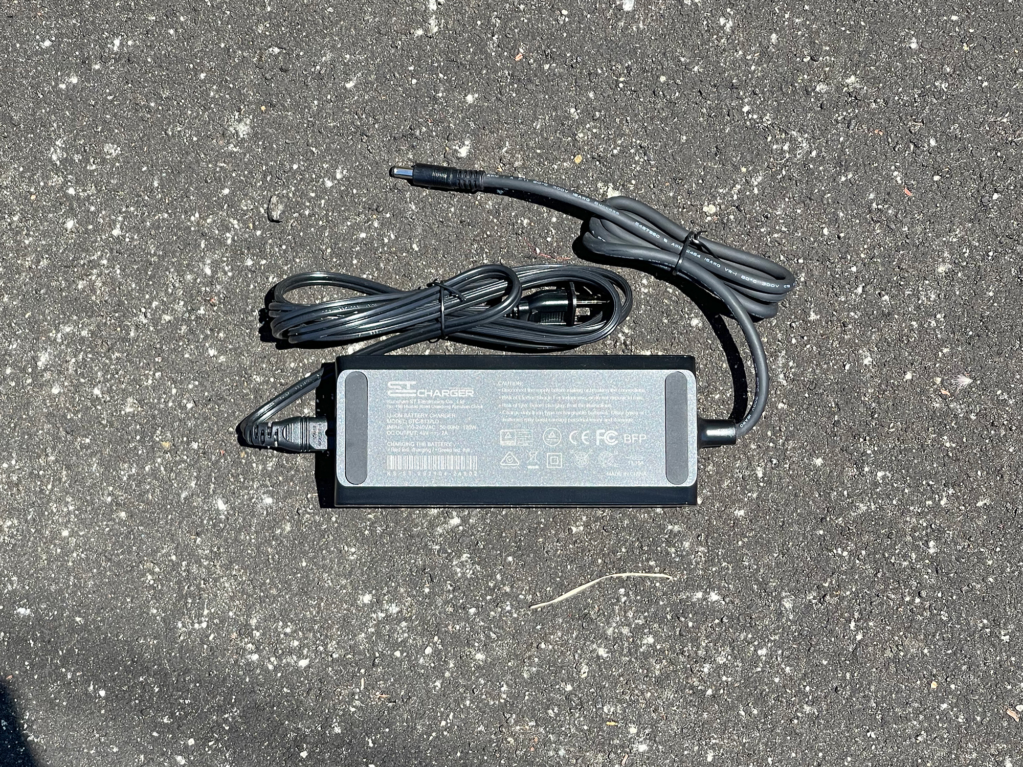

  • The new battery charger feels solid and looks great, it’s fairly small and lightweight, but I think it’s slower than before. You get a standard 2 amp charger here vs. 3 amp, and it can only charge one battery at a time (if you opt for a second battery pack). It could take 7 hours to charge each pack from empty, so consider buying a second charger if you plan to get the second pack use both batteries regularly.
  • Similar to the need for two charger situation, if you opt for the second battery pack, it will come with a unique locking core and key. This means that you’ll have to keep track of more keys and spend more time trying to figure out which one is for which battery. Perhaps you could paint a dot on one or use some colored tape to save time?

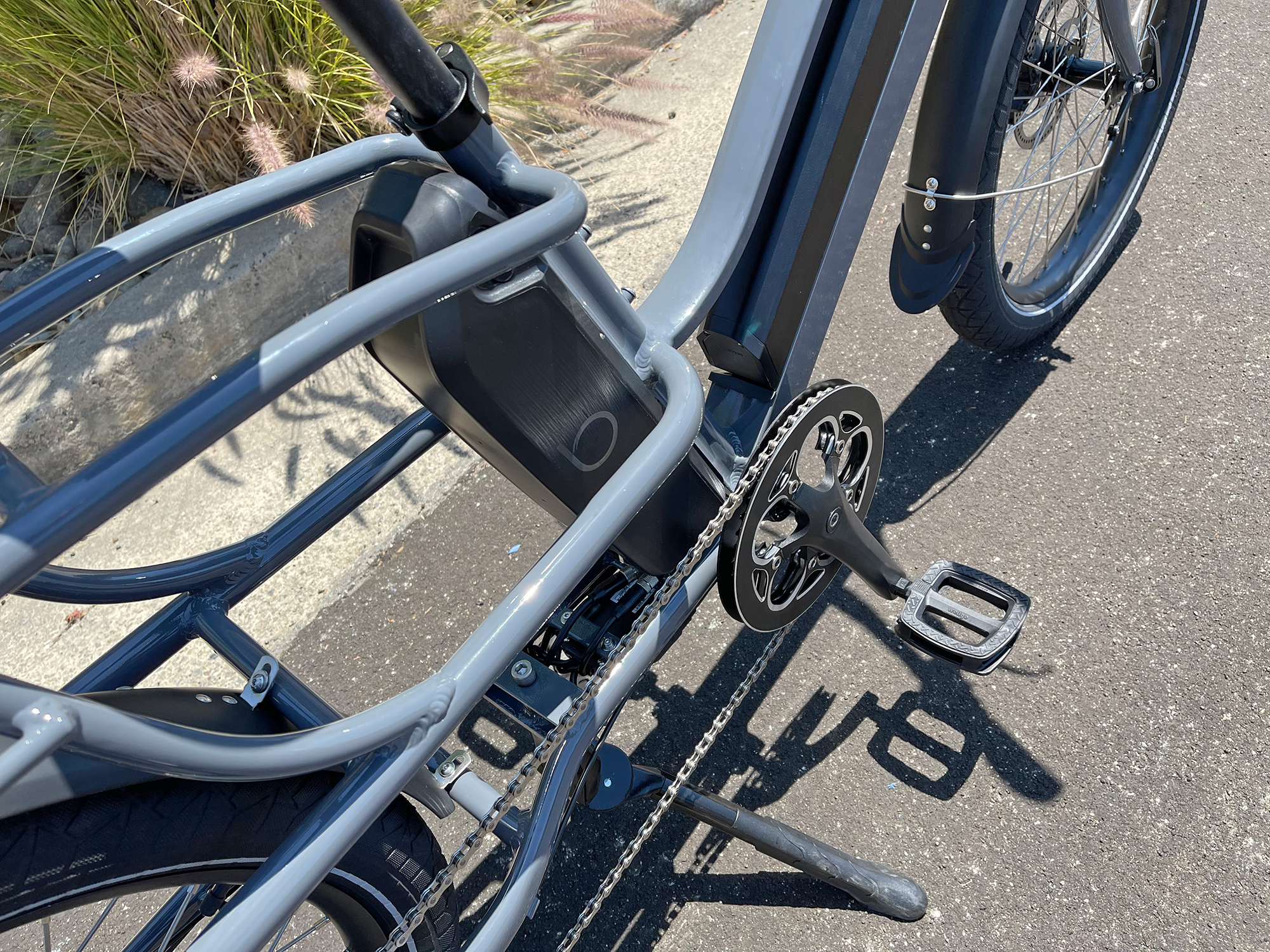

  • The long chain and mid-level derailleur results in some bouncing, producing noise and possibly marring the frame. I was surprised that Blix had not added a slap guard. Consider using some box tape to protect the right chain stay as a cheap and easy solution.
  • Minor complaint, the frame only comes in one size… but the mid-step design is fairly easy to approach and the adjustable angle stem, swept back handlebar, and adjustable seat height offer a wide range of fit options.
  • The charging port for the main battery is low down on the left side of the frame, directly in the path of the left crank arm, so be careful not to bump the pedals while it’s plugged in or the plug and socket could get damaged.
