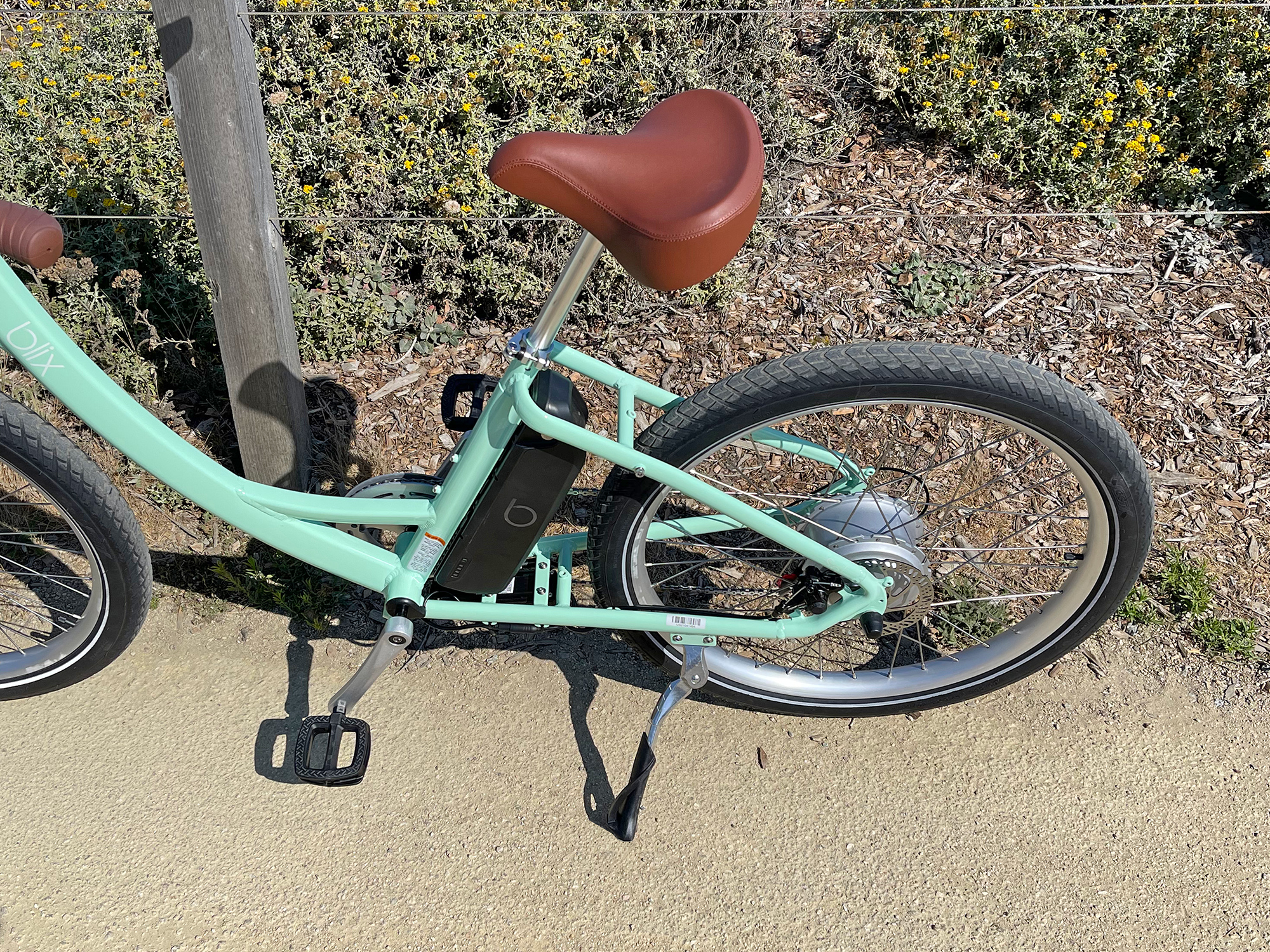

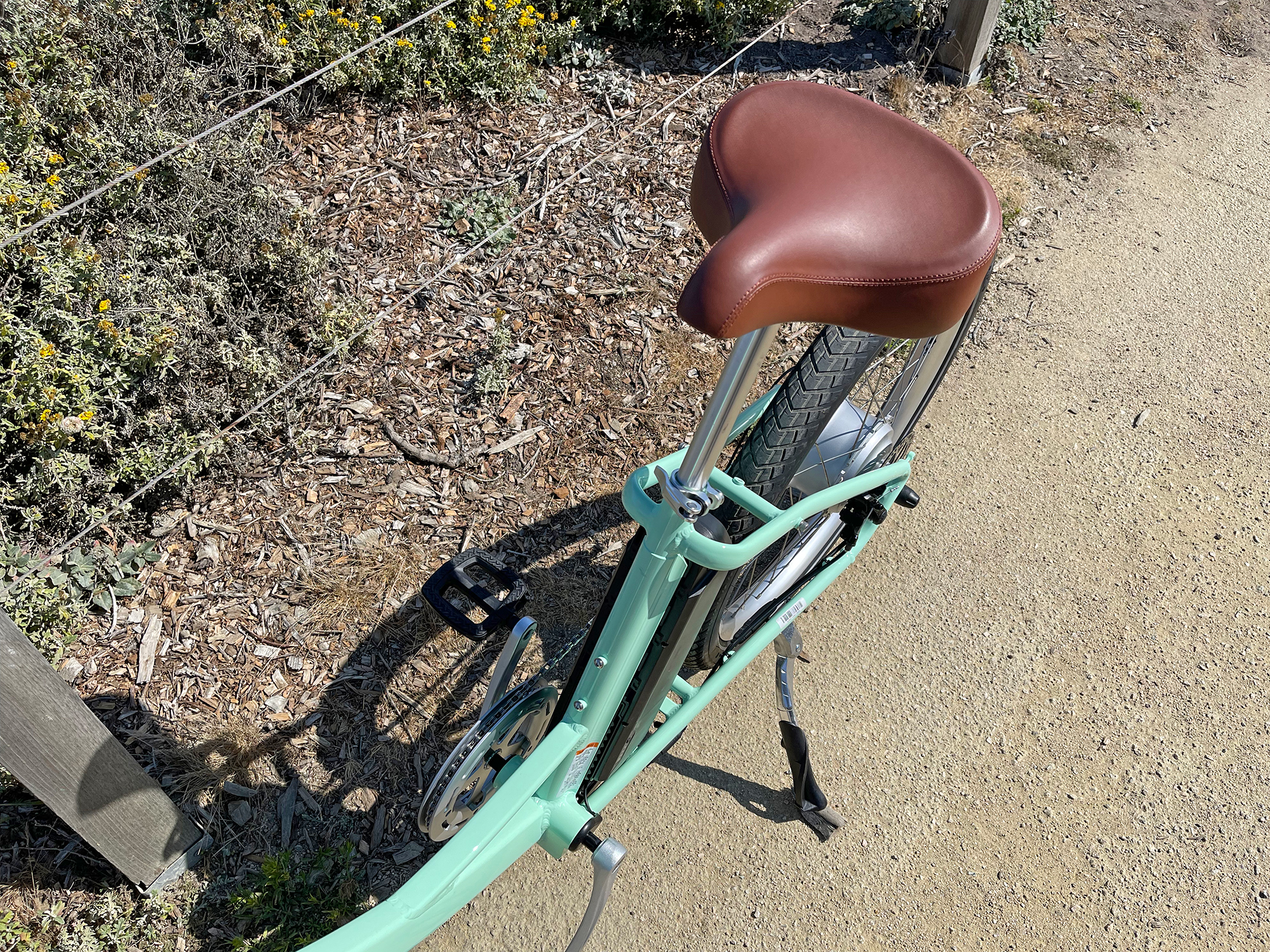

- Battery weight is positioned low and center on the frame, behind the seat tube so the pack won’t get kicked when you step onto the bike. They also included a pair of braze-on bottle cage mounts on the front side of the seat tube! I like that they actually welded on the threaded eyelets vs. screwing directly into the tubing, because it adds strength and might allow the seat post to go lower.

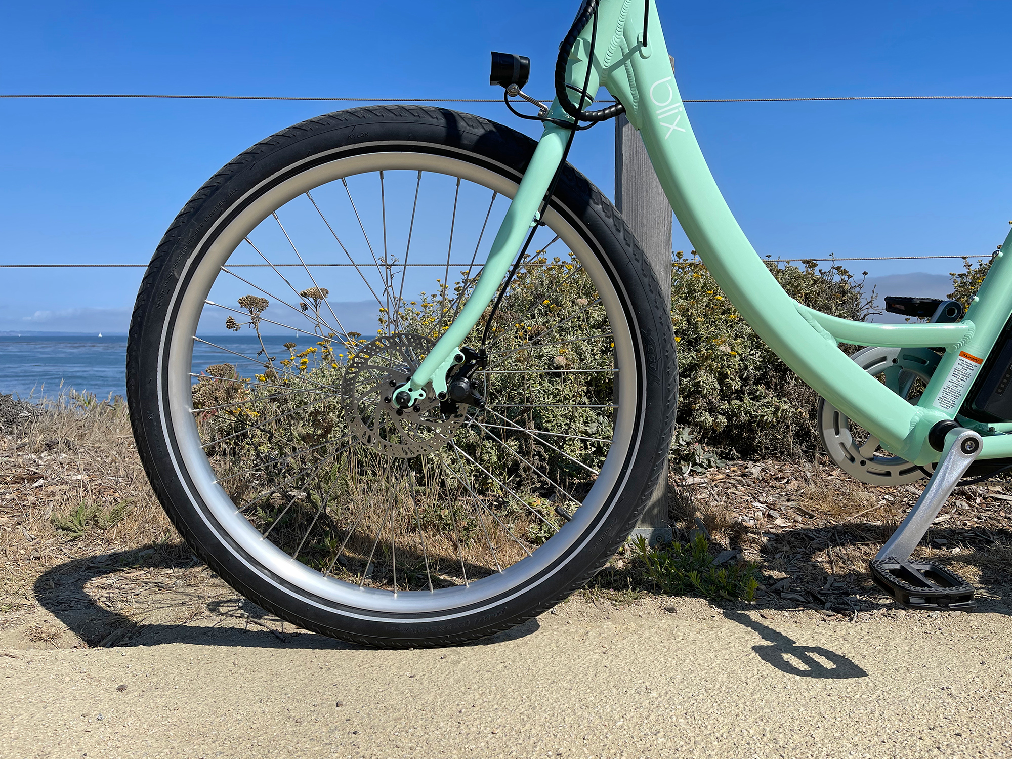

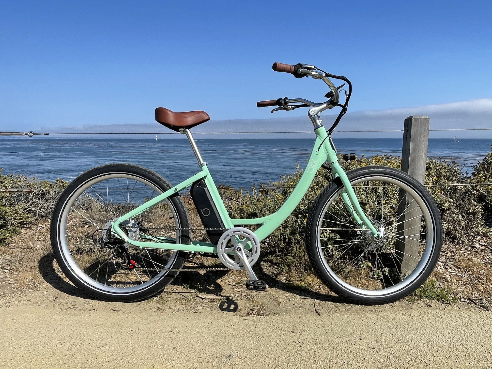

- Interesting wheel size here! Blix chose 27.5″ to smooth out the ride vs. 26″ on most cruisers. This larger size does raise the frame about 0.5″ but lowers the attack angle of the wheel and adds air volume. Note the wider 2.4″ tires they chose, which also add air volume, comfort, and stability.

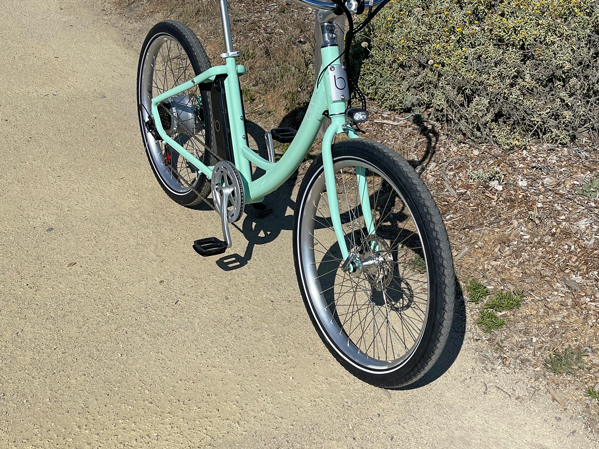

- As with most step-thru wave style frames, this ebike is extremely easy to approach, mount, and stabilize. I found that the frame reinforcement was strong enough to reduce flex, so it felt steady when riding. I love the adjustable kickstand that they chose, and appreciate that it’s mounted far enough back to be clear of the crank arms when deployed, so you don’t get pedal lock when backing the bike up.
- The bike felt very comfortable to me, even without suspension, because of the higher volume 2.4″ wide tires, upright adjustable angle stem, long swept back handlebar with ergonomic grips, relaxed head tube angle, and steel fork (which helps to dampen vibration).

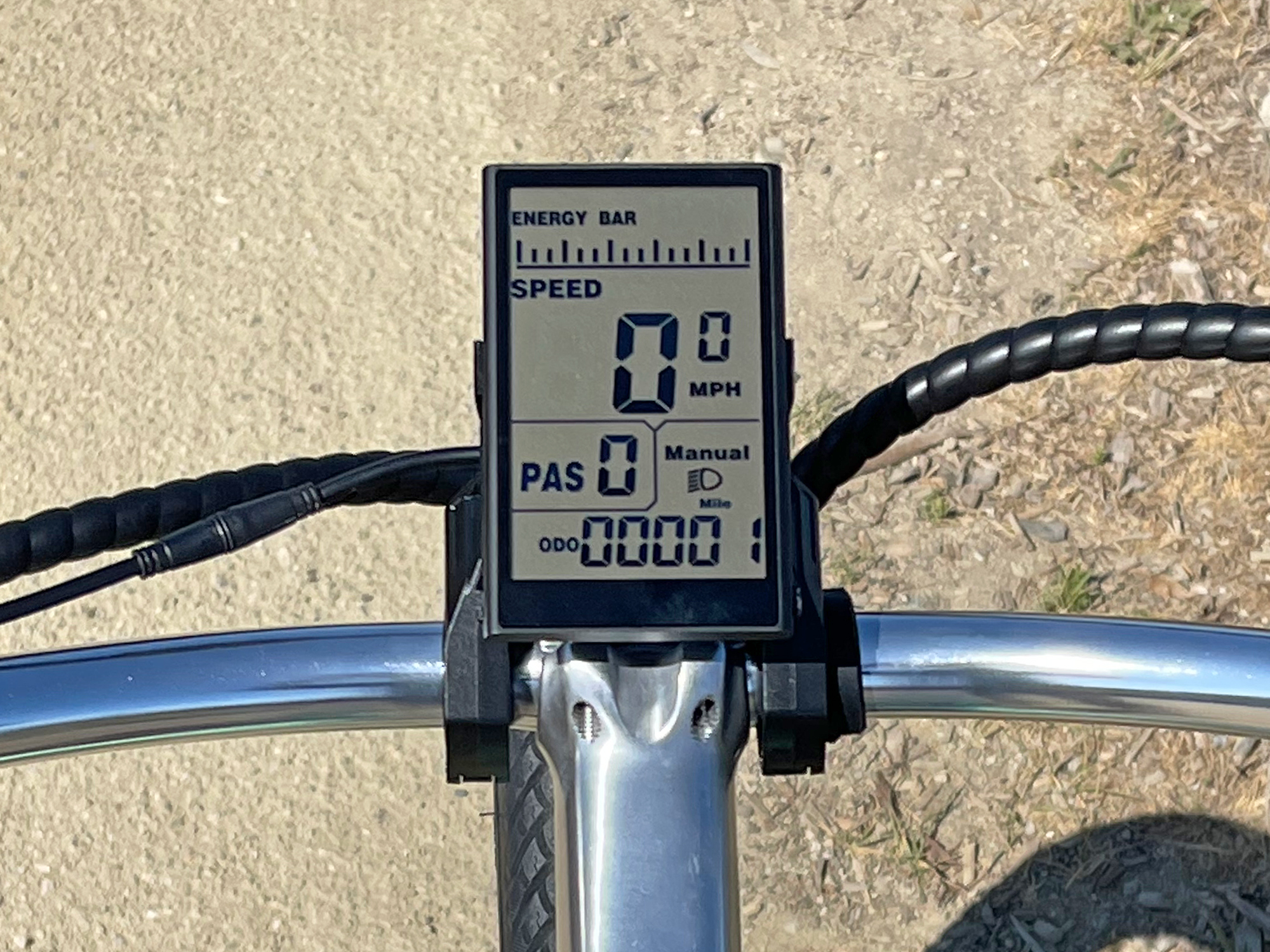

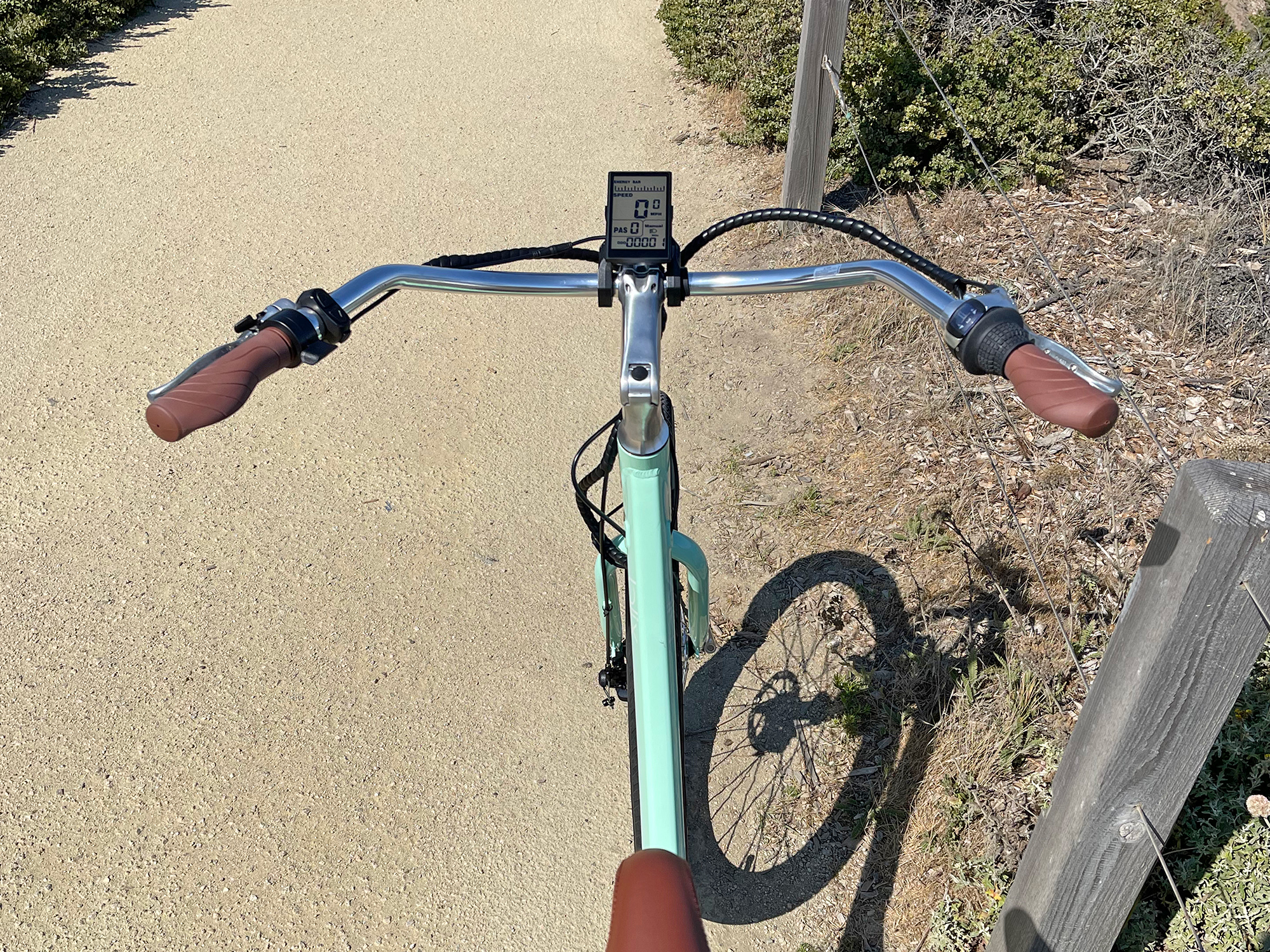

- The LCD display panel is center mounted and fairly large, making it easy to read. Most of the controls on this ebike are intuitive, including the half-grip twist shifter that switches gears. It has an optical window on top that displays the gear you’re riding in.
- I think it’s neat that the LCD display panel has a 5 volt 1 amp USB charging port built-in! This could be useful for charging portable electronics, like a smartphone, speaker, or additional lights, while riding.
- Blix has left the display panel open, so you can adjust the settings… including top speed. You can lower the top speed to improve range and add some safety, or raise it a bit and operate the bike more like a Class 3 speed pedelec if you’d like. They ship it at 20mph 32kmh to comply with legal framework for Class 2 ebikes. You could even unplug and remove the throttle to ride this as Class 1 if you wanted.

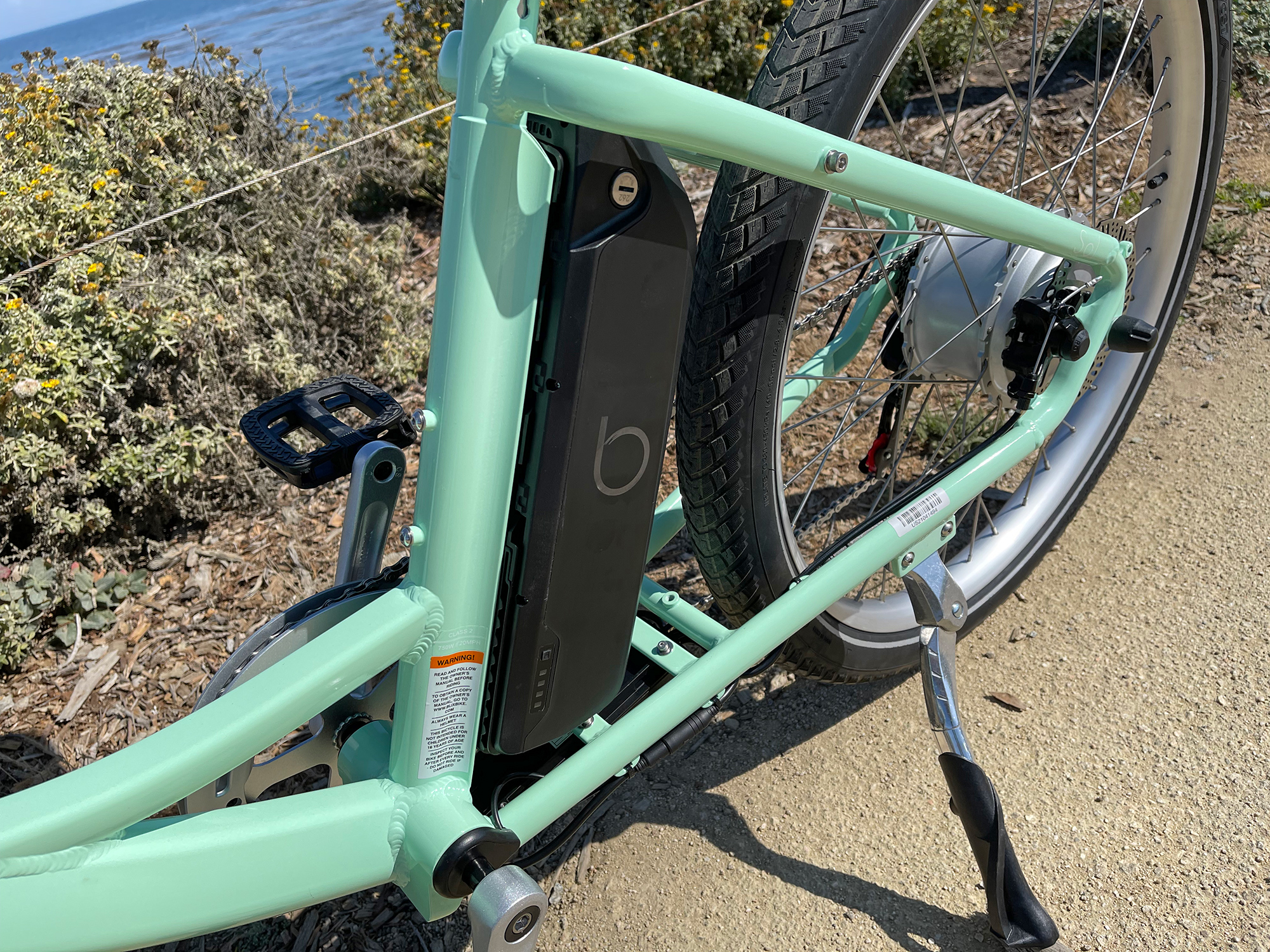

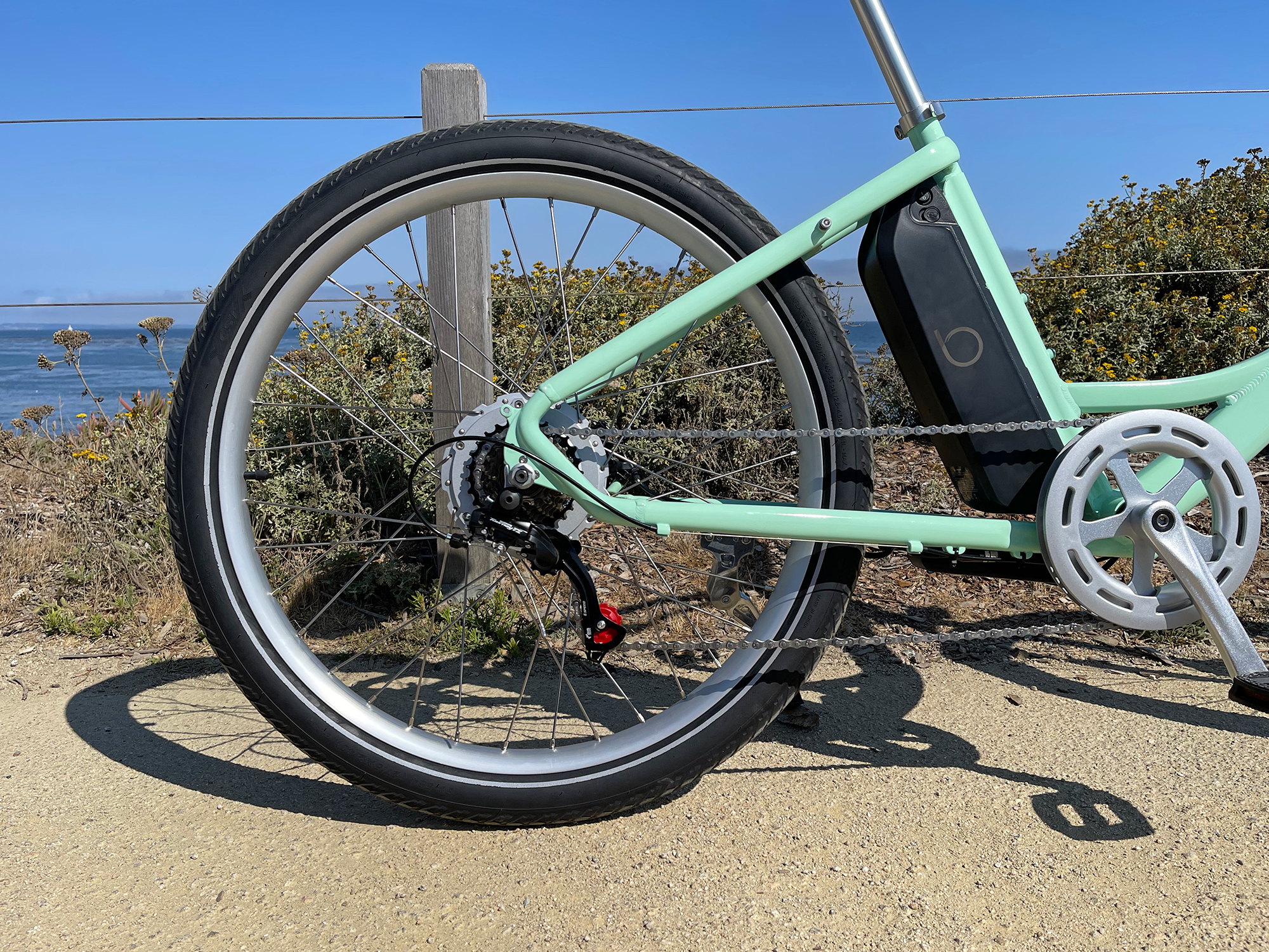

- Updated battery pack design! They are using very high quality Panasonic cells and spacing them apart in the casing for improved air flow and durability. The 48 volt system provides efficiency for sending energy and also increases the potential power output. This enabled them to increase motor power to 700 watts and get that high 90 newton meter torque rating.
- I like how the battery seems really secure on the flared metal seat tube, and how their replacement packs are less expensive since the controller is separate. There’s also an on/off toggle switch built into the side of the battery pack, so you can disable it completely when transporting or storing for long periods. Ideally, keep it in a cool dry location and try to maintain 50%+ when you aren’t riding the bike. Fully draining the pack can stress the cells.

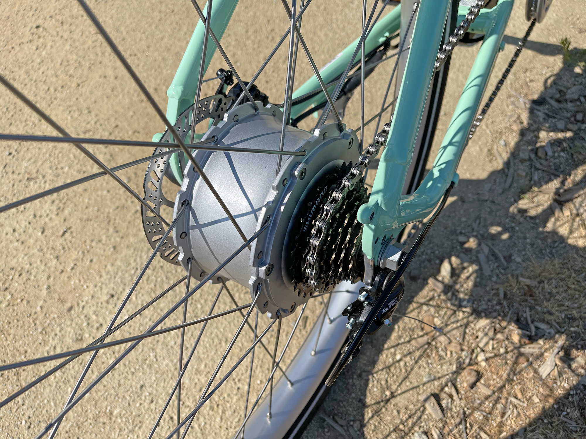

- Geared hub motors are known for being compact, lightweight, and efficient. I’m familiar with the Shengyi brand. This bike felt very satisfying, and I was able to test it out by climbing some of the steeper hills in Santa Cruz California, using throttle only (no pedaling). It seems like a solid choice, based on what I’ve observed from competing hub motor powered electric cruiser ebikes.

- The drivetrain is very basic, using the entry-level derailleur from Shimano. You get seven gears, but the range is pretty limited at 14 to 28. It’s best suited to neighborhood riding and cruising vs. steep climbing or high speed.
- Another component choice that helps to keep the price lower on this model is the mechanical disc brakes. In my experience, they do require a bit of extra hand effort compared to hydraulic, especially the rear brake (right lever), and the cables can set in and get stickier over time with dust and water ingress. Notice how the brake housing is pointed up and the wire runs down into it so water and dust can also settle downwards into it. Blix chose standard 160mm rotors vs. larger 180mm, which leaves less cooling surface and lower mechanical advantage, but they are also less likely to get bent at bike racks.

- The controller box is mounted below the frame where it can stay cool but may also take some damage if you get high-centered on rocks or logs. Sometimes it’s nice to have these internal, but that can make troubleshooting and repairs more difficult.
- It can be a little tricky to remove the battery pack because it’s surrounded by a section of frame tubing. This is especially true if the seat is positioned low, you may need to raise the seat or take the seat post out completely for easier access.
