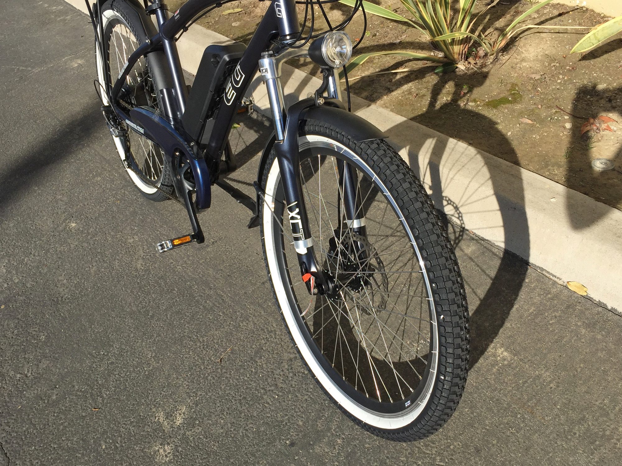

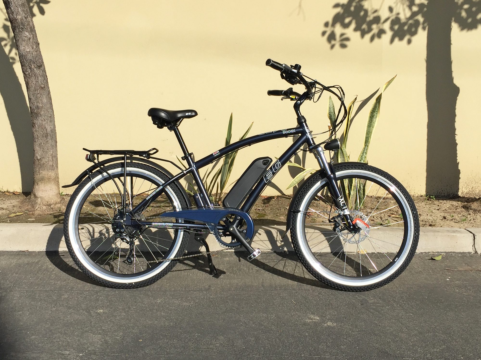

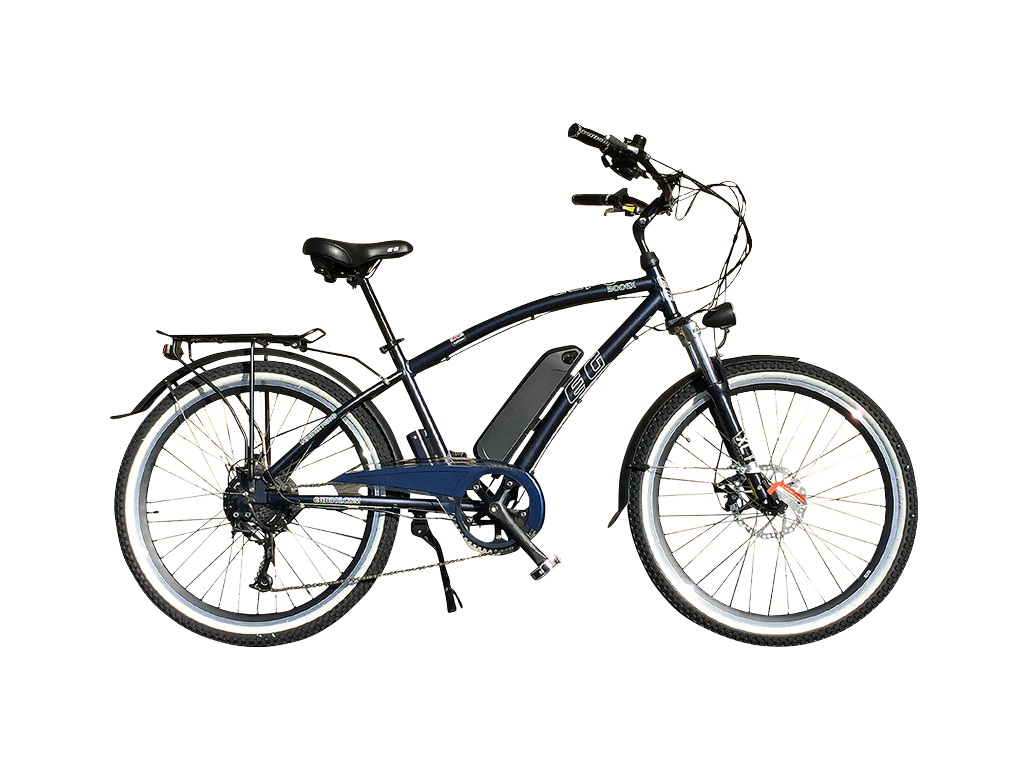

EG builds electric bicycles that tend to be lower priced while maintaining a comfortable, solid experience. The Oahu 500 EX is their high-step cruiser model and I saw a number of improvements over the prior build including a more compact battery with slightly higher capacity battery and repositioned kickstand for improved stability. It’s a heavy ebike at ~57 lbs due to the curved tubing, suspension fork, larger handle bar, rear rack and fenders… not to mention the more powerful 500 watt hub motor. This is all well and good, the front wheel and battery are easily removable, but there is a bit of flex in the stem and without lockou on the suspension fork, the bike can feel soft vs. rigid. I love the comfort of the suspension, larger tires and ergonomic grips… even the flex of the handlebar, but at higher speeds this can turn into wobble. In short, keep an eye on the fenders and stem and keep both hands on the bars if you’re riding at high-speed. For me, even the second level of assist felt zippy and powerful and I loved being able to override with the throttle at any time up to 20 mph. As sam mentions in the video above, it feels strange to go from greater than 20 mph down to 20ish if you stop pedaling and hold the throttle.

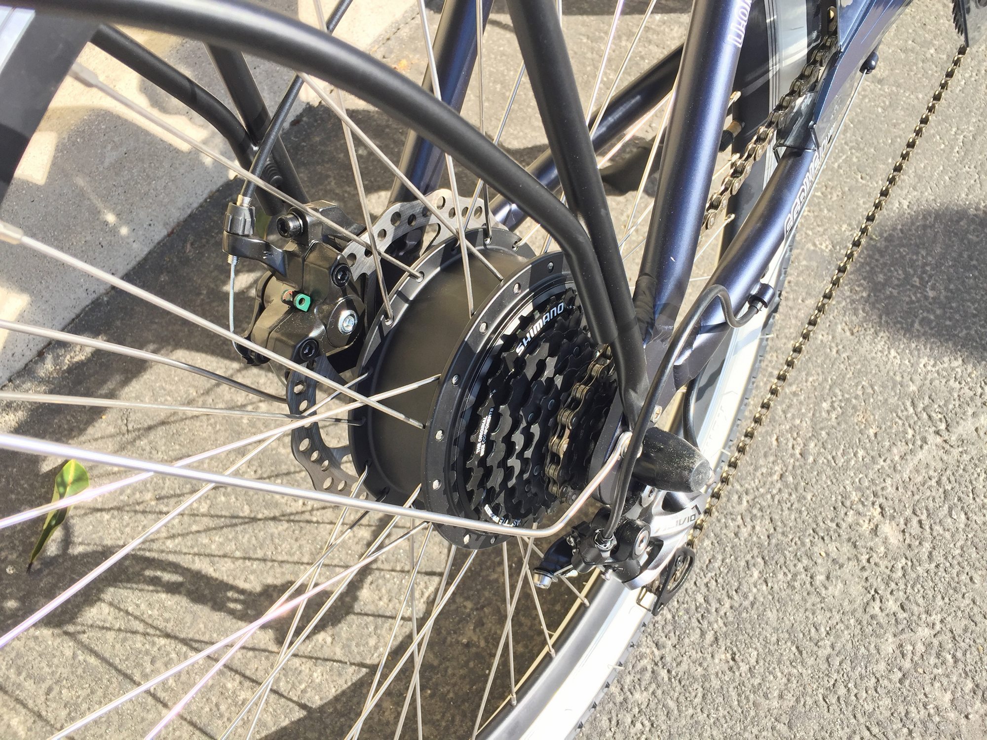

Driving the bike is a 500 watt nominally rated Dapu hub motor. This is a brand that Easy Motion and Pedego use for their bikes and I consider it higher-end. Hub motors aren’t as efficient as mid-drive but they are less expensive and don’t exert the same stresses on your chain, sprockets and derailleru. They also don’t complicate shifting and can be used with throttles more easily. You really feel (and hear) this motor at the higher levels and it was neat to see Sam zipping around as he weighs ~265 lbs.

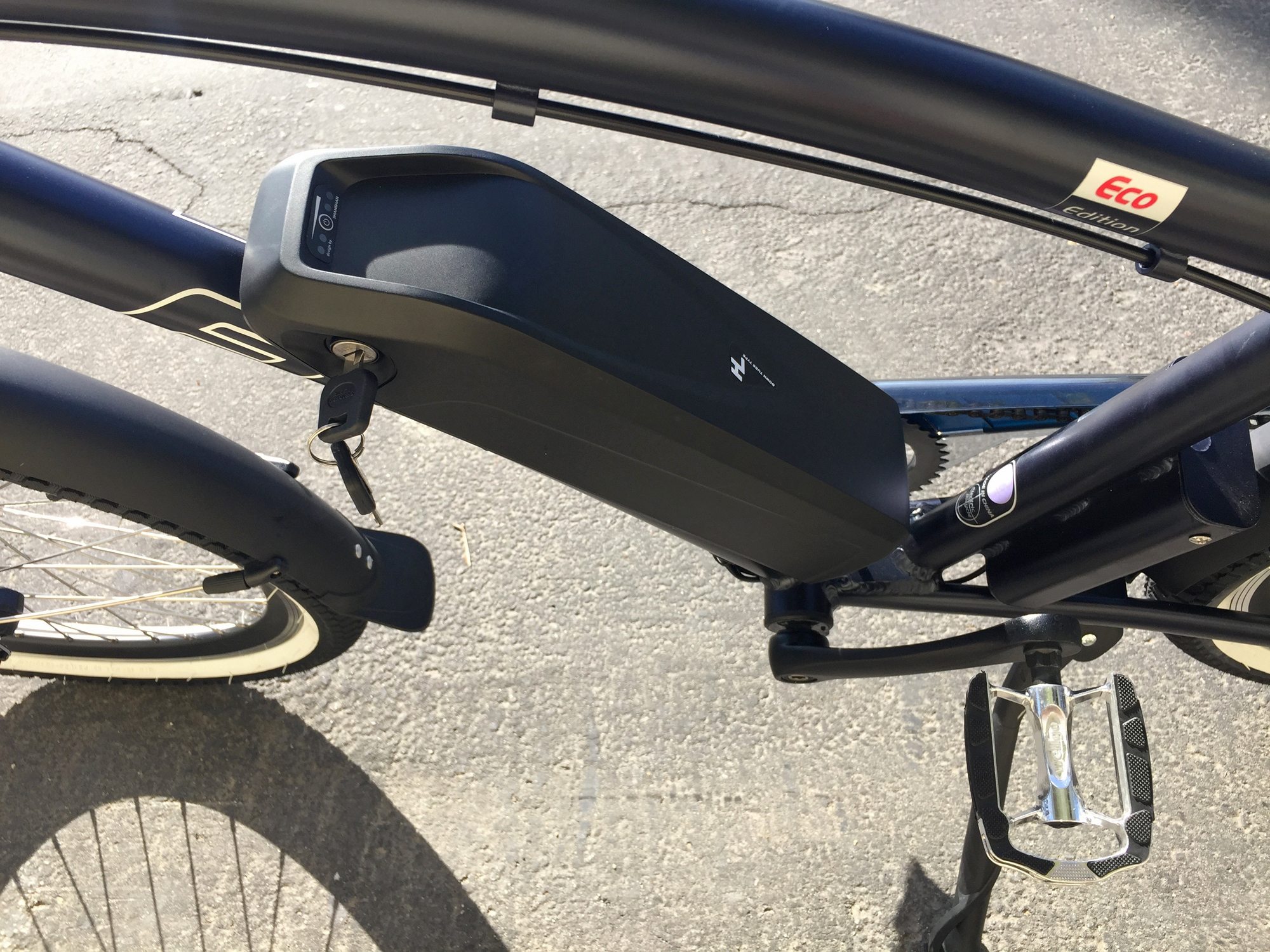

Powering the motor is a 48 volt 10.4 amp hour battery pack that mounts to the downtube. It’s slim and good looking with Samsung cells inside and you can charge it on or off the frame. I did notice that the frame mounting points seemed basic vs. reinforced or fully integrated like some of the fancier ebikes. I also noticed that there was no USB charging port like the older, physically larger, battery offered. At 6.6 lbs, this battery weighs about .5 lbs less than the older one and no, I do not believe the interface is backward compatible. EG has been producing ebikes for several years now and Sam Townsend, the owner of the Electric Bicycle Center in Fullerton, has sold a lot. He was pretty honest with me during the review about shortcomings on the bikes but I didn’t hear anything about the motor or battery being unreliable.

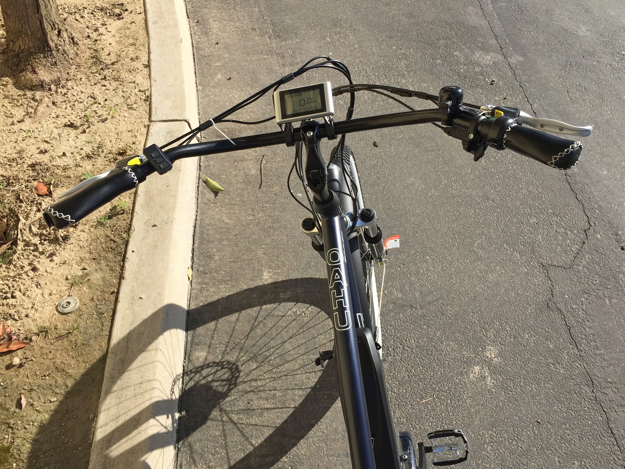

Turning the bike on only takes one step after the battery is charged and mounted. Just press and hold the center button on the little keypad near the left grip. Once it’s on, the display shows a six bar battery indicator, your speed and assist level among other trip stats like max speed and odometer. Considering how fast you could drain this battery (riding at higher speeds where air resistance makes a big impact) it’s nice to have six bars. I also feel like the button pad is well laid out and easy to reach. The main display swivels forward and back to reduce glare but is not removable. Keep this in mind if you park outside a lot or in public spaces where more weather-wear and scratching could occur. To be honest, the display and control pad looked very generic to me but worked as expected. The throttle was similar, pretty basic but easy to reach and use. I find myself excited but also questioning the $2k price point because of some cheaper perts like this display and the rattly fenders that can get loose (according to Sam) but the eight speed drivetrain is a few steps up from the entry model and the Dapu motor is great.

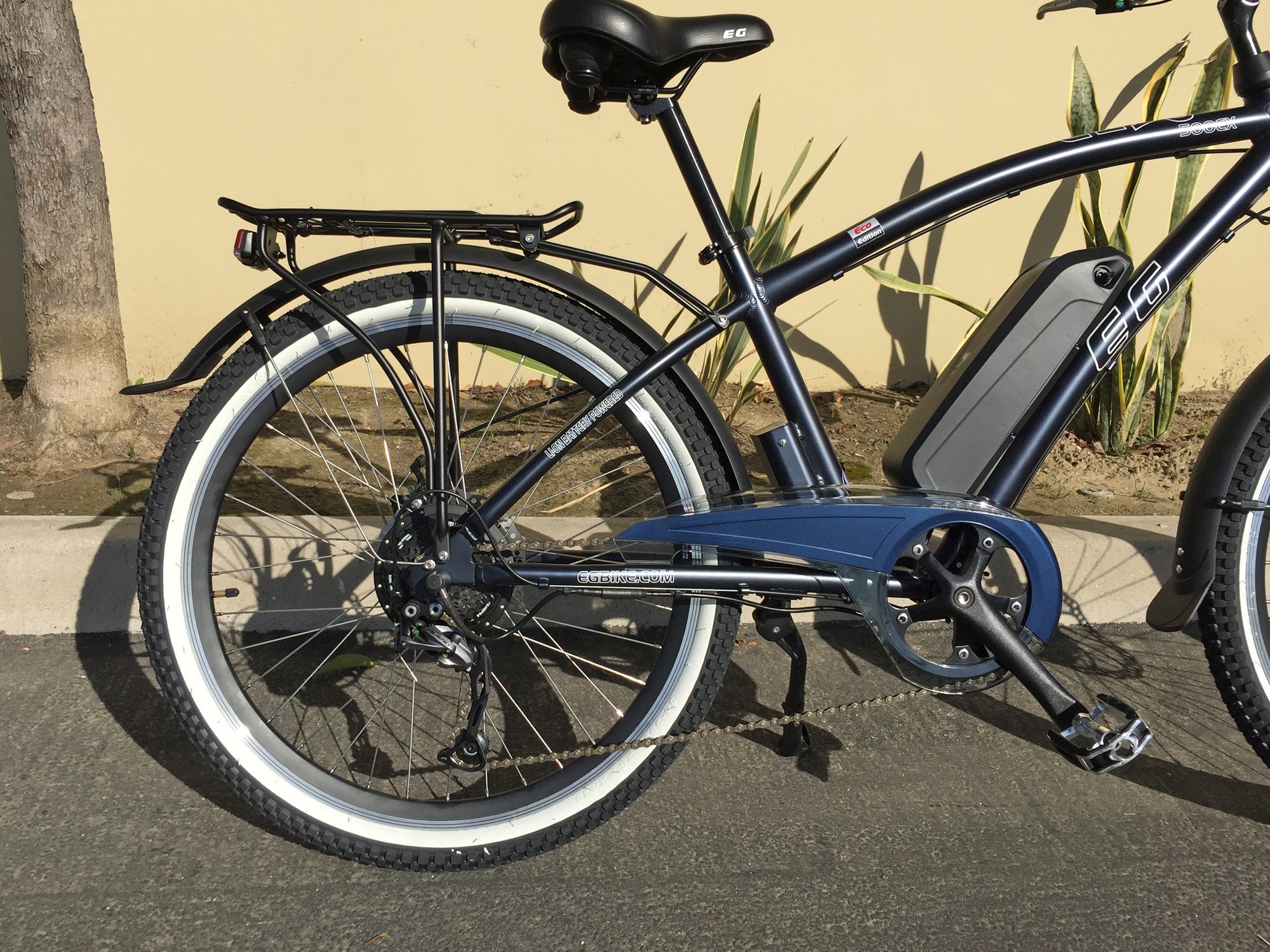

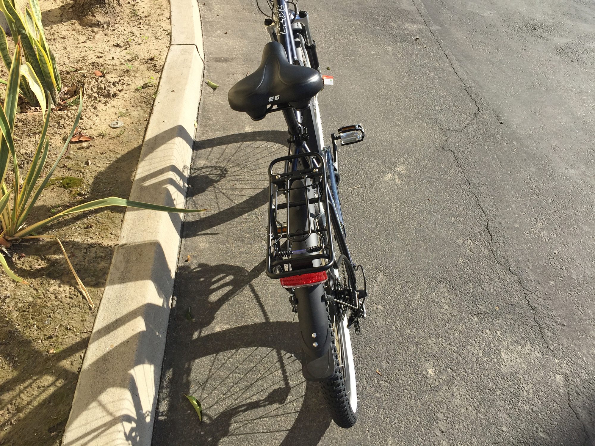

At the end of the day, as Sam said, you get what you pay for… but in many ways you’re getting more with the EG Oahu. The parts that really matter are great (motor, battery, drivetrain) but I could see myself replacing the stem right away, especially if I was larger like Sam. The whitewalled tires look great and keep you visible along with the independent lights (I love that the front one has a quick-release so you can take it with you like a flashlight!) and with two color choices, you could emphasize visibility further by going with silver. I was not able to climb with this e-bike but Sam said that Wayne (the owner of Evergreen “EG”) had the motor optimized for speed. Based on how peppy it felt for me and how easily it moved Sam, I’m guessing it would work pretty well on moderate hills. You can see the controller box mounted just behind the seat tube… it’s large and sturdily built, and paint matched! Having the controller separate keeps the battery cooler but also allows for a larger controller which can send more Amps. I’m not sure how many amps this system is running but it felt like a lot. Big thanks to Wayne at EG for working with Sam to have these bikes available for review and for partnering with me on this post. I enjoyed the updates but appreciate how much of this bike remained the same. It’s one of the fastest cruiser electric bikes around and I love that they chose a mid-frame battery so handling wasn’t compromised.

- Large 180 mm mechanical disc brakes help you handle the higher speed potential on offer and both levers have motor inhibitors so they cut power instantly when pulled

- I think this bike is aiming at affordability and you can see that with the separate control box… but it’s encased in Aluminum and painted to match so it looks way better (and feels sturdier) than the plastic boxes I see on some other products that are just zip-tied to the frame
- While some weight is positioned at the back of the bike (the hub motor and rack) a lot of the weight is low and center on the downtube in the “shark” battery, this improves handling and keeps the rack free for cargo
- The drivetrain is an upgrade, four levels up from the base offering in the Shimano line, it’s great to have a wider range here to help you reach those higher top speeds

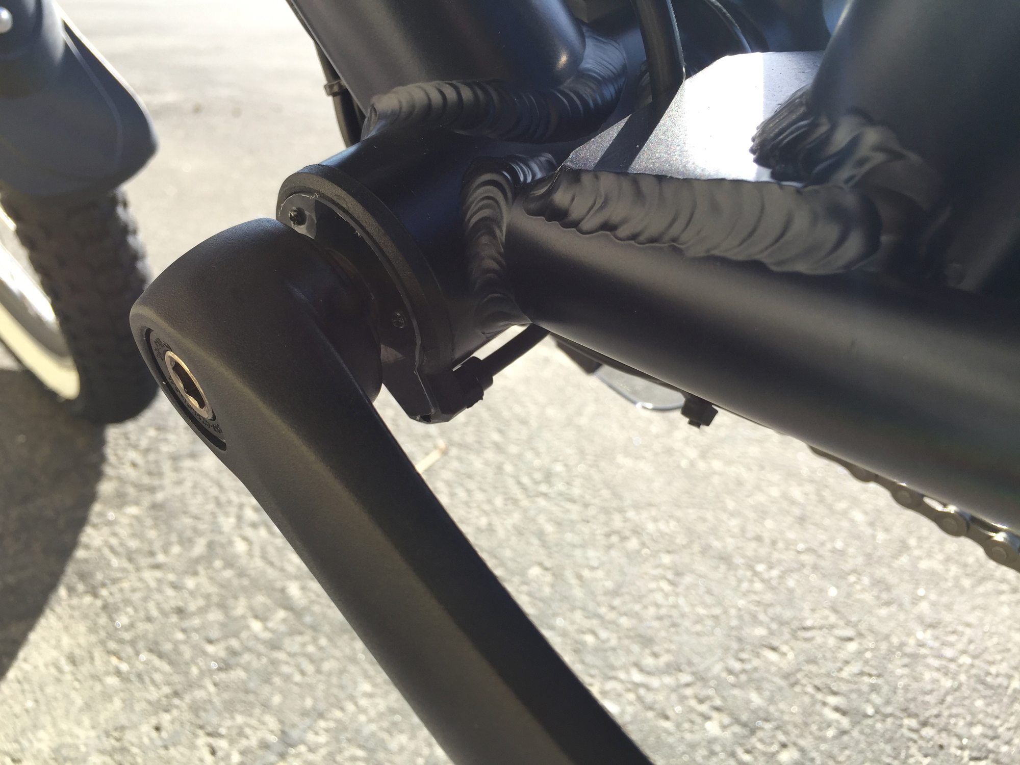

- The team at EG listen to their dealers and consumers and have adjusted and improved the bike a lot since my last review, apparently moving the kickstand more towards the center of the frame is one of these areas… but I found that the left crank arm now collides with the stand so just keep an eye on it if you’re backing up or turning the cranks with it down

- Both the adjustable stem and suspension fork reduce steering tightness, there’s a bit of slop which could develop into looseness if you ride on very bumpy terrain, keep an eye on the adjustable stem especially so you can tighten it on occasion and keep your hands on the bars or speed wobble could wipe you out at those higher speeds

- Older versions of this electric bicycle had a USB charging port on the side of the battery pack but the new pack does not have this

- The display is not removable but it does swivel up and down to reduce glare, I felt that it and the button pad looked a little rough, more generic than some

- The battery felt solid enough but wasn’t bolted down or built into the frame that some other bikes have done, try not to bang it around a lot and consider taking it off if you’re transporting the bike (it would make the bike lighter and just keep the mounting plate from getting loose)
