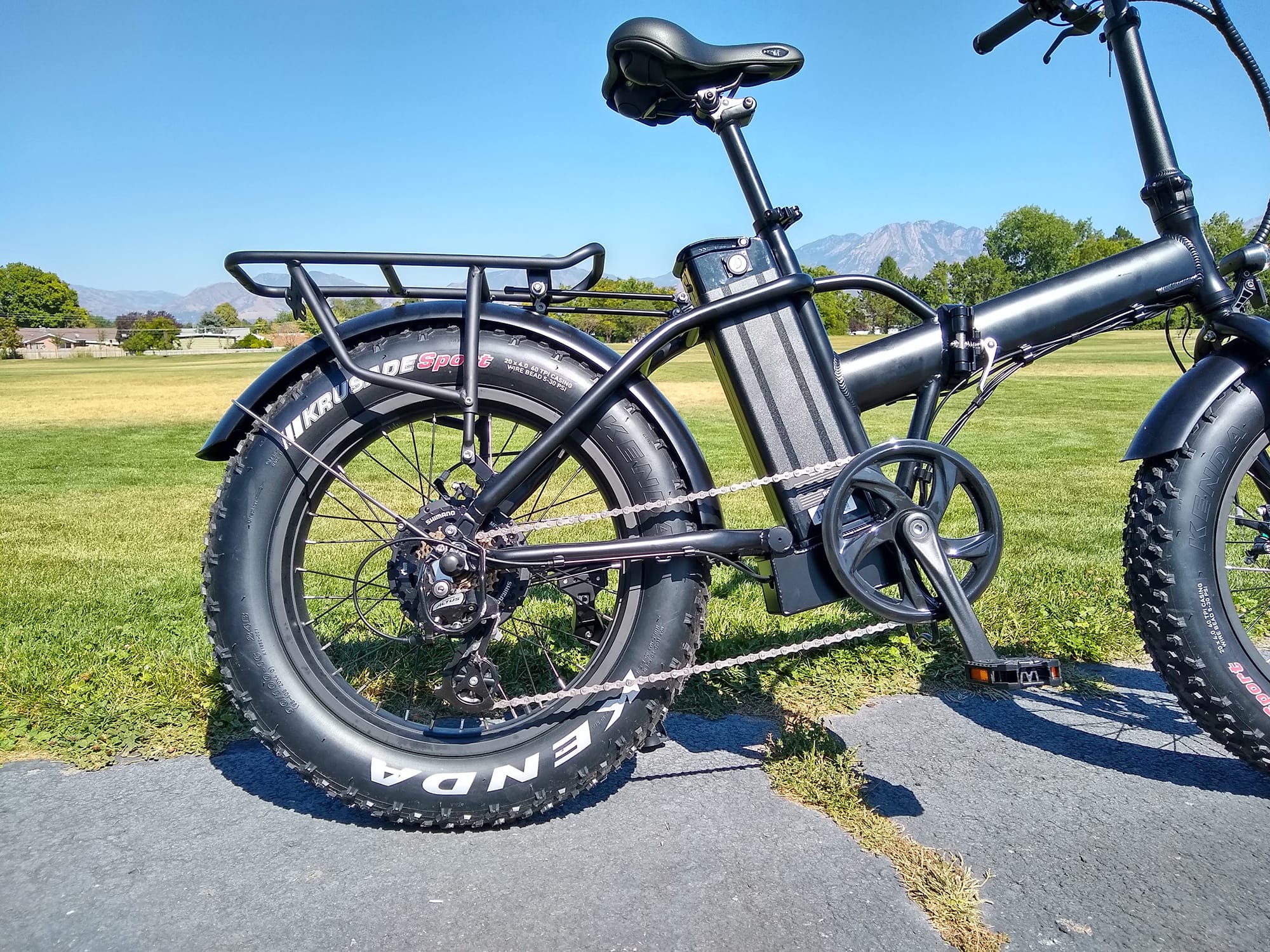

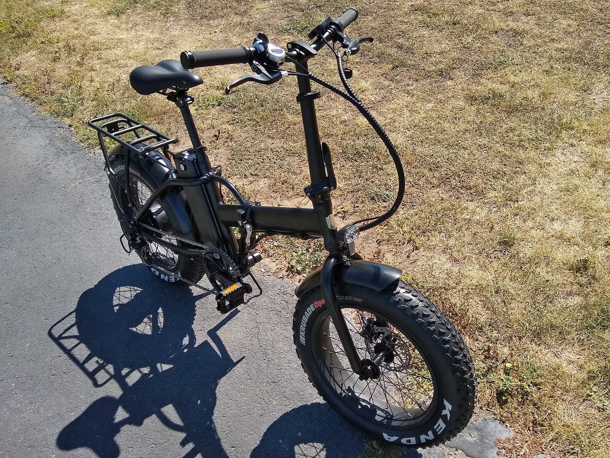

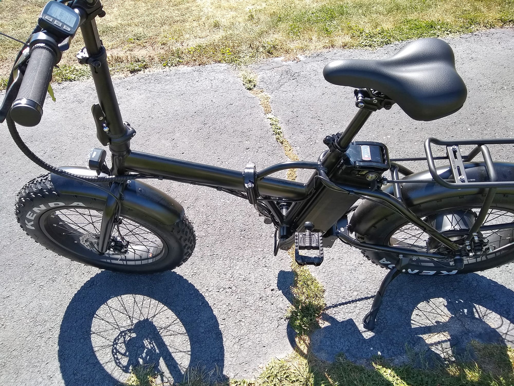

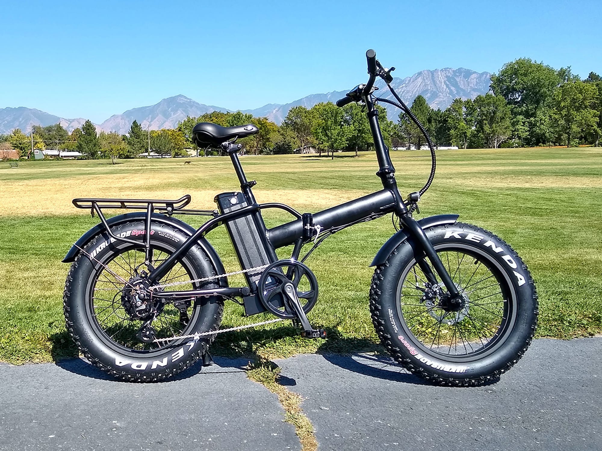

Eunorau has released their new E FAT MN bike, a hub-drive fat-tire folding bike made to take on just about anything you can throw at it. I was happy to have the chance to review it along the Jordan River in Utah, which let me really put it through its paces and see what it was all about. The E FAT MN (MN being a shortened version of ‘mini’) is a value priced folding ebike at $1,199 and comes in 1 color (matte black) and 1 frame size, but 2 frame styles, step-through and mid-step. The mid-step frame we are looking at today is very approachable, and these smaller 20” wheels give it a good stand over height. Although there is only 1 frame size, you do get some adjustability with the telescoping stem. Usually when I see these on folding bikes, they can be stretched and strained so that that wires and tight and don’t allow you to make a sharp turn. However, Eunorau supplied the E FAT MN with plenty of wiring slack in the front to alleviate this problem and I really appreciate it. The E FAT MN can handle quite a bit, and that is thanks to the Kenda Krusade Sport fat tires with 60 threads per inch casing. As mentioned before, the tires are 20” x 4” and rated for a 5psi-30psi… the lower levels, such as 5psi, really work well on various terrain such as sand or snow, I highly recommend dropping that tire pressure if you want to take it out on adventures because it makes a world of difference. But these tires here keep everything comfortable since each of those little knobs somewhat act as mini absorbers for the bumps on the road. Unfortunately, there is no puncture protection or reflective sidewall here. I love these extra thick spokes in the rear and 135mm hub spacing, really just making the experience sturdy overall. Looking around the bike I notice that it has this awesome included rear rack. The rack has some really thick tubing which is very sturdy, but probably would work best with double sided panniers. I do love the locking grips, 170mm crank arms, and Wellgo metal folding pedals. There is also a battery integrated 2 LED headlight, a nice feature, however, there is none on the rear. Other features include an adjustable kickstand mounted in the rear to eliminate pedal lock, integrated bell, gel saddle, and these included steel fenders to keep you dry.

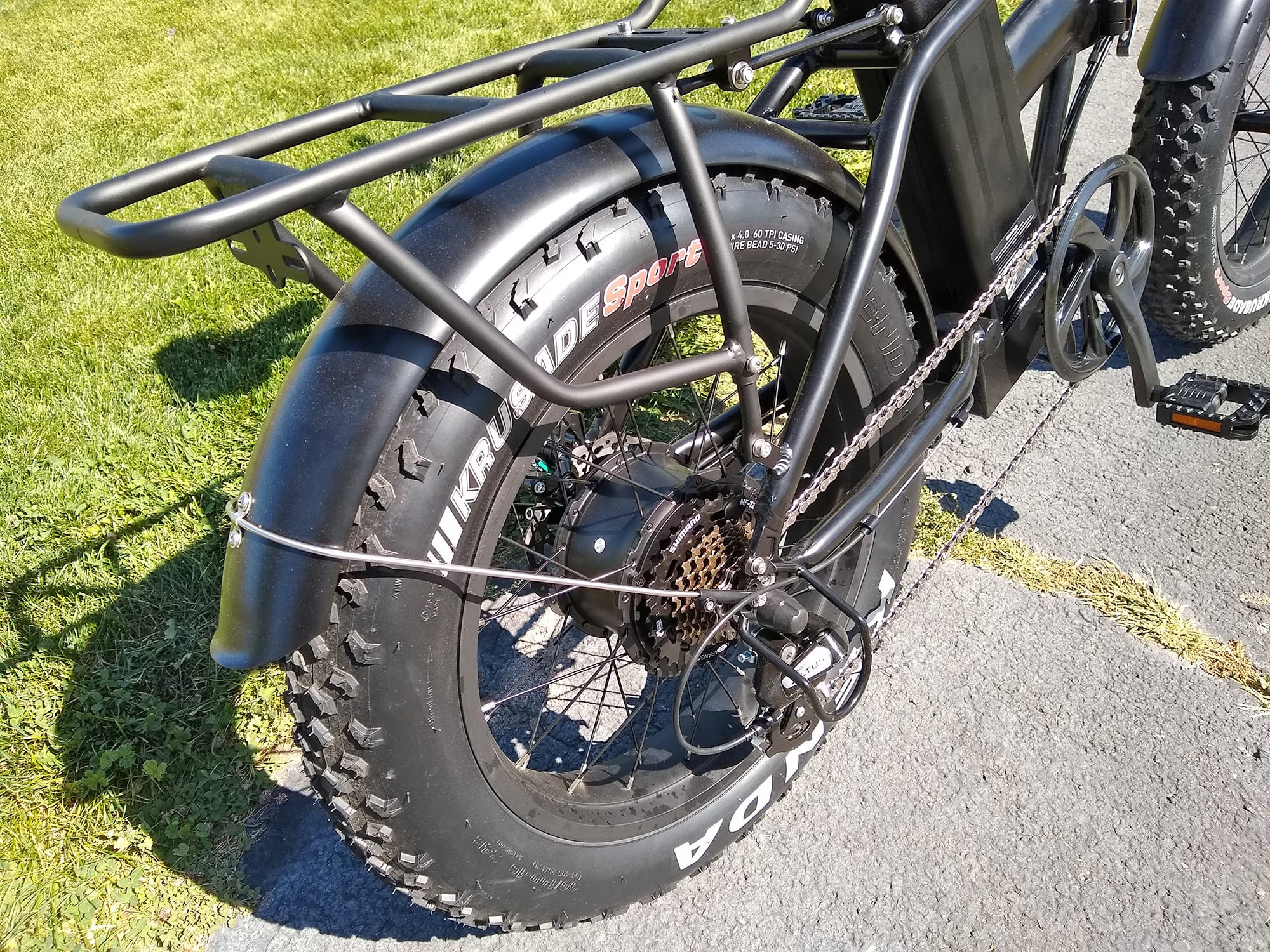

Diving the E FAT MN is this 500 watt Shengyi hub-drive motor with 5 modes of pedal assist and a thumb throttle located on the left. It has an 8 magnet cadence sensor, which is somewhat older technology for cadence based pedal assist. Compared to todays top of the line systems, it tends to feel sluggish because it has this very pronounced on or off feeling, so I recommend using the throttle to ramp up your speed if you want that smoother feel. It kicks up to 20mph with no problem and stopping is nice since they also equipped it with motor inhibitors. On the mechanical side, they have a 6 speed Shimano Altus derailleur which is a step up from the typical entry level derailleurs I usually see on value priced ebikes. I love that it has a derailleur guard too, that really helps protect these systems in the shipping process of if the bike gets knocked over. It has a 13-38 tooth on the cassette while in the front you have a 48 tooth chain ring. A thumb shifter is here, and I have never been a big fan of these, but I do see the benefit as these are really comfortable to use with gloves on for example. Stopping the E FAT MN are these 160mm rotor mechanical disc brakes with motor inhibitors. 160mm may not sound like the largest setup, but it works well given the smaller 20” diameter wheel size since you don’t need that much stopping power.

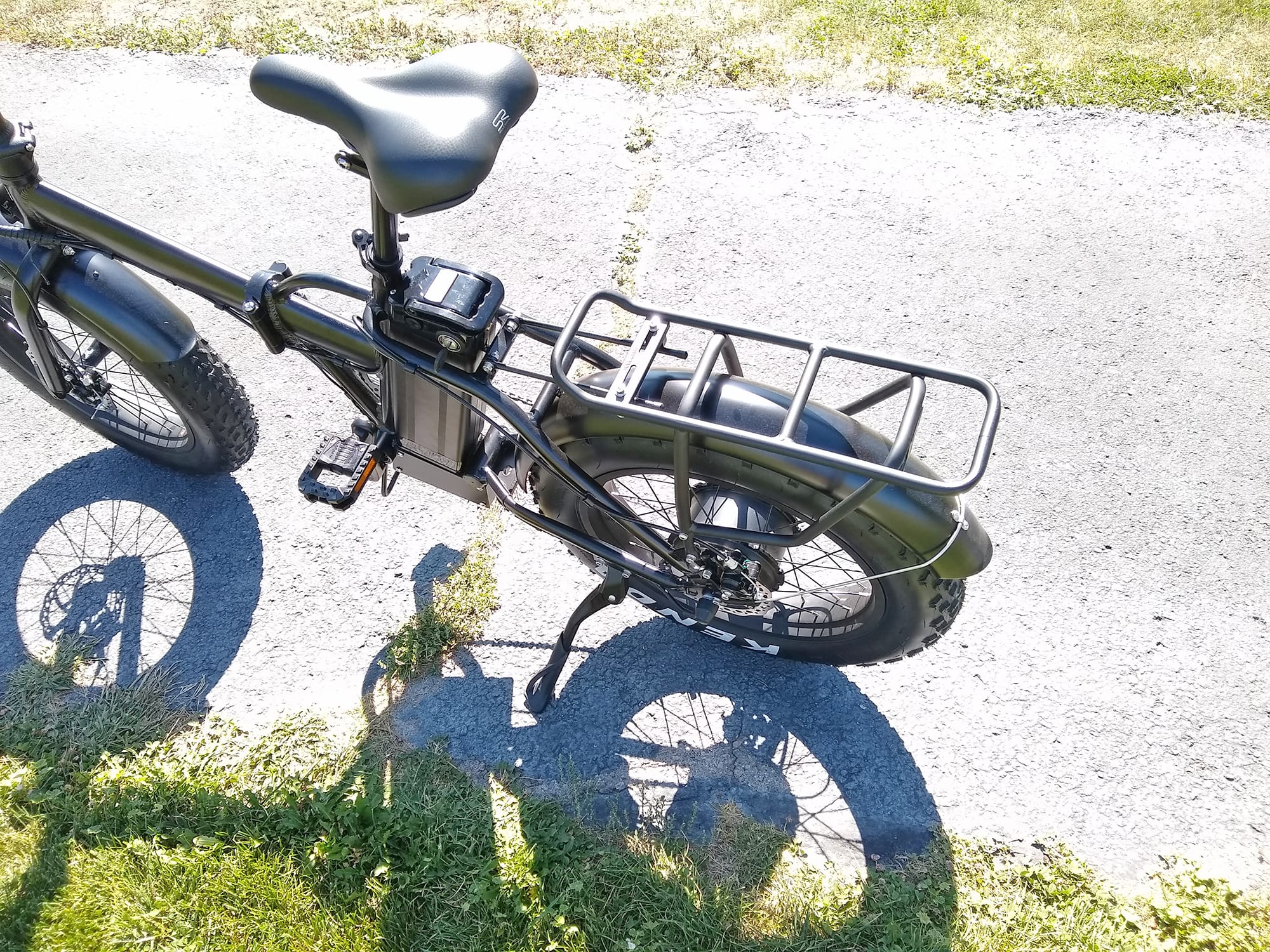

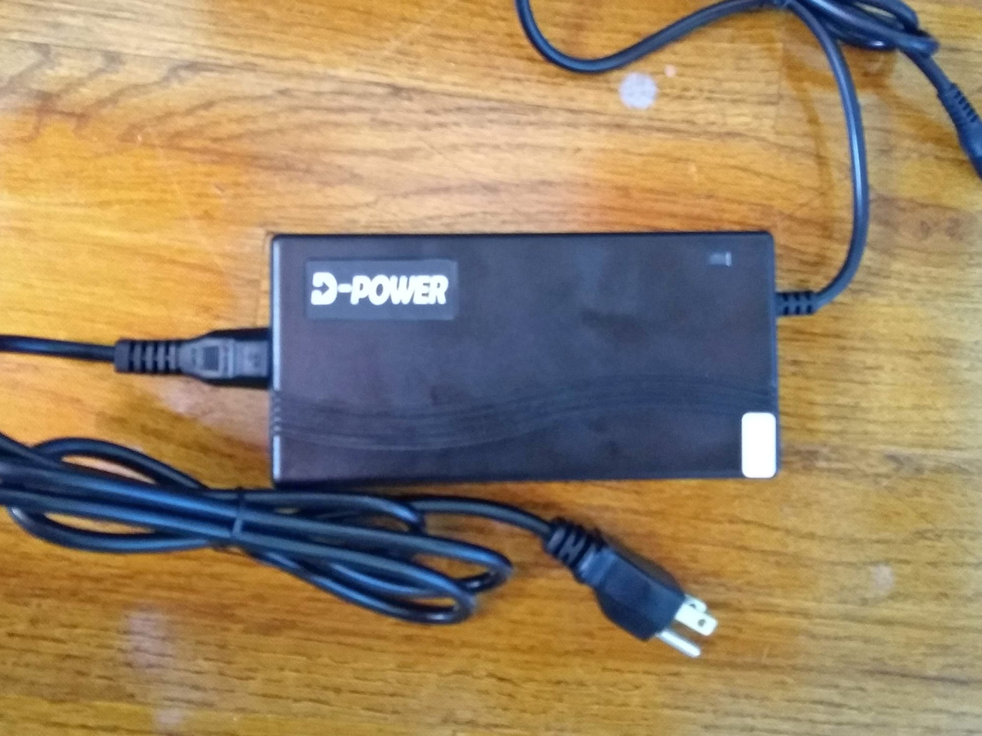

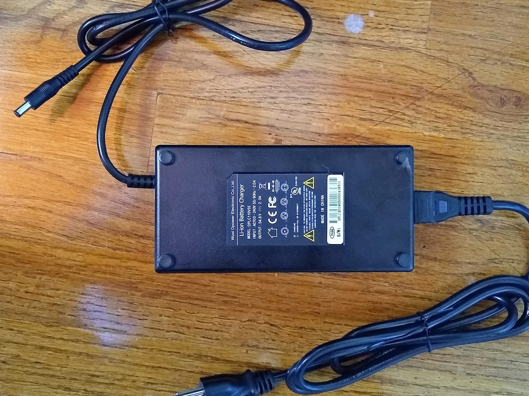

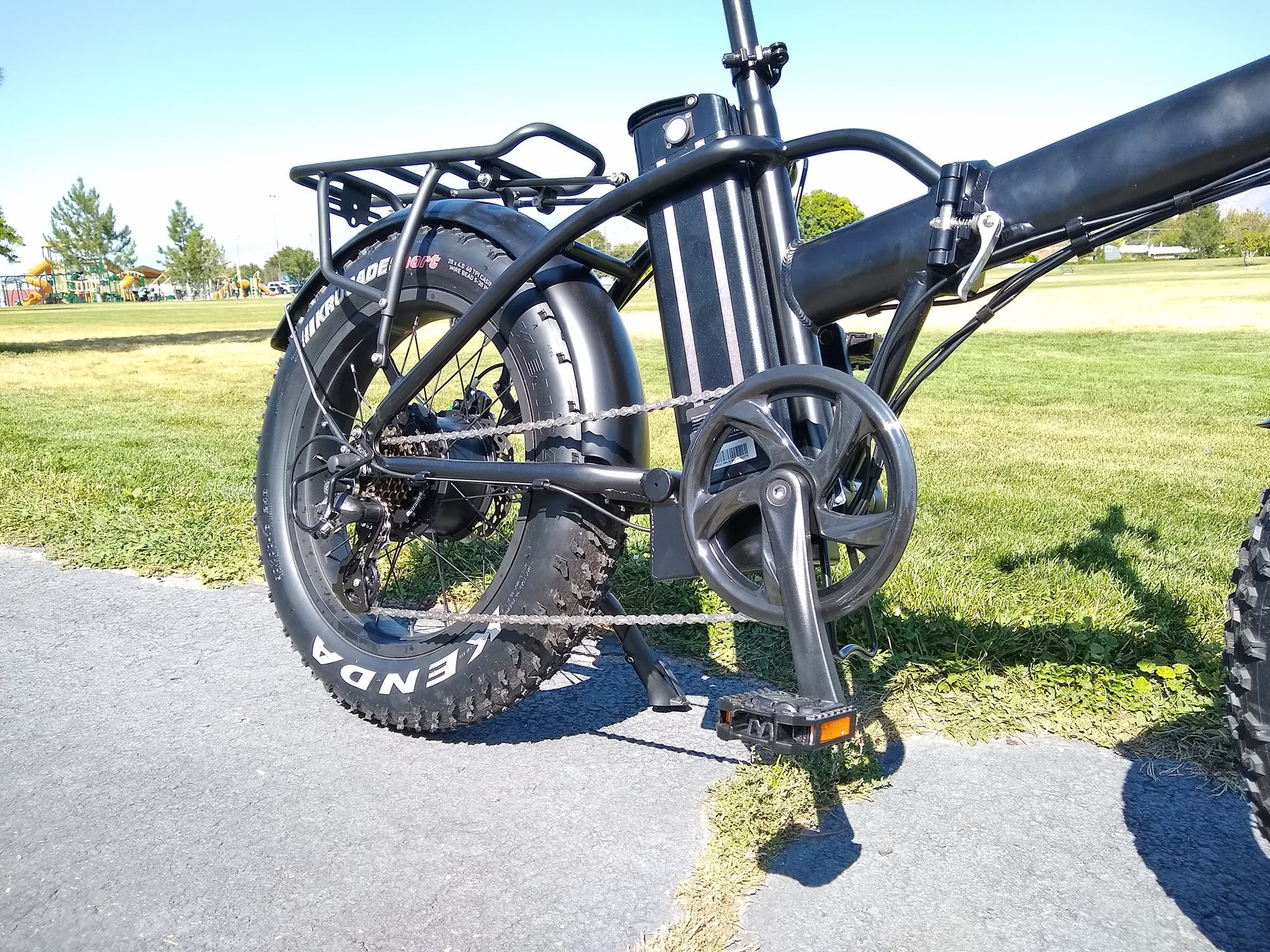

Powering the Eunorau E FAT MN is a 48v 12.5ah lithium ion battery pack. I would consider this a high capacity battery with that 12.5ah rating. The amp hour designation refers to how long the battery can perform at its peak, while the volts act as the peak itself. With a rating such as this, it would be able to go the extra mile and then some. The battery has an LED charging indicator and mounts behind the seat post. The bike is setup very well, but most of my gripes have to do specifically with this battery. Mostly, you must have the keys in at all times to operate it, so it can be annoying to have them jingle and bounce around. In addition to that, you have to take the seat all the way off if you want to remove the battery and charge it off the bike. Luckily for us, Eunorau added a seat latch so it you merely have to recline the seat forward and out of the way to reach the battery. Charging is done with this 1.4lb 2amp charger. To really care for this and other lithium-ion packs, I have heard that storing in a cool dry location vs. extreme heat or cold will extend the life and try to keep it about 50% full when not using for long periods so you won’t stress the cells. Try not to let it run down to zero, because that’s really hard on the cell chemistry.

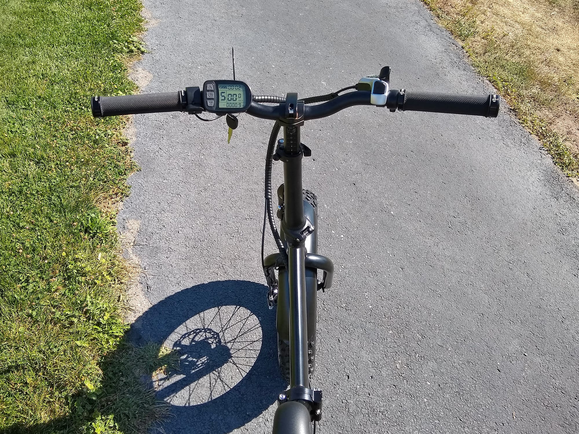

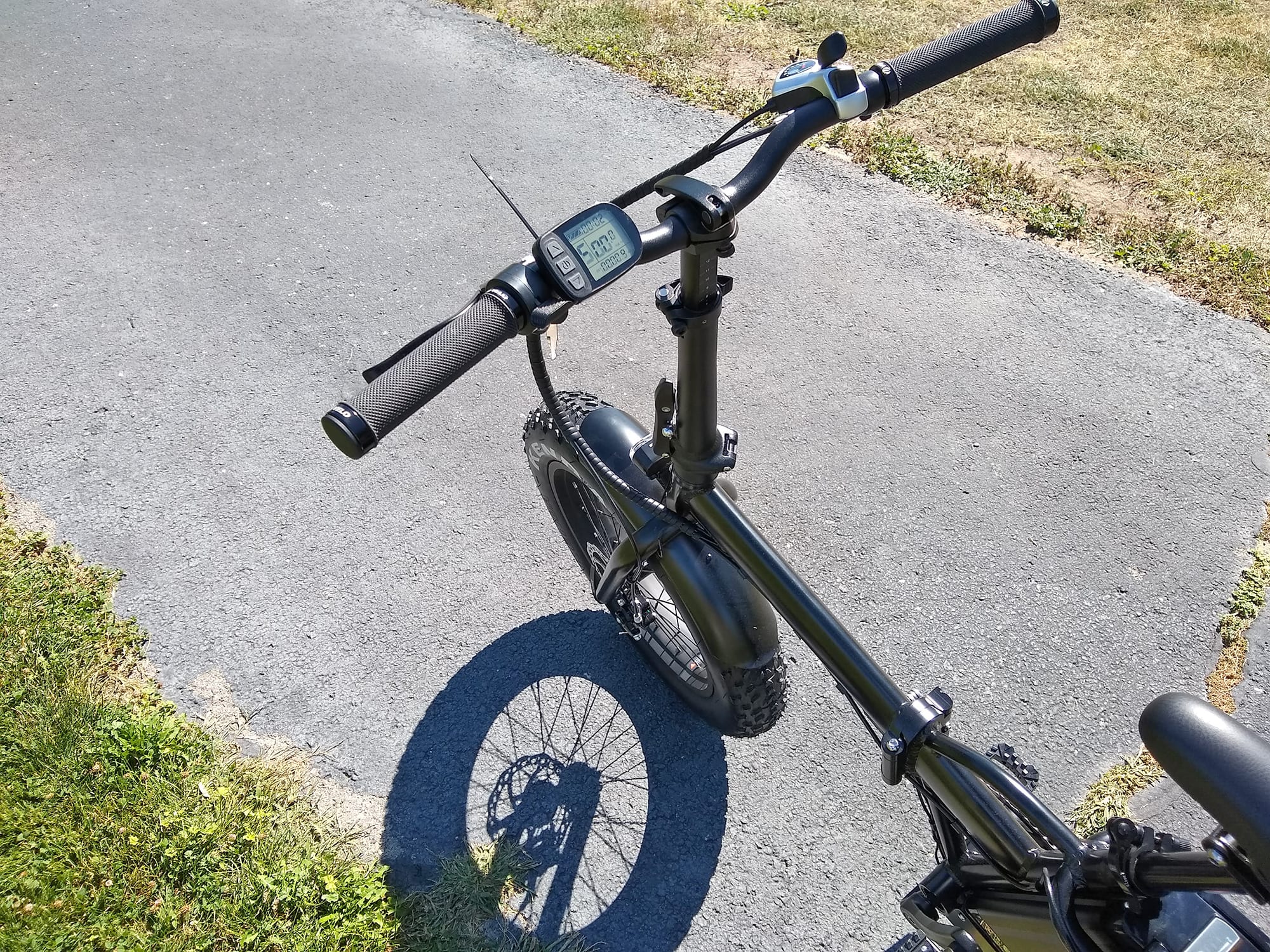

Operating the Eunorau E FAT MN is pretty straightforward. The LCD is large, backlit, and adjustable angle to reduce glare. It is not removable, but there does appear to be a disconnect spot for easy replacement if you experience damage at some point down the line. All of the standard readouts about current speed, battery capacity, and assist level are shown, and if you tap the power button, it will cycle through advanced readouts like average speed and max speed. Pressing the up or down button will change the pedal assist mode. I think my only real gripe here is the 4 bar battery info graphic. A lot of newer bikes are going with a battery percentage so you know exactly how much battery is left. I wasn’t able to do a range test, but I think this may be a 5 bar infographic, with the last bar being the battery outline itself. Anyways, at 4-5 bars, that means you only get a battery readout at 20%-25% per tick. If you only show one bar left, do you have 1% or 25%? A big difference, and you won’t know until you try and ride to home and hope it doesn’t die. I guess it is not a huge deal, a lot of ebikes have similar setups, I just am looking forward to the changes that I see on the horizon.
