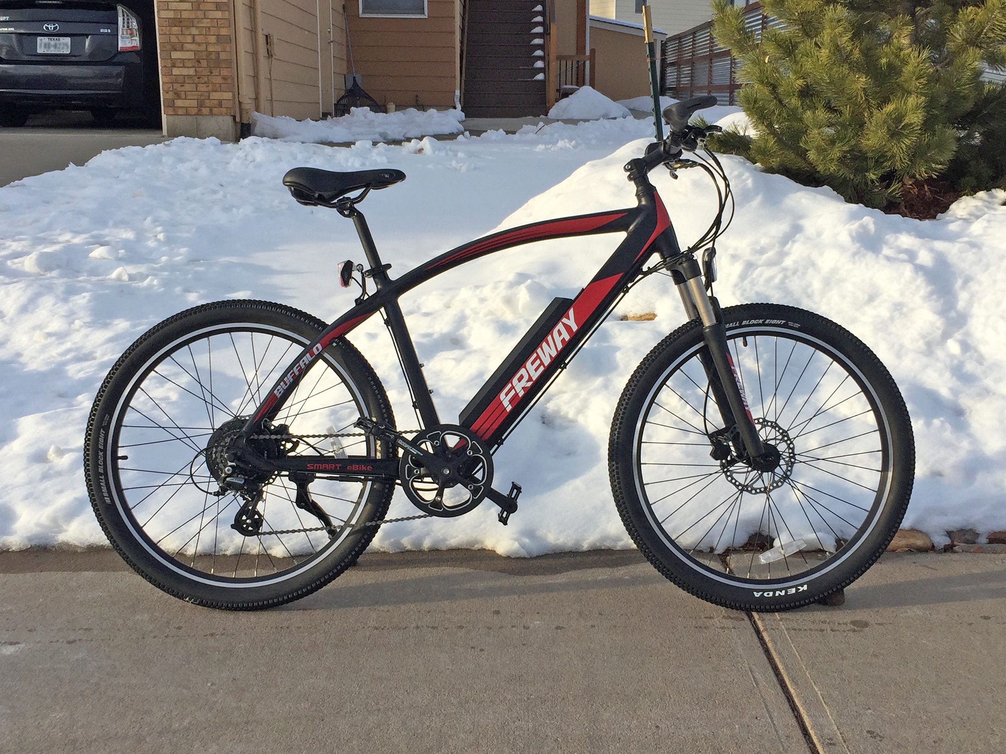

To Date, Freway has released two value-driven electric bikes in the United States. The first model, VR-01, took a more efficient light-weight approach with a below-average sized 250 watt geared hub motor and 36v 5.2ah battery pack. it weighed in at about 43 pounds and was priced at just over $1k. For me, it brought some of the best aspects of electric assist to a platform that was easier to lift and more agile than a lot of other products. The non-removable color display panel seemed super fancy and unnecessary given the mountain bike build but I loved the suspension fork and hydraulic disc brakes that normally aren’t present at these lower price points. Their new Buffalo model takes a lot of the best things from the VR-01 and gravitates towards mainstream e-bikes with a larger motor and battery pack. It’s still only available in one color, one frame size and one frame style (high-step) but it looks good and works well enough. You get 180 mm disc brake rotors vs. 160 mm before and now the levers have motor inhibitors built in so you get more control over the drive system and it feels safer. The adjustable integrated lights include a blinking mode to save power and the headlight even has a USB power port built in to charge your phone, music player or GPS device when mounted to the handle bars. The bars themselves are MUCH more open and normal looking thanks to a smaller (but still backlit) display panel. Overall, the bike looks a lot more polished and stealthy than the VR-01 because the battery is partially integrated into the downtube. It’s a lot less vulnerable, keeps weight low and center for improved balance and can still be charged on or off the frame. Perhaps the biggest win here is that there’s space for bottle cage bosses on the seat tube! For those who want to bring even more gear, there are additional threaded eyelets on the seat stays and near the rear dropout for adding a cargo rack. These are important little details that even some larger companies seem to miss or forego.

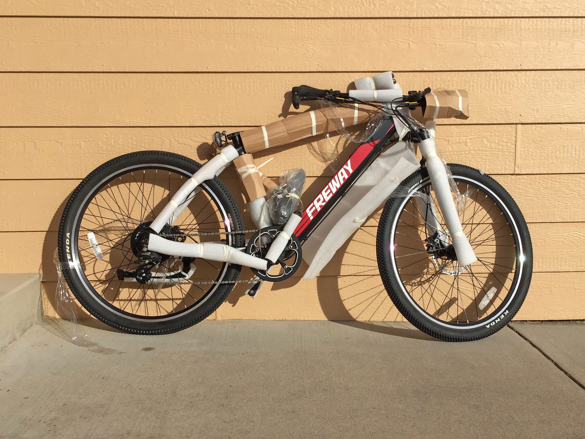

Being a mostly online-purchased electric bike, you’ll have to receive a huge box, unpack it and assemble the Freway Buffalo before you can take a ride. Assembly too me around 20 minutes and only involves twisting the stem, attaching the handle bar and spinning the pedals on. I absolutely love the sturdy Wellgo Aluminum pedals because they provide the stiffness needed to transmit pedal power into the wheels and a large enough pad with solid knubs to stay connected in wet or even snowy environments… I got to review the Buffalo when visiting family and friends in Colorado and had a blast romping in the snow but found that it wasn’t as powerful or fast as expected. Again, the 350 watt motor and 36 volt 11 amp hour battery are what I’d consider average in the US and despite a 25 mph top speed listed on their website, my experience put it closer to 20 mph and there was no cruise button mentioned on the Indiegogo page. Perhaps that’s just as well because it keeps the bike in Class 1 vs. Class 2 (throttle powered) or even a weak Class 3 (ebikes that go over 20 mph in pedal assist mode). The assist itself is driven by a 12 magnet cadence sensor that detects crank arm movement. You don’t need to push especially hard to get motor support but it isn’t always instant. Consider switching to lower gears so you spin faster if you want more immediate power. I guess the biggest takeaway here is that the latest Freway e-bike is a lot more normal in terms of weight and performance but still comes in at a lower price and packs some interesting extras.

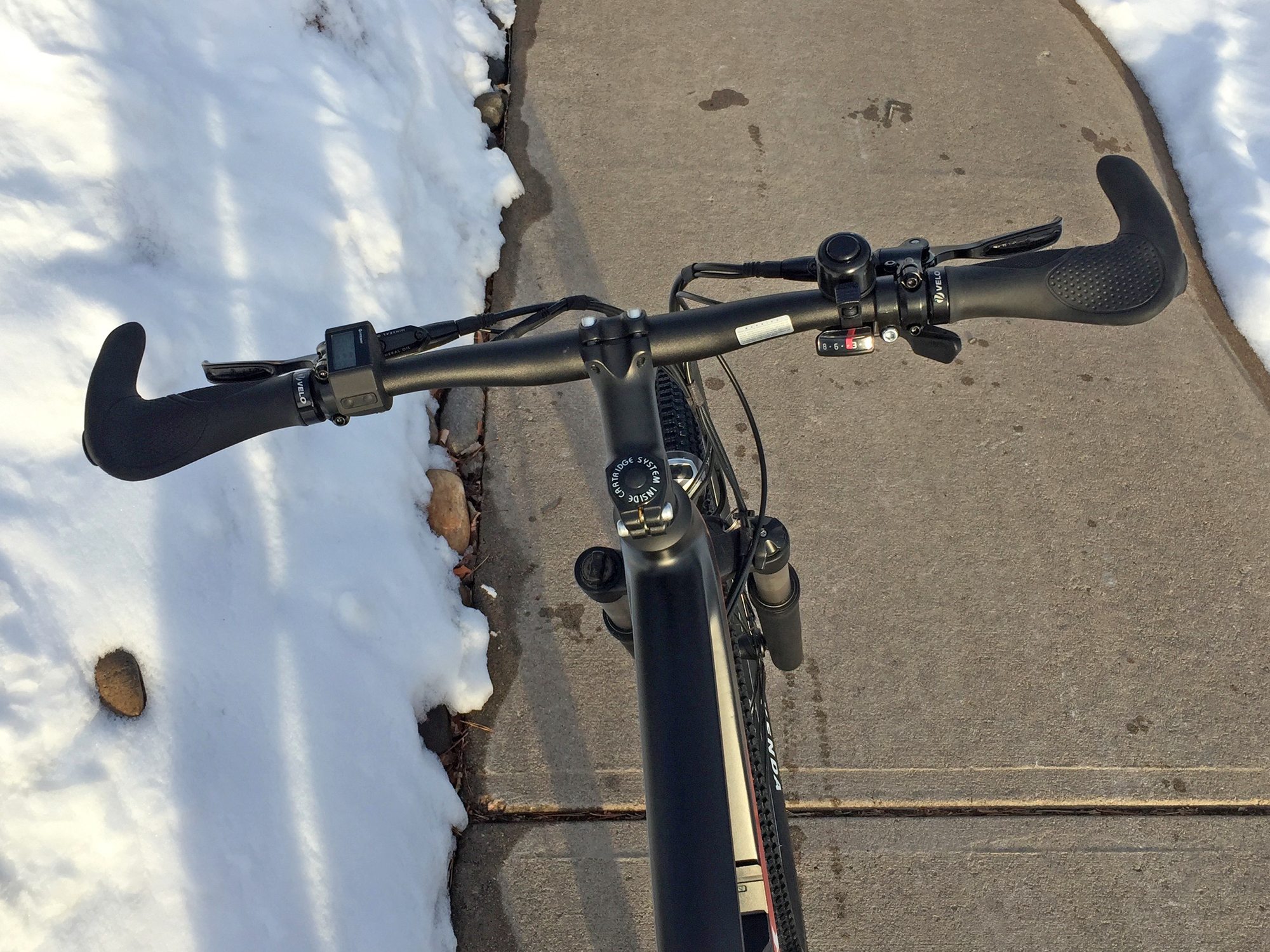

One of the most noticeable “extras” I discovered were the bull-horn grip ends that allow you to switch hand positions while riding. The execution is lackluster in some ways because the grip and horn piece are permanently connected. If you want a different grip angle then the bar end is also going to rotate. At least the grip locks so it shouldn’t spin out of position as easily and… at least it’s ergonomic, just not as adjustable. Another upgrade, mentioned earlier, are the hydraulic disc brakes. For people who actually ride off-road or in precarious environments (like snow) it’s nice to have brakes that respond with less hand force. I’ve heard that super low temperatures can impact hydraulic fluid (and that you can replace it with different grades for better performance) but these worked great for me even though it was a colder day. When you toss in an average suspension fork with lockout and rebound adjust and have larger 27.5″ x 2.1″ knobby tires you get a more comfortable, trail capable ride. Overall, I had a good time and was impressed with the traction and suspension but not thrilled. As a rider with some back and neck sensitivity, I’d probably get a basic seat post suspension like this to fit the 27.2 mm stock post and take the edge off rough terrain a bit.

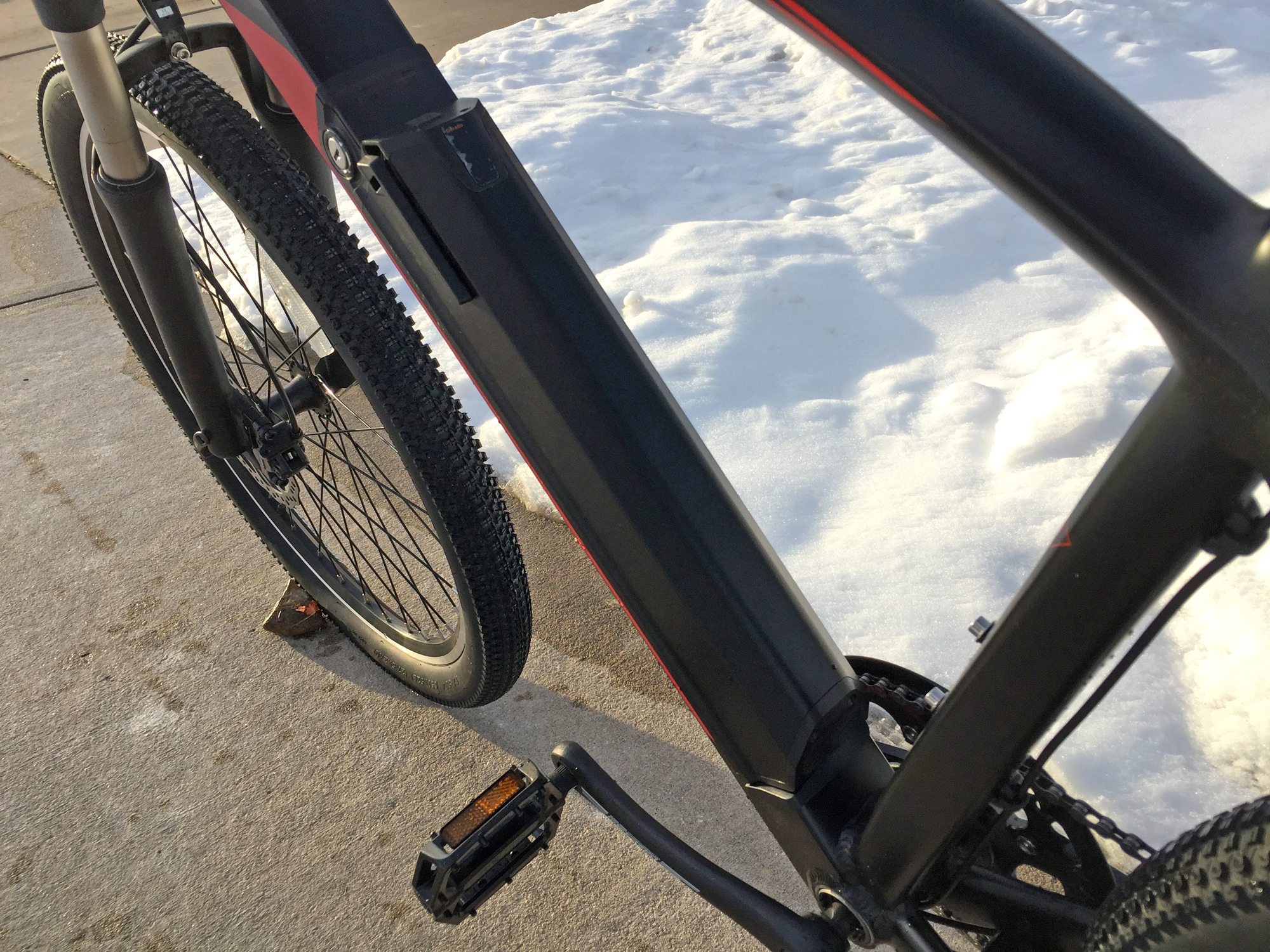

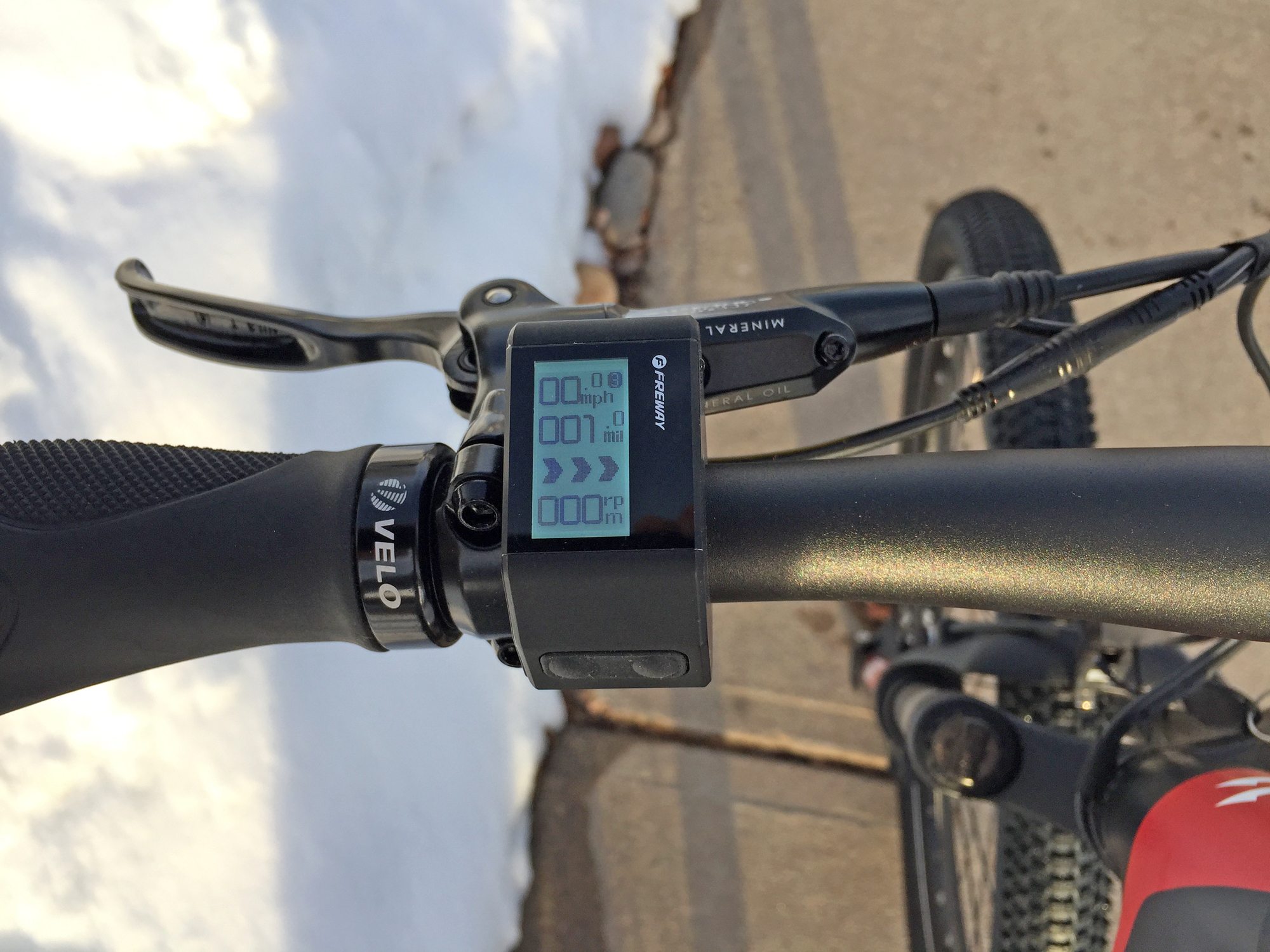

Activating and controlling the Buffalo is simple enough and actually requires fewer steps than some nicer models. Just charge the battery, fit it into the downtube mounting slot (perhaps use the key to help click it on more easily) then press the rubberized power button on top of the pack. This button simultaneously activates the display ring near the left grip and illuminates an LED light gauge on the battery indicating roughly how full it is. These little gauges are nice because they work even when the pack is off the bike, keeping you in the know about charging. Up at the display ring you can see all of the standard readouts such as current speed, assist level (of which there are three) and battery level… but the battery graphic actually shows a percentage, not just four or five chunks! This makes it much more precise and allows you to make better decisions about how far you can go before turning back. If you want to push ahead, the charger supplied with this bike is relatively compact and very light weight at just 1.2 pounds. I guess the only minor complaint I have about charging the battery on the bike is that the port is a bit tight, positioned at the base of the pack near the seat tube, so your cable will have to bend at a hard right angle and plugging in might not be as easy. Back to the display, I found that the left and right buttons cycled through the different power levels and that the picture of a person riding was “off” or zero assist mode. The three different levels display as chevrons and the whole thing loops so you can go from full power to no power with just one click. To see different readouts just hold the left or right button for a few seconds and to enter the settings menu hold both simultaneously. This is where you can set the lights or change from Kilometers to Miles. It all works fine but I came away impressed with how capable and nice looking the little display was. It automatically becomes backlight for a few moments when either button is clicked and it’s close enough the grip that it’s easy to manipulate while riding. It also seemed protected against bike tips and crashes compared to the much larger (and not removable) attention-grabbing display on the VR-01.

Quick note from Freway about using the control pad: Left button single click adds a power assist level. Left button double click enters the second interface (with charge level indicator) and you can open the front light. Right button single click reduces power assist level. Right button double click enters the second interface and you can open the rear light. I think they mean “activate” the lights… I couldn’t try this in person as Gary already had the bike! Big thanks to Freway for partnering with me for this review and to Andrew at Ultimate Sports Nutrition in Fort Collins Colorado and his friend Gary :)

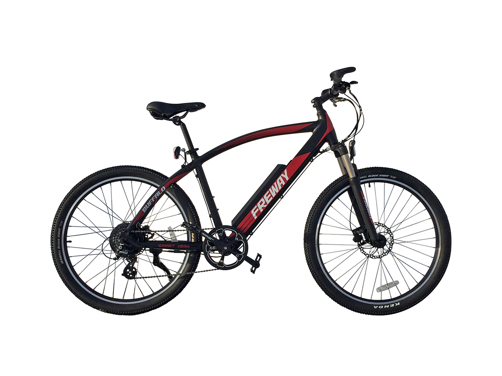

Pros:
- They chose some of my favorite pedals! These aren’t the top of the line but they offer more traction and surface area than a lot of stock pedals… especially for a more affordable ebike
- Love that the seat tube has bottle cage bosses, convenient for adding a folding lock, mini-pump or standard water bottle holder. There is also a pair of bosses and threaded eyelets at the back so you could add a rack or possibly a fender setup

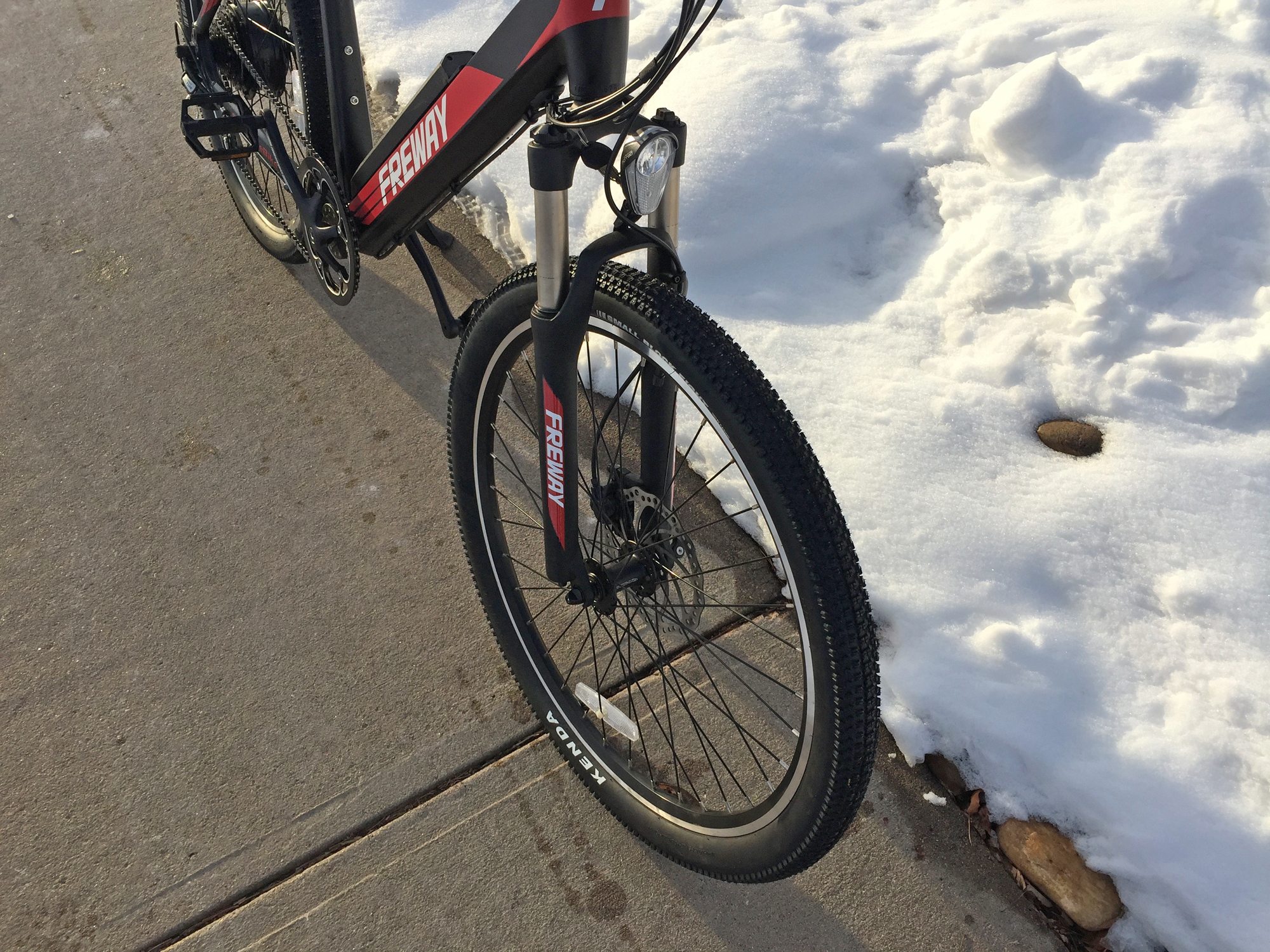

- Decent tires, the 27.5″ diameter offers a nice compromise between quick steering 26″ and smoother cushier gap-spanning 29ers
- Very nice integrated lights! I couldn’t figure out how to keep them on during the daytime but I love that the rear light flashes vs. just staying solid… I’m guessing that they use light sensors and automatically turn on when it gets dark out, to change settings hold both control pad buttons
- The display is compact but easy to reach and fairly easy to read day or night (thanks to a soft green backlight that comes on when you press either of the two buttons), it blends in and keeps the bike looking more normal

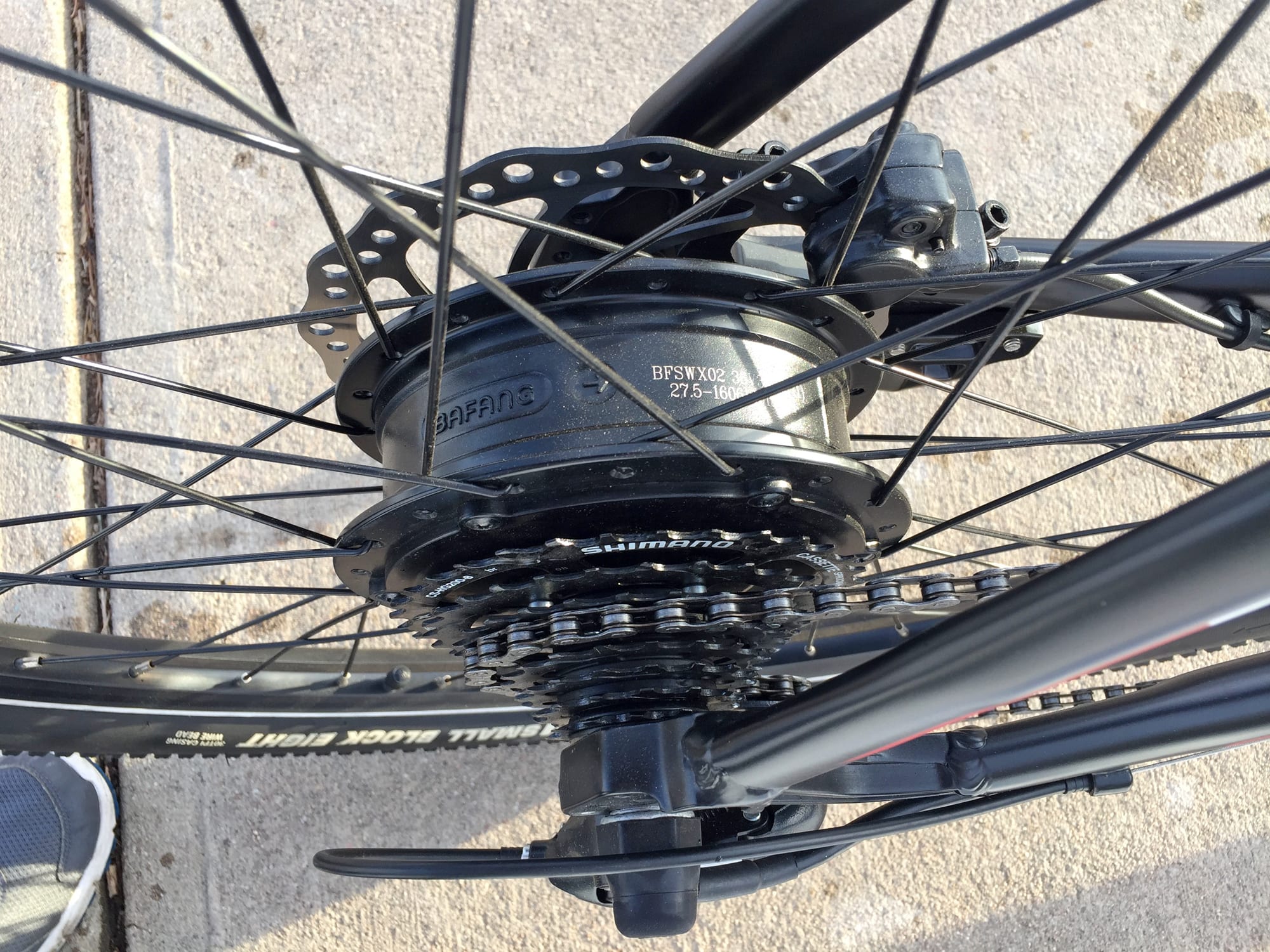

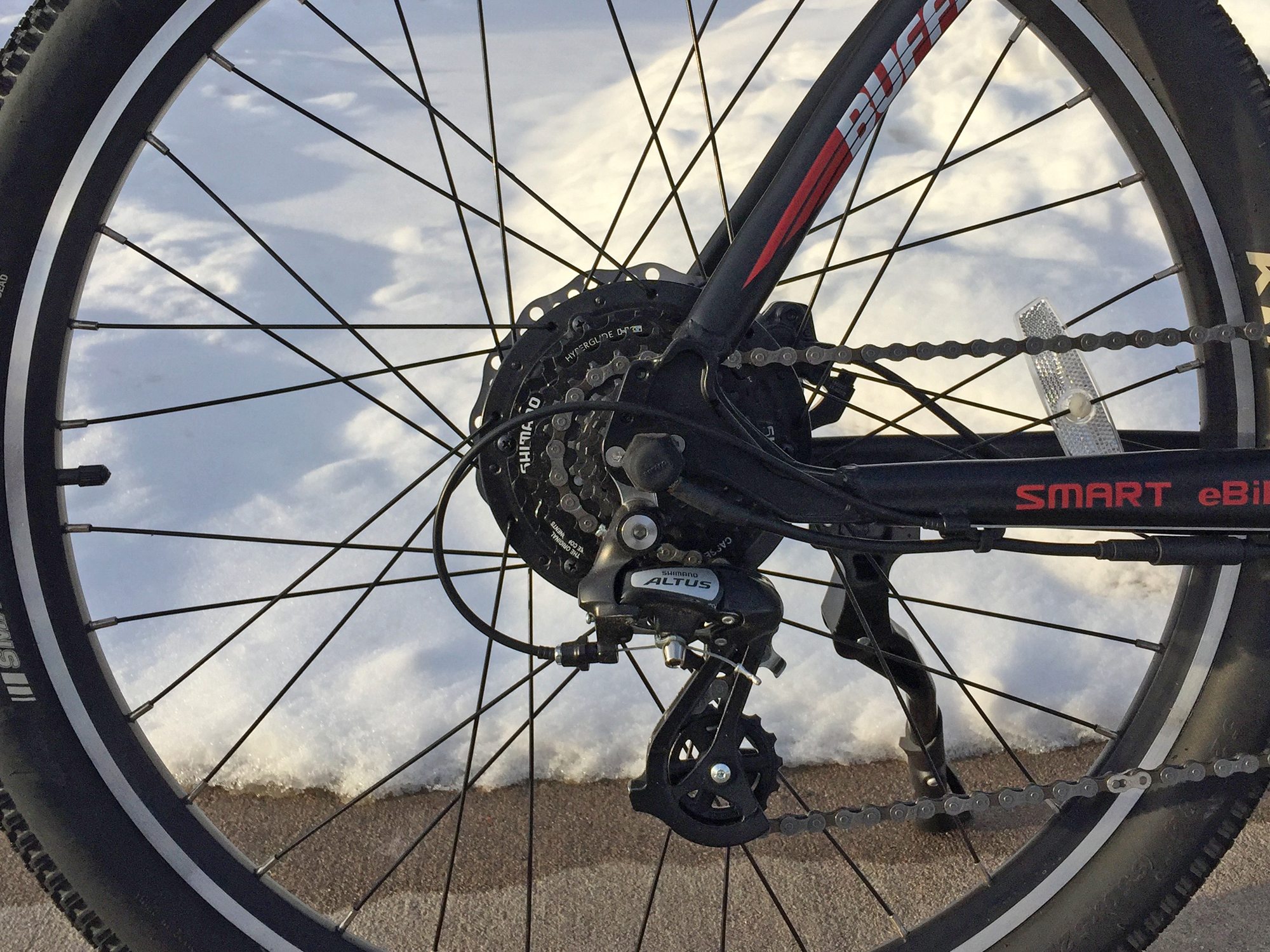

- Solid eight speed drivetrain with Shimano Altus (one step up from the bottom), I appreciate the bash guard on the chainring and the 12 magnet cadence sensor… all good for a value e-bike
- Adjustable length kickstand with a larger pad so it won’t sink into soft terrain, positioned towards the back of the bike so you can lube your chain or adjust settings without colliding

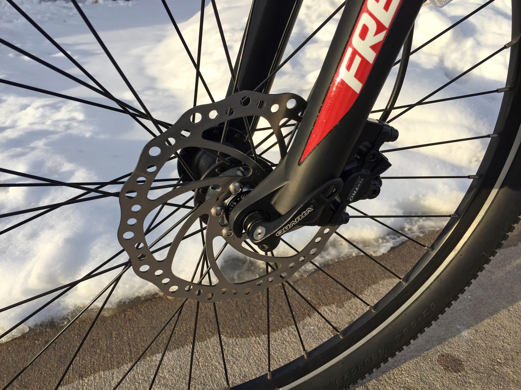

- Superb hydraulic disc brakes with large 180 mm rotors, the levers have ebike specific motor inhibitors to keep the bike under control when you need to stop

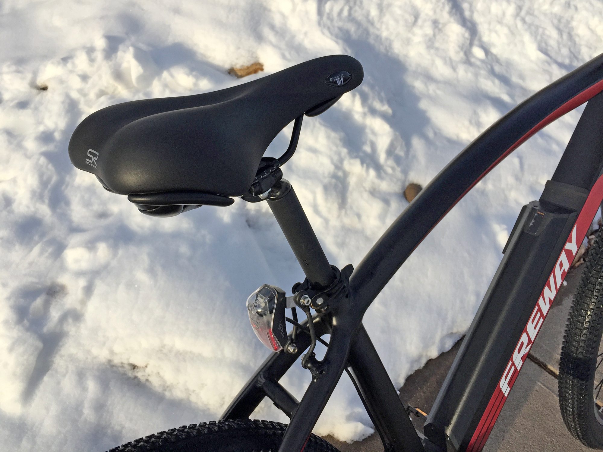

- I like the upgraded Selle Royale saddle and locking ergonomic grips but felt that the bar end parts were less useful (since they don’t adjust independently)
- Most of the wires are internally routed which keeps them from snagging and makes the bike look nicer, it seems that just one hydraulic line is tacked below the downtube
- It’s really nice that instead of a four or five bar info-graphic communicating battery charge level they actually show percentage (which is much more precise)

- The suspension fork has lockout and rebound adjust but didn’t travel as smoothly or fluidly as higher end hardware, maybe it just needed some more breaking in? Consider adding a 27.2 mm suspension seat post for greater comfort
- I love that there’s quick release on the front wheel be cause it makes flat fixes easier and reduces the size and weight of the frame (great for tossing it into the trunk of a car)

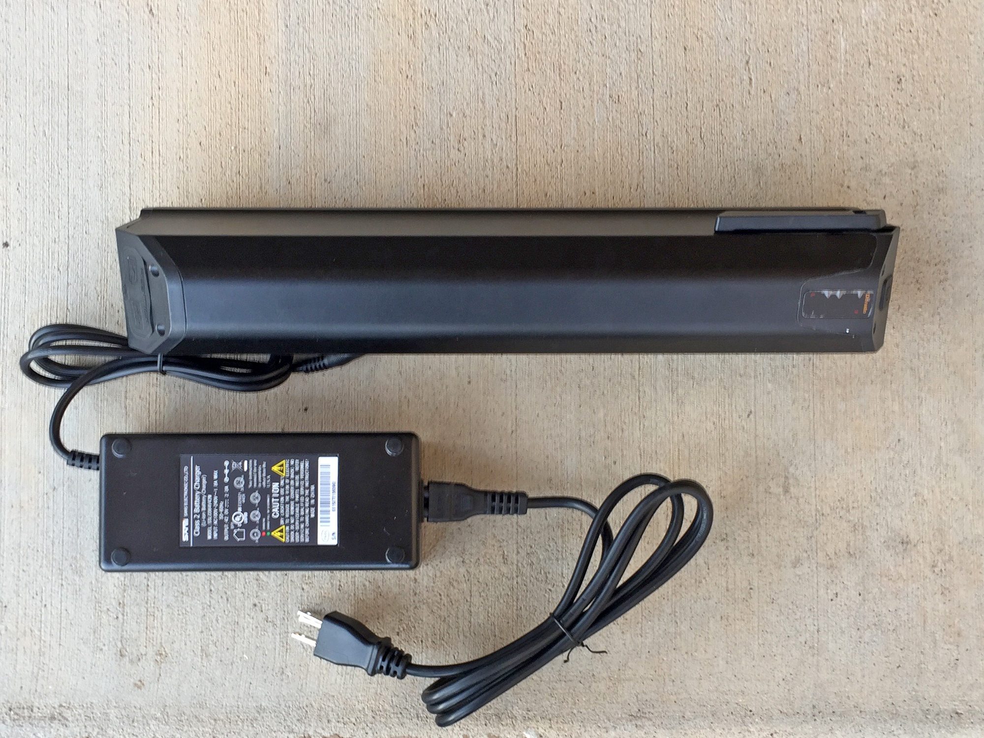

- Offering 2 Amps of power output, the charger isn’t going to be as quick as some others (these days I see a lot of 4 Amp chargers but mostly on 48 volt ebikes)

I have two freway buffalo e bikes I need two batteries, Can you help me with this please.
Court says
Hi Rosa! I’m not sure if Freway is still around. Perhaps you could get help repacking the existing batteries by contacting FTH Power or a similar company :)
