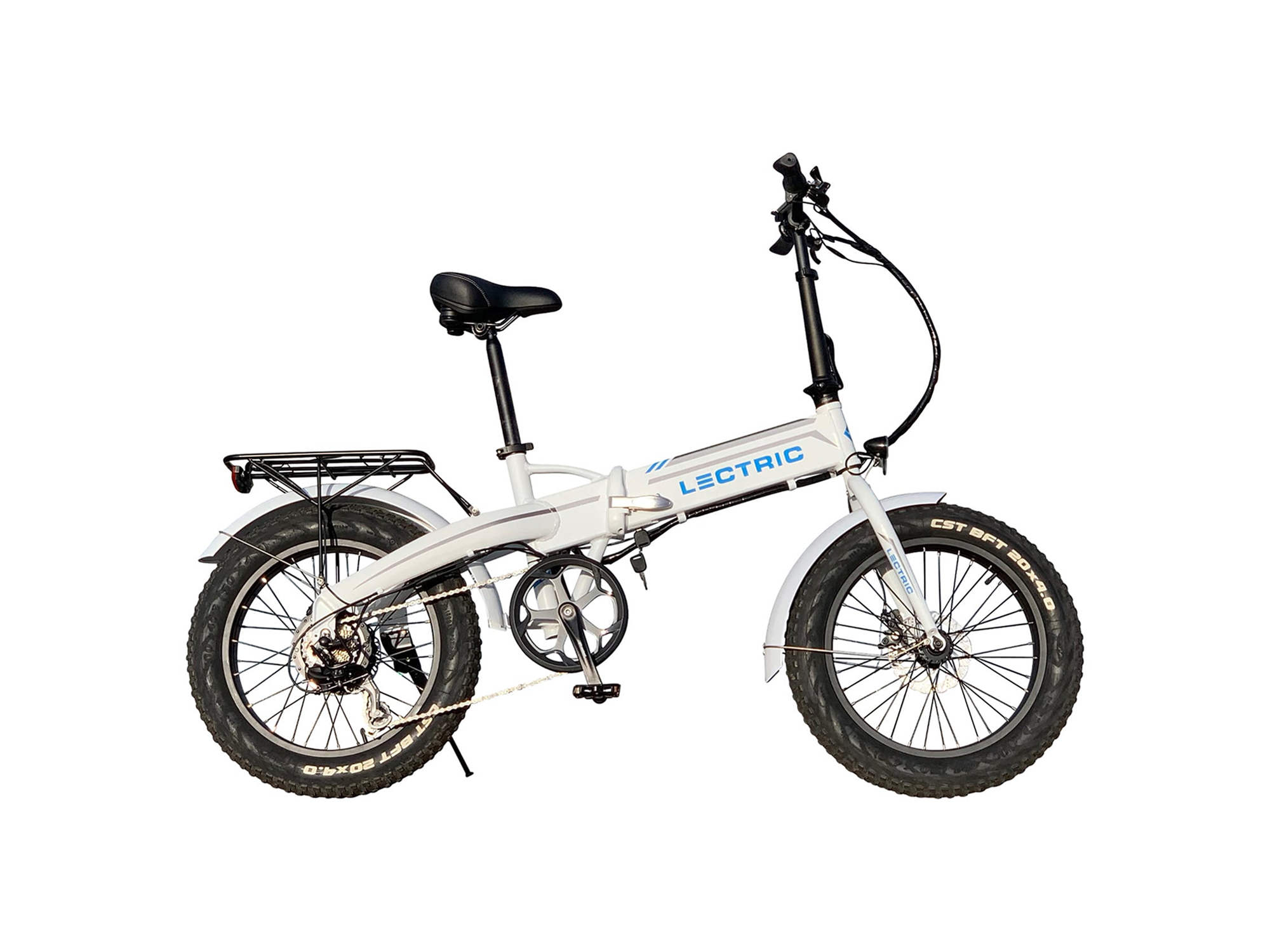

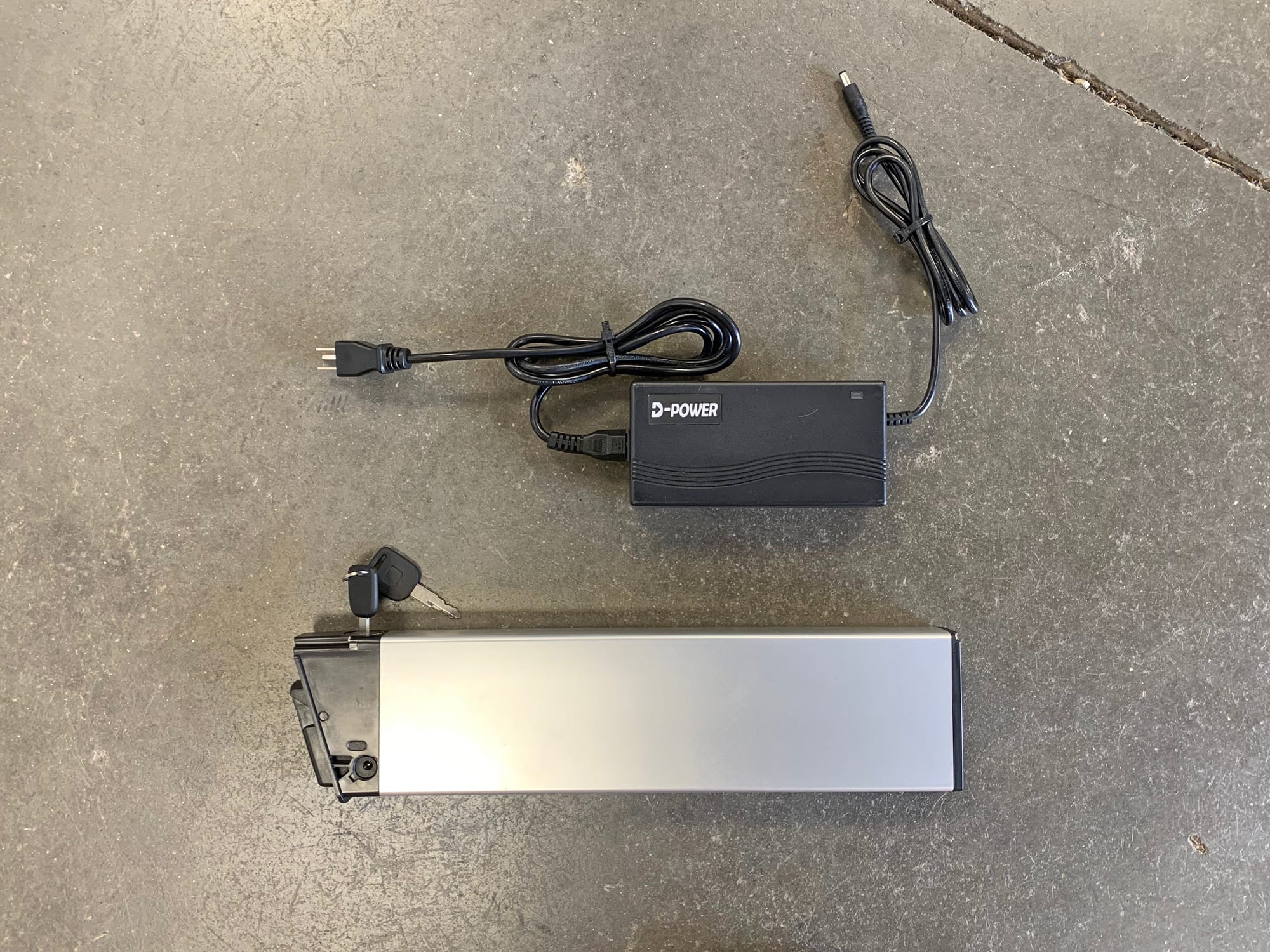

- The battery pack and controller are hidden on this frame, that gives it a nice aesthetic and probably protects the parts from physical impact and the elements… though it requires a bit more effort to remove the battery. The wires and electrical cabling is all external, but on a folding frame, that can mean they won’t get pinched as easily
- I love that the bike comes in two colors, and am a fan of their design and accent color choices, this lets you and a friend personalize a bit, and the white is my favorite because it’s more visible at night… great for a lower-riding bike where you’ll be easier to see, and Lectric eBikes even paint matched the fork and fenders on both models!

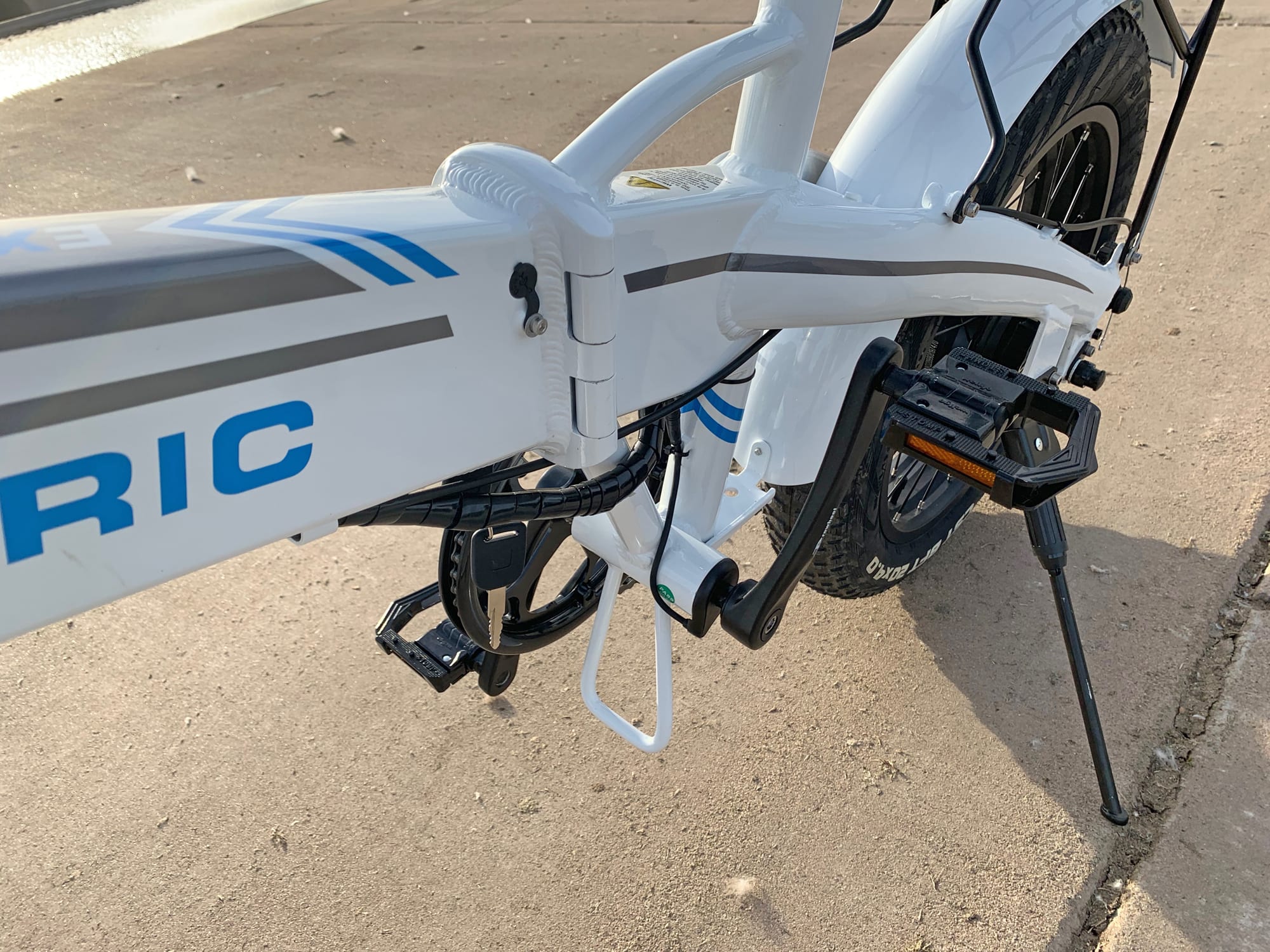

- I love the sturdy Wellgo platform pedals they chose here, many other folding pedals are plastic and offer less surface area and rigidity, the plastic chain guide and steel derailleur guard also keep it running smoothly and protected when folding and unfolding, the chain shouldn’t drop off and you’ll be less likely to get a snag or bend in the derailleur cable and motor power cable
- The battery design is compact and nicely hidden, I like that they use LG cells in the pack (higher quality) and offer a replacement pack for less than a few hundred dollars! Solid one year warranty with good customer support availability and willingness to make things right

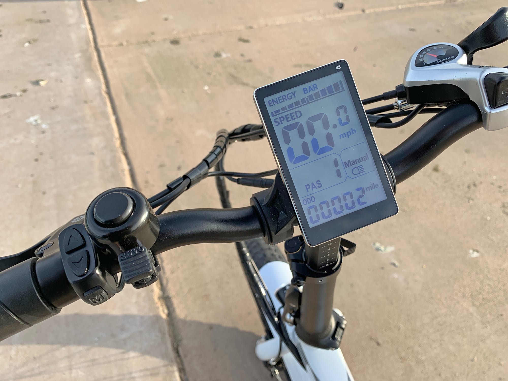

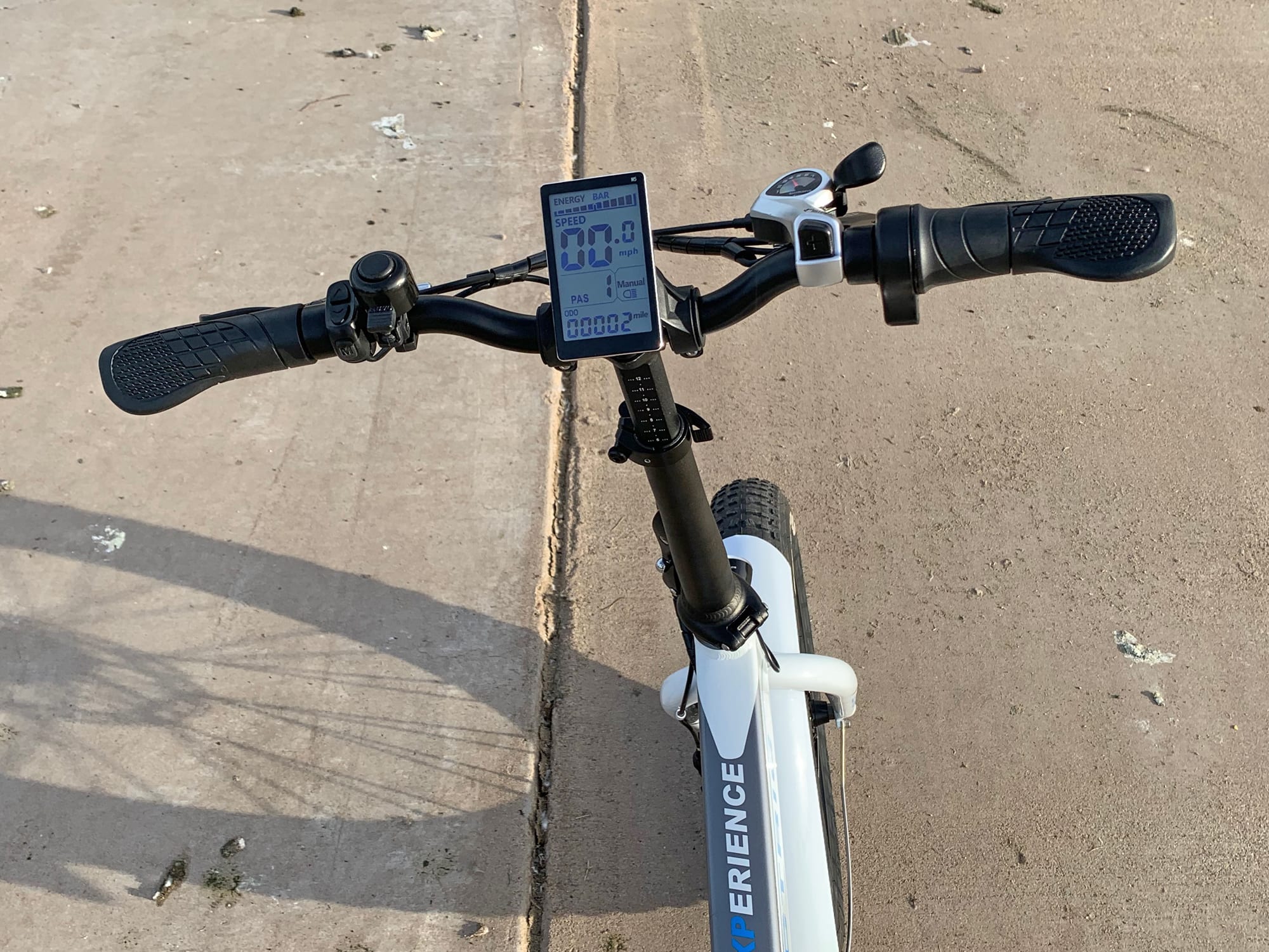

- The display is large and easy to read, it angles slightly to help you reduce glare, has a higher resolution 10-bar battery charge level indicator, and offers lots of adjustability in the settings… including the ability to set the top speed at ~28 MPH for speed pedelec performance, or lower it for better range and possibly safety or peace of mind for some riders

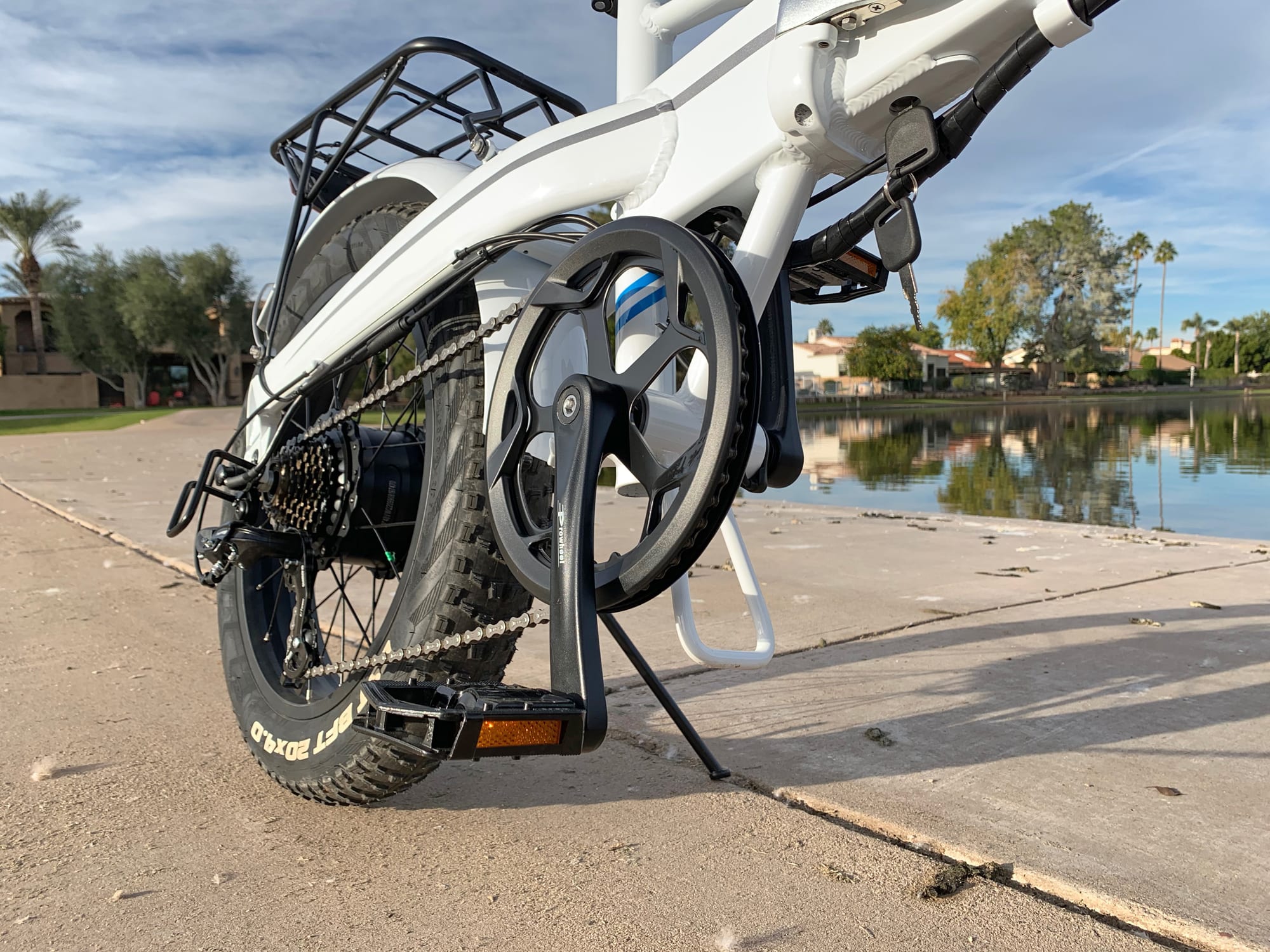

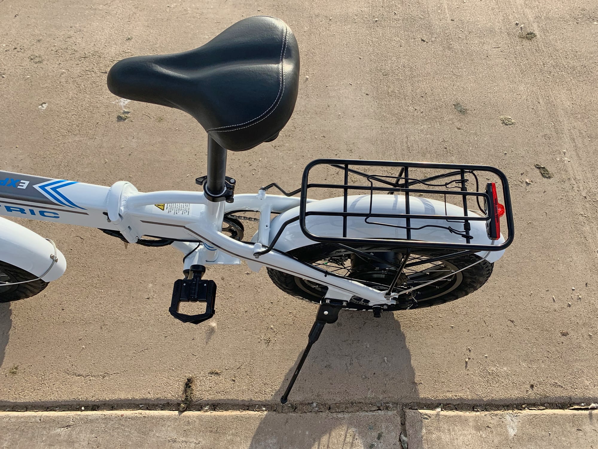

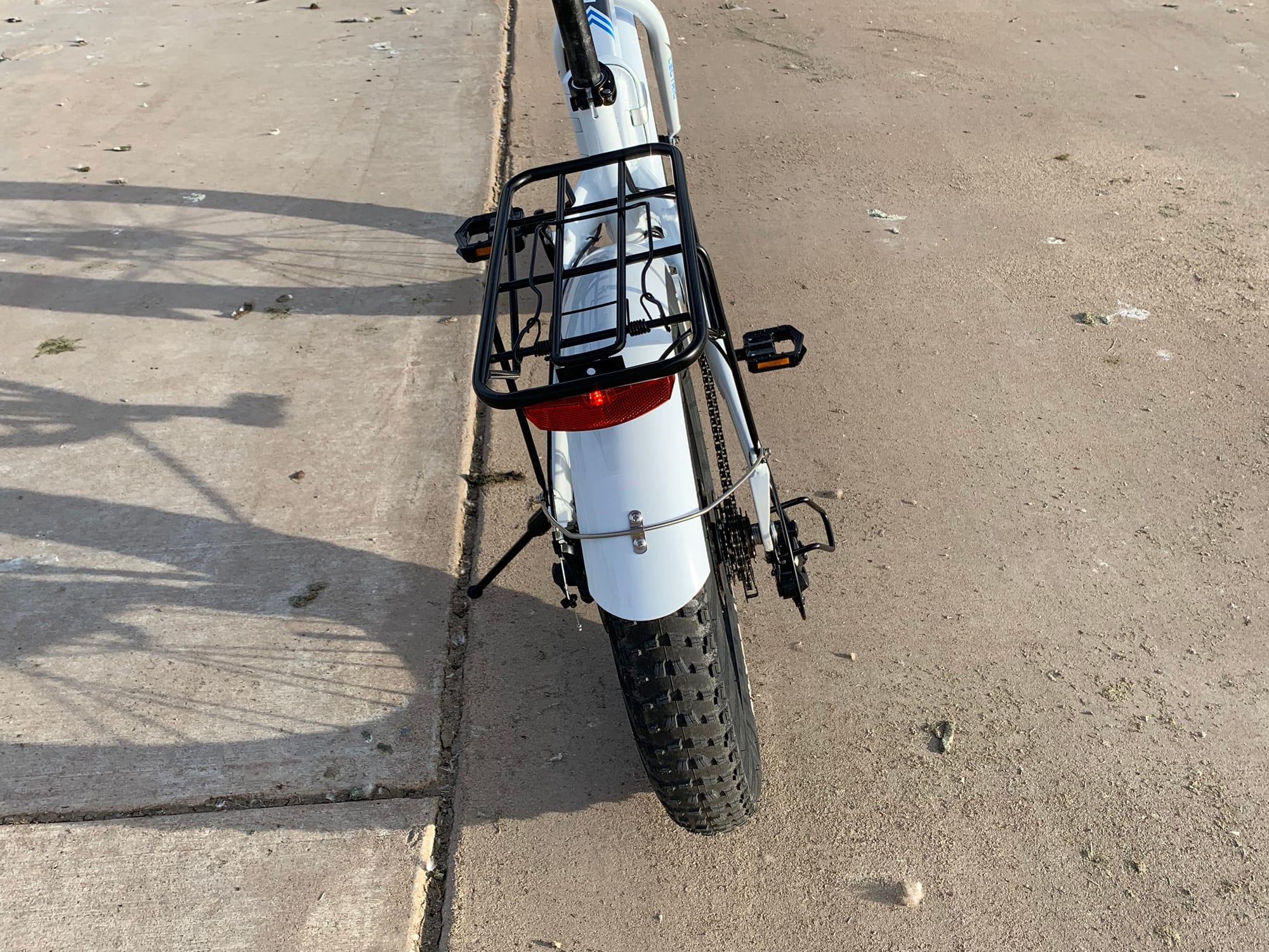

- The kickstand is positioned very well at the rear end of the bike, this won’t cause pedal lock and it didn’t bounce around or make a lot of noise during my test rides… even on bumpy hilly grass sections

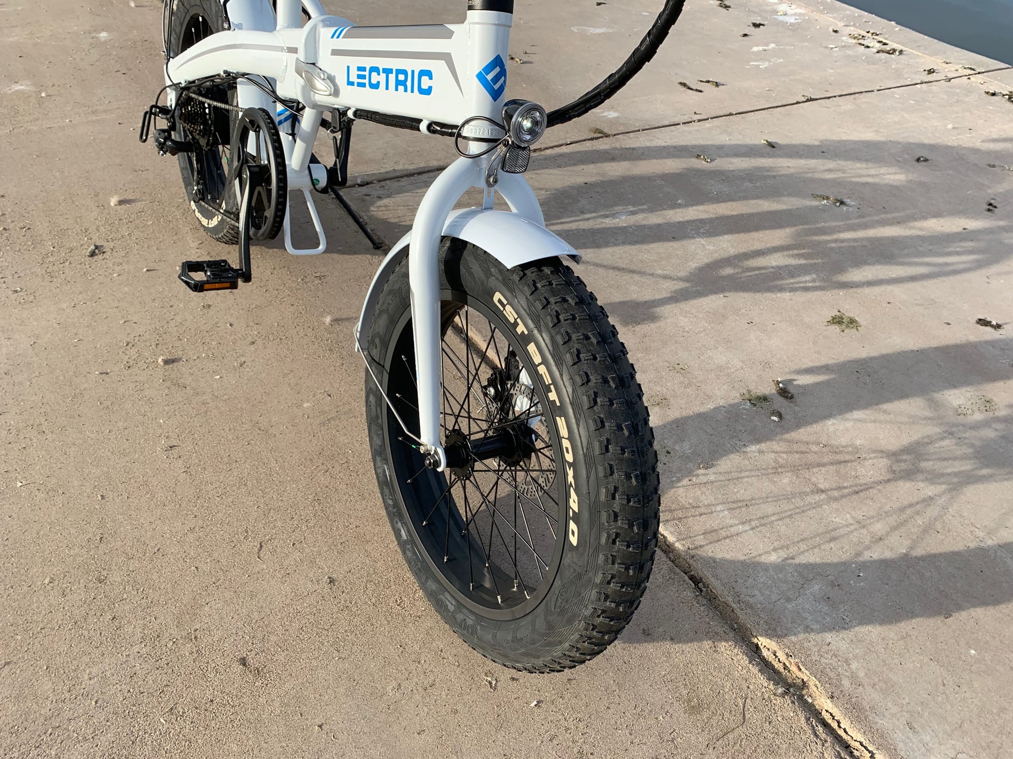

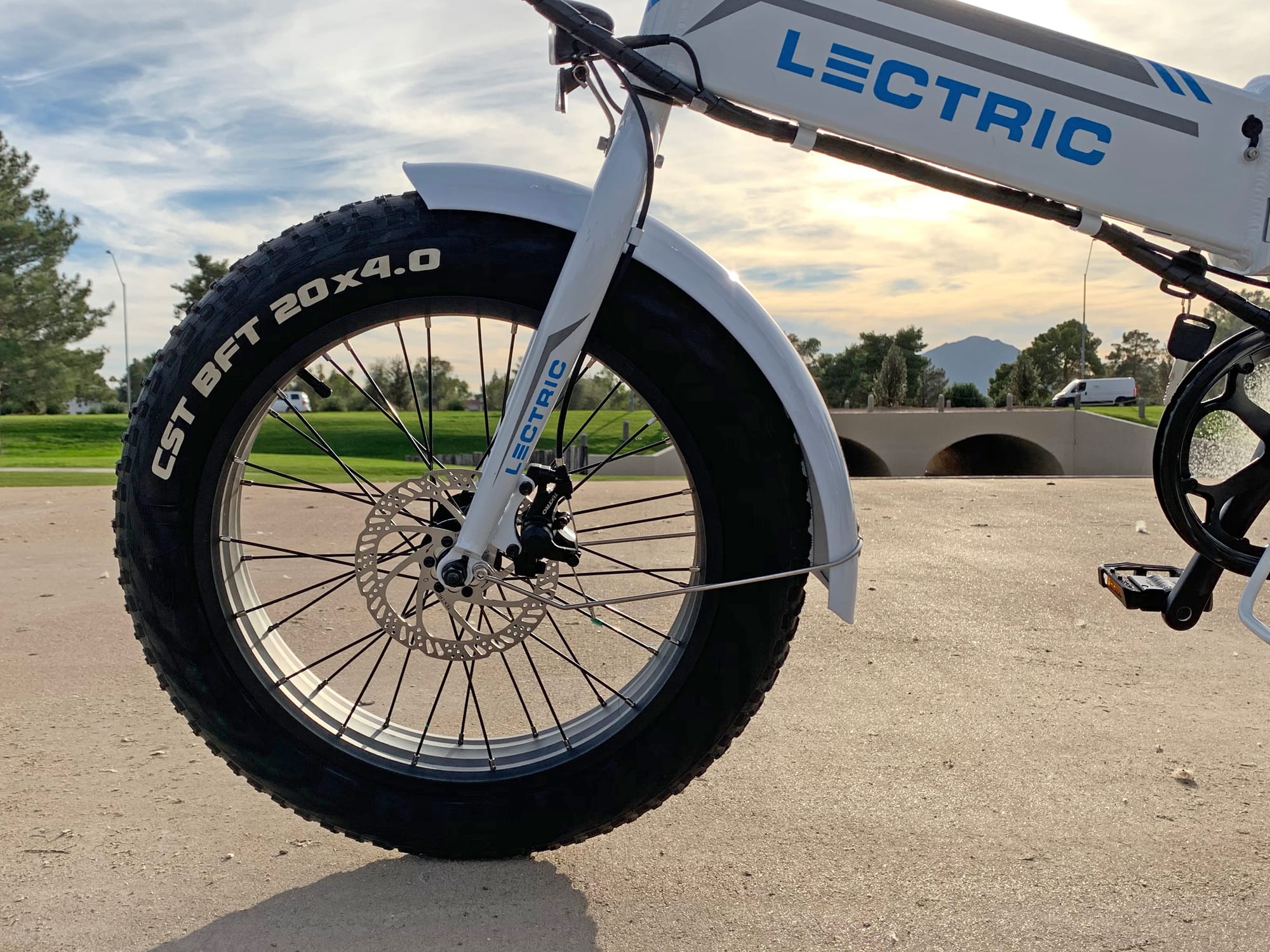

- Both wheels are built with thicker 12 gauge spokes for increased durability and weight capacity on the bike, the official max weight rating is 330 pounds (~149 kilograms) which is the best I’ve seen for a folding model

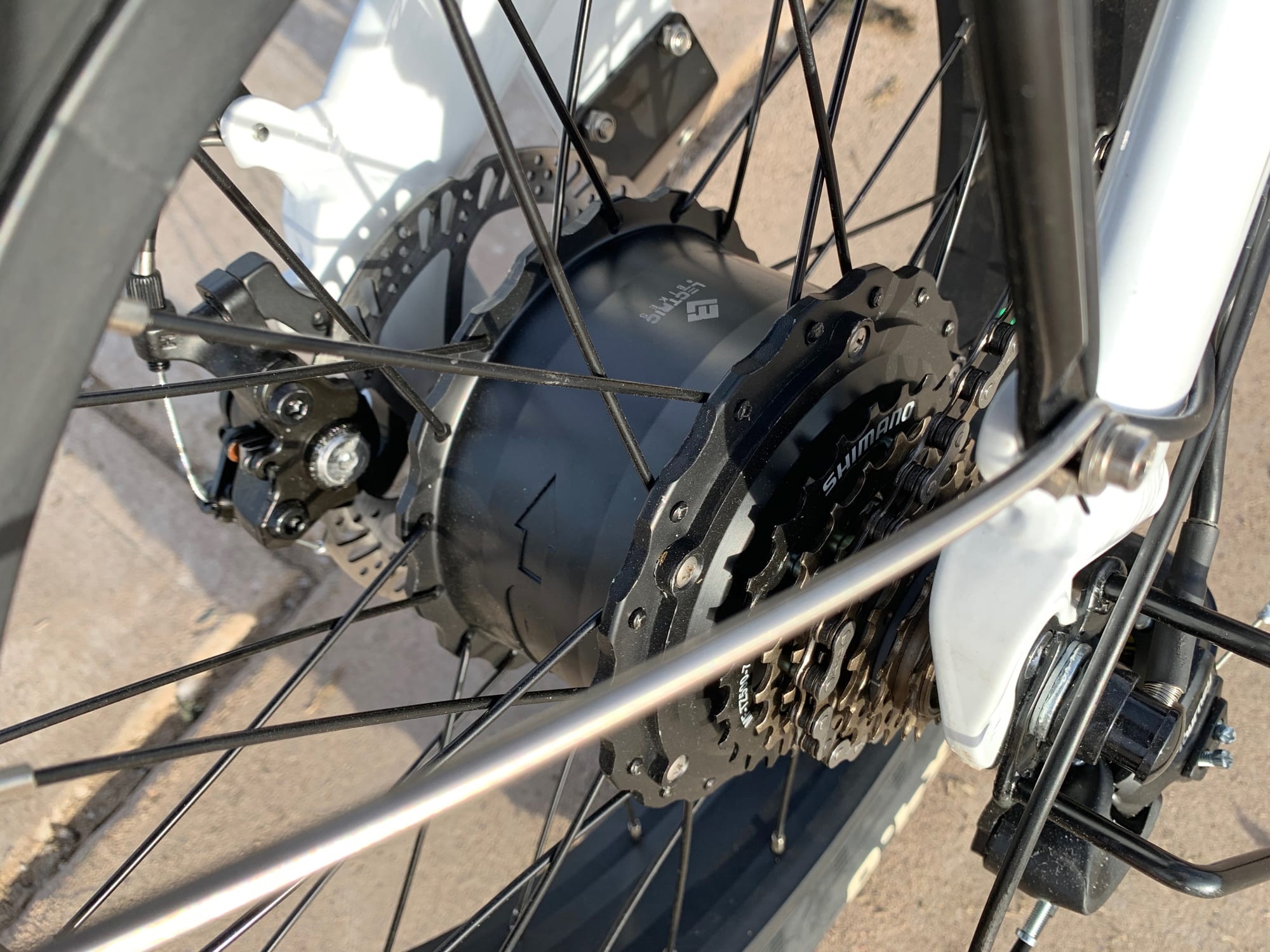

- The geared hub motor is zippy and powerful, it gets a big mechanical advantage because of the smaller 20″ wheels and can produce a lot of torque (up to 60 newton meters), it freewheels efficiently and is fat-tire specific so it’s wider and offers a solid bracing angle for the spokes

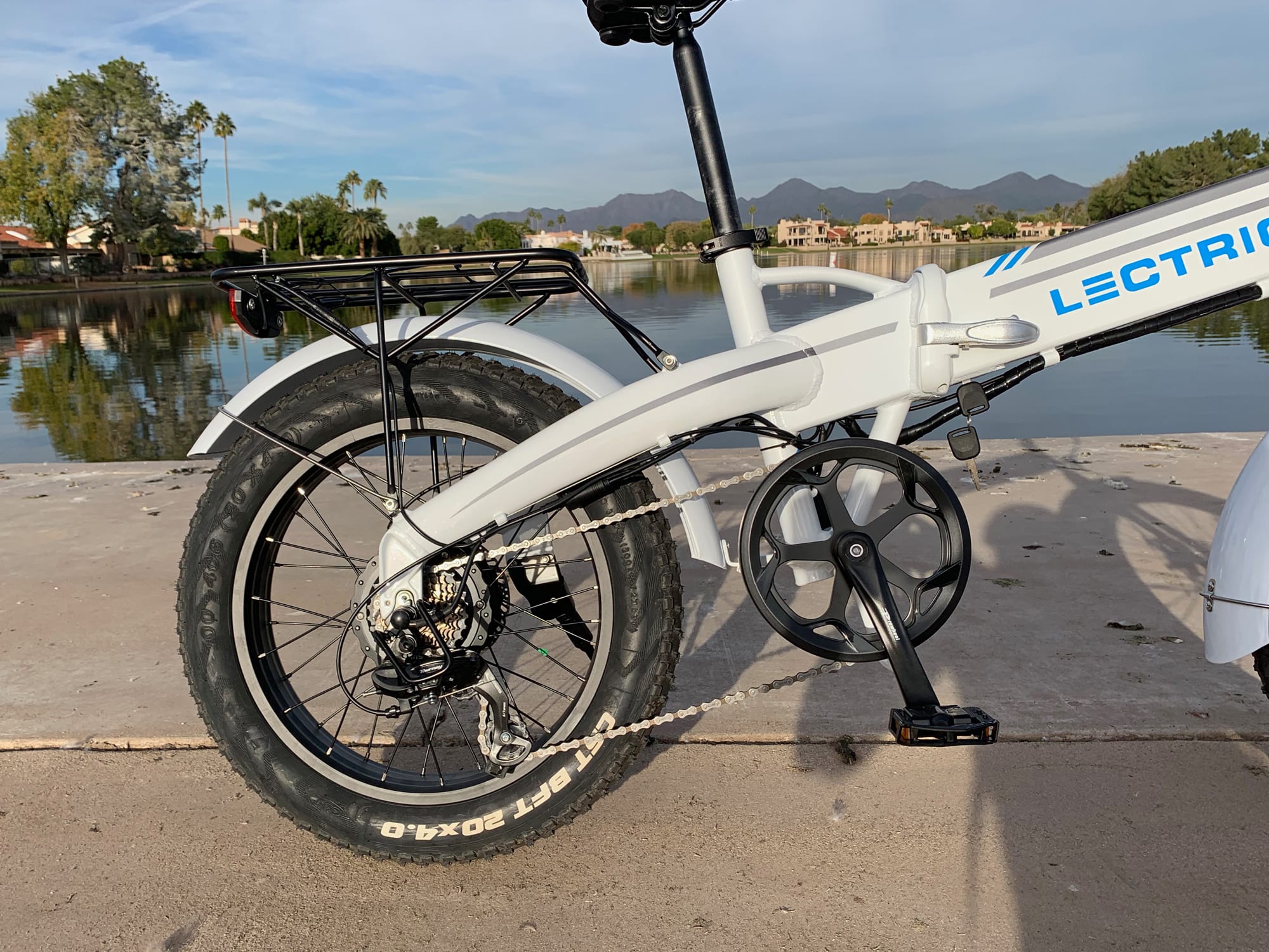

- The rear rack is wide, has a spring latch, and uses standard gauge tubing so it will work with most aftermarket pannier bags, please note that it’s 55lb (25kg) max weight rating subtracts from the total load of the bike (so a 55lb loaded rack plus a 275lb rider combine to 330lbs)

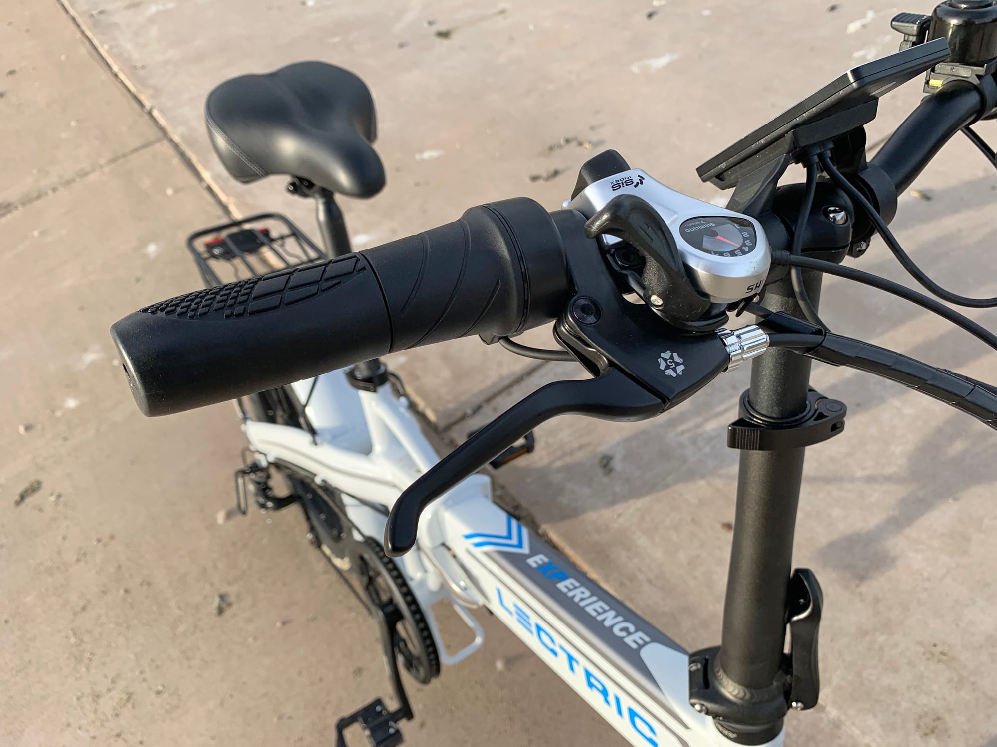

- Even though the saddle and ergonomic grips are unbranded, they both performed very well and offered a lot of comfort, especially the saddle which is thick, not too wide that it chaffs your legs, and has rubber bumpers for added cushion

- The handlebar is a bit narrow, this can make the steering feel a bit twitchy… especially since it has smaller 20″ wheels, this is easy enough to fix with a different handlebar but it’s something Lectric eBikes could also upgrade in the future. Consider a bar that’s got a bit more rise and backsweep like we see on the e-Joe Epik SE, but this could take up more space when folding
- Very basic Shimano Tourney derailleur and limited range freewheel, it offers 14 to 28 tooth sprockets vs 11 to 34 or more. Given the adjustable speed settings, up to ~28mph, it would be nice to see an upgraded cassette and a rust resistant chain
- The chain, steel fork, steel fenders, and steel rack are all vulnerable to rust… and the headset isn’t sealed. These are strength and cost savings decisions and it’s cool that the fenders don’t rattle around as much as plastic or aluminum alloy but they do also add weight

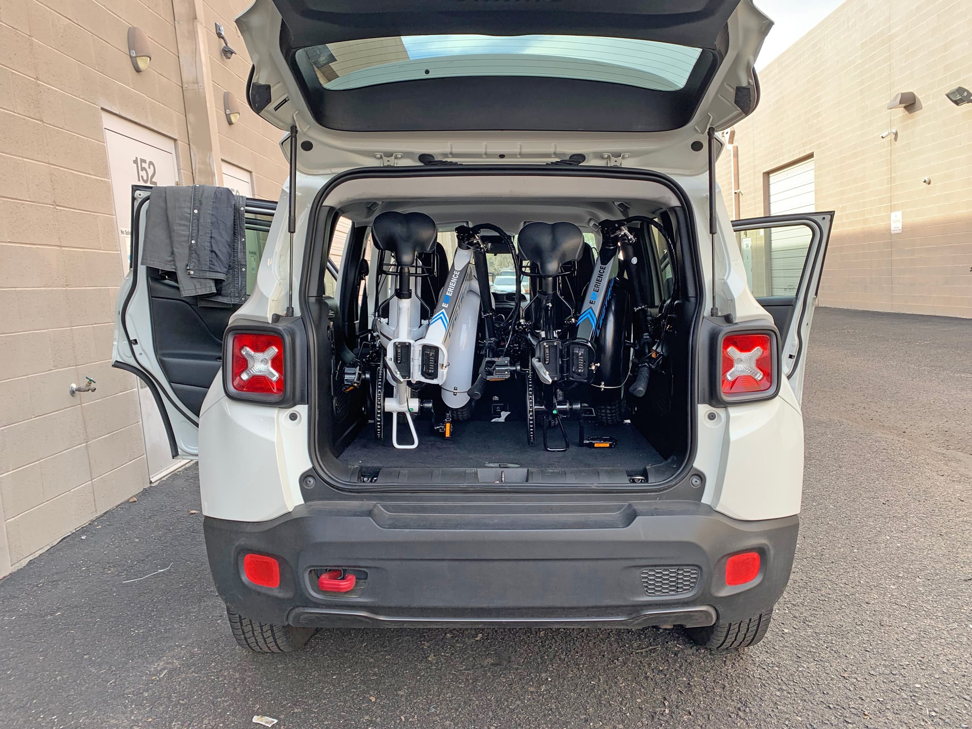

- The bike is fairly heavy at ~62.2 pounds (28.2kg), especially for a folding ebike. Yes, you can remove the 6.6lb battery pack and even take the rack and fenders off… but that takes time and manny people will just want to load it up and go, consider getting help from a friend and lift with your legs, not your back ;)

- I wish the locking core was somewhere more convenient than below the main tube, it requires you to bend down and insert upwards in a direction that you can’t really look at unless you get down on your knees, and turning the key wasn’t particularly easy or smooth for me… these issues are all compounded by the requirement that you insert the keys and turn the bike to on each time you want to ride! The guys said this has to do with safety so the bike can’t be tampered with, and also that it completely shuts down the battery so it won’t slowly drain and get damaged… but for me, even having to leave the keys in while riding (possibly dangling down with a keychain on them) is annoying and uncommon
- There are no USB charging ports on the display or battery pack here, that’s something you get with most competing bikes that are just a bit more expensive, but that can also slowly drain the battery, add electronic complexity, and not everyone needs it, so I see why they left it off
- The display is large and easy to read but not removable, so it could take extra weather wear and possibly get scratched at a bike rack, if the bike gets crashed, or if you’re folding it

- I’m not a huge fan of the big thumb shifter design for the gears because it seems like I have to stretch my right hand to reach it and the gears don’t shift as quickly or crisply, but this same shifter is often chosen to make room for twist throttles (as we see here), and the larger shifter levers can be easier to interact with when wearing gloves
- The 160mm mechanical disc brakes worked okay during my ride test, especially with the smaller 20″ wheels, but I definitely prefer hydraulic because the levers are easier to pull and can be reach-adjusted for small and large hands, expect the right lever (for the rear brake) to be harder to pull, for there to be some cable stretch over time, and for both levers to become more gunked up over time as dust and water get into the cable housings

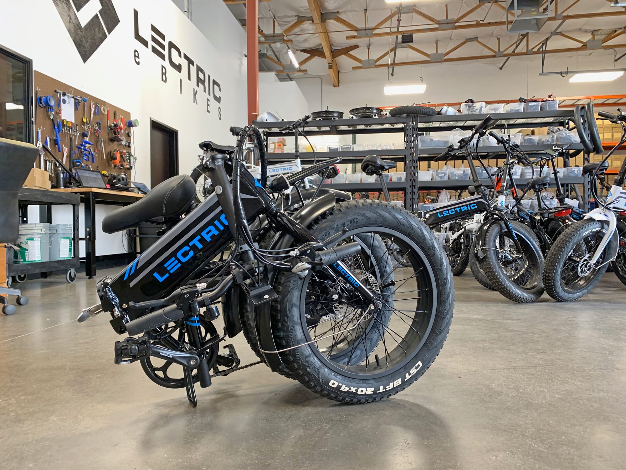

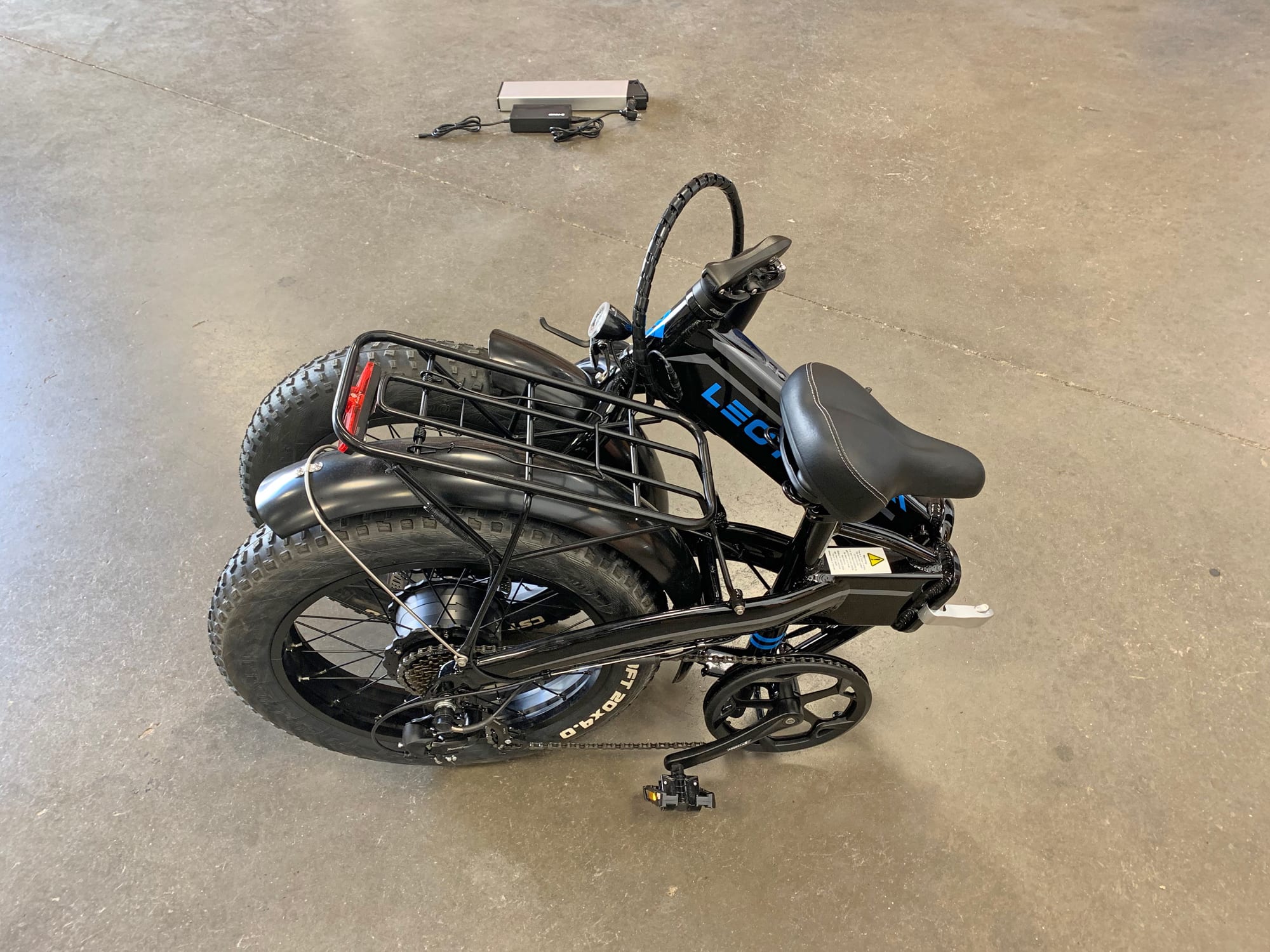

- There is no folding retention mechanism (like magnets or a rubber strap), so consider buying so plastic bungee cords and putting a towel between the two portions of frame to keep the bike from rattling around and scratching itself up
