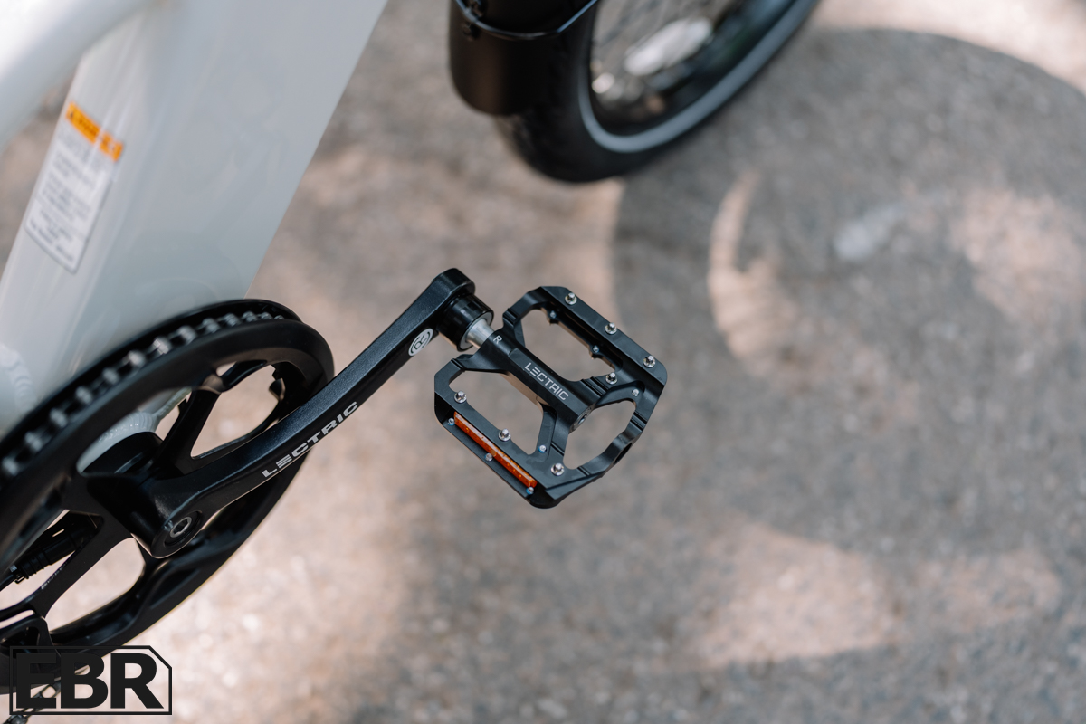

In my first spin on the XPedition 2.0, I quickly started forming some first impressions. Right off the bat, you can see some consistent features across Lectric’s newer models, like the quick-release pedals and that trusty M24 motor. Now, with the addition of the PWR+ programming and torque sensor, it really seems to be dialed in for a longtail cargo setup with those compact 20-inch wheels. This combo works surprisingly well—the PWR+ strikes a balance between cadence and torque sensor benefits, which means even a light pedal in a higher assist level gives a solid 300-400W of output, ideal for hauling a load. Then, when you put some real pressure on the pedals, it peaks at around 1310W’s, giving you that extra push right when you need it.

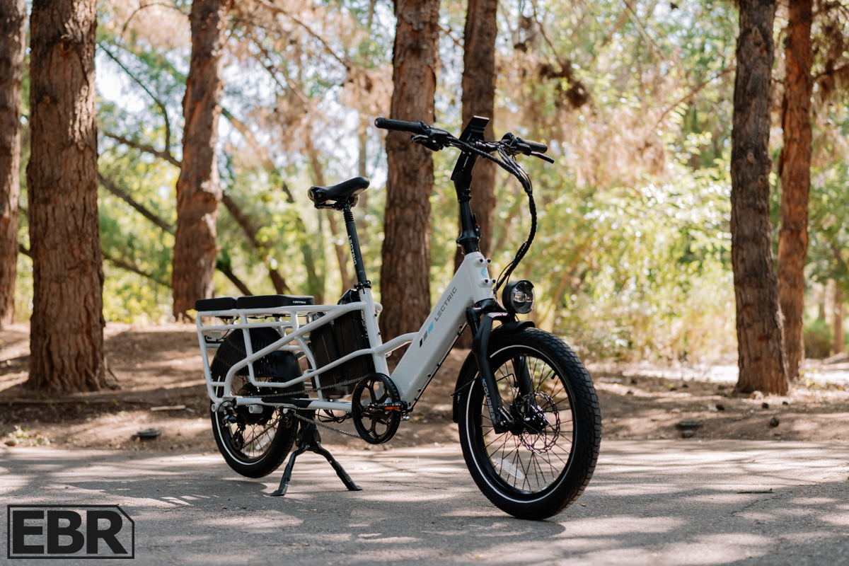

When it comes to handling, I noticed that despite being a longer bike, the XPedition 2.0 doesn’t feel cumbersome or oversized. It’s set up for comfort with an adjustable stem that lets you dial in a comfortable position, and it’s stable enough that even at higher speeds, you don’t feel that “weight pull” in the rear until you’re really loaded up or hitting bumps. That can’t be said without giving a nod to Lectric adding in the Courier 50 front suspension fork, again, a big jump in specs and no change in price. Compared to the original, the fork and narrower tires seem to add a bit more agility, which makes navigating urban roads feel easier and, overall, improves rolling efficiency.

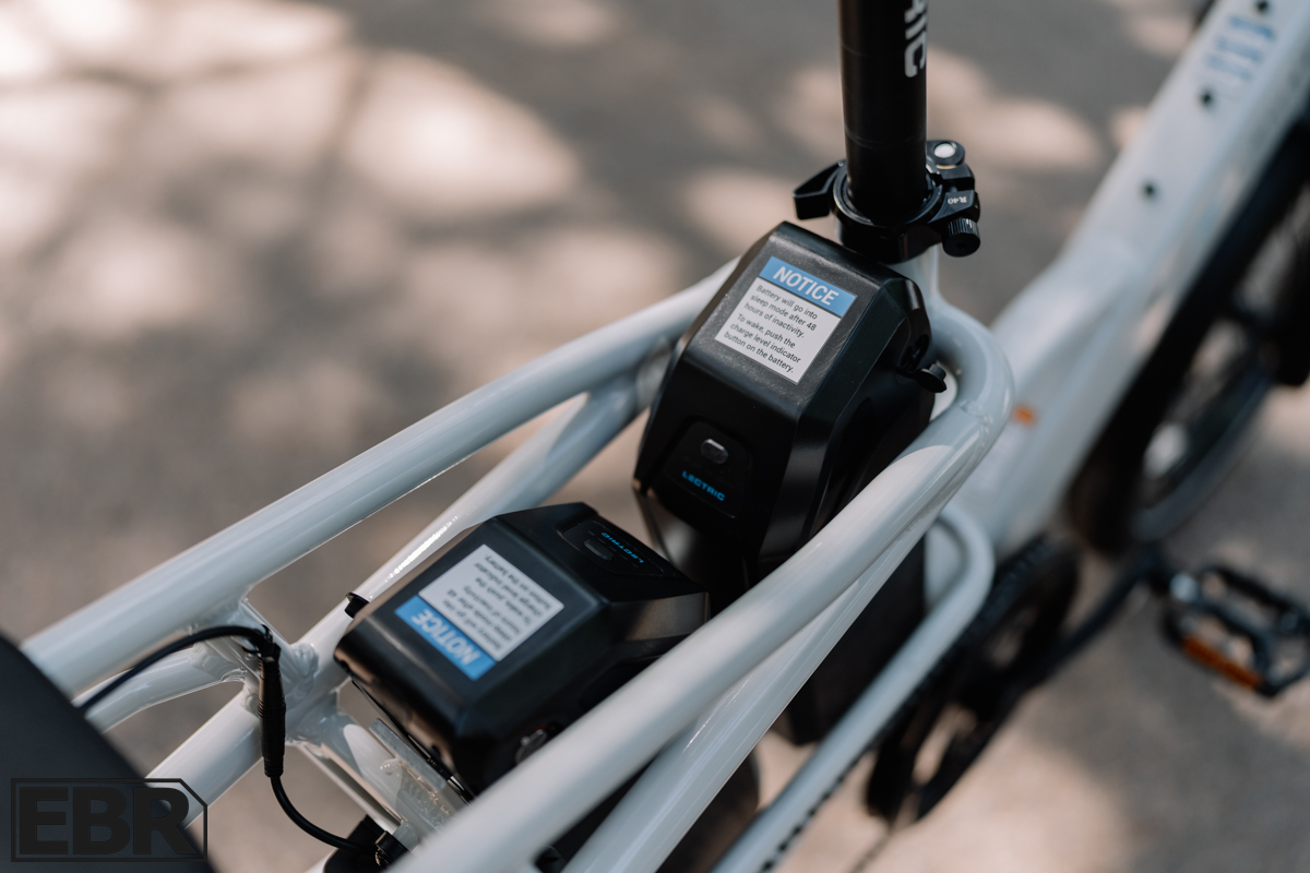

When it comes to range, you have some choices at purchase that will affect pricing. First is the stock version ($1,399) with a single 624Wh battery estimated at up to 60 miles of range, then a dual 624Wh (for a total of 1248Wh’s and priced at $1,699) with a range estimate of 120 miles and finally the creme-de-la-creme, a dual long range battery setup with two 840Wh batteries totalling a massive 1680Wh’s of juice that’s expected to deliver a mind-bending 170 miles range priced at $1,999.
I was sent the dual long-range version, equipped with two 840Wh batteries, totaling 1680Wh and boasting that claimed range of up to 170 miles. To keep the test manageable, I opted to run it with just one battery (840Wh), as covering the full dual-battery range in PAS 1 could take days to achieve the potential 170 miles.

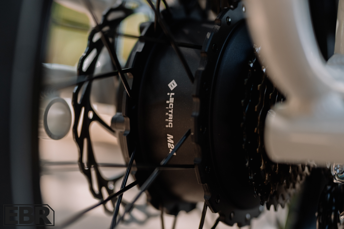

The Lectric XPedition 2.0 is equipped with a proven 750W rear hub motor, complimented by the M24 “stealth” technology for what Lectric markets as a quieter and smoother performance – which seemed to ring true in my testing, it’s not silent, but certainly quieter than the previous conversion and definitely smoother.
Integrated with PWR+ programming and a torque sensor, the motor provides precise, responsive pedal assistance that adapts to the rider’s effort, ensuring an efficient and intuitive riding experience. Delivering a peak power of 1310W and 85Nm of torque, it’s equally at ease taking you up a steep climb as it is on flats. The torque sensor feels dialed-in and smooth, and gives some added efficiency by modulating power output based on pedaling force, thereby extending the bike’s range.
The bike can also be configured as a Class 1, 2, or 3 e-bike, subject to local regulations, providing versatility for different use cases. The combination of M24 technology, PWR+ programming, and the torque sensor ensures the XPedition 2.0 delivers plenty of power and impressive range, making it a solid choice for anything from hauling the kids to school cargo to extended commutes.

The XPedition 2.0 brings even more upgrades that tackle stability, power delivery, and cargo handling—key areas where the original could use a boost. The frame keeps the same sturdy aluminum build but with an extended wheelbase, making it more stable under load. This longer frame not only accommodates the dual battery setup but also provides a bit more real estate for cargo, giving it a solid, balanced feel—something you’ll appreciate when hauling up to 450 lbs.

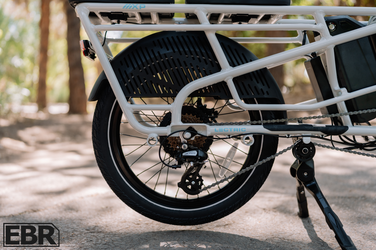

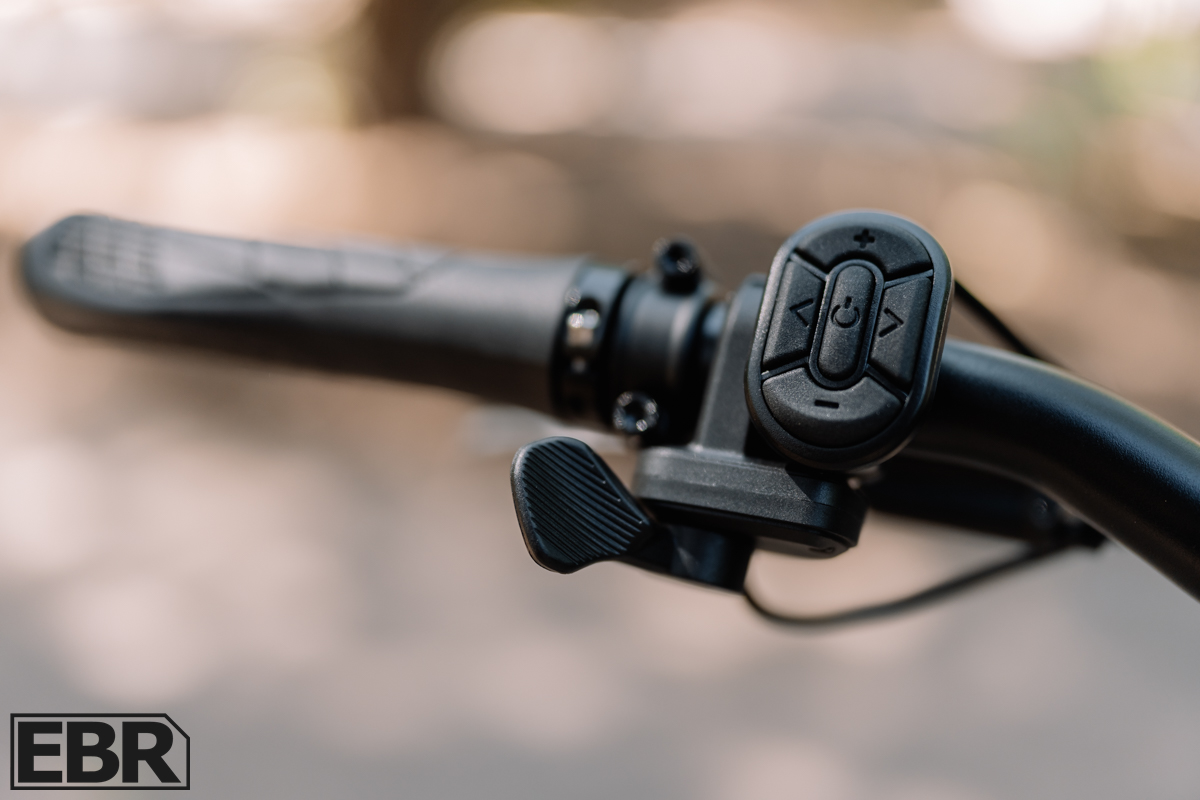

In the drivetrain, Lectric upgraded to a Shimano 8-speed system from the original 7-speed with an 11-32T Shimano HG cassette and 52T chain ring, giving a bit more range to handle hills or heavier loads. Shifting is now managed with under-the-bar trigger shifters, replacing the older, clunky thumb shifters that oddly sat above the bar making it difficult to reach, a welcomed upgrade. Does it matter a ton? Nope, but subtle improvements like that just improve shifting on the go without the need to look at the shifter each time.
The hydraulic disc brakes stay true to the XPedition’s utilitarian focus but get a boost as they are now bumped in thickness from 1.8mm to now at 2.2mm for better cooling and brake longevity..

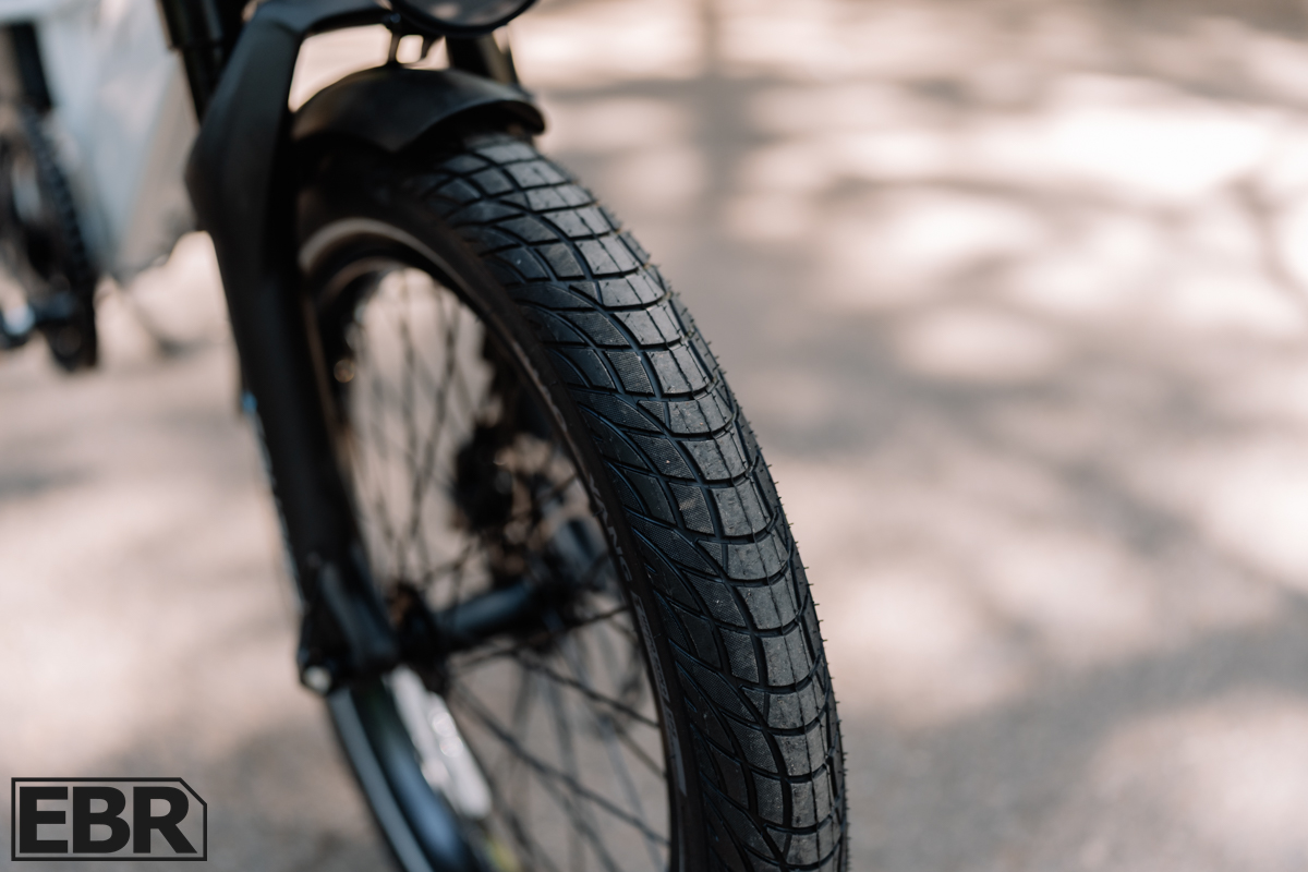

The 20 x 2.5-inch tires are narrower than the typical fat tires you see on some cargo bikes, which might seem unusual, but it actually helps with maneuverability. They’re nimble enough for city riding while still wide enough to support heavier loads without compromising grip, and you still have a little room left to air down for some extra comfort should you have a rear passenger.
Other updates include a color display with turn signals and lock-on grips for improved handling and control, although you still need a owners manual to decipher the codes on the advanced settings menu.
Rounding things out is an improved, extra-wide kickstand. Its massive 15-inch footprint and center-mounted, double-legged design keeps the bike rock steady. This makes it easier and, I think, safer to get going: just push the bike forward while still seated, eliminating the need to dismount, support the bike’s weight, put up the kickstand, and then remount.

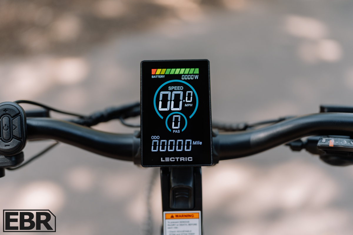

The XPedition 2.0 steps up from the old-school, duo-tone LCD with calculator-like text to a modern, full-color display. This upgrade not only looks sharper but also makes it easier to read in bright sunlight or shaded areas. It’s a simple, heads-up setup that shows all the essentials—speed, battery level, distance, and trip data—at a glance, so there’s no need to scroll through menus.
A backlight makes evening rides a breeze, and the USB-A port is a practical touch for on-the-go charging, whether it’s for your phone or another device. With IP-65-rated electronics, the display and components are better protected from dust and water, adding durability for riders who might venture beyond the usual paved paths.
Lectric kept it straightforward without app connectivity on the XPedition 2.0. For most riders, this isn’t a big deal since all key info is available directly on the screen. However, the advanced settings in the menu requires the owners manual to decipher the coded settings that represent basic adjustments like screen brightness, class selection, and more, unless that is, you can remember all 22 codes, I was unable. Overall, the color display is a welcome update, offering better functionality and readability without adding to the price.

One of the biggest choices at check out is the battery and range model options. The XPedition 2.0 offers three battery configurations: a standard 624Wh, a 1248Wh dual-battery option, and a Dual Long-Range 1680Wh setup, all certified to UL 2271 standards for safety. Riders can select from five pedal-assist (PAS) levels, ranging from PAS 1 for minimal support to PAS 5 for maximum assistance, each getting progressively more capable along the way.
