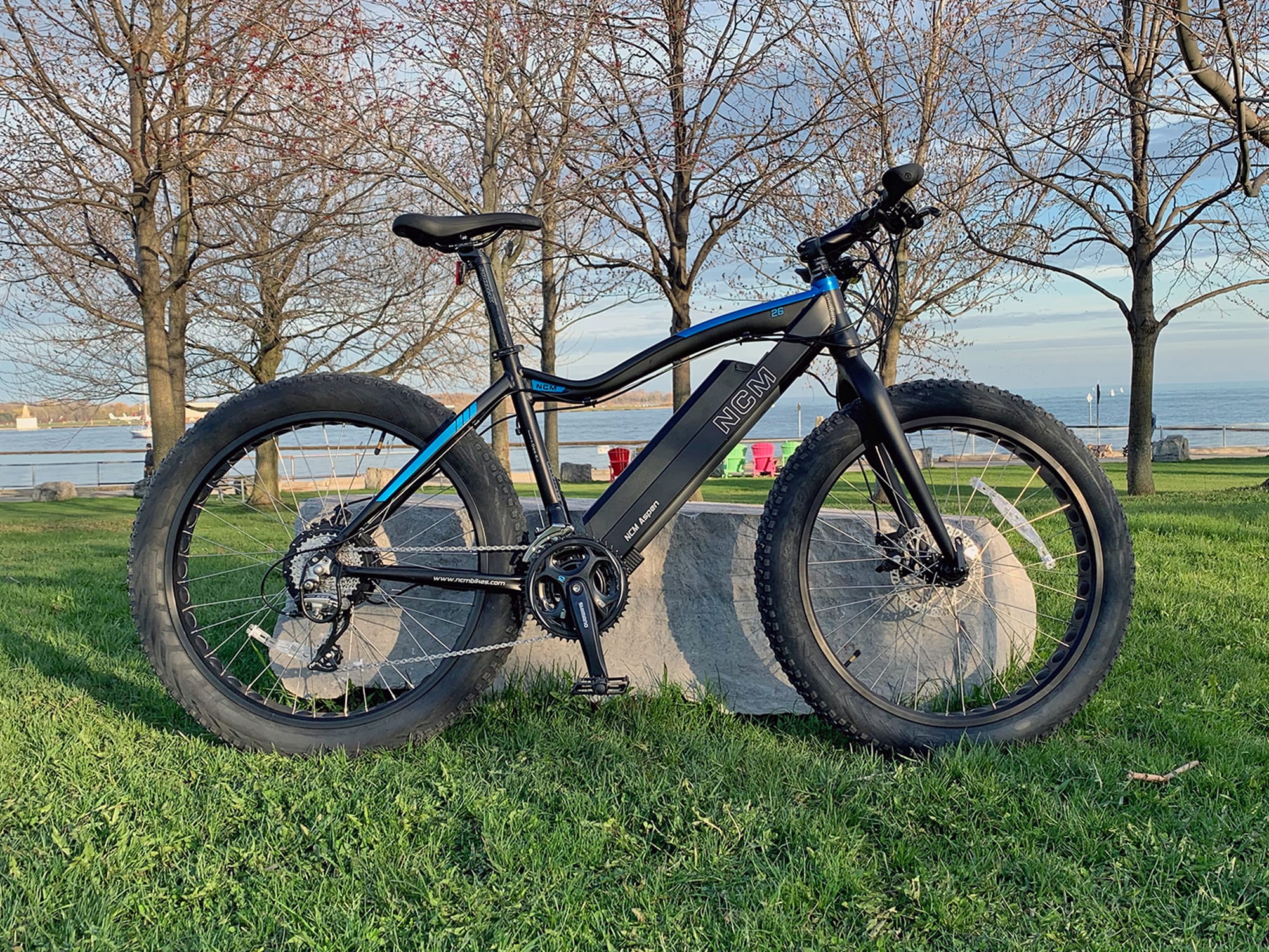

The NCM lineup of bikes so far have been value bikes with purpose built offerings. Such is the case with the Aspen, a powerful hard tail fat-tire mountain bike. The bike may be missing a few things like a kickstand or provisions, bottle cage bosses, or rack bosses, but it makes up for in a drivetrain that delivers and an extremely competitive price point. The bike is $1,699 in the US and $2,199 in Canada. What you do get are these nice 26” x 4” fat tires rated for 5-30psi and these punched out rims to save weight. As a matter of fact, the bike is pretty lightweight overall, we weighed it at 59.3lbs total with battery and all. Some of that weight savings may be due to the rigid fork that provides a responsive feel to the turf. The aggressive stem reach adds to that feel as well, so you really get this feeling of being on top of the trail. The frame is reinforced well and even has a sloped top tube to reduce the stand-over height. You also get a sticker slap guard which I really appreciate to keep the paint clean. Looking around, I see an integrated bell and locking ergonomic grips too. I think it is important to keep that $1,699 price point in mind, with that savings you could add a lot of things to this bike you may want like a suspension seat post or a dropper seat post. There is also a set of fender bosses, so you could add fenders too. The bike really shines on the drivetrain, so let’s jump into that right here.

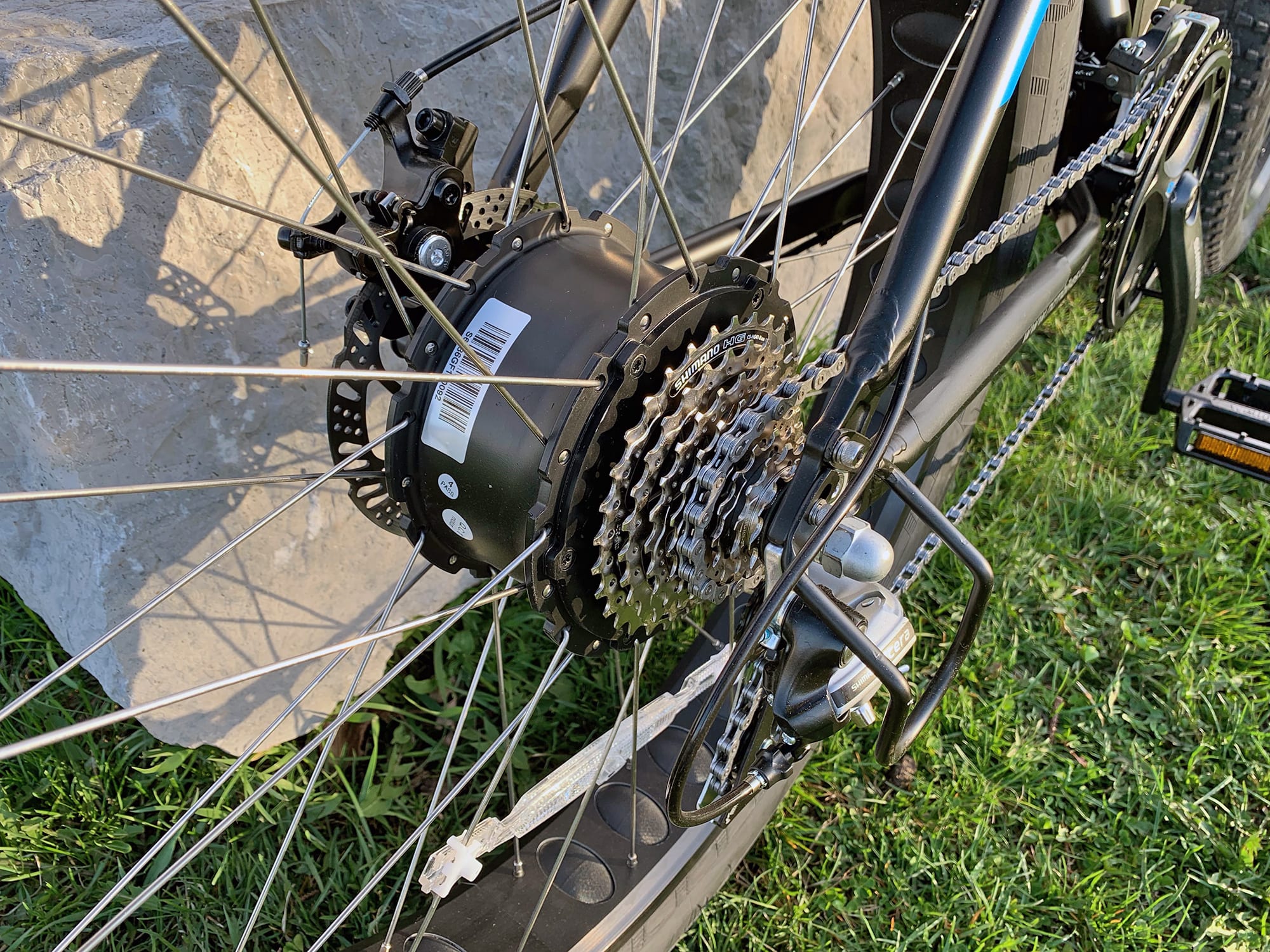

Driving the bike is a fat-tire specific 500 watt hub motor from Das-Kit. I found the motor to be really responsive with it’s 80nm of torque and it performed well on the ride test. Engagement of that motor is done either via the slim thumb throttle on the right, or through the sealed 12 magnet cadence sensor for pedal assist. I love that the display has a deep menu too so you could crank up the settings to make this a fast Class 3 ebike, or even remove the throttle to make it a Class 1 to comply with more jurisdictions. Mechanically, the bike has an 8 speed Shimano Acera system in the back with a 11-32 tooth cassette. I love that they went with Acera, typically on value priced ebikes, companies spring for the lower-end Tourney derailleur. In the front, you have a 28, 38, and 48 tooth triple chain ring. This makes for a large configuration of 24 gears altogether. Combined with the electric system and trigger shifters, it feels like this can tackle just about anything! Stopping the bike is a 180mm mechanical disc brake rotor in the front and a 160mm disc brake rotor in the rear. Mechanical disc brakes are easy to maintain as well as adjust, however, they lack the immediate stopping power that hydraulic brakes offer. Mechanical brakes are still quite capable, but they take a little bit more hand actuation compared to hydraulic brakes.

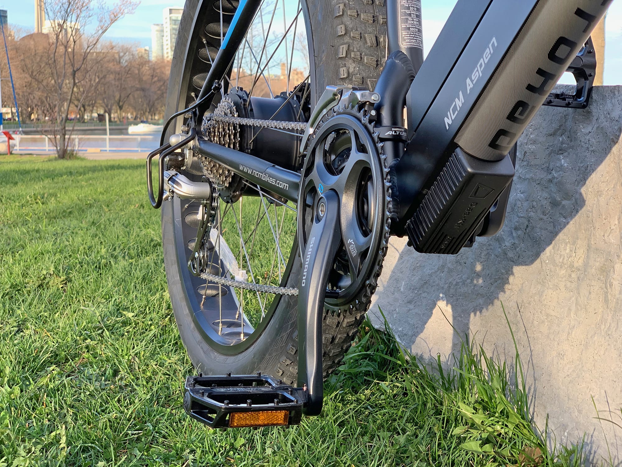

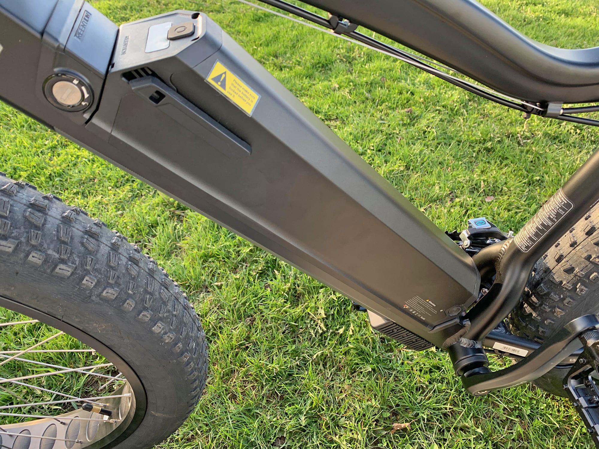

Powering the bike is a 48v 13ah hour Lithium-ion battery pack, mounted semi-internally to the downtube. During the filming, Virgina tells me there may be battery upgrades available too. This is a pack I have seen on many, many, many, other electric bikes. It locks in securely and has a little lever on the left which helps to pop it off the frame and can be used as a fairly secure way to transport. You can charge the pack when it’s mounted to the frame or separately, and I’ve heard that extreme heat or cold can be hard on Lithium-ion cells, so charging in a neutral environment if the bike has to be left outside in a snowstorm or inside a non-insulated garage during a heat wave is advisable. Charging completely from empty may take 6+ hours, but I’ve been told that it’s best to keep batteries from dropping below 20% because that can stress the cells… and you should still be able to get fantastic range with the top 80% of the pack. Of course, it all depends on how much you weigh, what the terrain is like, the wind, even the tire pressure being used. I’m a lighter guy, and I don’t always use the throttle, so I get pretty good range even if I drop the tire pressure (for comfort), and the recommended PSI range is listed above in the stats. The battery has a little rubber button on the top that illuminates a 4-LED charge level readout (handy if you’ve stored the pack away from the bike and cannot remember if it’s charged), and there’s a full sized USB port on the right side of the pack (presumably offering 5 Volts and 500 mA of power for charging phones and other portable electronics). If you decide to tap into the USB while riding, consider using a right angle USB adapter and some zip ties to keep the cables tight to the frame and away from your legs as you pedal. Similarly, the charging port for the pack itself is near the left crank arm, so if you leave the battery on the bike when charging, the cable could get snagged or bent, be careful.

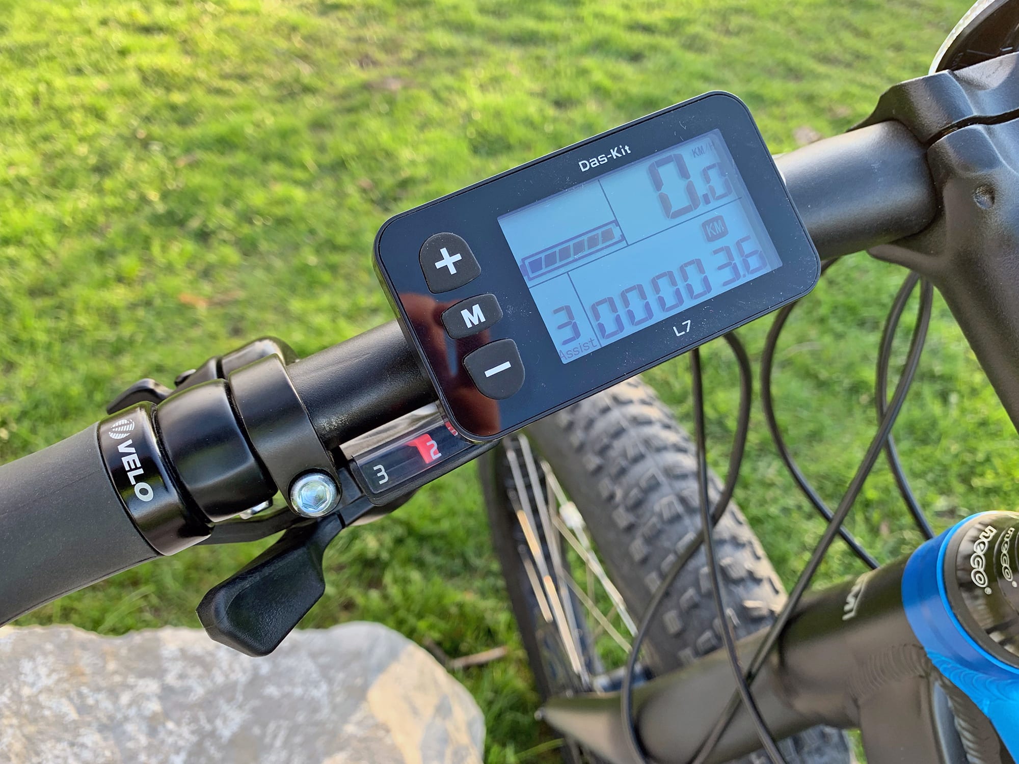

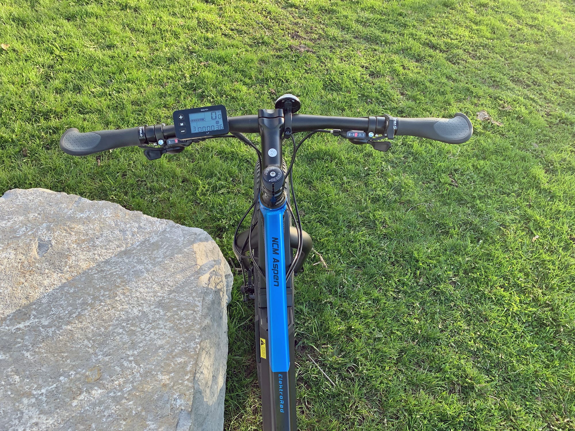

Operating this bike is simple and straight forward. There’s a control panel that’s made by Das-Kit (the same company that makes the motor) called the L7. It’s an all-in-one LCD display with three rubberized buttons near the left. To activate the bike, once the battery has been charged and mounted to the frame, just hold the M button in the center. I think this button stands for “mode” and doubles as a screen readout selector once the display is on. The default readouts include battery level, current speed, and assist level (0-6). I really appreciate how the battery infographic has six bars instead of just four or five, this gives you more precise feedback about capacity so you can plan trips accordingly. Many times, ebikes just have four or five levels of assist, but here again there are six. The really cool thing about changing assist levels (by pressing the + or – buttons) is that the levels loop from six back down to zero and also the reverse. This saves you time and finger fatigue. Unfortunately, the display panel is not easily removable, and may take scratches and sun fade over time. It cannot be swiveled easily to reduce glare (and if you leave the mounting bracket too loose, pressing the buttons will spin the display and be frustrating). I hear owners talk about covering their displays with their helmets, and some have used plastic sacks when it rains or snows, but you don’t want to trap water in with the display either because it can vaporize and get inside the electronics as the temperature heats up. I don’t mean to be alarmist, I’m just digging in deeper here since the review was in Canada where it snows in more locations, and where it rains in Tornoto specifically. Worst case scenario is that you order a replacement screen, mount it to the bar, and plug it into the quick-connect wire that was used for the original display. Other quick tips here include holding the + button for backlighting, and holding the – key for walk assist. This can be very useful for a heavier ebike when walking up a hill, through grass in a park where bikes shouldn’t be ridden, or if you get a flat tire and need to walk home.

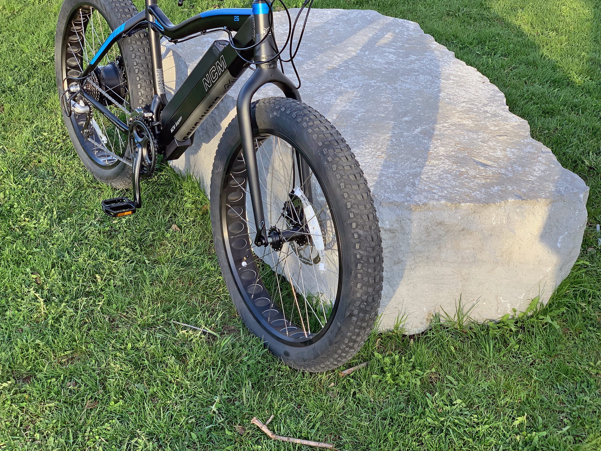

- I love the nice 26” x 4” fat tires rated for 5-30psi and these punched out rims to save weight

- Driven by a fat-tire specific 500 watt hub motor from Das-Kit, I found the motor to be really responsive with it’s 80nm of torque and it performed well on the ride test

- The display has a deep menu too so you could crank up the settings to make this a fast Class 3 ebike, or even remove the throttle to make it a Class 1 to comply with more jurisdictions

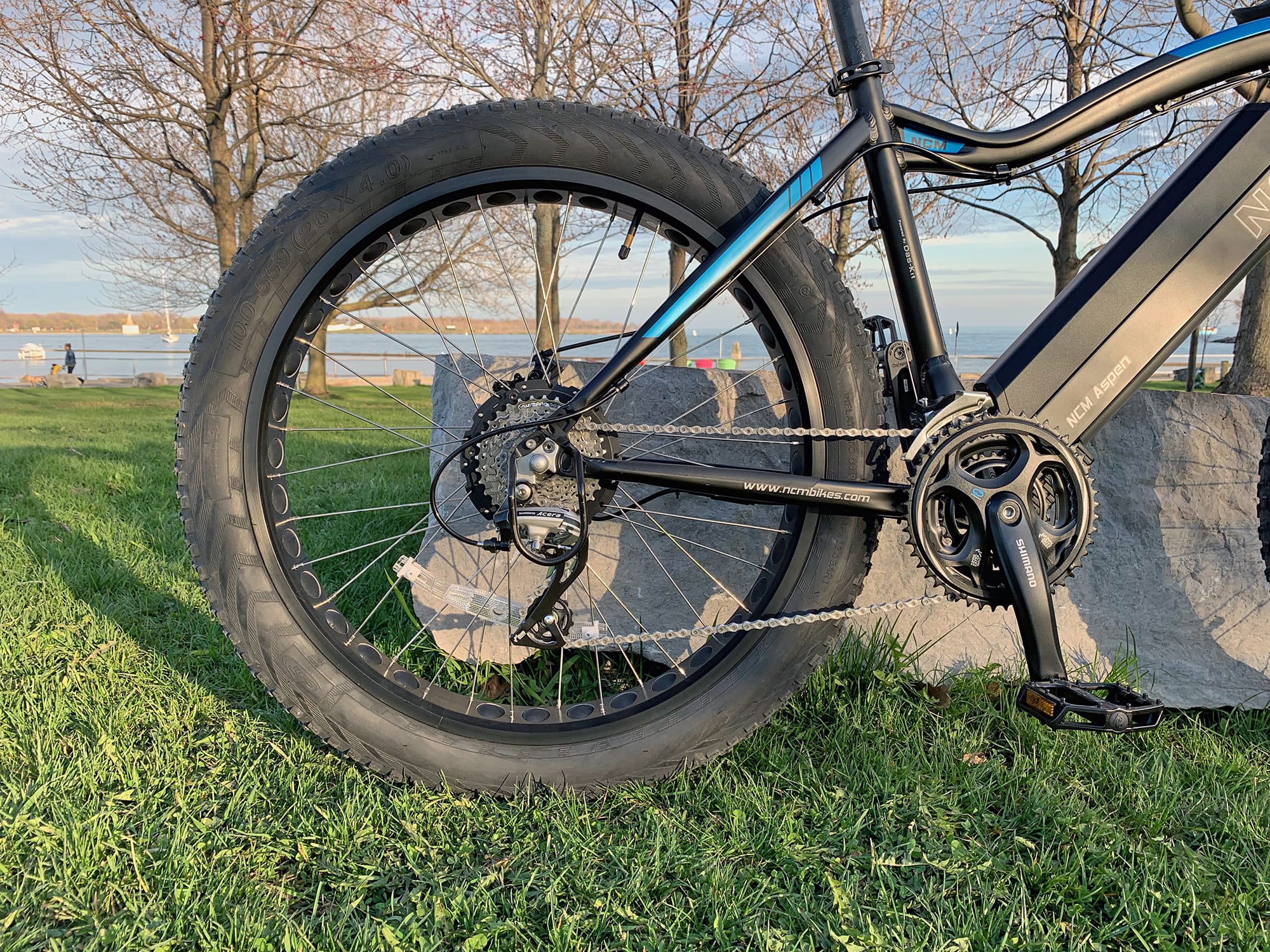

- 8 speed Shimano Acera system in the back with a 11-32 tooth cassette, in the front you have a 28, 38, and 48 tooth triple chain ring, this makes for a large configuration of 24 gears altogether, combined with the electric system, it feels like this can tackle just about anything
- You get a high capacity 48v 13ah battery with a USB port for charging, LED charge level readout light, and the battery can even be upgraded to a higher capacity

1 year agoWhat’s the procedure on the display to change it to a fast class 3 e-bike.
ReplyCourt
1 year agoGreat question, Bill. I’m not 100% sure, but often times you can either hold + and – for a bit… or hold the M button for a bit, or hold + and M for a bit to enter into the settings, from there, you may be able to adjust the top speed or change the wheel size to get a slightly faster speed while sacrificing the accuracy of the speedometer readout. If those combinations of buttons don’t work, try turning the bike off and then on, and do the button presses within a couple of seconds of the bike restarting. Sometimes, you can dig into deeper menus by doing the same button combos from the first settings menu! So, it’s like a second level of settings ;)
