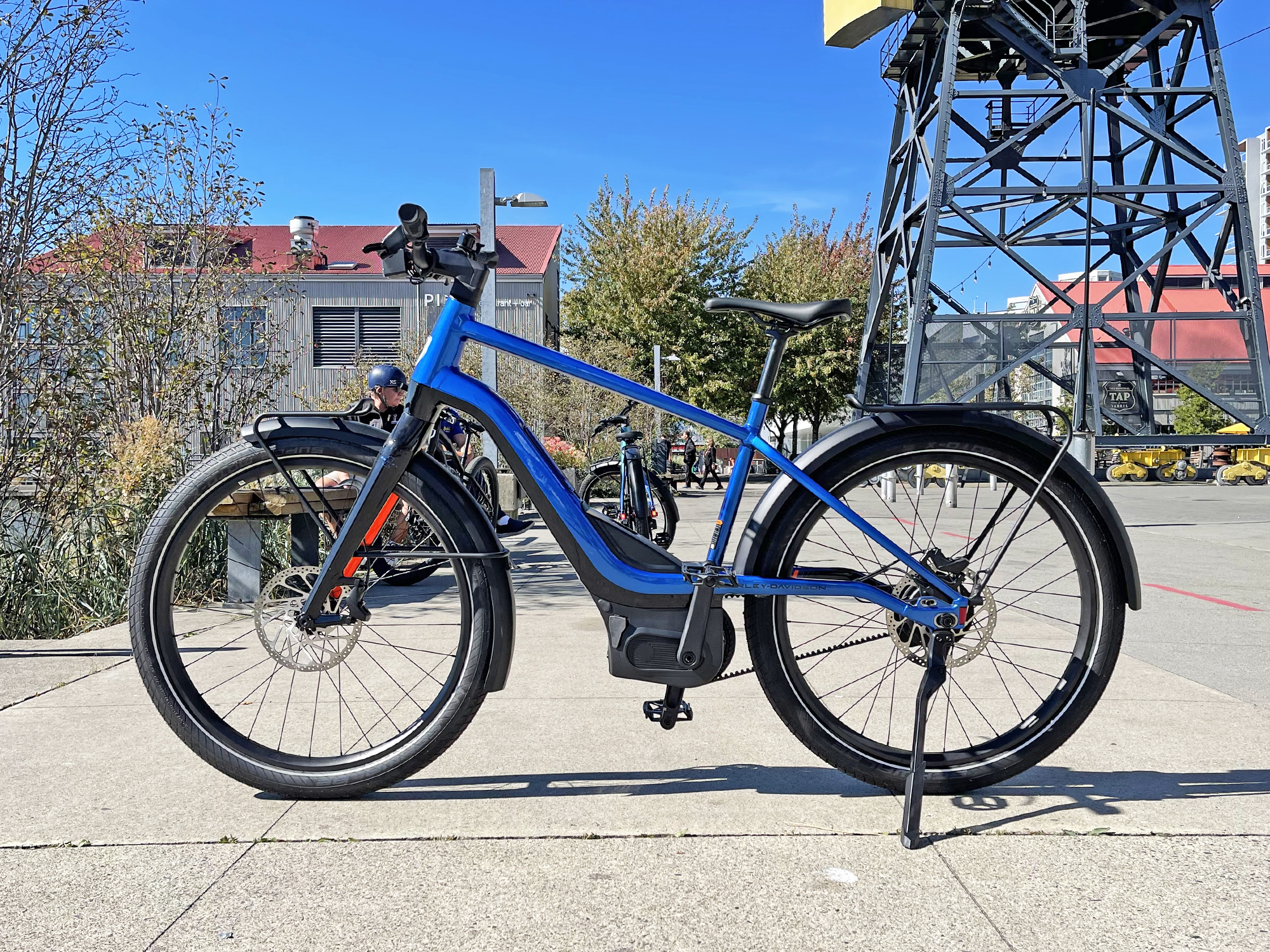

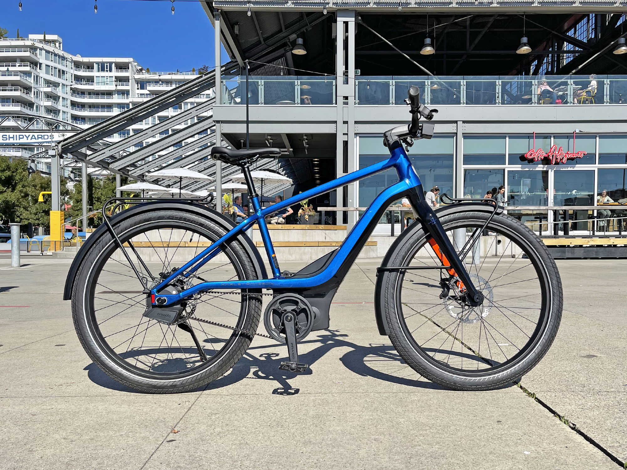

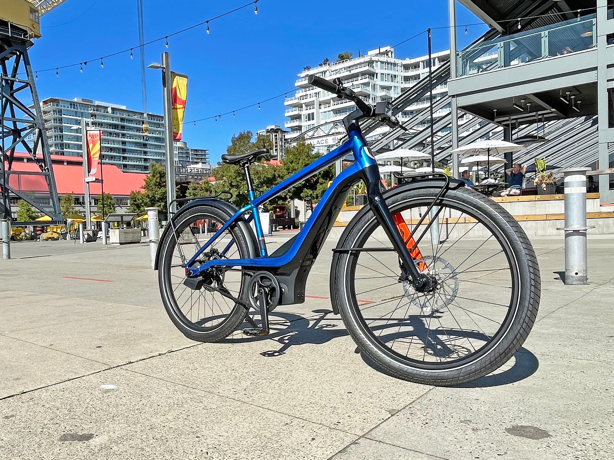

- The bike looks amazing, very professional and refined. Notice the premium paint and two color choices, the black highlights that make the frame look thinner, the hidden wires that route through the handlebar, stem, and body.

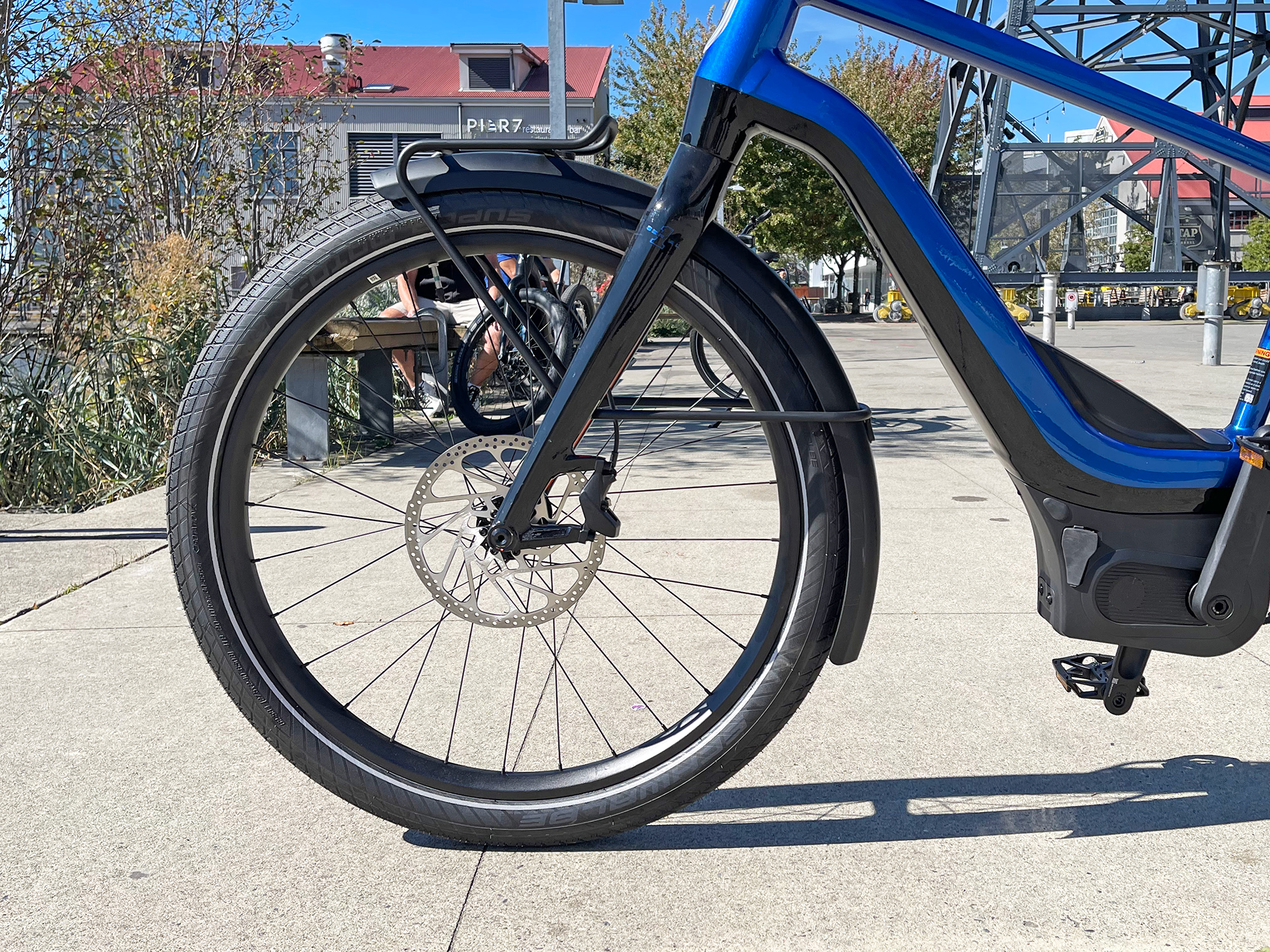

- It comes with everything you need for riding in all sorts of conditions. The plastic fenders are sturdy, relatively quiet, and wide and long enough to provide good coverage. The lights are bright, visible from multiple angles, and run off the main battery pack. The tires are puncture resistant and have reflective sidewall stripes!

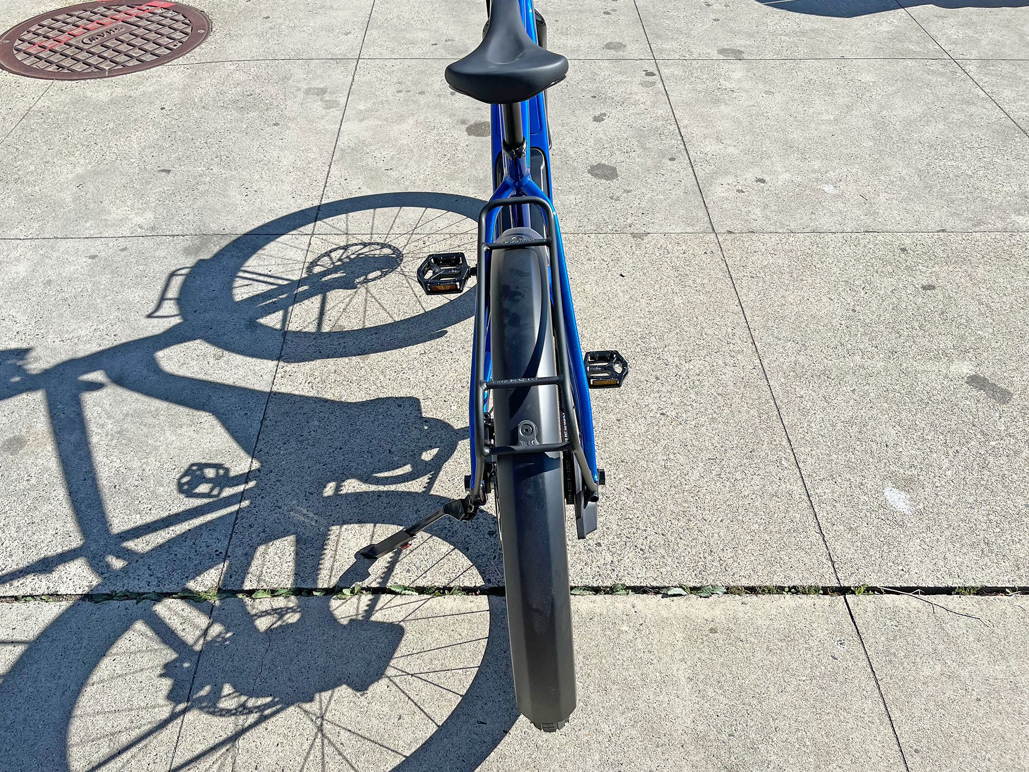

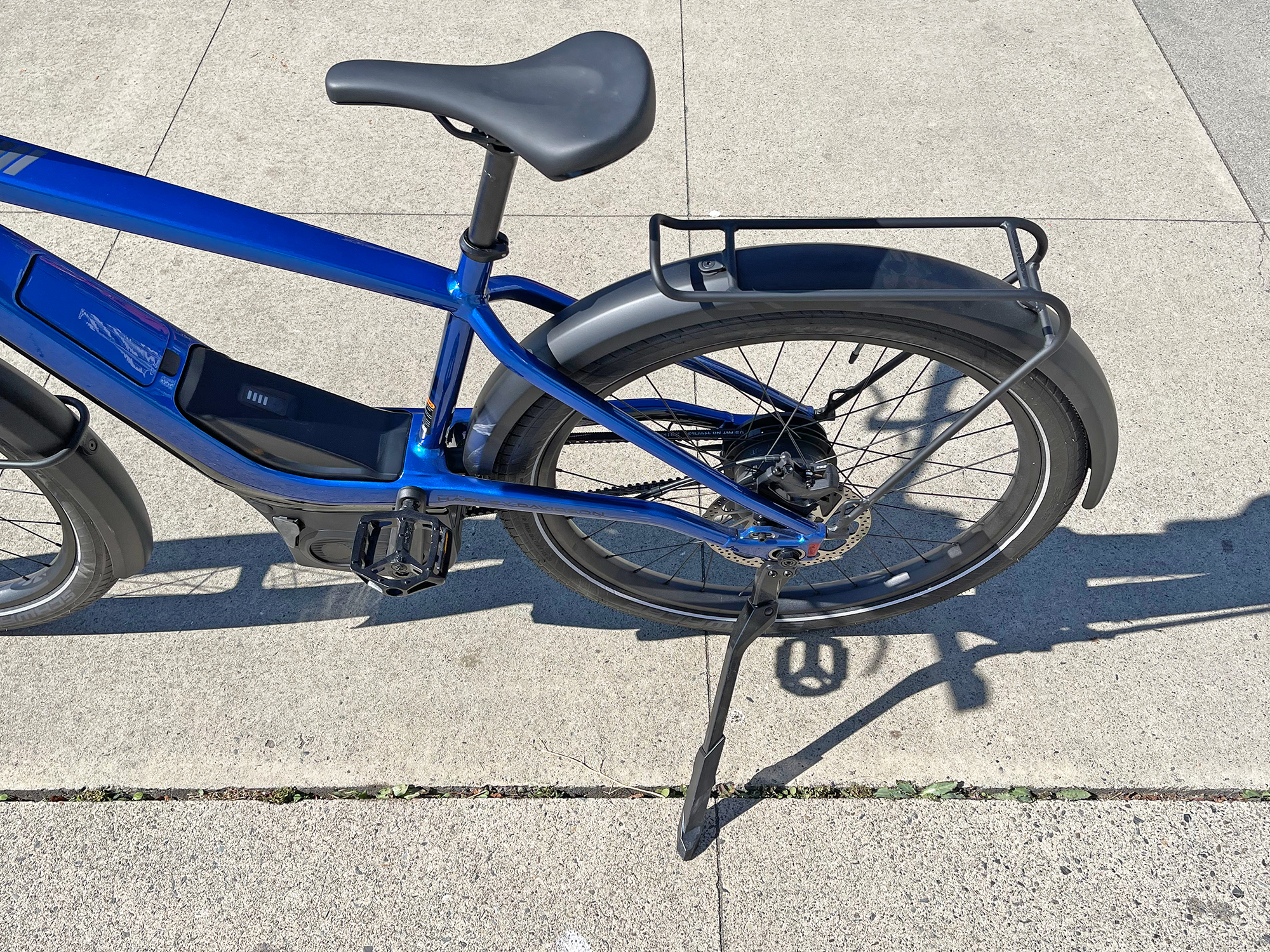

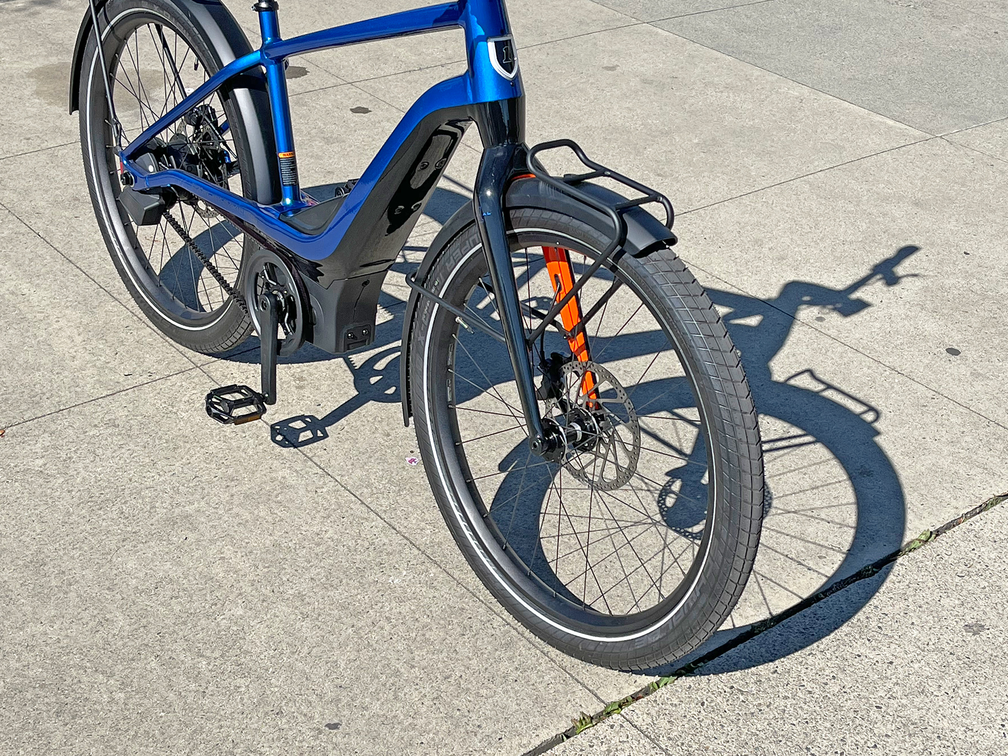

- Many ebikes come with a rear rack, but this one also has a front rack! I think they would work well for trunk bags and panniers, but the rear rack also has a bungee loop for a simple tie down. Note that overloading the front rack could impact steering because it’s fork mounted vs. steer tube mounted.
- The weight isn’t too bad at roughly 26.7kg 59lbs considering it includes so many accessories, is using a CVT hub, and has Boost hub spacing with plus sized tires. The weight is positioned lower and more centrally than a lot of the other ebikes I’ve tested. It’s sturdy, stable, and compliant… especially with the high step “diamond” frame.
- It’s easy to miss if you don’t know bicycle brands and parts, but the Praxis crank arms, Sapim spokes, locking ergonomic grips, tool-free adjustable kickstand, Wellgo platform pedals, and sealed saddle with integrated handle, are all upgrades that improve durability and ride quality.

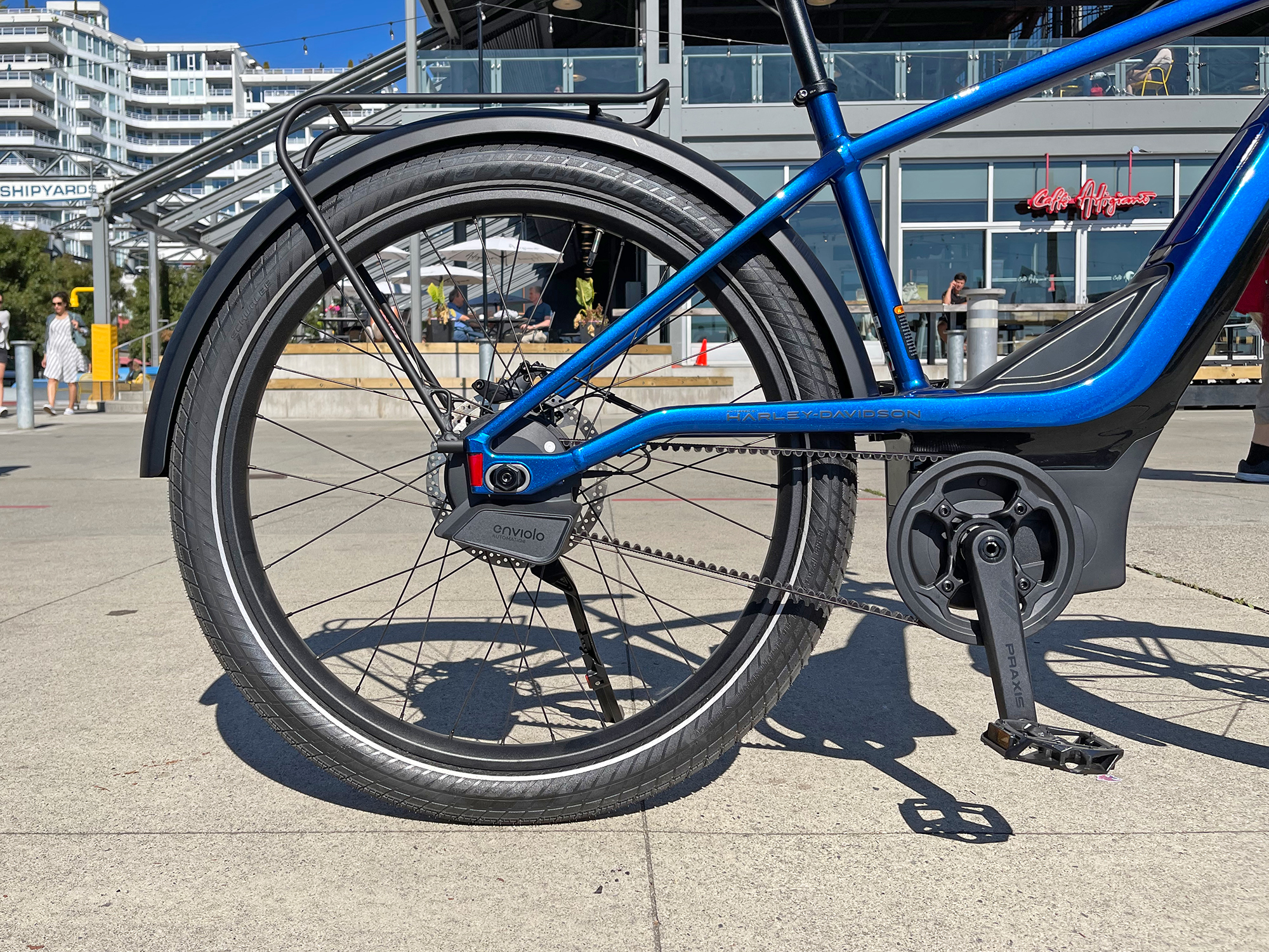

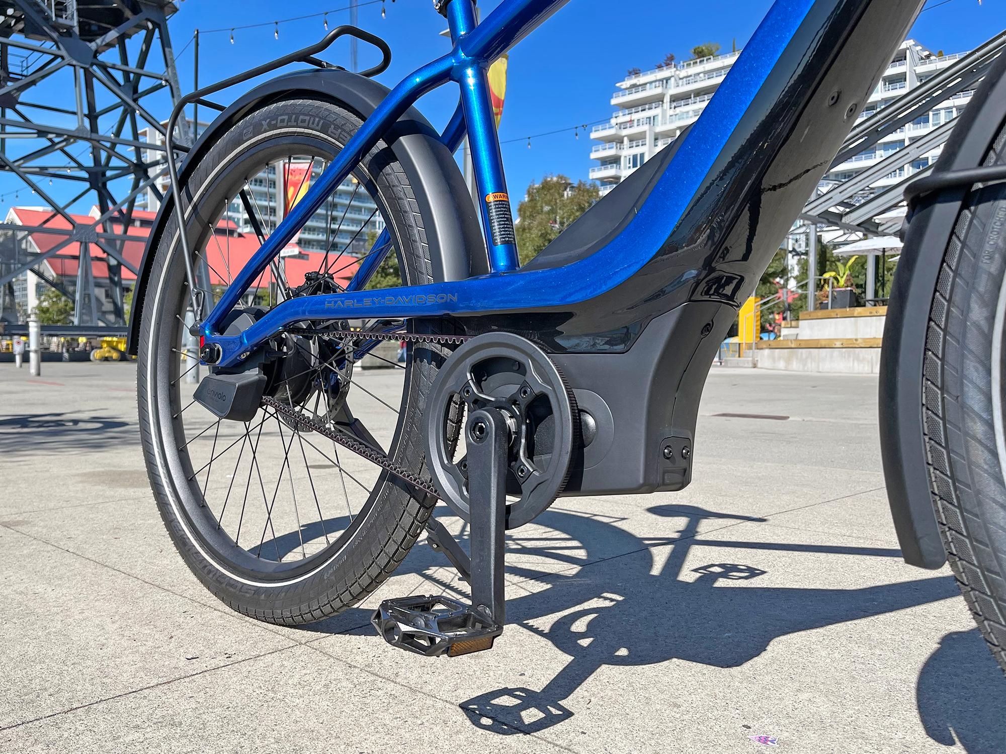

- The Gates Carbon Drive belt is quieter, cleaner, and more durable than a traditional chain. The way it’s configured, the frame tubing and right chainstay act as a chain cover, protecting pant legs or dress ends from touching and snagging. Serial 1 was smart about their frame design, they configured it with a belt drive in mind so there’s no break in the frame to get it on, instead the rear dropouts hang lower than the seat stay. This improves strength and frame stiffness.

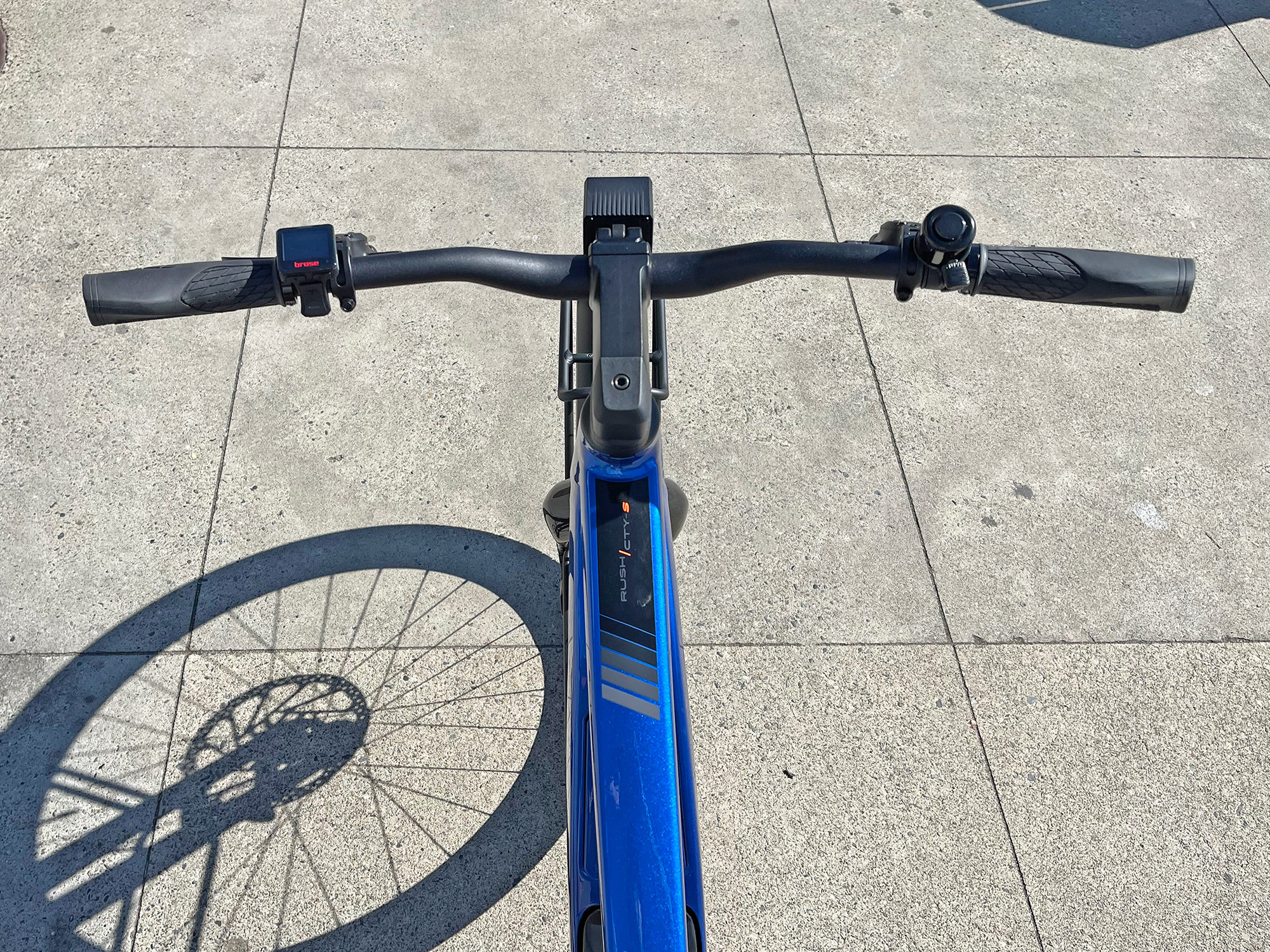

- Wires and cables are almost completely hidden, being routed through the handlebar, stem, and main body of the frame. This looks beautiful, but also reduces snags. Note the headset has oversteer protection, so you can’t twist it all the way around and strain or break the cables inside! This is an awesome little touch that would be easy to miss.

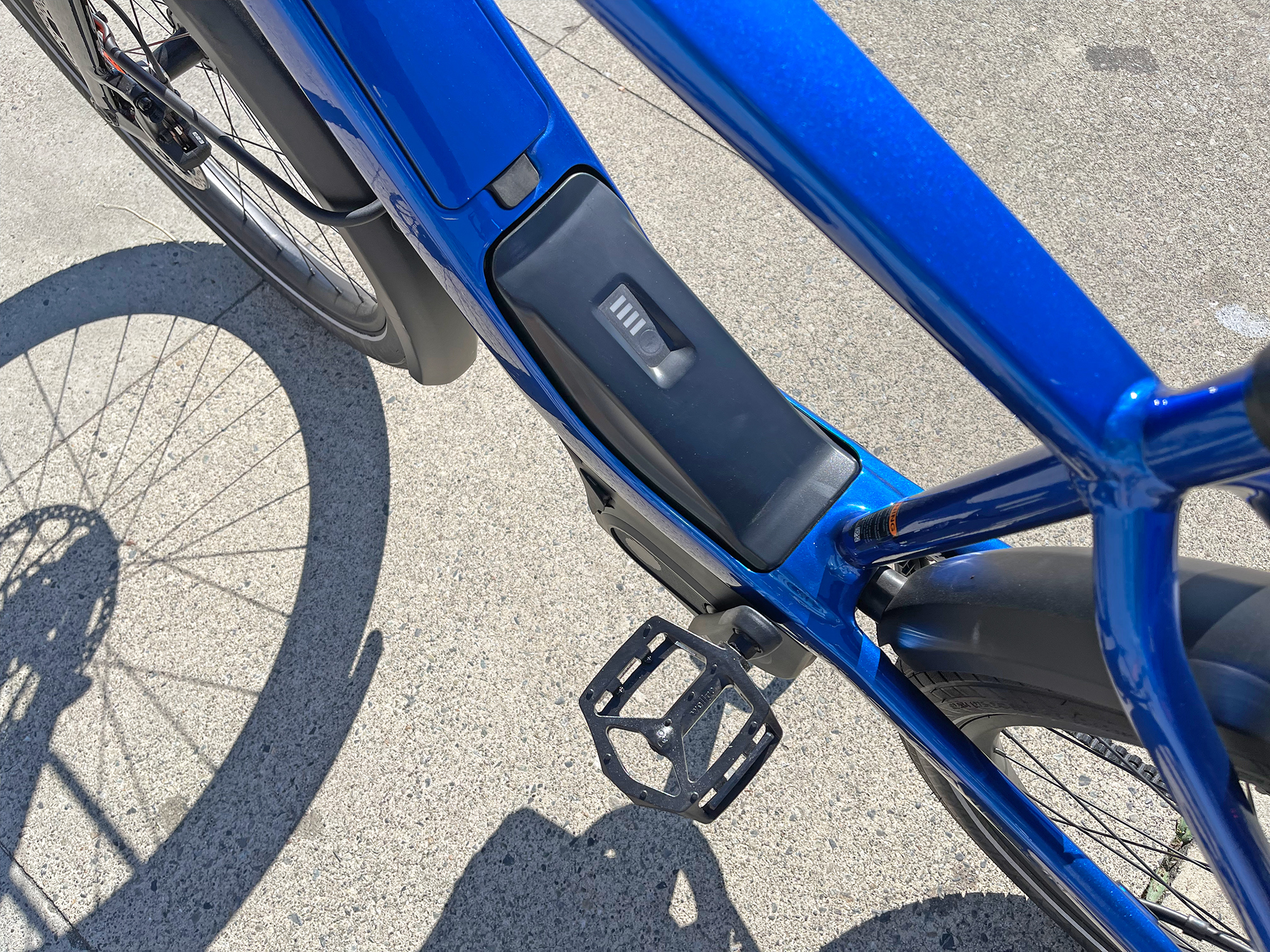

- Serial 1 was creative with the frame design, adding a little “Glovebox” compartment above the battery bay. It’s fairly large, and locks securely with the same key as the battery. This would be a great place to stow a lightweight jacket, tool set, folding lock, and anything else you’d like to bring along for utility or safety!

- The upgraded TRP brakes are perfect for this model! You get larger and thicker 203mm x 2.3mm rotors with longer quad piston calipers that provide leverage and cooling benefits. The adjustable reach levers will fit a wider range of hands, which pairs nicely with the four frame sizes.

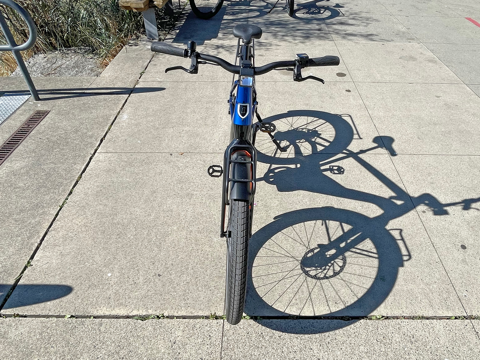

- The headlight is excellent! It’s large and bright, putting out 900 lumens, and the housing is sturdy aluminum alloy. I love that the mounted it high and center on the stem/handlebar area, but seems to have a top cutoff so it won’t shine up into the eyes of oncoming cyclists and automobiles. The light isn’t blocked by the fender or rack (or a small trunk bag if you mounted on there), and points where you steer.
- In addition to the headlight, there’s also a “running light” head tube badge which increases your visual footprint. This badge is more visible from the sides than the headlight itself, which does not have side cutouts like some other lights I’ve seen.

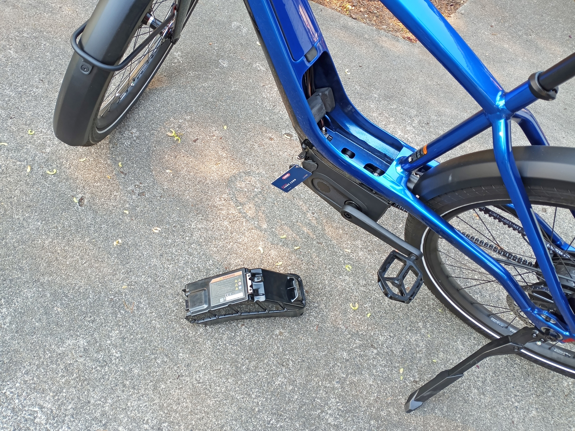

- The battery pack design is modular, so you could always borrow a 529 watt hour pack from a friend or family member who has one of the other models… or loan them your high capacity 706wh pack! I was told that Serial 1 is using the fanciest cells available, they are 21700 size high density (which means lighter without taking as much space).

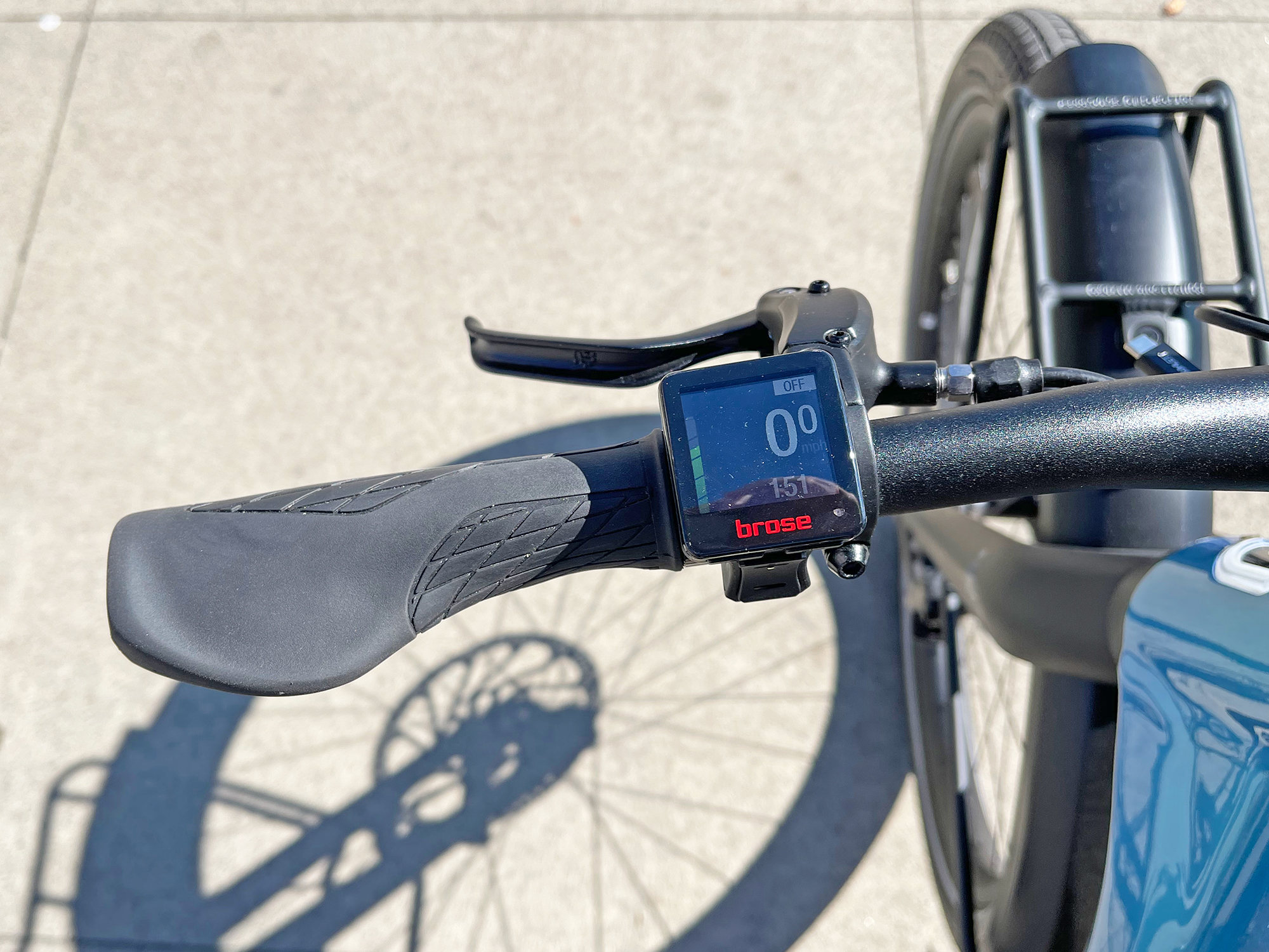

- I am glad that Serial 1 chose a fancier display for this model than the MOSH/CTY, because it’s easier to read and provides a lot more feedback. There are dedicated buttons for the lights, it has walk mode, and the transflective LCD is easier to read in bright conditions than the tiny LEDs on the other model. It’s easy to reach, and the buttons are intuitive once you explore it a bit, so you can press to change assist levels without looking down.

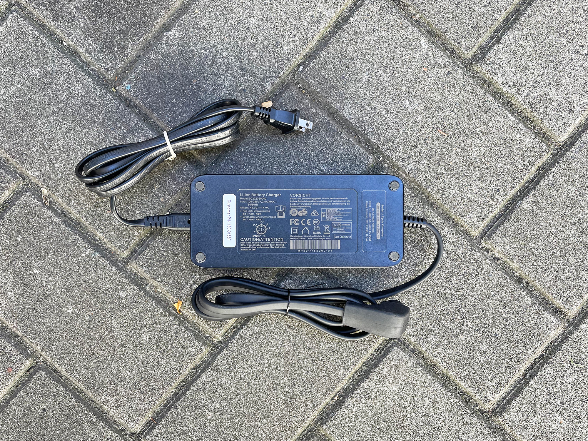

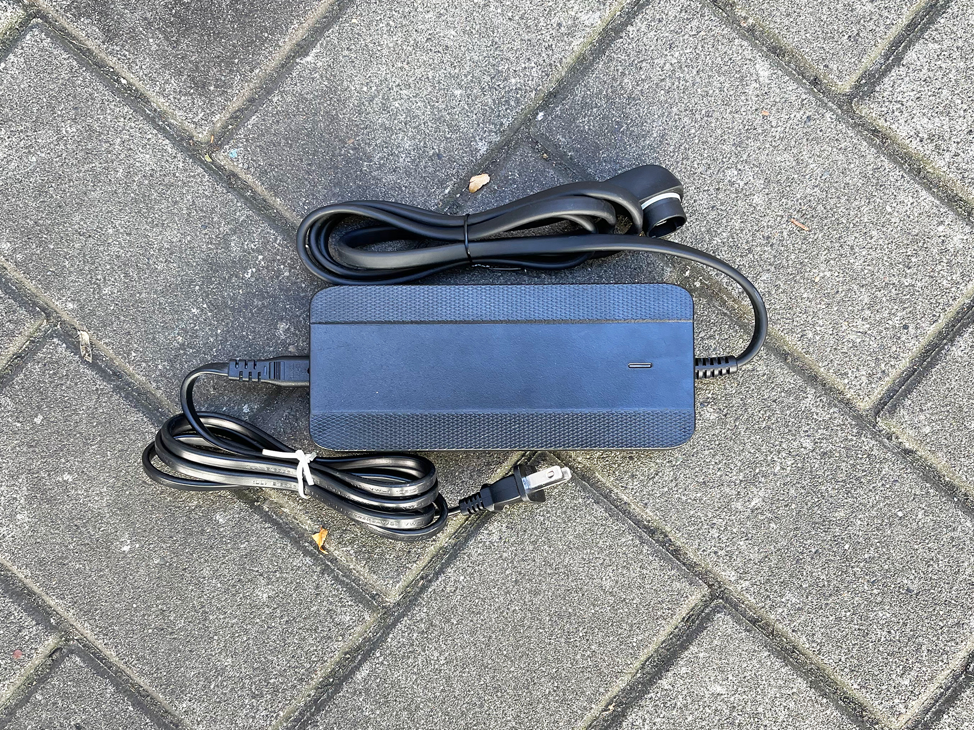

- The battery charger is great, offering higher speed 4 amp output, and the right angle plug won’t get snagged by the left crank arm when it’s plugged in. It’s also fairly compact and light, it seems very solid for the performance level.

- To me, the frame looks a bit chunky at the bottom bracket area. Serial 1 designed a modular battery pack that sits lower on the frame, and I think this contributes to the aesthetic. In short, this line of ebikes isn’t as stealthy as some of the competing products I see… but the upside is that more weight is positioned low. This is especially true for the higher capacity 706 watt hour pack that comes stock with the RUSH/CTY Speed model.

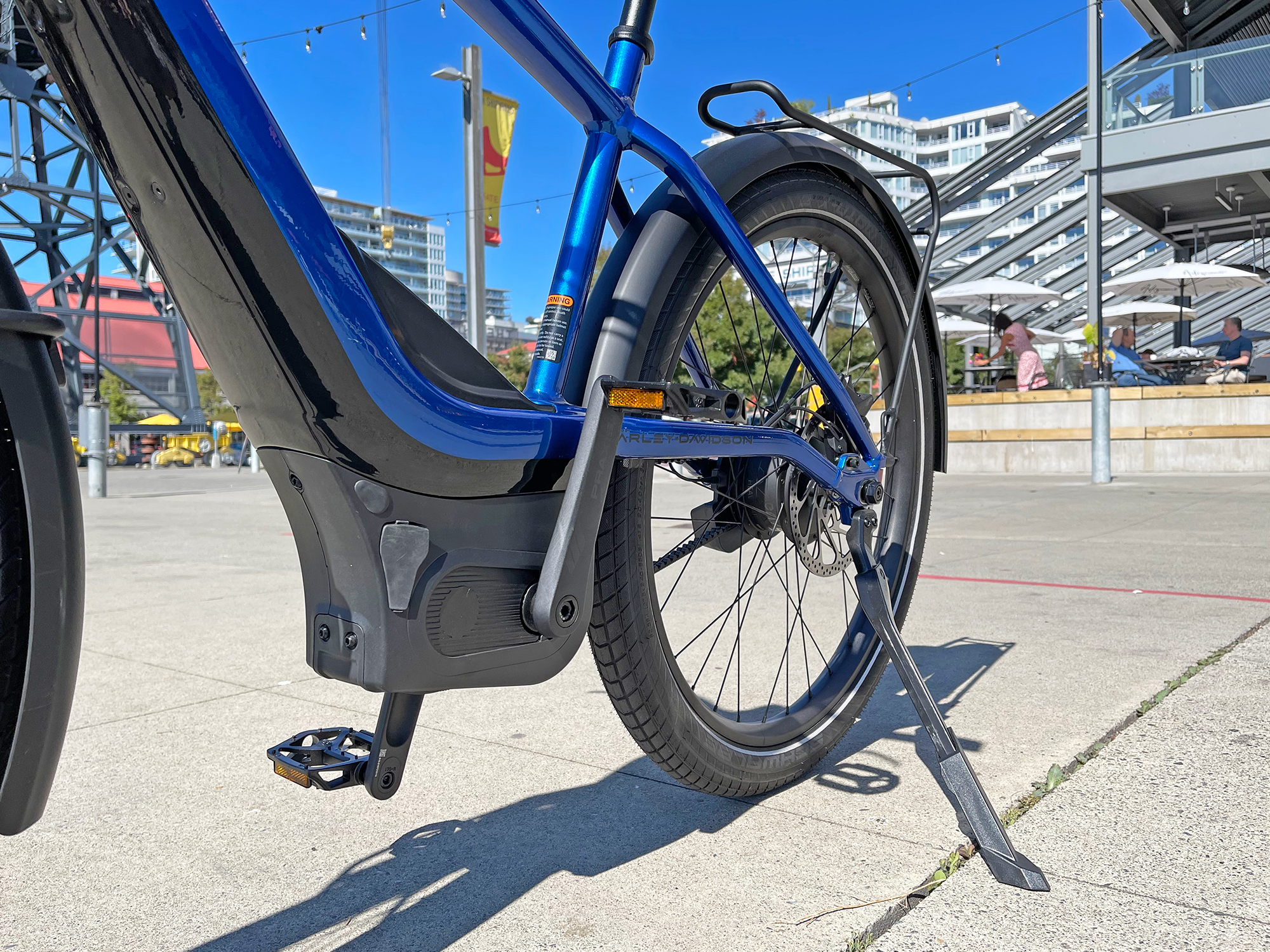

- Both the charging port and locking cylinder to release the battery are located low on the left side of the downtube, very close to the left crank arm. In my experience, they require more energy and flexibility to bend down and reach… and it’s easy to bump your head on the left handlebar when getting back up. I noticed the rubberized cover for the charge port can be a little tricky to line up and set.

- The Enviolo Automatiq is preconfigured to offer a 75 RPM target cadence, which I find a bit slow. In order to change this, you have to download the Enviolo app vs. having a physical shifter like most traditional bicycles. This is in addition to the Serial 1 smartphone app for mapping and ride stats. The app allows you to adjust 30 to 100 RPM target cadence, or select virtual “gears” instead.
- The LCD display panel that comes with the bike is called the Brose Allround. It shows battery charge level, but isn’t super precise (5 bars vs. percentage), and doesn’t have a range estimate tool built in. I appreciate that it’s color and transflective, making it easier to read in bright conditions, but it is fairly small and could be difficult to read for some riders. Use the Serial 1 smartphone app for precise battery percentage readout.
- The rear lights are positioned very low on the frame, which could make them harder for cars to see. I have a helmet with a built in light and often attach another light on my backpack to be extra safe. At least the rear lights both have two LEDs, are visible from the sides, and go bright when the accelerometers detect that you’re stopping!
- Although this model comes with two integrated racks, they both have relatively low 10kg 22lb weight ratings. The rear rack also specifies that it is not designed to support child carriers. While these racks look clean and help to support the fenders, I feel like some utility is being lost compared to other products I’ve tested.
