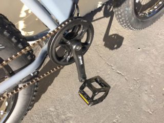

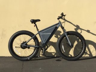

I sold the original Sondors ebike to the store owner Sam after reviewing it last year and he still had it on the showroom floor so I was able to compare it closely with this new V2 model and this is what I found: they weigh about the same (without the suspension fork and upgraded battery) at ~60 lbs even though the new version has a stiffer Aluminum frame, they both have an always-on pedal assist that feels about the same, the tires are slightly smaller with 4″ diameter on the new one vs. 4.9″ on the original, the battery now contains premium Panasonic cells vs. generic and there are new color options to choose from. Mostly… it’s the same bike, and that’s okay. For riders who are tall enough to straddle the high-step frame with a 30″ stand over and those who appreciate the “go anywhere” beefy tires it’s pretty cool. I felt a bit limited when pedaling from rest because there’s only one gear the sprocket is smaller with 40 teeth vs. 44 so it’s easier than the original. Having only one speed means there is reduced need for maintenance and tuneups and since pedal assist kicks in quickly (if the bike is turned on) it’s not so bad. Unlike most other bikes I test, you can’t adjust assist or discern how fast you’re traveling because there’s no fancy LCD display included, what you get is a basic LED console with three LED’s roughly communicating your battery voltage (remaining energy). The trigger throttle works great and can be used from standstill which I appreciate. The throttle delivers much more power than pedal assist and allows you to hit ~20 mph top speed.

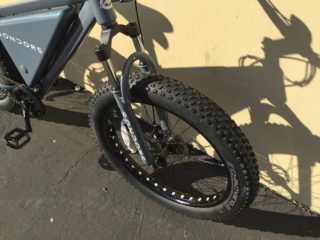

The Sondors fat bike is beautiful product to me because it balances design with price and makes a lot of good decisions around which compromises to make. It’s not a bike for everyone but it has sure generated a lot of attention for electric bicycles in general and I love that. This campaign was run very well in my mind and I felt like it was a lot less confusing and controversial than the first. Now that Sondors also has a Thin model in the works there’s even more reason to be excited as a lighter weight city-oriented rider like myself (I’m just not as interested in the large tires and heavier frame found on the fat models). My friend Sam from the shop test rode the Sondors V2 fat bike and said he felt really comfortable on it because he’s a larger guy. The suspension fork seemed wasted on me because it really didn’t activate as smoothly or frequently as hoped but then again I only weigh ~135 pounds so for Sam and people like him I bet it would offer a much better experience. The tires can be inflated to 20 PSI for the best efficiency or lowered to 10 to 15 PSI for improved comfort and traction on soft terrain. The biggest win with this ebike in my mind is the upgraded battery pack option which should offer at least 15 miles with throttle-only and upwards of 25 to 30 with assist depending on terrain, tire pressure and load.

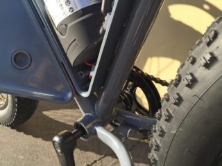

- The unique plastic frame box protects and conceals the battery, controller and wires… it looks pretty good, is color matched with the frame and has removable rubber nipples so you can charge the pack on or off the bike

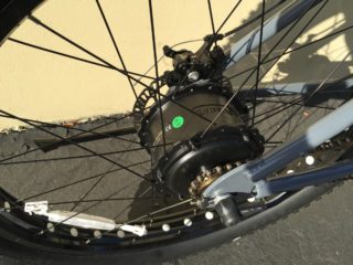

- Pedal assist will help extend your range and offers a good workout, the eight magnet sensor is better than average and responded fairly quickly to my starts and stops pedaling

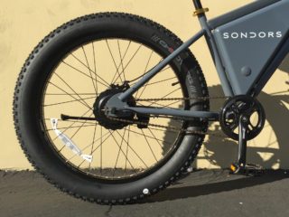

- Because this is a single speed ebike, the chain shouldn’t fall off easily and you won’t need to get tuneups as frequently, it’s just tougher
- The battery can be charged on or off the bike, there are rubber nipples on both sides of the battery box to switch it on or plug it in, taking the battery out can be a little tight and mine got scraped up doing so, the charger is relatively compact and light weight so you could bring it along to top-off on longer rides

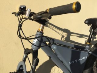

- The suspension fork is pretty basic, there don’t seem to be any rebound, stiffness or lockout adjustments so the performance may vary depending on rider weight and cargo

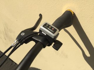

- There’s no way to adjust pedal assist level and it defaults to “always on” unless you purchase a compatible LCD display unit separately, I believe Lunacycle sells them here

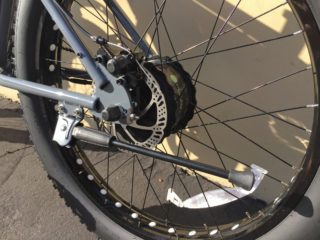

- There’s no bottle cage mounting point on the frame but the seat stays have threaded bosses where you could add a rack, neither wheel is quick release so you need tools for transporting and doing service
- The disc brakes are sort of average, they require more time and effort to fully stop the bike vs. larger 180 mm rotors or hydraulic but should be easier and cheaper to repair

- Limited use on soft terrain like sand and snow because the motor isn’t especially powerful and there’s only one gear to pedal with… consider adding a schlumpf or efneo bottom bracket to add gears

Hi Taipan, I was under the impression that the EU version has the 250 watt motor and lower top speed to meet European regulation but have never actually seen one in person… so it’s difficult to say. What I can say is that the US version has a 350 watt hub motor and is capable of 20 mph top speed :)
