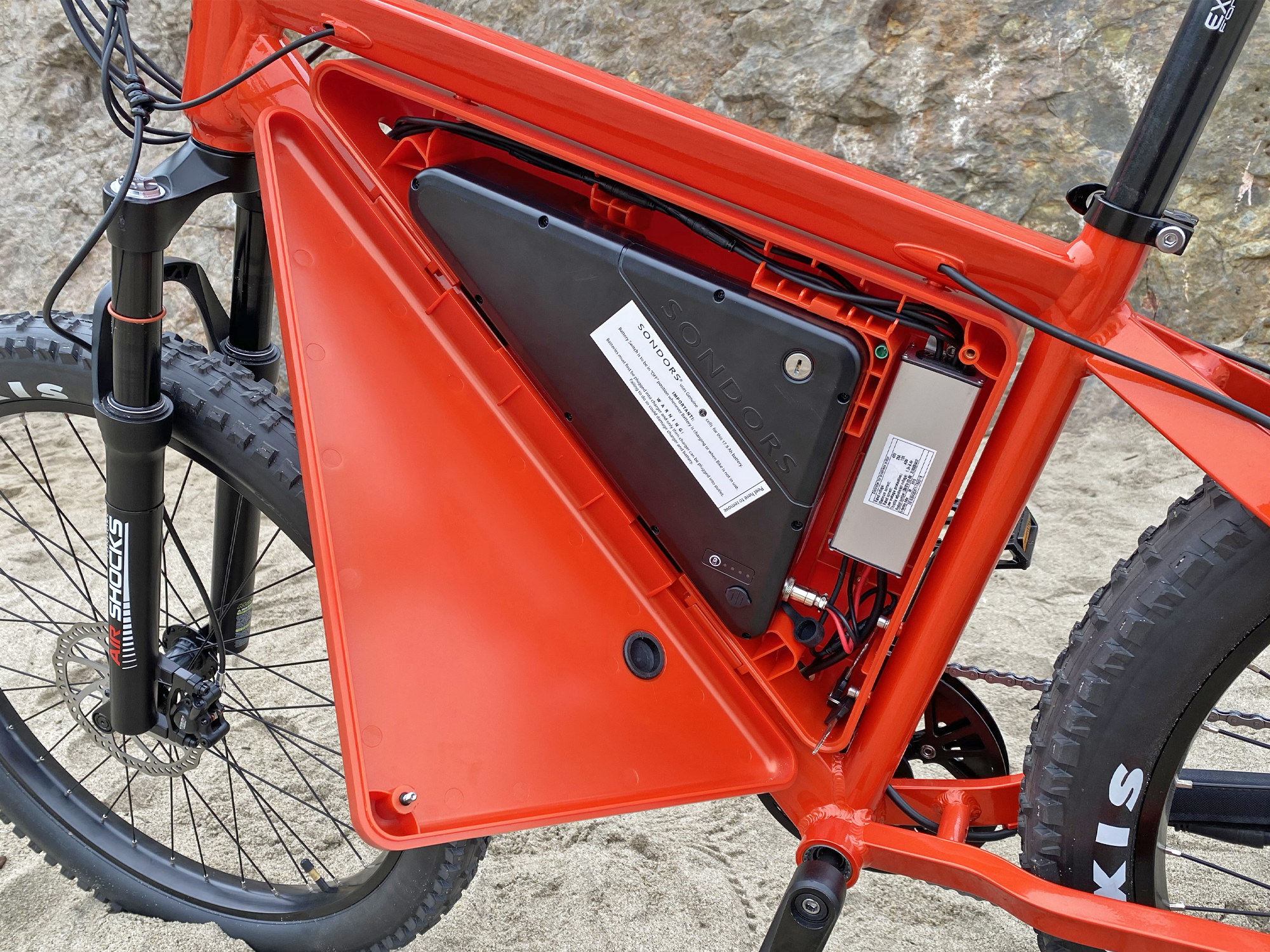

- Bright, eye-catching colors of Torch and Ghost Torch (white) and the iconic SONDORS battery compartment make the MXS stand out in a big way, well managed and internally routed cabling keeps it looking sleek as well

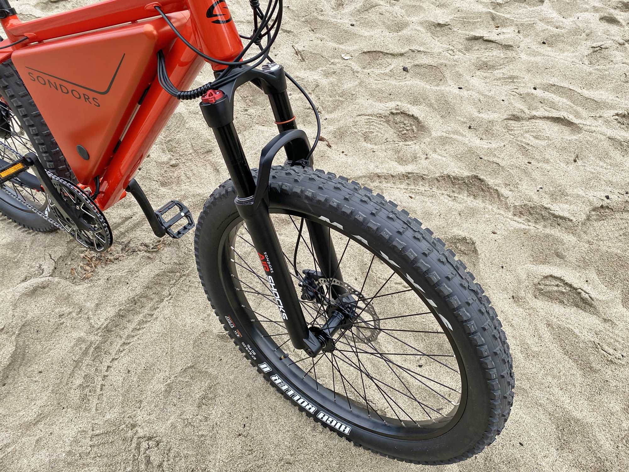

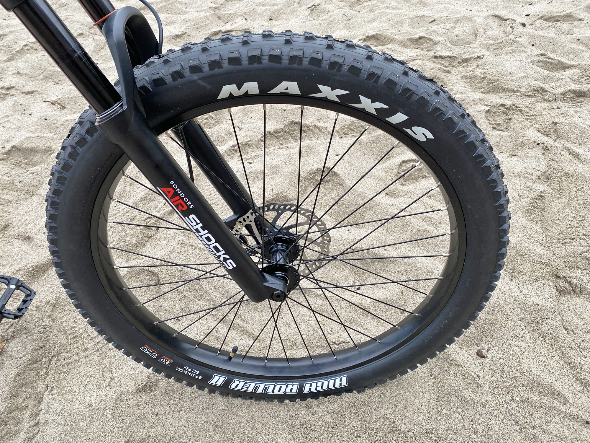

- The Maxxis tires are excellent all-purpose mountain bike tires with EXO puncture protection, they are tubeless-ready and plus-sized at 27.5×3.0 which increases comfort and stability
- Stronger-than-average spokes with 12 gauge up front and 11 gauge in the rear, the MXS also has boost hub spacing which further increases strength and durability

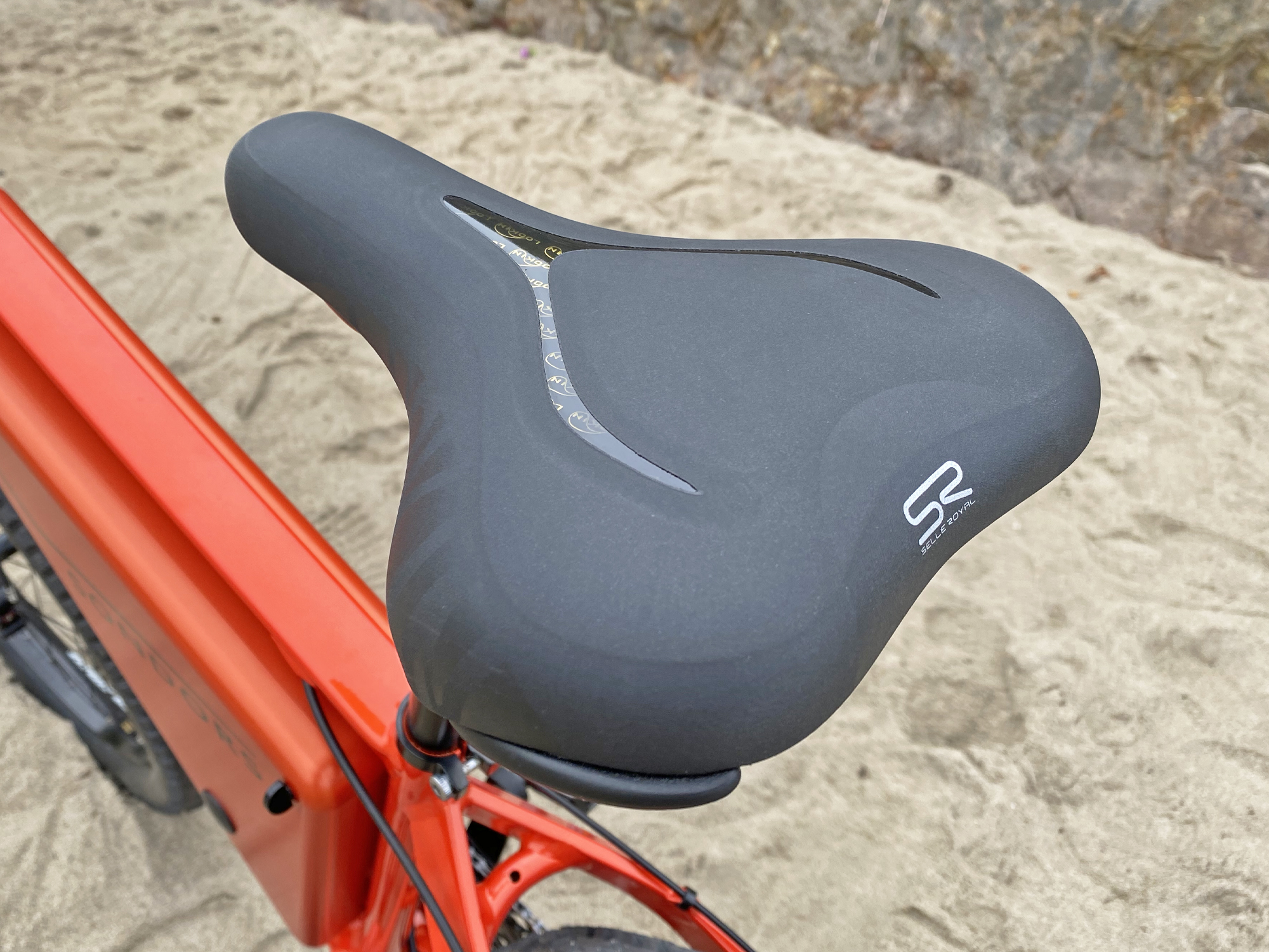

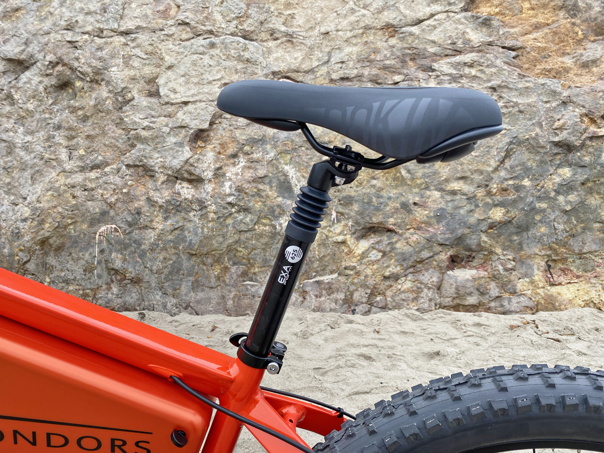

- Fairly comfortable for a hardtail thanks to the addition of a suspension seatpost with 30mm of travel, which isn’t a lot but every little bit helps! Up front is the MOZO air suspension fork with 130mm of travel, large 34mm stanchions, as well as a manual air adjustment valve a clicker for rebound adjustments

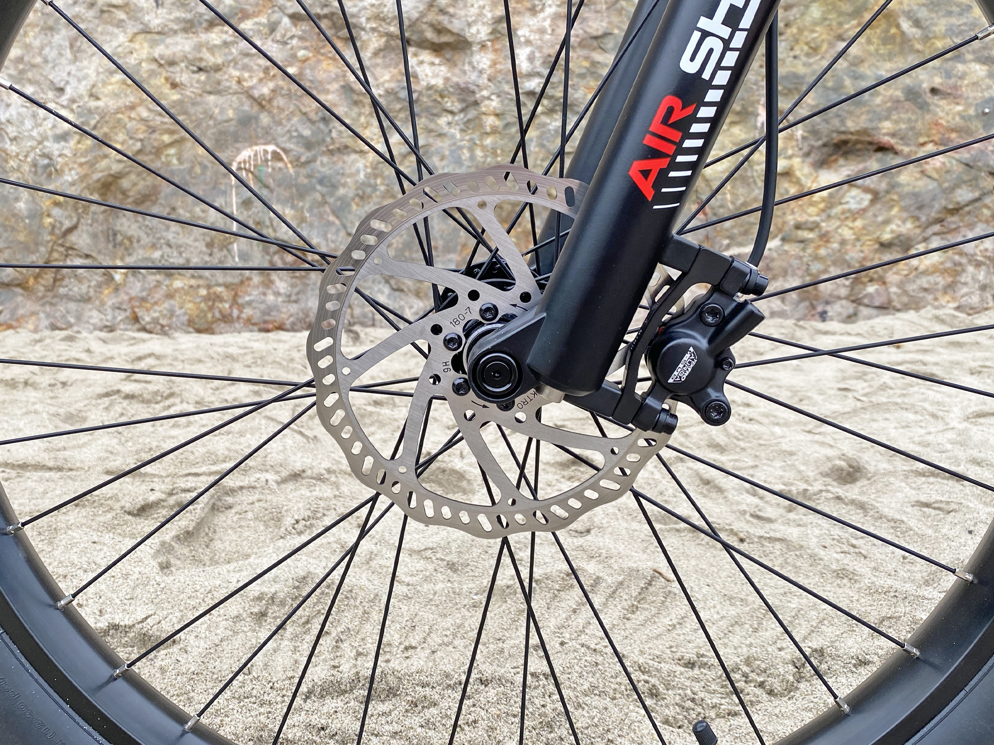

- Excellent stopping power from the Ebike-specific Tektro Auriga E-Sub brakes, these are hydraulic disc brakes with large four-finger levers which makes them incredibly easy to actuate even if you have low grip strength, for contrast most mountain bikes have two-finger levers (designed so that you can operate the brakes with two fingers while keeping most of your hand on the grip for stability). Large 180mm rotors in the front and rear provide good dissipation and these brakes have no problem stopping the hefty weight of the MXS

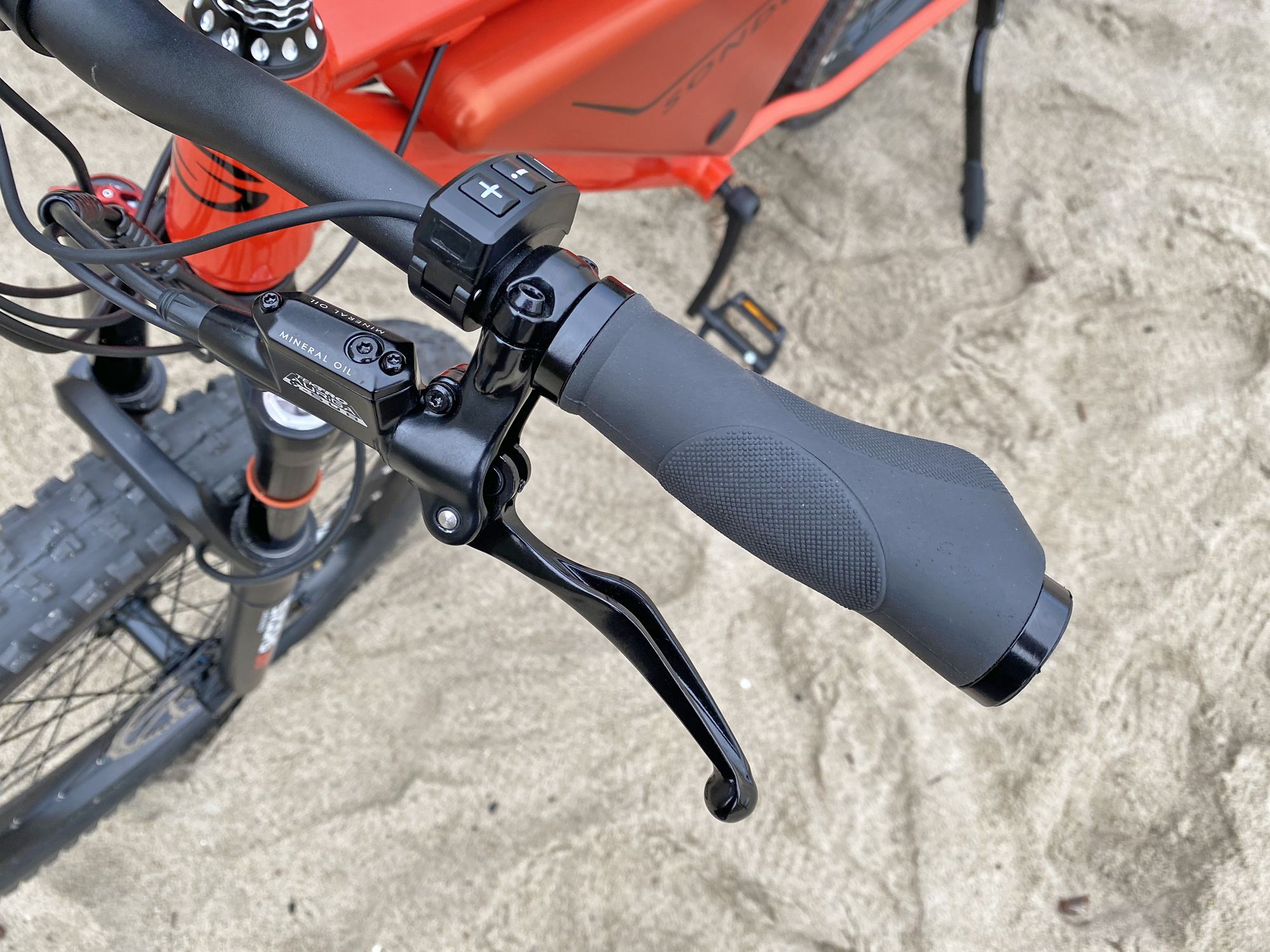

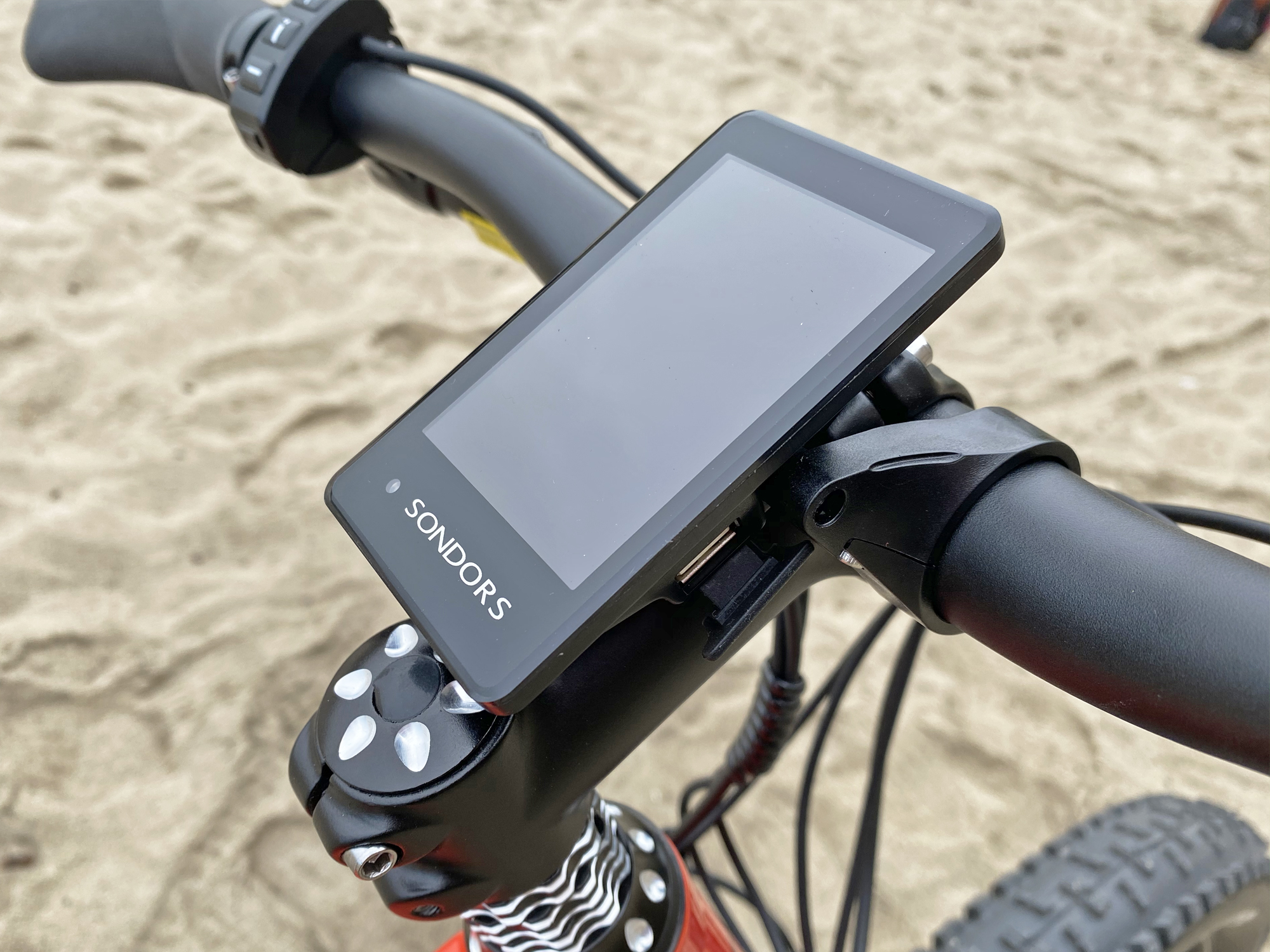

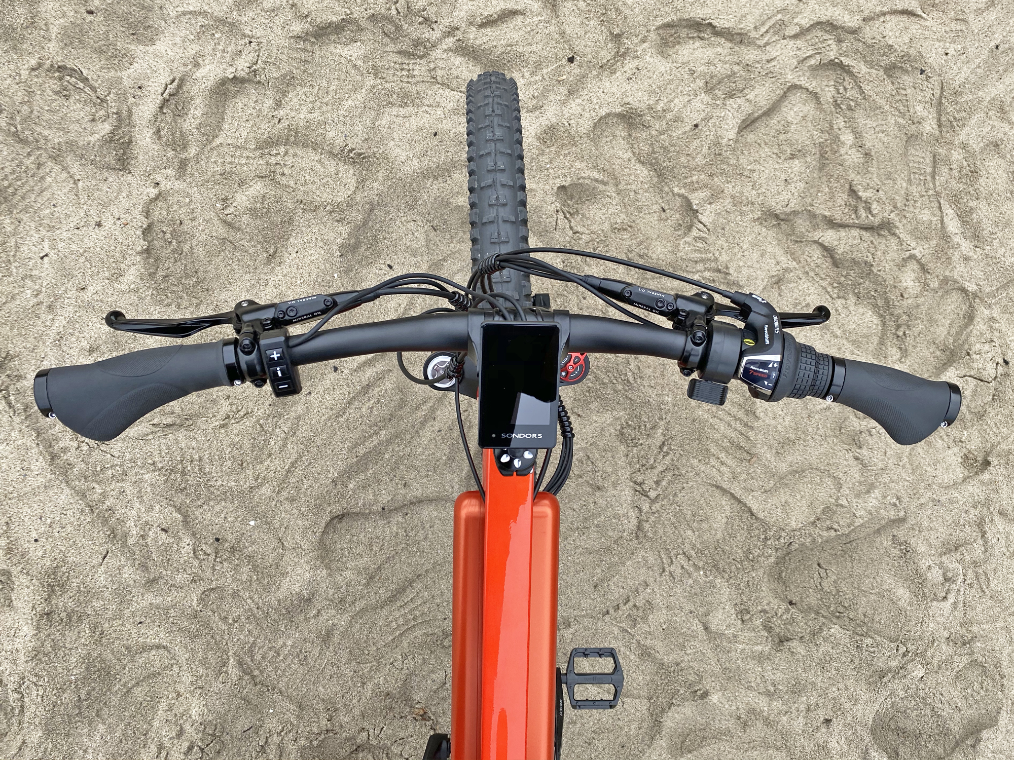

- The display features an appealing 3.5″ color LCD with numerous readouts, as well as a USB-A charging port on the right side that pushes a full amp of power, which means you can charge any smartphone with it (iPhones require a full amp vs. the 0.5 amps required by Android devices)
- The control system is incredibly configurable! You can adjust the number of pedal-assist levels as low as 1-3 or as high as 1-9, you can customize what percentage of motor assist you get for each of those levels, and you can even tweak the sensitivity for the battery capacity readout. Of course, you also have access to the more standard options (such as wheel size and backlighting levels)
- The battery is constructed of high-quality LG 3500 cells and has a massive capacity of 840 watt-hours, and should provide plenty of range even when using high levels of electric assist. Its triangle shape fits snugly into the iconic SONDORS frame compartment, and when removed from the bike you can use the carrying handle for easy transport

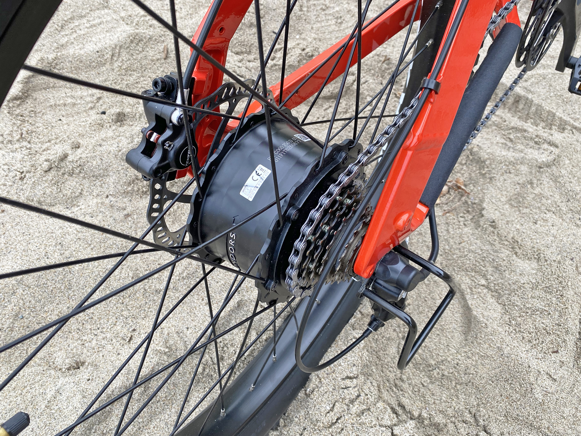

- The Bafang rear hub motor is satisfyingly powerful with 750 watts nominal and about 1000 watts peak, hub motors aren’t often seen on mountain bikes as they can sometimes struggle on grades at lower speeds, but this motor had no problem with some steep inclines as well as riding on sand (check out the video review to see it in action)

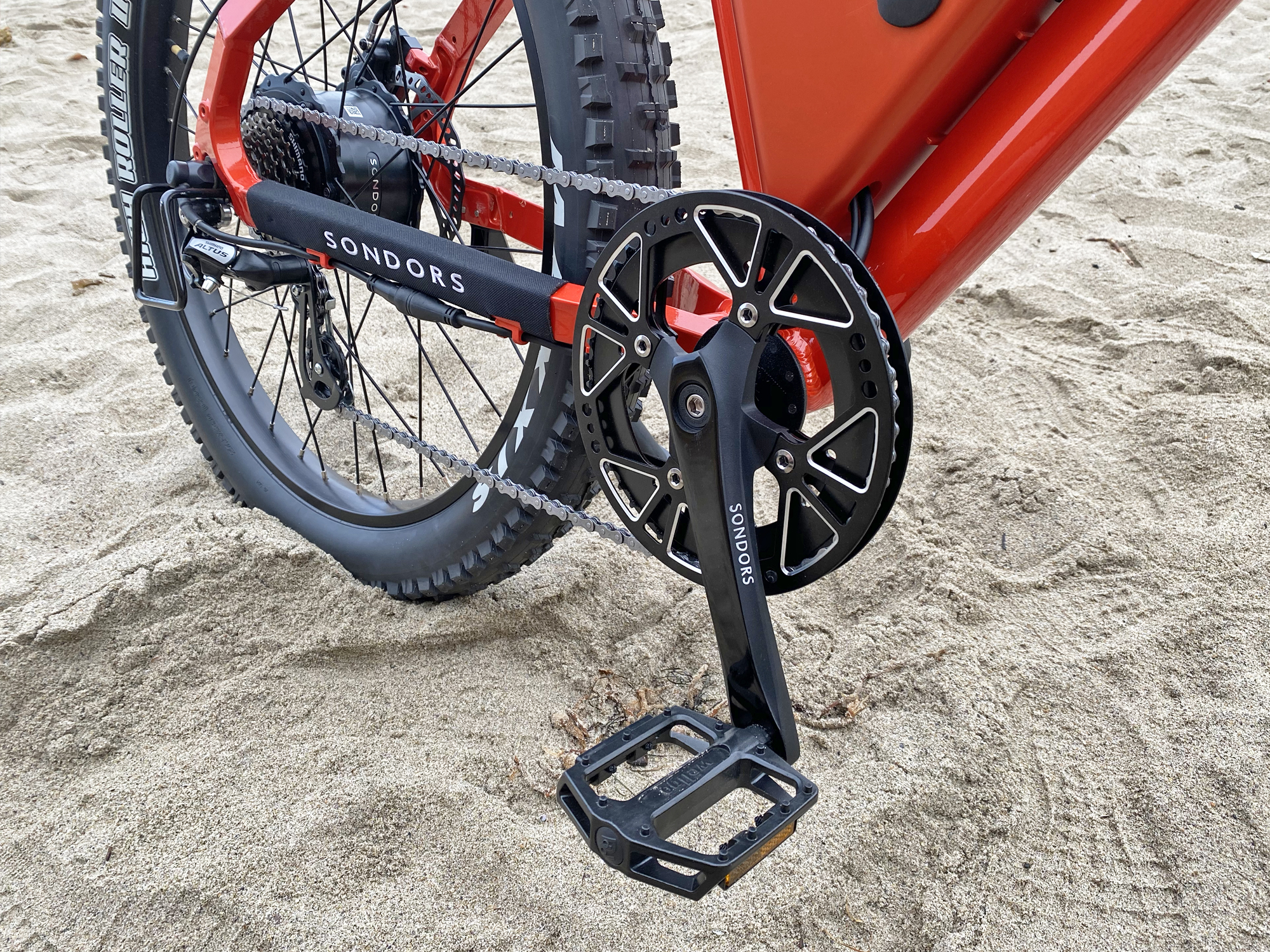

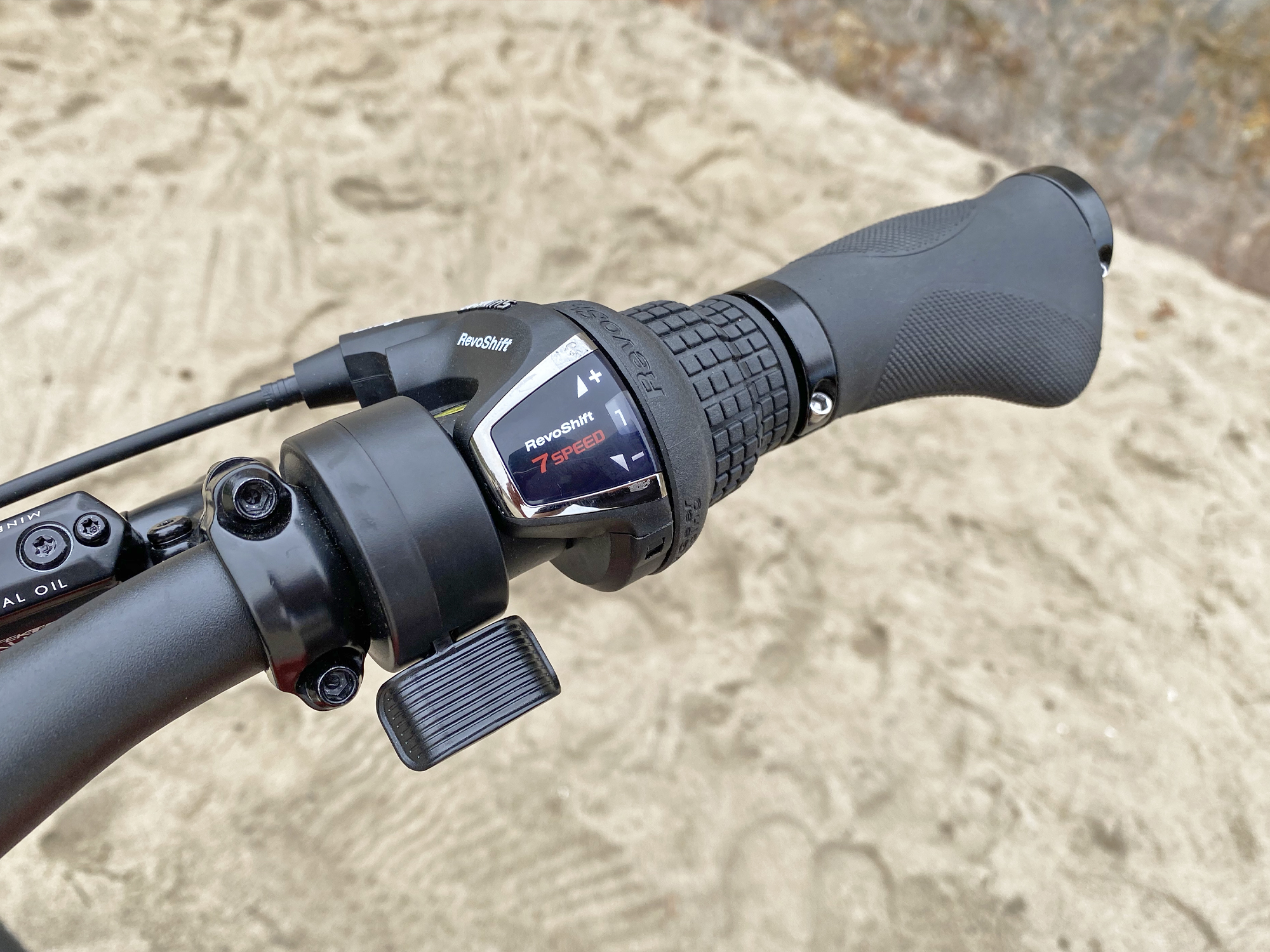

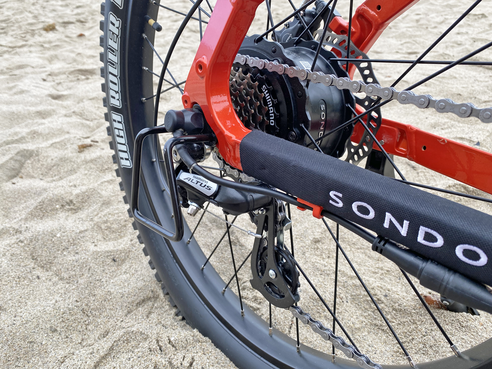

- The drivetrain features a Shimano Altus derailleur and a RevoShift half-grip shifter, and while it isn’t top-of-the-line I really appreciate it for its simplicity and ease of use, grip shifters make it easy to quickly shift up and down the entire 7-speed cassette, and the Altus derailleur is a step up from the entry-level Tourney. I also appreciate that a steel derailleur guard is included, extra important here as it also protects the motor connection point
- The chain is stainless steel which is more durable and rust-resistant, and the MXS also has a double-sided bash guard that serves to protect the chainring as well as keeping the chain securely in place

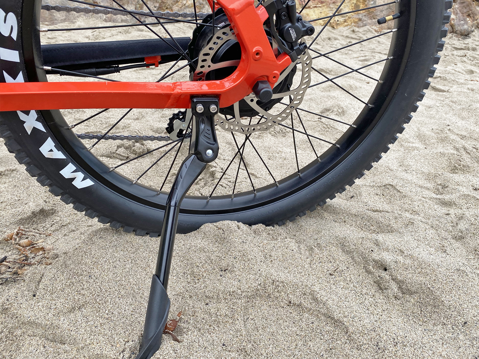

- The adjustable-length kickstand has a wide base and did well even parking in the sand, and it is rear-mounted which means it won’t lock up the cranks when moving the bike backward while the kickstand is down

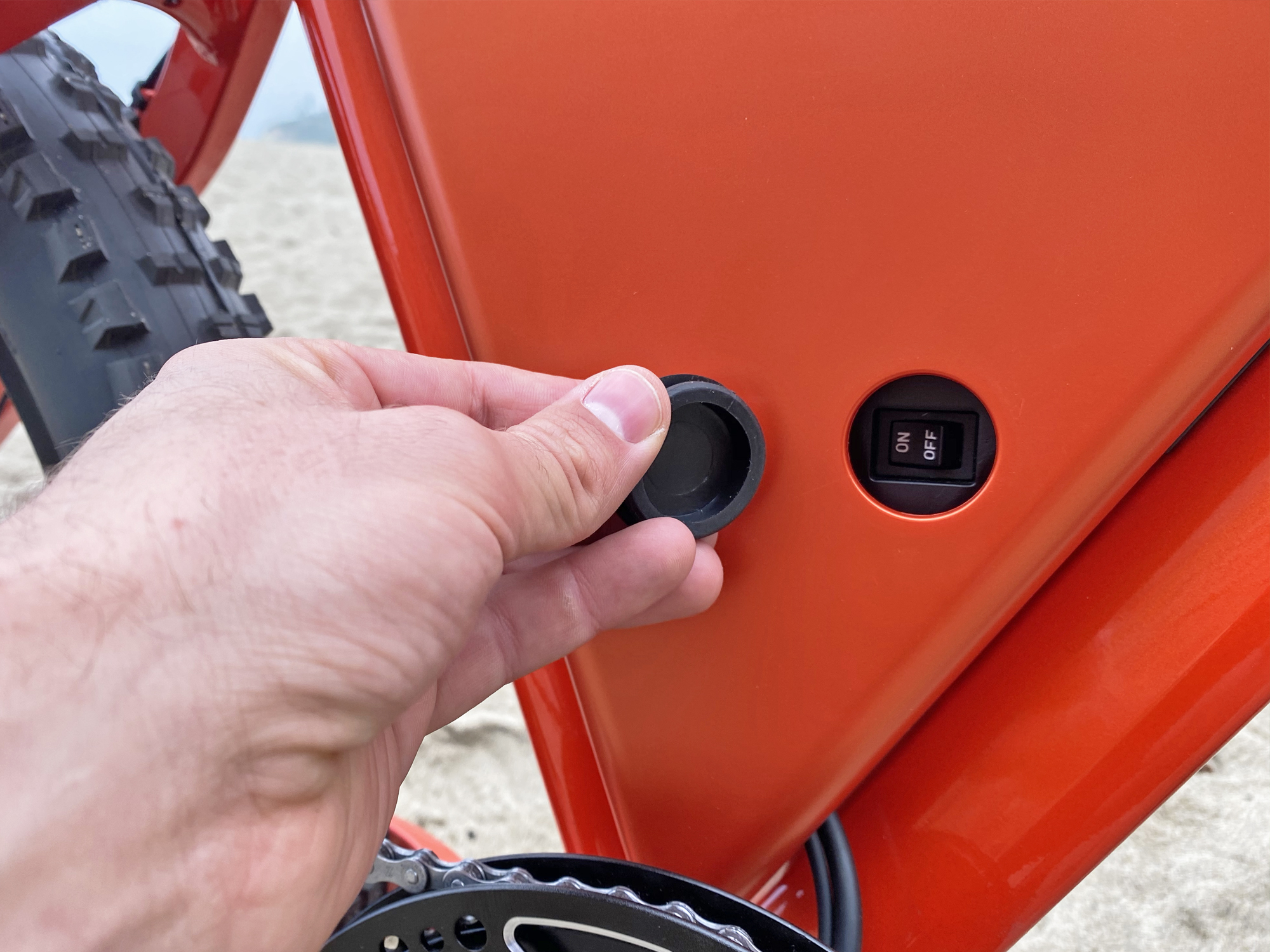

- The battery can be removed from the frame compartment but it is a multi-step process that feels time-consuming compared to most Ebikes. You have to unscrew the compartment, unlock the battery, lift it part-way out while being careful not to stretch and damage cables, and then unscrew the controller connector. These are simple steps but it does mean extra time and effort if you want to regularly remove the battery and store it inside while not riding, which is something I recommend to prolong battery life. Lithium-ion batteries will last longer if you protect them from extreme temperatures, as well as keeping them about 50% full when storing for longer periods of time

- The display is adjustable for angle for reducing glare, but it is not removable, which means it is vulnerable from damage to weather or getting dinged at the bike rack. More so here it is at risk to damage while mountain biking, this is why most eMTBs have displays that are either removable or small and out of the way
- The rear cassette has seven speeds but a range of only 14 to 28 teeth, this is a basic range and smaller than I would like to see on a mountain bike, the first gear being only 28 teeth means that you won’t be able to tackle steep inclines without serious help from the motor. Fortunately, the motor is more than up to the task, having no problem with a sustained steep incline during my ride test

Now I need to find a way to service the Mozo front fork with a rebuild kit. I haven’t found anything on Mozo forks to get what I need. Anyone help me here???? Semper Fi Vic
Court says
Hi Vic! Happy to hear that the bike is holding up well and you’re enjoying it. I don’t have any knowledge about servicing the Mozo fork, and have mostly worked with local shops to do this kind of service. Maybe some of the parts are generic enough that they would have access? I’d love to hear what you learn as you dig into this more. perhaps someone on the EBR forums could help, in the maintenance section here.

For this price should be 10 gear cassette not a cheap old tech 7 Speed 1×7 Shimano Altus, MF-TZ500-7 14-28 Tooth Freewheel
Tyson Roehrkasse says
I hear you, I would definitely like to see a cassette with more range on it as well! That would raise the cost though, and the motor does help to balance it out pretty well.

Just to let everyone know, they have changed the display design. More edge to edge visibility, smaller, super bright. Only 5 settings for pedal assist which I find is OK.
The only thing is the the USB port is not on the side anymore. There is a cable with a connector that comes from the back of the unit and has a separate USB mount for the handle bars. It’s OK, just takes up real estate on the handle bars.
