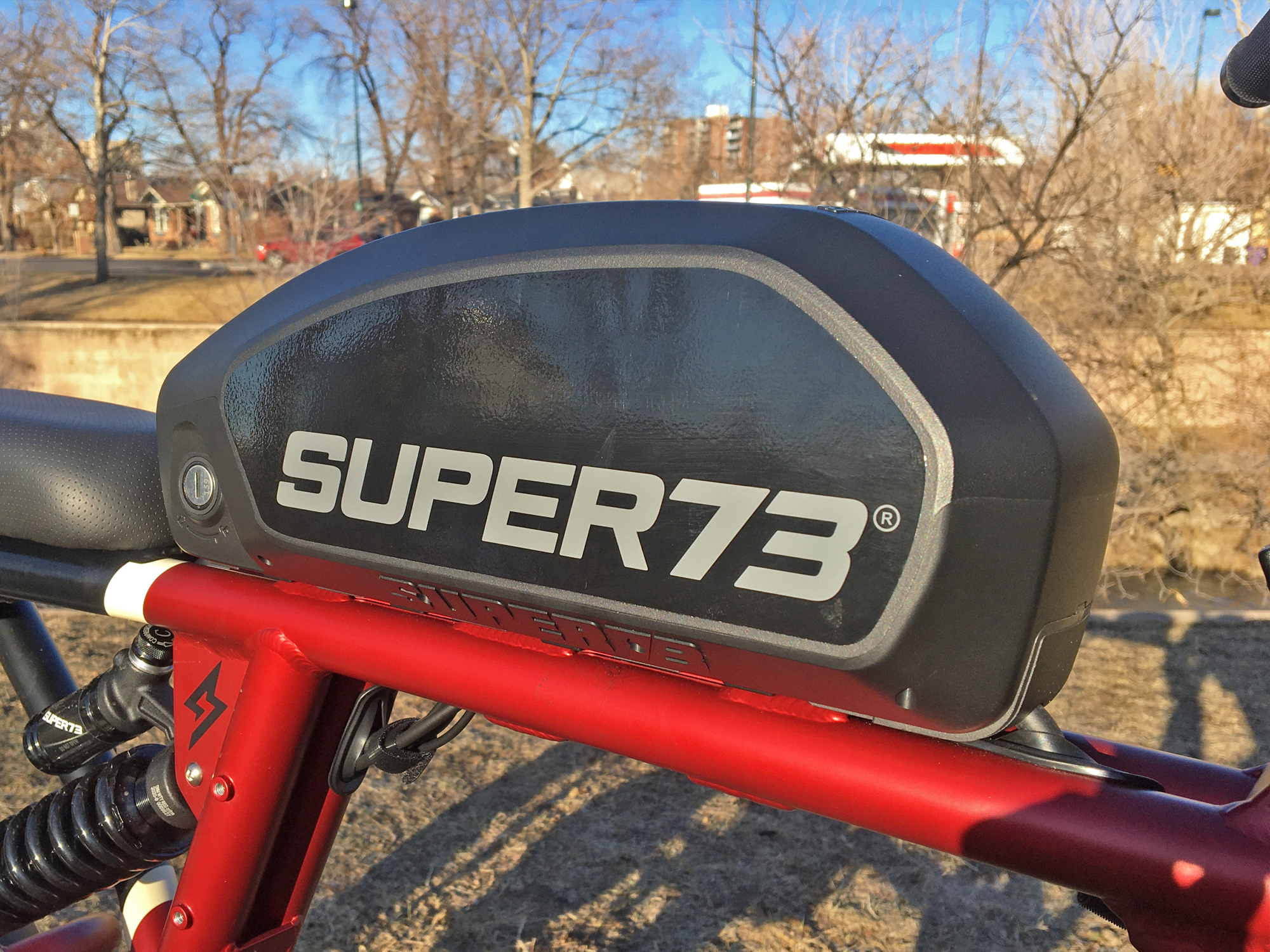

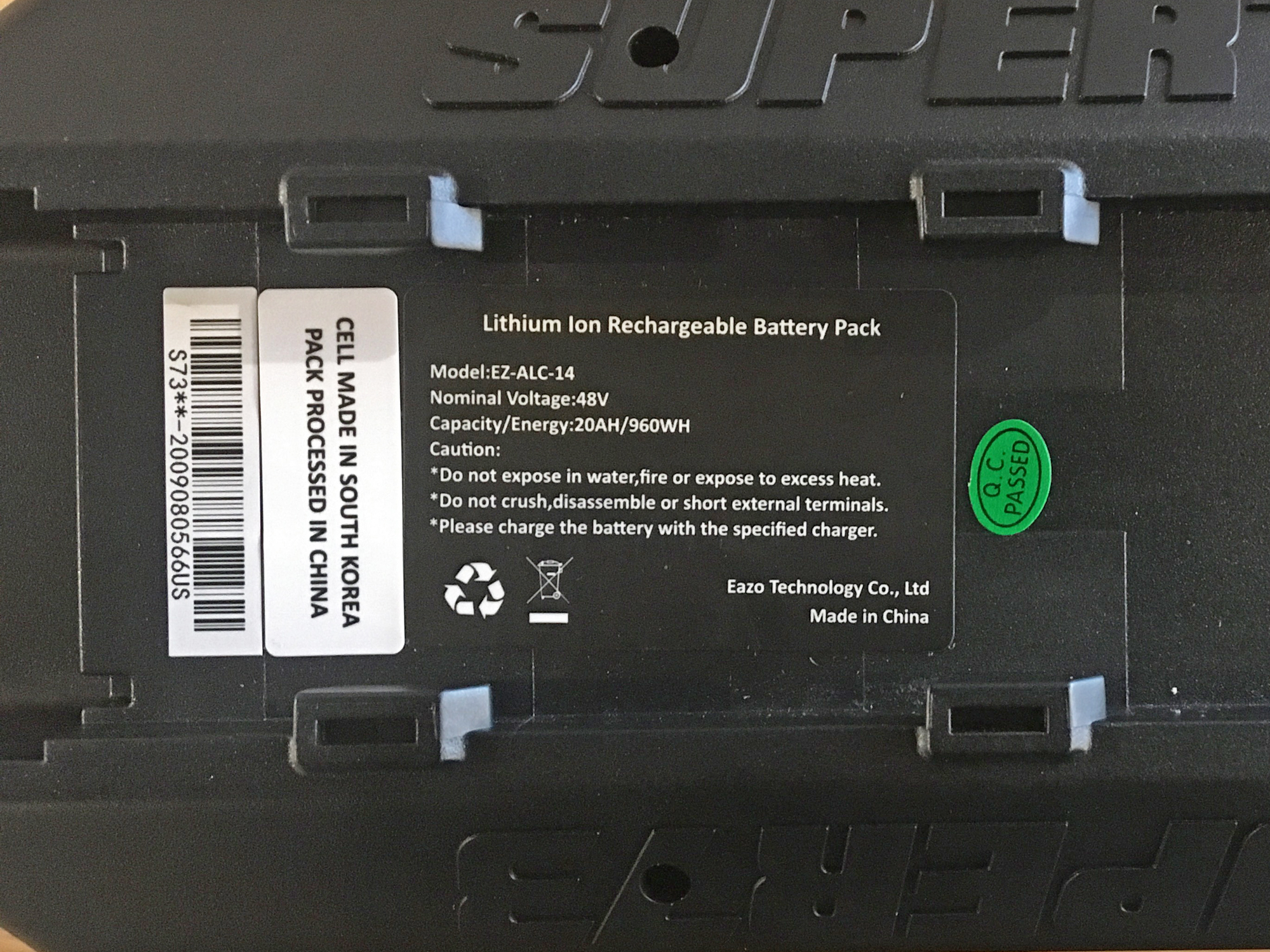

- The battery is a massive 960 watt-hour pack, shaped and positioned like a motorcycle gas tank. The high capacity will provide plenty of range even when only using the throttle, Super73 estimates 40 to 75 miles of range and based on my ride test I think that is accurate. I have heard that they use high-quality Samsung cells for their batteries but I wasn’t able to find official confirmation on that.

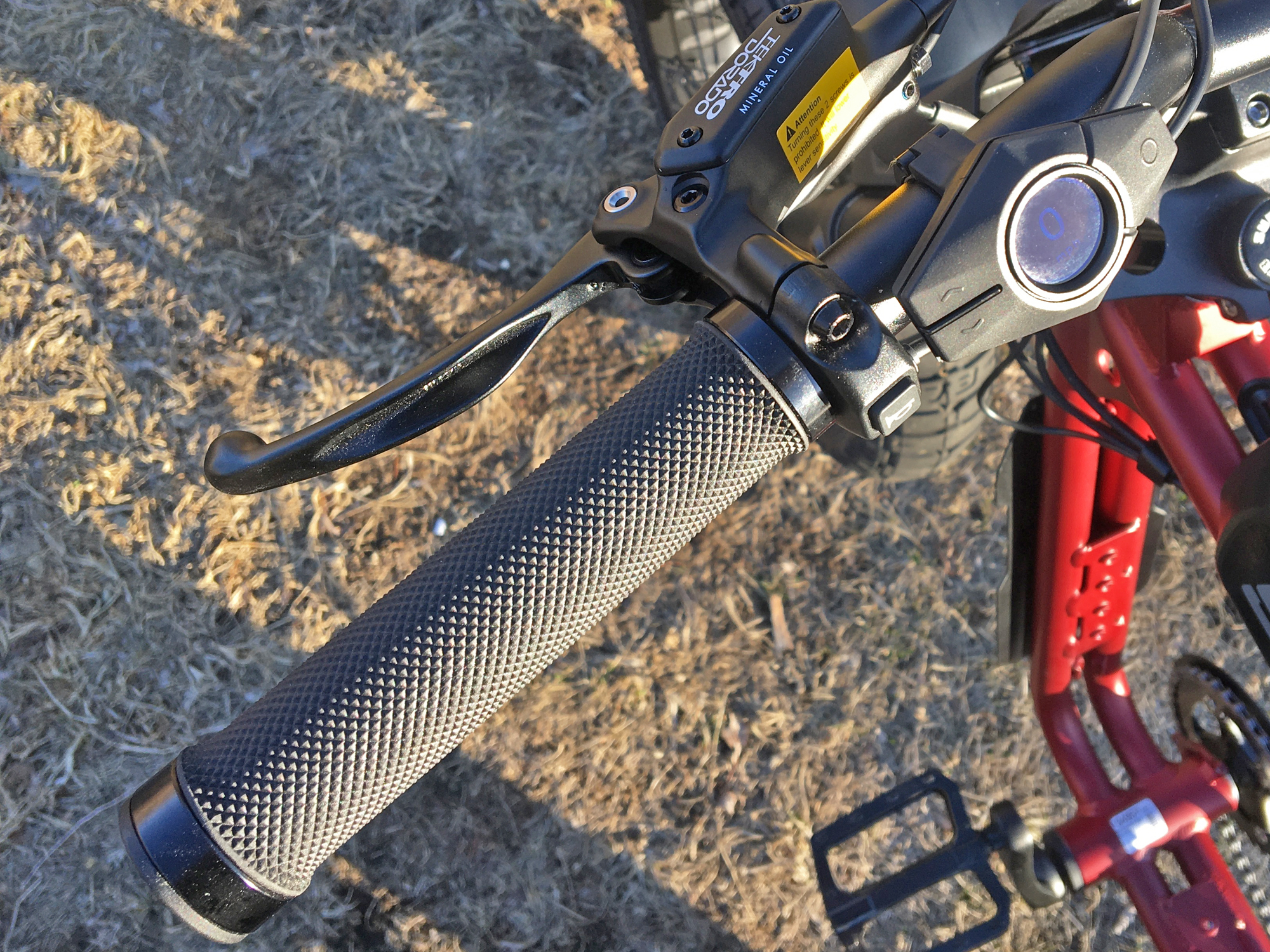

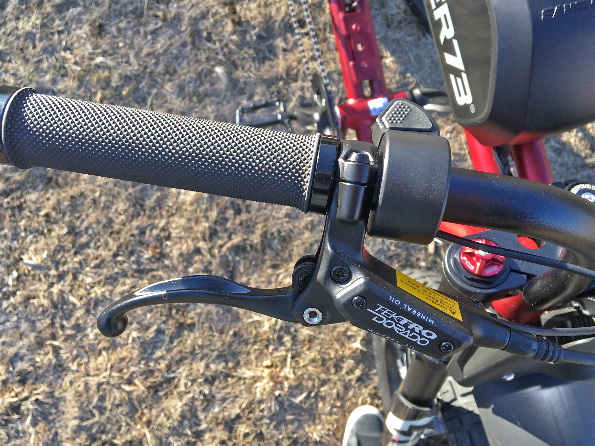

- Hydraulic disc brakes from Tektro feature a large 203mm rotor up front and 180mm in the rear, quad-piston calipers, and integrated motor inhibitors that will cut power to the motor immediately when activating the brakes. These are excellent brakes and provide ample stopping power considering the weight and speed capabilities of the RX.

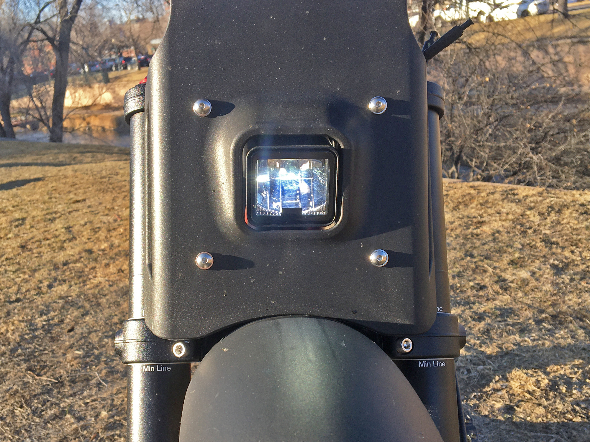

- Good integrated lighting from Roxim, with the headlight mounted in the front faceplate and the taillight positioned right behind the banana-style seat. Both lights are connected to the main battery and activated from the control pad by holding down the up arrow, and the taillight is brake-activated, even when the lights are switched off – a great safety feature! The headlight is rated at 600 lumens and plenty bright enough for night riding without blinding other riders (for reference, the average car headlight is 1300 lumens).

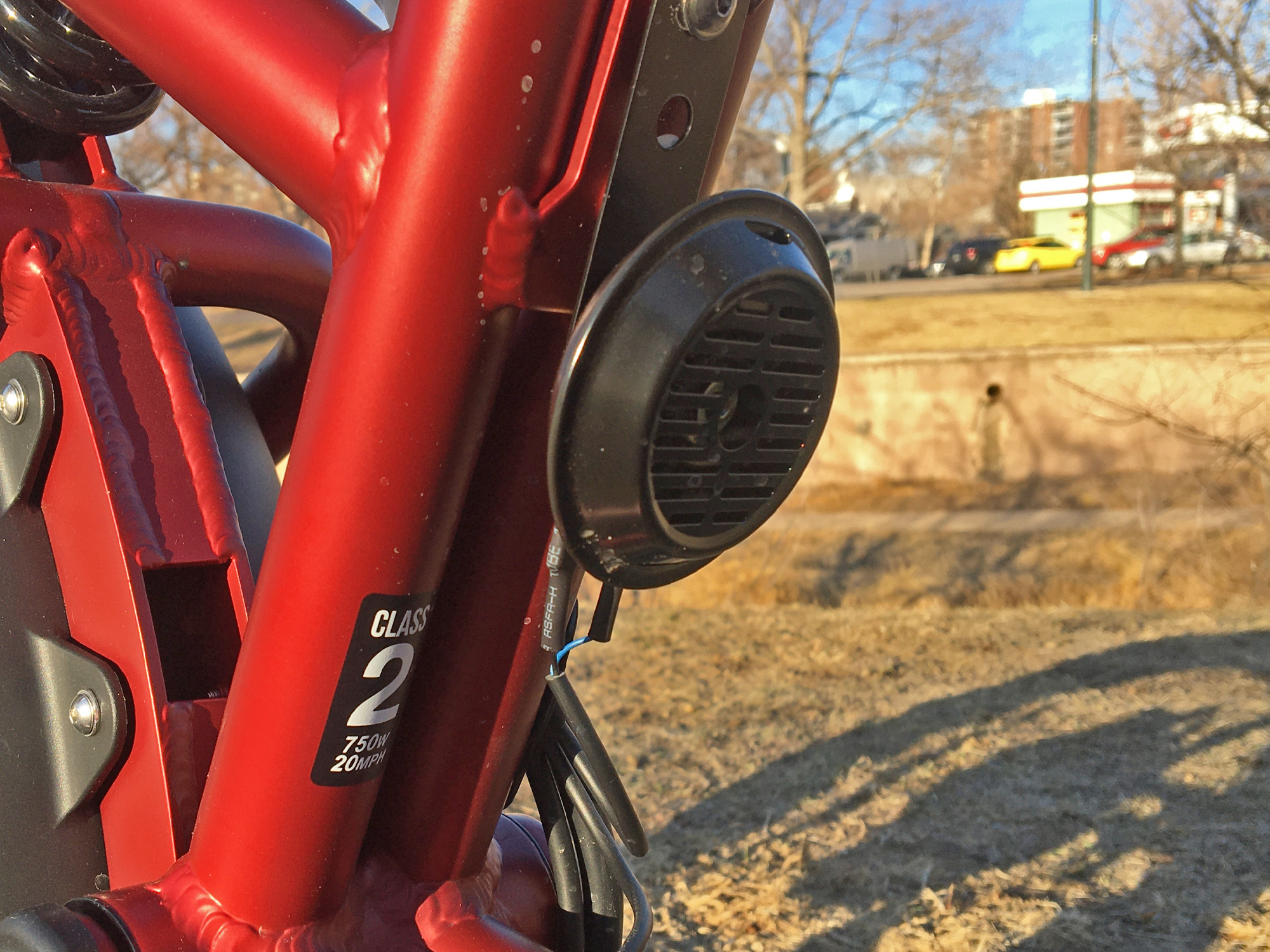

- A horn is included, mounted low on the “seatpost tube” and activated via a button on the left grip. It is very loud and capable of getting the attention of vehicle drivers when riding with traffic.

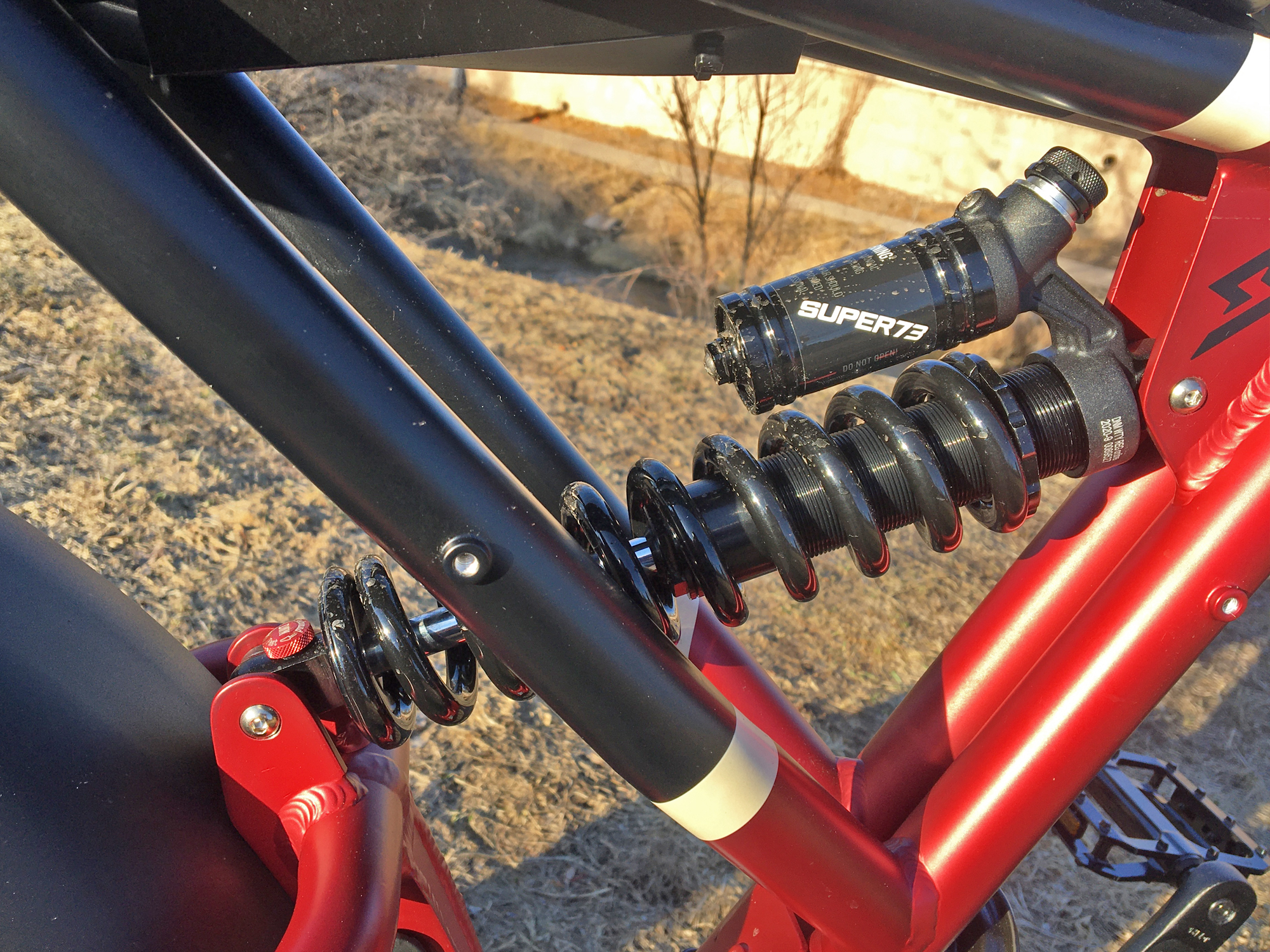

- The frame is exceptionally sturdy with a unique parallel tubing design, constructed from aircraft-grade 6165 and 7071 aluminum alloy, much stronger than typical ebike frames which use 6061 alloy. It feels rock solid on any terrain, and I also appreciate the plethora of mount points, positioned well for mounting bottle cages, additional batteries, racks, or even passenger foot pegs. Yes, you can take two on the RX (although it would feel pretty cramped) and the listed weight limit is 325 pounds.

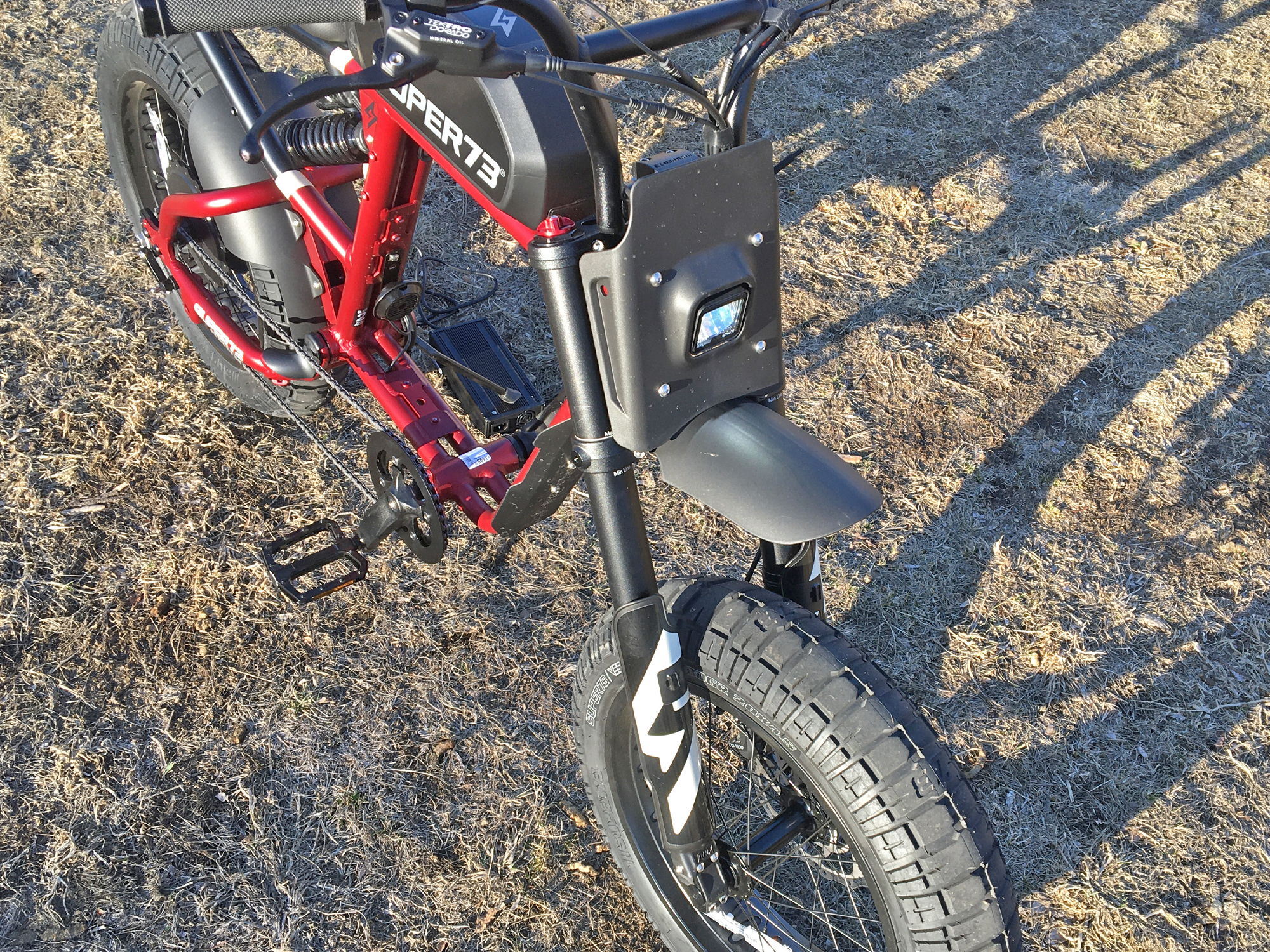

- Premium full suspension from DNM looks and feels excellent! Up front is an inverted coil suspension fork with air assist and 120mm of travel, adjustable preload and and rebound damping, complete with front-facing plastic guards to protect the stanchions from damage and debris. The rear suspension is a single coilover piggyback shock, also with adjustable preload and rebound, as well as a preload dial at the top of the coil. This makes for smooth riding on city streets and excellent off-road capabilities for more adventurous riders.
- Semi-integrated cabling is well managed and contributes to the rugged and powerful look of the RX, I loved the appearance of my test bike with a Carmine Red frame accented by black components. It has a strong dirt bike asthetic and feel, thanks in part to the upright riding position and thumb throttle positioning on the right grip.

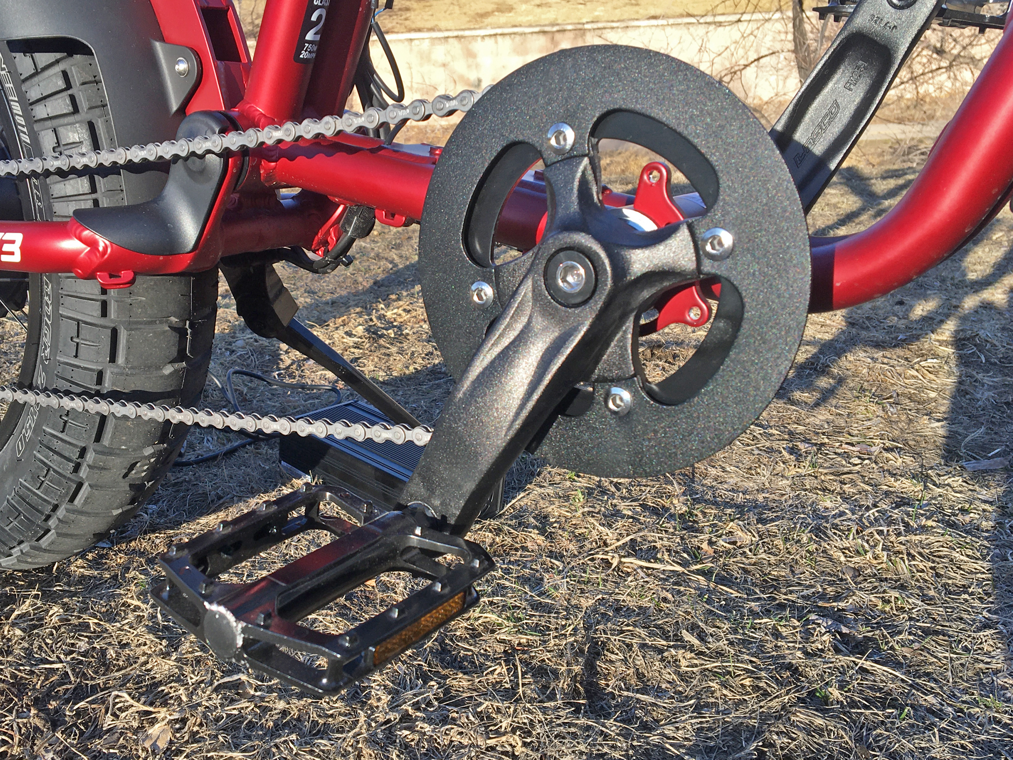

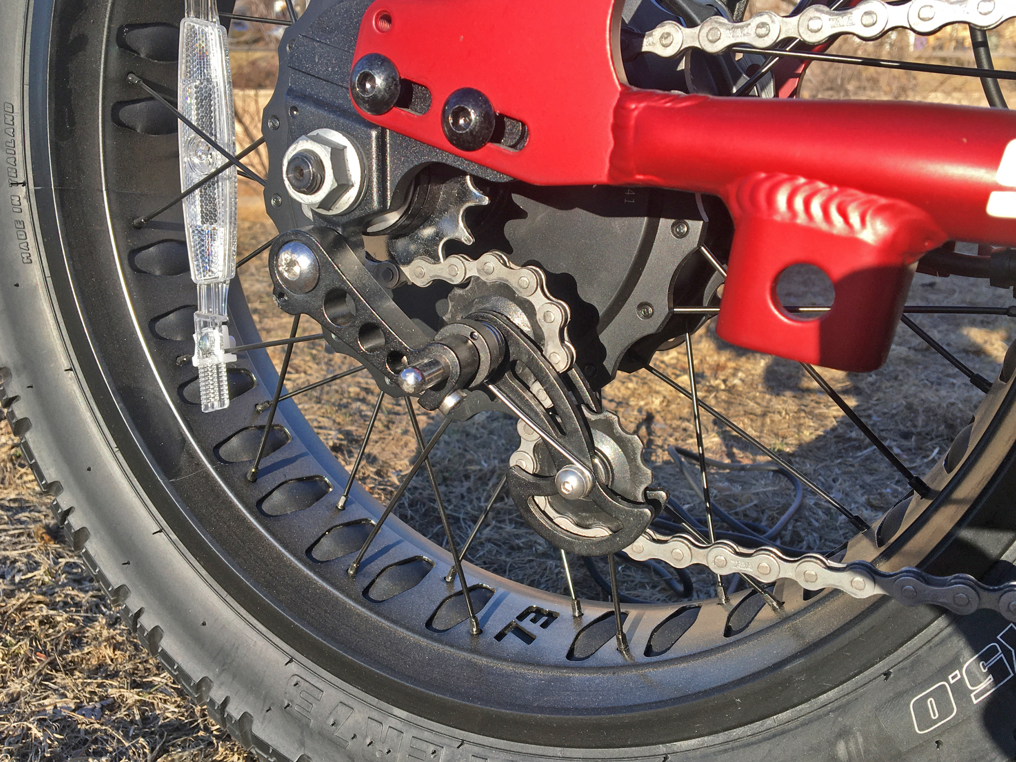

- The minimalist single-speed drivetrain has a 36-tooth chainring and a 16-tooth rear cog, complete with a chain tensioner to prevent derailling. Normally you wouldn’t need a chain tensioner on a single-speed setup, but since the cranks are positioned farther forward than usual (to help with pedaling) the tensioner is a good choice here. Pedaling feels best at medium speeds of 10 to 20 mph, and Super73 does sell a 10-speed upgrade kit if you want to pedal more at higher speeds. I like single-speed setups as they are simple and easy to maintain, and there’s also a bash guard on the outside to protect the chainring, as well as keep your pants from getting snagged in it.

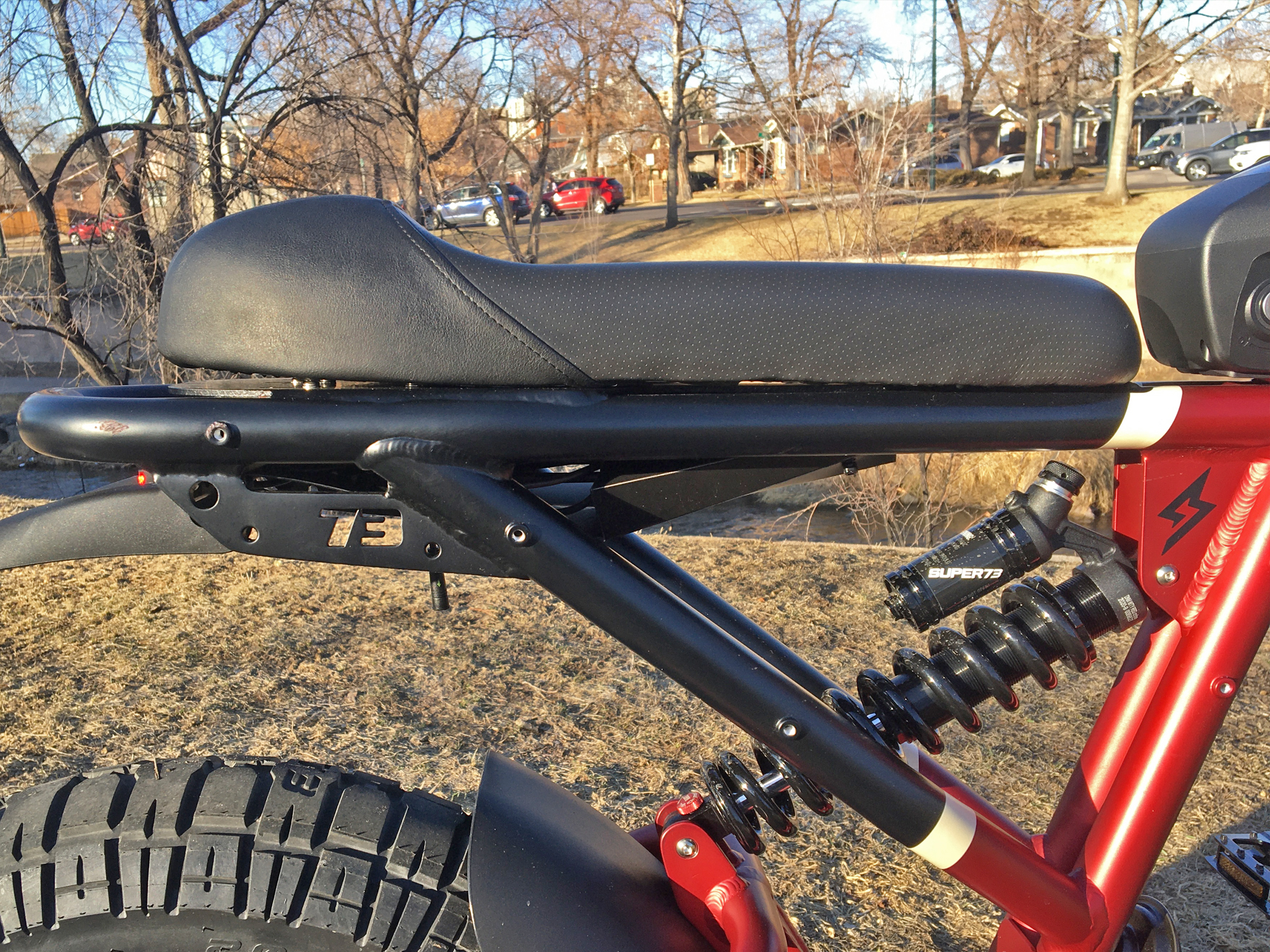

- The seating position is surprisingly comfortable for such a small bike, even for my lanky 6ft 3in frame. I was able to sit in an upright relaxed position, there’s room to slide forward and backward on the seat and the handlebars can also be adjusted forward and backwards somewhat, so a wide range of riders should at least be able to sit comfortably. Pedaling is a different story (more on that in the cons section below).

- The spokes are quite thick with 10 gauge rear and 11 gauge front where a standard ebike would have 12 or 13 gauge for both, and the hub spacing is 200mm (rear) 150mm (front), wider than the standard fat-tire ebike spacing of 170mm and 140mm respectively. This wider angle provides a better support angle for the spokes and translates to more strength. Also factor in the thick axles of 18mm rear, 15mm front, whereas most ebikes have 10mm in the rear and often only a 5mm quick-release front axle… put all this together and you get an impressively sturdy bike that feels excellent at any speed.

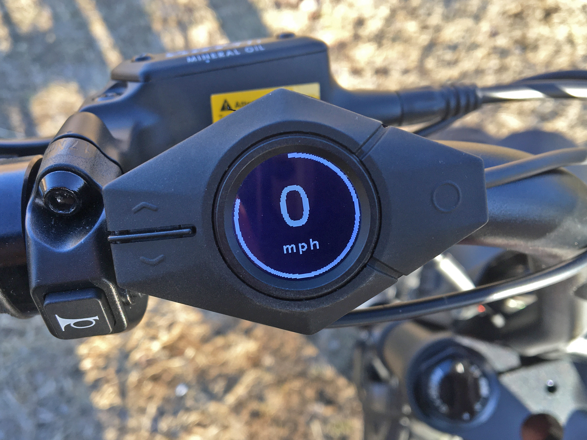

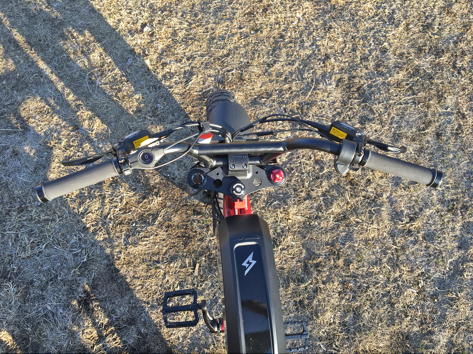

- The display is a simple circular LCD with excellent contrast ratios for viewing in any lighting, unobtrusive, and intuitive to control. I like this setup as it minimizes fiddling with controls so that I could focus more on riding. I was impressed that it also has readouts for pedal cadence and motor wattage, although the motor wattage readout isn’t able of going above three digits so it isn’t very useful for the 2000-watt capable RX.
- For more advanced settings, informational readouts, and even GPS navigation, Super73 has a smartphone app which pairs with the RX. Many ebike companies are touting their mobile apps and to be honest I don’t like most of them; they tend to be buggy and the pairing process is usually time-consuming and frustrating. That was not the case for the Super73 app, pairing took less than 30 seconds and I was able to figure out the app settings without any need for a tutorial. Great design, I hope other companies take note! As a bonus for reviewers it’s also easy to un-pair the app and bike later, this is also good if you buy a used Super73 model or sell yours at some point in the future. The RX can also receive OTA firmware updates via the app, a huge convenience compared to most ebikes that must be taken to a dealer to receive updates!

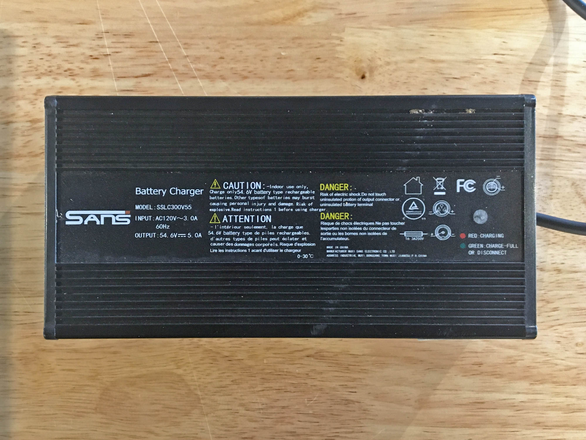

- The standard charger is rated for 5 amps which means much faster charging than the typical 2 amp charger, much appreciated considering the massive battery pack.

- The pedaling experience is not great especially at my height of 6ft 3in, I felt a bit silly with my knees coming up well above the battery pack. The cranks are 125mm in length and much shorter than the standard 170mm cranks, further limiting pedaling efficiency. Pedaling feels best at medium speeds and cadence is brisk by 20mph, I was able to get up to 25mph with my feet going ridiculously fast but couldn’t sustain it for long. Super73 does sell a 10-speed upgrade kit which is nice if you want to pedal more often, but it can’t be ordered installed on the RX – you have to install it yourself or pay someone to do it – and at the time of this review it is sold out on their website.

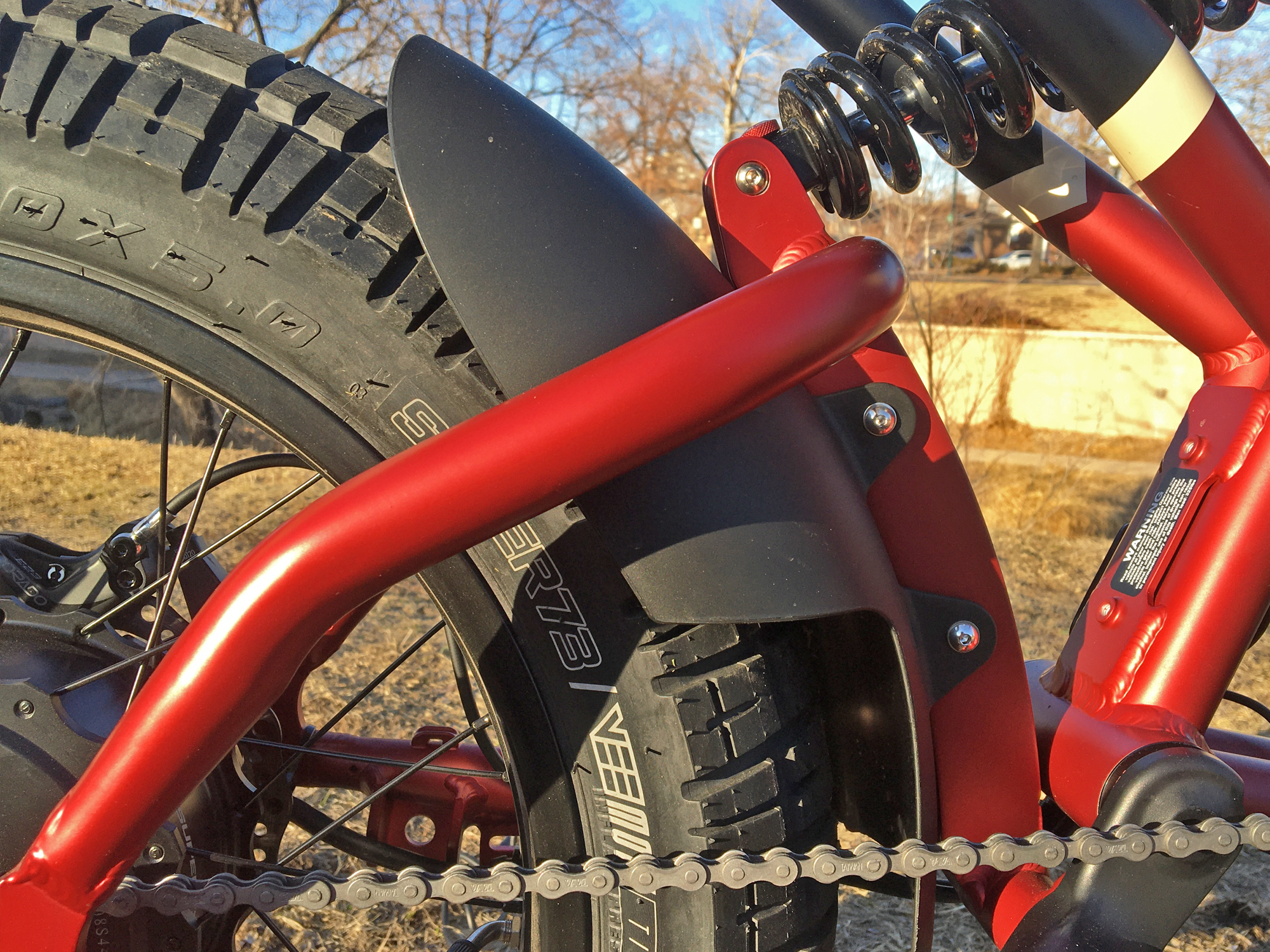

- The taillight is bright and I appreciate the brake activation, but it’s poorly positioned behind a rear frame bar that almost entirely blocks the taillight when viewed from behind at average car-driver height. You can still see the glow of the light around the edges of the bar so it’s better than nothing, but positioning it on the back of the frame itself would be a much better location.
- There are no side cutouts for the lights and no reflective stripes on the tires, and not even any side reflectors on the spokes… so side visibility is quite poor on the RX. Most accidents involving cars and bicycles involve a side collision because the car driver didn’t see the cyclist, so I recommend adding some lights of your own to increase safety when riding at night.

- I appreciate the power of the charger but it is significantly large and heavy at 2.8 pounds, not very convenient if you want to carry it in a backpack, hopefully the high capacity of the battery will mean that you can leave the charger at home for most rides.
