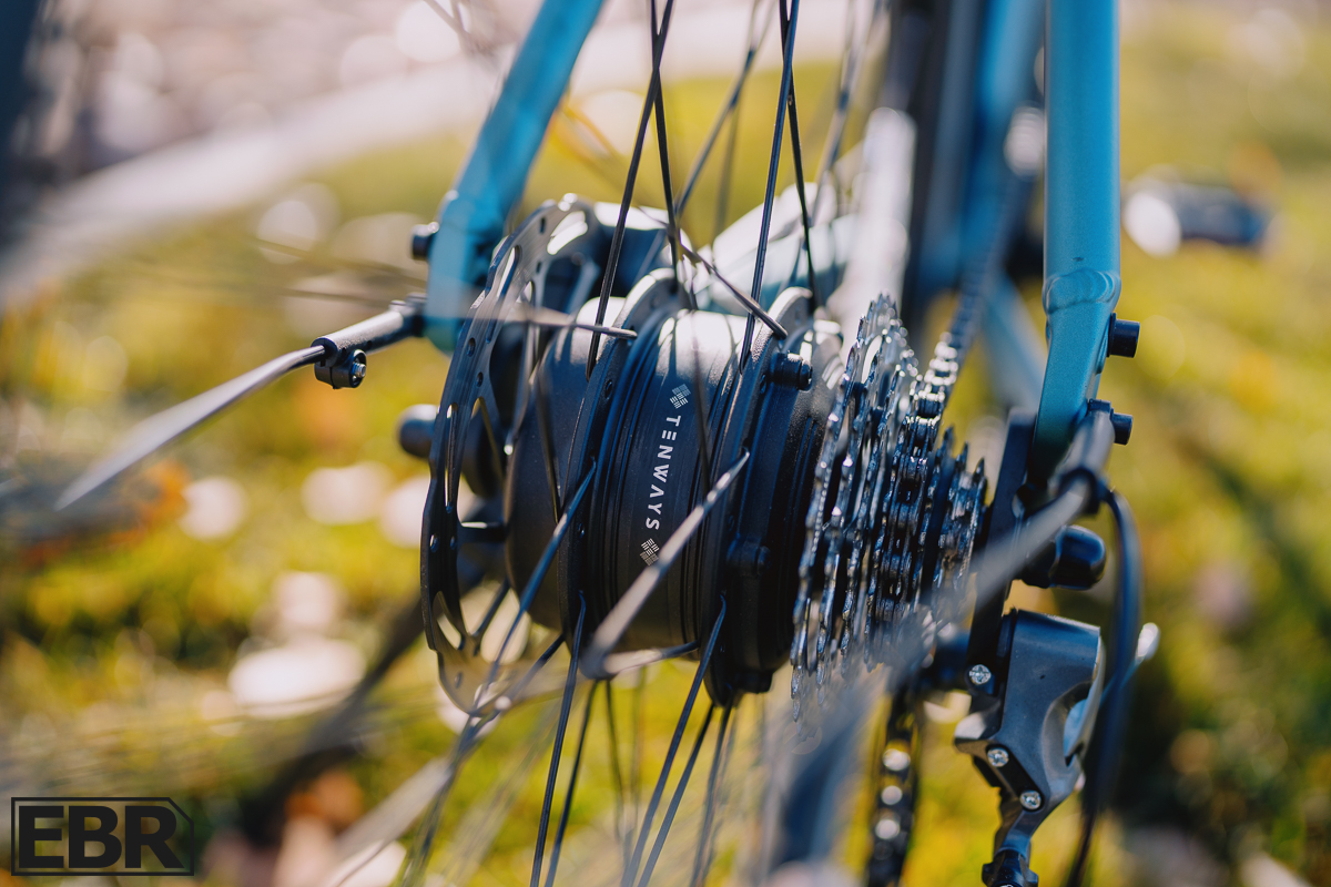

Here’s something that caught me off guard – this might be one of the quietest e-bikes I’ve tested. The 350W rear hub motor (45Nm torque) barely whispers, and paired with that refined torque sensor, you get surprisingly capable performance that feels natural. While steep climbs over 10% will still demand some leg work, the bike handles most terrain without breaking a sweat.

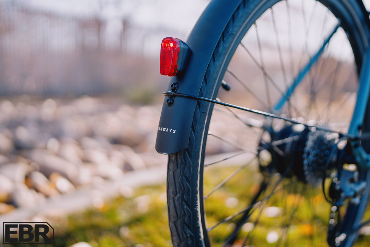

One nitpick though – those alloy fenders. While they look clean, they tend to rattle on gravel and rough patches. A composite fender set would kill that noise while being lighter and more resistant to bending. Just saying, Tenways.

The 350W rear hub motor might be the quietest setup I’ve tested yet. Usually with torque sensors, you’ll catch that whine ramping up and down as you apply pressure to the pedals – but this one’s different. Even with my ear tuned for it, I couldn’t detect motor noise at any point during testing. That’s rare, and for riders who appreciate a stealthy ride, it’s a legitimate selling point.
But, don’t be fooled, stealth doesn’t mean weak.
The motor’s 45Nm of torque hits a sweet spot for this bike’s intended use. Since we’re working with a Class 1 setup (pedal assist only, 20mph limit), the power delivery feels just right. The lighter overall weight of the bike helps here too – you’re not asking that motor to move a tank up hills, so that torque goes further than you might expect.

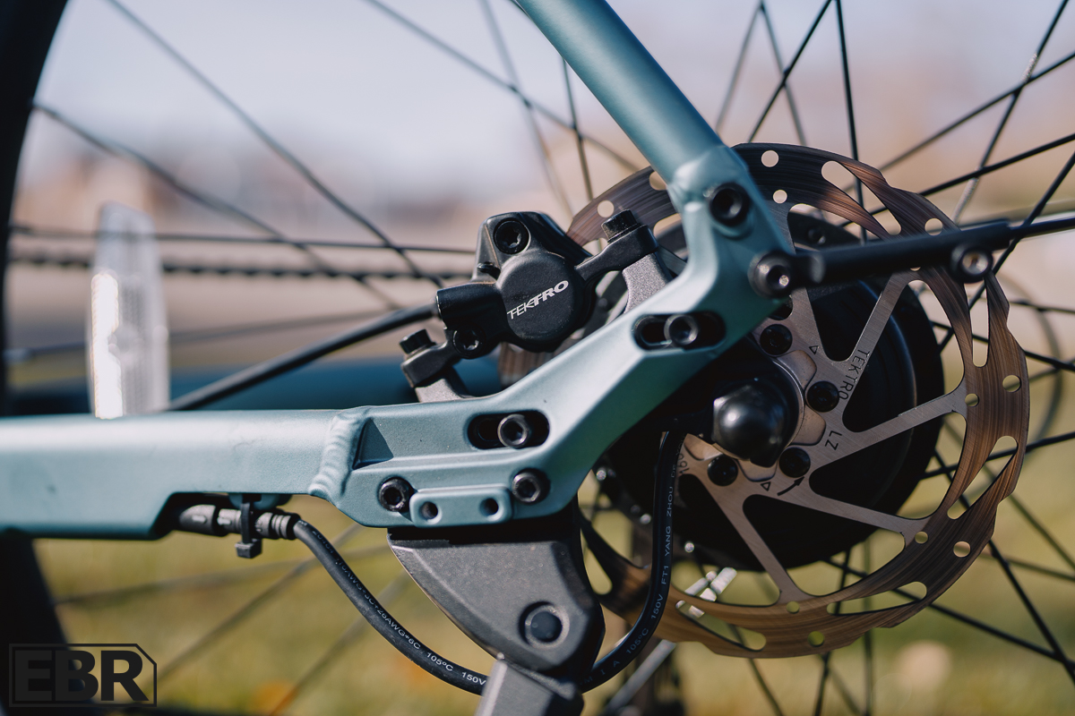

Starting with the essentials, Tenways keeps it straight forward with a rigid aluminum frame and fork – simple, light, and exactly what you want in a city bike. The 700c wheels are wrapped in CST 700x45c puncture-resistant rubber, which hits that sweet spot between efficiency and comfort on rough city streets.
Here’s where things get interesting – you’ve got two drivetrain options at the same price point.
Option one is a Shimano Claris 8-speed setup with an 11-32t cassette and 48t chainring, giving you range for varied terrain.
Option two is a Gates carbon belt drive running single-speed, which means nearly zero maintenance but requires more thought about your local topology. The fact that there’s no price difference between the two is pretty sweet – it’s purely about your riding style and maintenance preferences.

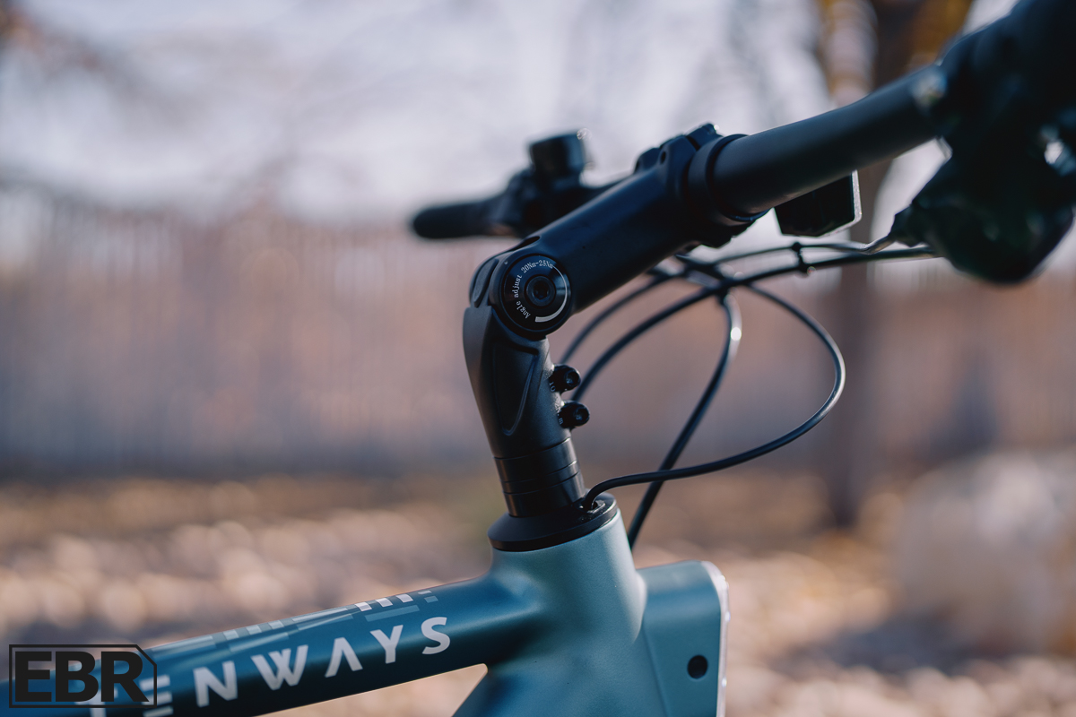

In the cockpit, you’re looking at a 660mm flat bar paired with an adjustable stem and lock-on grips – nothing fancy, but all functional choices for urban riding. The unbranded MTB-style saddle sits on an alloy post with 8 inches of adjustment to dial in your fit. Pedals are flats with reflectors and traction studs in a plastic construction.
Stopping power comes from Tektro hydraulic brakes with 160mm rotors, which is pretty much right on the money for a bike that’s a lightweight city commuter. They’ve got good modulation and enough bite for confident braking or the unexpected quick stop.
Overall, the component mix shows some smart choices for a city bike. Everything’s serviceable, replaceable, and chosen with actual city riding in mind rather than spec sheet marketing.
