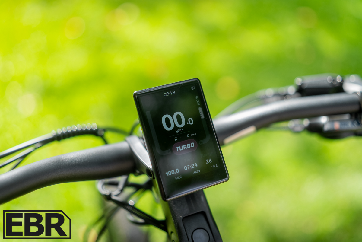

Without all the smart features to mess with, I could just ride. The new color display handles everything you actually need: time of day, battery level, PAS level, estimated range based on which assist mode you’re using, plus cadence and power metrics. Clean, straightforward, no distractions.

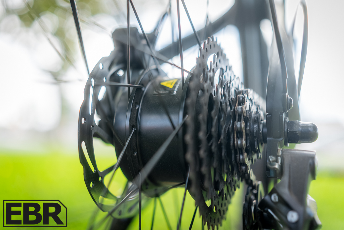

The motor and battery setup on the Carbon Classic is identical to what made the ST so good. You get a rear hub motor with 350W continuous output and 750W peak power, delivering 45Nm of torque through a torque sensor that reads your pedaling input and adjusts assistance smoothly.
The five assist levels (Eco, Tour, Smart, Boost and Turbo) give you plenty of options to match terrain and riding style. Top speed sits at 25 mph, and the motor is genuinely silent. There’s no whine, no grinding, just smooth and responsive assistance that feels natural to your pedaling rhythm.

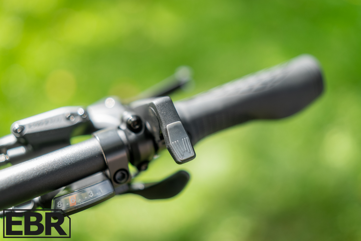

And the star of the Carbon Classic’s show is the new throttle that so many folks wanted added on when the Carbon 1 Pro was released. Mounted on the right side of the cockpit as a push throttle, it works exactly as you’d expect. No fancy integration, no learning curve, just straightforward throttle assist that kicks in when you need it.

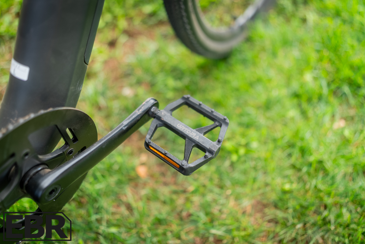

The Carbon Classic keeps things simple and reliable with a Shimano ACERA 8-speed drivetrain. You get an 11-40t cassette paired with a 44t chainring, which gives you a solid gear range for most areas without being overwhelming. 170mm cranks are mated to composite flat pedals that let owners open the box and hit the bike path, complete with traction studs and reflectors. Shifting is predictable and smooth with the 8-Speed Shiomano Acera drivetrain and under-the-bar trigger shifters.

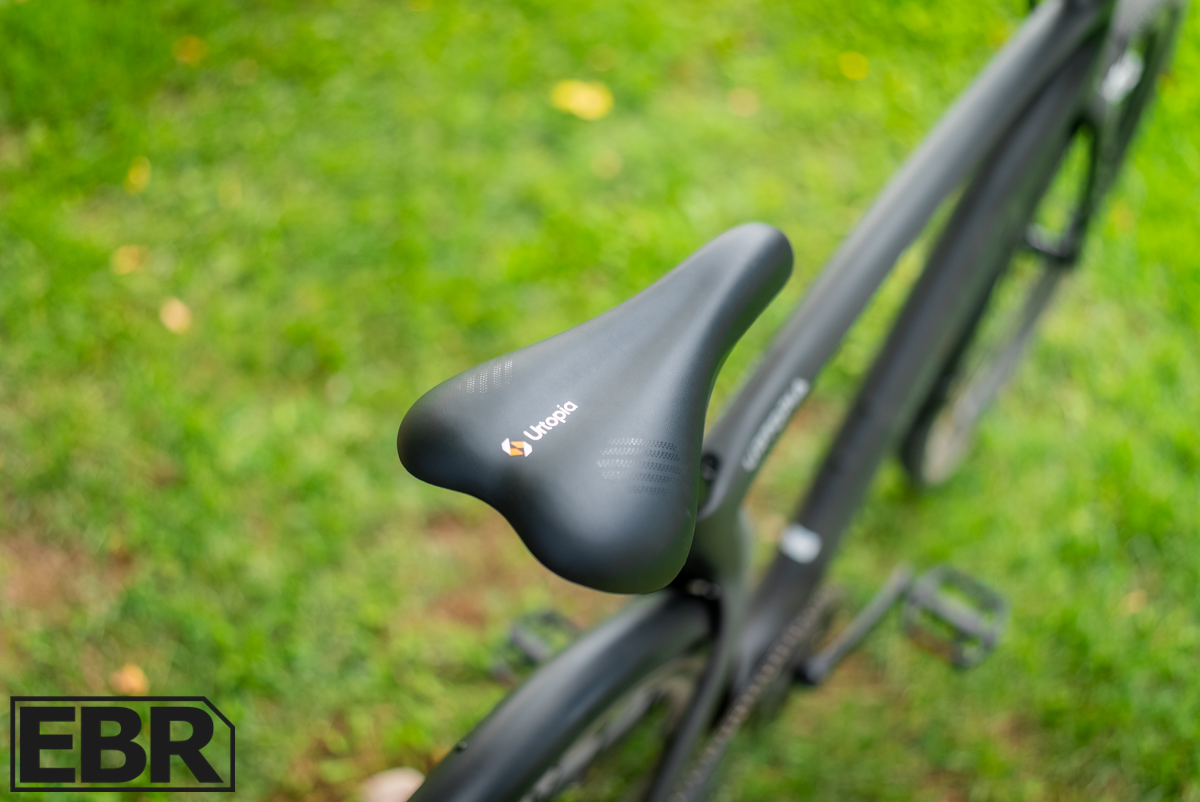

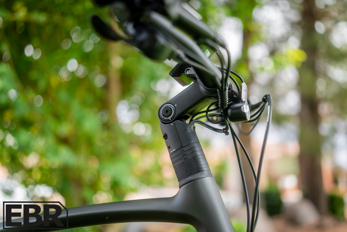

For contact points, you get a COINLLI comfort saddle that’s about 10.6 inches wide, an aluminum seatpost with about 6 inches of total adjustability, and ergonomic lock-on grips that stay put. The cockpit starts with a 680mm wide aluminum handlebar with a flat bar profile and slight rise, putting you in that comfortable hybrid riding position. The stem has 0-90 degree adjustability so you can dial in your fit. Everything is clean with internal cable routing through the headset that matches the stealthy carbon fiber aesthetic.
The throttle sits on the right side of the cockpit as a simple push-style button, trigger shifters handle gear changes, and the Tektro brake levers have adjustable reach to fit different hand sizes. No unnecessary complexity, just straightforward controls that work.

The Carbon Classic swaps out the old dot-matrix display for a straightforward color LCD, which addresses one of the biggest complaints about the Carbon 1 Pro. No ChatGPT integration, no subscription fees, just a clean display that shows what you need: speed, PAS level, battery percentage, time, trip and odometer readings, plus cadence and power output. You can switch between mph and kph, and adjust the speed limit between Class 2 (20 mph) and Class 3 (25 mph) depending on local regulations.

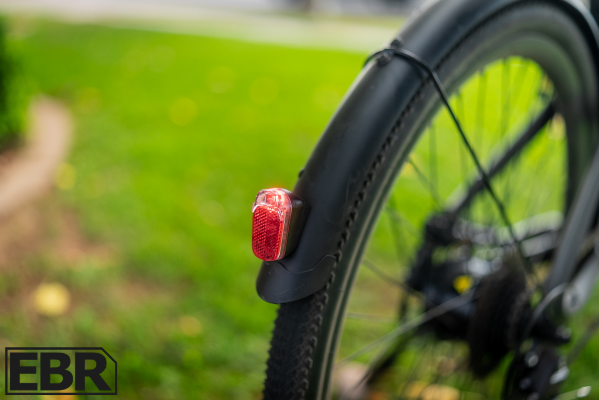

Every Carbon Classic ships with the essentials already installed. You get a kickstand, front and rear plastic fenders, a 30 Lux front LED headlight, a rear tail light mounted on the fender, and flat pedals. It’s ready to ride out of the box.
