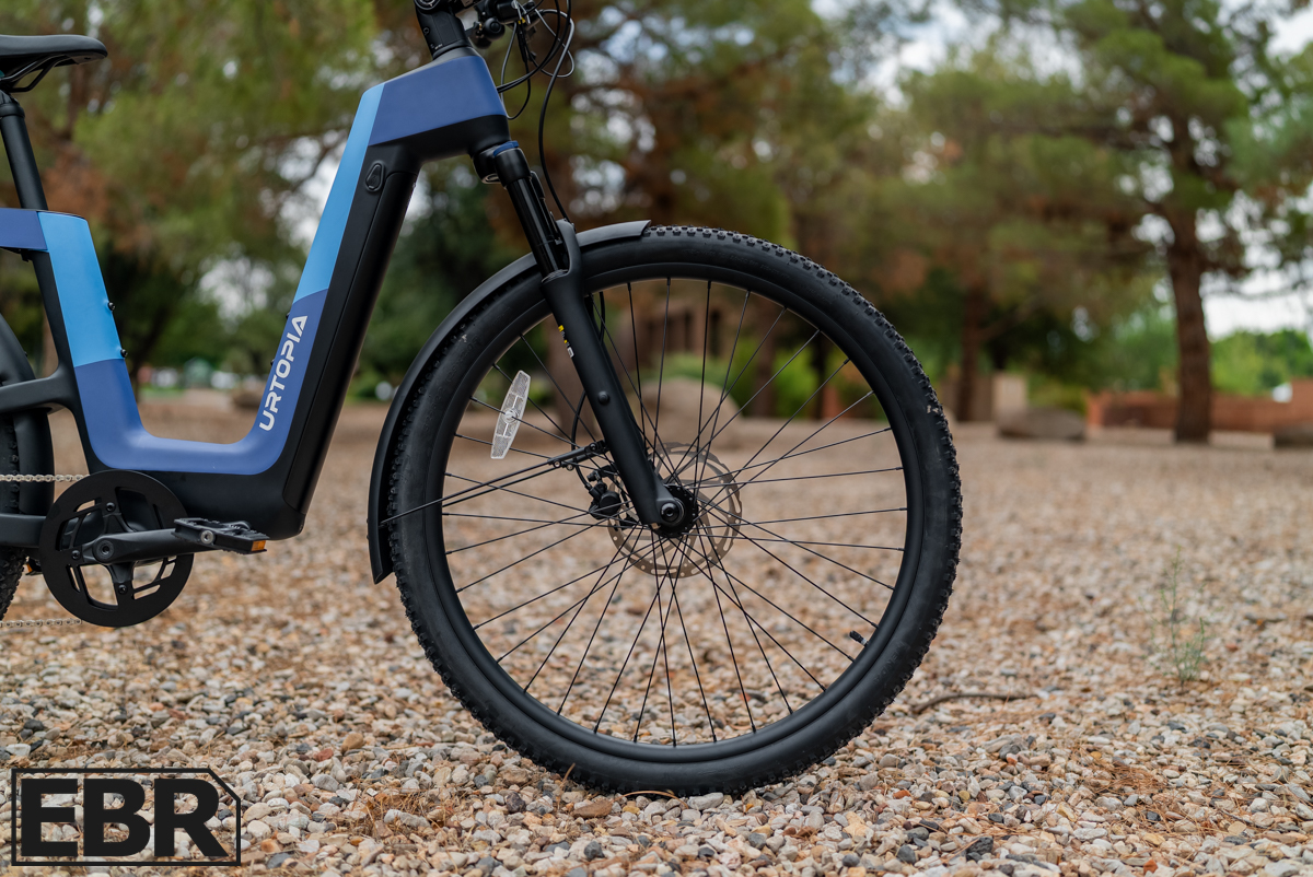

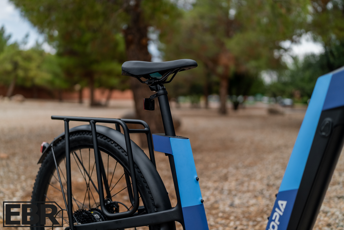

The Carbon Fusion Pro rides on a step-through carbon fiber frame that keeps things sleek and lightweight. Up front, you’ve got a 60mm travel suspension fork with 32mm stanchions, coil spring, and both lockout and preload adjustment features, perfect for smoothing out those city streets and bike path bumps without adding unnecessary weight.
Rolling on 29-inch alloy wheels wrapped in 29″x2.05″ Kenda Commuter tires, this setup strikes a nice balance between speed and comfort. Those slightly thinner tires help with efficiency and that sleek aesthetic, though they won’t be your best friend on loose gravel or rough terrain.

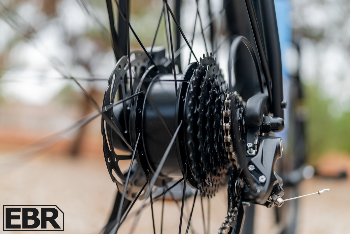

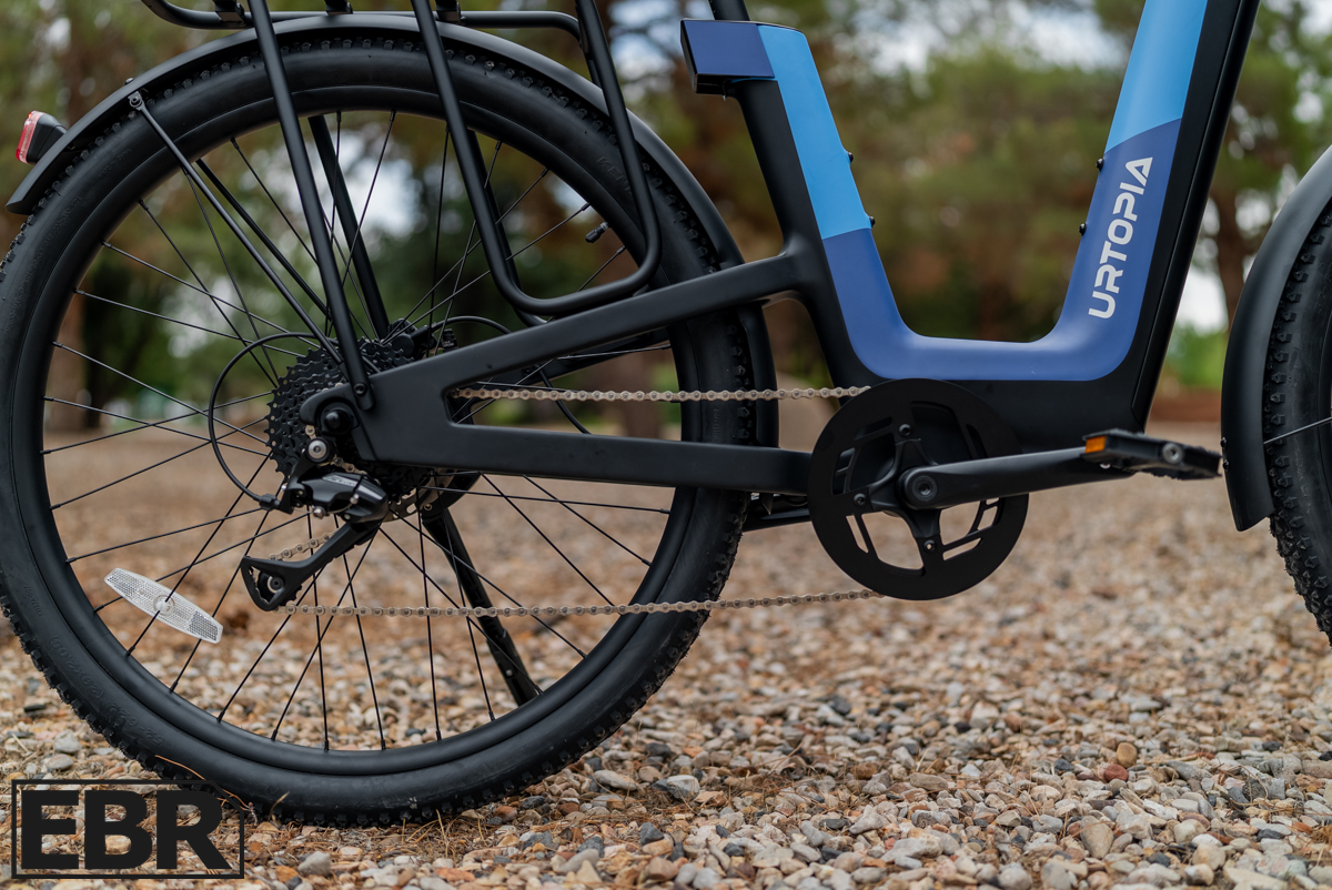

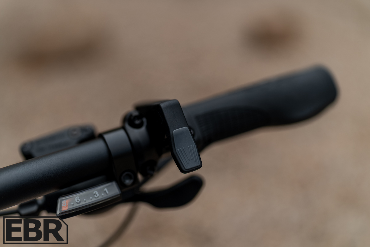

The drivetrain features an 8-speed Shimano setup with Acera rear derailleur, Shimano trigger shifters, and an 11-40T cassette paired with a 44T chainring. That gearing range gives you plenty of options for tackling various terrain, the 11T small cog helps you keep pedaling efficiently at higher speeds, while the 40T large cog provides enough climbing gear for most hills, especially with that motor assist backing you up.

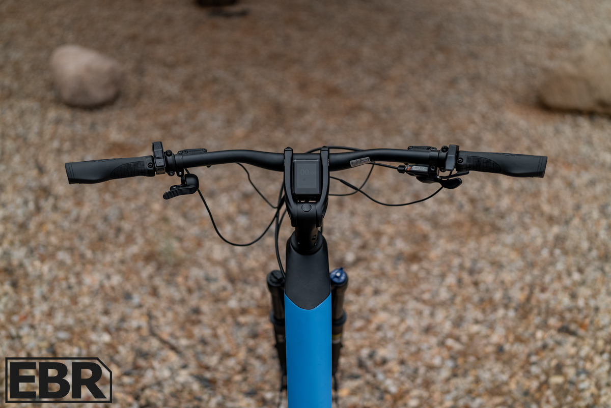

Other notable components include a 0-60° adjustable stem for dialing in your riding position, a 740mm alloy handlebar with a slight rise for comfortable cruising, and rubber ergonomic lock-on grips. The seatpost is a standard 31.6mm alloy unit at 250mm length, topped with an unbranded saddle, and you’ve got simple alloy flat pedals with 9/16″ threading if you want to swap them out.

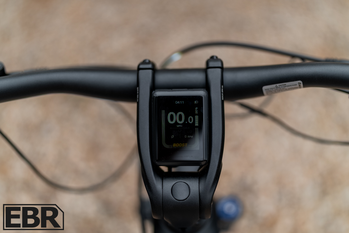

The Carbon Fusion Pro features a compact LCD color display that, while fairly small, does a solid job of showing you all the ride metrics you need when you’re out there pedaling. The main screen displays your current speed, battery level, PAS level, cadence output, and a pedal assistance output bar, basically everything you’d want at a glance.
Hit the ‘M’ button (located between the plus and minus buttons for pedal assist) and you can scroll through additional data screens with info like max speed, average speed, odometer, trip meter, power output, and more. It’s not the flashiest display on the market, but it gets the job done without being distracting.
Urtopia advertises the entire bike as having IP65 water resistance, which means you can ride in the rain without worrying about water messing with this system or the rest of the bike’s electronics, always a relief for commuters who don’t want to be stuck indoors every time the weather turns.
For the tech-minded, holding the plus and minus buttons simultaneously gives you access to the advanced settings menu. This is where you can bump that top speed from the factory 20 mph setting up to the bike’s 25 mph max, switch between MPH and KMH, or dive into other options like factory resets, trip meter clearing, and checking firmware versions.

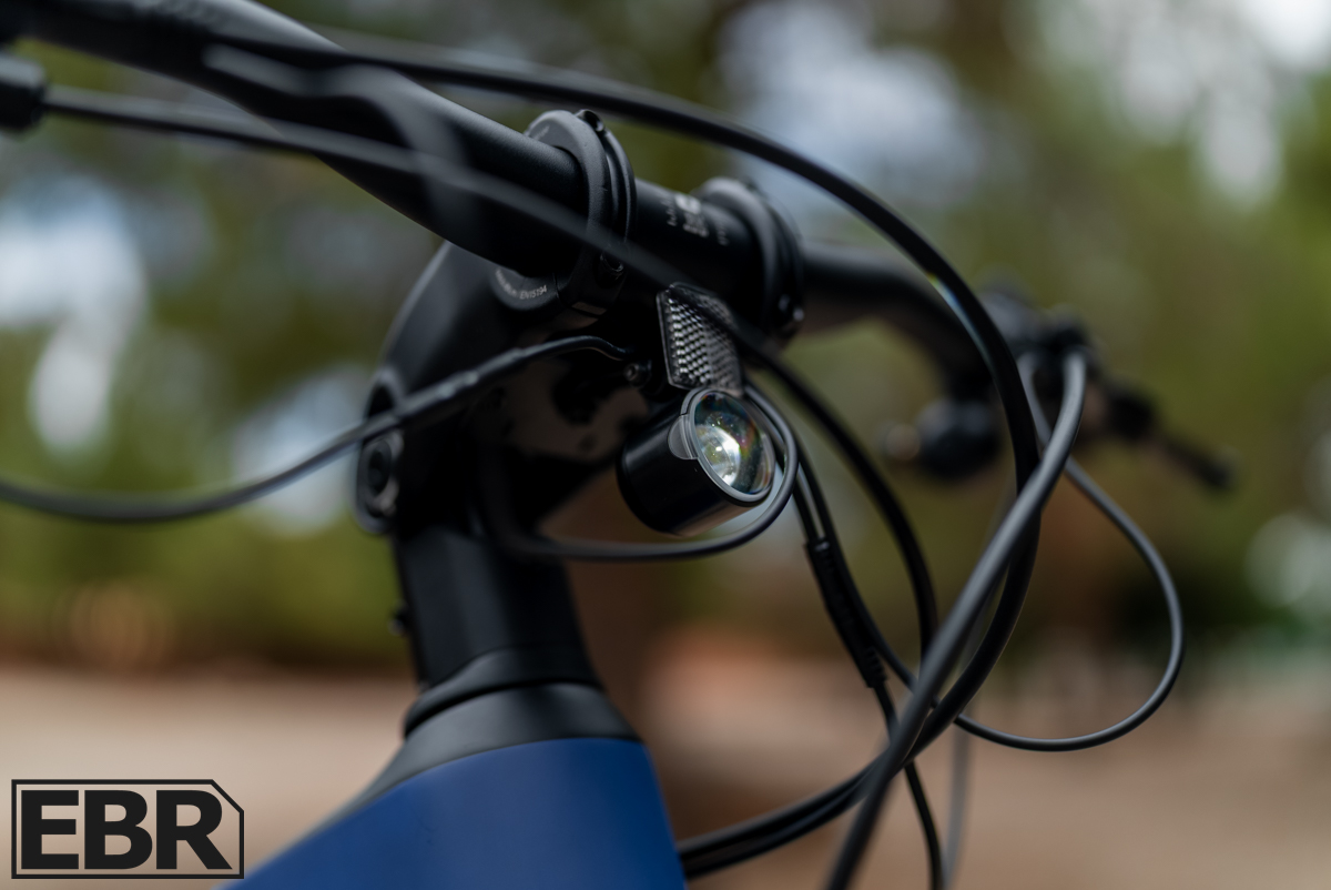

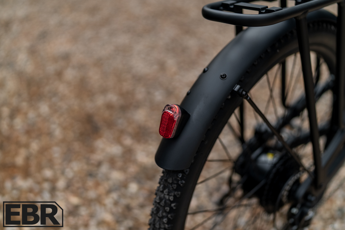

The included freebies with your Carbon Fusion Pro purchase extend well beyond the 4A fast charger and key set for battery removal. You also get front and rear fenders (alloy, painted black), a kickstand, and front-to-back lighting, specifically a 40-lux LED headlight and StVZO-compliant rear tail light. It’s a solid package that gets you road-ready right out of the box.
