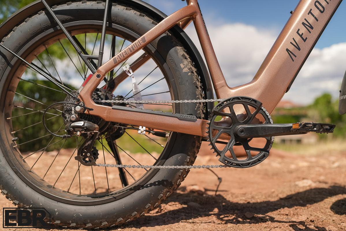

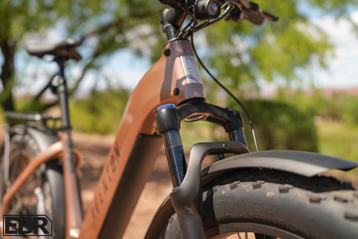

At first glance, the Aventure 3 might seem like a familiar fat-tire e-bike, but a closer look reveals meaningful updates. The redesigned frame, built with a new gravity-cast 6061 aluminum alloy, sports cleaner lines and fewer welds, resulting in a more rigid and responsive structure. Unlike the bloated frames common in fat-tire bikes, this one keeps things slim where it doesn’t need extra bulk, giving it a modern, purposeful look.

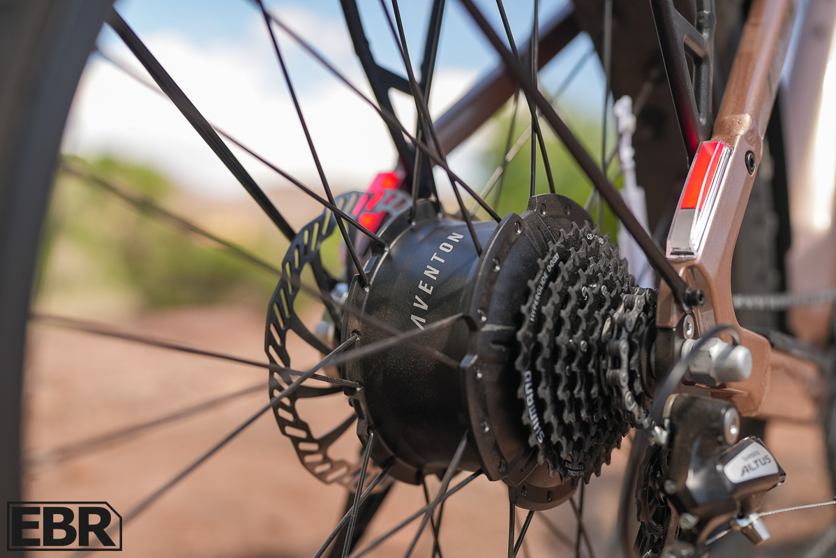

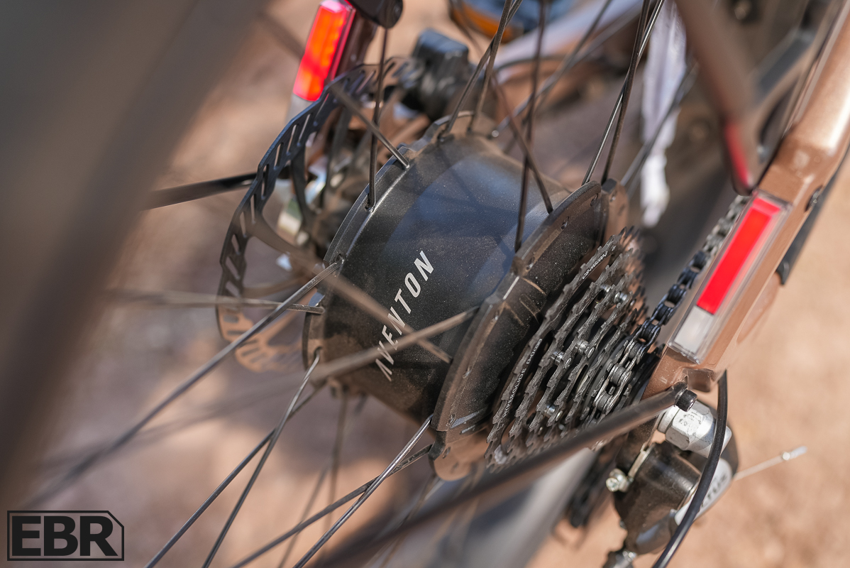

The 750W rear hub motor (peaking at 1188W with 80 Nm of torque) is paired with a torque sensor, a feature Aventon has refined in recent models. This setup feels smooth and natural, delivering power that enhances your pedaling without jerky surges—it’s like your legs are just stronger than usual. The motor stays quiet, only becoming faintly noticeable at higher pedal assist levels or speeds, making it unobtrusive for most rides.

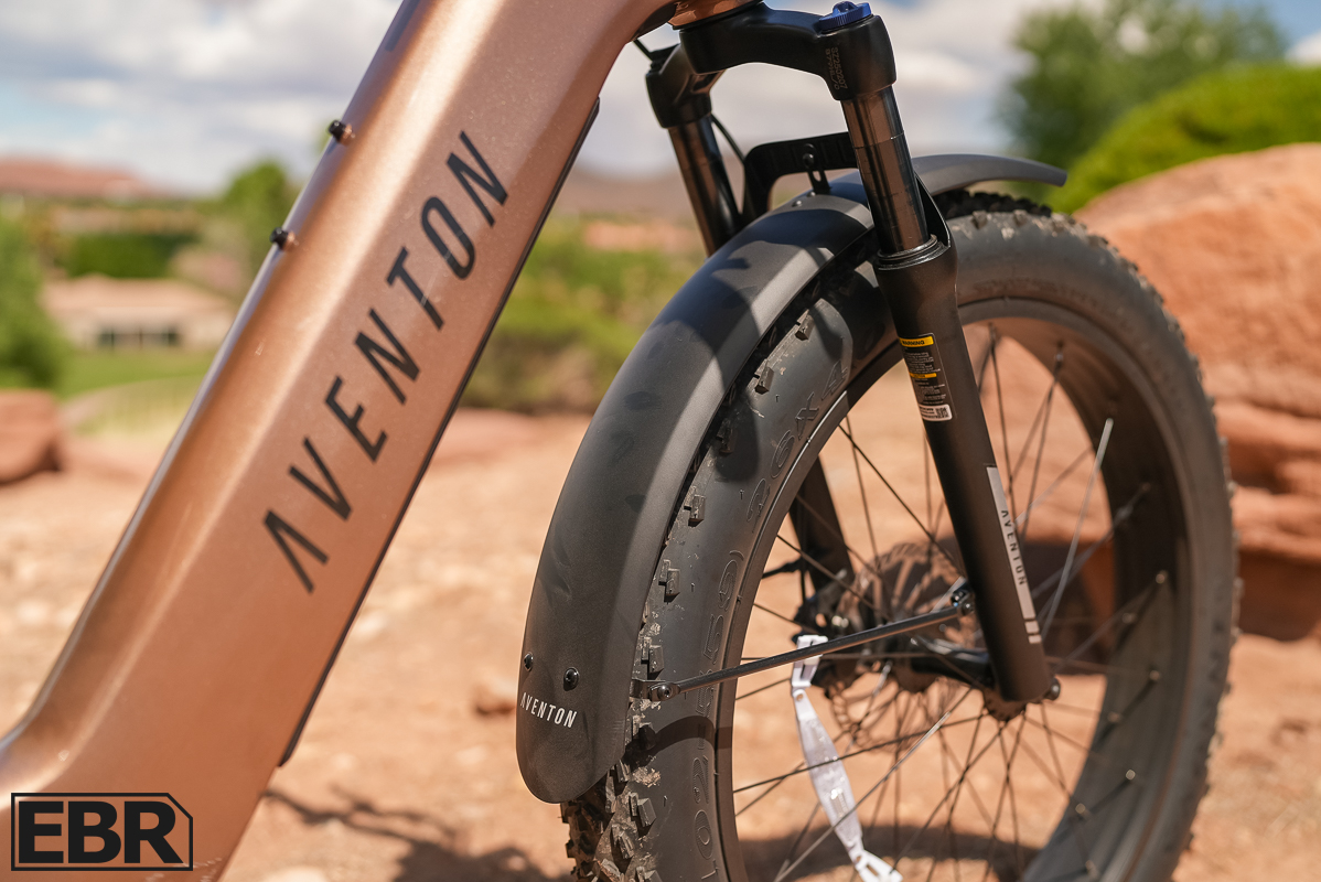

The 26” x 4” Innova tires roll over obstacles like a two-wheeled monster truck, a hallmark of fat-tire bikes that exploded in popularity during peak COVID years. They’re fun, capable, and surprisingly quiet on both pavement and dirt, adding to the bike’s playful, go-anywhere vibe. Whether commuting or hitting backroads, these tires make rough terrain feel effortless.

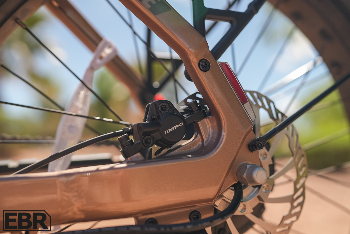

Braking comes from Tektro HD-E3520 hydraulic disc brakes, which provide solid stopping power for an 80-pound bike. They handle most situations well, but on technical off-road sections, I found myself wishing for a 4-piston setup for extra bite—a personal preference rather than a necessity. For general riding, these brakes are more than adequate.

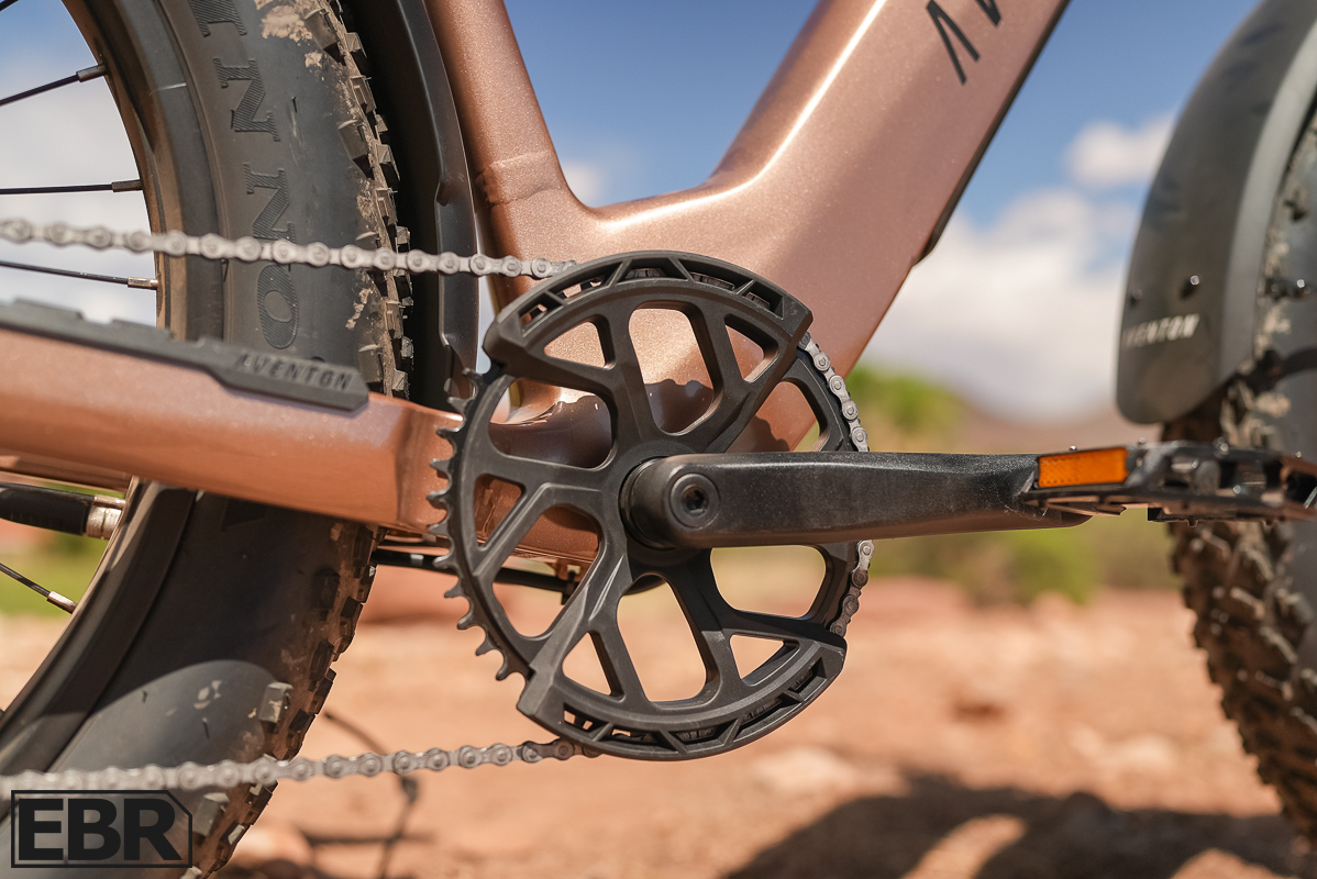

The Shimano Altus 8-speed drivetrain, with a 48T chainring and 12-32T cassette, offers reliable gearing for most scenarios. With pedal assist, I never felt limited by the range, as the motor picks up any slack when climbing or cruising at speed.

The Aventure 3 is powered by a 750W rear hub motor, capable of peaking at 1188W and delivering 80 Nm of torque. It’s activated by a torque sensor, a refined version Aventon has rolled out in recent models like the Abound SR, LR, and Level.3. This sensor is smooth, quiet, and intuitive, seamlessly boosting your pedaling to feel like your legs are just naturally stronger—no jarring surges here. The motor offers three pedal assist modes—Eco, Sport, and Turbo—each stepping up the power progressively for everything from leisurely cruises to faster trail rides.
Out of the box, the bike is configured as a Class 2 e-bike, capped at 20 mph for both throttle and pedal assist. With a few taps in the Aventon app, you can unlock Class 3 performance, bumping the throttle to 20 mph and pedal assist to 28 mph. The process is simple: acknowledge a liability waiver, agree to follow local laws, and you’re set—no tools or hassle required.
The battery is a 36V, 19.88Ah system with a total capacity of 733Wh, using LG 21700 cells and carrying UL 2271 safety certification. Aventon’s decision to standardize 36V batteries across multiple models is a smart one, streamlining production and keeping costs down without needing unique batteries for each bike. This also benefits owners, as spare parts like batteries, displays, and controllers will be easier to source down the line—a critical consideration when a broken component can sideline your bike, especially if the brand discontinues support. With this shared platform, Aventon can stock spares more readily, a win for both the company and riders.

The drivetrain centers on a Shimano Altus 8-speed setup, including a 48T chainring, a 12-32T cassette. A three-piece crankset with 170mm arms, and flat alloy platform pedals provide a solid gear range that handles most rides, especially with pedal assist to cover any gaps.
Braking is handled by Tektro HD-E3520 hydraulic disc brakes with dual-piston calipers and 180mm rotors (1.8mm thick) front and rear. This setup provides sufficient stopping power and performs reliably in testing. However, on a bike weighing over 75 pounds with massive 4-inch tires, I found myself wishing for 4-piston brakes to better manage the rolling mass, particularly on technical off-road sections. The dual-piston brakes get the job done for general riding, but heavier bikes like this could benefit from extra braking muscle.

The wheels are 26-inch double-wall aluminum rims with steel spokes in an offset pattern, built to handle the rigors of fat-tire riding. They’re wrapped in Innova 26” x 4” puncture-resistant tires with a subtle, all-terrain tread that performs well on everything from pavement to trails. I added Slime to the tubes for extra flat protection and ran the tires at 18 PSI, striking a balance between traction and comfort. These fat tires are like pillows for the bike, soaking up bumps and rolling over roots and rocks with ease, making rides both comfortable and fun.

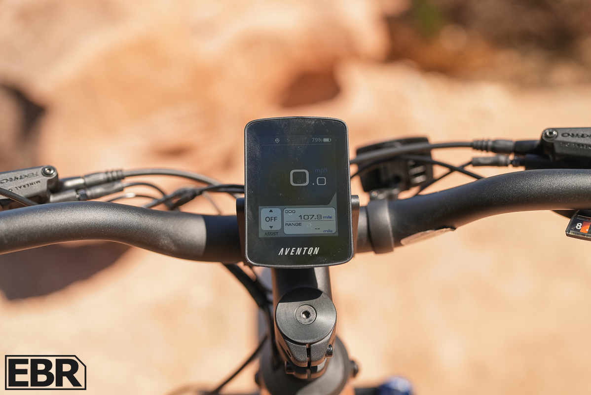

The Aventon Aventure 3 is equipped with a BC280 center-mounted display, a clean and functional color LCD that shows all the essential ride data: battery level, time, odometer, speed, and pedal assist (PAS) level. Cycling through the screens is simple with the three-button control pad on the left handlebar, letting you access additional metrics like trip distance or max speed without fuss. The display is clear and readable in various lighting conditions, including direct sunlight, which is always a win.
The Aventon app, paired with the Aventon Control Unit (ACU), brings a suite of tech and security features that set the Aventure 3 apart. With 4G and Bluetooth connectivity, the app offers GPS tracking, ride logging, and real-time bike stats, syncing data to the cloud for easy access.
Security is a major focus on the Aventure 3. You can remotely lock the bike, set geofencing boundaries, or enable a passcode-protected login to deter theft. The ACU also includes a rear wheel lock and battery alarm system, plus abnormal event logging and power status reporting, giving you peace of mind when the bike’s out of sight. Over-the-air (OTA) updates keep the system current without needing a trip to the shop.
Beyond security, the app enhances customization. The Ride Tune feature lets you fine-tune the feel of the three PAS modes (Eco, Sport, Turbo) to match your riding style, adjusting how the motor responds to your pedaling. You can also switch between Class 2 (20 mph throttle and pedal assist) and Class 3 (20 mph throttle, 28 mph pedal assist) with a few taps, provided you accept the liability waiver and agree to follow local laws. I do like ditching the physical keys and moving to the keyless battery system—locking and unlocking the battery is handled electronically through the app or display, eliminating the need to make your existing key set any bigger..
